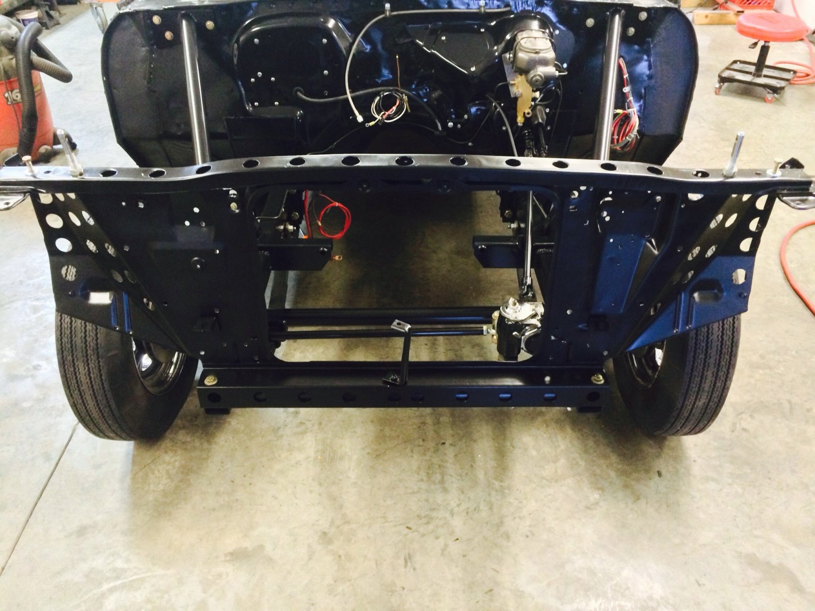

    A little Progress, plus my valve springs arrived today should have my heads back tomorrow !! image.jpg Seats are mounted..... image.jpg Core support blasted and painted.... image.jpg Getting some done ;)

    Looks fantastic Art... Can't wait to see it run!

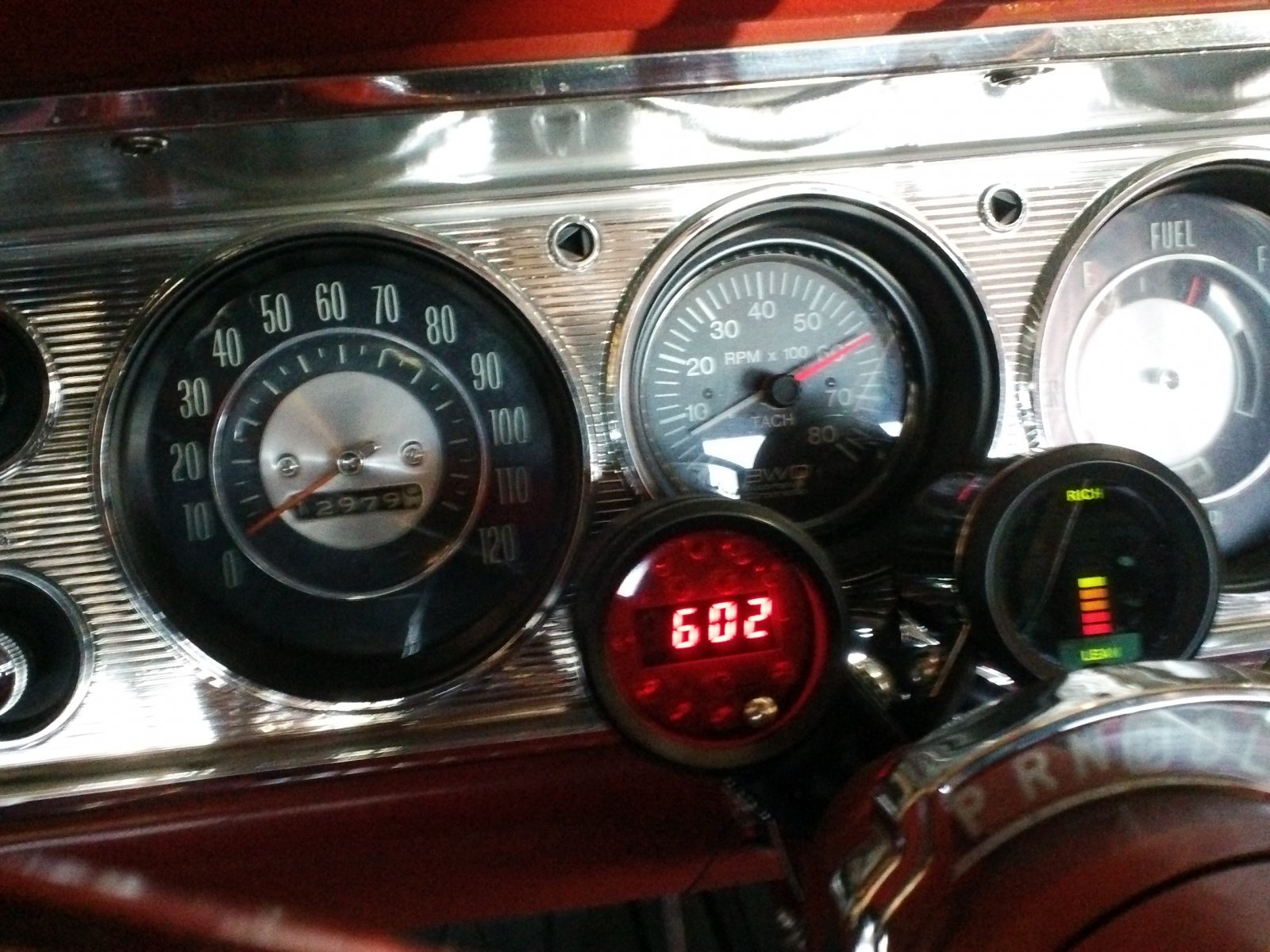

    The (narrow band) bar graph air/fuel ratio gauge is from Summit Racing
    part # IZL-MS7008 for $37.97.
    Dyno max 02 bung (weld on header collector or exhaust pipe)
    at Advance Auto part # 88103 for $14.49.
    Bosch narrow band Oxygen sensor at Advance Auto part #11027
    for $17.99.
    Sooo for about $75.00 the center green lights tell you when are at ideal clean
    14.7 emission air/fuel burn. (Not the ideal 12.2 max. power ratio.)
    The best gauge for the job is (Much More Expensive) wideband gauge and controller.
    FAST dual senser air/fuel meter Summit part # fst-170402 for $417.97.
    But I am Cheap,Cheap,Cheap, and always figuring out a Cheaper patho_O
    Sooo using (narrow band) 1st tune for the green lights. 14.7 ratio.
    Max gas mileage tune for orange & 1 green bottom lean end of gauge.
    (when 2 orange/no green lean you will start to get a lean miss):oops:
    Max Power tune jetting in steps (sneak up slowly) until both red rich lights are on
    at W.O.T. :cool:
    Finally tune with 1/4 max m.p.h.:)

  8. Darn kids and their computers... whatever happened to a weather station barometer and a vacuum gage?
    Fancy version of a Colour Tune and an air meter!

  12. if you can ever afford A/f meters in every primary tube you'll learn things that plug reading could never teach

    Got mine after a bad chassis Dyno tuning experience:(. (The Guy just wanted to sell carbs).o_O
    He started several pulls (shut down early said we were lean) jetted up several times and never made
    progress on his gauge.o_O Installed two of his carbs. and never got good results.
    Lost all my tuning confidence and drove home less $180.00 for never a good pull and with my 750 in my hands.
    Not many wide band kits were available then, but this gauge will at least let me know (dangerous lean)
    and get close.
