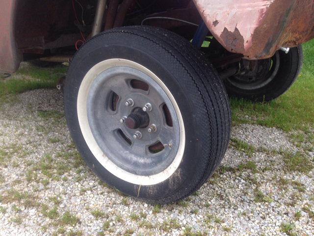

    Thanks Saltflats, she'll go down the track, I'm still worried about that front right tire shimmy...! Had it rebalanced 1.5 oz off?!? I don't think being that far off would make it bounce like a basketball...! Steering Gearbox is rebuilt & tight now... Next I think I'd change front tires or shocks too... Need to get out on some back roads like around the Grove & give er...! See what it does at about 90mph...

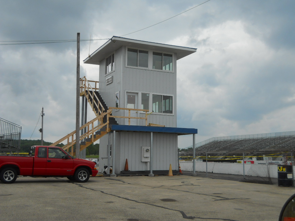

    ...here's pics of the new Byron timing tower,(3 stories now).. heard they re-did the starting pad and part of the strip also. 2015 meltdown 001.jpg 2015 meltdown 002.jpg 2015 meltdown 003.jpg

    Kind of like to think the success of the Meltdown event was a major contribution towards all those upgrades.
    Supporting the event - and - supporting the track are some of the main reasons I come back every year.
    Well done kids... well done

    On a tip from racer-x, I had the front tires Hunter Road Force Balanced... Found out why the right front bounces at 90mph. Both tires are out of round & R/F is way worse! From printouts the rims aren't bent so that's good... So looks like front tire time!?! I'm not sure what tires I should look into? Coker has some the are radials with bias ply look or nostalgic look, but have S rated for 112mph... Or something like M/T front runners? Scott got Hurst piecrust tires for rear, so I'm thinking nostalgic for front? What do you guys think?

    Jimbo I have towel city tires on my Willys and I drive it a lot and it's been 128 mph (at least according to the cops lol) and no problem so far and they not only look right they drive great

    Hey Scott found this on the drag cars in motion thread today thought I would stoke the fire a bit

    Coker now has a radial that looks like a vintage bias ply.
    That might work nice with those Hurst tires that Scott picked out for the car,as they are recapped radial casings.

    Wrenchbender, are the tires in pic recaps? I'll have to check their website again, but I think they are...

    Yes jimbo they are just as the slicks in the rear are as well

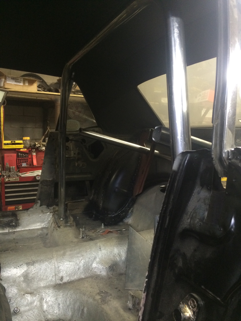

    Main hoop cut,fit,and tacked in,door bars going to be bent this morning,rear bars going in tomorrow after work.
    Rear spring relocation kit installed,welded out,and painted,and springs reinstalled.
    ImageUploadedByH.A.M.B.1433153347.232859.jpg ImageUploadedByH.A.M.B.1433153365.016915.jpg
    And if anybody wants all this Model A stuff,come get it.Im out of room,and time to work on it.
    Should be assembling the motor very soon also:)
    Not sure if I should cut those tacks and lean the main hoop back to match the angle of the quarter windows,or leave it perfectly straight?As it is,it almost looks like its leaning forward because of the angle of the window post.

    Lean it back...if you already noticed it, then it will bug you later.
