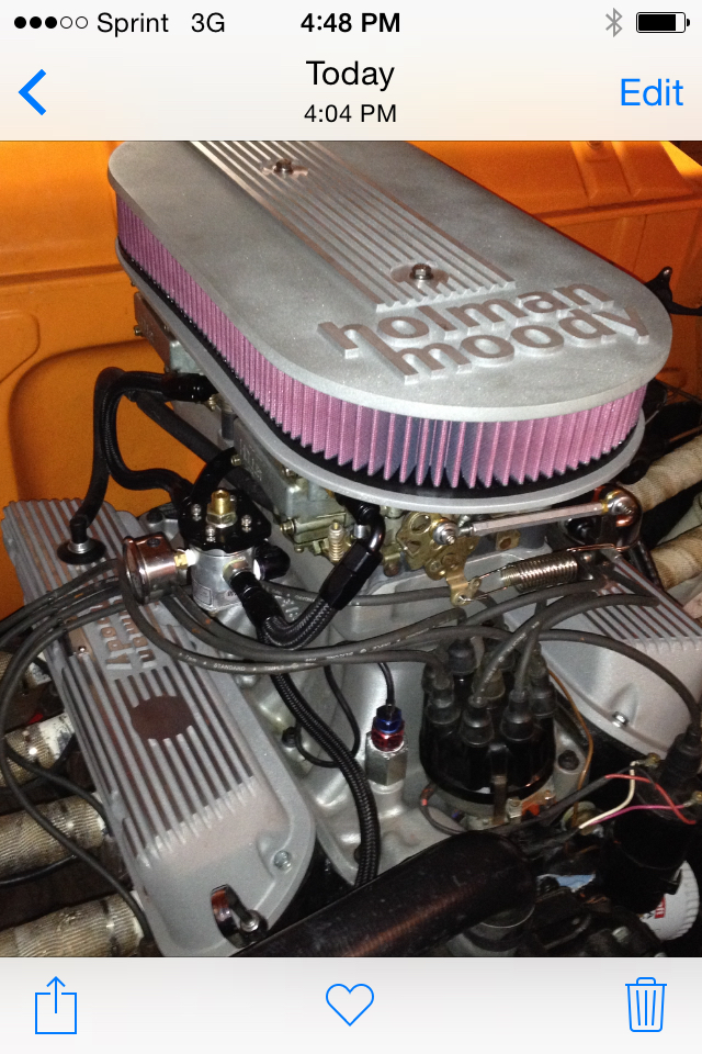

    Hey Rick, yes pulled air cleaner off... I'm using a Holman Moody oval air cleaner now instead of them 2 I had on the clog ram...

  3. how tall is the filter?

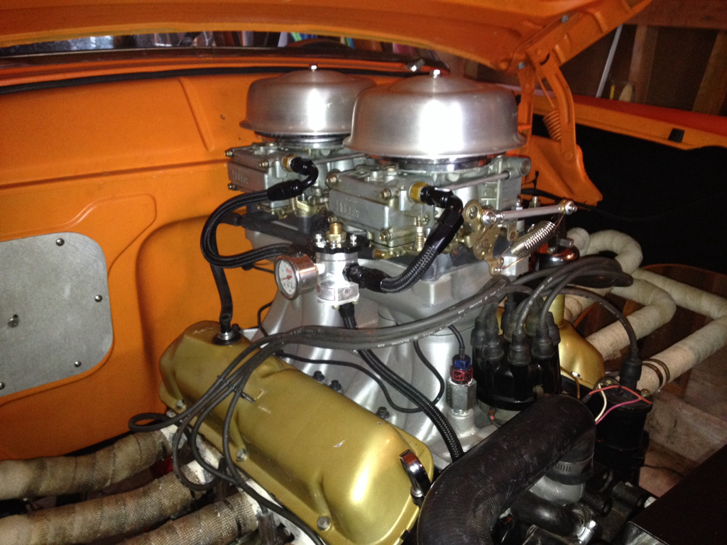

    RIC, it's 1.75" tall, looks to be K&N brand filter... Here's pic of old setup & new ImageUploadedByH.A.M.B.1434072048.468889.jpg ... ImageUploadedByH.A.M.B.1434071920.221760.jpg
  5. If you have more room with the hood scoop, get the tallest element that'll fit, or glue two together with weather strip adhesive. For racing, make big air pan that seals to the under side of the hood with the carbs isolated from engine heat, and able to gobble air from the scoop openings. Lots of induction there trying to breath thru a small element with the lid close to the choke horns, vent tubes etc. You got a choke chain on your Doberman brother.

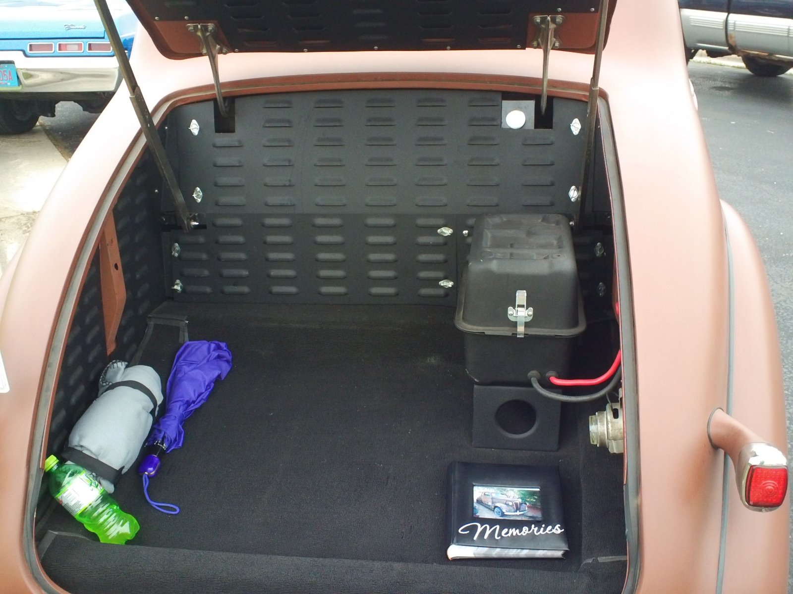

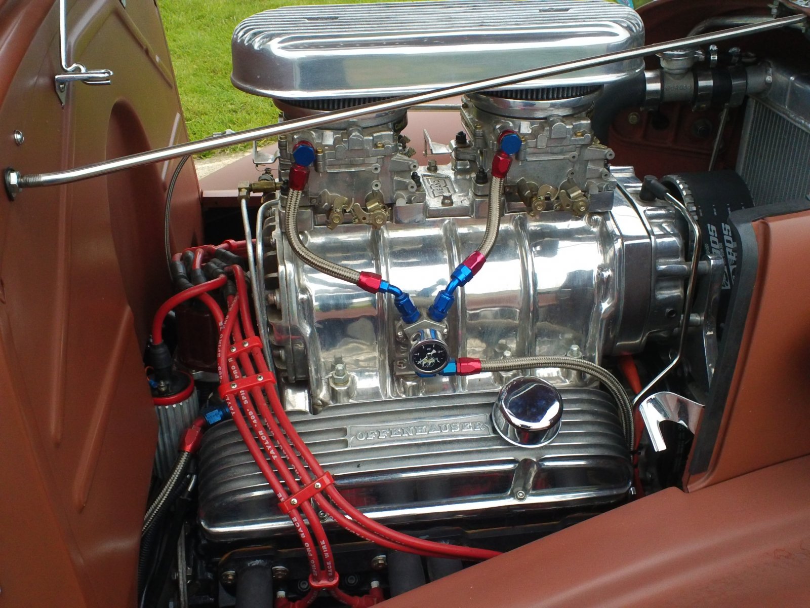

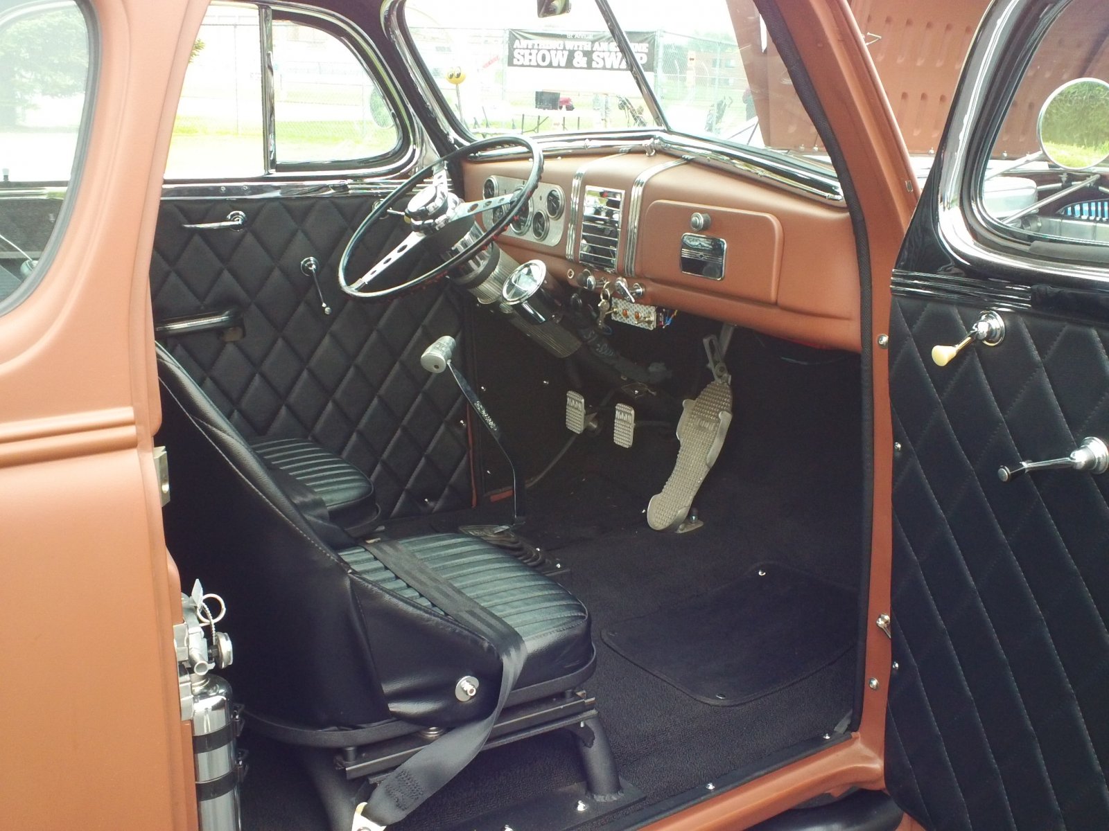

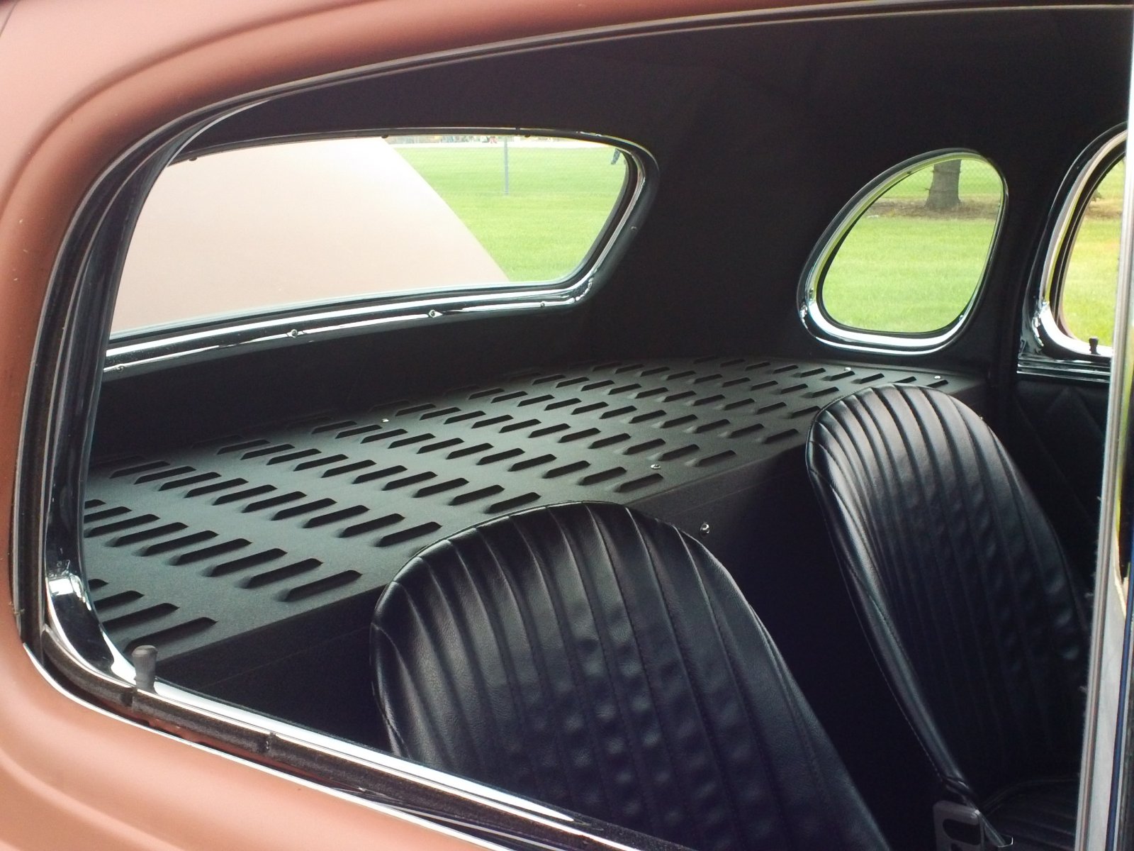

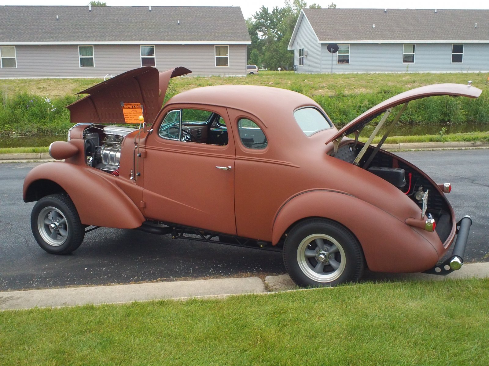

    37 chevy left side.JPG 37 Chevy engine.JPG 37 Chevy Dash.JPG 37 Chevy  rear deck.JPG 37 Chevy  trunk.JPG
    Took some pics. Saturday at a Car show in Brillion Wisconsin of a nice 37 Chevy that Todd
    Built into a G***er (they might bring to show) :)

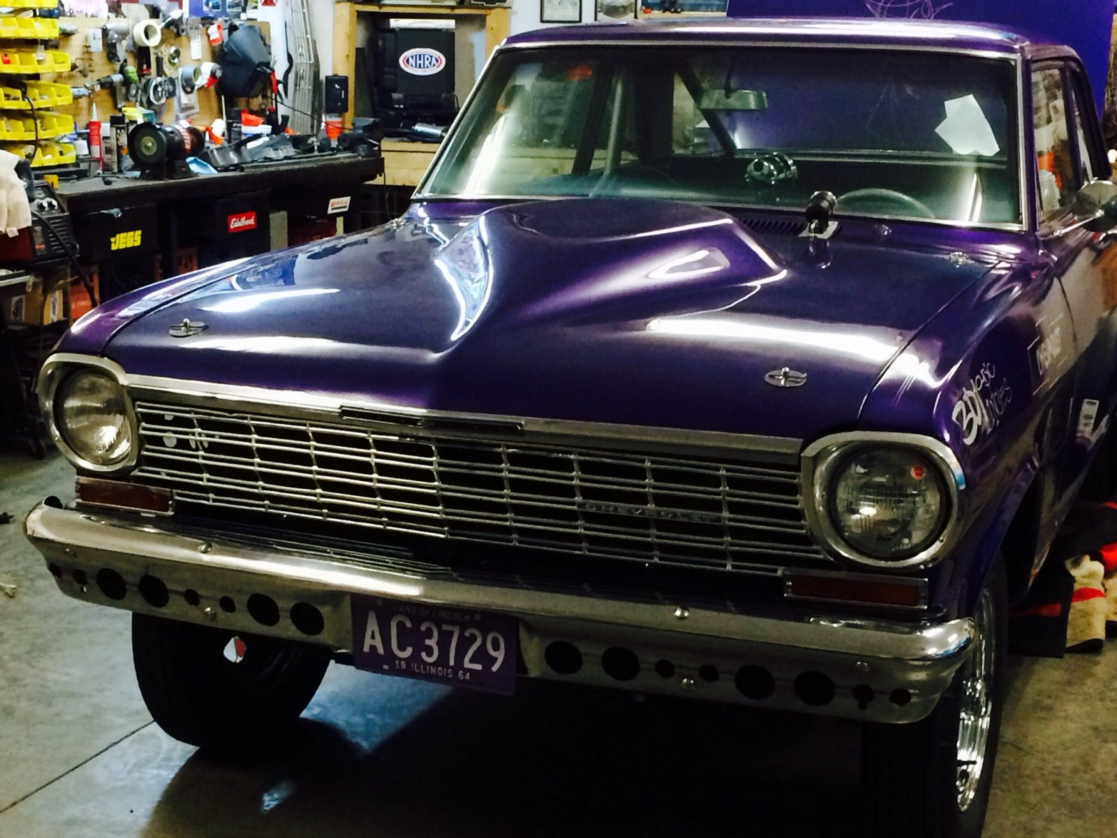

    Well I got some help from some of the No Club Guys and got the FURIOUS running now to start the fine tuning

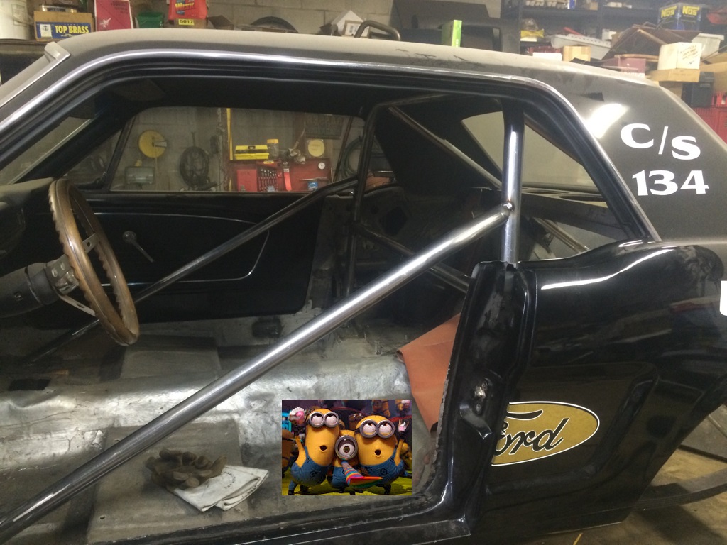

    Got the old Toploader out of the car last night,bellhousing bolted to the Nash trans,and to the mockup block.
    Cut the floor for the shifter (ouch),and mocked up some seat/harness stuff,as well as tacked hood pin brackets on and marked n drilled the hood.
    Exhausted.Need an apprentice.lol!

    That's perfect Tony!
    Maybe he's smart enough to not tomahawk himself by dropping a 24"x3"X1/8" piece of steel onto his own head by knocking it out of the rack with the top of the ladder...?lol!
    That one definitely buckled my knees for a second.[emoji44]

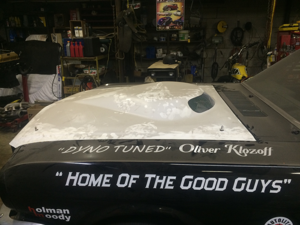

    All those spots on the hood it almost looks like a reverse Dalmation

    Those are all my fingerprints in the thick coating of grinding dust.....Im gonna be itching for a year after working on this thing!lol!
