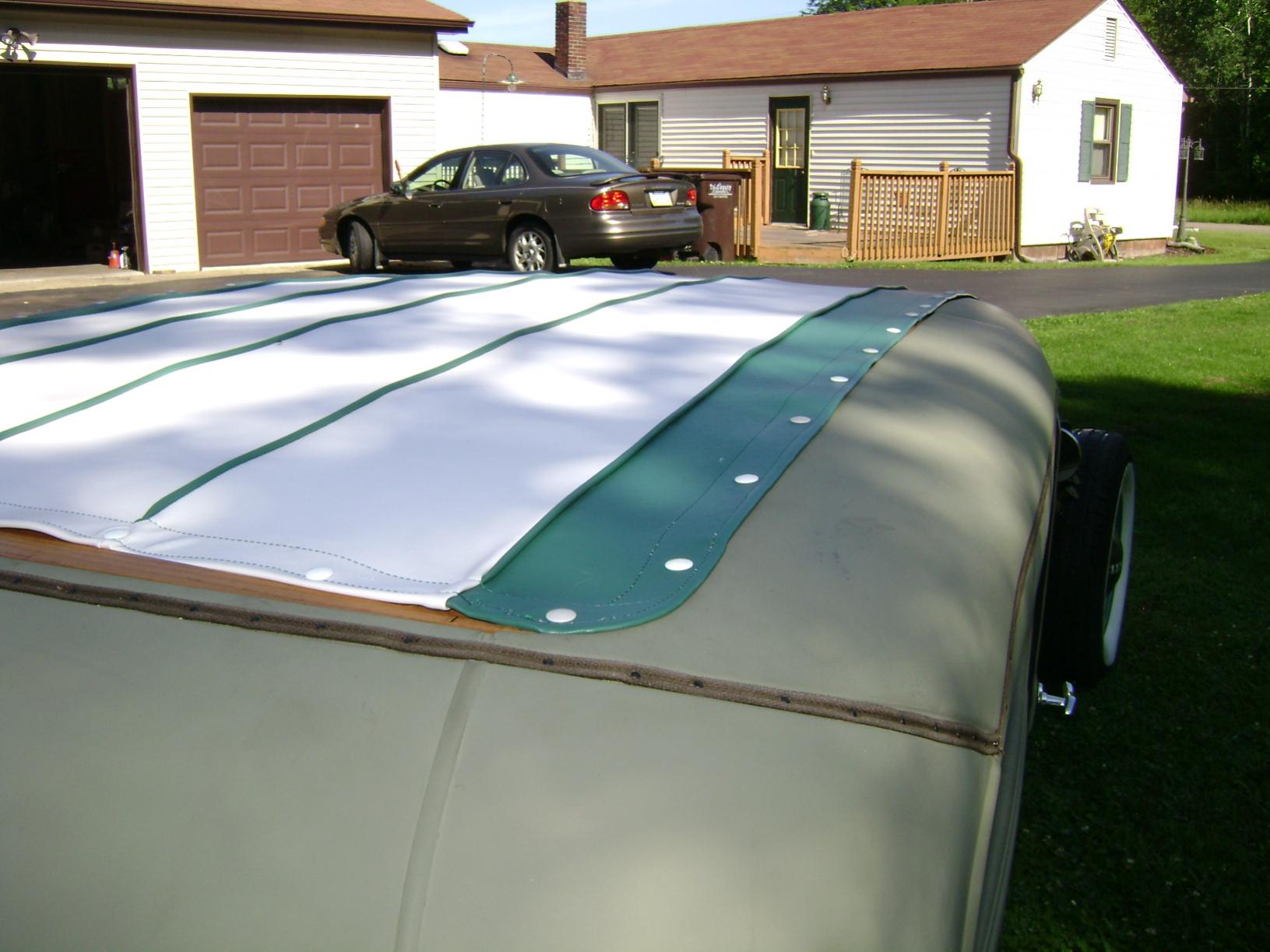

  9. Black vinyl from a upholstery shop, chicken wire from a DIY shop and 1/4 inch soft foam sheet also from the upholstery shop. Tacks and nails. Fine aluminium roof gutter from a R/V camper supplier. Old school. :D:

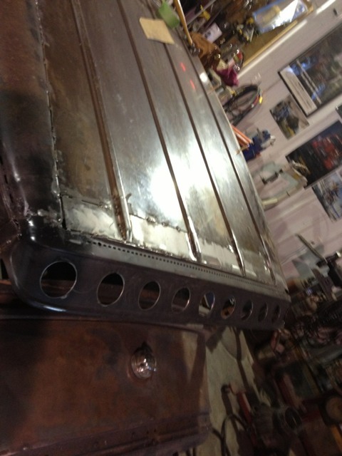

    I used a roof off a 70's chev van worked great, but it was a little short had to work some magic on the front and back ImageUploadedByTJJ1360337552.203621.jpg ImageUploadedByTJJ1360337567.009872.jpg

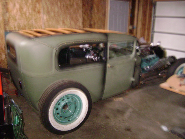

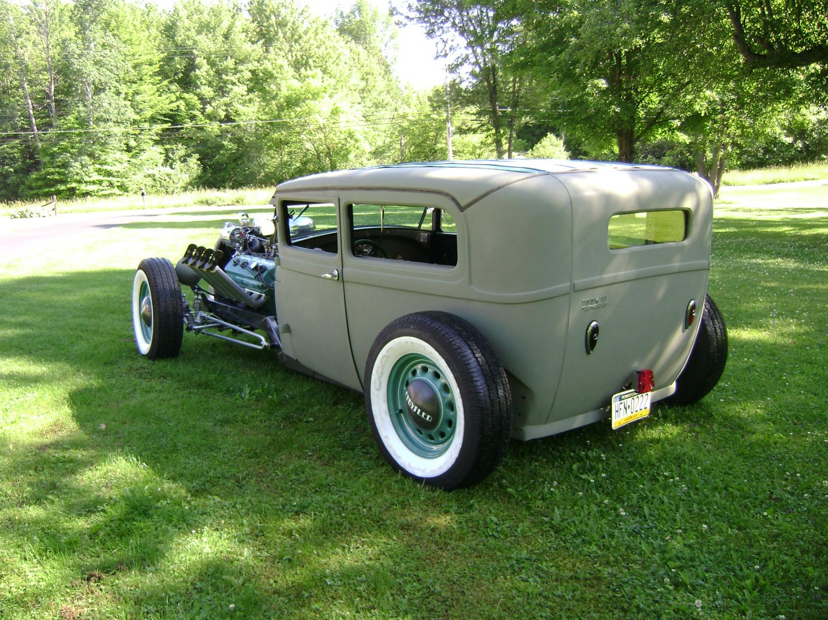

    when i built the 29 , i used a new wood kit from SNYDER MODEL A & T PARTS then i had a local amish guy sew me together a snap on top . it worked great , i could un snap and drive like a semi convertable , but i also drove it in 25 degree weather and a couple of times in very heavy rain .

    I purchased an insert from Howells and was extremely disappointed (another thread). I ended up modifying what they sent but this is what I would do now. Make a pattern to set into the recess surrounding the roof opening. Install a wood kit as I did to support the flat roof. If you are using the steel roof brace across the center, bend it down to the level of the wood. Cut a piece of 18 gauge to match the pattern and set into roof opening. Weld and finish like any body work. After the insert was installed, I caulked with PL Premium between the ribs and the insert. The roof is dead silent. I wish I could get pictures posted but you can look at it here. http://www.flickr.com/photos/52296758@N06/
    This install was so easy except for paying and modifying Howell's piece.
