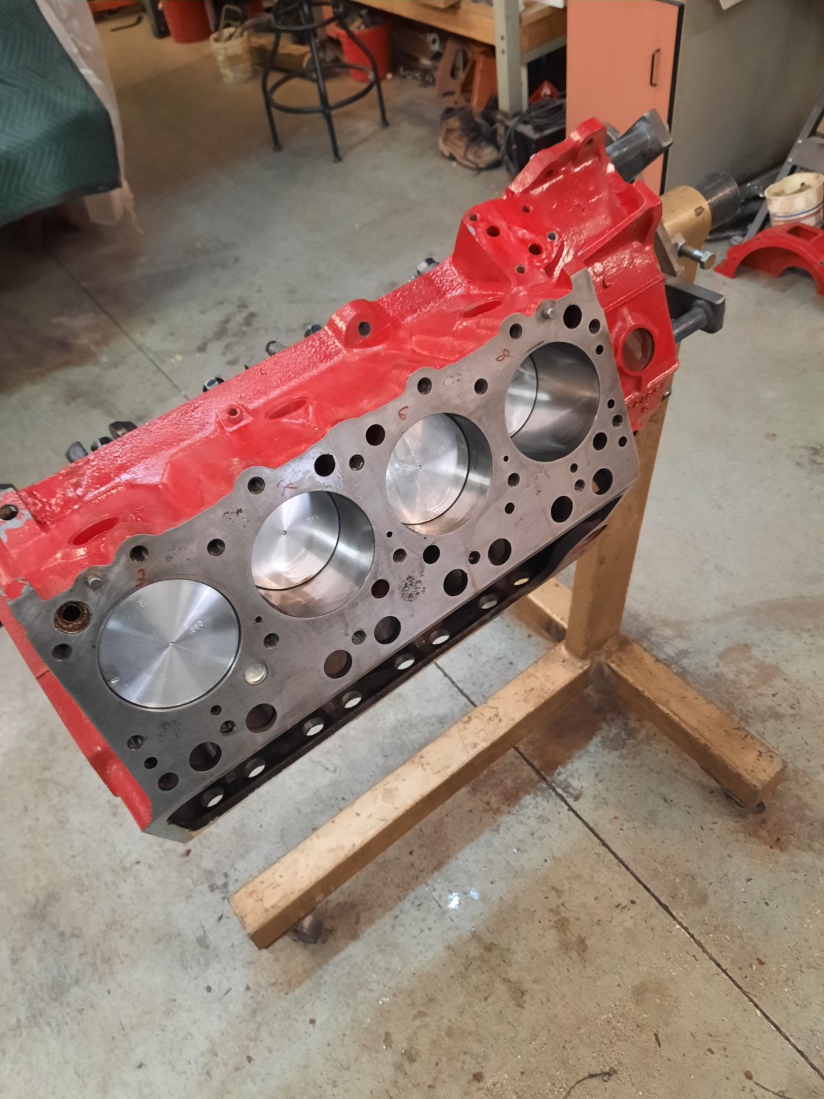

    Installed the pistons back in the rocket installed the solid roller from Ross. 20240330_134826.jpg 20240330_134814.jpg 20240330_143732.jpg

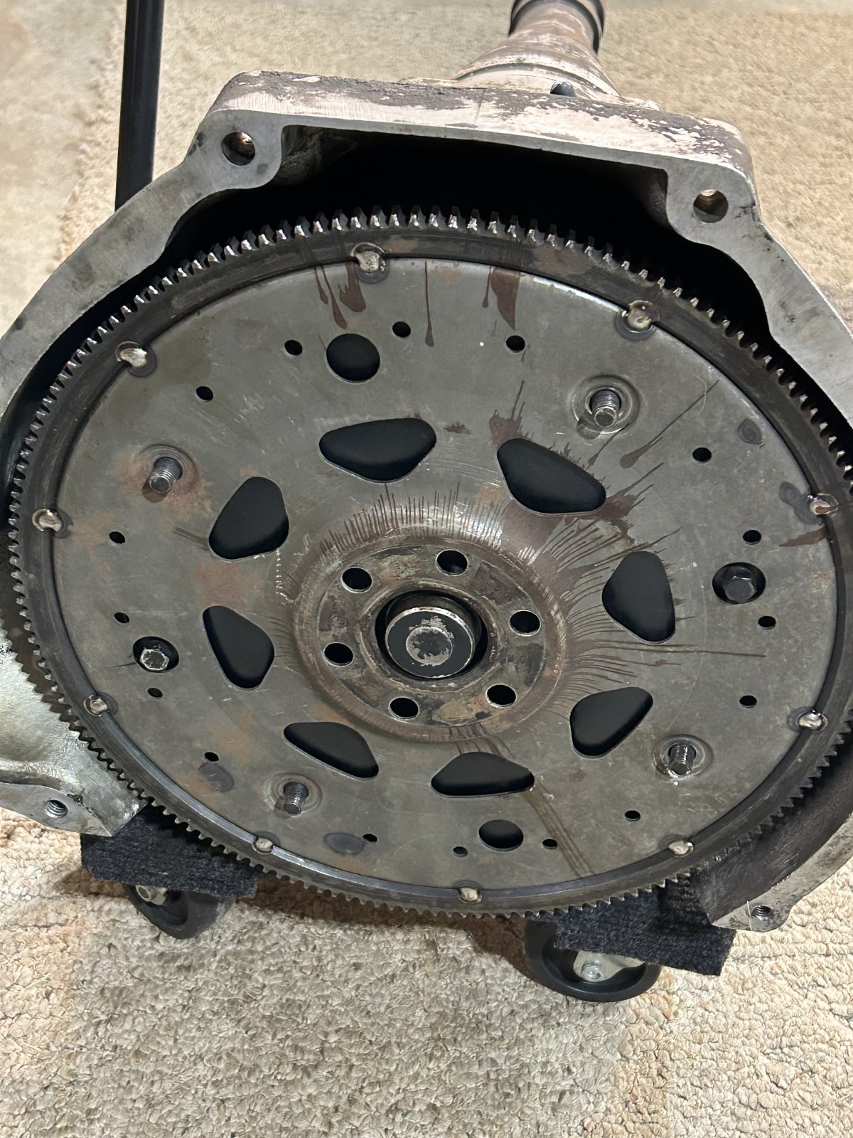

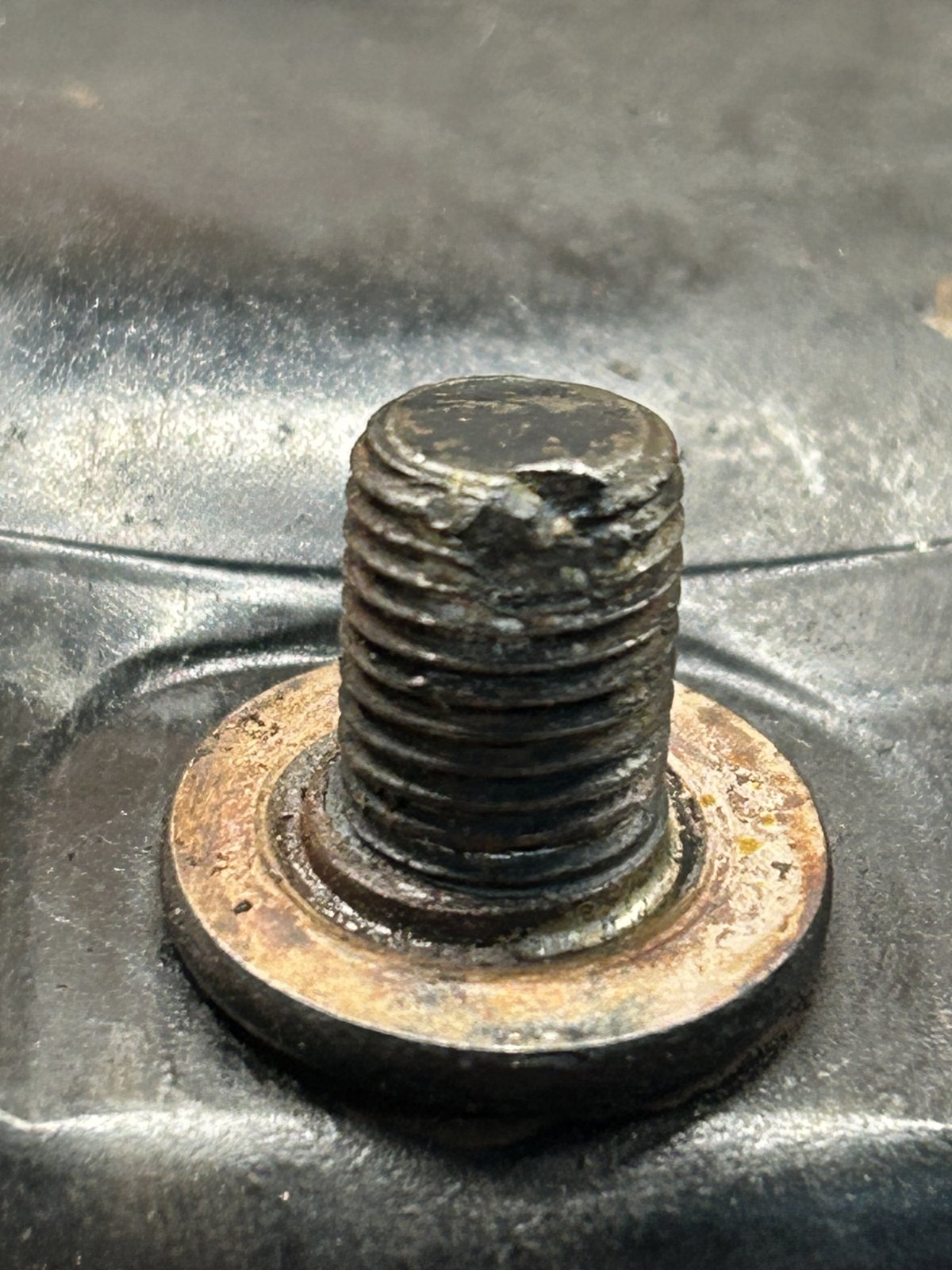

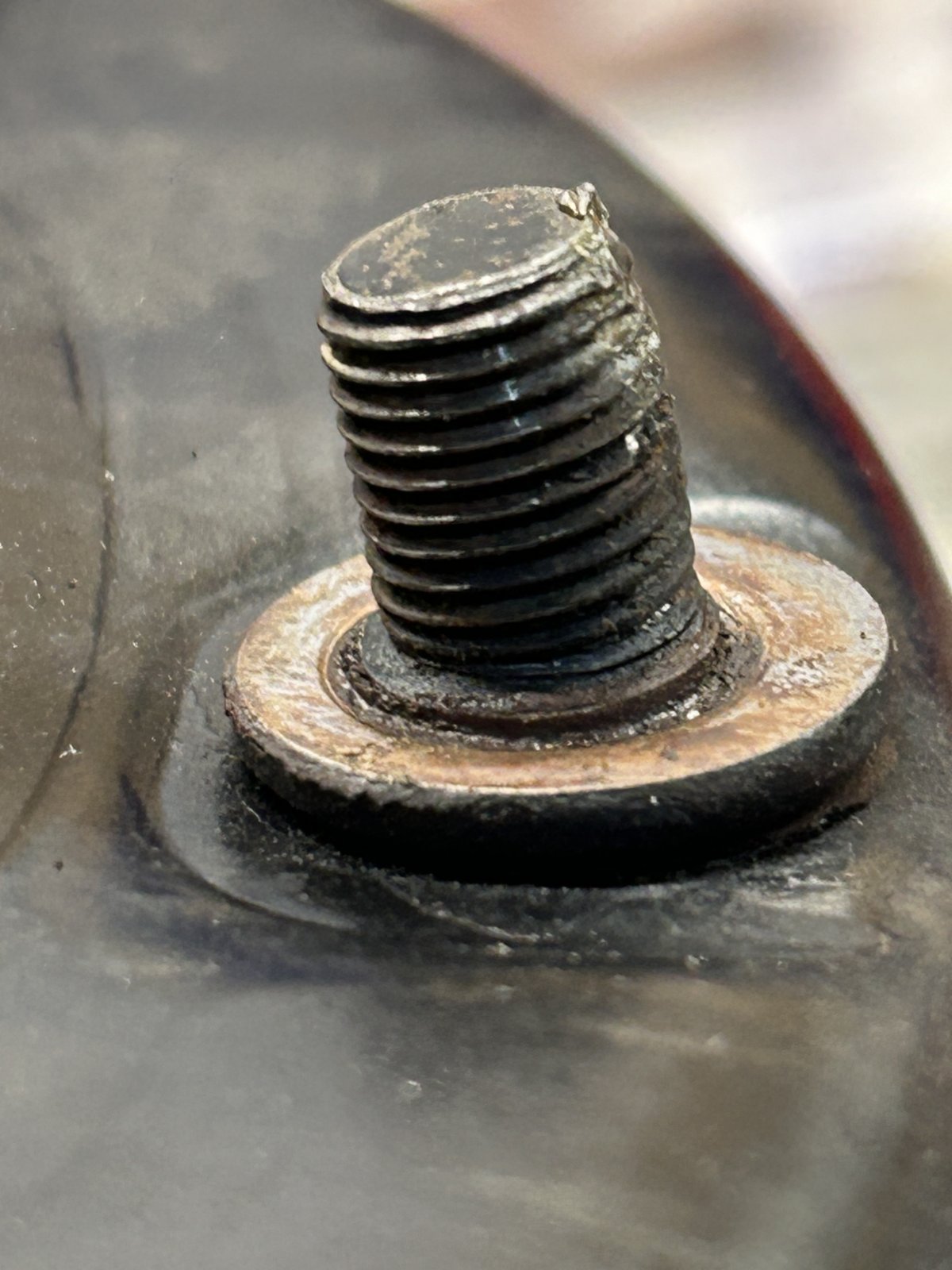

    IMG_1138.jpeg IMG_1139.jpeg IMG_1143.jpeg Productive day, I THINK.
    When I moved about a year and half ago to my new place, one of the guys helping me move decided to pick my Merc transmission up and load it on the trailer alone. The torque converter dropped off and hit the floor bending and boogering one of the flex plate mounting studs.
    I chased the threads, that went ok. Then put a nut on the stud and tried to bend it straight using an offset box end wrench. That would just flex the wrench.
    Plan B, take a 1/2” extension and a couple pound sledgehammer to knock it straight. It worked, but really had to wail on it. I took about half the bend out until it would fit the flex plate. Worried I’d damage the front pump or something if the kept at it. We’ll see….

    I doubt you'll hurt the pump, the pilot on the front of the converter locates the converter in the crank, so the studs are just along for the ride.

    Oh, I should have mentioned I was wailing on it with the converter on the transmission. Kept moving around trying to bend it and knock it straight on the bench or floor.

    oh...hmmm....

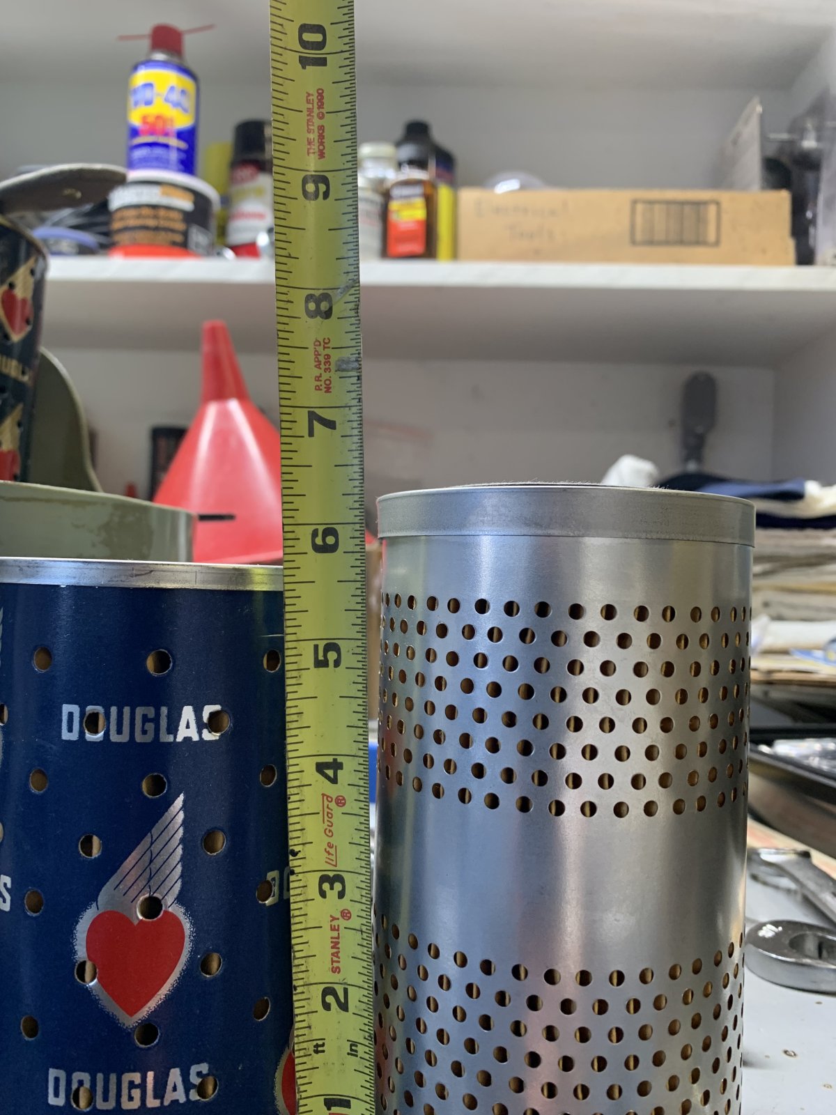

    Got a ways to go, but here's more progress on the oil to air filtration upgrade: PXL_20240406_203718053.jpg

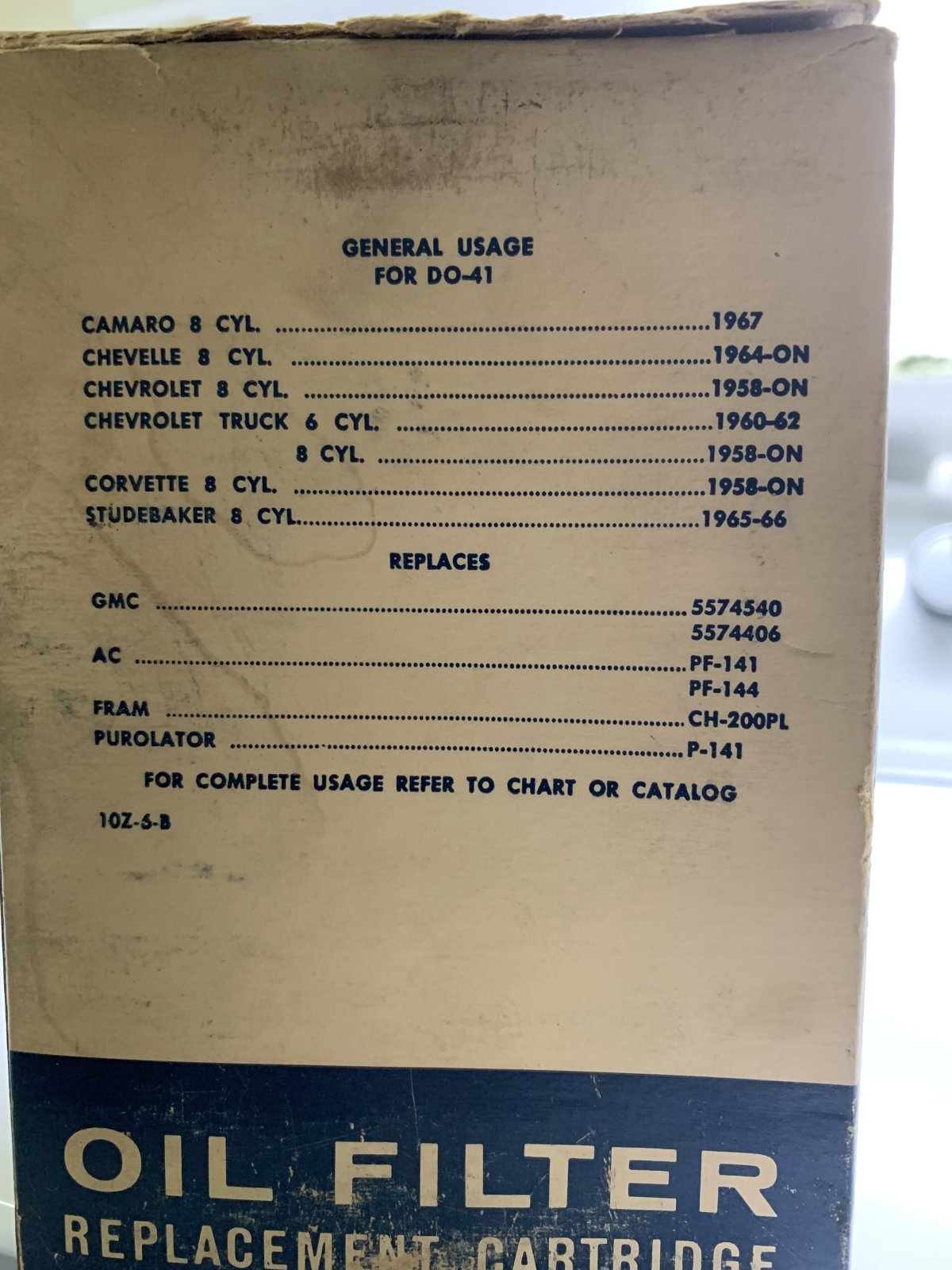

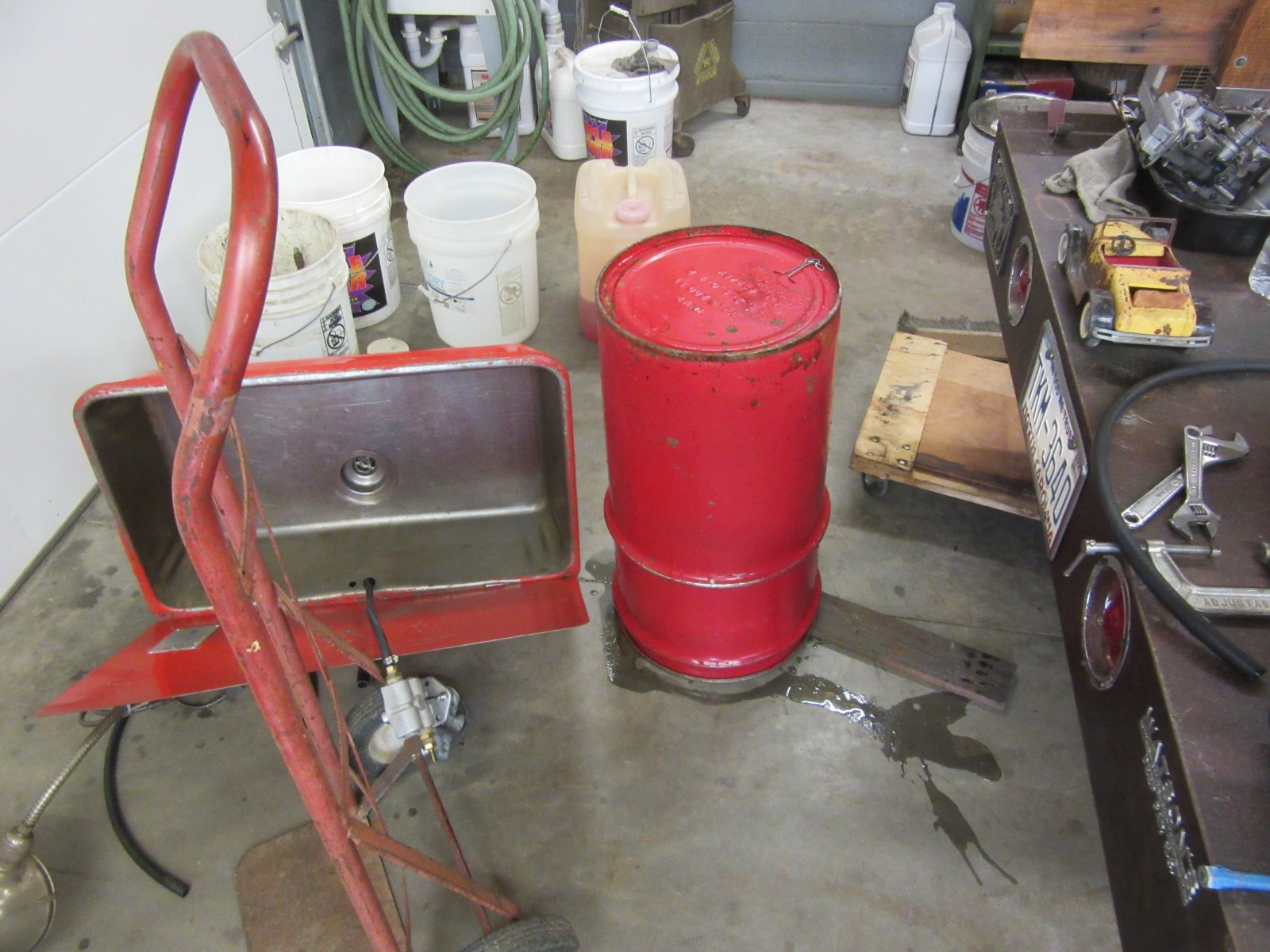

    It has been about 35 years since I have built a Torqueflight but here we are. I serviced my parts washer and was totally surprised at the current price of mineral spirits. IMG_1319.JPG IMG_1314.JPG

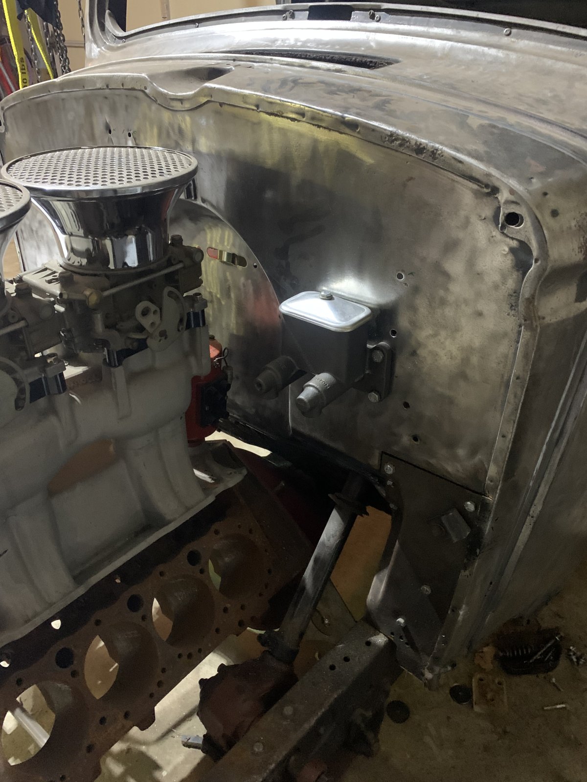

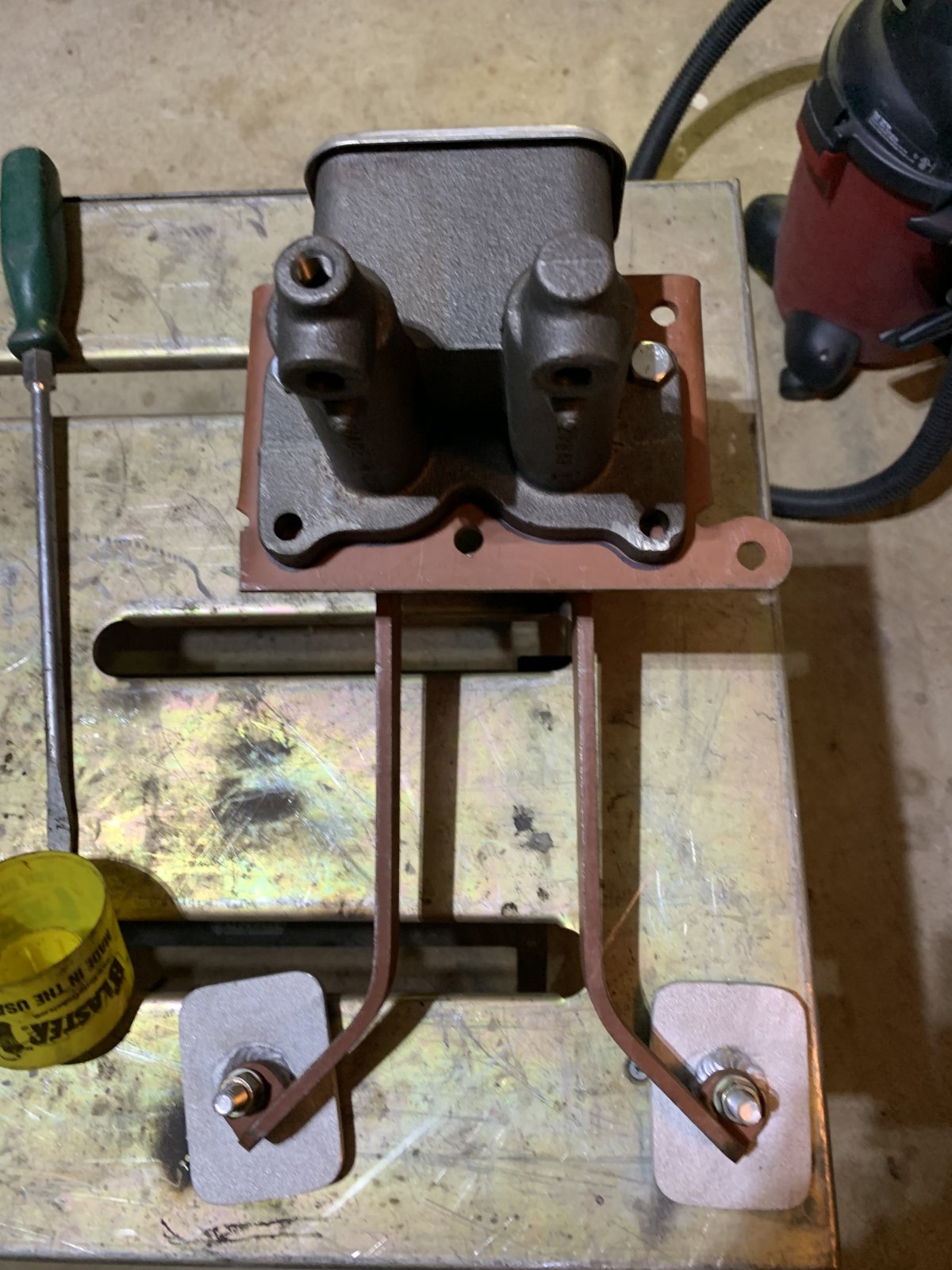

    Master cylinder and pedal install:

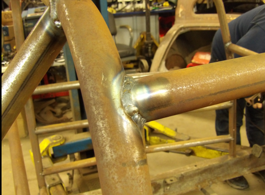

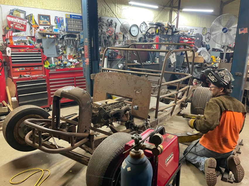

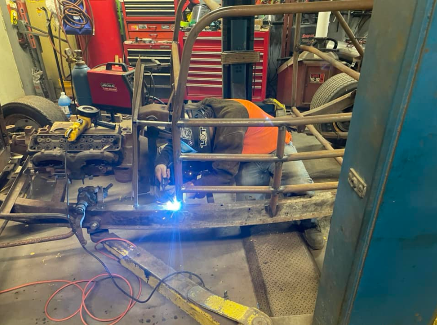

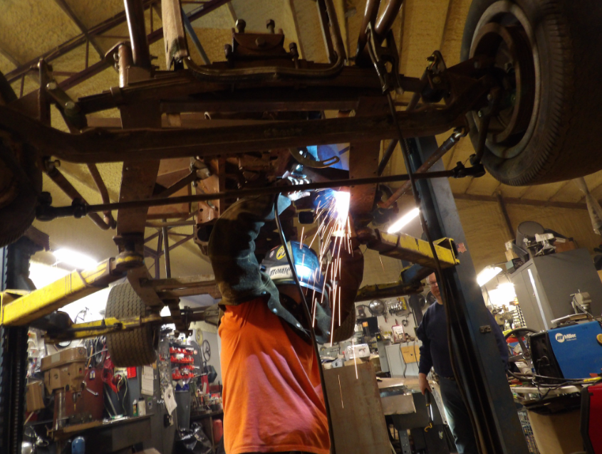

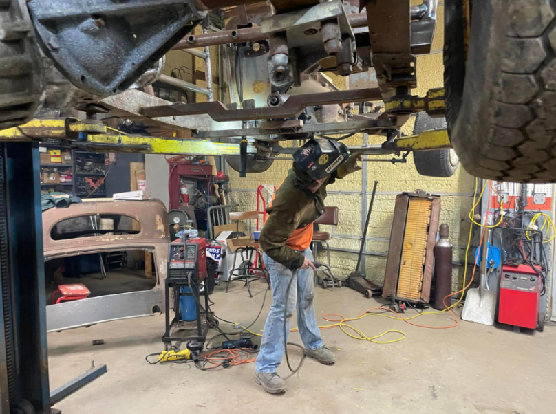

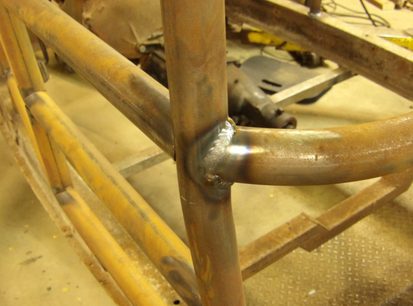

  12. Yesterday's project to weld up the cage in Jeff and John Hager's 33 Chevy Stock car/Hot Rod project.
    The body is an old Middletown (Orange County Fairgrounds) Speedway (NY) car. The ch***is and cage are built by the Hagers the frame is a 49-54 Chevy which were the hot ticket for oval track racing from the early 1960s until the early 1970s.
    upload_2024-4-7_9-0-50.png upload_2024-4-7_9-1-28.png upload_2024-4-7_9-3-28.png upload_2024-4-7_9-2-9.png upload_2024-4-7_9-2-32.png upload_2024-4-7_9-5-1.png
    Luckily John brought some vintage how to for me to study.
    Photos by John Hager and myself.

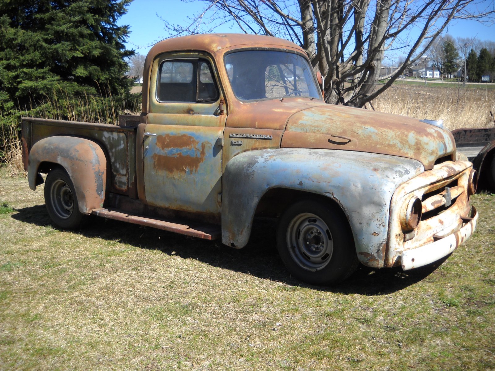

    pulled my 54 IH out of it's shed for pics, soon to be for sale in cl***ifieds...

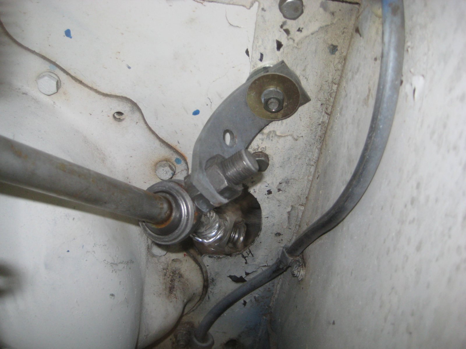

    My neighbor & friend milling an adapter bracket for the TV cable on our Elco. Trying to get it ready for Round up.
    Then cleaning all the stuff I dont need off this Model A frame while its nice oustide.

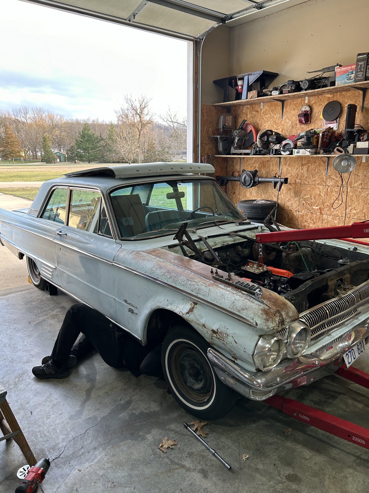

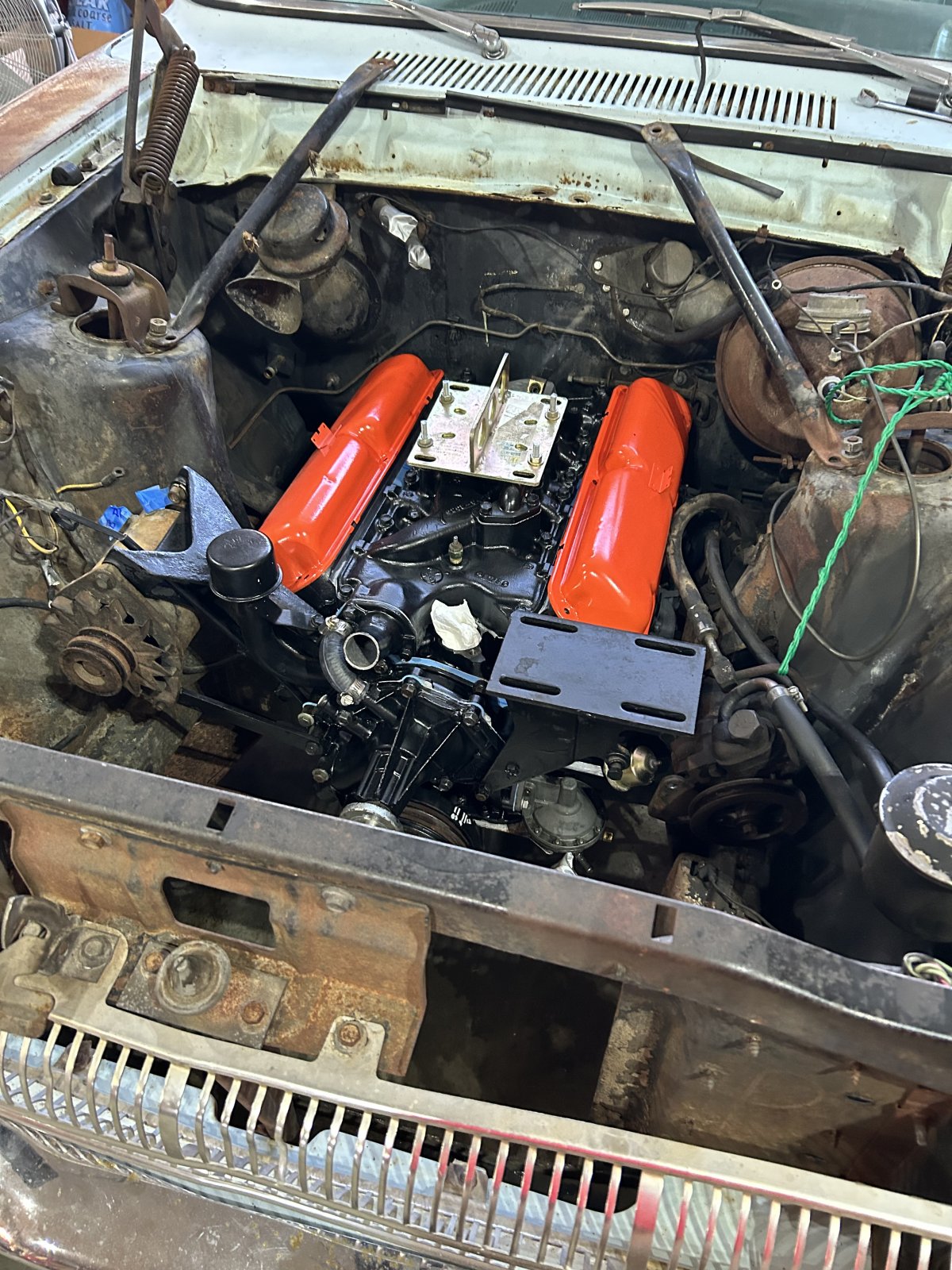

    IMG_1205.jpeg IMG_1204.jpeg Finally! Engine IN car.
    Cam break in later in the week. I’m swamped with work outside of my shop lately.
    Sure is nice having kids interested in cars. My 16 year old did 90% of the on the ground work like motor mounts, starter, trans cross member, ect. Saves my old back.

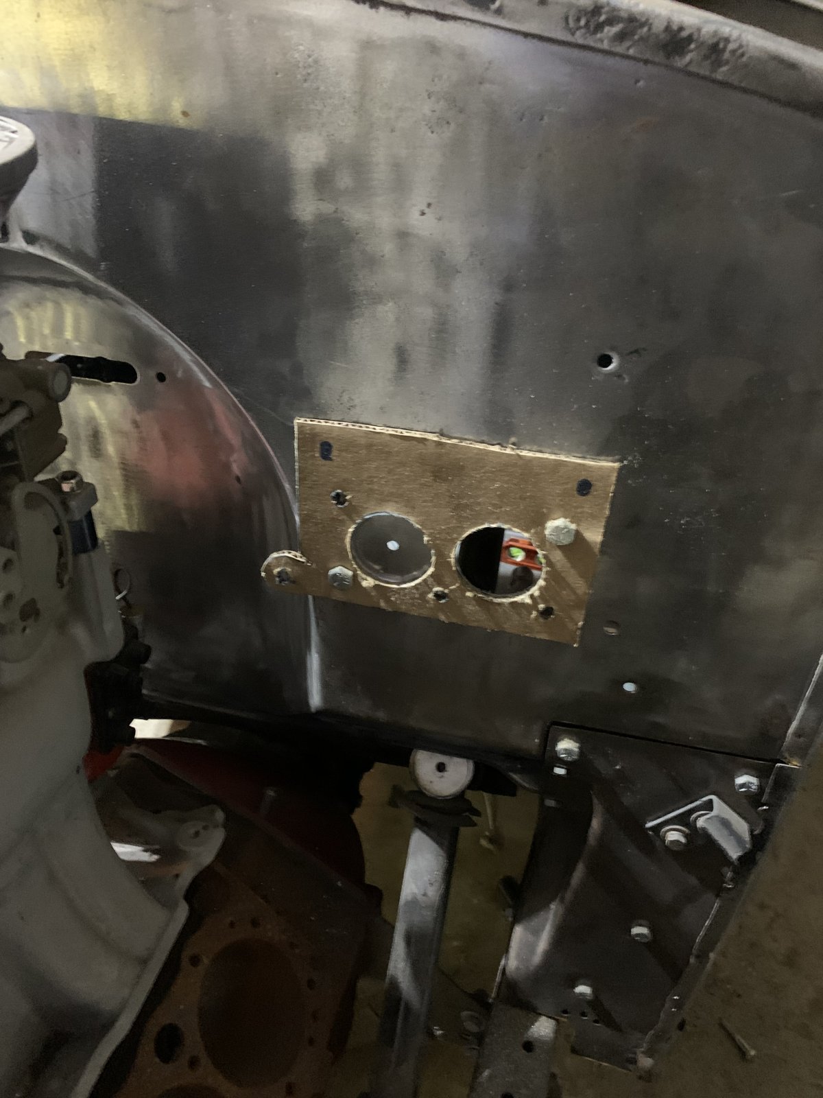

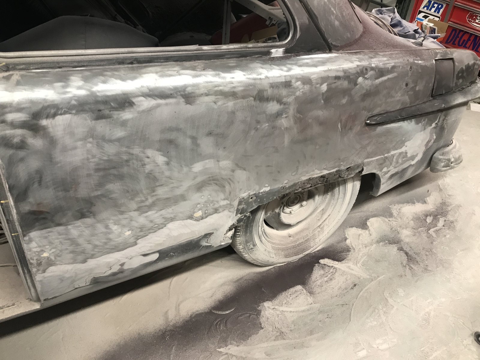

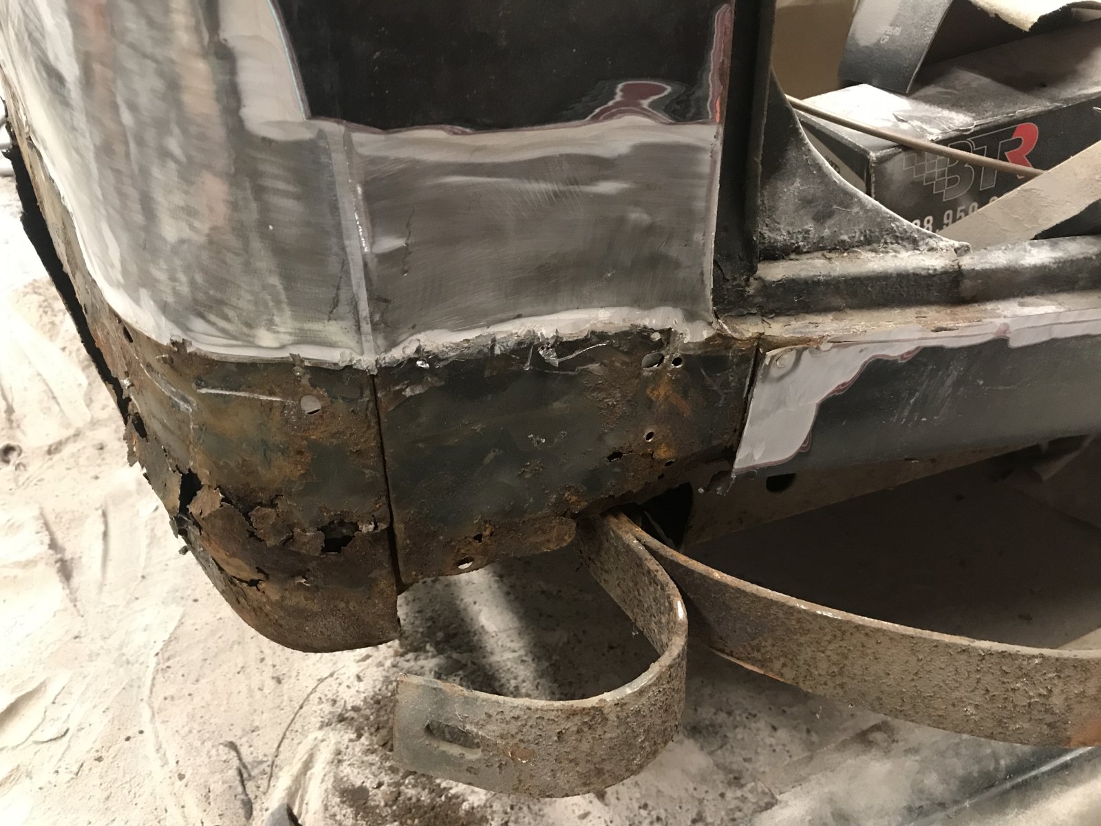

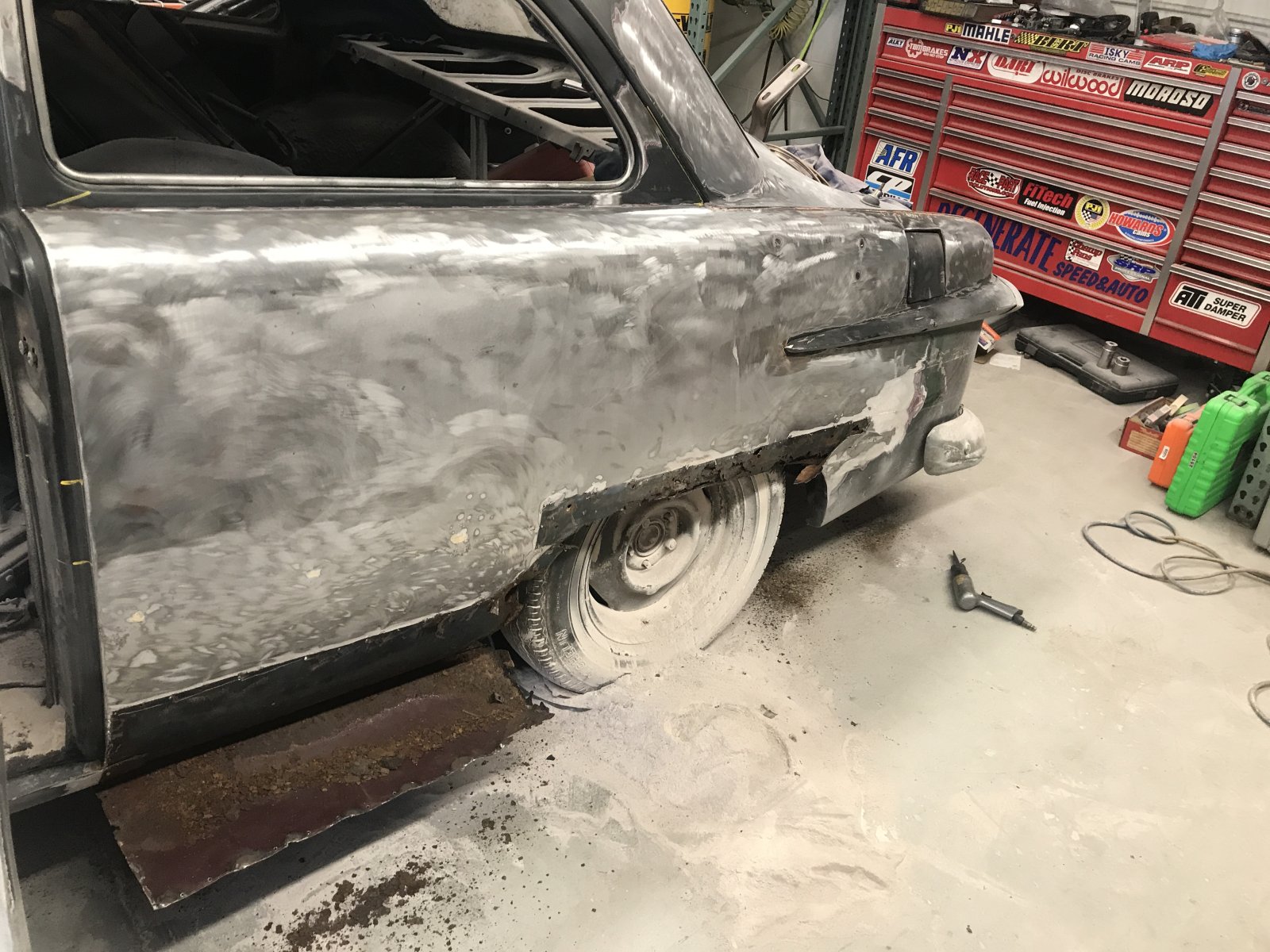

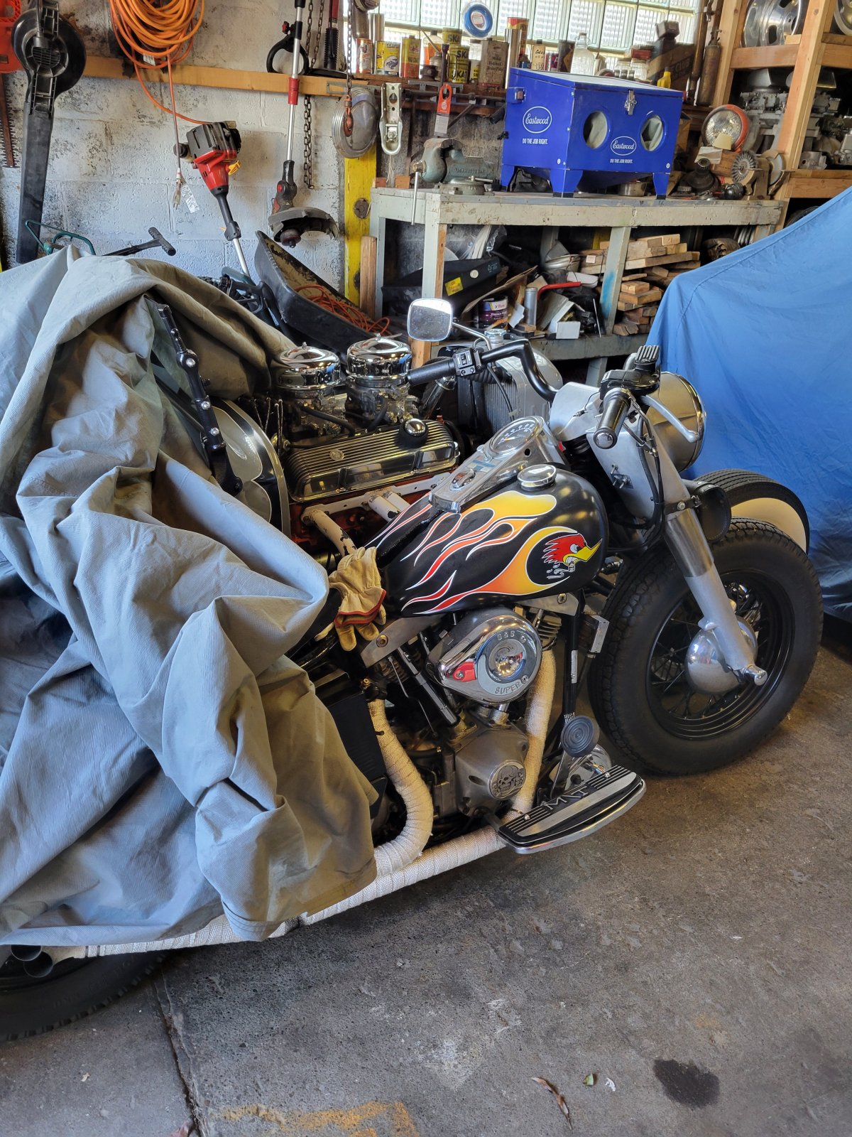

    Today I woke up the t-bucket from it's winter slumber, all systems a go
    Then I started clearancing the lower fender sections on the Henry J, since I switched to big block and moved the engine back another couple of inches they interfere with the collector.
    I decided to replace the skull hole fillers on the 41
    With a pair that light up, I'm going to wire them into the line lock ****on

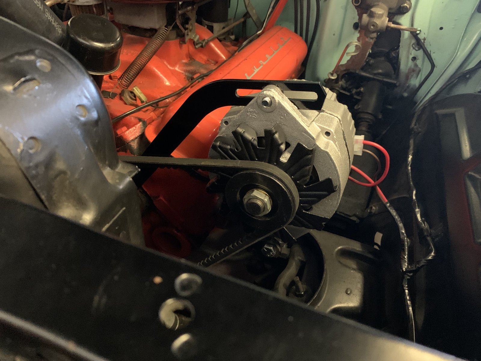

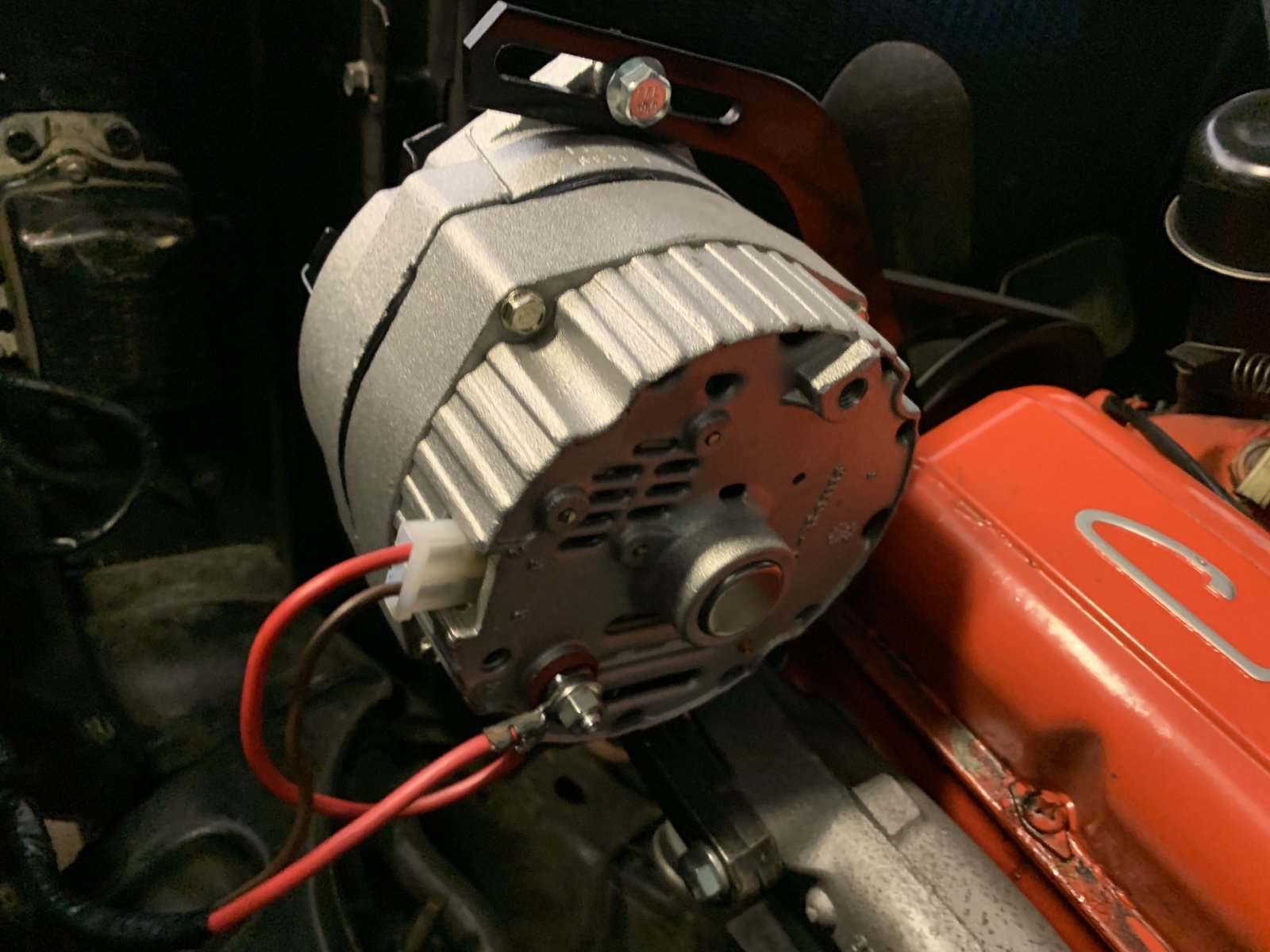

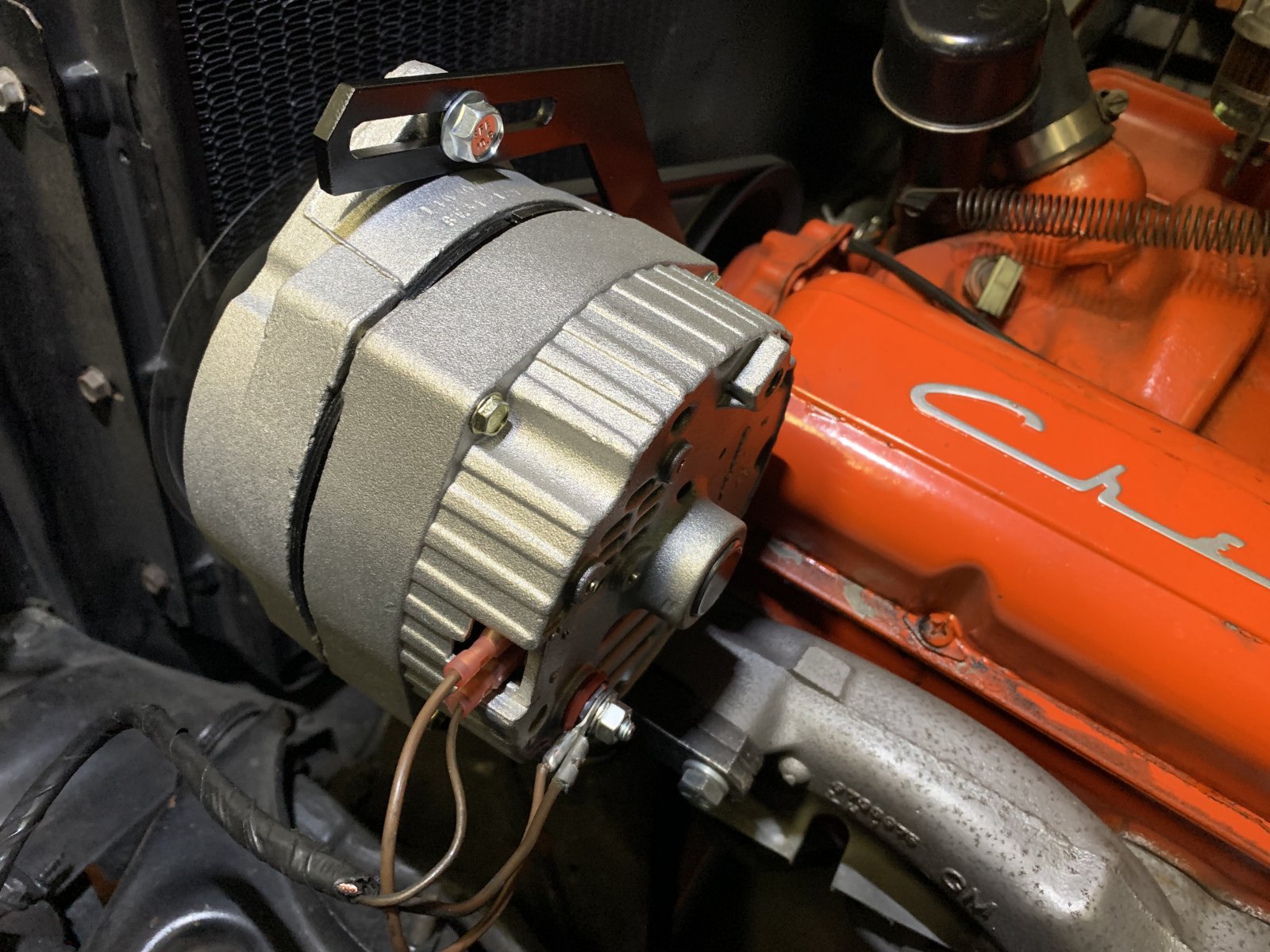

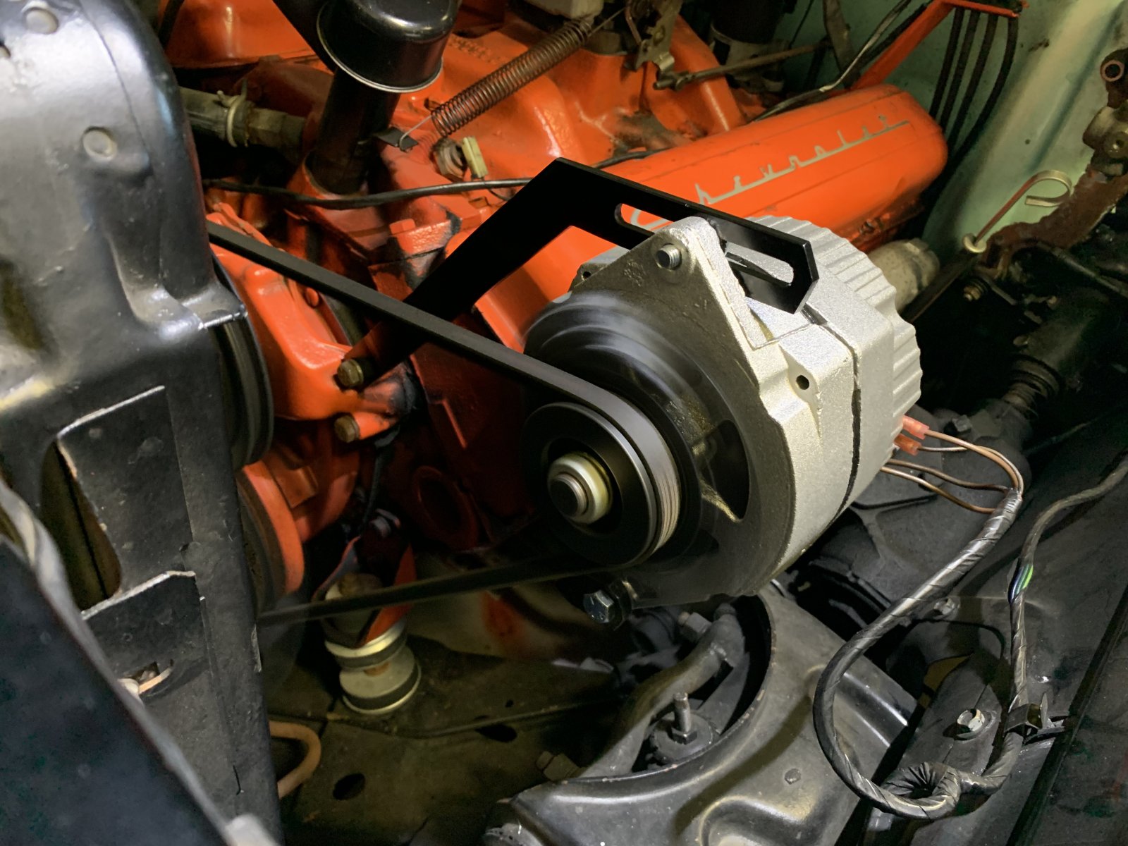

    Last week was get it done so 57 would get out and about for Granddaughters invite to the prom. However she declined because boyfriend had another vehicle in mind. :confused:
    Today I reworked adjuster bracket as well as remove old charging system wiring from loom and replace with new wires. Much better. :)
