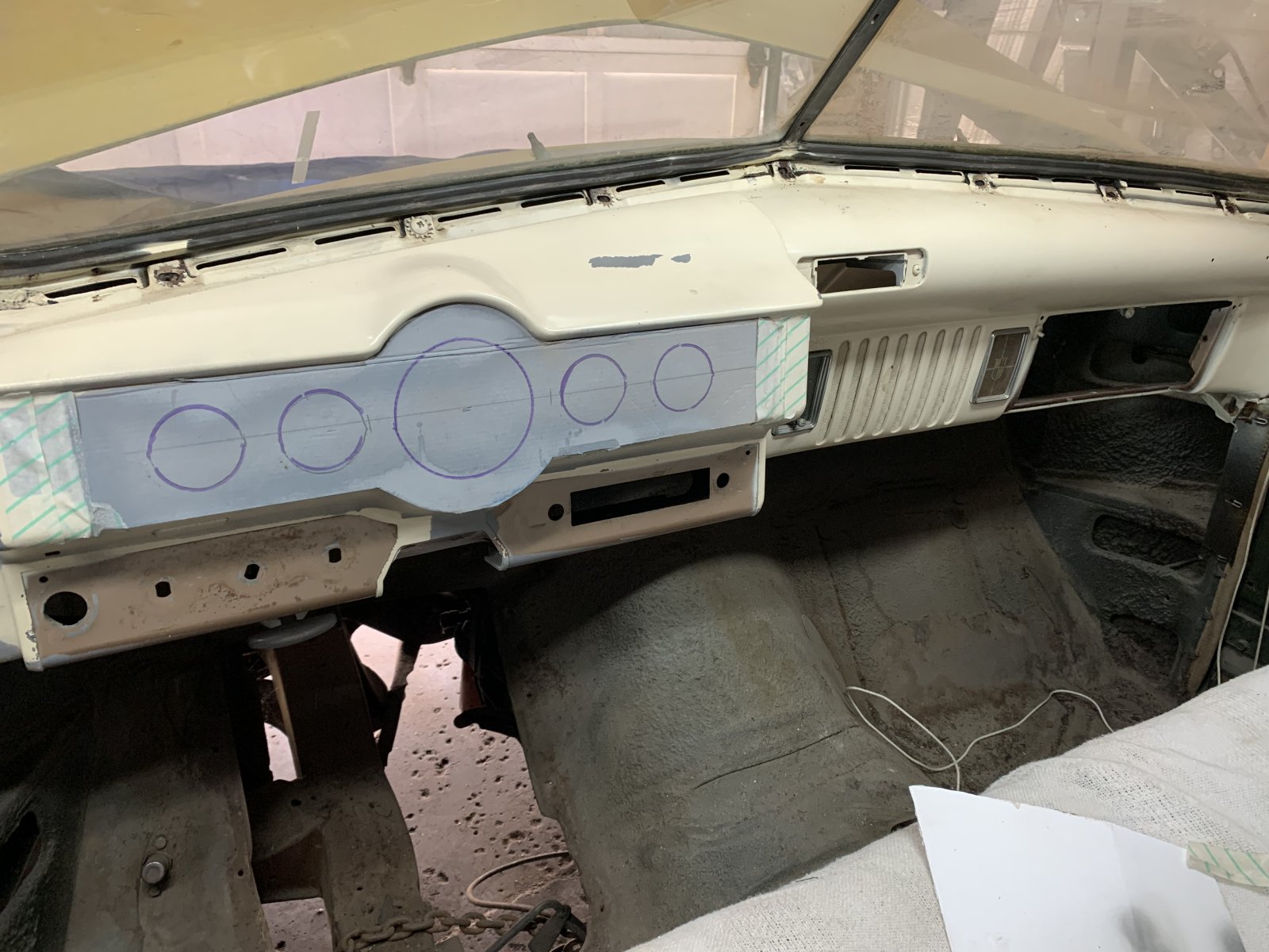

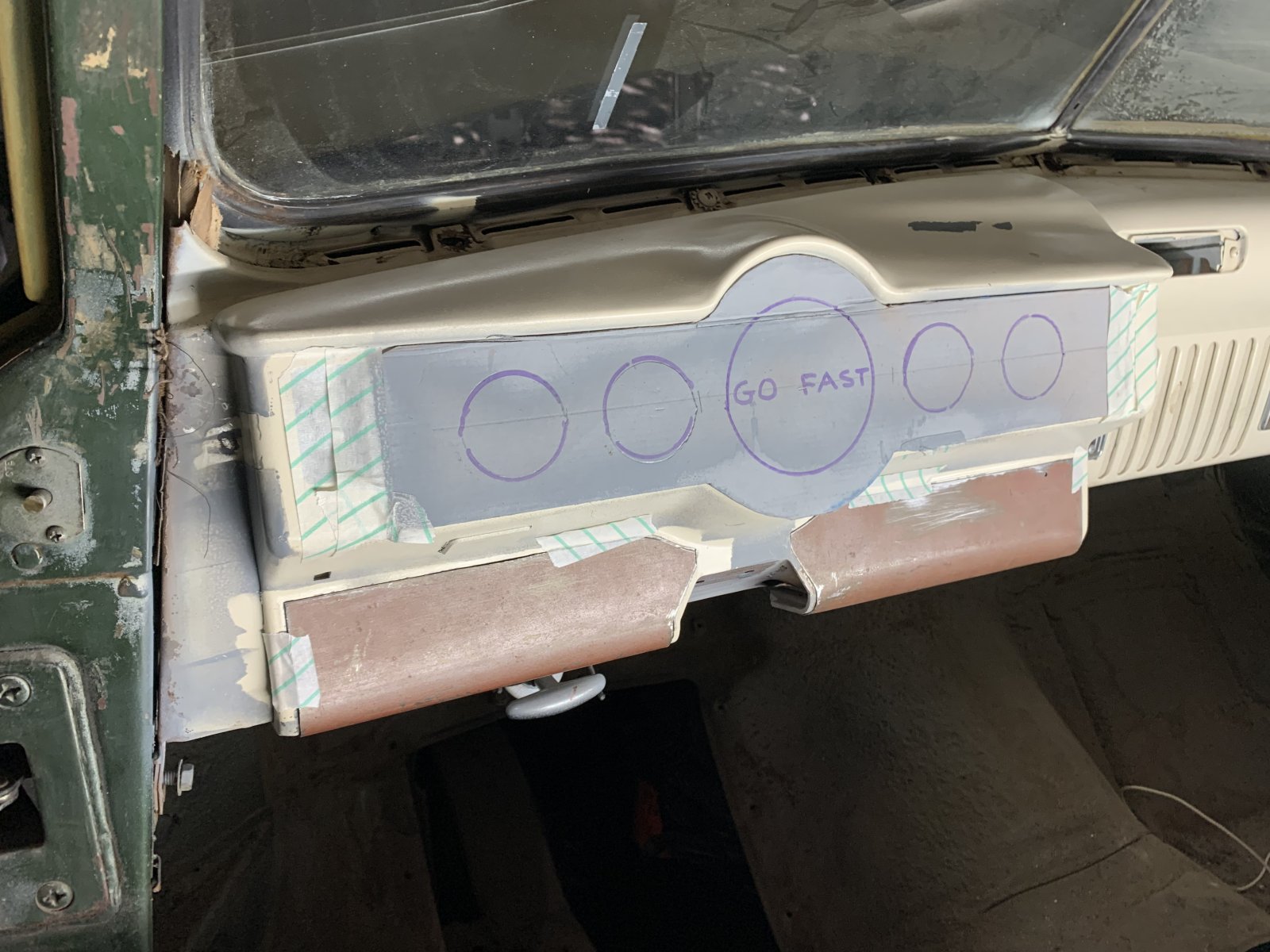

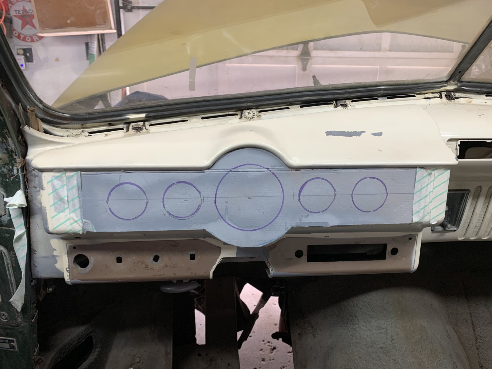

    Dash panel mockup....will be 1/4 inch aluminum.... BA3D1437-58C7-4B3B-93CE-DAF3864F411D.jpeg AB6BC02B-A947-402A-B2BA-15A0A5F623EB.jpeg

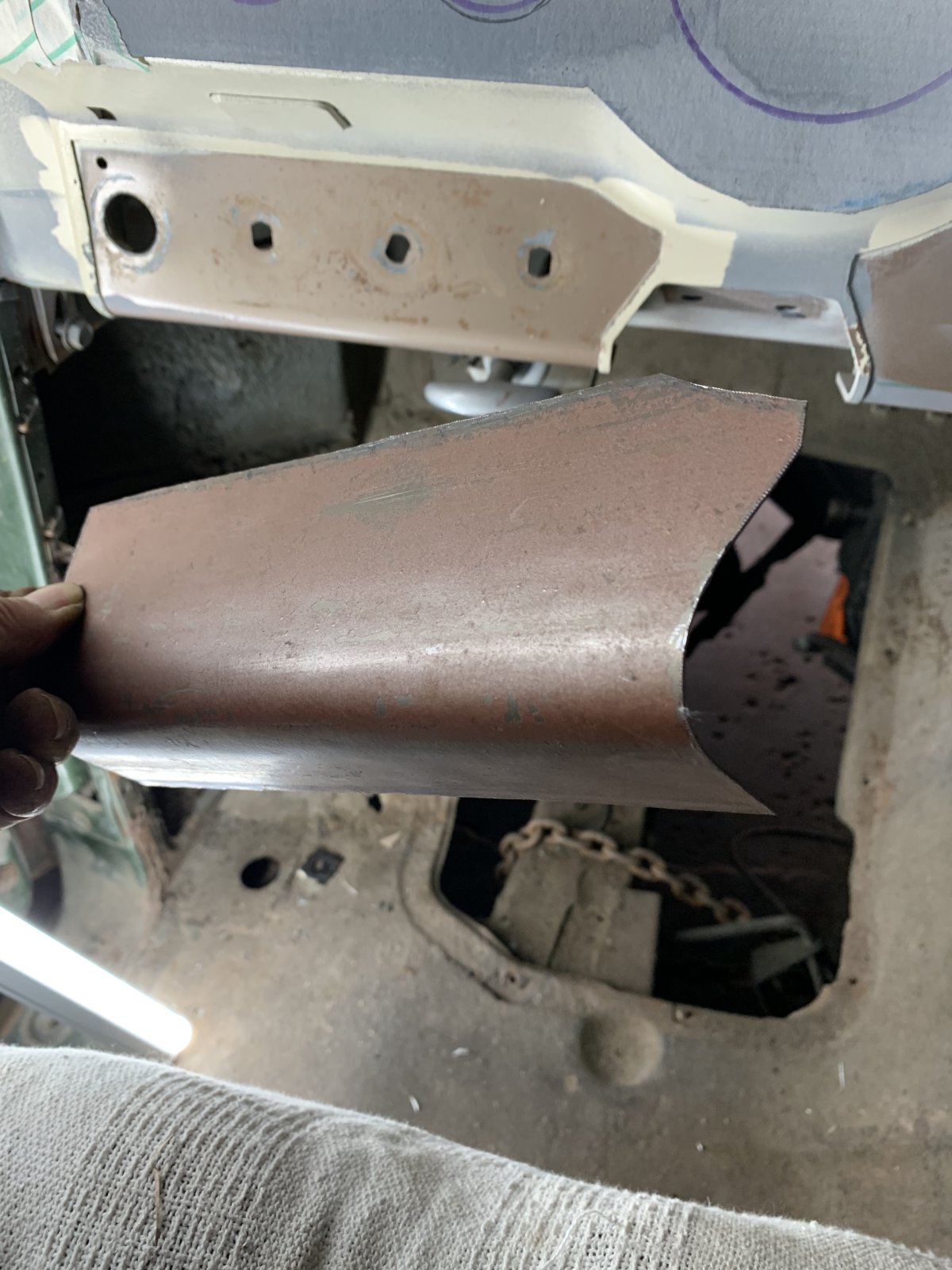

    Left side panel fabbed up.. fine tune it and done 4198DF01-3B4D-4739-AA26-DDFE25964F79.jpeg 116E8FB8-FD7B-485F-B309-7B1B09ED9545.jpeg 2428162F-9511-4A12-932E-2187685746E6.jpeg

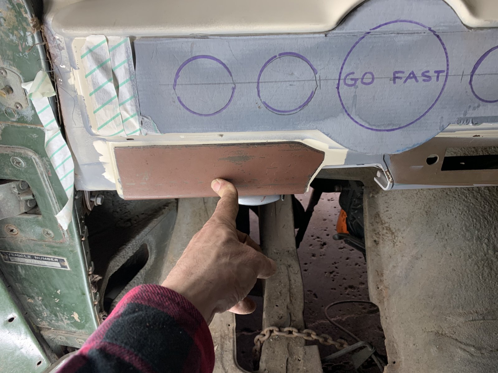

    28D907DD-1E5E-4461-8DED-14C6720A08EB.jpeg …..both lower ignition switch / radio panel blanks fabbed..

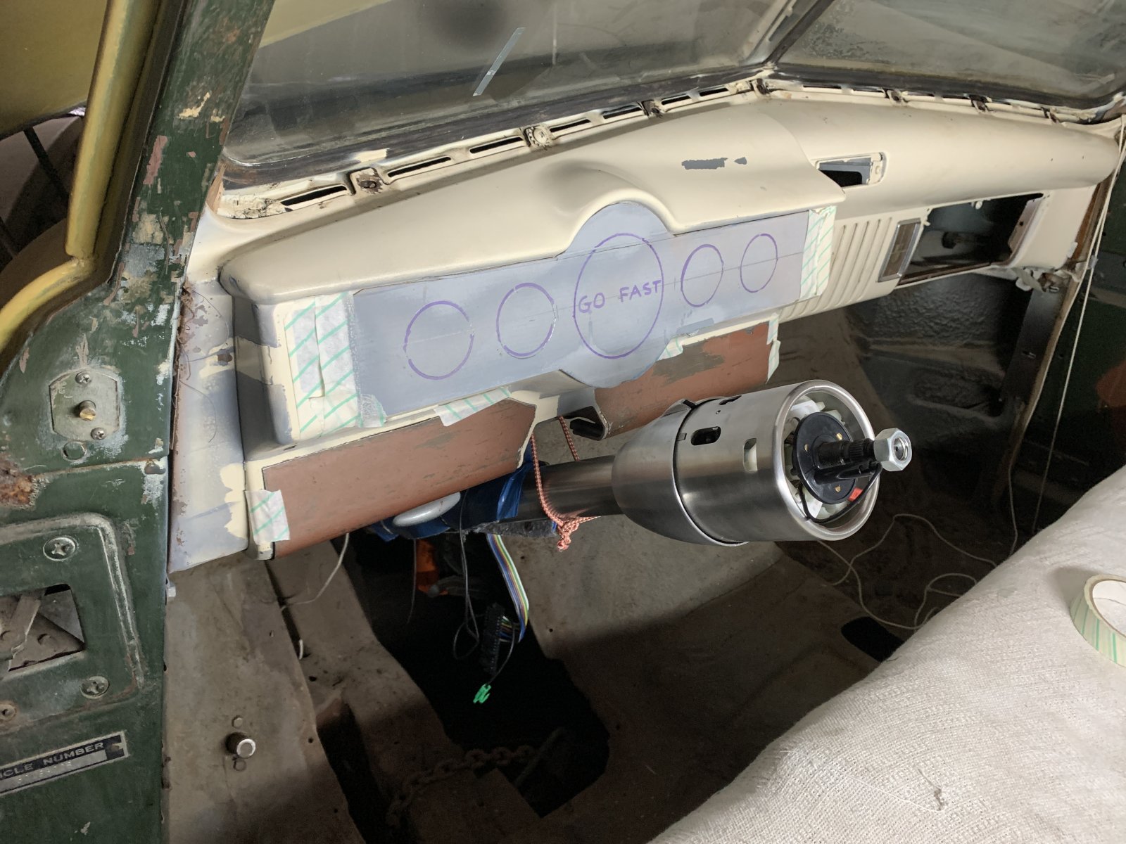

    image.jpg …….. Steering column mockup…

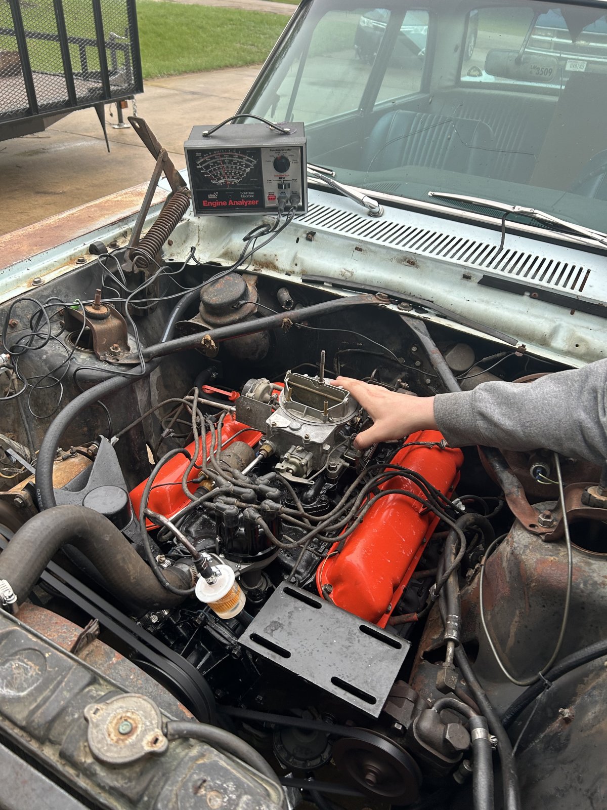

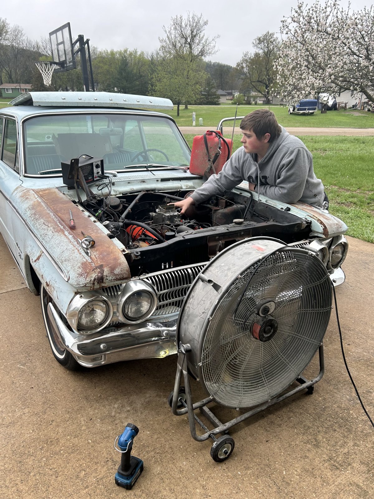

    IMG_1318.jpeg IMG_1317.jpeg Seems like it took forever, but FINALLY got my 260 Mercury engine/HFT cam broke in today for my ‘62. Still had to jump the solenoid, as I had a no crank situation last week, and haven’t had time to track it down because I’ve been so busy. Figured now I can track the bad connection down without the pressure of the HFT break-in looming. :)
    Hope my 16 year old learned something along the way too.

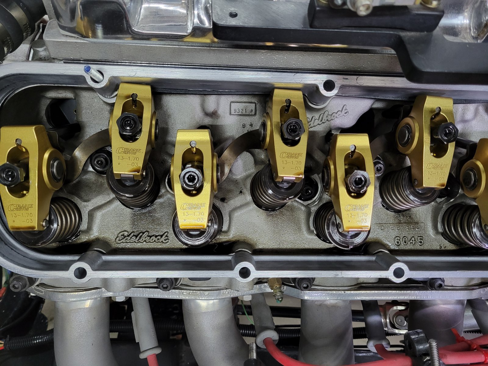

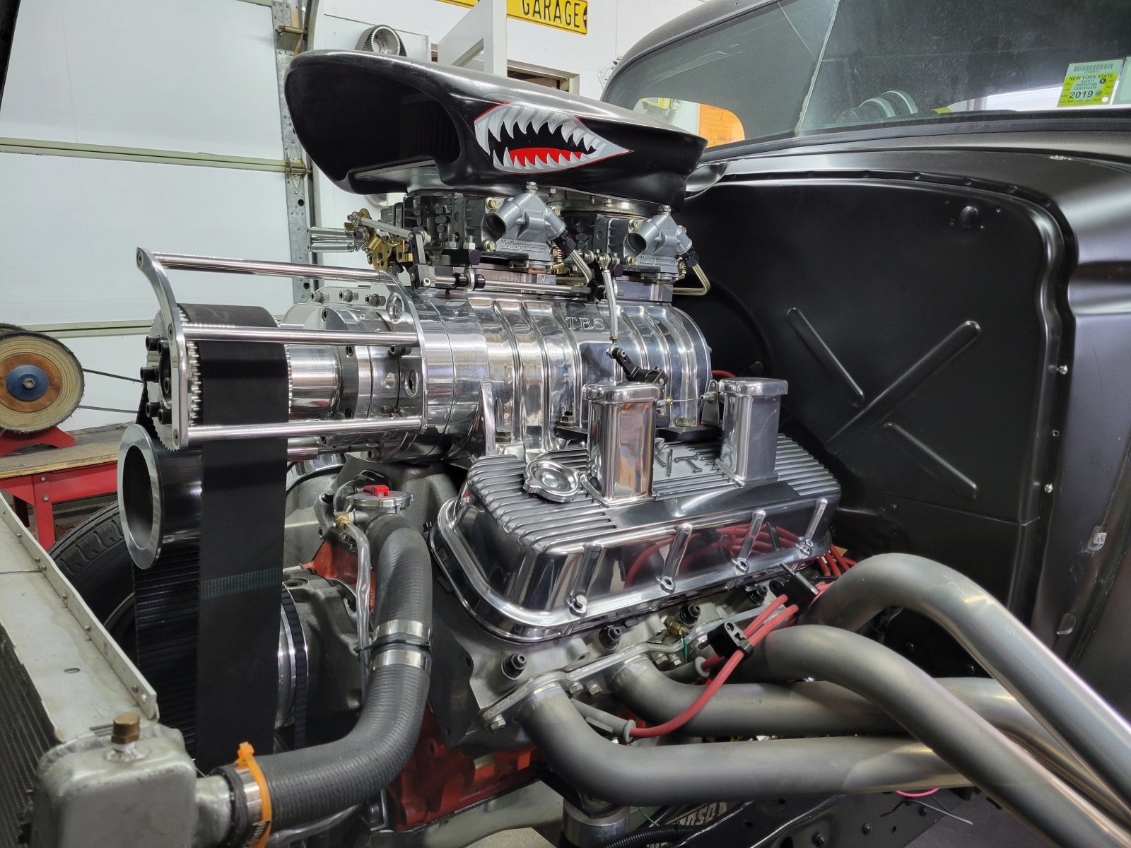

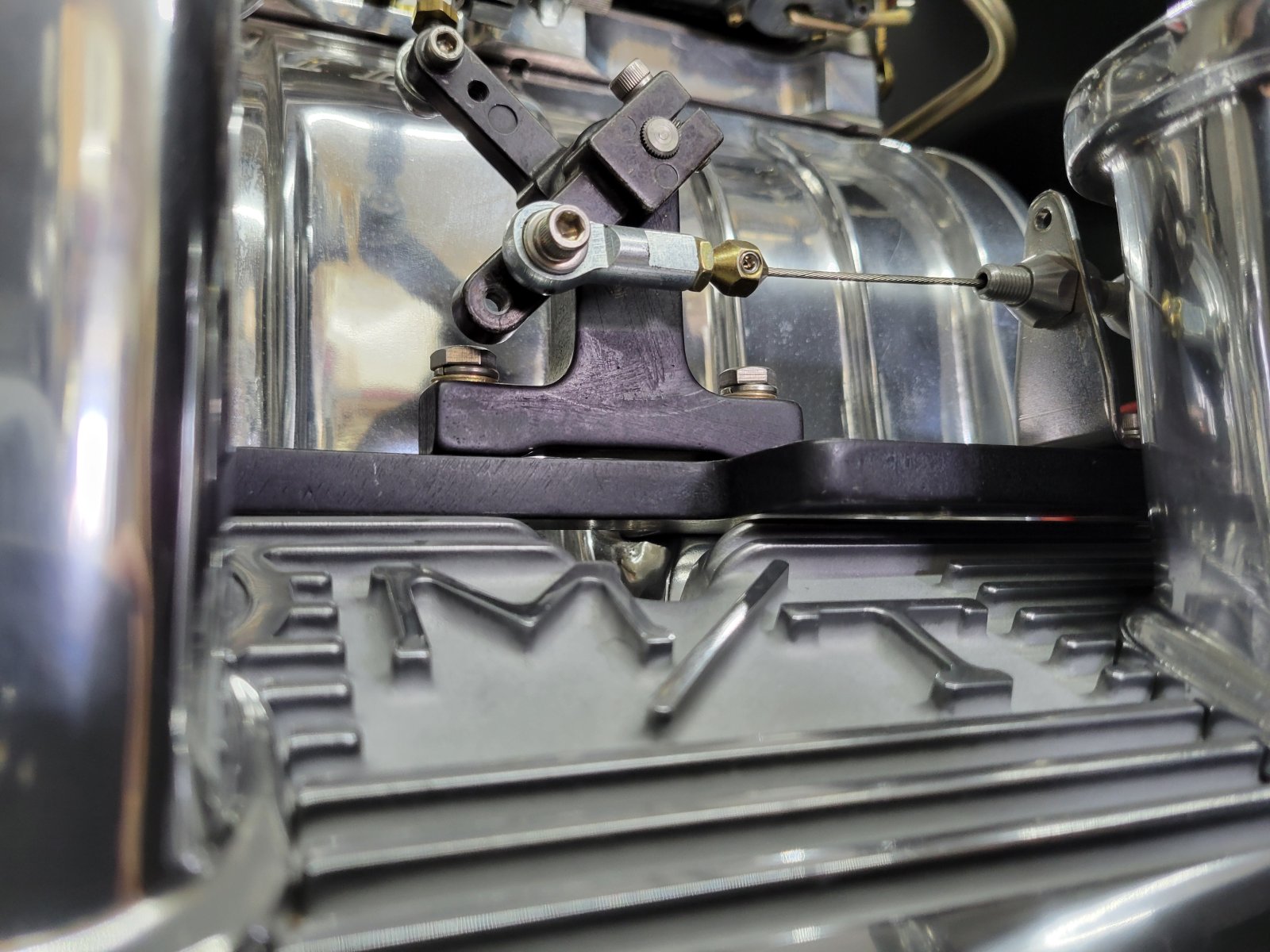

    New spacers are better but still rub the rockers, left valve cover hits throttle bracket and right valve cover hit the intake manifold where the blower bolts on, batting a thousand here lol
    But they look *****ing

    Originally when the motor was built, none of that has changed though.

    Just seems odd they hit, Crane rockers and MT valve covers has got to be pretty common thing.

    I recently had a similar issue on a BBC with roller rockers even hitting a set of stamped steel valve covers. :mad: I had messed up one of the Crane rockers and bought a new set of Harland Sharp rockers to replace them. Anyway, I ended up grinding the corner off of two rockers on each side that were hitting. When I pulled it back apart later, I just went back with the Crane rockers after filing down the small scar on the one I screwed up. As good as quality is today with new parts, I trusted the 25 year old Crane rockers more than the new ones from Harland Sharp.

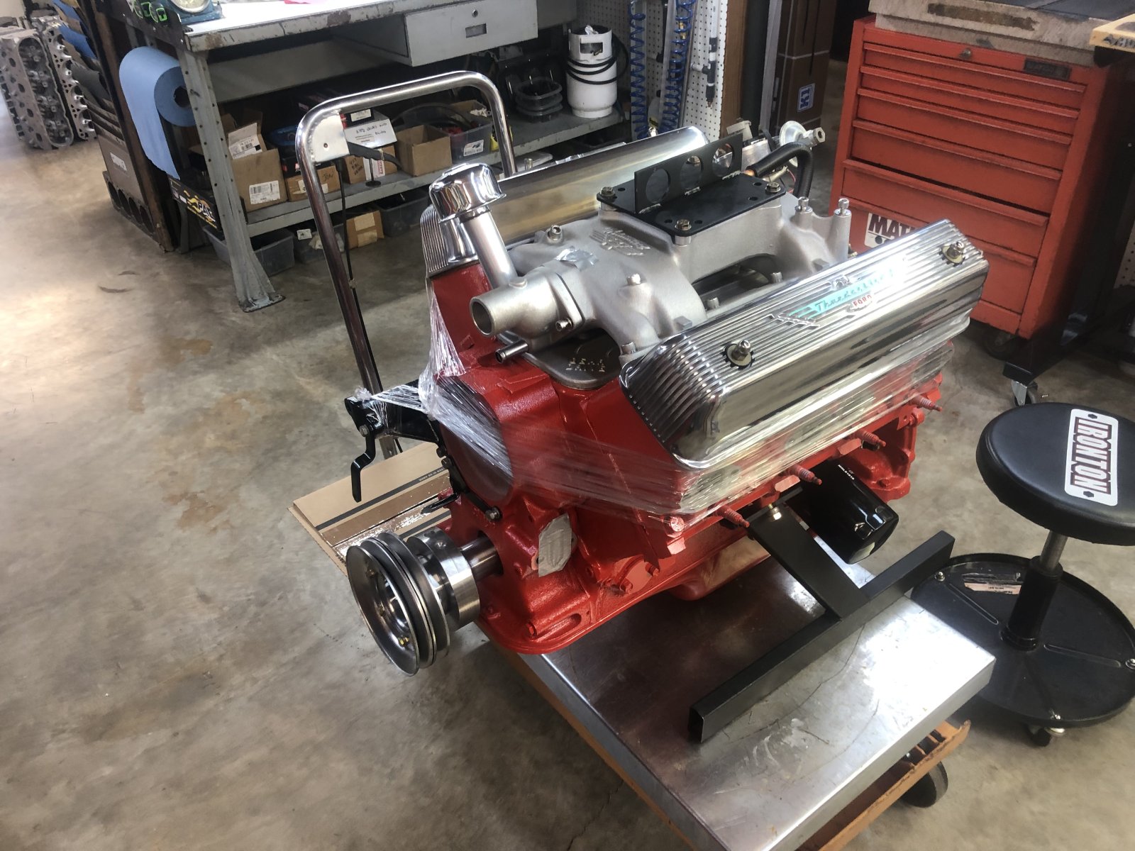

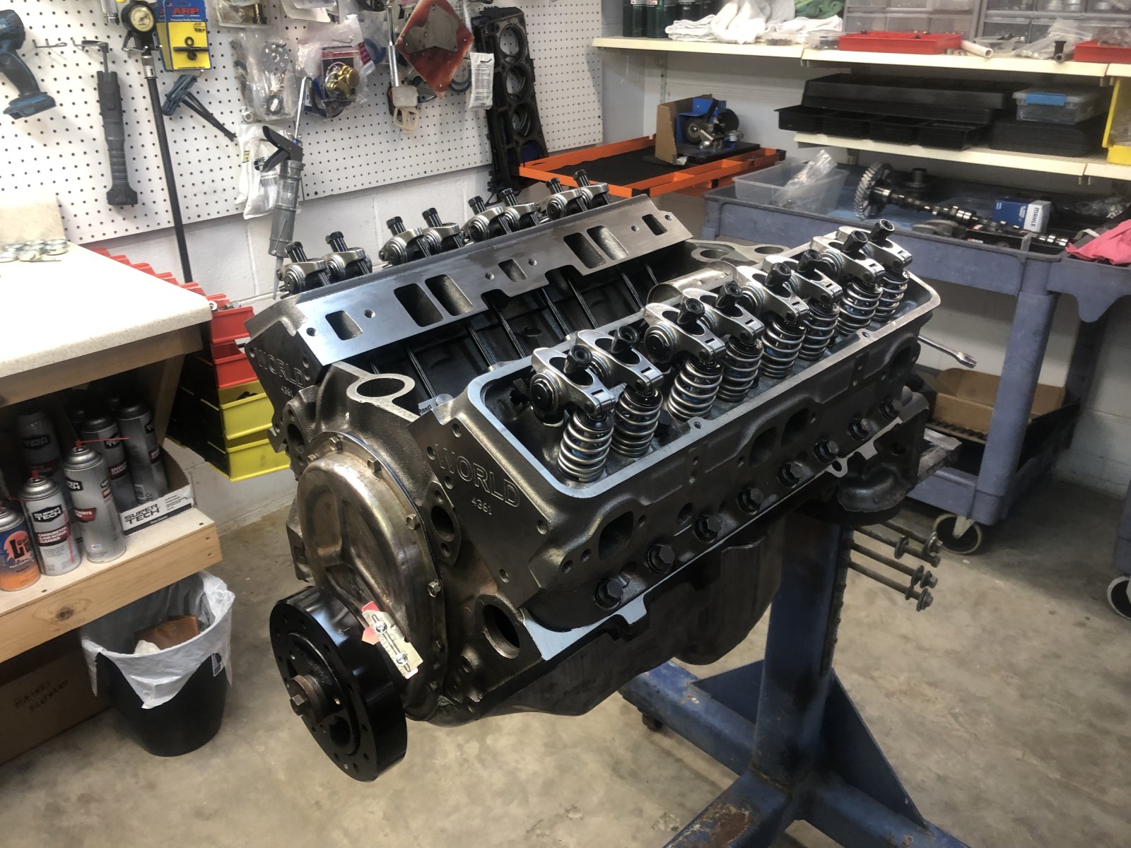

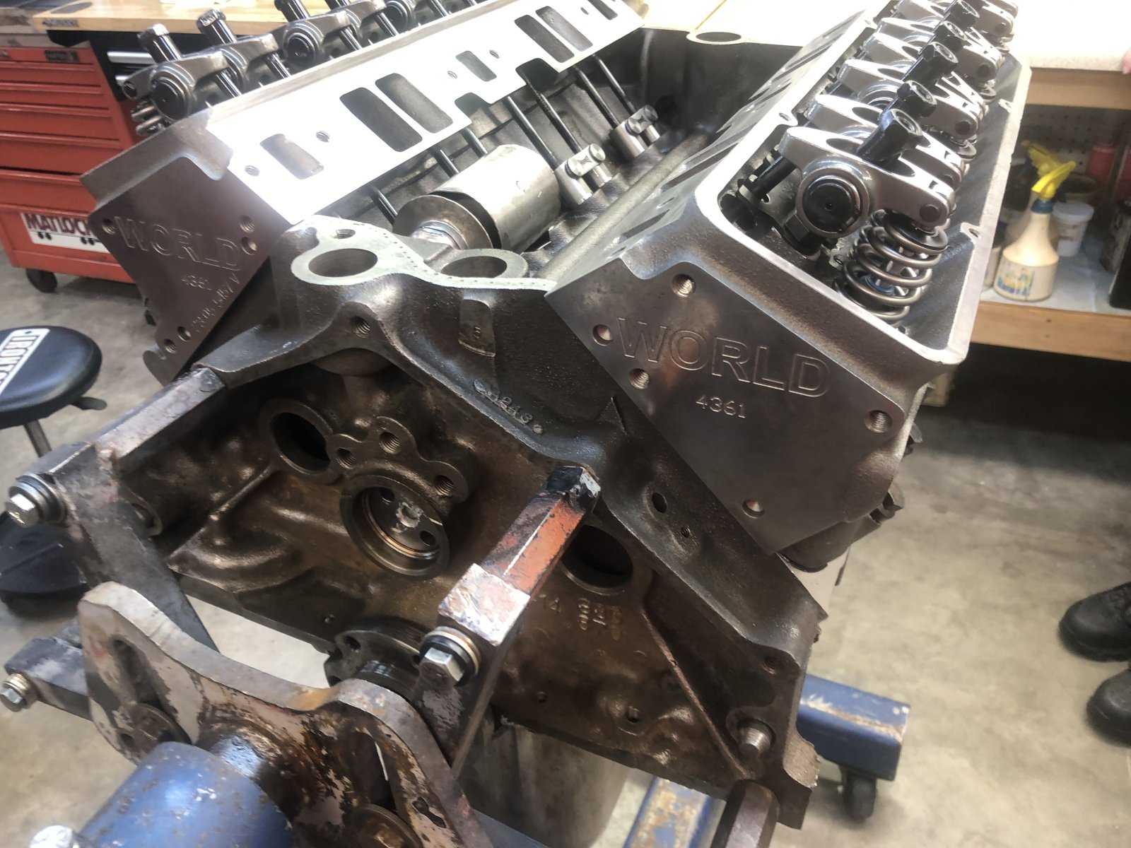

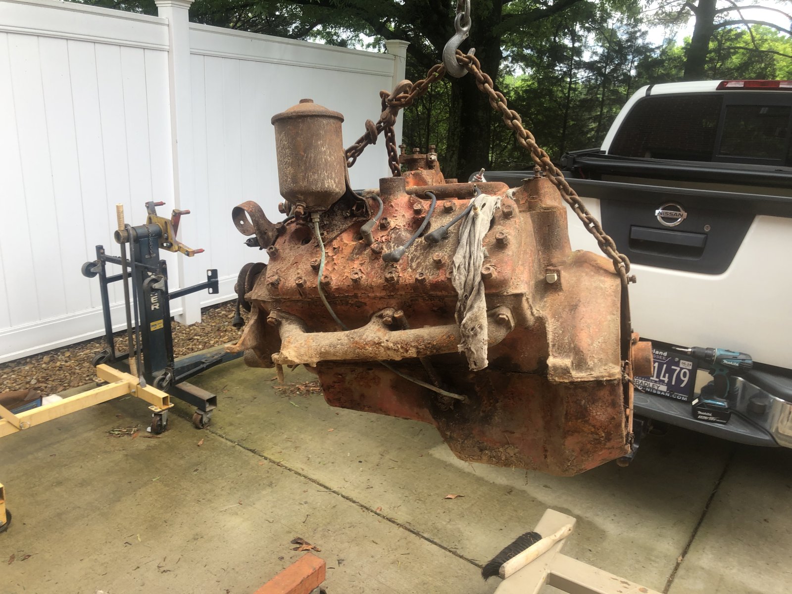

    I need that y-block!

    M/T's will clear the rockers once you remove the oil drippers, I didn't remove the drippers because I had the spacers, not knowing the rockers would hit the spacers.
    Here's the old M/T's I had on it, with drippers removed.
