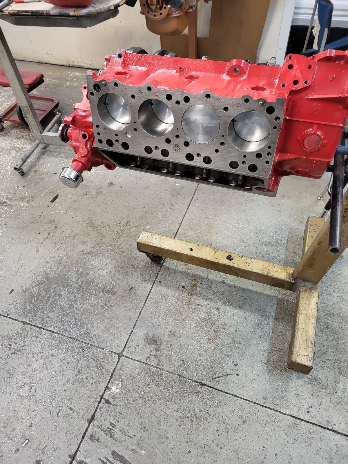

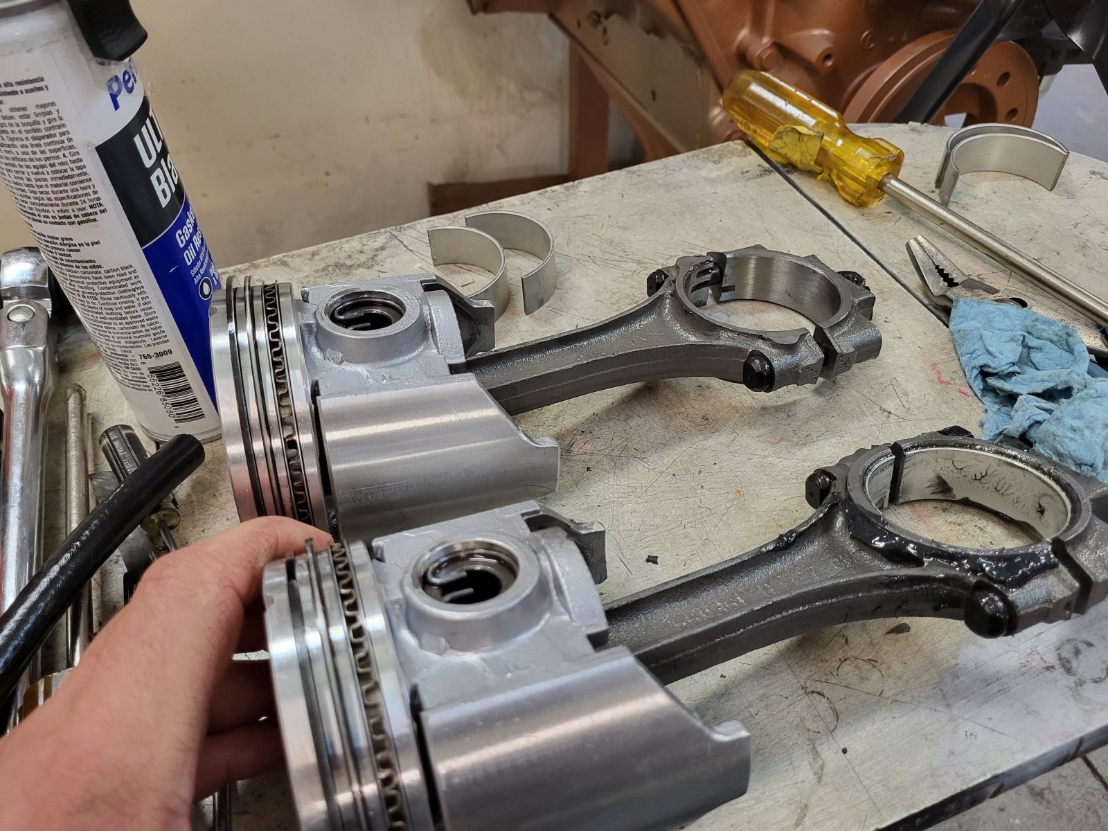

    Checked the valve to piston clearance last week called Tony with the specs not going to work the pistons need to be notched. I didn't want to notch the Egge pistons so I'm ordering forged from Tony and having him notch them
    So out came the pistons for the third and hopefully last time. This is on my 303 rocket. 20240504_093417.jpg 20240504_093437.jpg

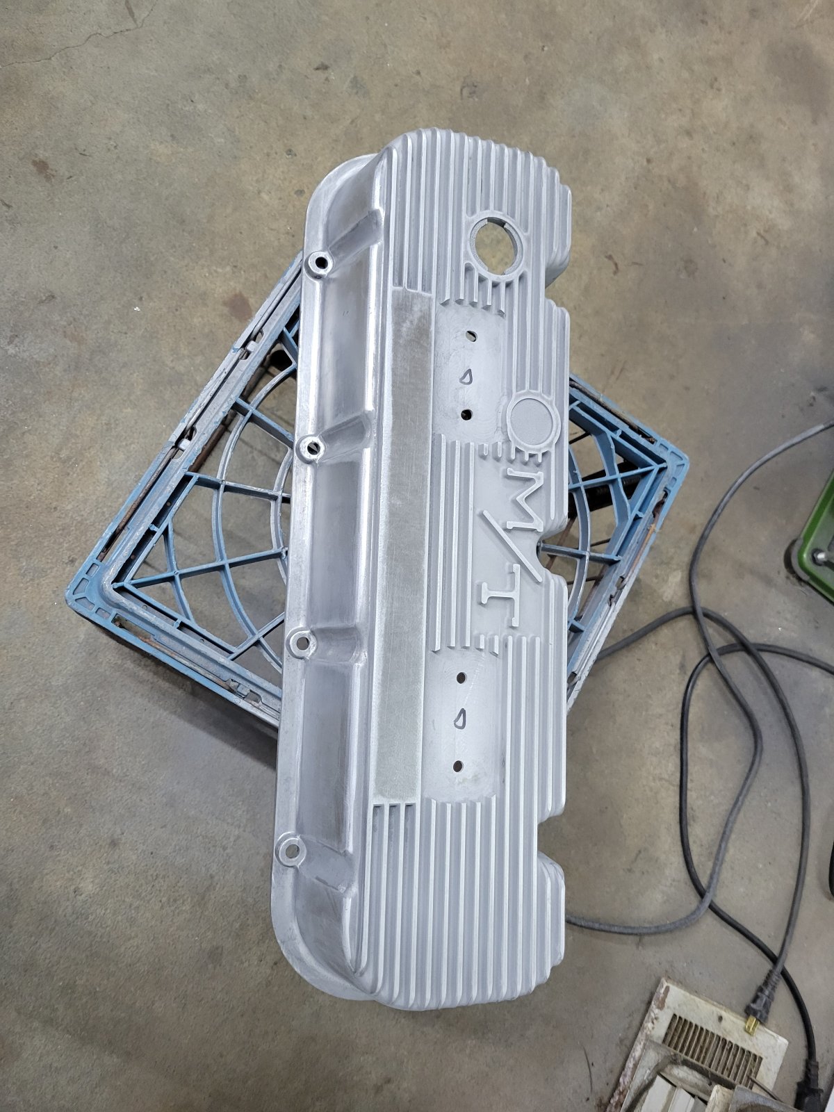

    A year ago almost to the day I quit working on this mph scoop, it was a bad casting that someone filled with bondo.
    I milled it out with a hole saw in my drill press and then jumped to the same process on those valve covers that I recently finished after sitting a year. Do you detect a theme here ???
    Screenshot_20240505_181424_Gallery.jpg Screenshot_20230516_184443_Facebook.jpg
    I started whittling away at it with hand tools today, it's beginning to look like something on the one side.

    Curious what lift you have in your cam that you have clearance issues? Just went thru this with Tony myself but i was OK with my flat top pistons and his cam in my 324.

    Finished the other side, I'll bead blast the spots I "milled" out and polish the rest, it's not perfect but much better than it was.

    Finished the scoop today, no fingerprints left and could probably crack a safe with how tender they are lol
    How it was and where it is
    20230414_162154.jpg Screenshot_20240505_181354_Gallery.jpg Screenshot_20240505_181424_Gallery.jpg 20240508_173943.jpg 20240508_173827.jpg 20240508_173835.jpg

    Nice modification on the scoop....never would have thought about a hole saw to mill aluminum....

    I think I would try using a Rotabroach instead of a hole saw, probably give a better finish to work with and they aren't that expensive.

    I think it does a pretty fair job, especially in this old *** Craftsman drill press, I kinda enjoy figuring out how to make whatever I have on hand work, I'm not a professional here.

    It was just a suggestion to make it easier and work better by giving a smoother finish that woudn't require so much sanding time.

    Sorry I didn't get back to you sooner I haven't looked at this thread for awhile the camis a solid roller lift at .357,duration at .243 lobe center at 112 so it's not to big but a had a clearance of .065 Tony needed .100 on EX.
