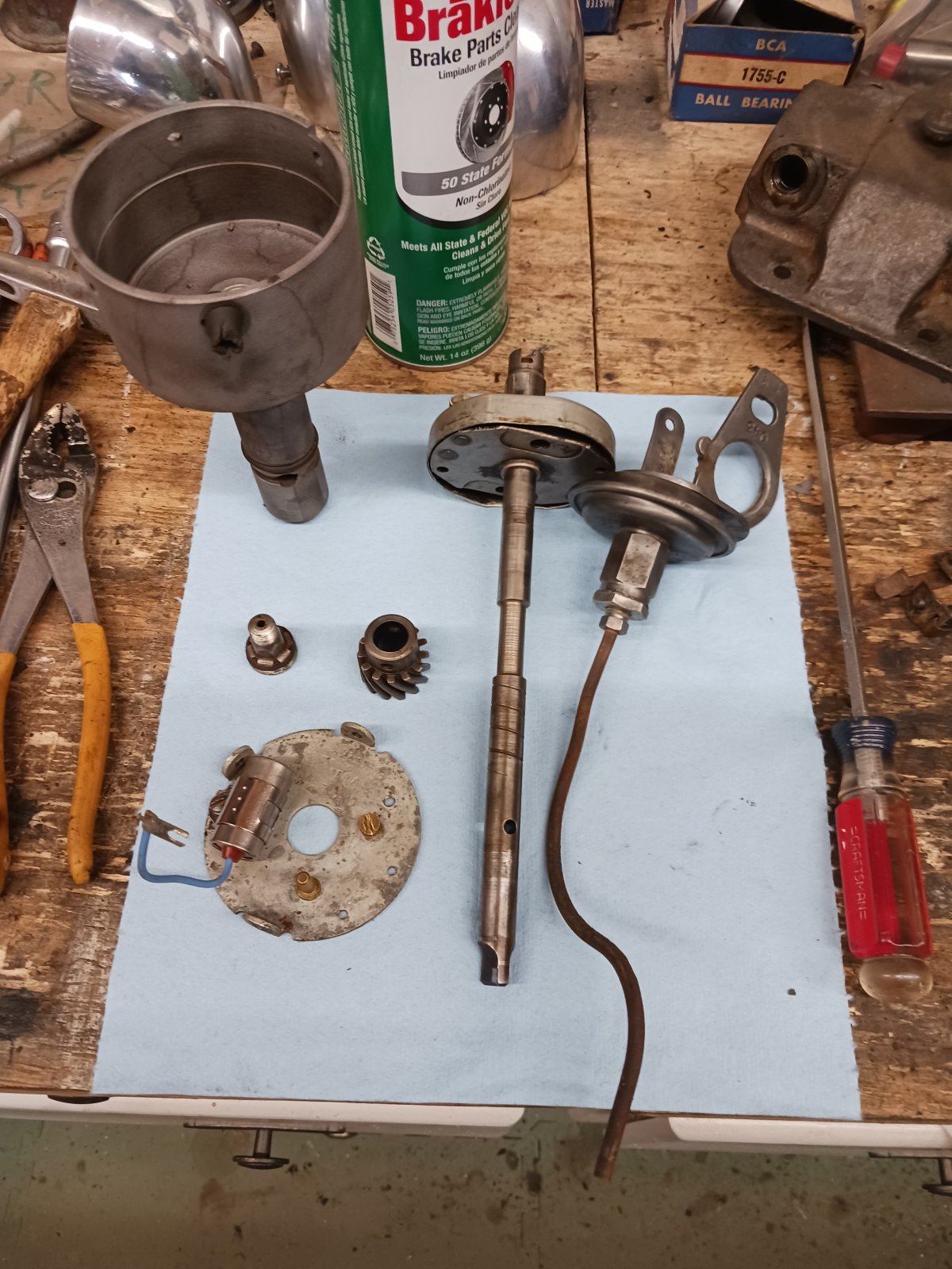

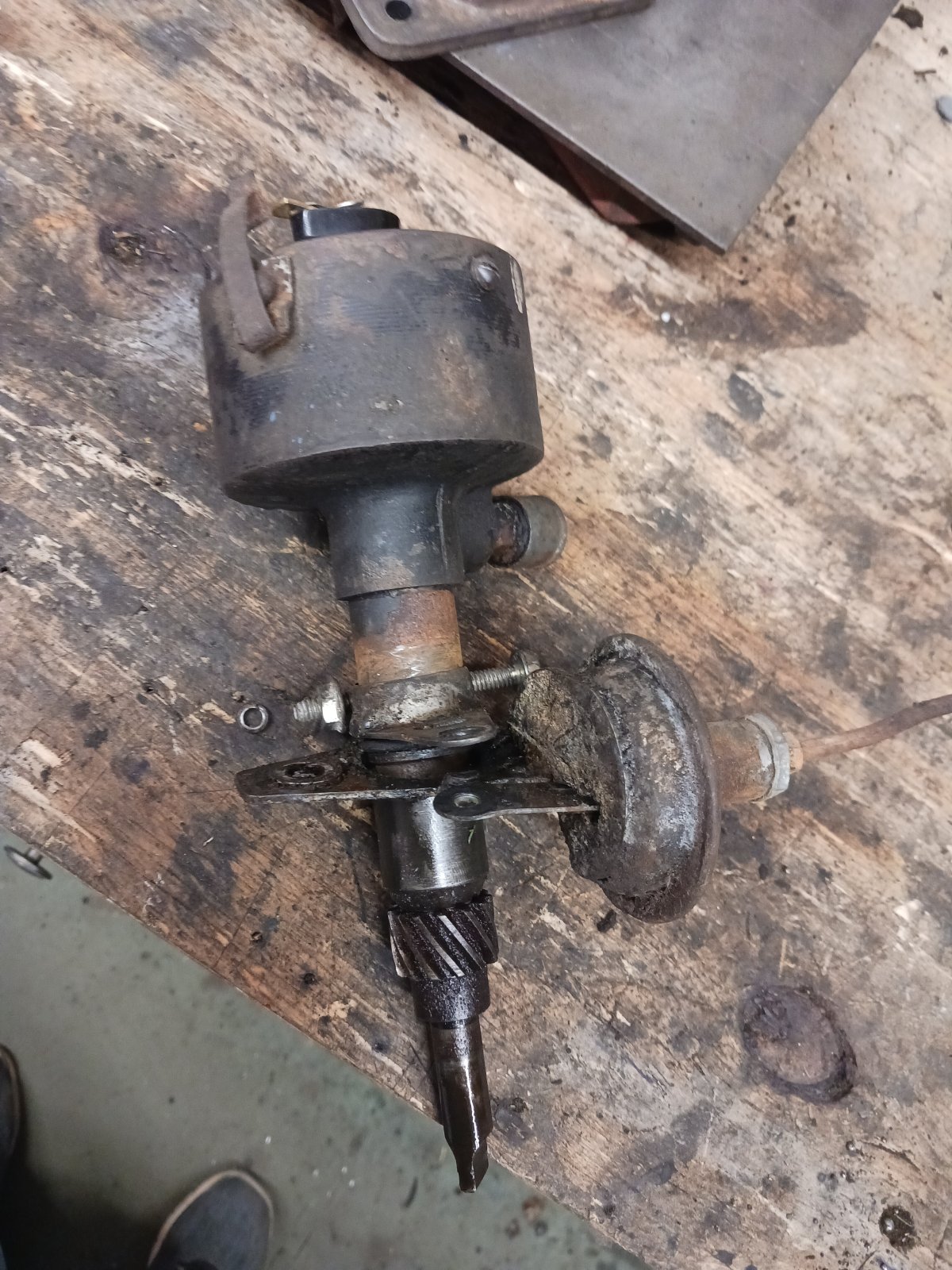

    Working on a 51 216 trying to get it to run. No spark led me to pull the distributor as it was not getting any power. It had been doctored up by someone in the past when the insulator for the primary feed was replaced with some rubber item and a piece of plastic. Temporary fix at best. Dismantled it all and gave it a good cleaning. Used a Mallory connector from a leftover distributor I had hanging around to provide an insulated connection. Turned out well. Now we will see if it fixes one of the issues with this old truck.

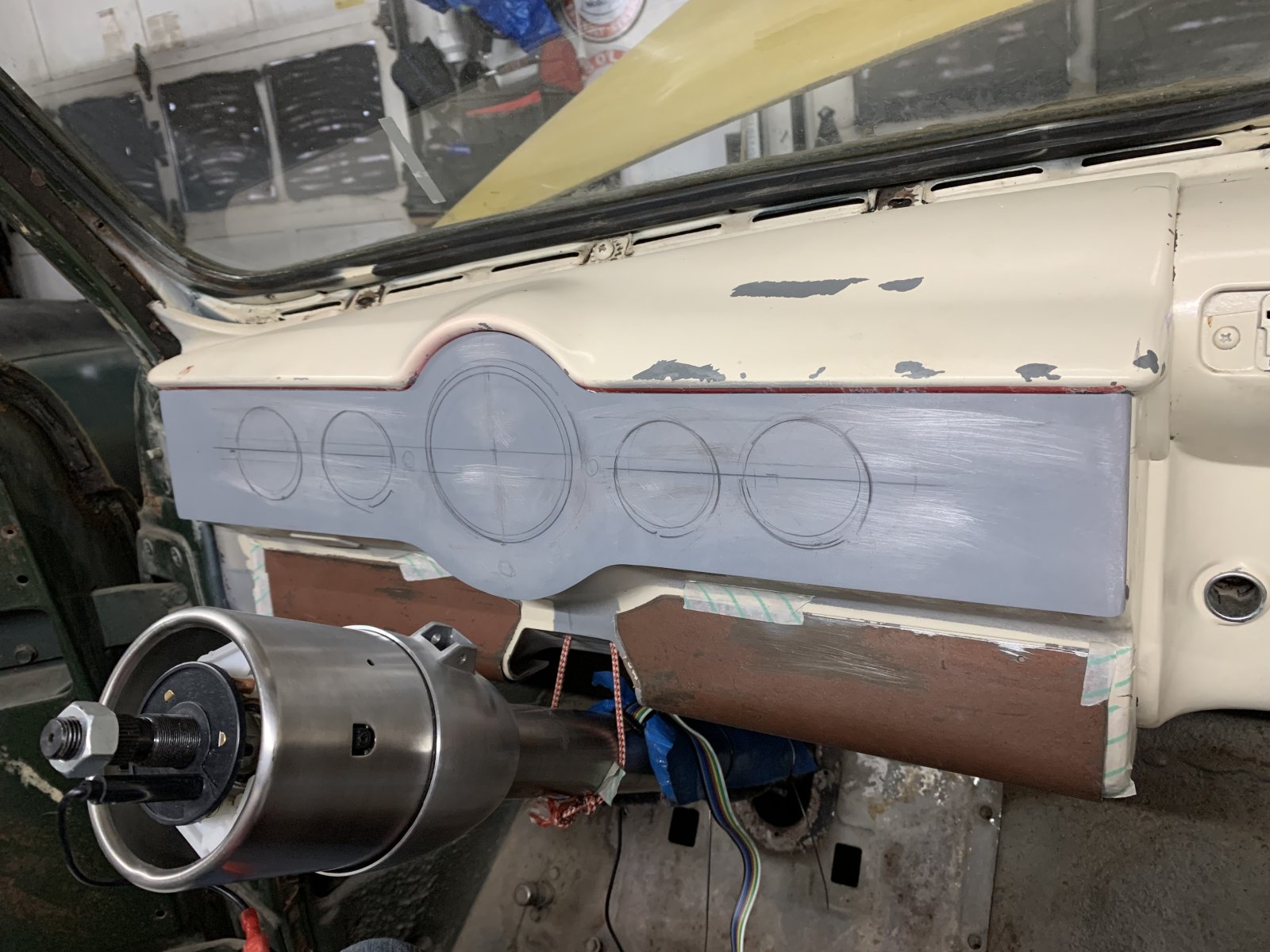

    Got the steel dash panel all fabbed up and looking good. Gauge layout as I see it .. Got a fast ratio Borgeson manual steering box. Next mockup steering colymn to box.. Fun fun fun… C6834242-8634-4F72-9B2C-CB86E082473A.jpeg

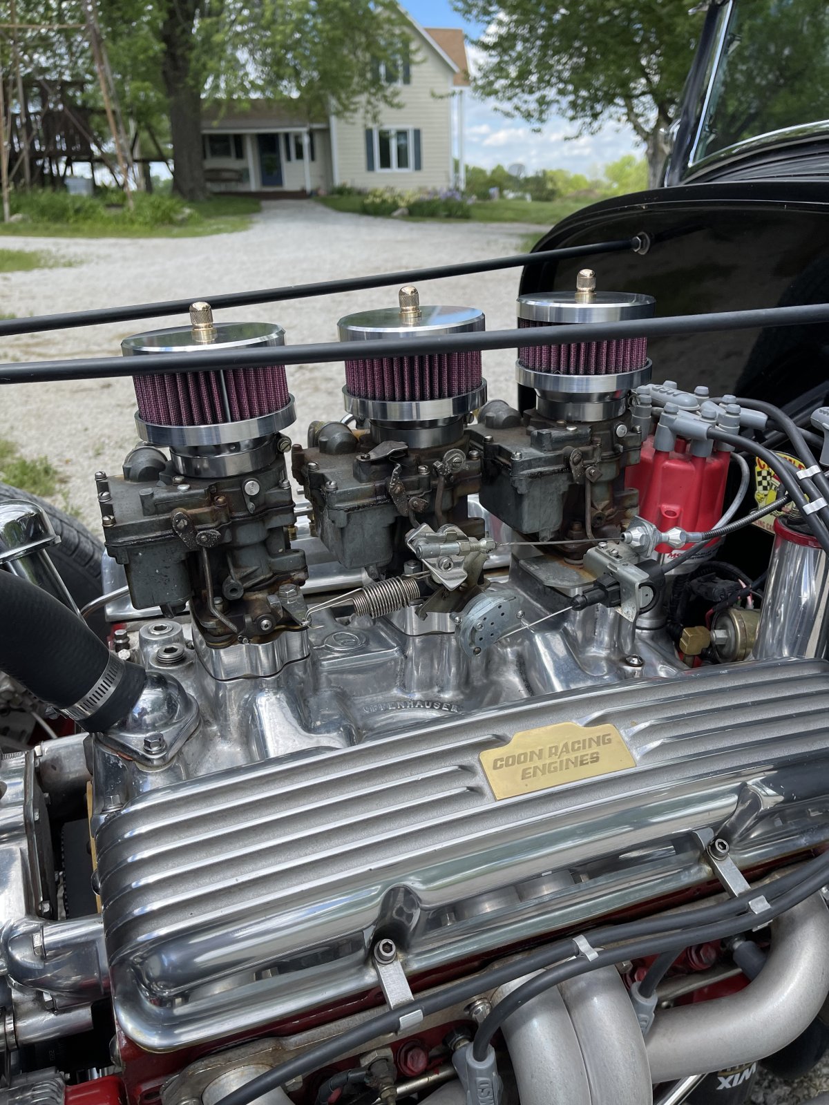

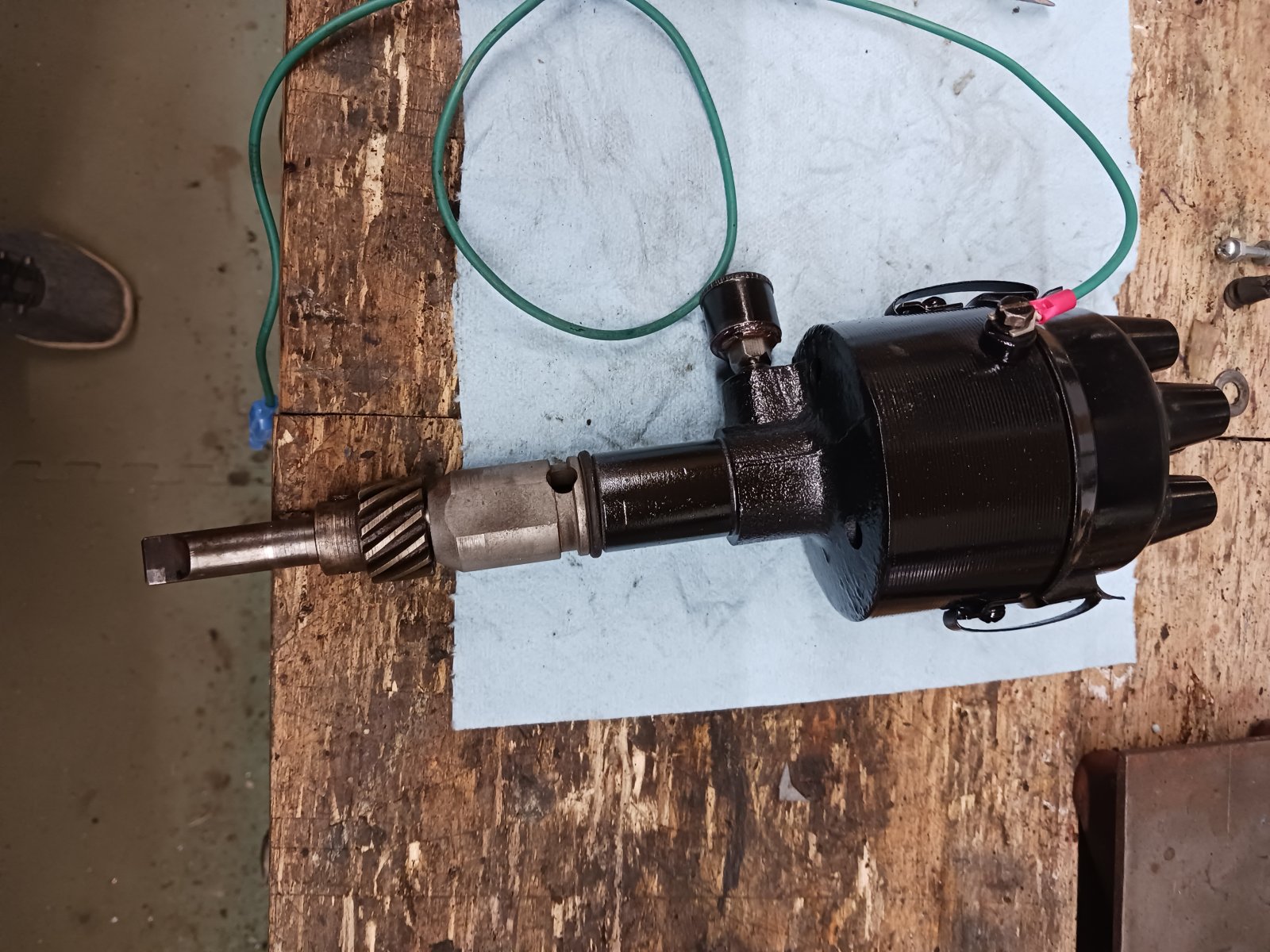

    Completed the rebuild on the 216 distributor. Time to see if it helps make it run.

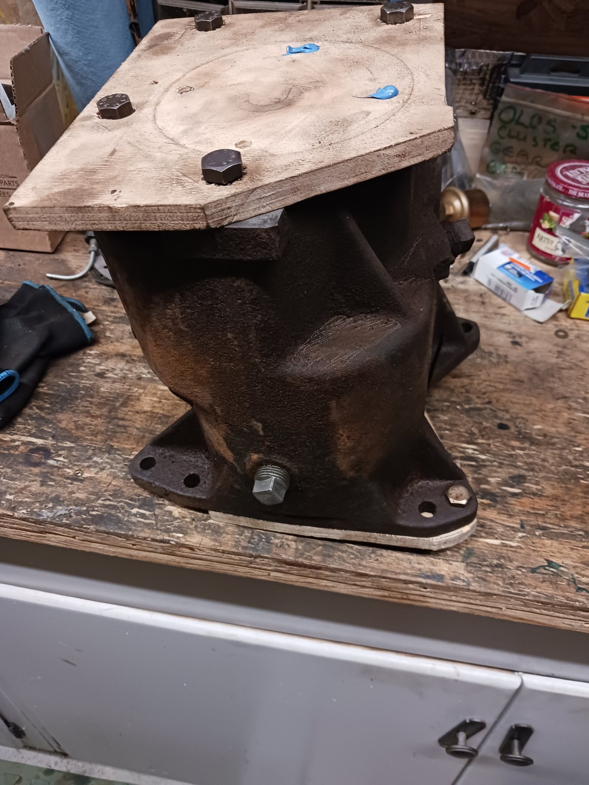

    Working on my 68 top loader. It is a mess so I built some wood covers for it and will hit it with some black beauty this morning followed by some fresh paint.

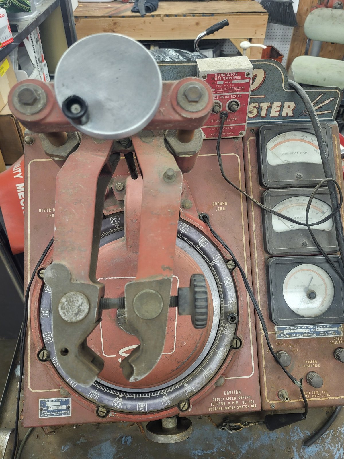

    Picked up an old Sun 400 distributor machine, I've been picking Moriarty's brain about getting it up and functioning. Mark was even nice enough to send me a missing crank handle. Pulled it apart yesterday and found these crusty batteries in it, after replacing them it seems to be working. Going to finish cleaning it and test all the functions 20240512_173328.jpg 20240504_083816.jpg

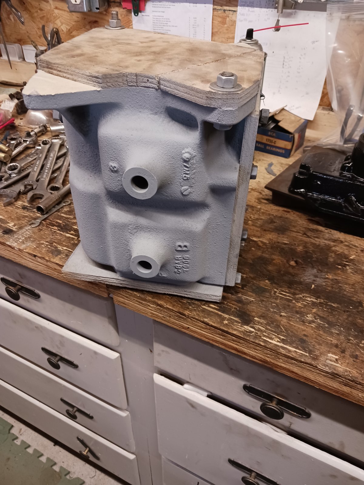

    Blasted that T150 case and then primed it. Ready for some black paint.

    looks like it came out of a nos box!

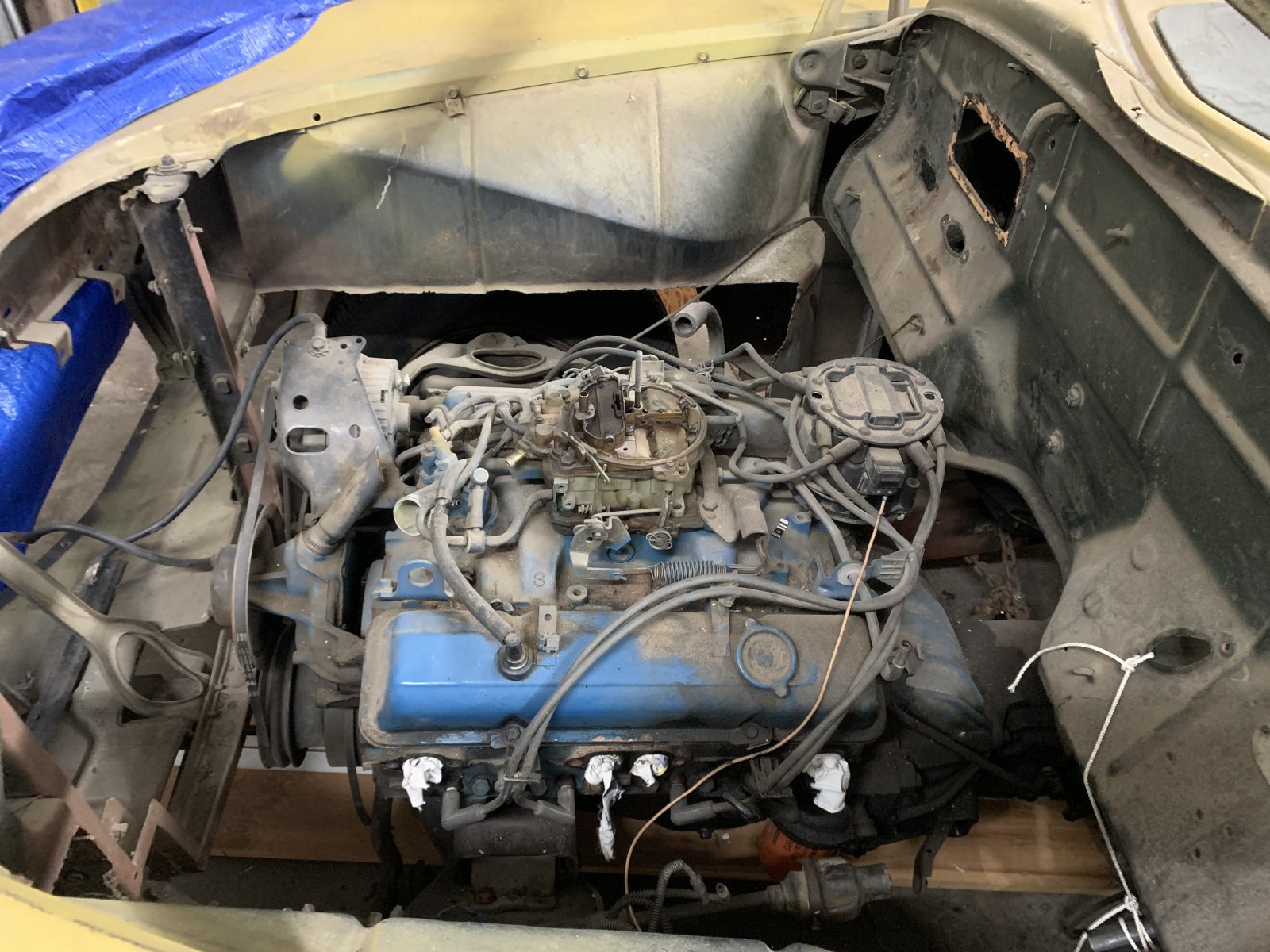

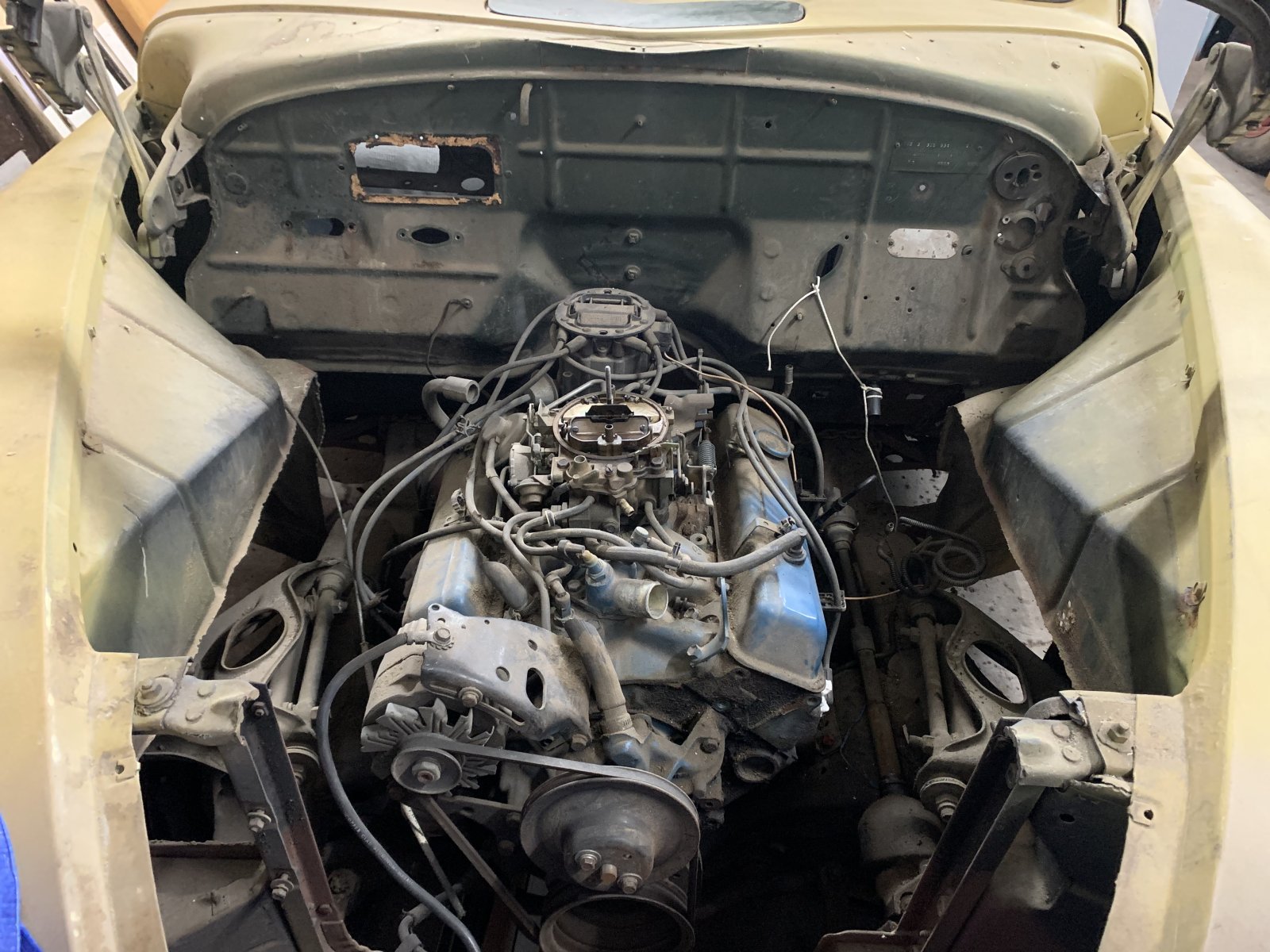

    Hood unbolted , now I can reach in and get a better visual ....For radiator clearance / better weight distribution going to move the engine back 6 inches....Fabricate mounts ....next go pickup the low mile Chevelle 400 Turbo trans I put a deposit on a while back..... 121A7D4E-D3D9-48D8-B644-B782EBDFE3EE.jpeg F7904214-B499-4301-A20A-DEBAF13F8830.jpeg

    Von Mac, is it the camera angle or is the fan going to be real low on the radiator?

    vtwhead , more of the angle..yet to determine fan size.. gonna notch frame on setback to keep stock mechanical fuel pump ..
