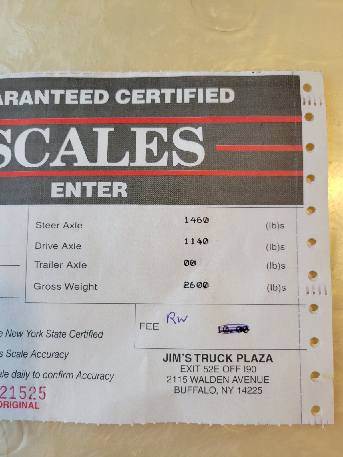

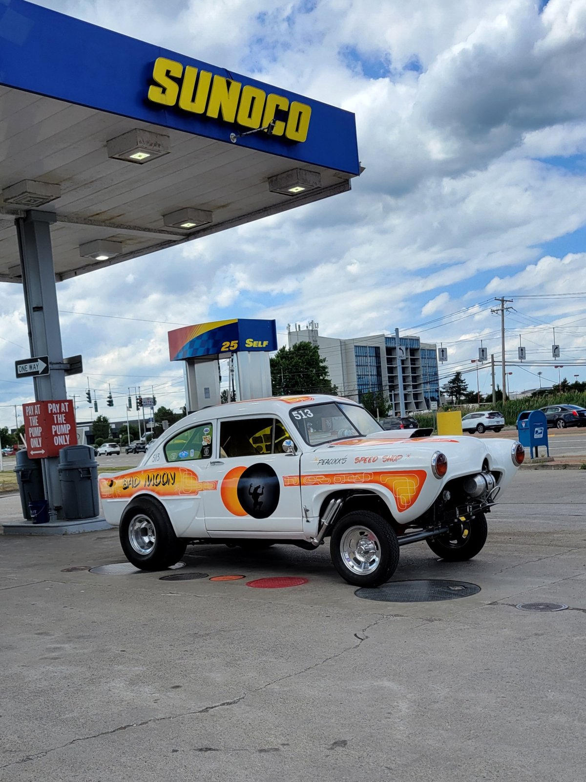

    Took the J down to the local truck stop certified scales, guaranteed plus/minus to 20 lbs, little heavier than I wanted because it gained 190 lbs with all the changes.

    Wow. I sure thought it would be lighter than that.

    It was 2410 when I weighed it at the track in 2013, who knows if they were accurate though. I had weighed it there in 2012 when it was all steel and flat black and it weighed 2400, so it gained 10 pounds by going to a gl*** nose, doors and a paint job. Lol
    Stock they weighed 2341 with the 4 cyl.

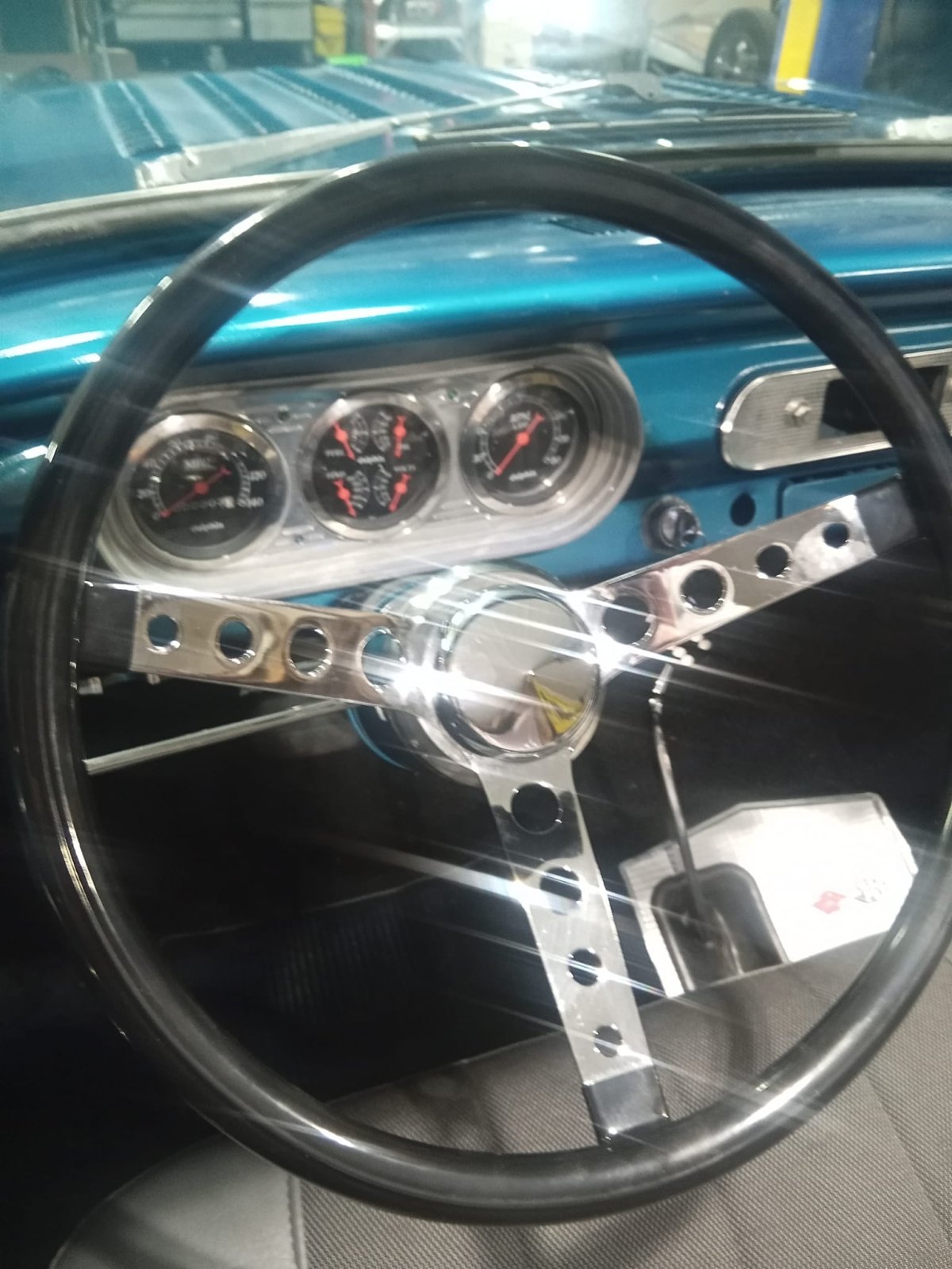

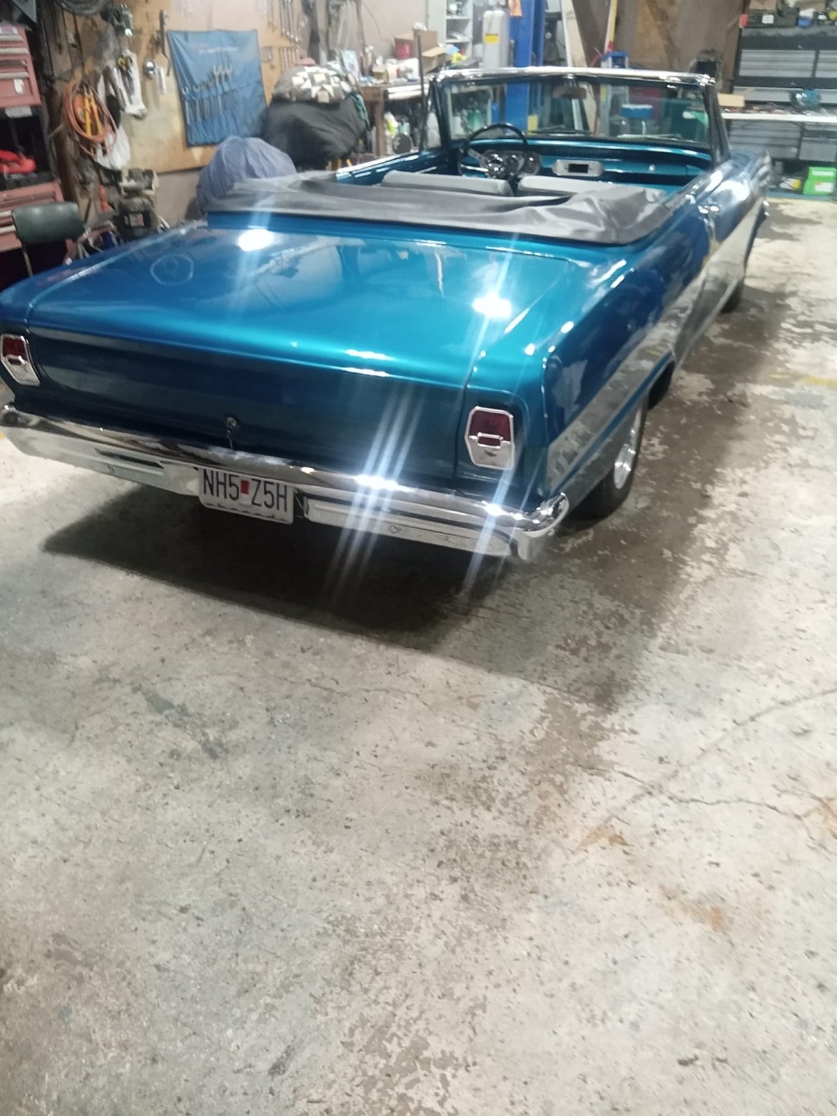

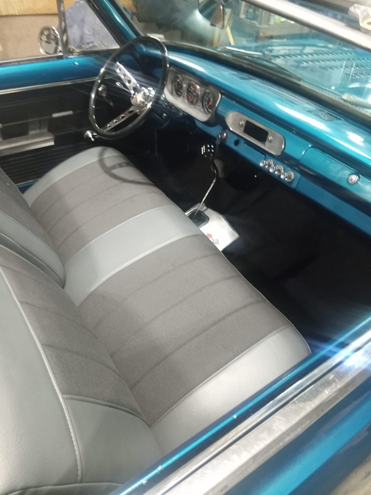

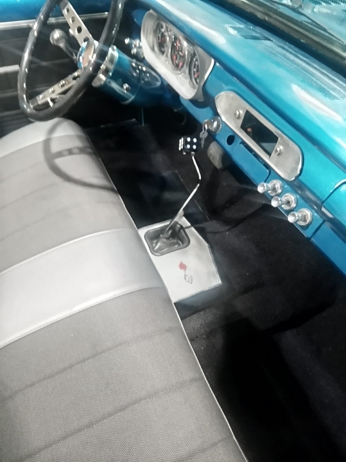

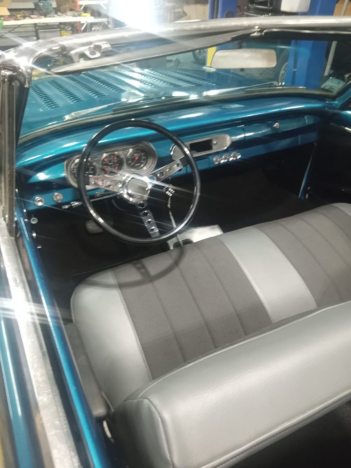

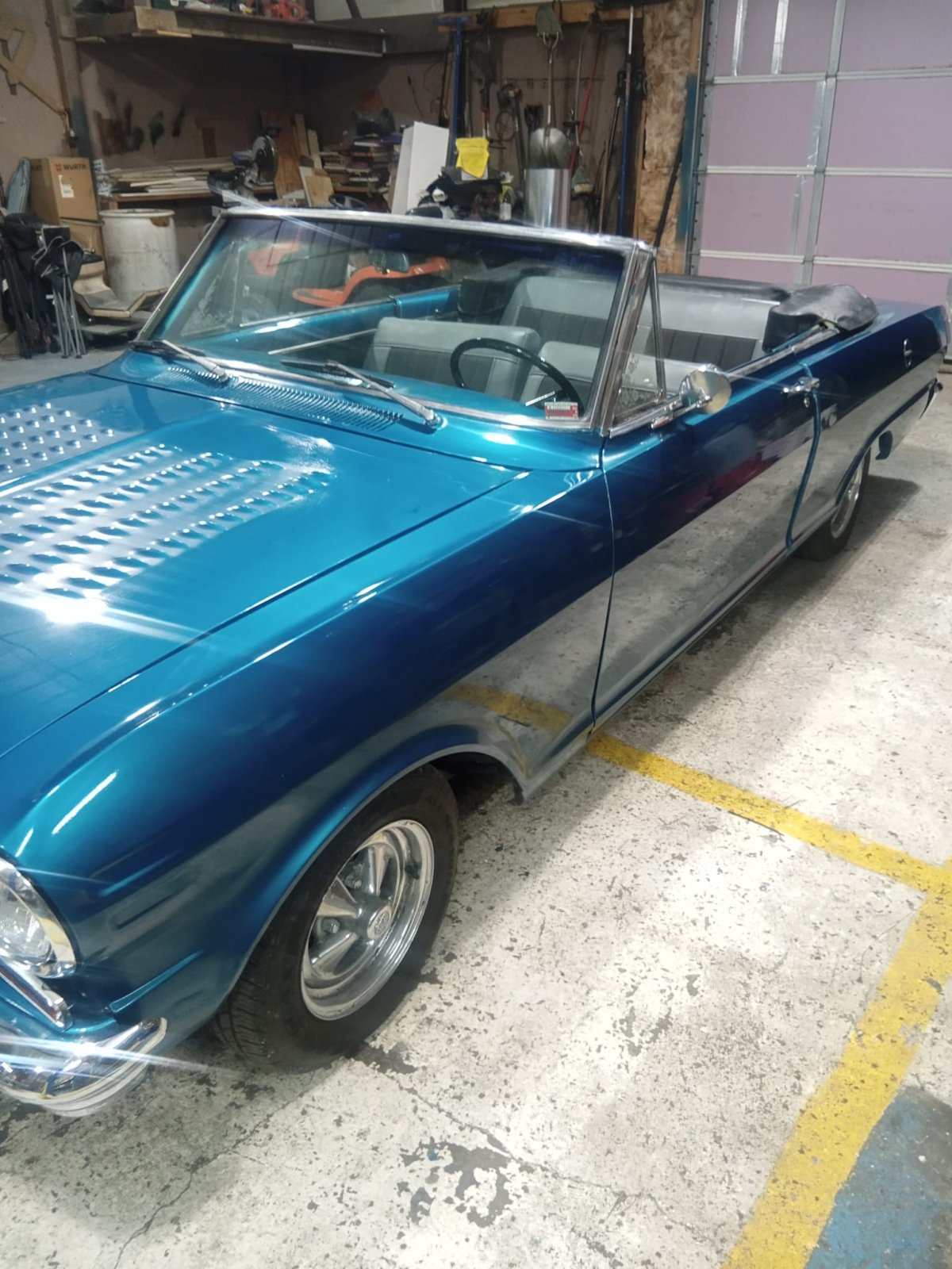

    Getting the Nova ready to show to the public. 449437074_8197682396922641_1594054566845093233_n.jpg 449439556_8197683363589211_6075546632892683070_n.jpg 449443792_8197683773589170_6360199659834232259_n.jpg 449487014_8197689563588591_2650990422720969442_n.jpg 449531919_8197684173589130_5731759453572071862_n.jpg 449792161_8197684646922416_3334897836403534514_n.jpg

    @atch Yes just don't look real close. It's like a prop car for t.v.. A lot of stuff is just on the car for looks. Hood not bolted down. carpet not finished . Hell the shifter isn't even hooked to transmission.
    It does run and drive just start in gear and go. :D:D

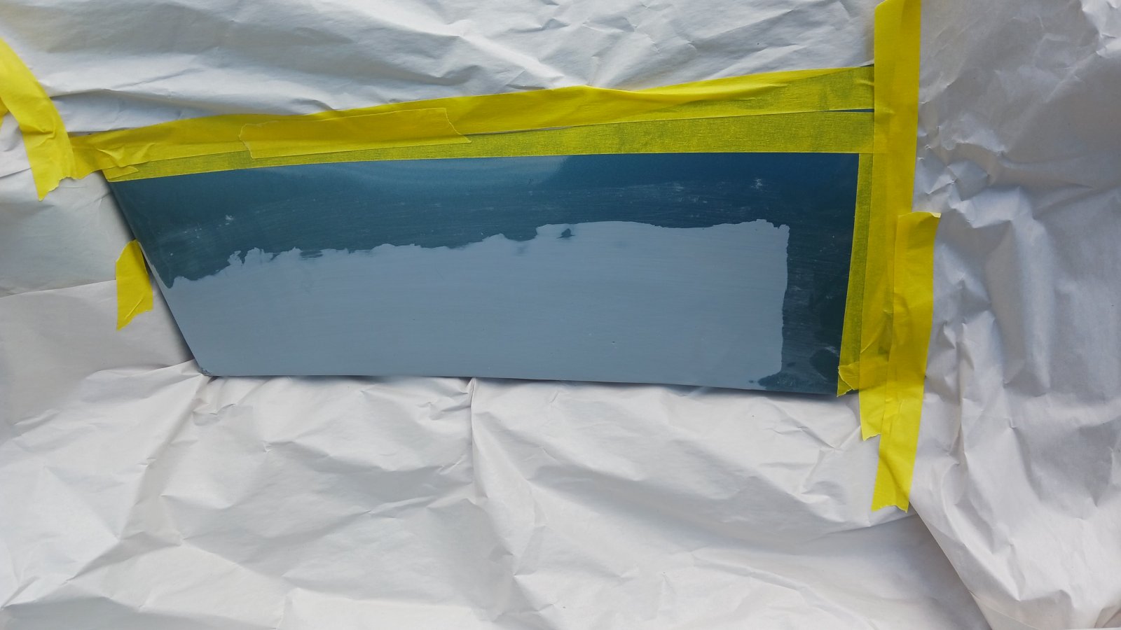

    Just before we took off to Ohio for the weekend I decided to touch up my 49. The previous owner had repaired some spits and could never get the paint matched back to an acceptable shade. So he just re-primered it. My Kentucky paint guy just happens to be better than whoever he used in WV.
    I had him put some in a spray can and it sprayed out fine. I think after a little wetsanding and some buffing it will be just good enough.

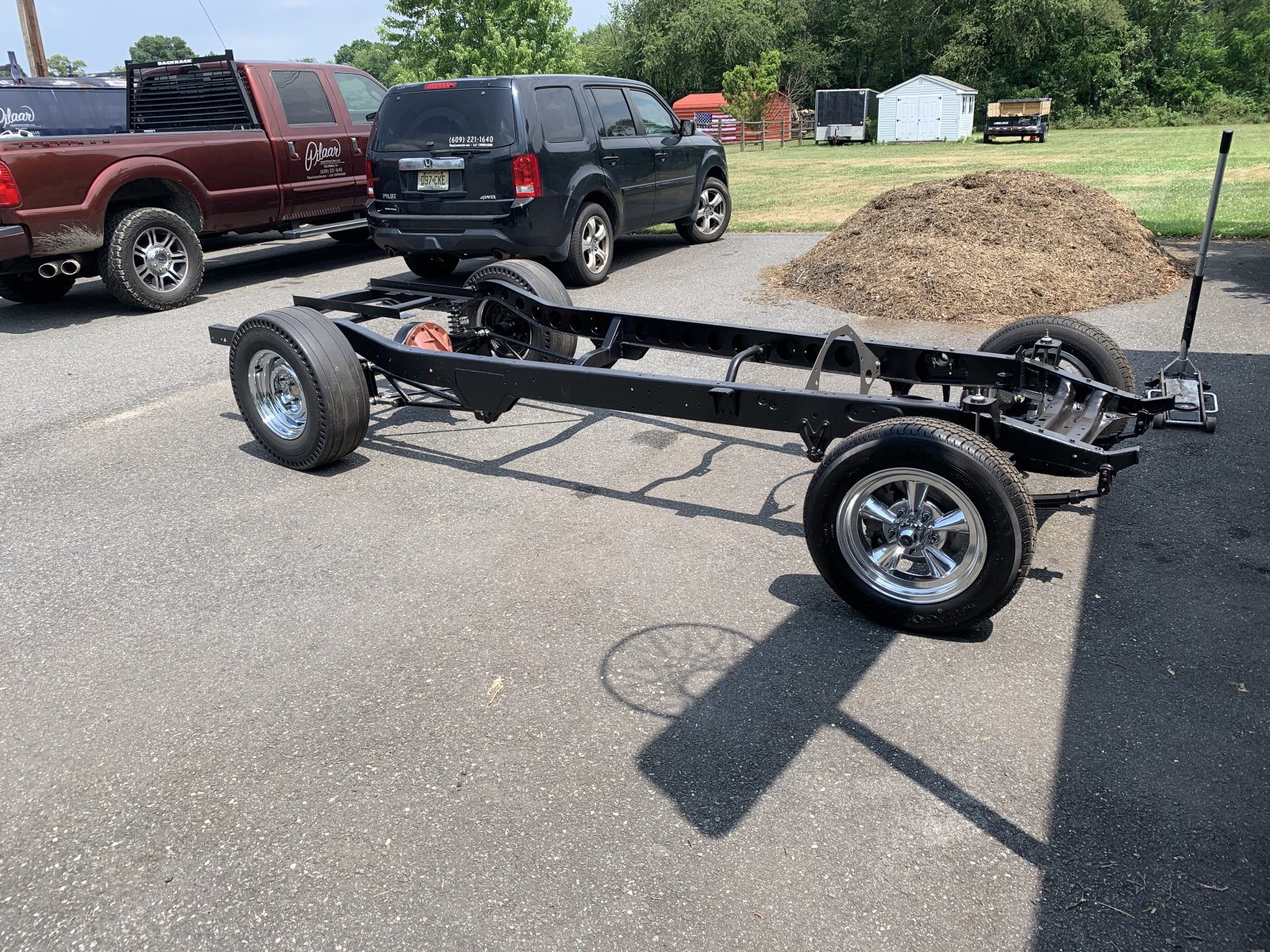

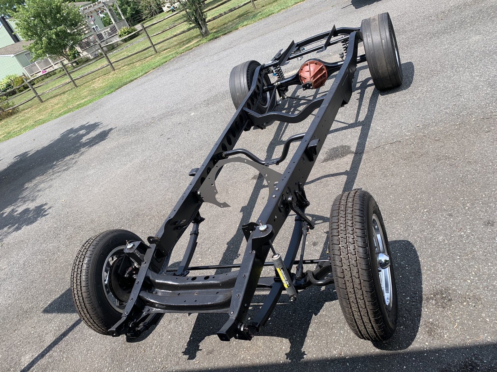

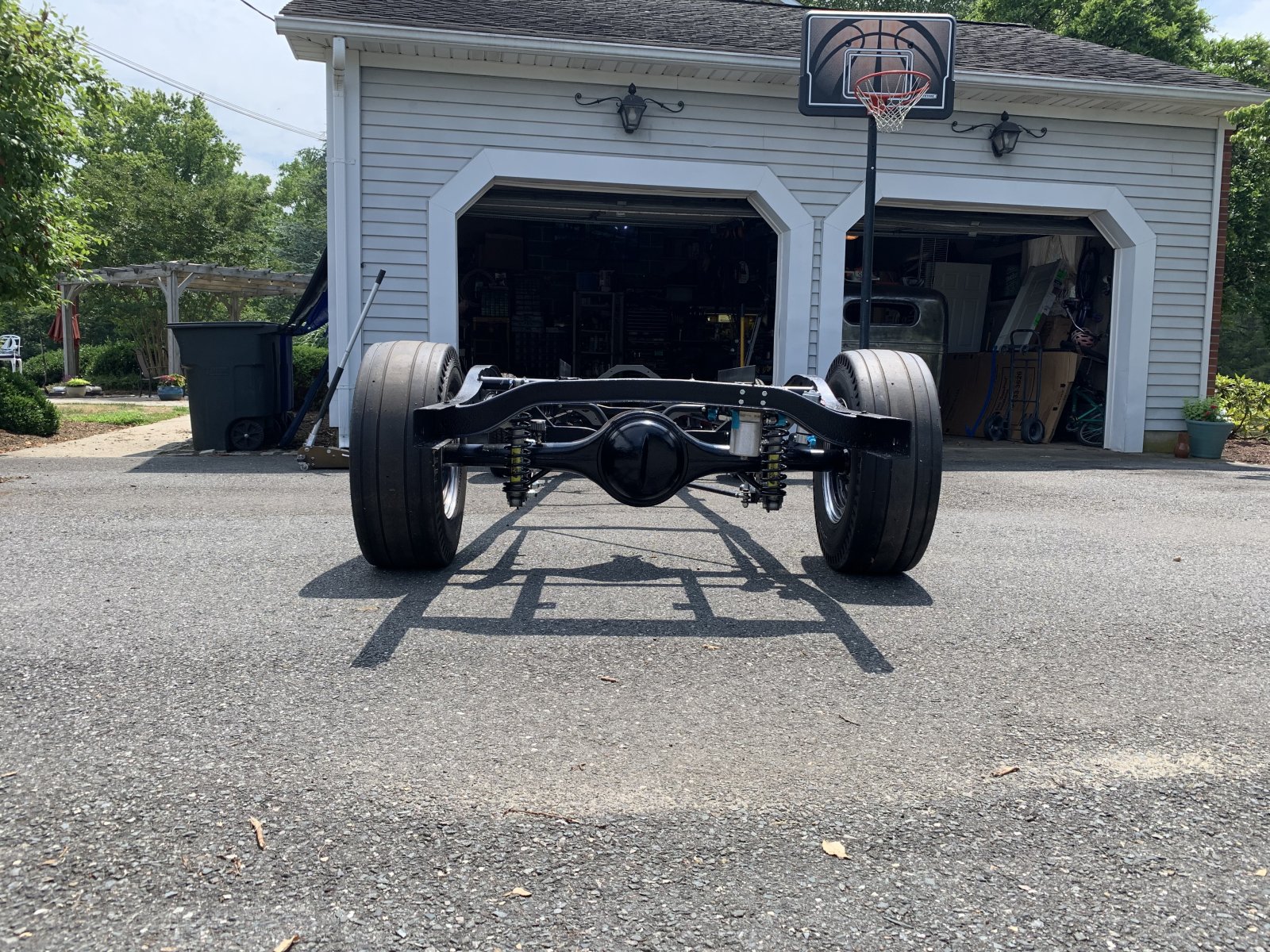

    Ch***is is ready for the road. Messed up and set one shock wrong, so it’s sitting a bit ****eyed. Working on cleaning up the cab now for primer and lizard skin.

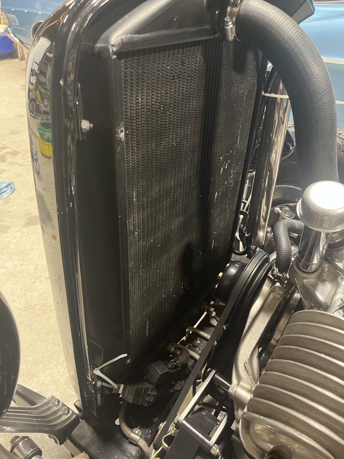

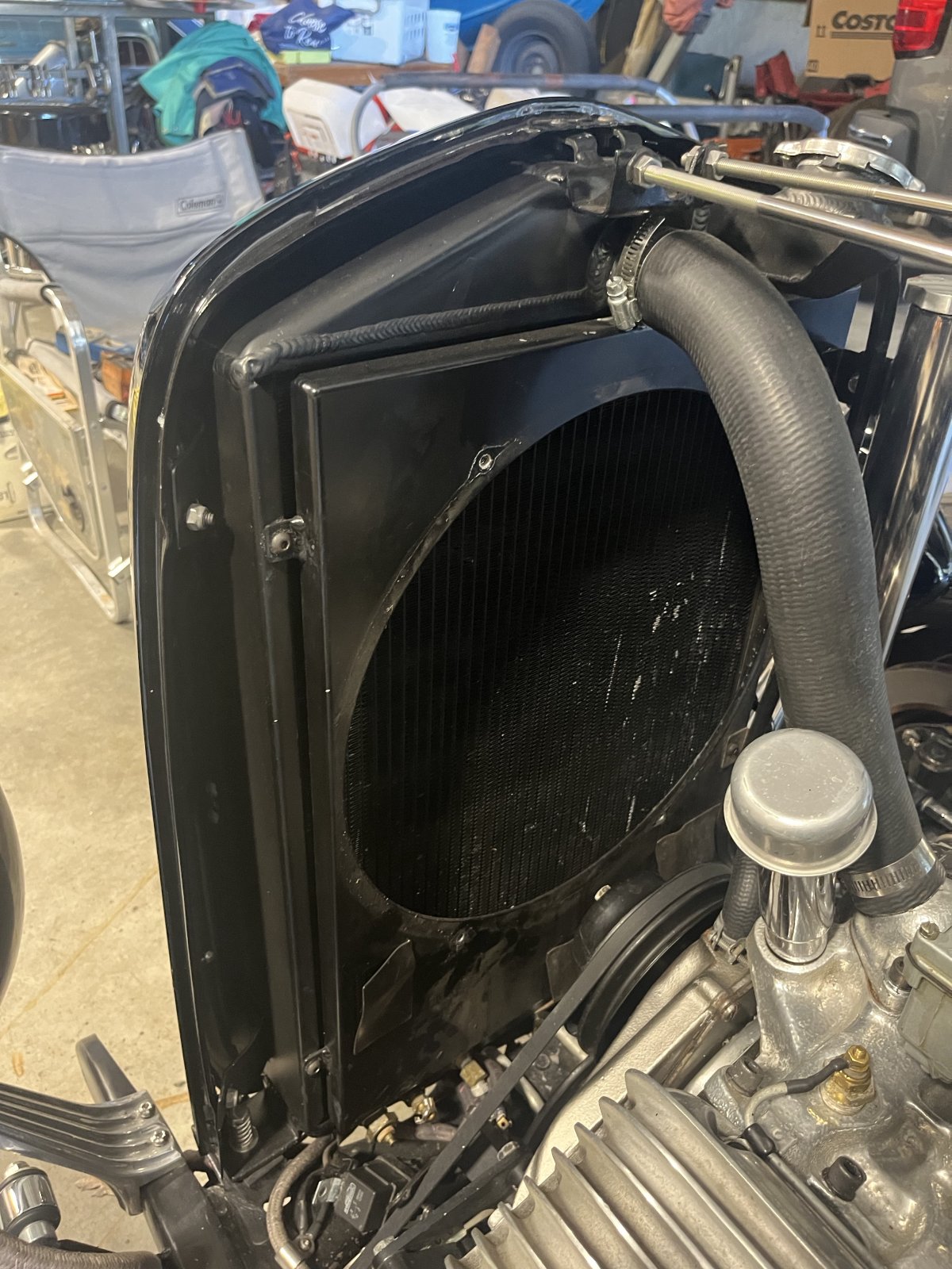

    Working through some ‘almost’ overheating issues with the Model A (avatar). Driving to LARS last month it got to 230 degrees climbing hills near Mohave, CA in near-100 degree heat. I made it home ok because we travelled along the coast, but that aggression won’t stand.
    Electric fan takes care of it at slow speeds, but it gets hot while cruising in hot weather, which usually equals airflow problem. I took advantage of our recent near-100 degree weather and drove a hilly route with the electric fan removed (better, but not the holy grail), then without the fan shroud (improved, but no). Got home and flushed 10,000 miles of bugs from the AC condenser and radiator and checked the timing for the heck of it. Flippin’ thing had 17 degrees initial! Got that corrected and took drive with the AC on ‘blizzard’ up to our local Cascade Range mountain at 96 degrees….. mostly stayed between 190-210, so that’s that. I had the distributor out this spring and the wife must have reinstalled it with the wrong timing.
    Giddyup,
    John

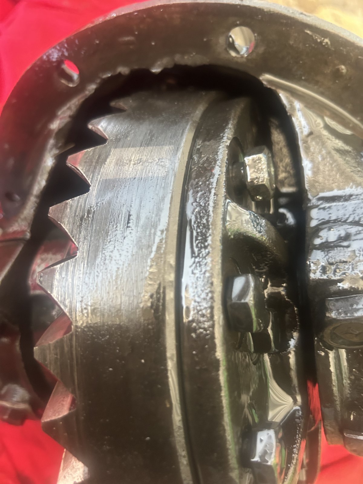

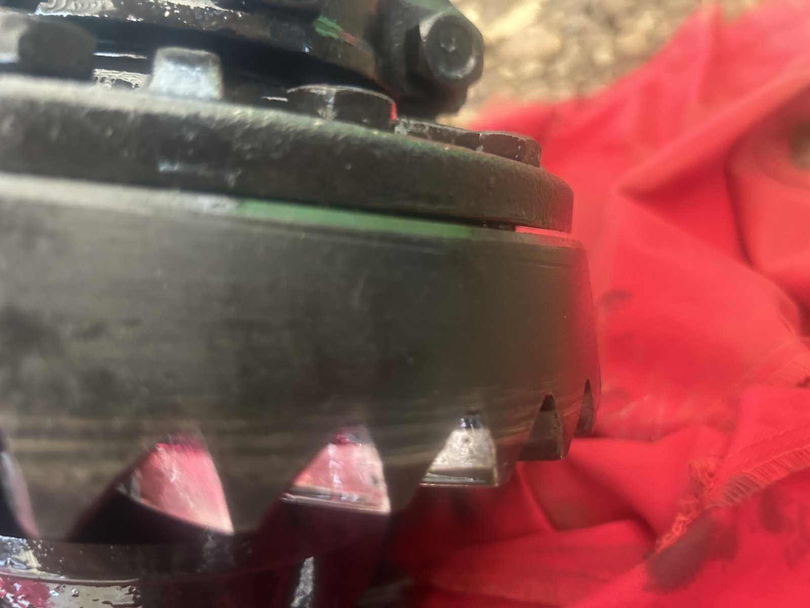

    Planning a road trip with the little Barracuda, figured since it has 4.56s in the rear end I would throw a little more highway friendly gear in it, put together a one legger with 3.55s in it. Pulled the old center section out of the car and found this…. IMG_5655.jpeg
    Ring gear bolts were finger tight, good thing I decided to change them, explains the gear noise I suppose.

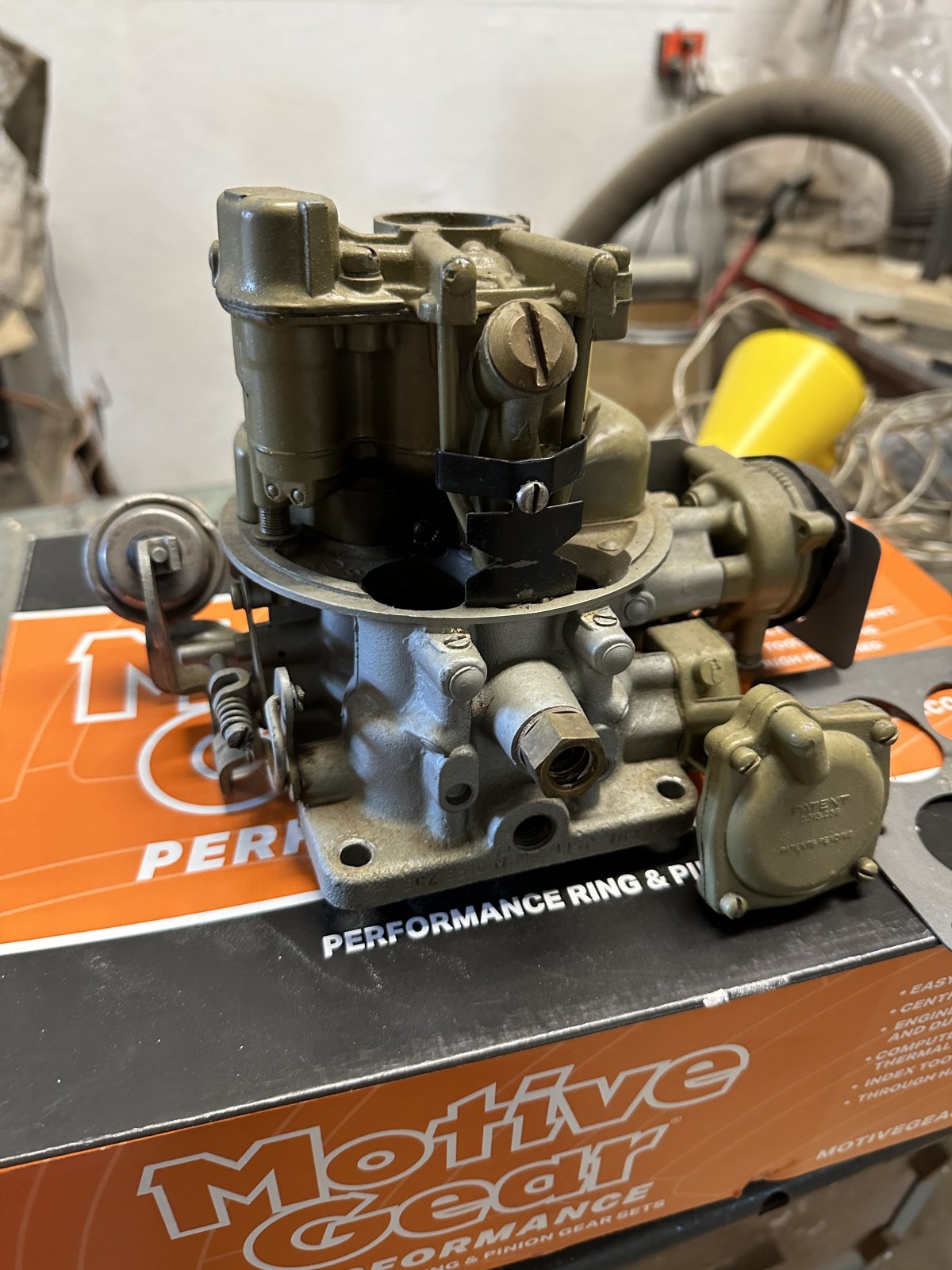

    Getting stuff ready for the Iola swap meet. Space BH80

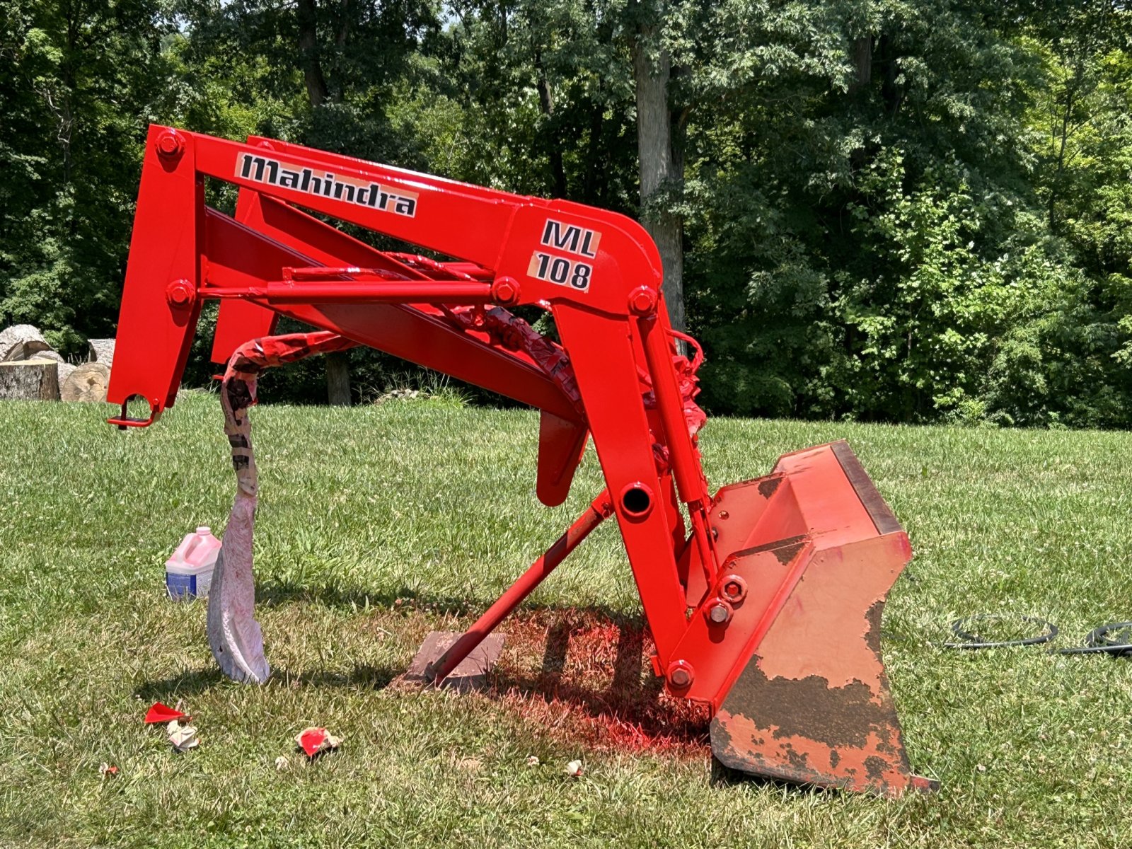

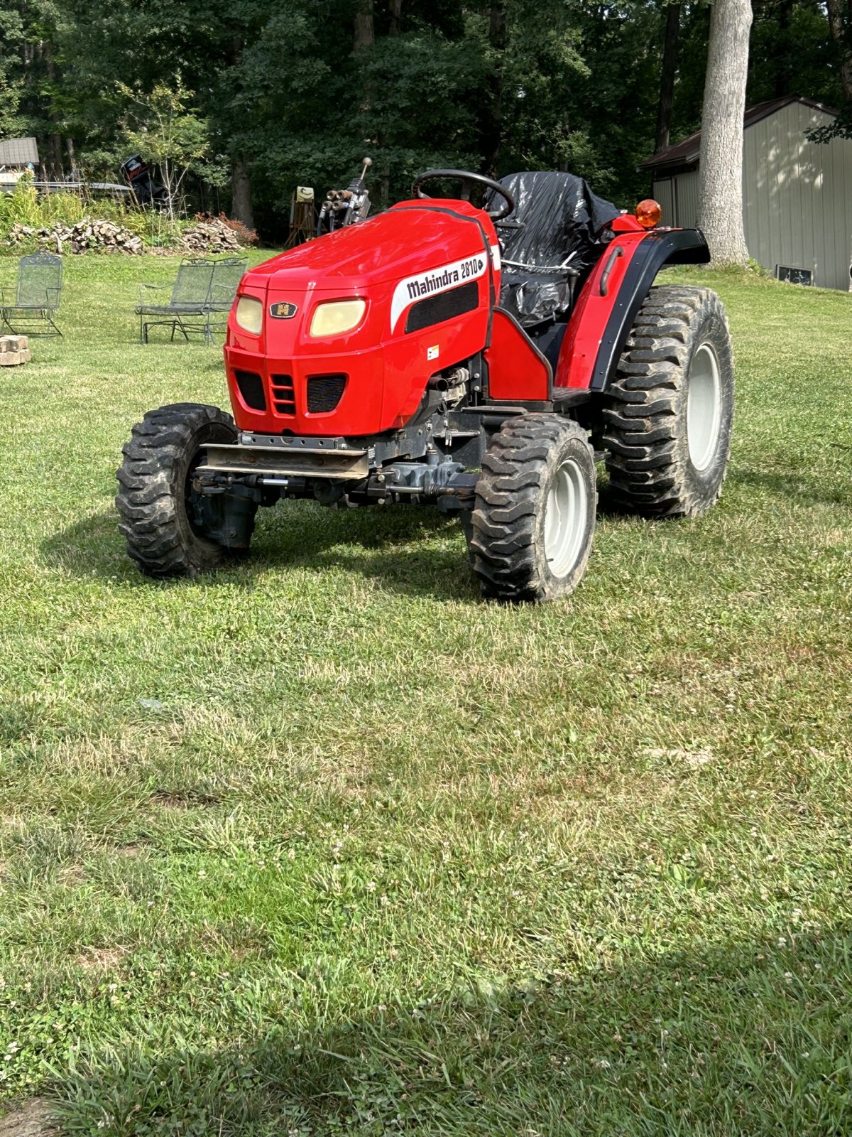

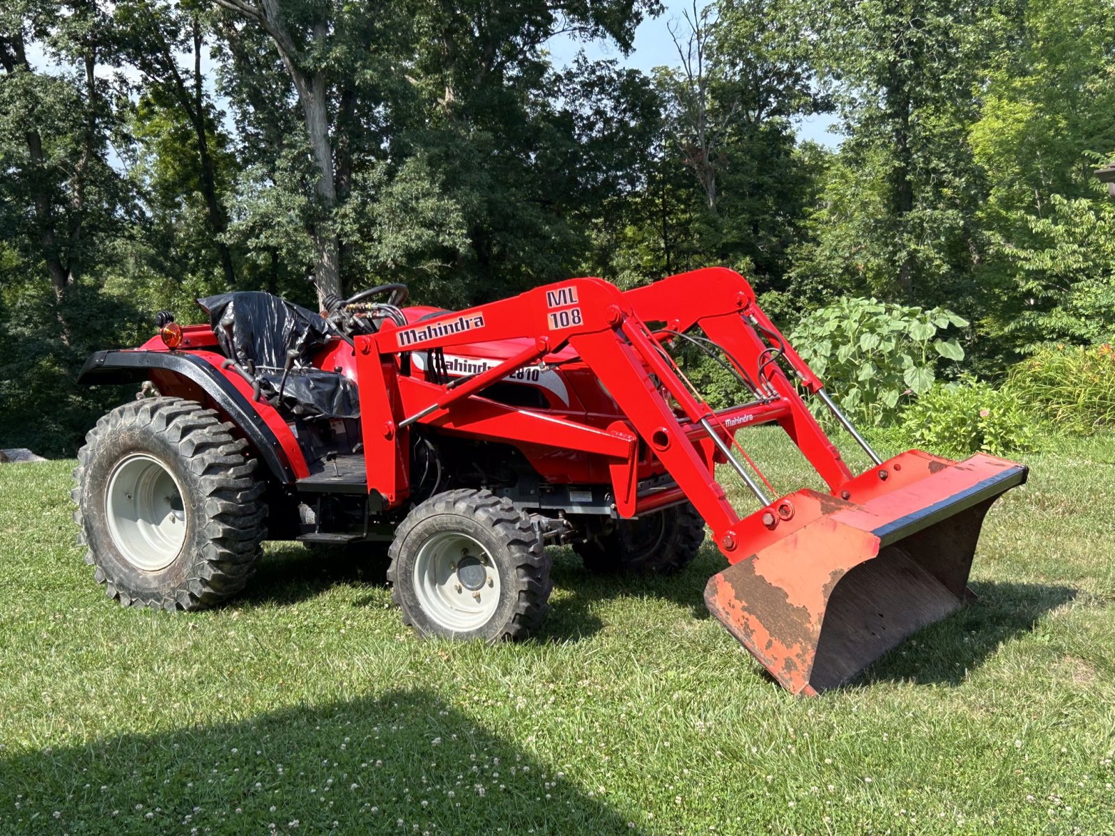

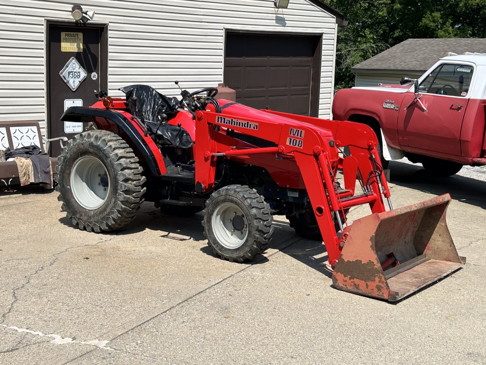

    OT but repainting one of my tractors

    Not OT, It's a 4x4 powered mobile engine hoist.:cool:

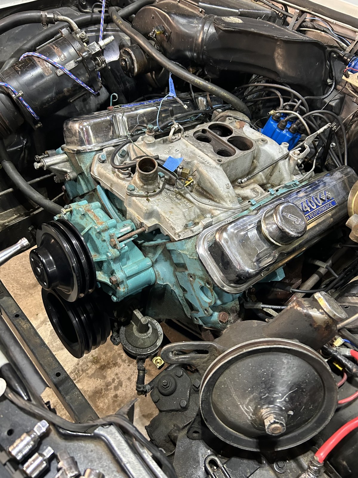

    IMG_2079.jpeg Getting ready to pull the engine on my ‘63 Pontiac. Lots of oil leaks, and detonation at WOT. Tried everything else to get rid of detonation, so gonna pull engine and see what’s in there. Previous owner thought it was a 400 out of a ‘73 Pontiac, so it would have been a smog era low compression ratio. In reality I decoded it as a ‘69 400 with 10:1 CR. So maybe the dufus threw an inappropriate cam in there to build cylinder pressure like a lot of CompCams are ground. I’ll find out soon enough.

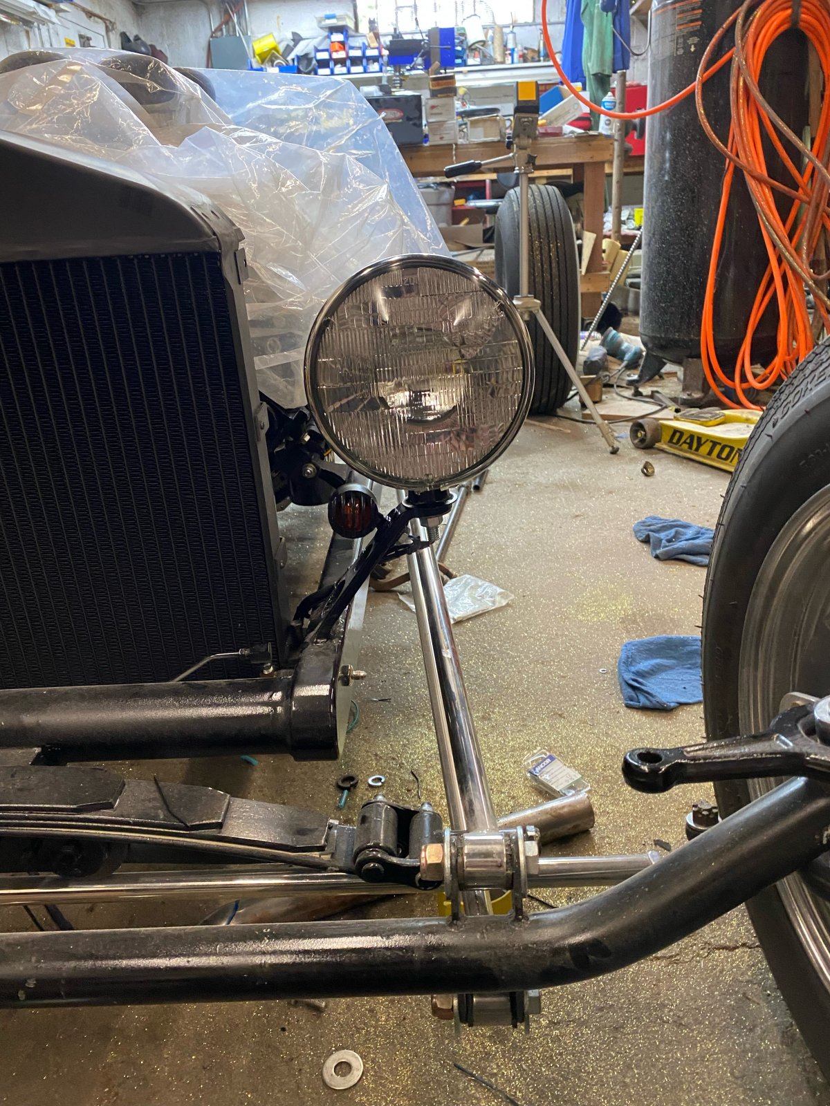

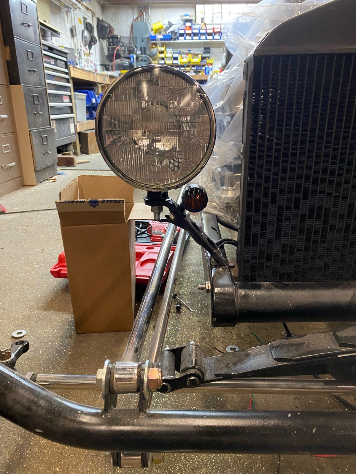

    Got my headlights and running / turn signal in place IMG_6526.jpeg IMG_6525.jpeg

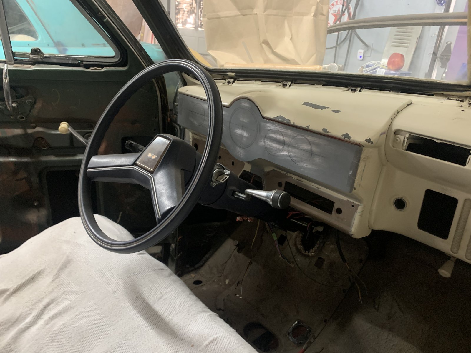

    Test fitting the GM column.. looks ok. Might wanna go with key on dashboard .. 2184EA42-AC9C-4A1C-93BD-2BD3B867682B.jpeg

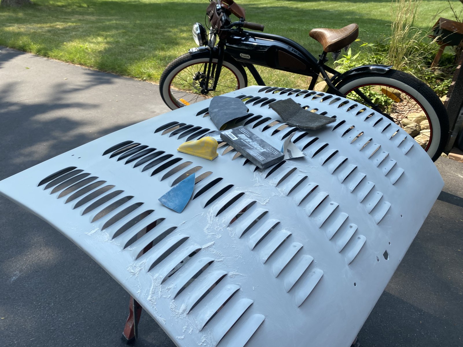

    The painstakingly slow process of prepping my louvered trunk lid for paint.:rolleyes:
