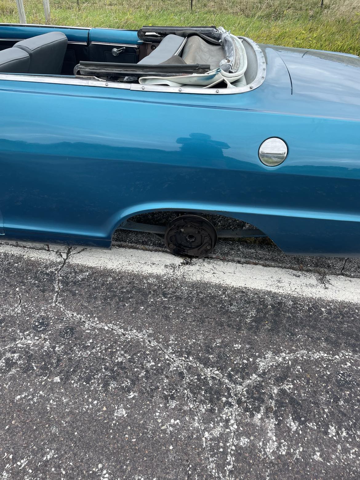

    Ouch !.. I bet that took the wrinkles out of your forehead.
    Thankfully the quarter appears to have escaped any carnage.

    I have a rear end. Will be ordering discs for front. Didn't want to have to do this right now.

    How much power are you putting out? Looks like you needed C Clip eliminators to keep the shafts in the axle. I have a 10 bolt rear end from a 68 Camaro set up with locker, good 28 spline shafts, 3.55 gears, and disk brakes that is just sitting in the shop now that it won't hold up with the engine power increase on my 51. How far away are you searching?

    It's a 194 6 cyl. I have the old out and the new going in. Thanks.

    It's home. Only thing hurt was backing plate and brakes. Besides my pride.
    Old is out and new going in.
    Ordering brakes tomorrow.
    I checked these bearings and they are good.
    I will have to see what wheel and tire fits now that I'm going 15 inch.
    I have a pair of 15x6 with 195/65/15 tires . Will check the fit when it's back in.
    Installing new studs also. Gears all look good.
    I got the axles out and old mounts off plus new mounts tacked in place.

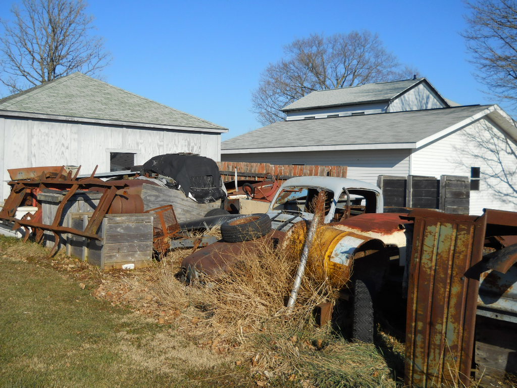

    rusty1

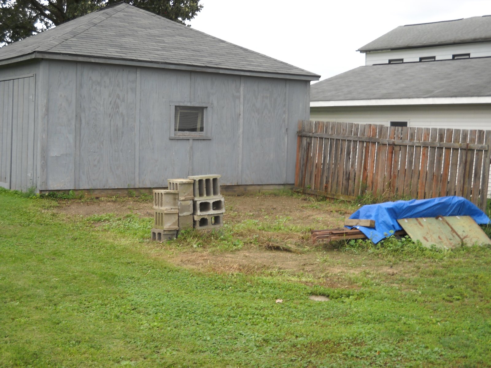

    been cleanin up this mess...

  14. choptop40
    Joined: Dec 23, 2009
    Posts: 5,765
    choptop40
    what mess...thats heaven on earth...lol
    427 sleeper likes this.
  15. choptop40
    Posts: 5,765
    choptop40
    now you have room to buy more cars,,problem solved..he he he
    chryslerfan55 and 427 sleeper like this.
  16. guthriesmith
    Joined: Aug 17, 2006
    Posts: 13,227
    guthriesmith
    Cleaning up is what I need to do too @rusty1
    rod1 and Truckdoctor Andy like this.

  18. rusty1
    Joined: Nov 25, 2004
    Posts: 13,474
    rusty1
    s**** was $140 per ton, had over 2 tons,
    kept a lot of this stuff, just relocated it, sold some, gave some away, s****'d the rest.
    ...feel lots better now.

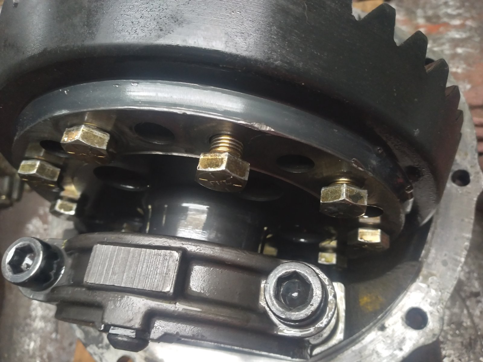

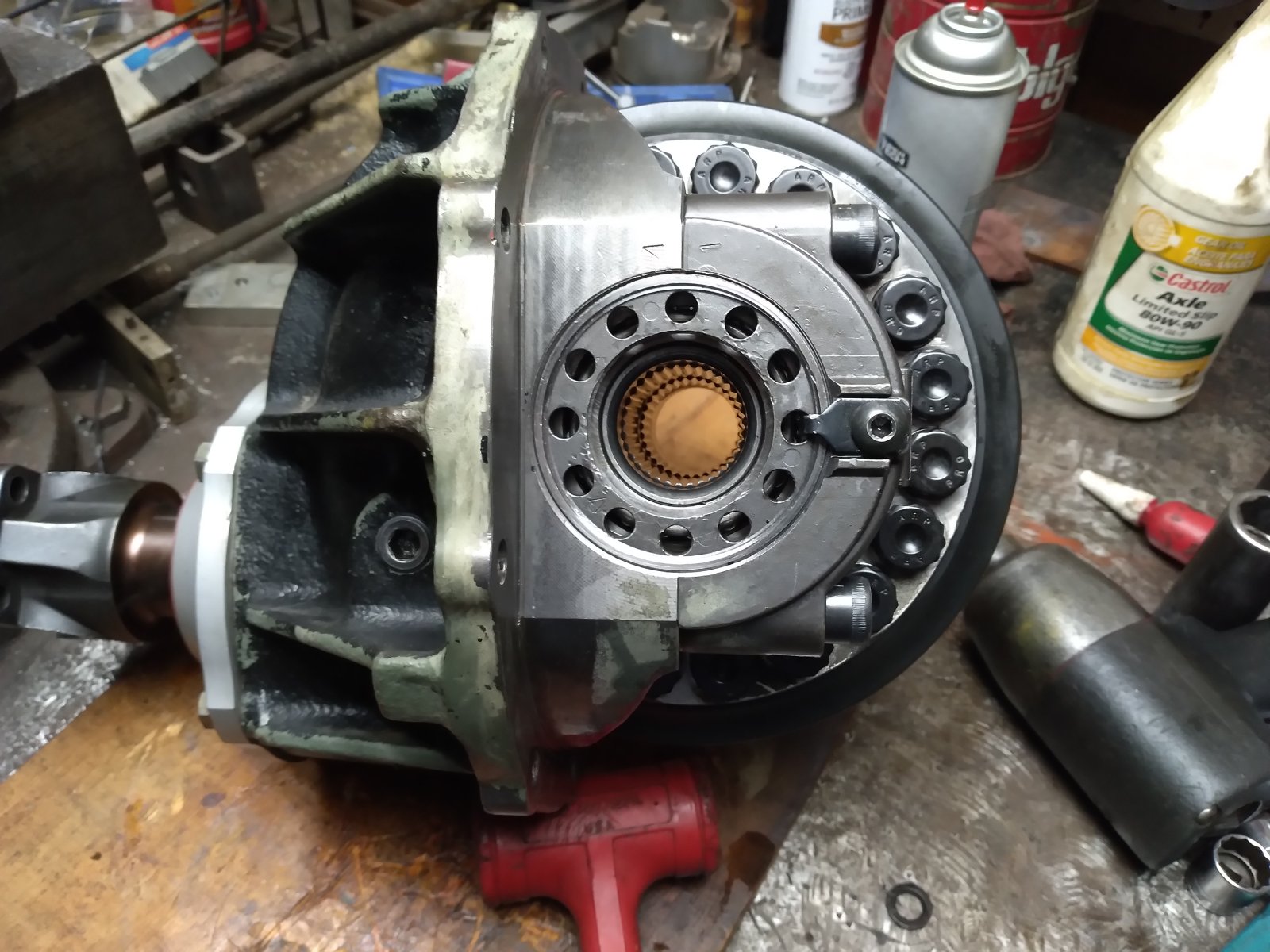

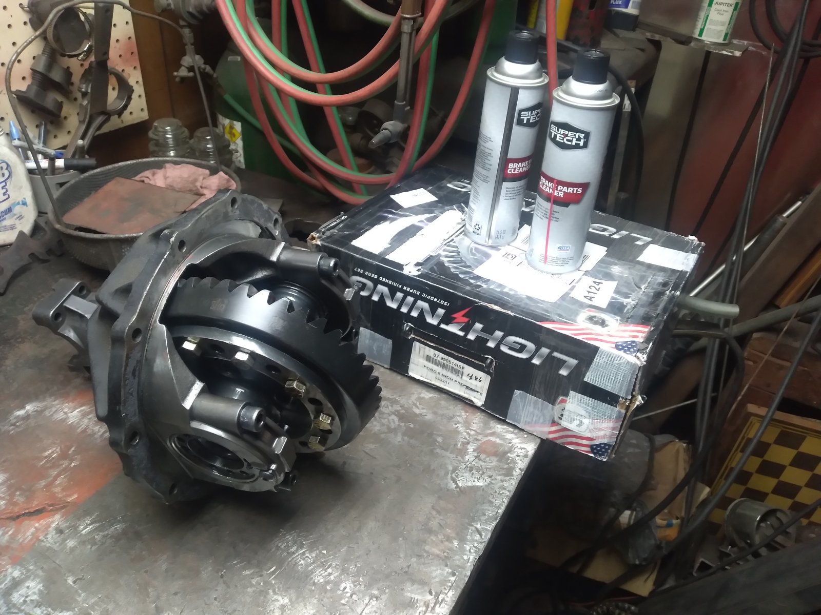

    Had a disaster avoided. My buddy with the White Lighting 62 Chevy was changing rear tires and decided to change the rear gear from the 4.30 to a 4.88. Well when he pulled the third member out all but 2 of the ring gear bolts were tight. :eek:
    Should be good now.
  25. When I find something like that it raises the hair on the back of my neck. Next to impossible to drill those Grade 8s for wire but the right loc-***e should do the job.

    There was no loc-***e on these bolts and not even ring gear bolts. It's loaded up with 7/16 and 1/2 inch ring gear bolts now with red loc-***e.
