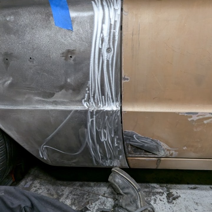

  5. My door to fender to rocker is screwed on the driver's side. The fender has been patched on, but I'm just about to go wild with a cut off wheel and make my own gaps lmao

    That is how it is done. Cut and weld.
    I cut and cap where they are too narrow. I add TIG rods where they are too wide.
    My Falcon was built with a HALF-INCH gap between the trailing edge of the hood and the cowl. There are now two rows of 1/8" TIG rods there, and I even made a new drop filler panel to correct the whole leading edge.
    The p***enger door does not line up properly line-up with the dashboard, too. It is just made wrong. That entire feature will need to be rebuilt. It is blatantly wrong.

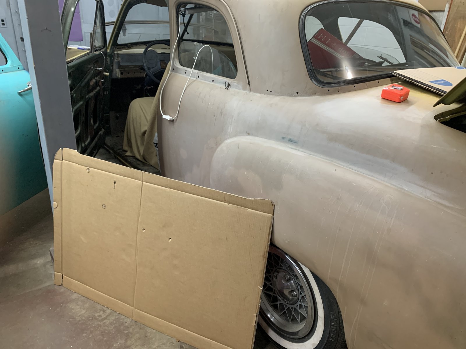

    Made cardboard template for the door panels.. Not sure whats the best material. image.jpg

  13. Personally, I go to Lowe's and buy the utility board. It's not much over 1/8" thick, kinda similar to thin luan, about $10 for a 4X8 sheet.
  14. OK maybe it's been a bit since I bought a sheet. Don't you love this economy? Screenshot_20240811-213643_Samsung Internet.jpg Screenshot_20240811-213634_Samsung Internet.jpg

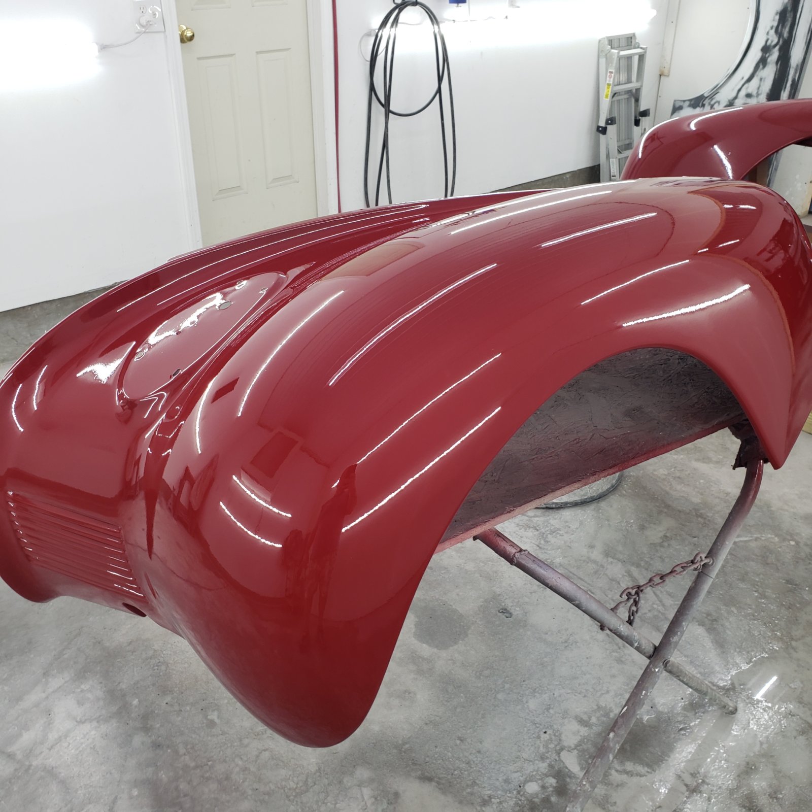

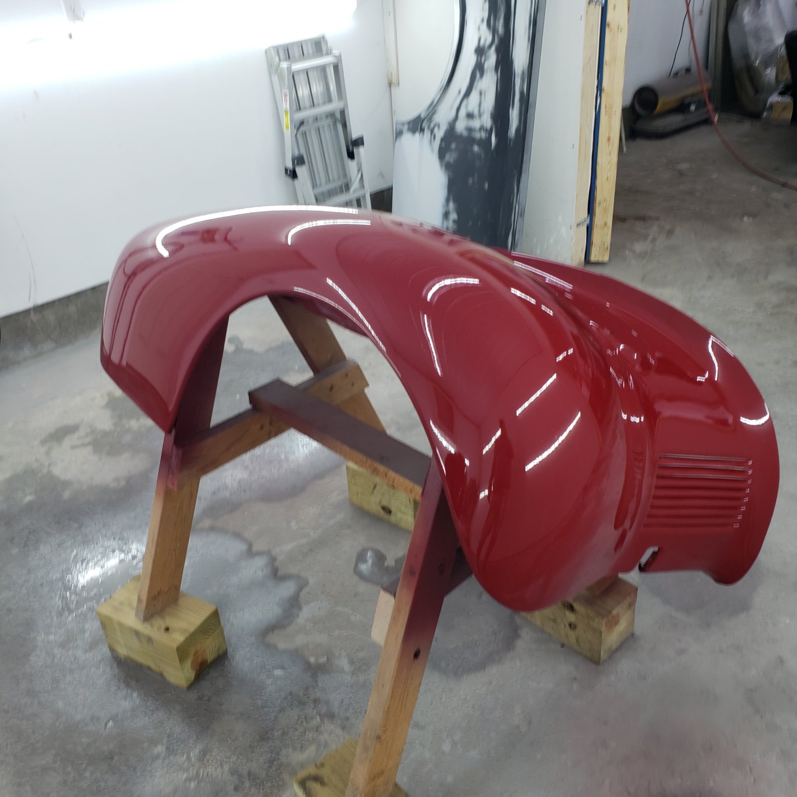

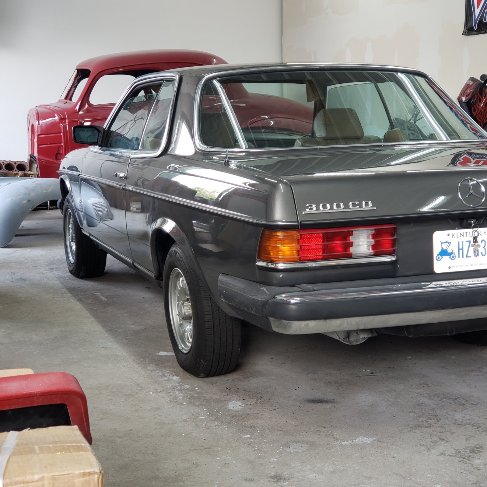

  15. Hey Brother, the car is looking great, that Benz is beautiful, and I really dig the color on the 39 Chevy.
  16. Thanks man, that's 69 Chevy garnet red.
