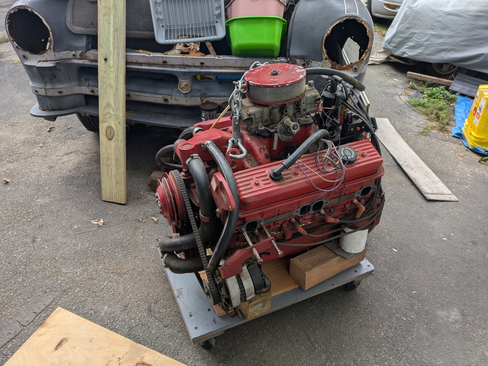

    Picked up a Mercruiser High Silicone Graphite casting 350 with super low hours in it. Bayliner hit a rock...Note the 750 Holley double pumper..Had a 4800 rpm rev limiter.... 50 DeSoto engine bay now has a mill .. PXL_20241001_145041856.jpg

    @choptop40 - Good deal, standard rotation the way it looks from a normal alternator.

    Did it sink, and if it did, was it in fresh or salt water? Nice catch, by the way.

    Oil is clean ,..ordered Pioneer FLA-159 , 168 tooth 1 piece real seal automatic flywheel...to replace the marine one....

    Is the carb marine or standard car type ?

    marine....an added lever riveted to throttle bracket..

    Marine carb should have tubes that bend back over the top from the vents. Does the alternator and starter have USCG approval stickers on them?

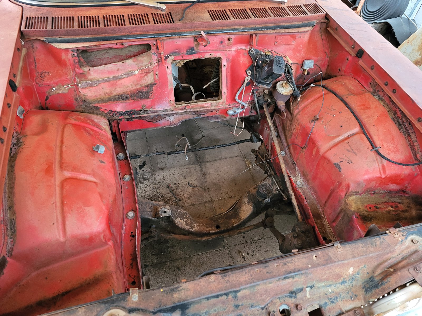

    20241004_180635.jpg Worked on cleaning up the tempest engine bay, very rust free. I discovered the engine cradle brackets are centered it's the mounting brackets on the engine that are offset. It looks like if I flip em left to right it will offset the V8 1 inch to the p*** side which would be perfect.

    Looking very closely at the 1962 HRM article it kinda looks like that's what Mickey did.

    Would that be a positive or negative offset? :D

    Would depend on if you lived here or in another country where they drive on the wrong side of the road:p

    but are you measuring to the inside or the outside of the bracket?
