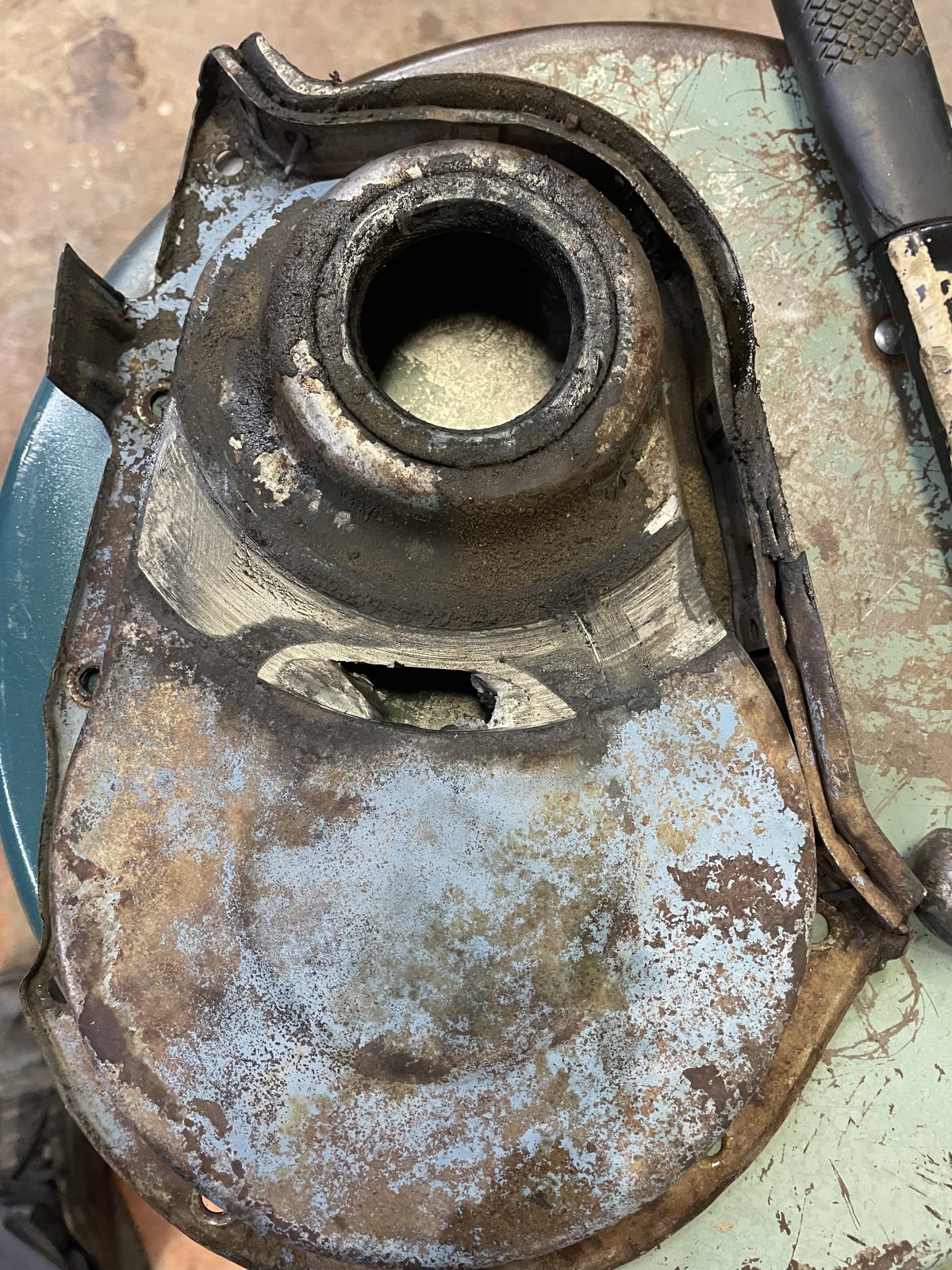

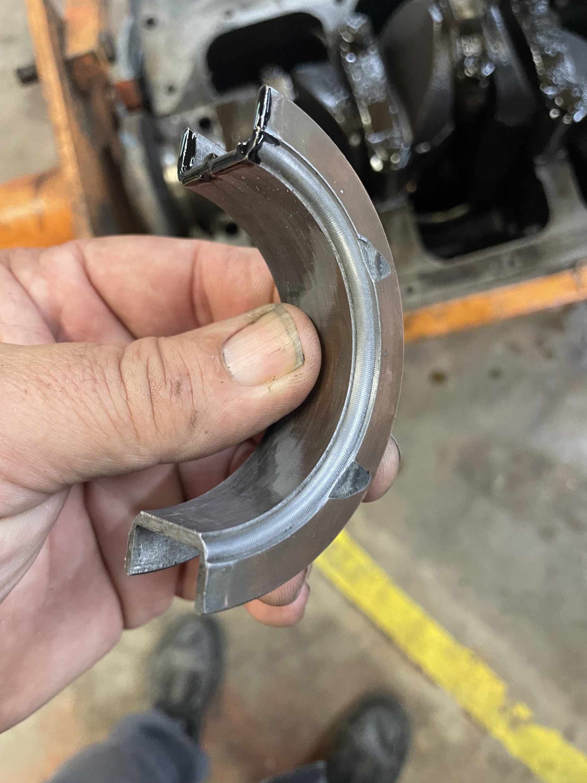

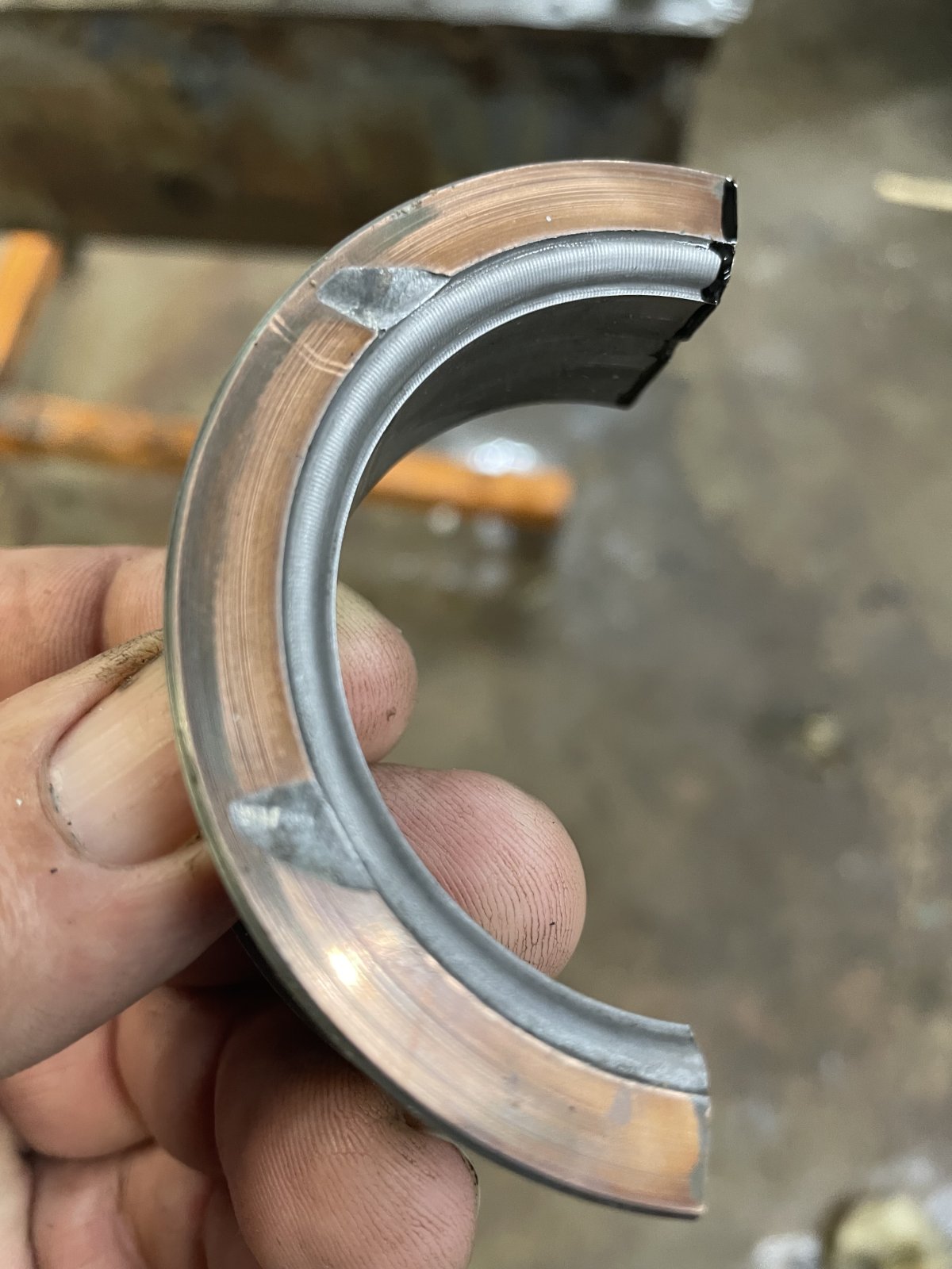

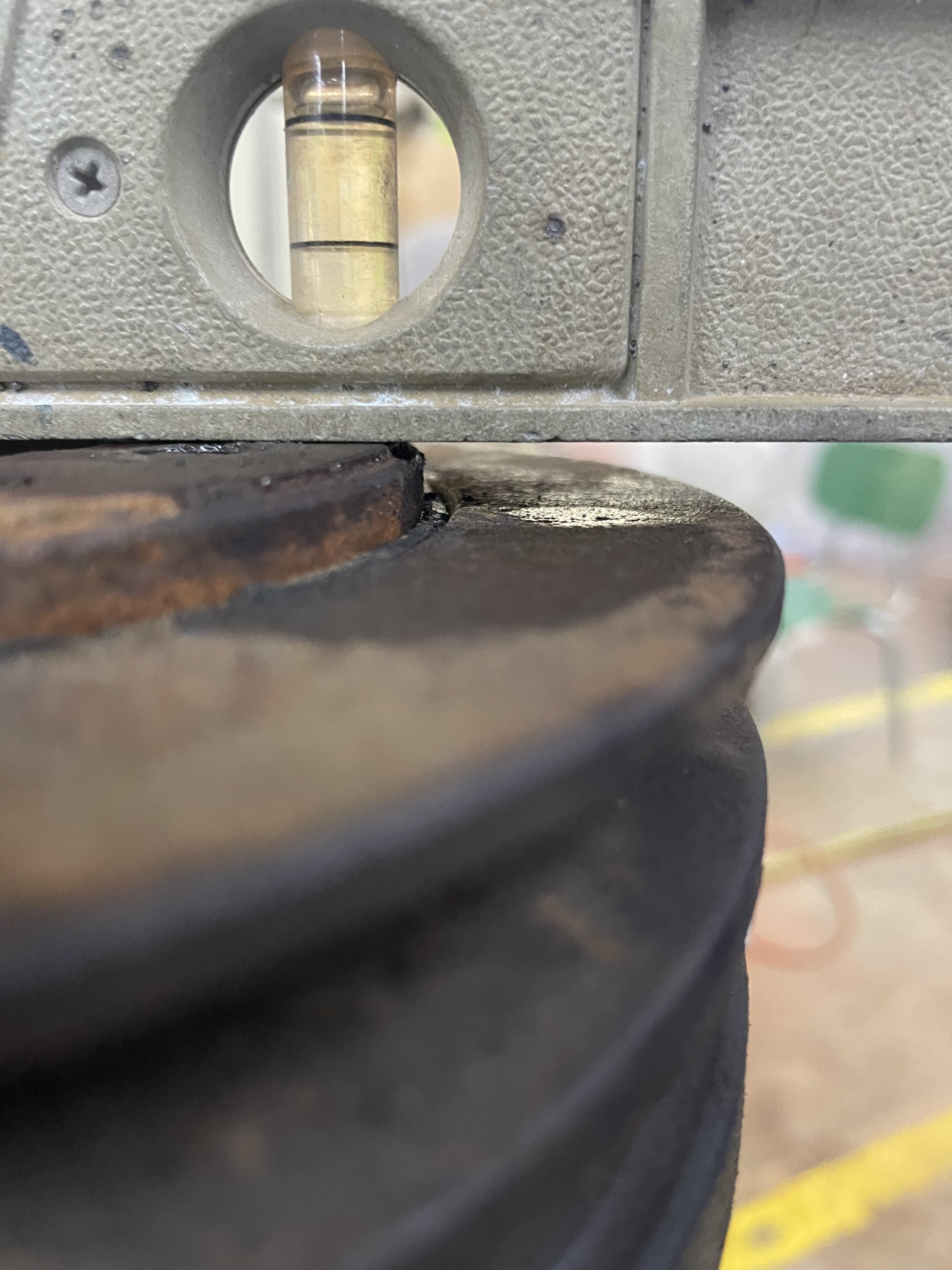

  1. Student asked “why are we taking apart an engine that ran so good”
    10 minutes later:
    thrust bearing has some wear but not as bad as I thought it would look if the crank had moved far enough
    Timing gear is not touching the block. I’m thinking the dampener was hammered on to much

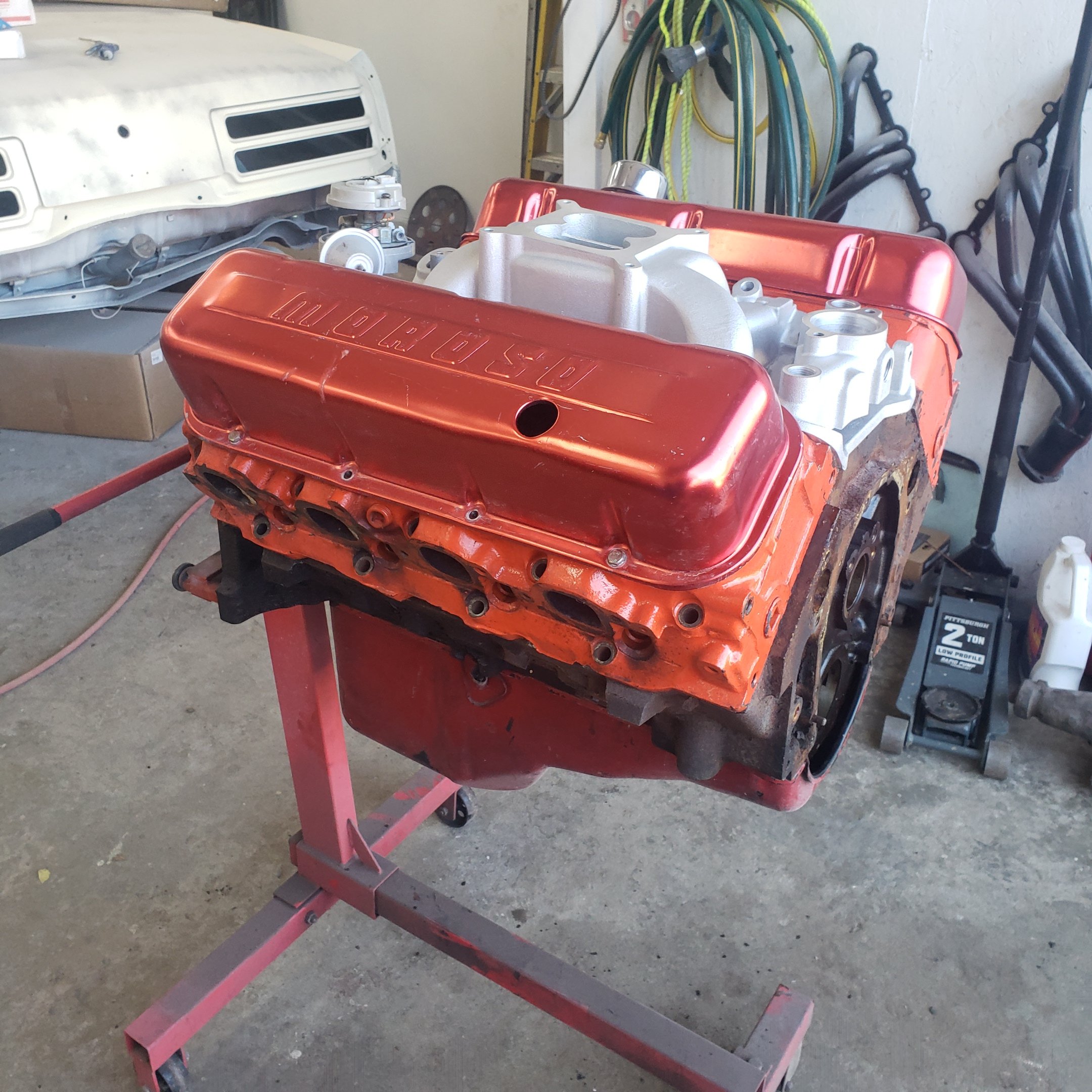

  3. Cheap trade for the engine .
    I’m still happy with it. Ive got another cover Just more curious for the cause. The hole wasn’t there until I pushed thru it
    chryslerfan55 and Sharpone like this.

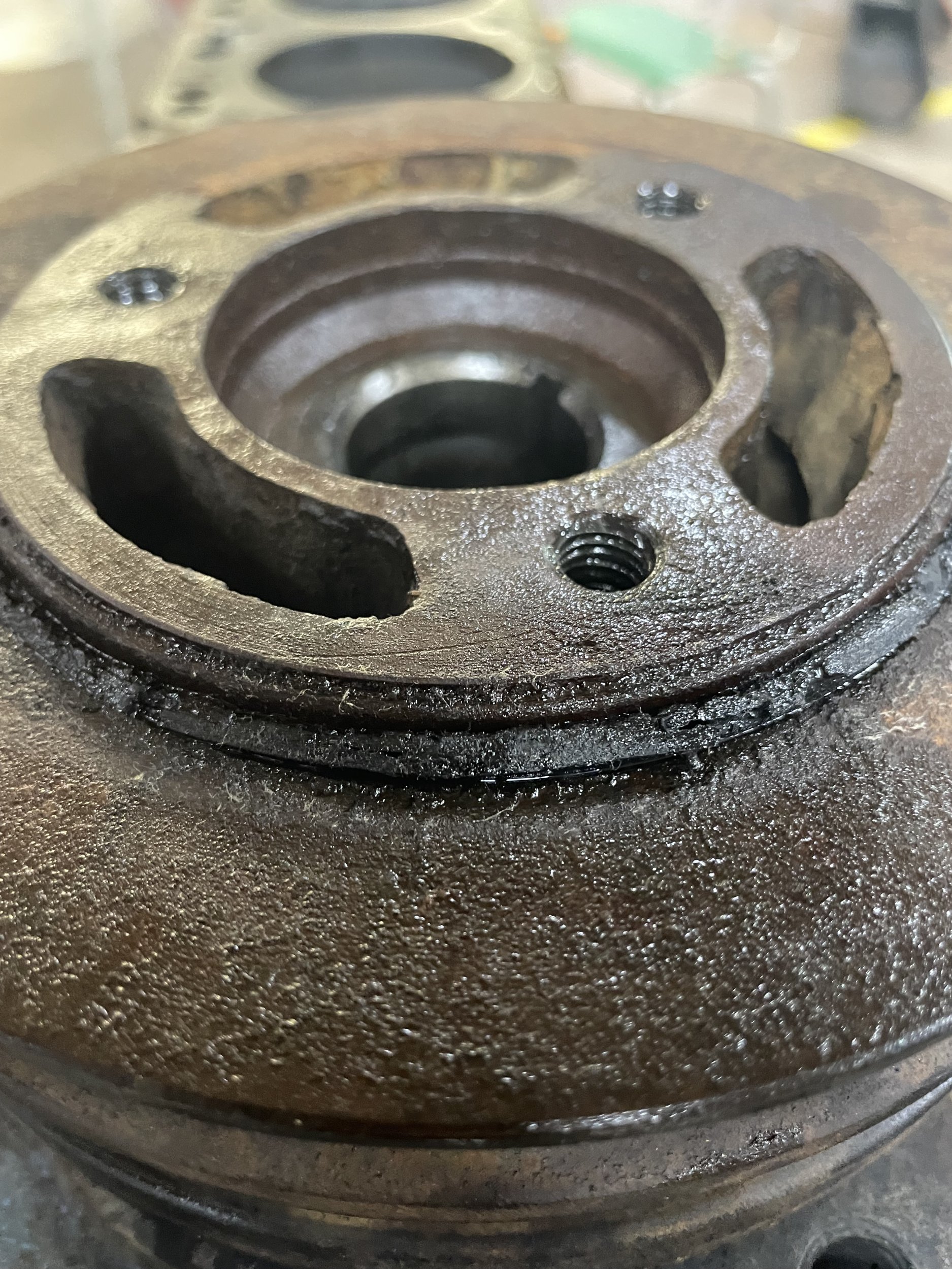

  4. I’m going with this as the issue

    What does the crank thrust look like?

  7. Looks like a normal bearing.
  8. saltflats
    Joined: Aug 14, 2007
    Posts: 14,131
    saltflats
    from Missouri
    My luck was always the crank took all the wear.
  9. lumpy 63
    Joined: Aug 2, 2010
    Posts: 3,608
    lumpy 63
    I took apart a 400 sbc recently , the bearing looked pretty good...crank thrust surface not so mucho_O

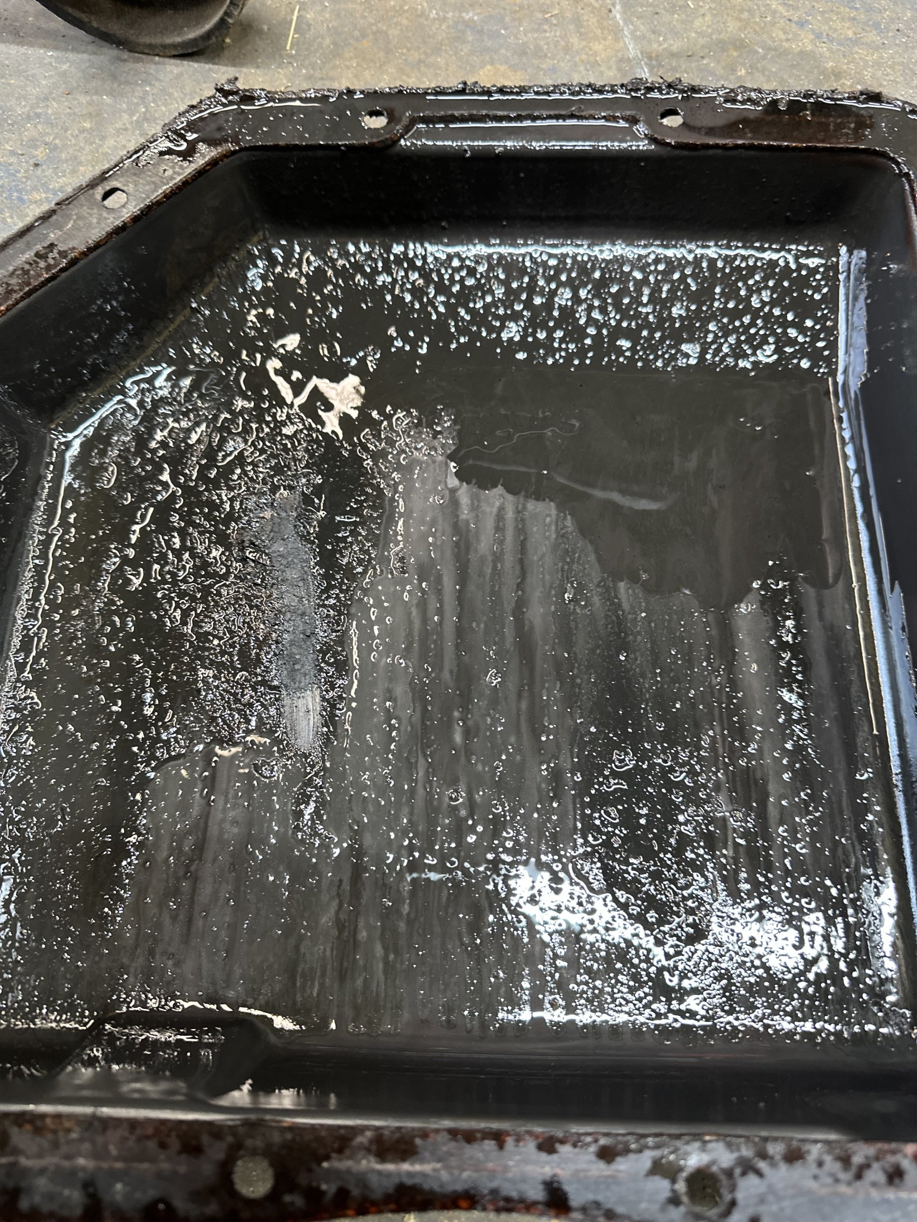

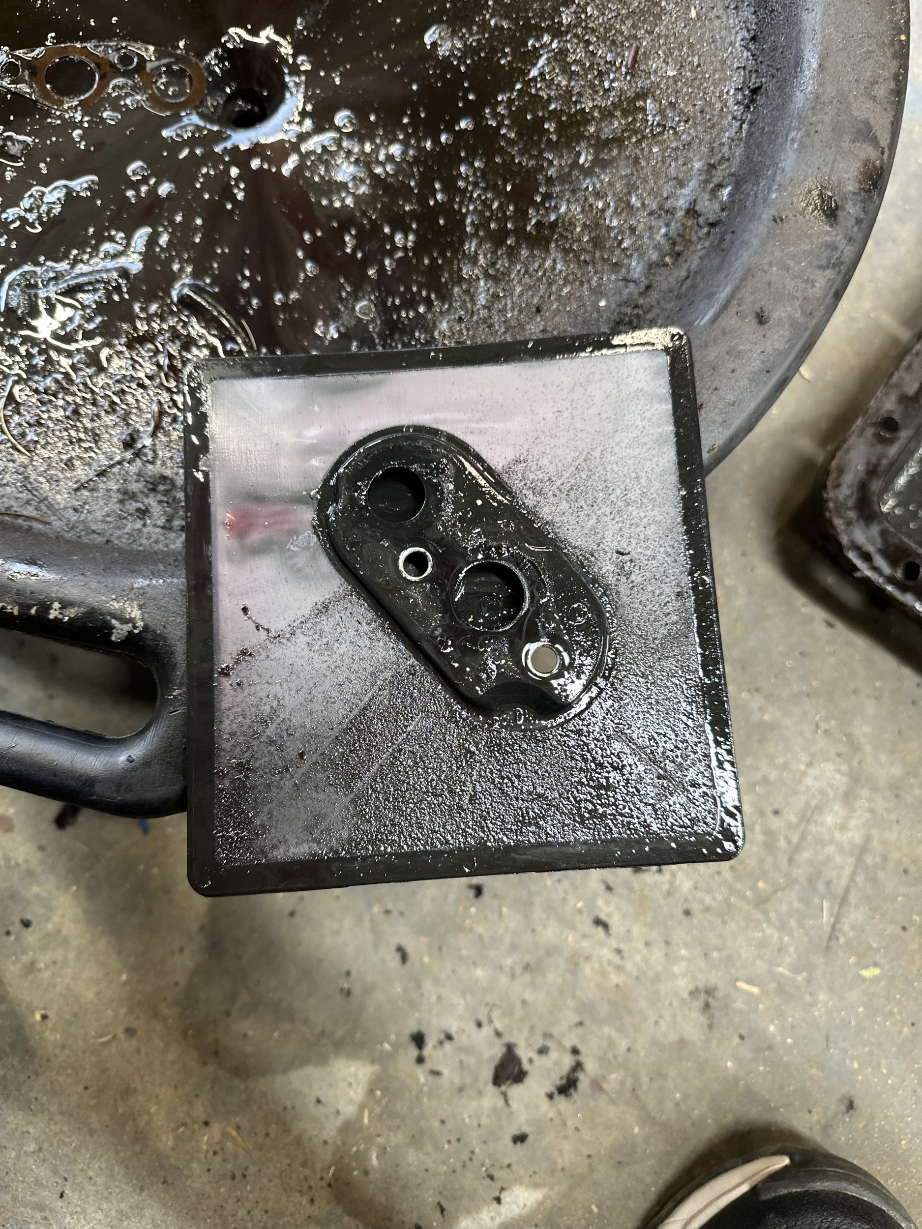

  15. IMG_8304.jpeg IMG_8305.jpeg I didn’t have much time yesterday to work on Papaw, but I drained the TH-350. My plan was to change the filter, front and rear seals, and run it. The fluid on the dipstick was nice and red, I can’t smell anything since Covid, so I couldn’t go by smell. I removed the pan and found most of the friction material from the clutches laying in the pan. ****. It’s been 30 years since I attempted to rebuild an automatic and then it was a **** shoot if I wound up with a transmission full of neutrals. The last bench job for a 350 around here was $7-800, that was for my nephew’s buddy’s Square Body. I guess I’ll start shopping for transmission kits. I think we have an account with Transtar at work. Automatic transmissions were the only subject in Tech School I struggled with, but that could have been because of the train wreck with the killer body I was dating at the time. :eek: There can’t be that much Black Magic inside a Turbo 350.

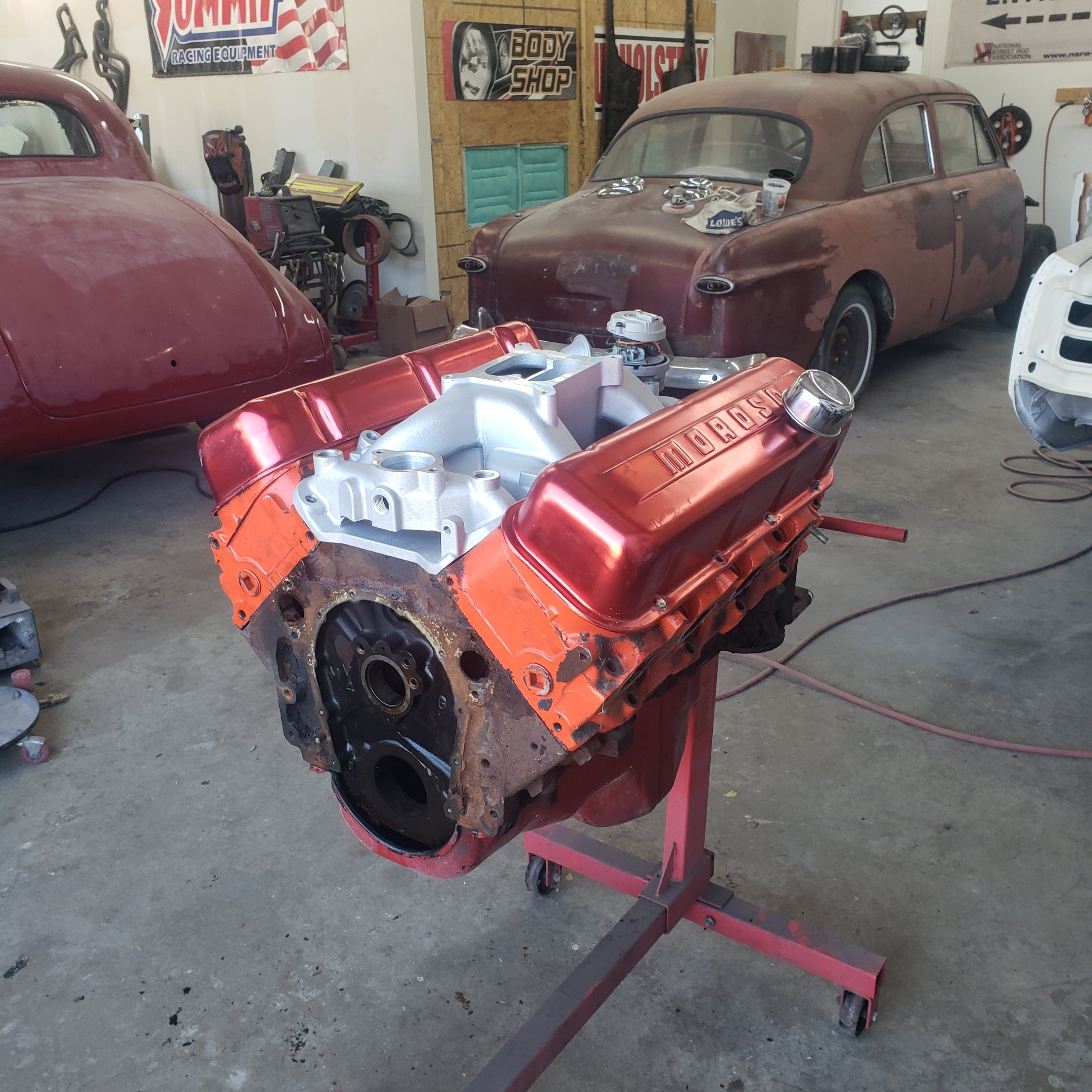

  19. Blah blah blah... stand back gentleman, I built a 454, it's the lightweight version, low compression, but none the less, I did good :D 20241011_115832.jpg 20241011_115843.jpg

  26. Your version probably weighs less than a Small Block!

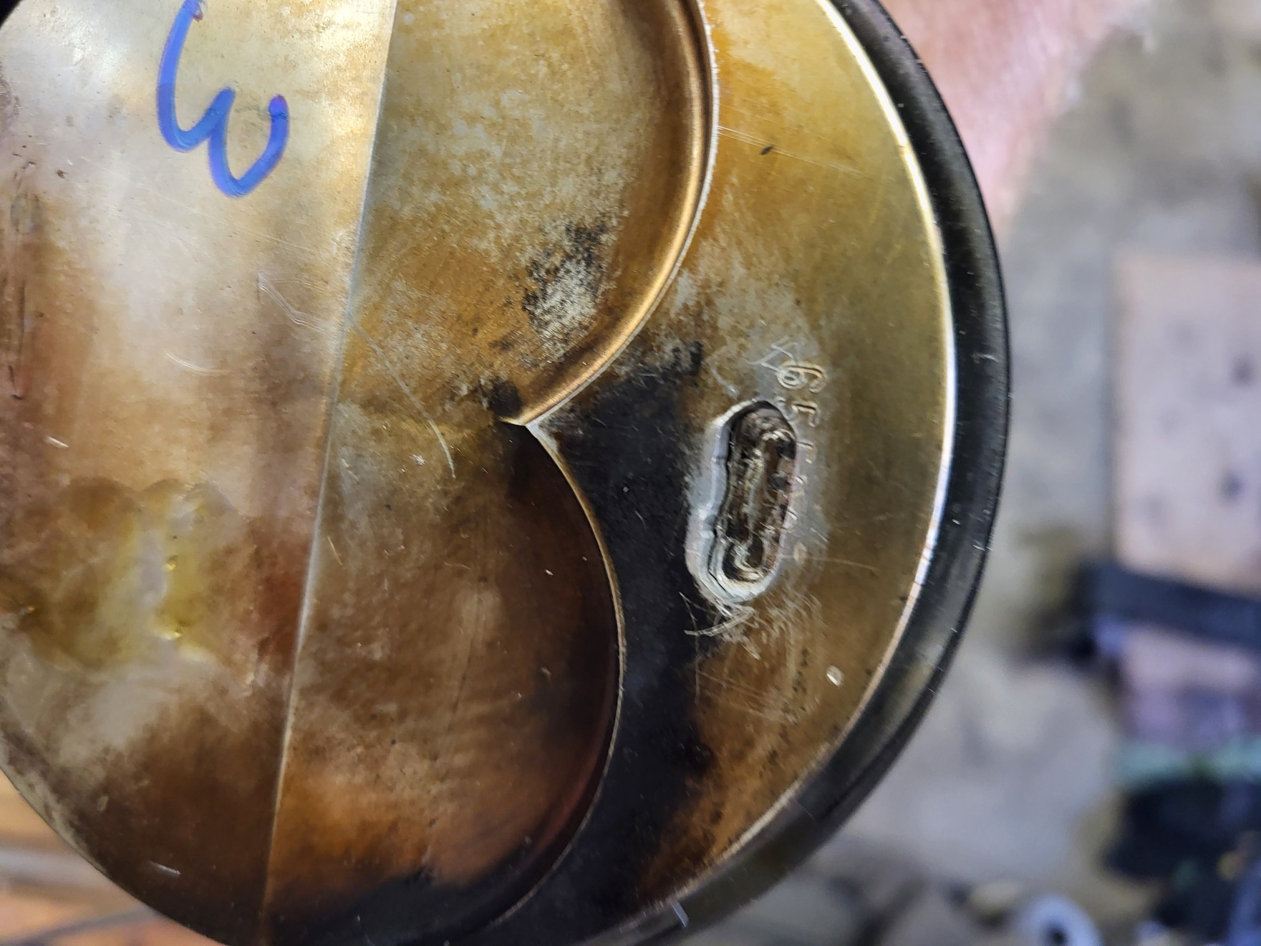

  29. lumpy 63
    Joined: Aug 2, 2010
    Posts: 3,608
    lumpy 63

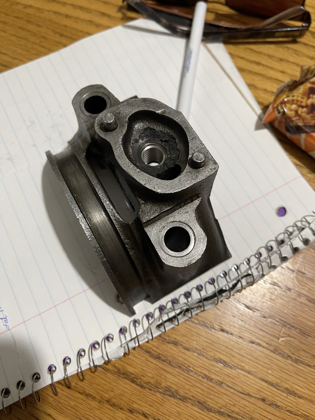

    20241011_114119.jpg 20241011_114112.jpg Let's play a game... it's called what did the Poncho eat? It's a very distinct imprint , I don't recall seeing anything similar, no thread marks or nut looking imprints.
  30. lumpy 63
    Joined: Aug 2, 2010
    Posts: 3,608
    lumpy 63
    Luckily it hit the piston in a weak spot...
