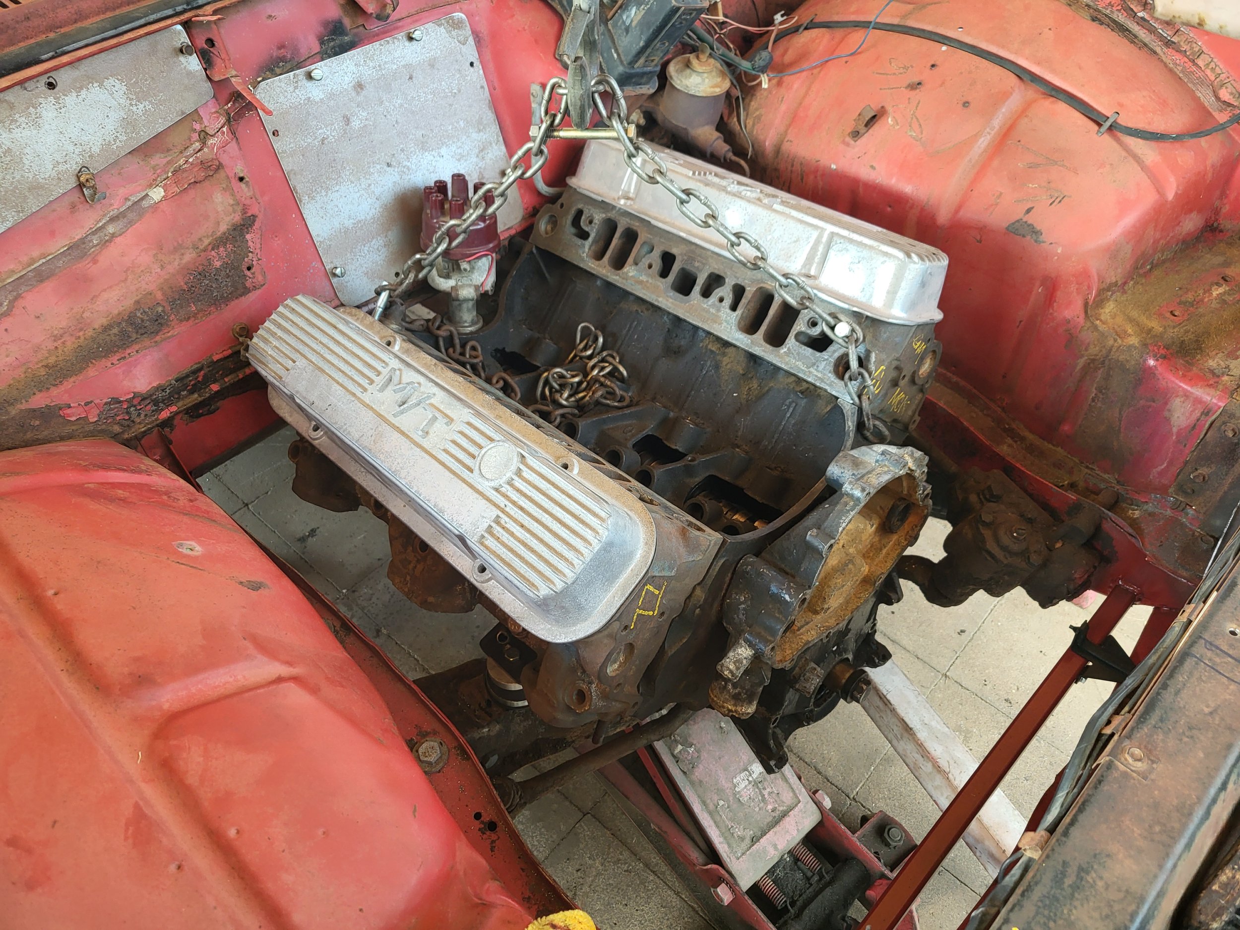

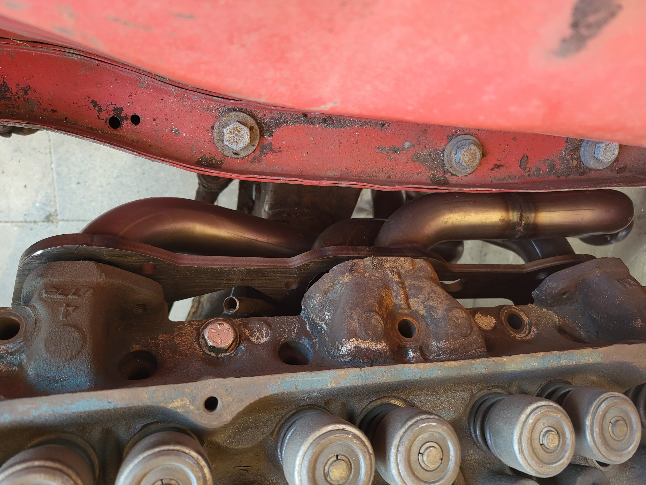

    20241017_164315.jpg 20241017_164357.jpg 20241017_172733.jpg test fitting mockup 400. A body headers are going to work:cool:

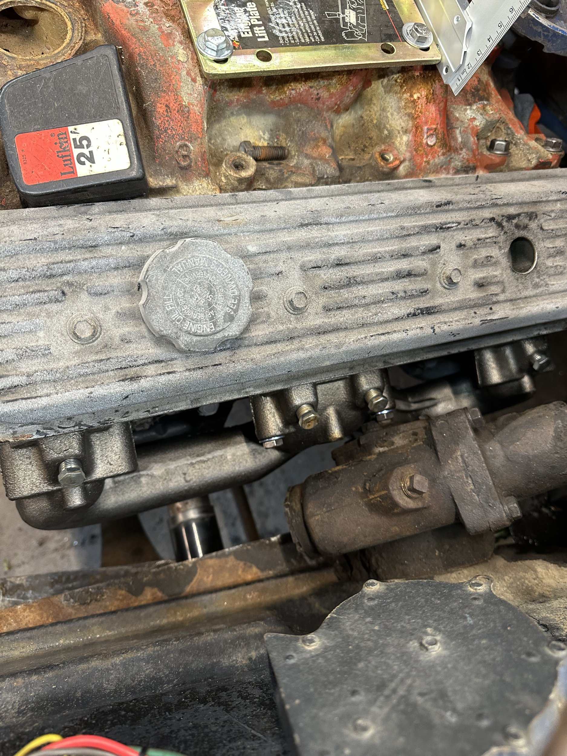

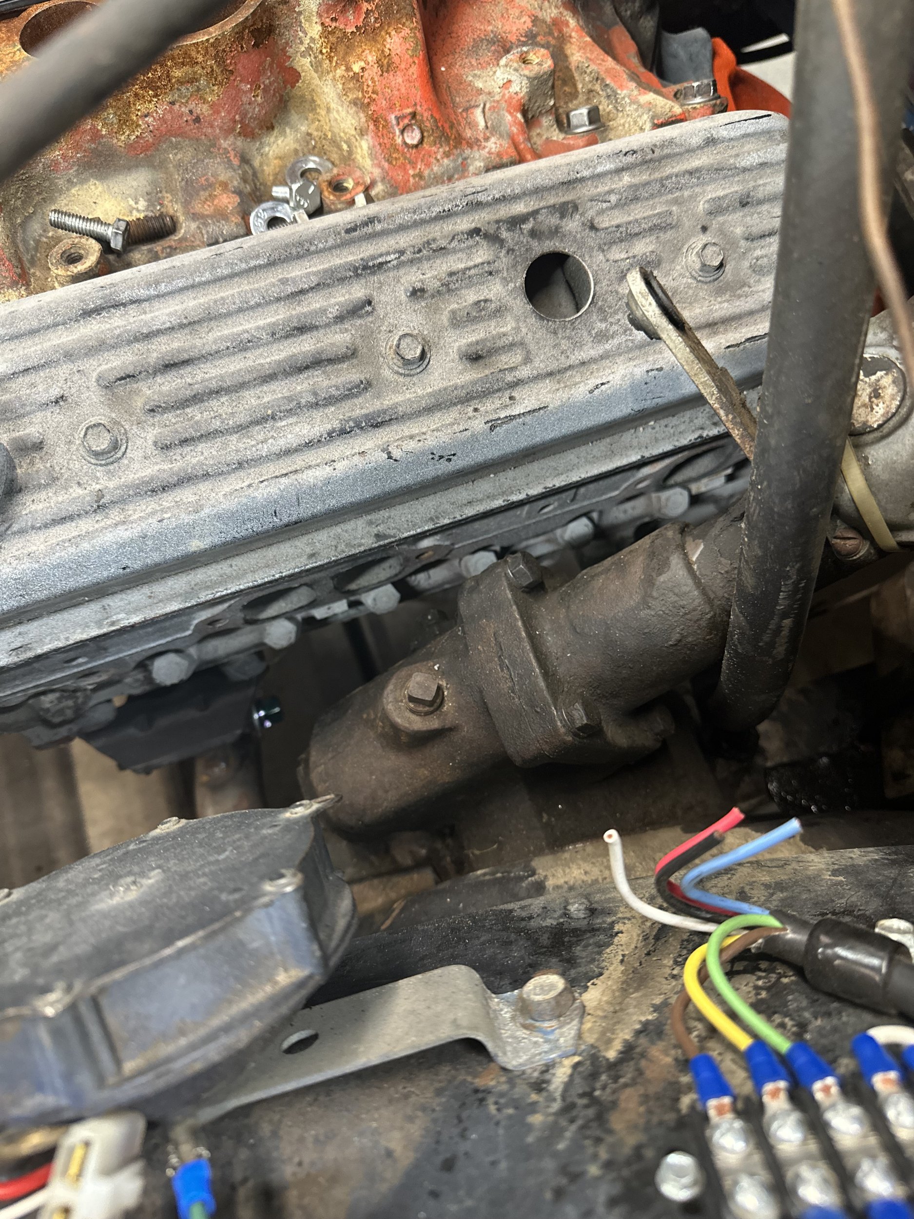

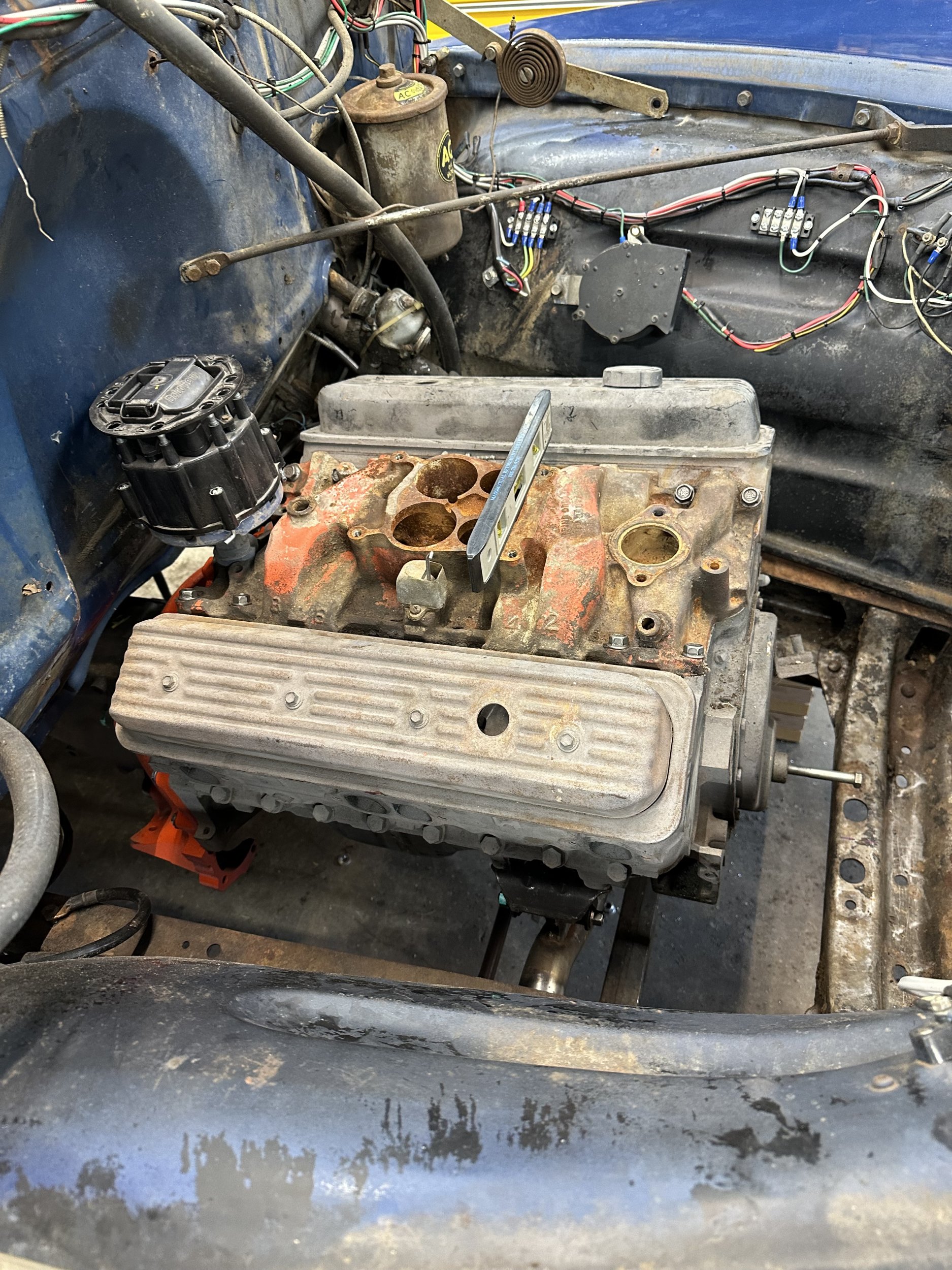

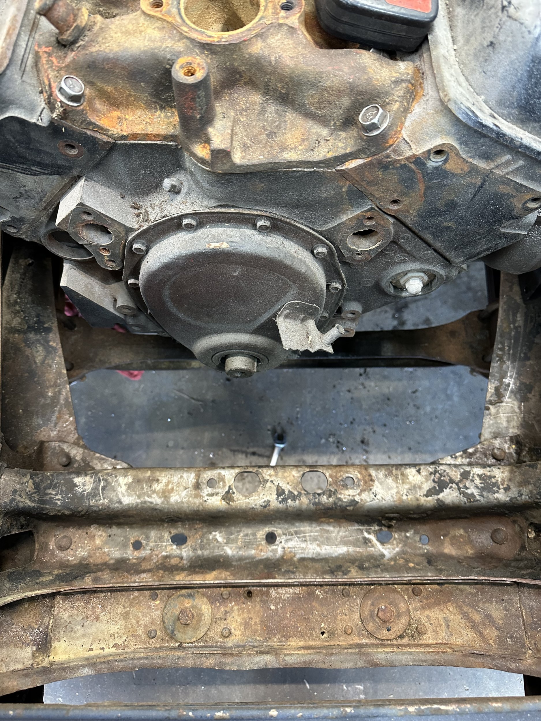

  2. Little Truckdoctor and I set the mock up engine in place last night. It’s no where close to where it needs to be, but we ran out of time. We will go back at it Saturday. IMG_8337.jpeg IMG_8340.jpeg IMG_8336.jpeg

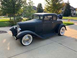

    Recently purchased this Henry 32. Has many little items needing my attention so I'll be working on it over the winter and hopefully drive it some this coming spring 2025. A**** the chores is new fuel line, new partial brake lines and adding residual valves, changing trans cooler lines, valve covers, air intake, dented oil pan and new shocks and coil overs and possibly a new wiring harness. I know once I start it will multiple!

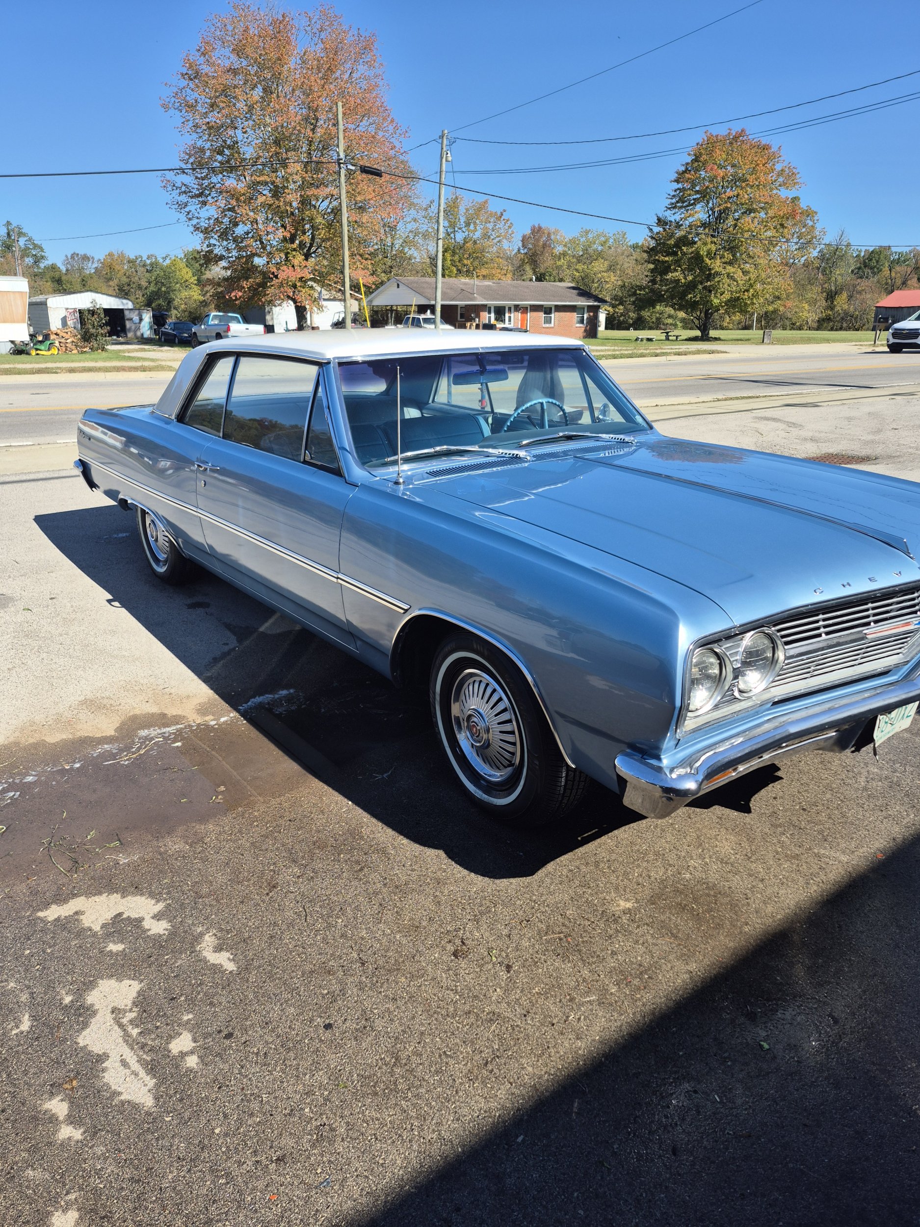

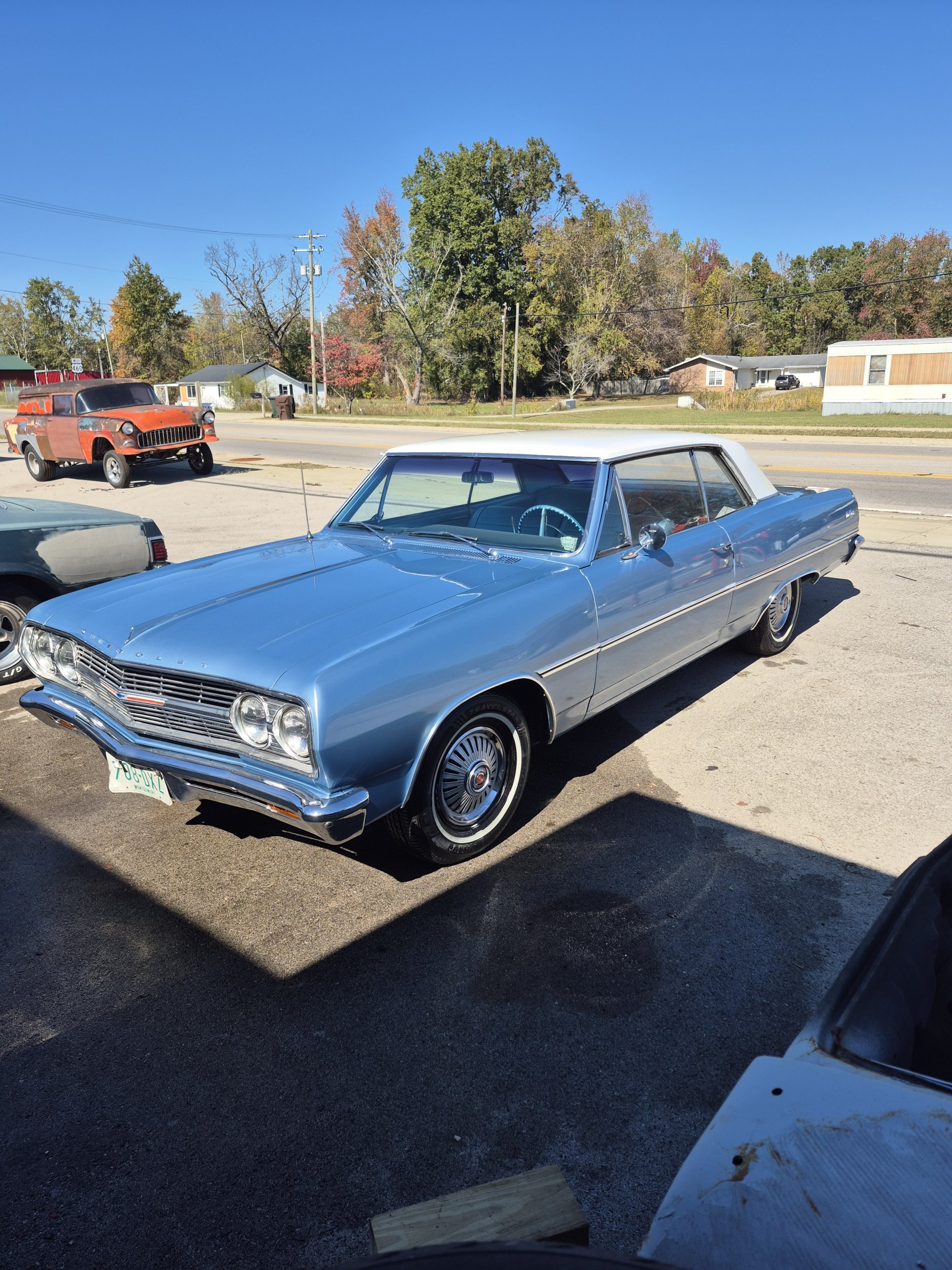

  5. Cleaned up and going home :cool: 20241018_131431.jpg 20241018_131421.jpg

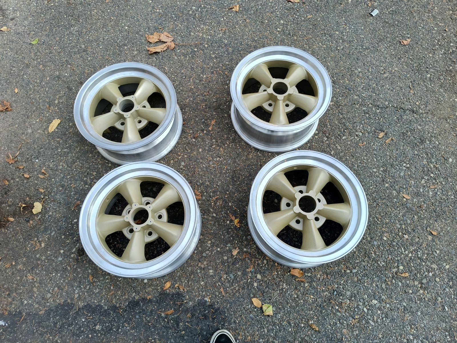

    just finished painting the center on these early D spokes for my 66 Nova Wagon

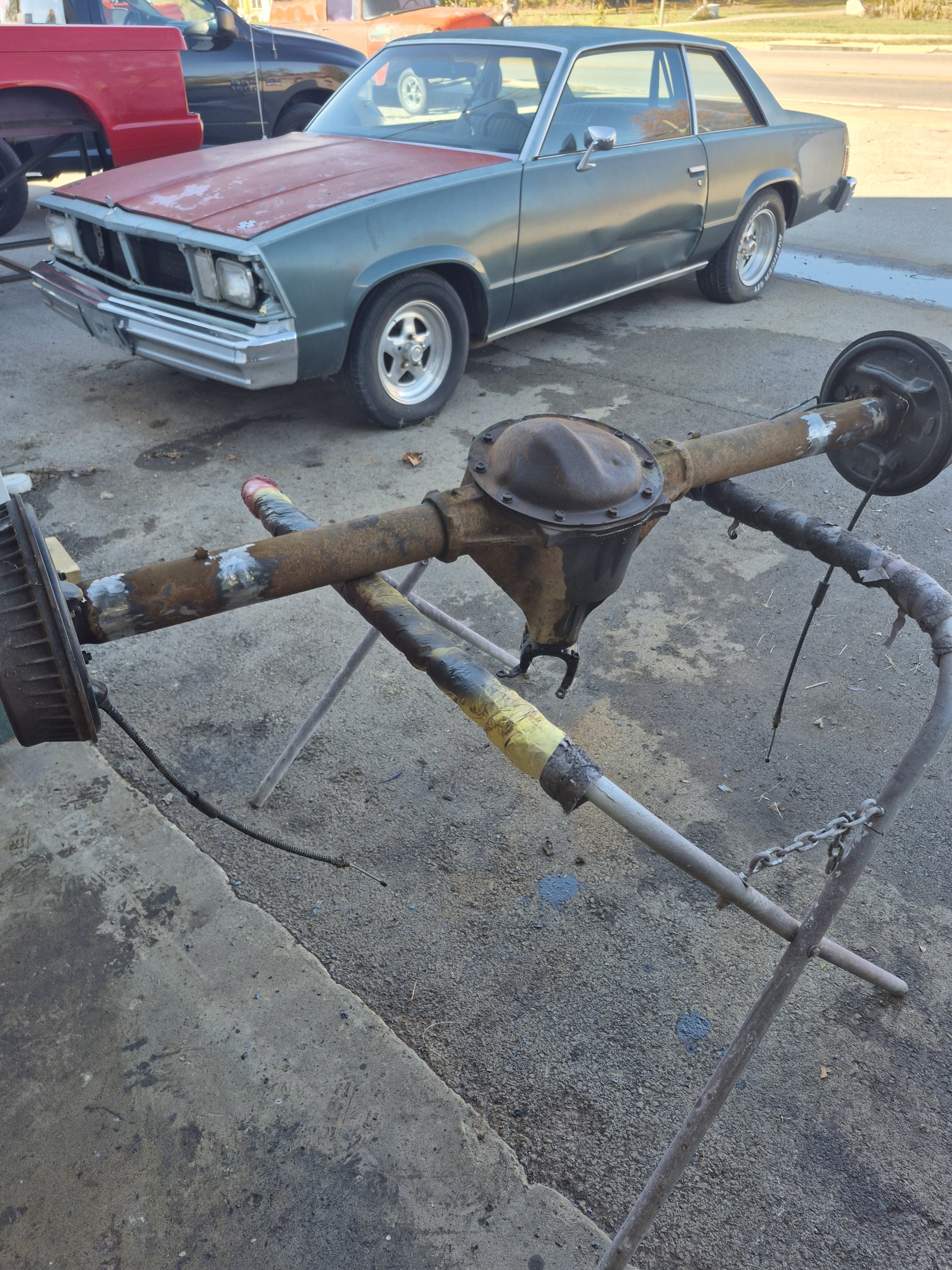

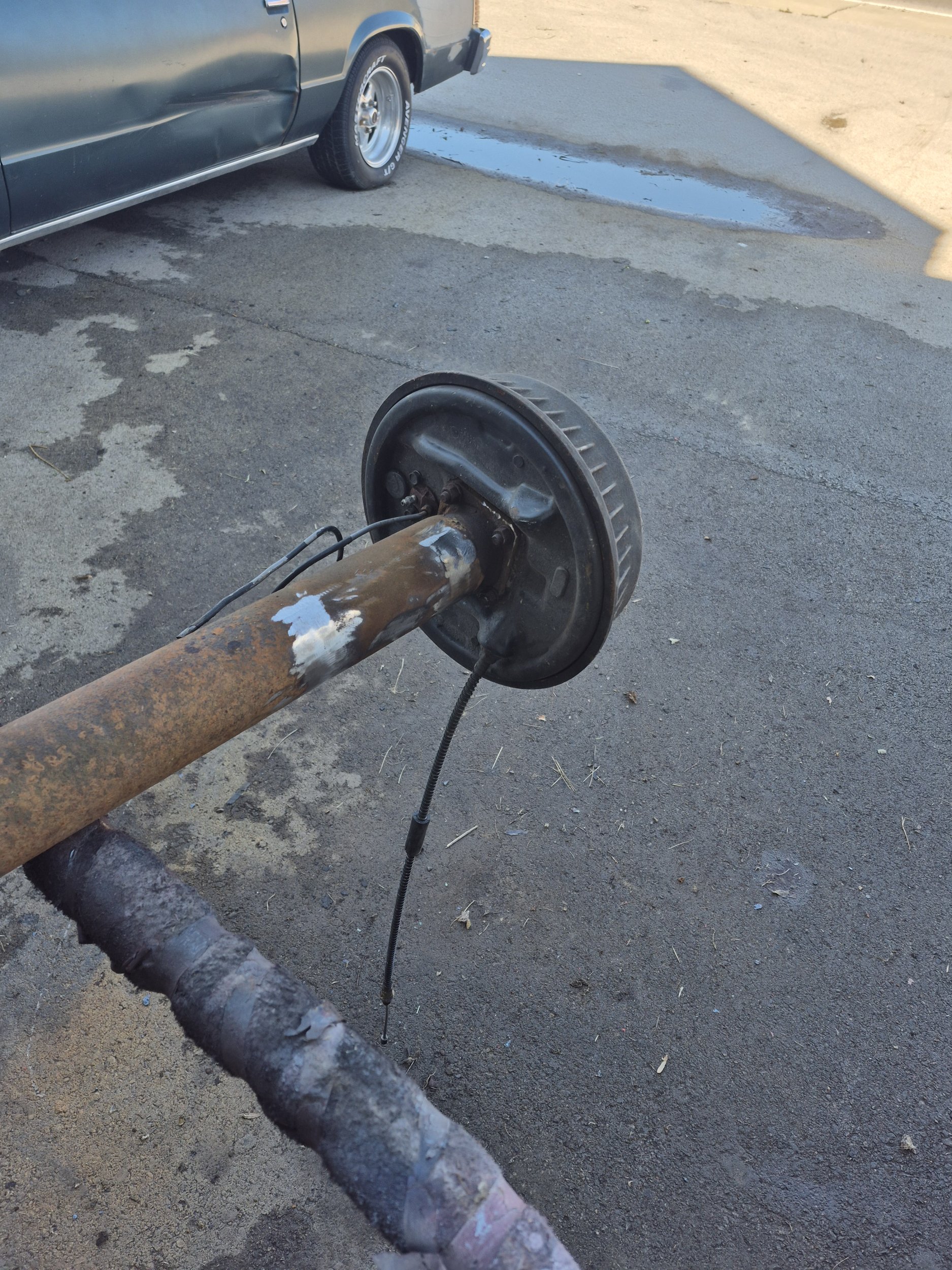

  7. Cut the leaf spring brackets off of my rear axle, pulled the axles and changed the brakes, I had a new set of loaded backing plates with new drums, had them for sale at the first Lloydfest for $75, glad nobody bought them :D 20241018_154346.jpg 20241018_154353.jpg 20241018_154356.jpg

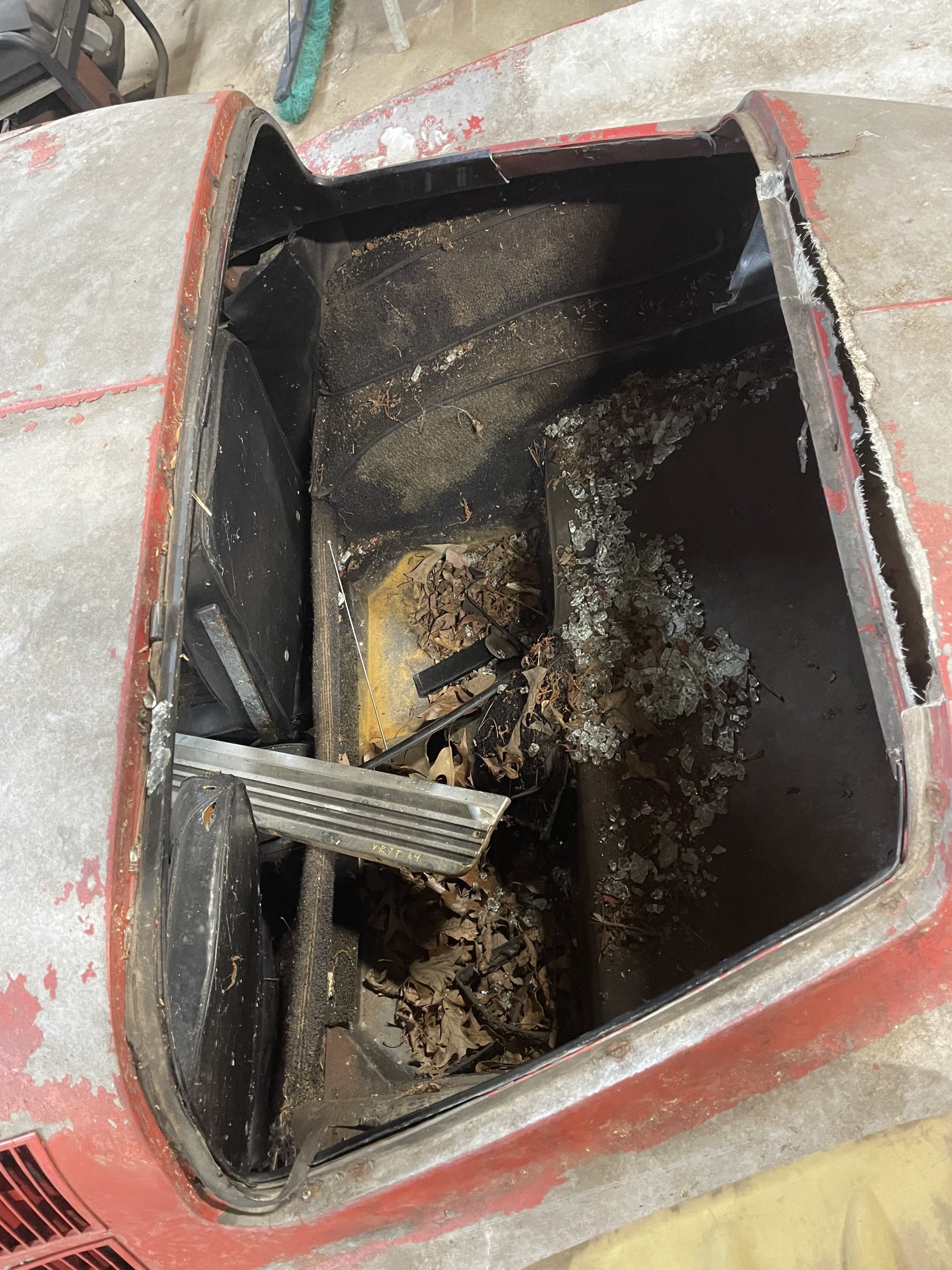

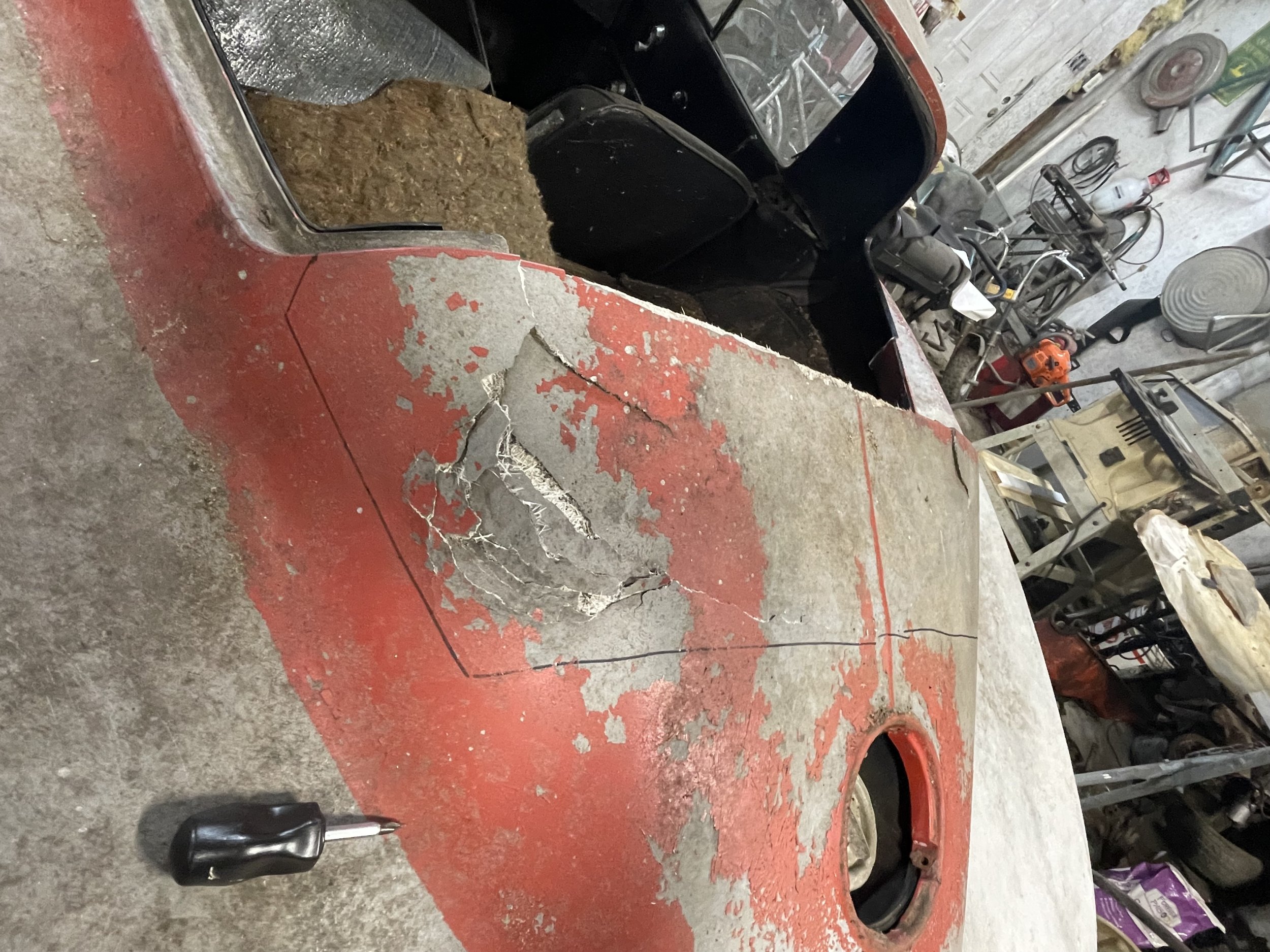

    What happened to the Vette Anthony?
    Sharpone and chryslerfan55 like this.

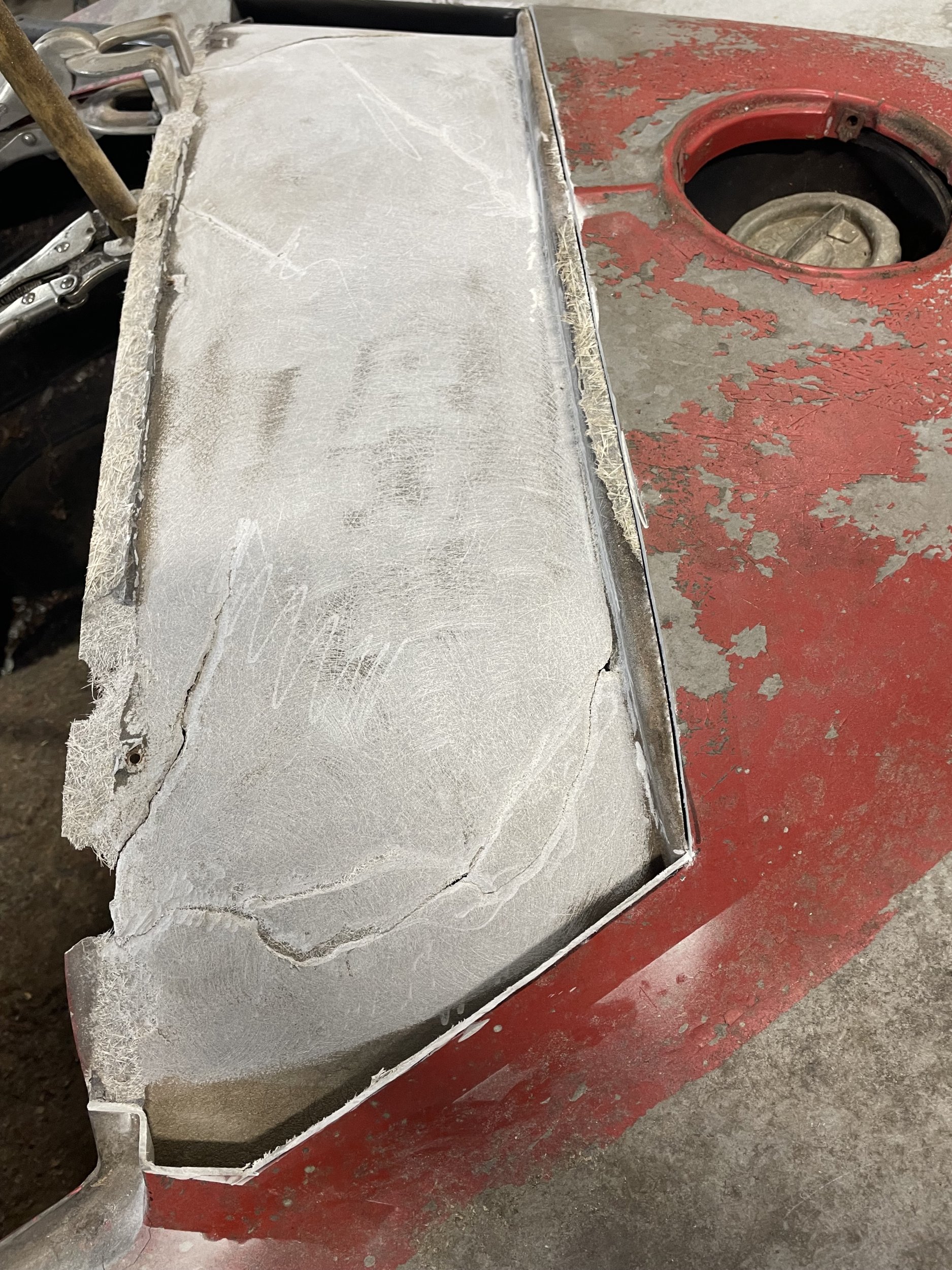

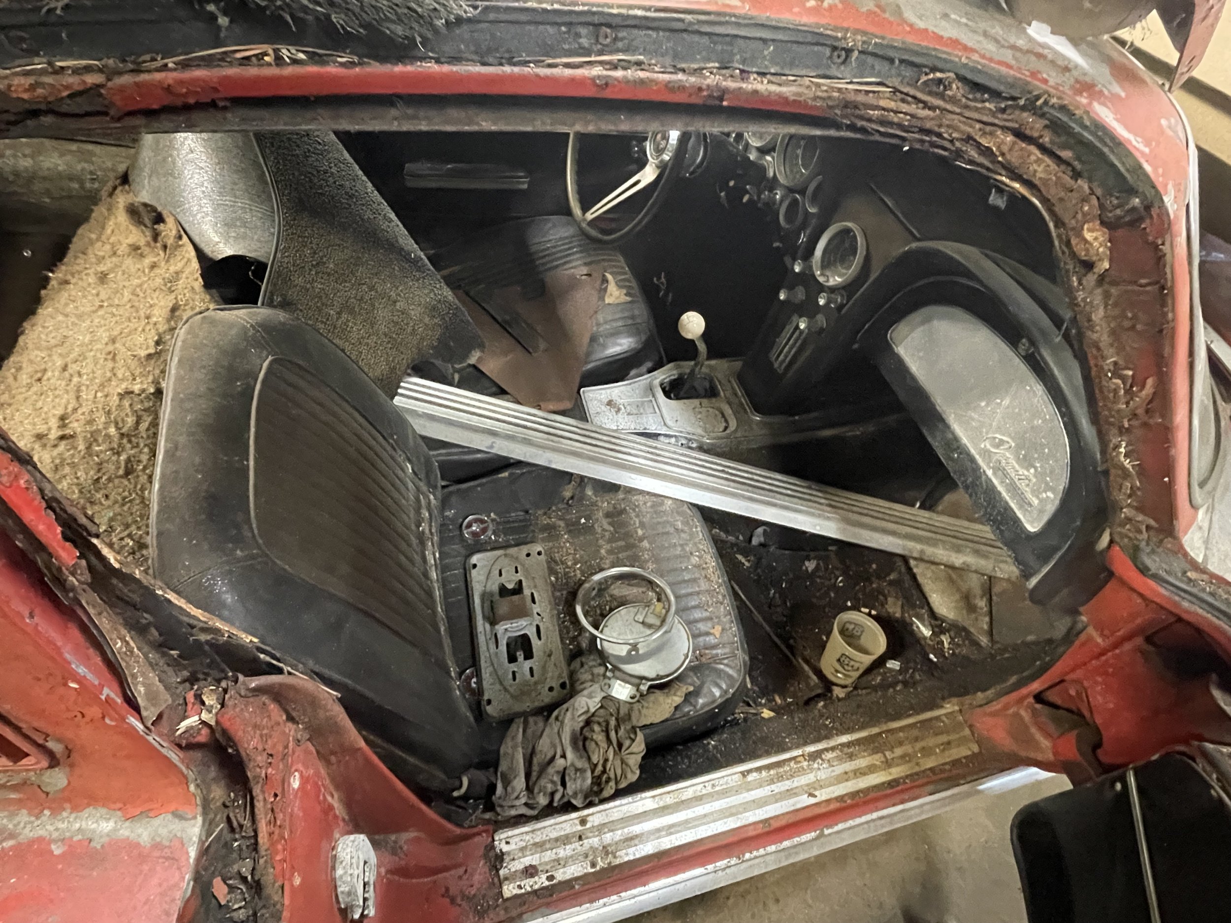

  17. Something fell on it.
    This one sat outside for a long time
    Rat and squirrel (not the HAMB one) poop
    The sun eat this one up. Most is raw gl***.
  18. guthriesmith
    Joined: Aug 17, 2006
    Posts: 12,673
    guthriesmith
    That vette has definitely had a hard life. I grew up riding in the back of one of those.
  19. The guy just wants this fixed. Needs the upper bird cage replaced.
    He doesn’t want it painted either. Said the plan was to make it go and stop.
    Im ok with that but he better get the ch***is under control before it gets bad.

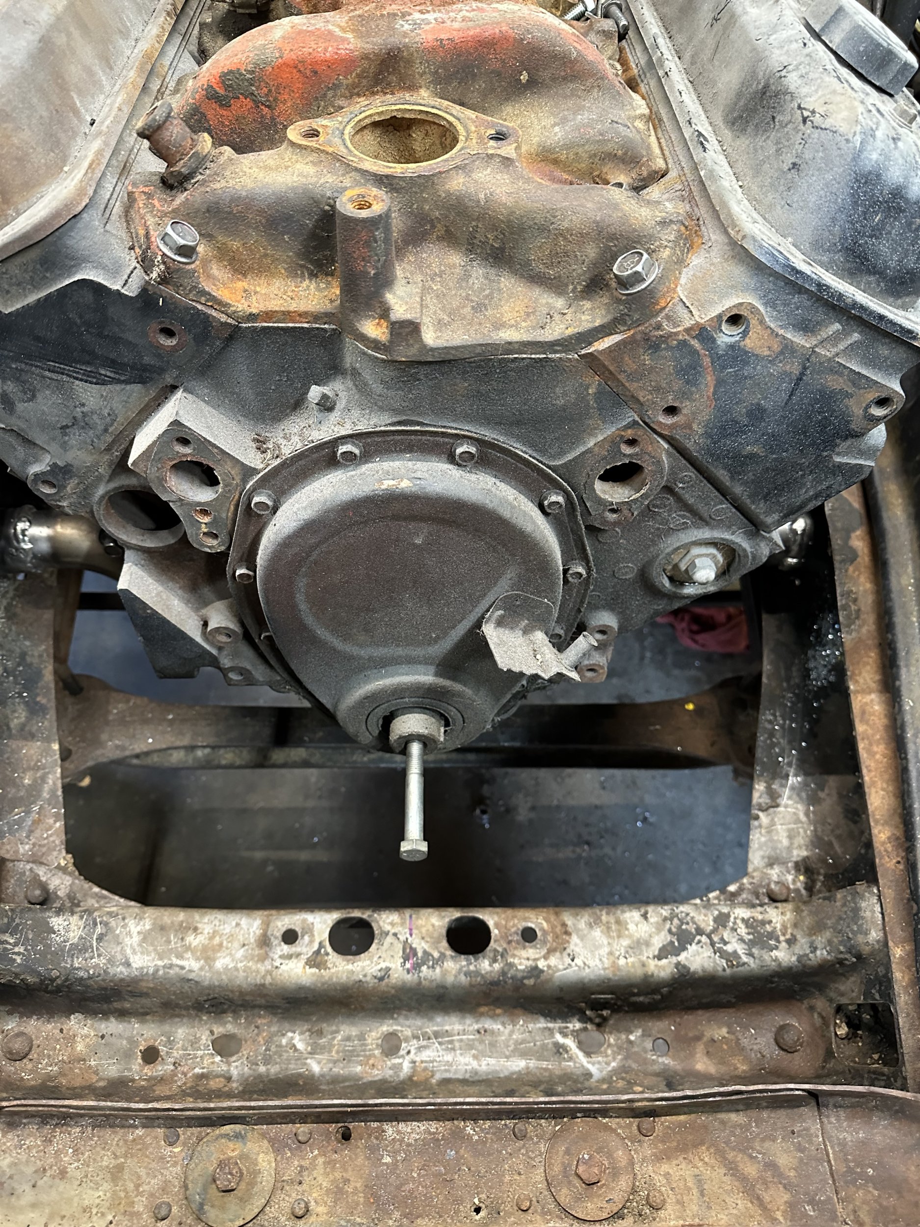

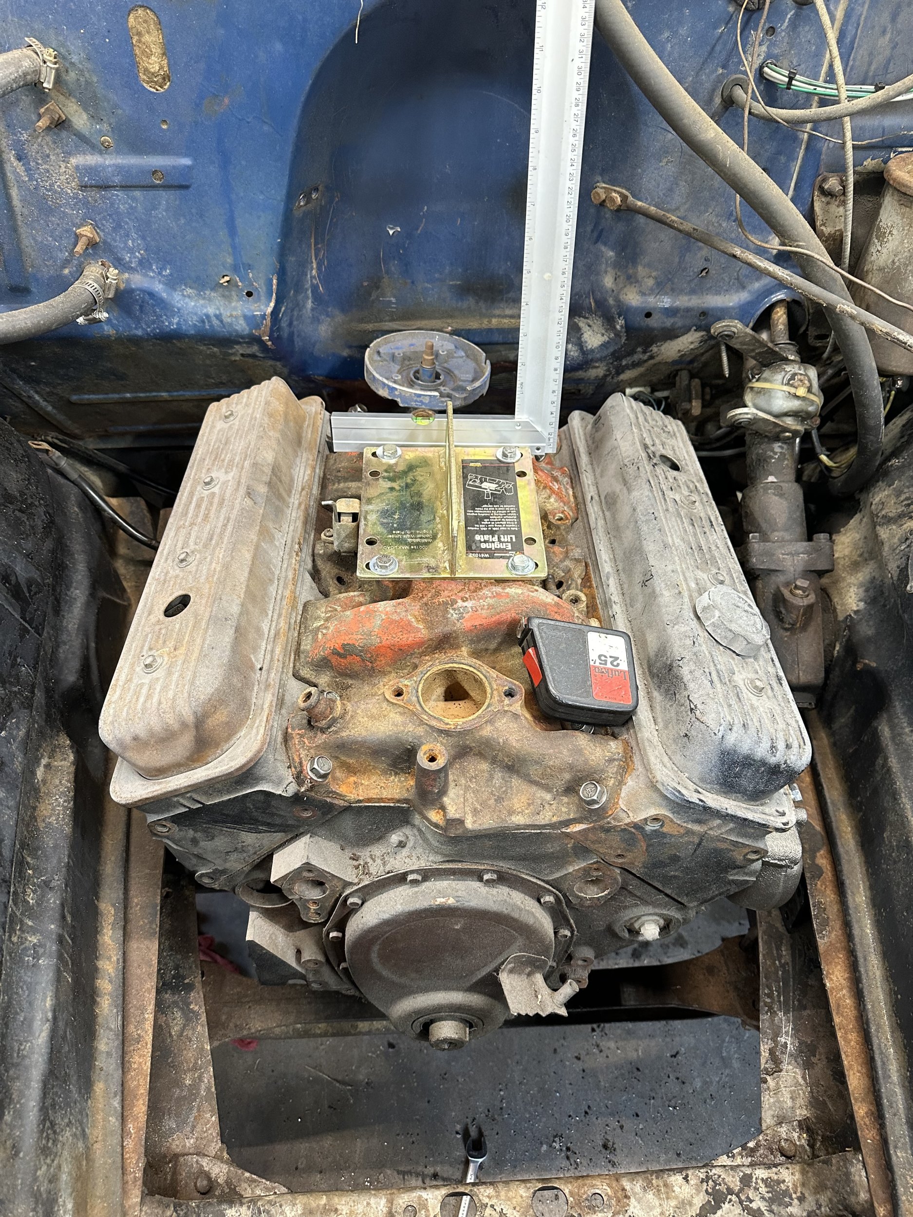

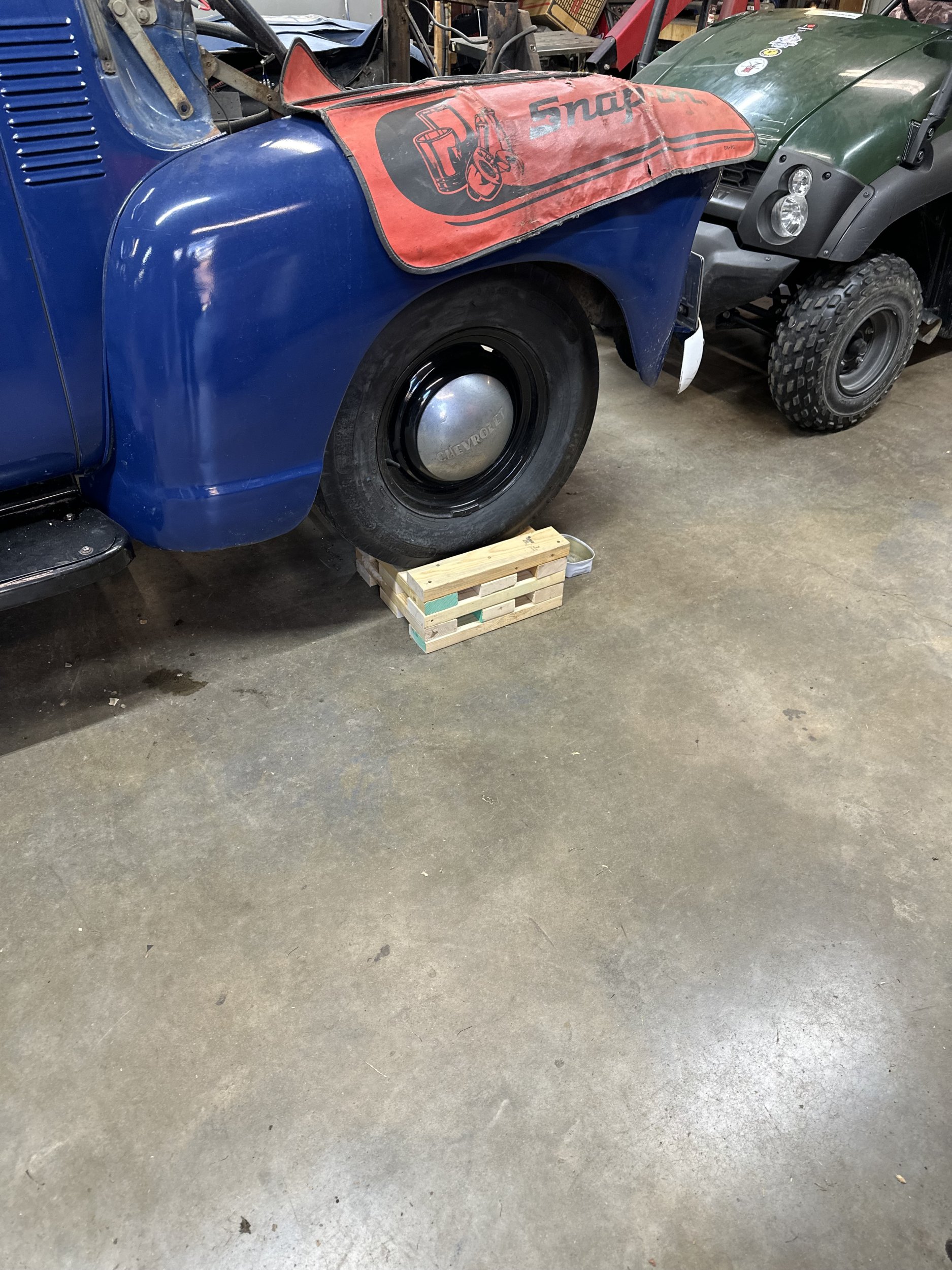

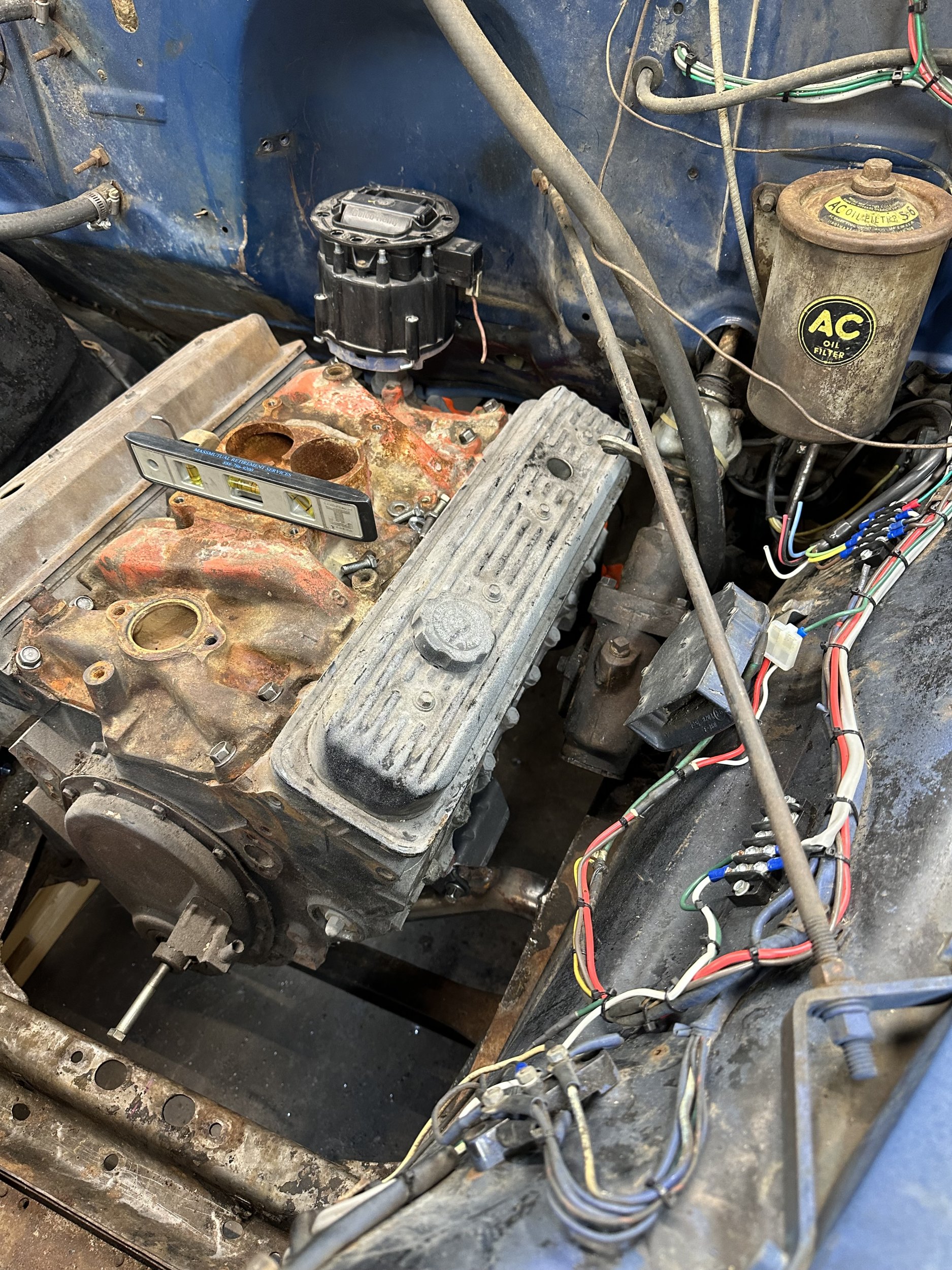

  24. IMG_8362.jpeg IMG_8348.jpeg IMG_8347.jpeg IMG_8346.jpeg IMG_8359.jpeg Little Truckdoctor and I got the engine installed and mount made. We ran out of time for the transmission crossmember, it’s currently C clamped to the frame with some wood blocks. We have an idea on what to do, just need some time. Maybe this afternoon when I get home from work. Little Truckdoctor also built us some wheel stands so I can get under Papaw and have him at ride height.

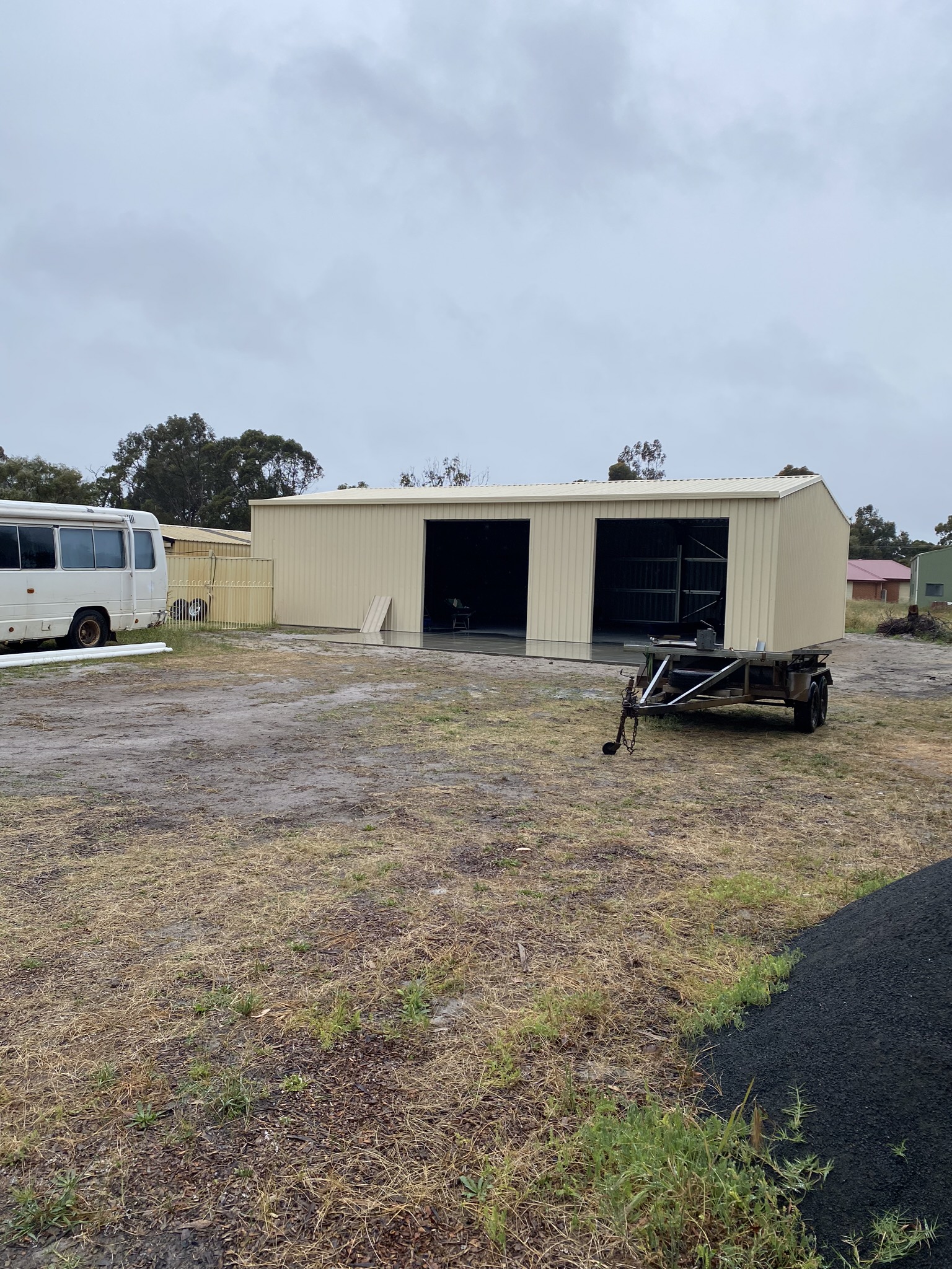

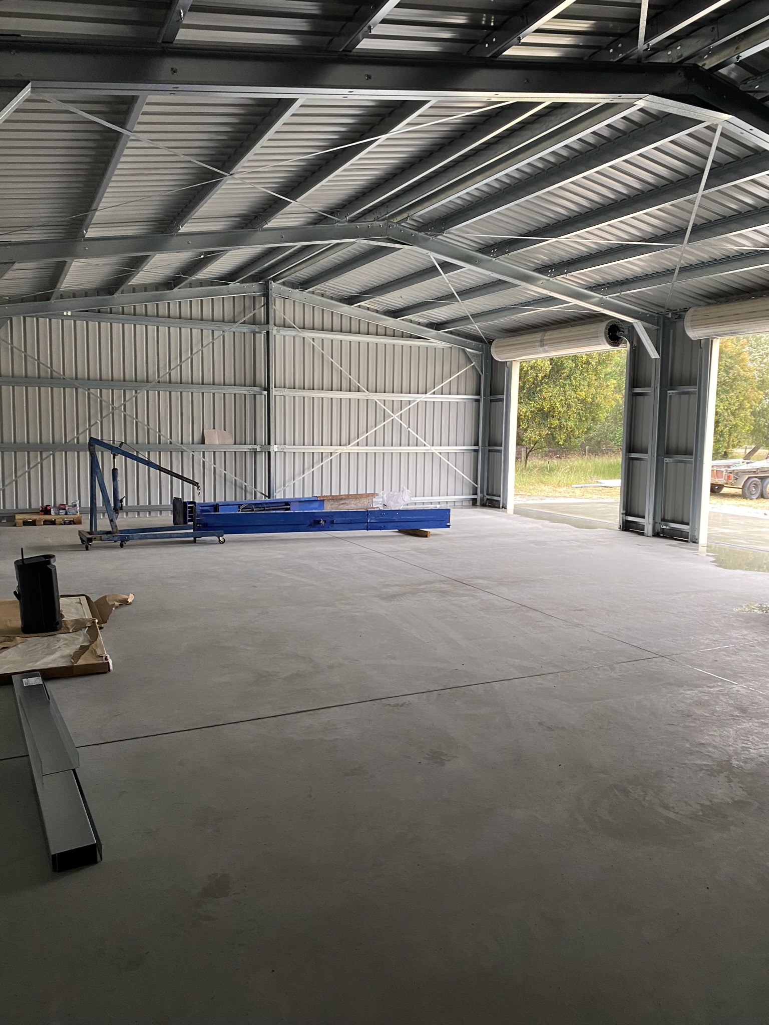

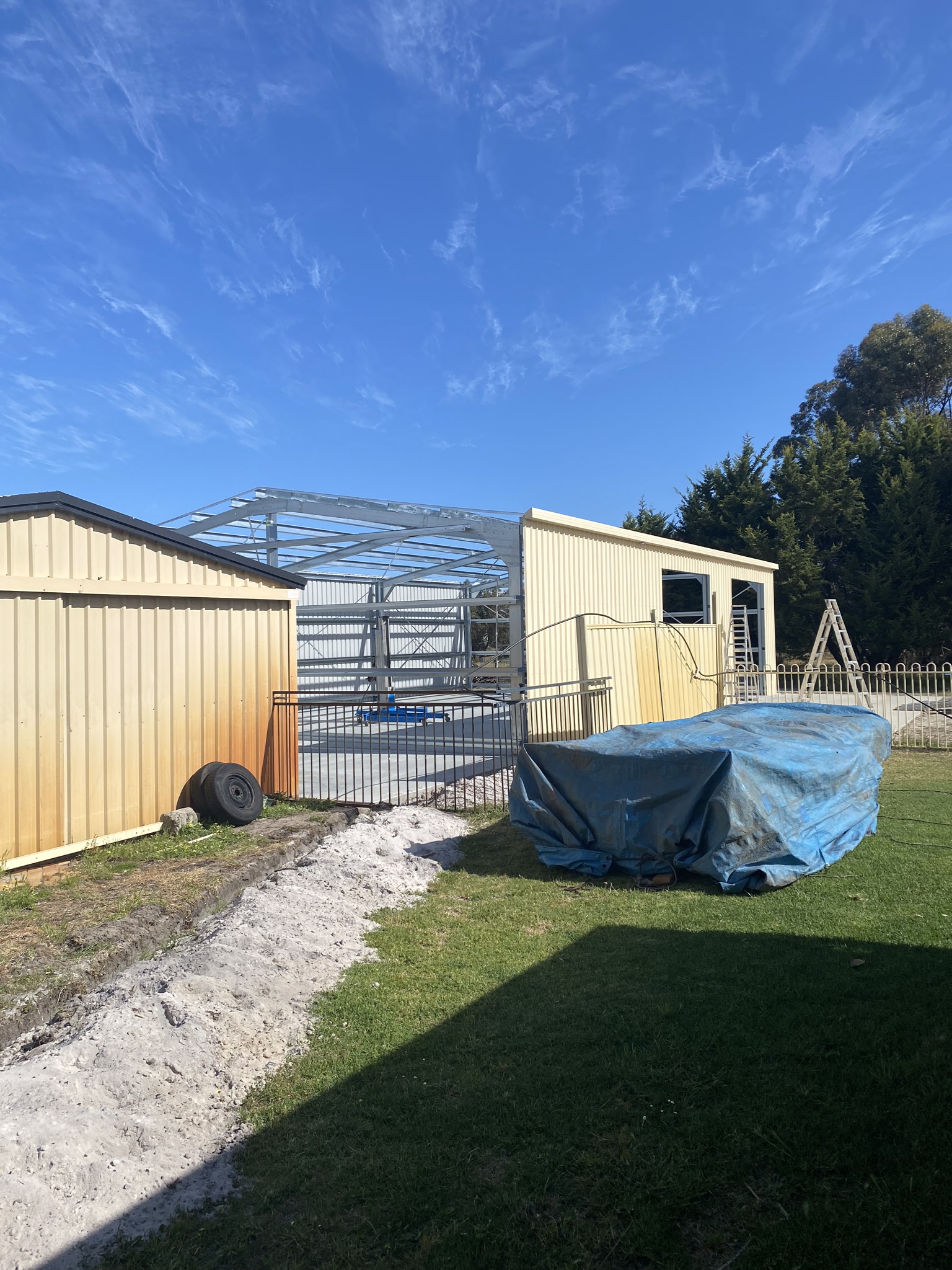

  25. My worlds been on hold for 2 years without a shed, or workshop while finding a new home. Last run at it so I finally have my dream cave,nearly. 787AC7D1-33D5-44F9-912D-C6F015A733EC.jpeg A8D874C4-48B7-4CC4-814A-E7B76FABFE13.jpeg 37BC038F-A645-457D-8F3C-DA42E1C7AAFC.jpeg

    Awesome Chris!

    Um....Andy, did you forget the exhaust manifold?:p

  29. Lumpy, when we first mocked it up, there was absolutely no way the manifold was going to clear the steering box. With the manifold on it, the engine was pushed approximately 1-1/2-2” to the right. I pulled the manifold off, centered and leveled the engine and will use either the POL or Speedway kit to use a Square Body C-10 power steering box on the outside of the frame. IMG_8340.jpeg IMG_8337.jpeg
