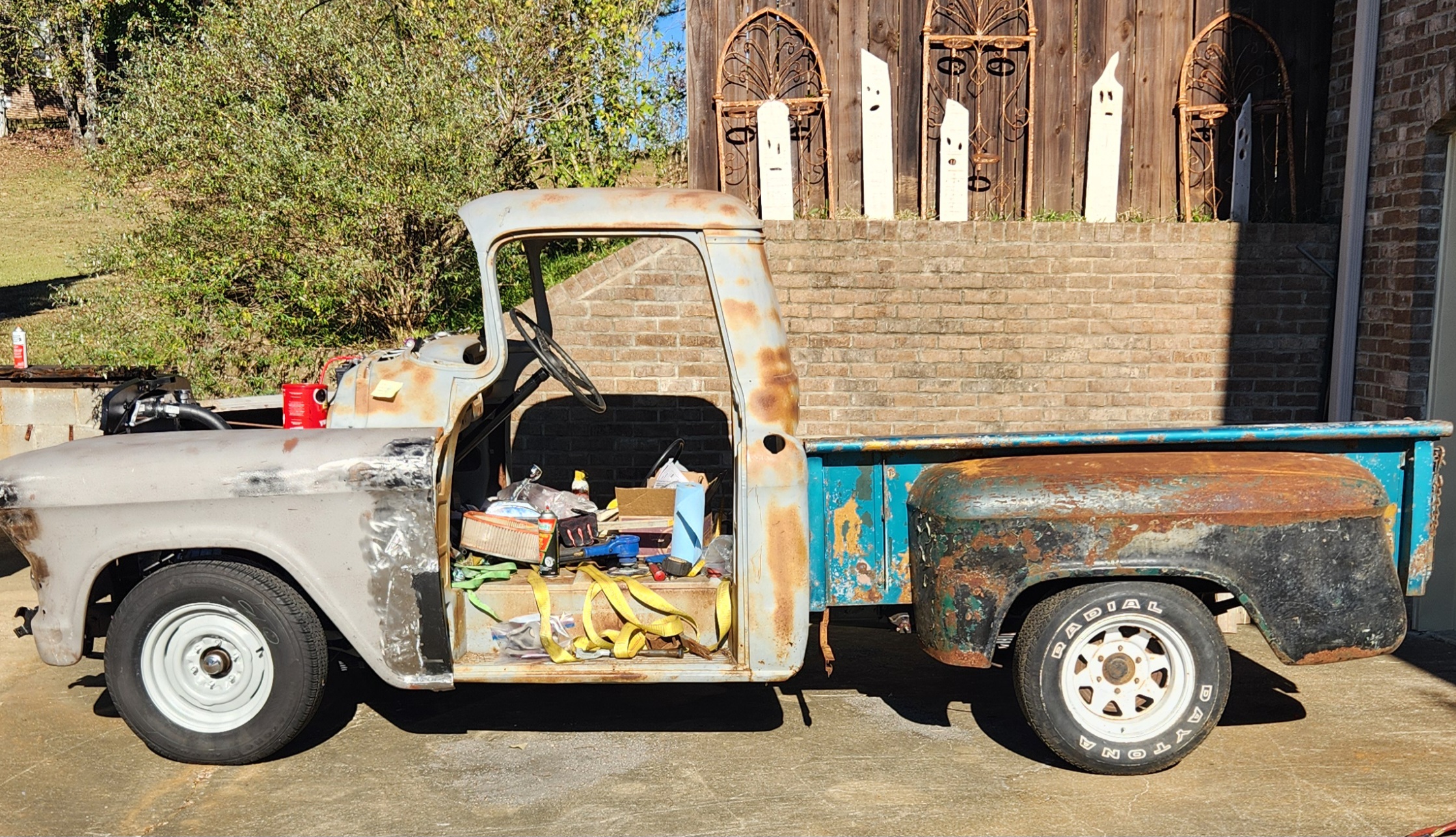

    Threw the bedside and fender on to check the stance. It has a 3" drop axle in front with new stock height springs and so far I've removed 2 leafs from each rear pack. I think the rear needs to come down 2 more inches.

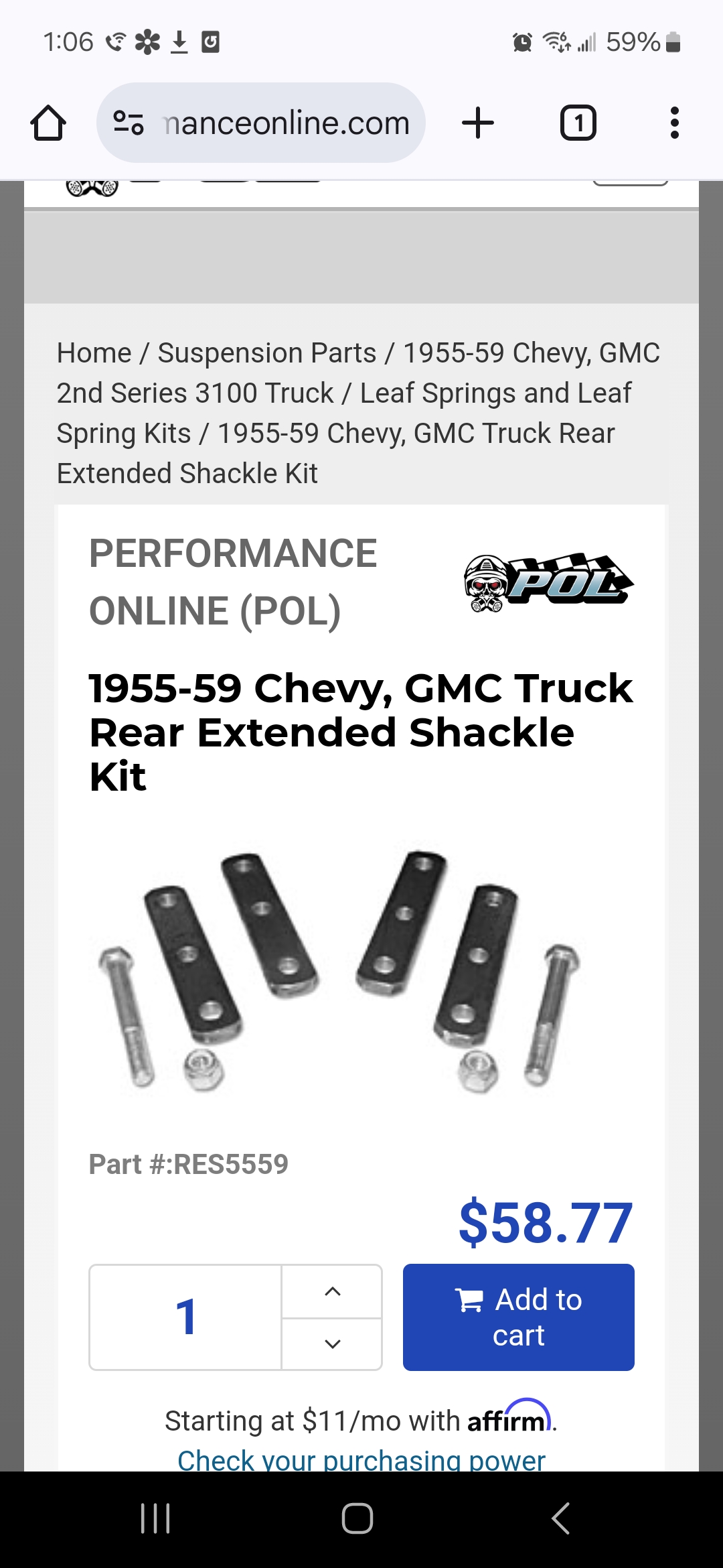

    Try extended shackles on the rear:cool:

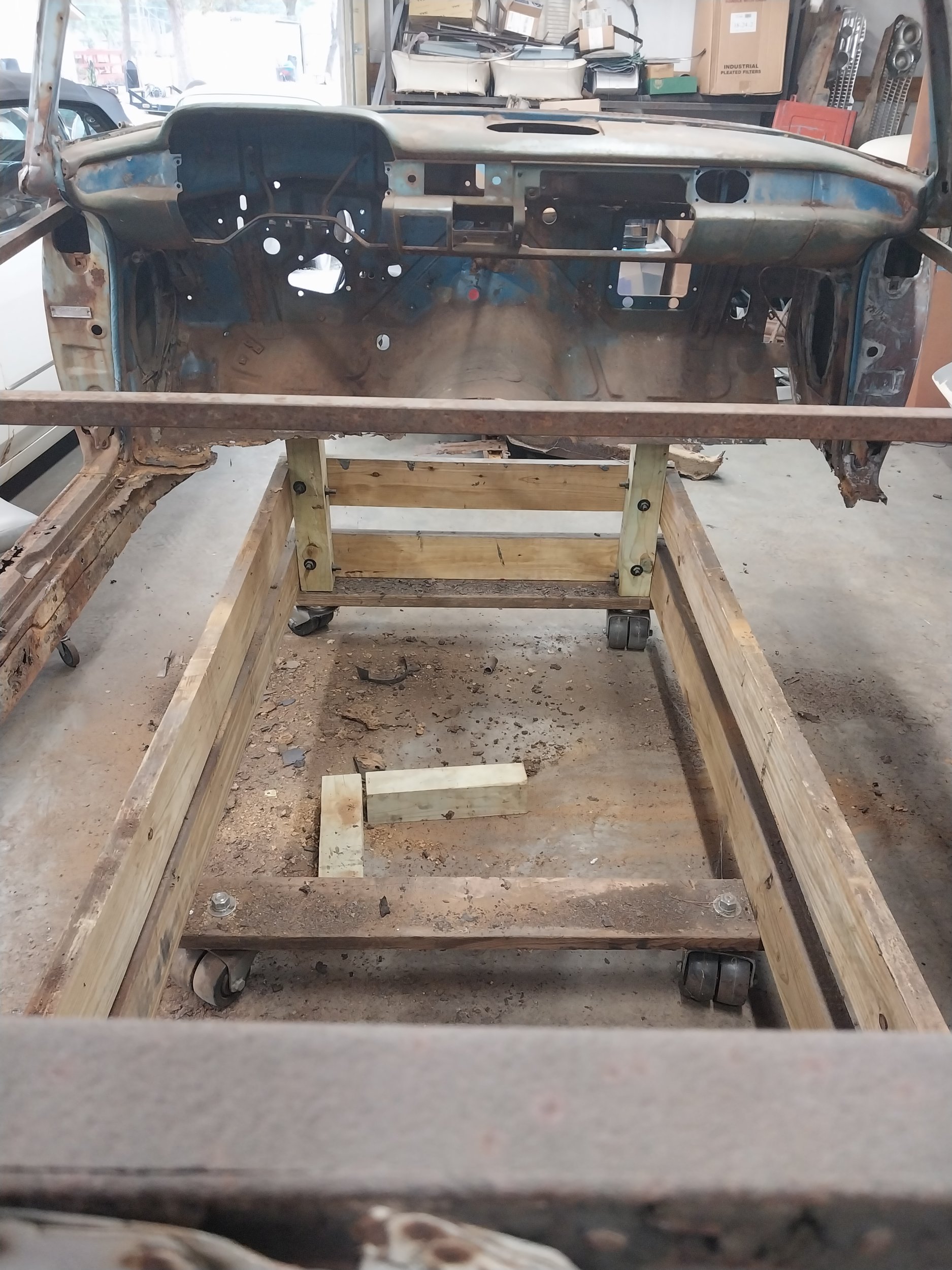

  7. wood buck made from the new gl***

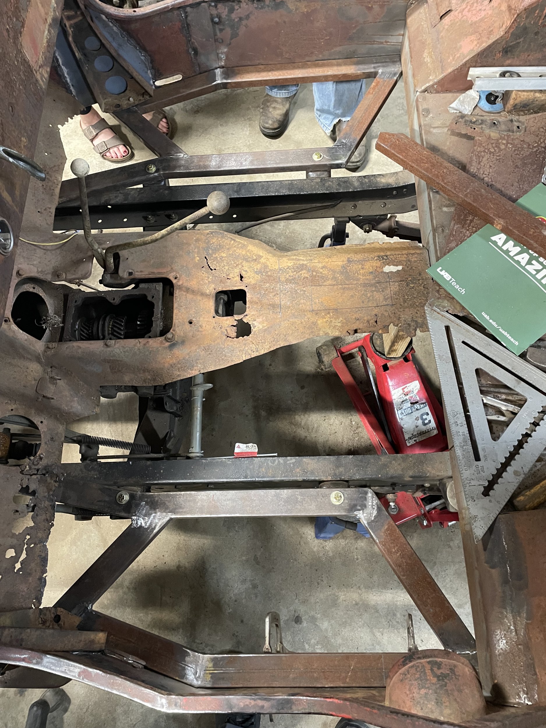

  8. Son built this structure for his jeep floor IMG_2537.jpeg One more brace to go

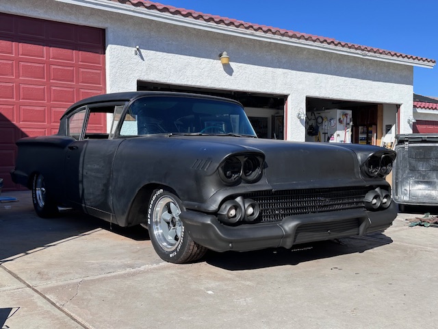

    3 weeks in on my street stripper, got the new winshield......sanded the bumpers , painted them to preserve them till I find a chrome shop.... looks like they are all gone...mexico???started cleaning under the hood....took a week off and went to utah... so all in it's 2 weeks IMG_3547[9100].jpg IMG_3558[9108].jpg IMG_3589[9116].jpg IMG_3733[9127].jpg IMG_3734[9128].jpg IMG_3547[9100].jpg IMG_3558[9108].jpg IMG_3589[9116].jpg IMG_3733[9127].jpg IMG_3734[9128].jpg IMG_3735[9129].jpg IMG_3736[9130].jpg IMG_3737[9131].jpg

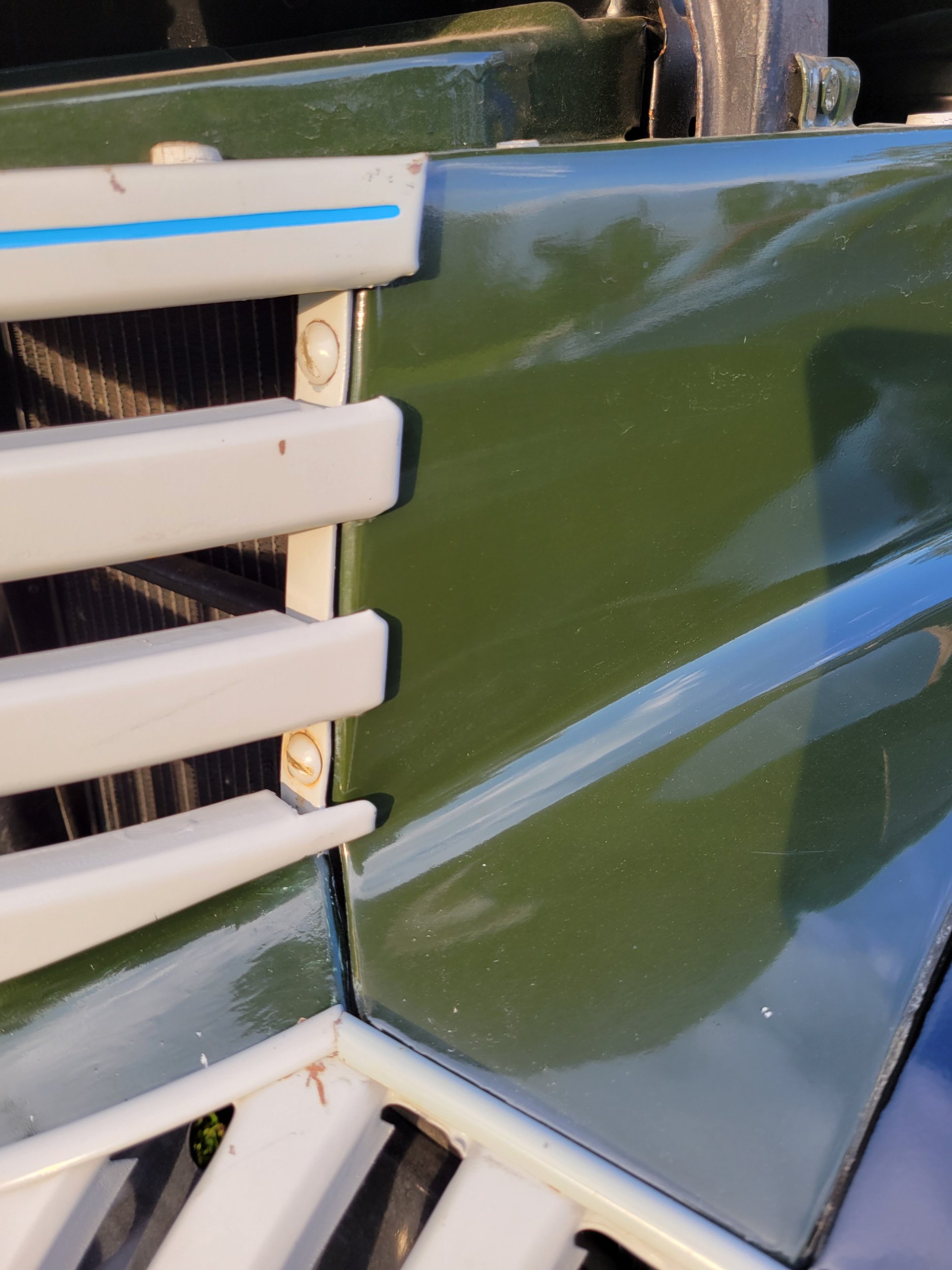

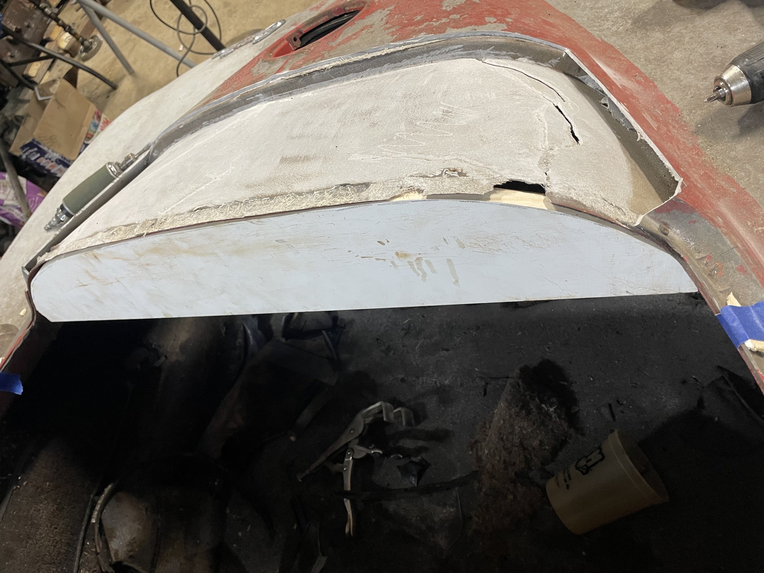

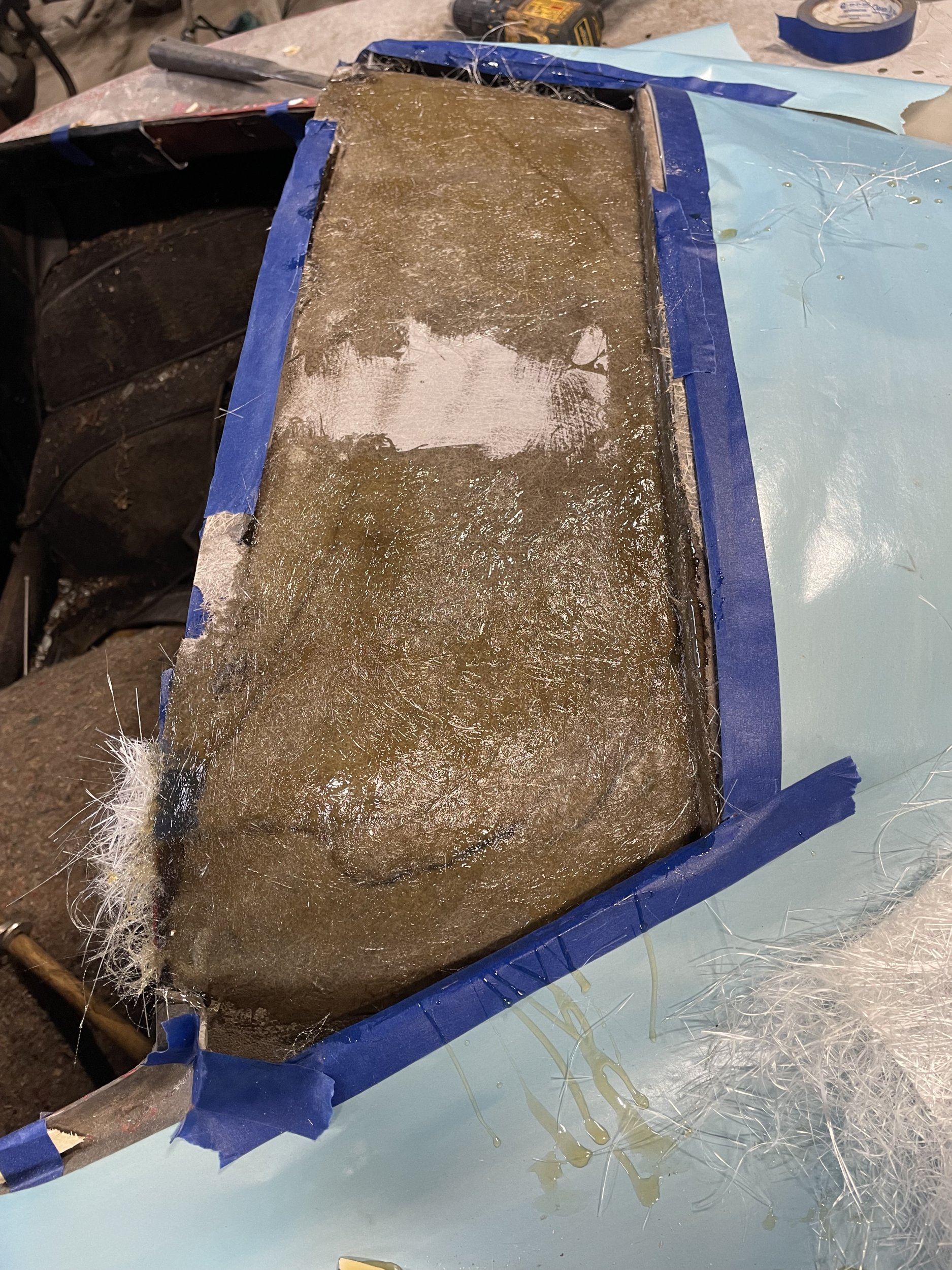

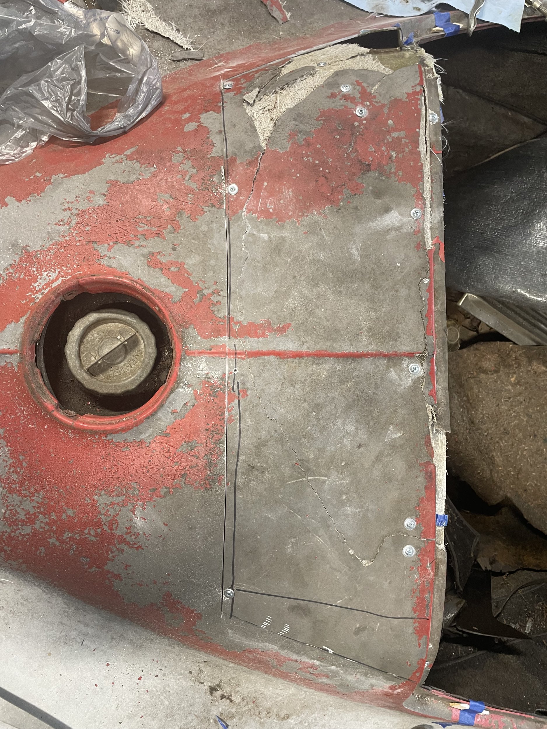

    I've been doing my own fibergl*** work as of late, trying to make a silk purse out of a pig's ear with this damn truck hood.
    So far I think it's winning, two afternoons and I still can't get the grill to fit this oversized hood but I'm literally whittling away at it.
    What a stock one looks like, grill fits over the hood.
    I added a flange to bolt the grill to but the hood is so wide I've actually resorted to carving out a space for the grill to sit in.

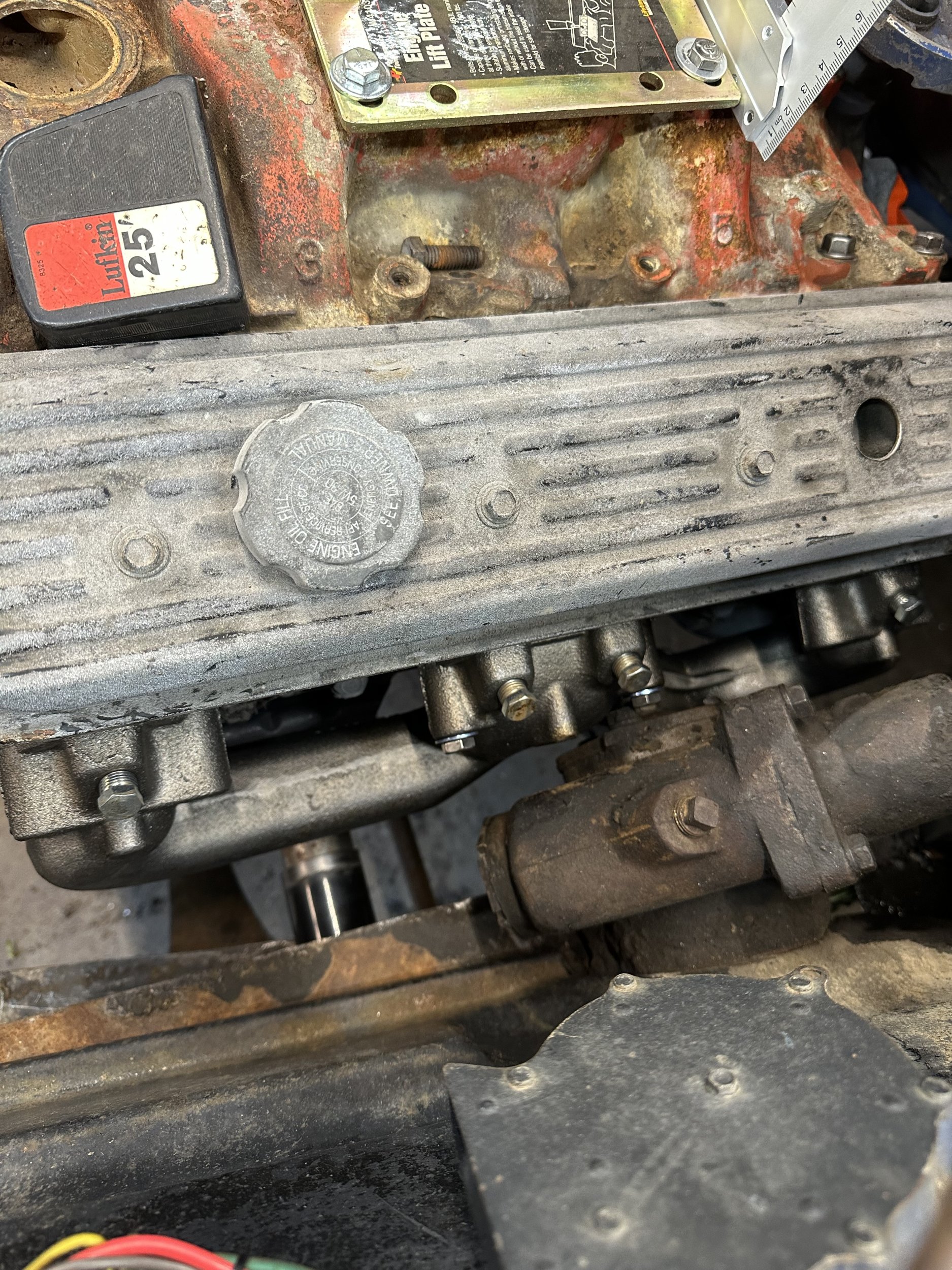

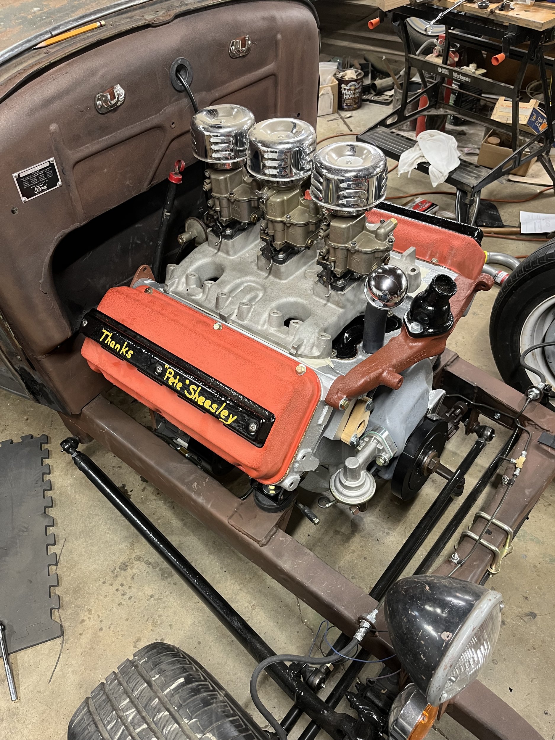

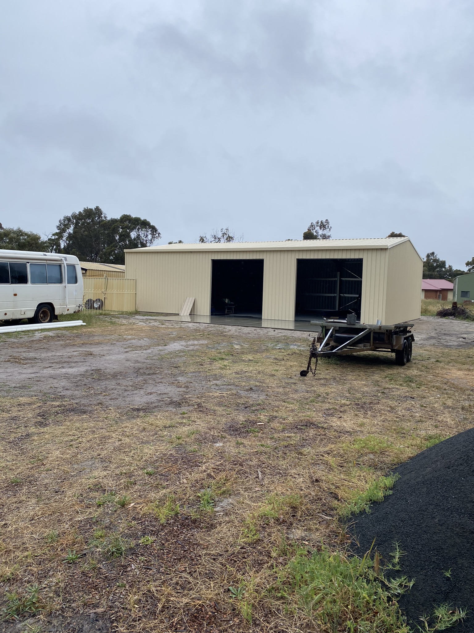

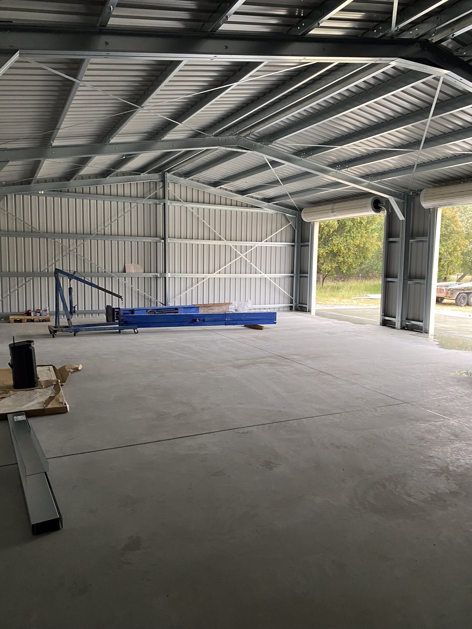

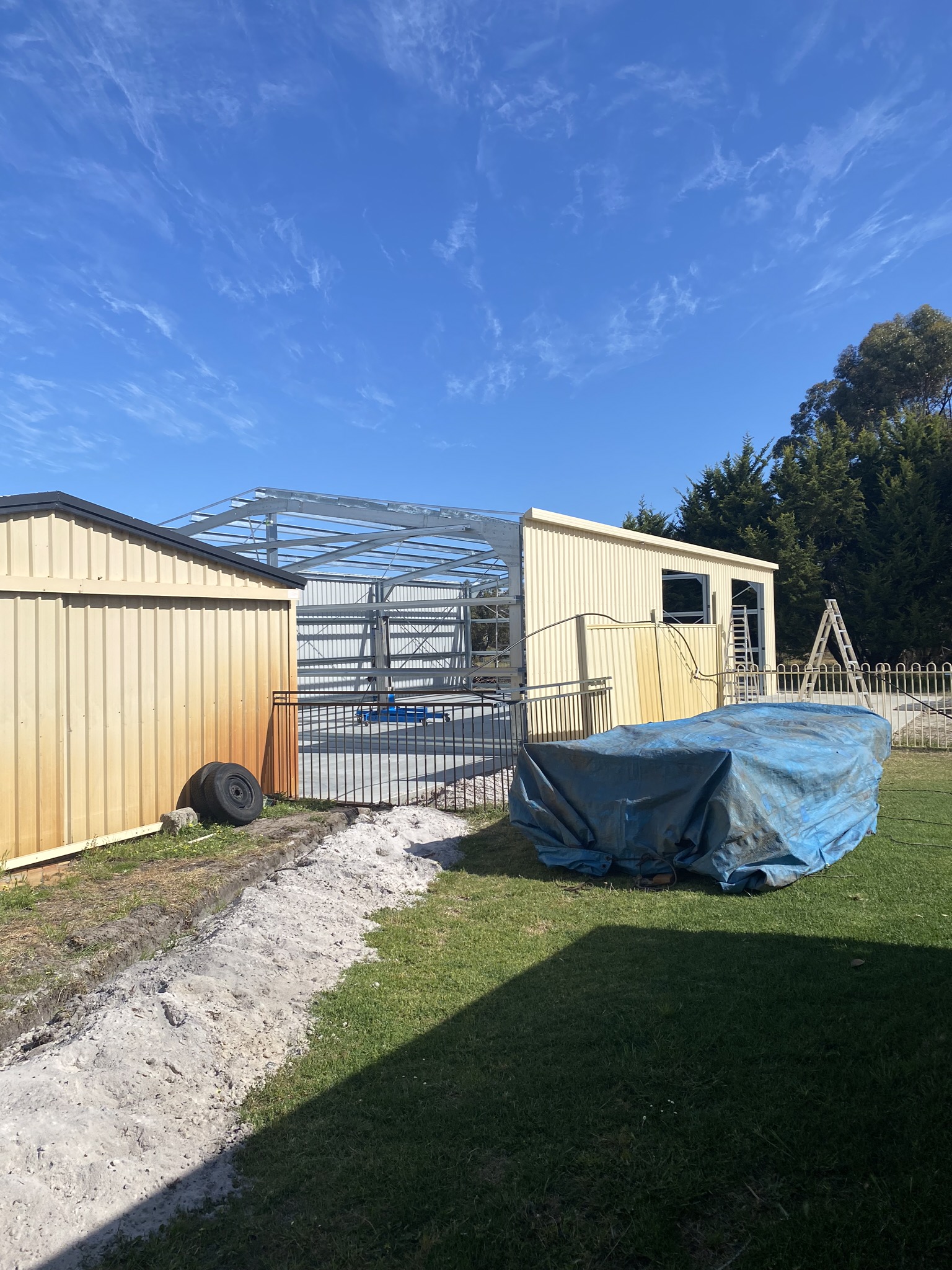

  13. Cheers Colin,
    It’s been pretty stressful these last couple of years, literally had nowhere to work on anything and all my gear, and I mean, all my gear has been in storage.
    It has been like living a different life really, soon be back on it though. You don’t realise what you do until you can’t do it.

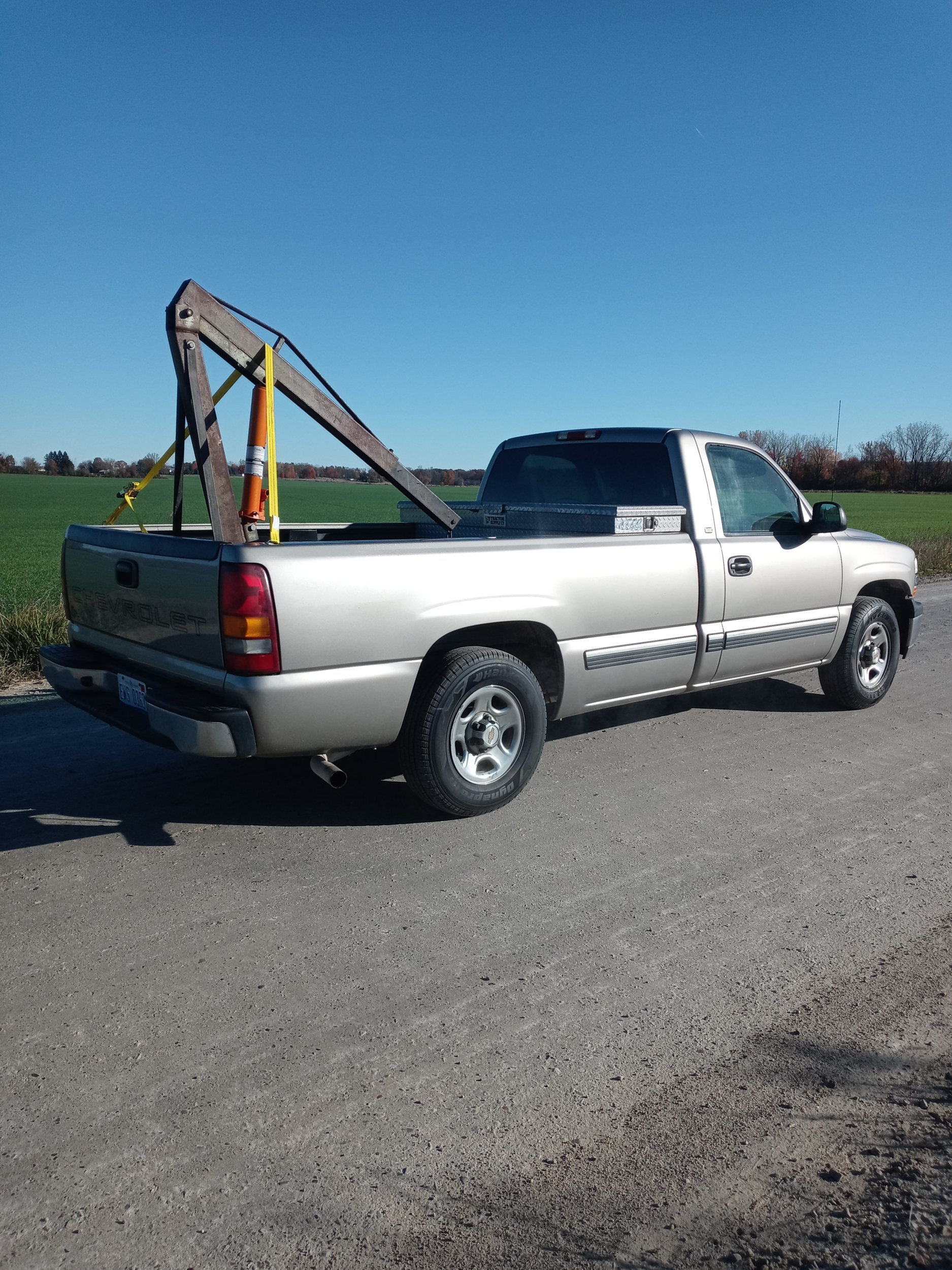

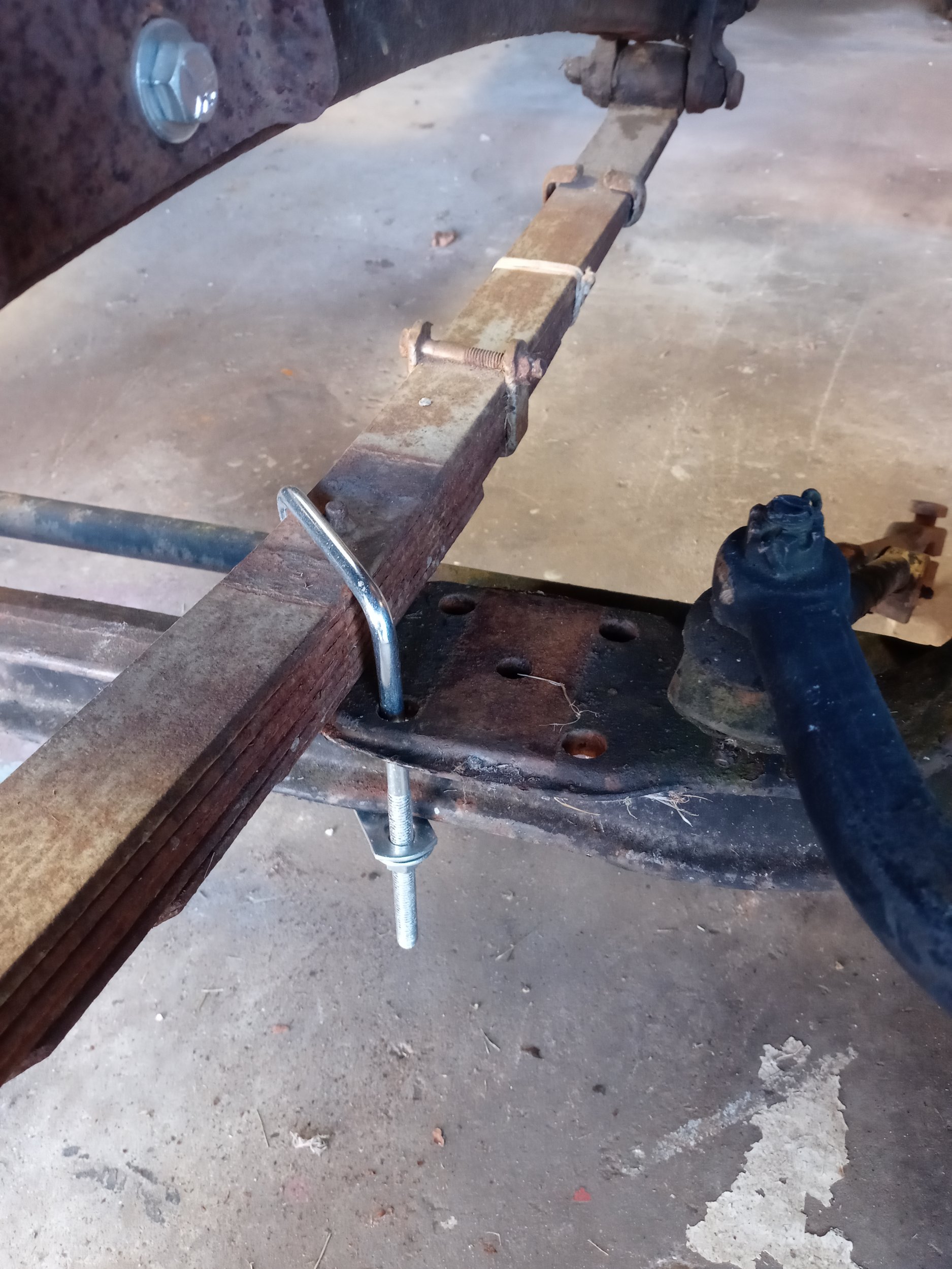

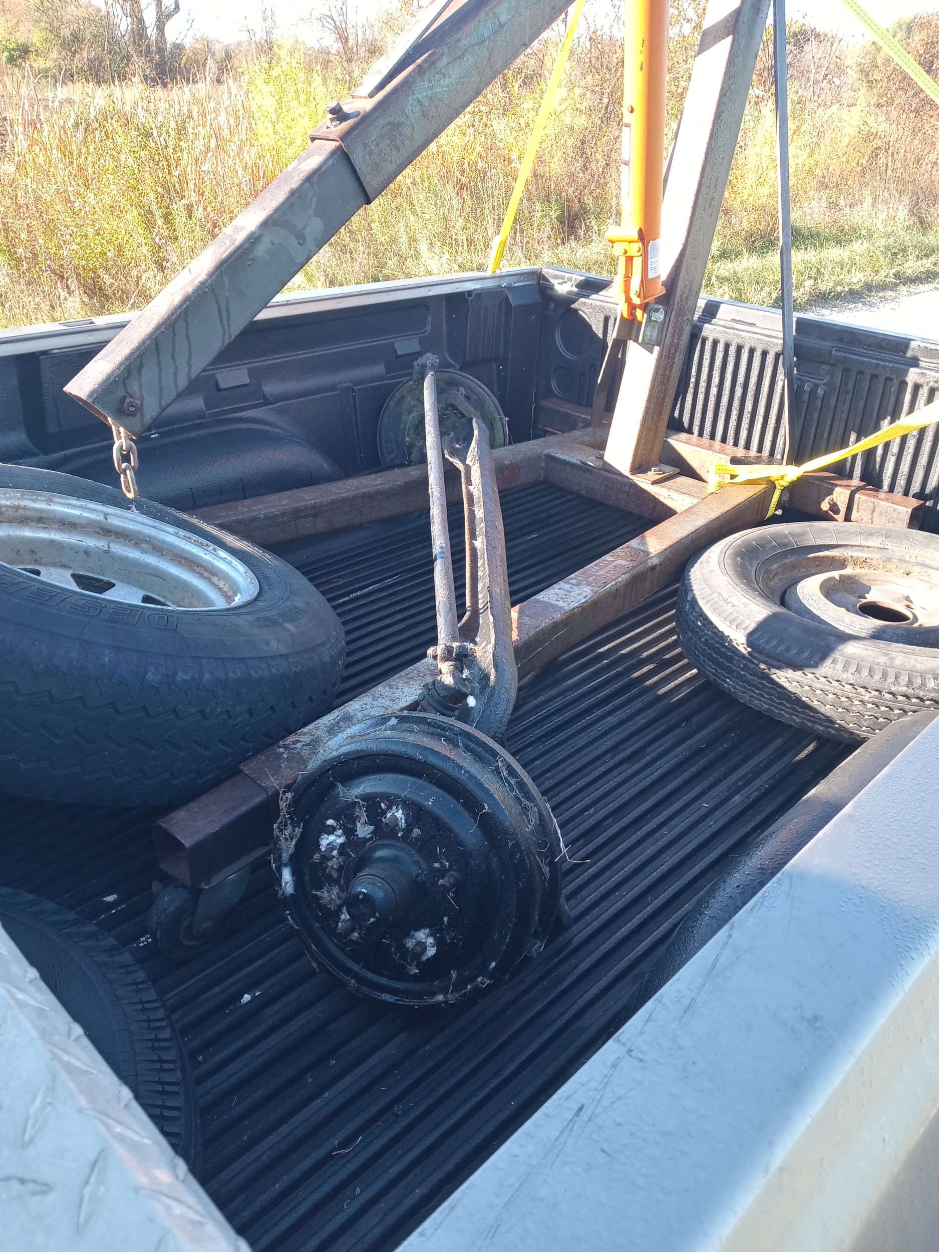

  19. Nice bright sunny fall morning. Heading off to prep my 1931 Plymouth PA Business Coupe I just purchased so I'm sure it's ready to go when I take the trailer down there in a few days to haul it home. It doesn't have a front axle. So I'm taking an axle from a 1964 Ford truck and I'll u-bolt it to the leaf springs on the Plymouth.
    At least, that's the plan.
    I think I have everything...
    Edit:
    Done did it.
    Just like downtown. LOL
    Good enough just to get it on and off the trailer.
    Looks like a car now.

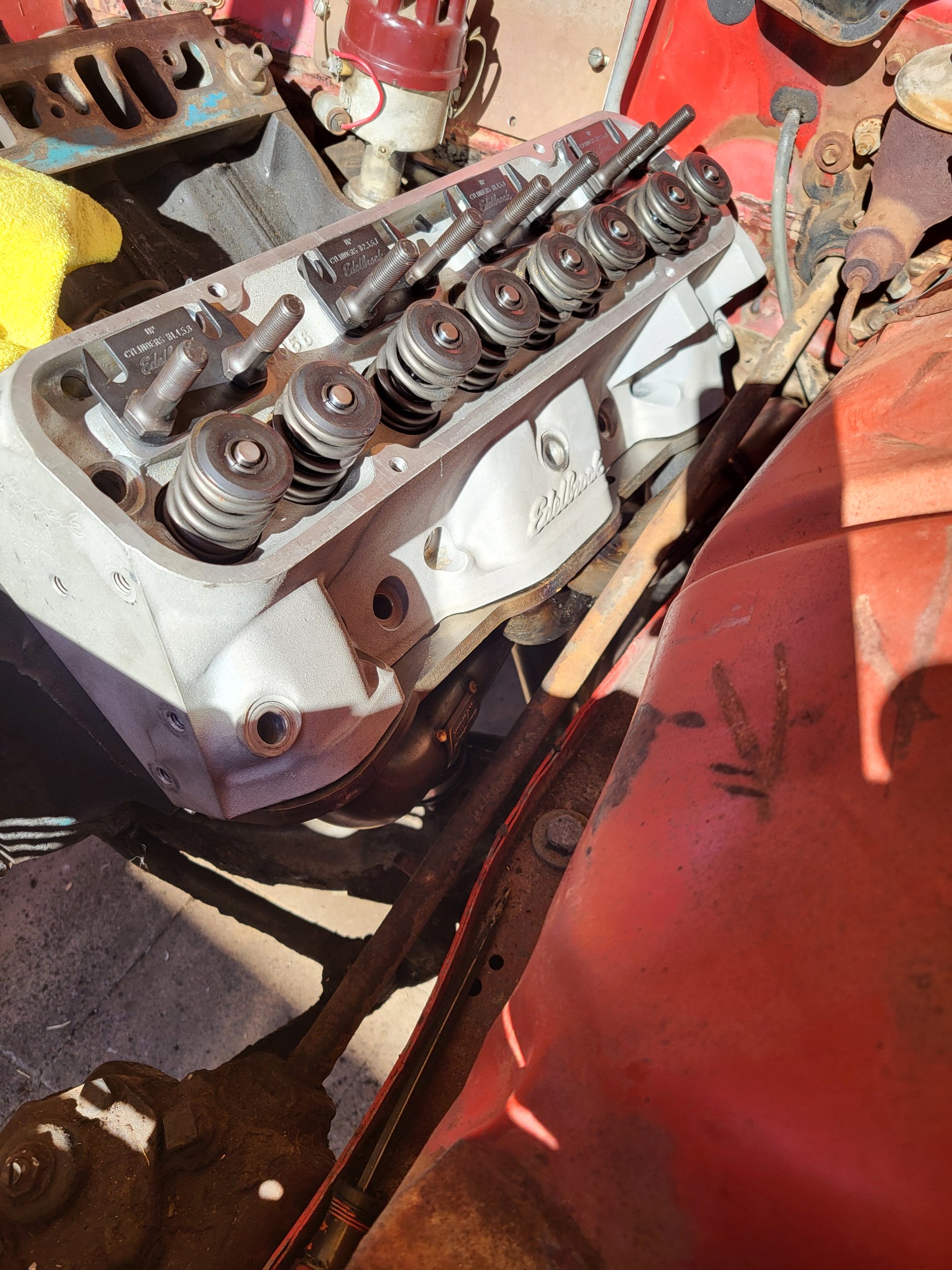

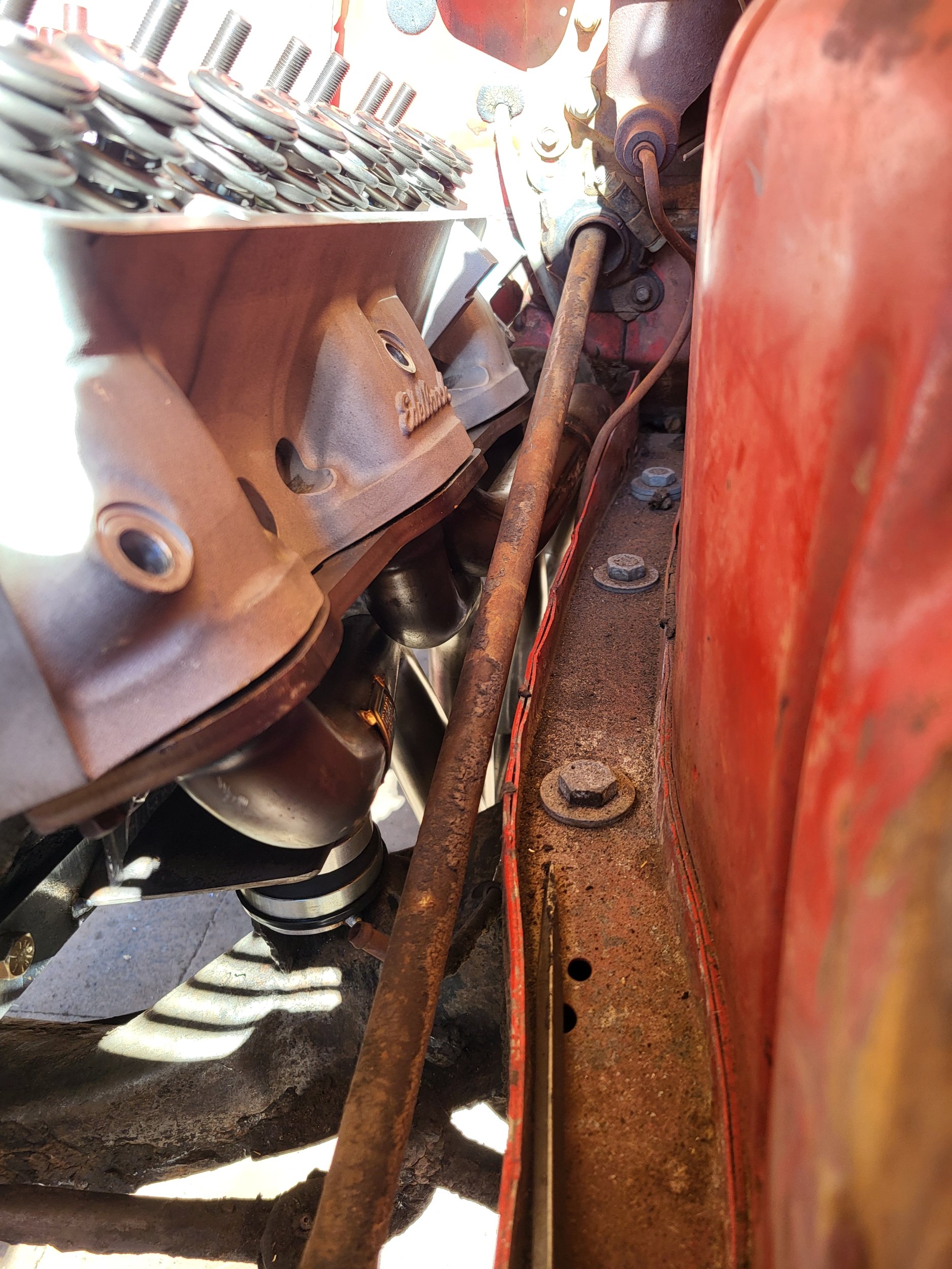

    20241024_100630.jpg Tested header fit with actual heads

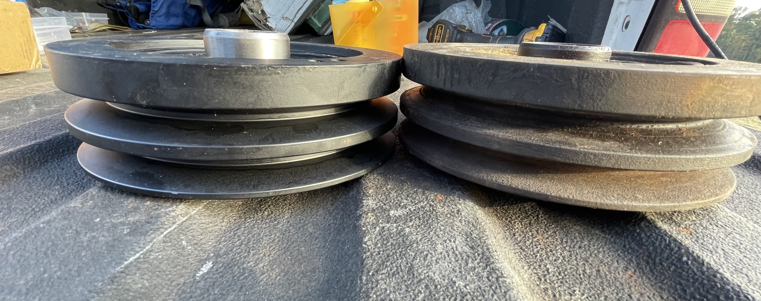

  24. IMG_2639.jpeg Should fix the issue with hitting the timing cover

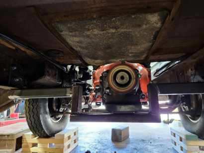

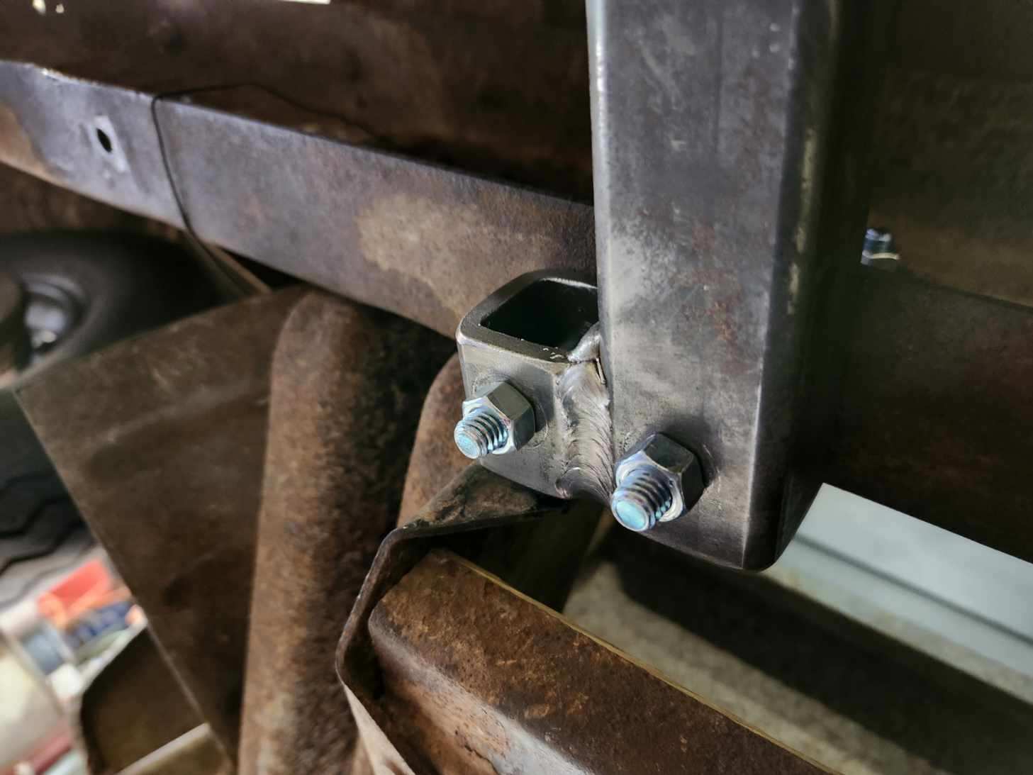

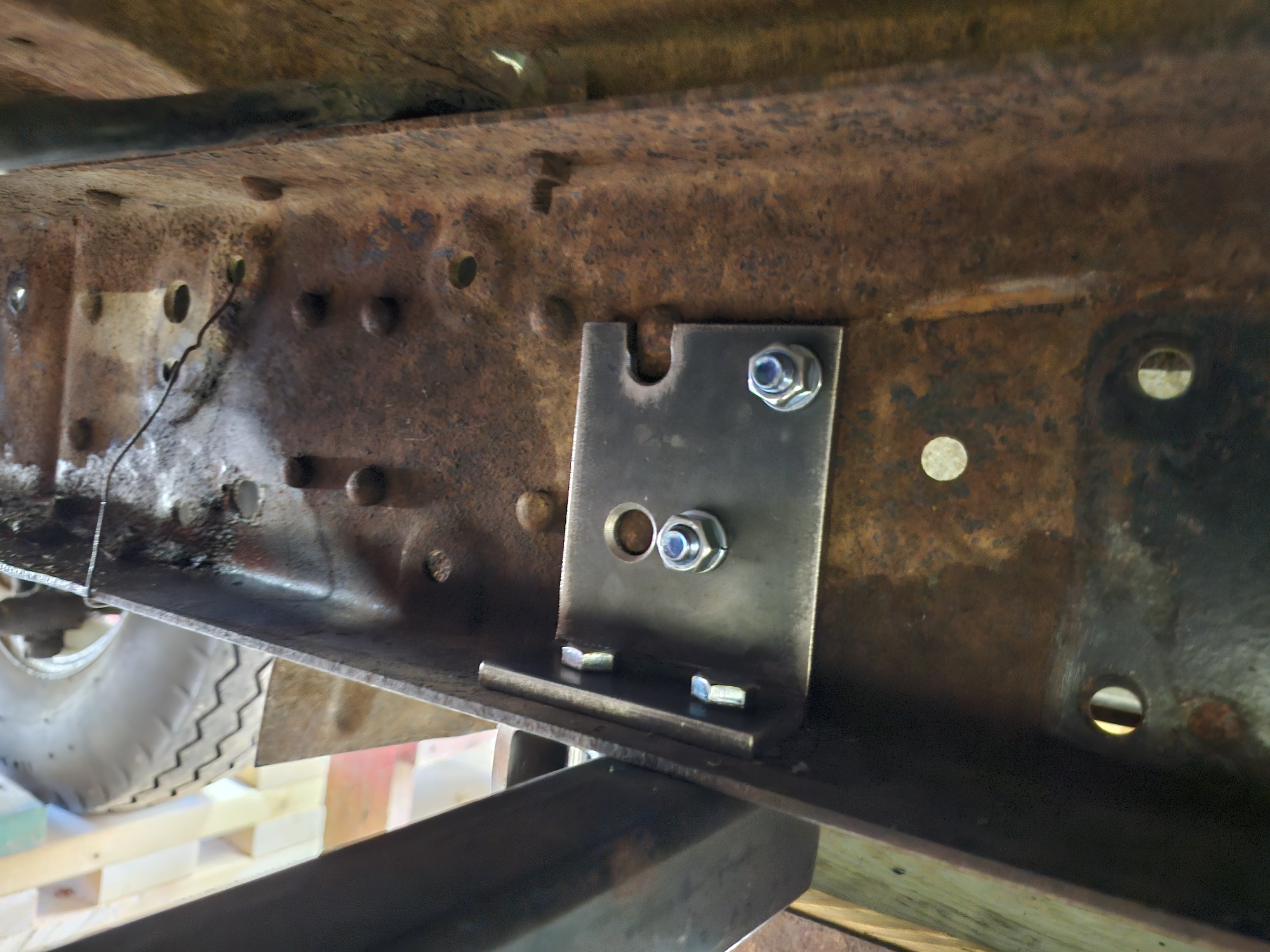

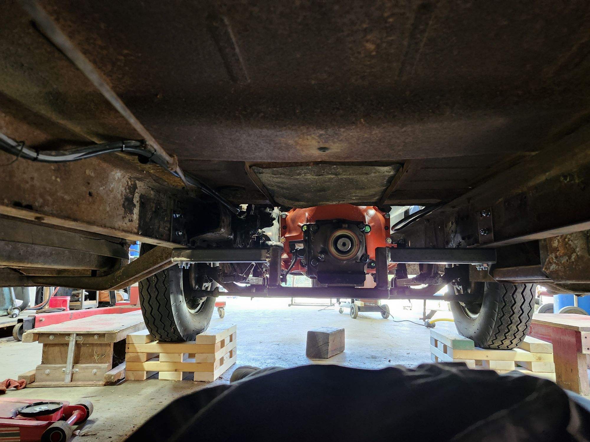

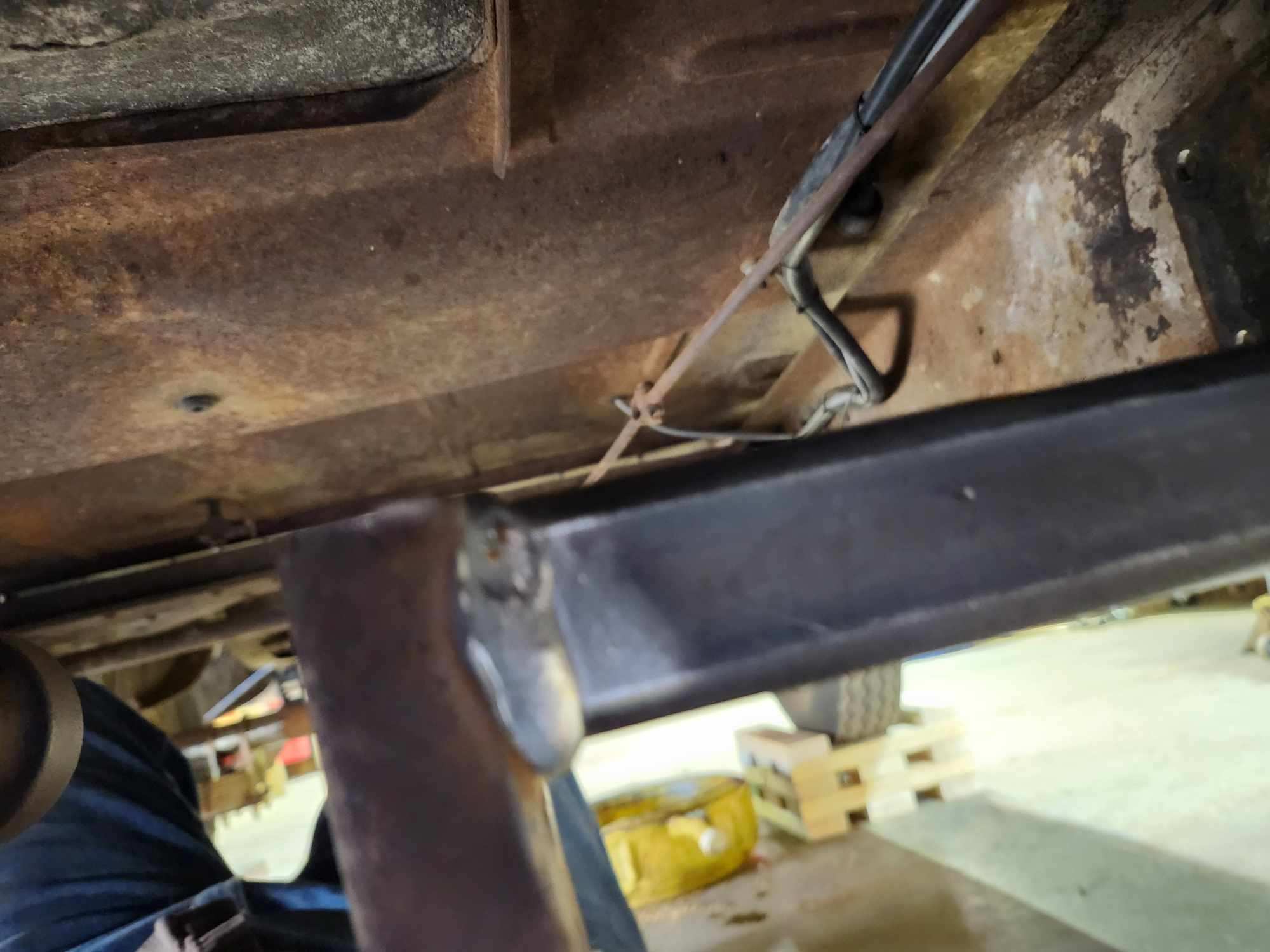

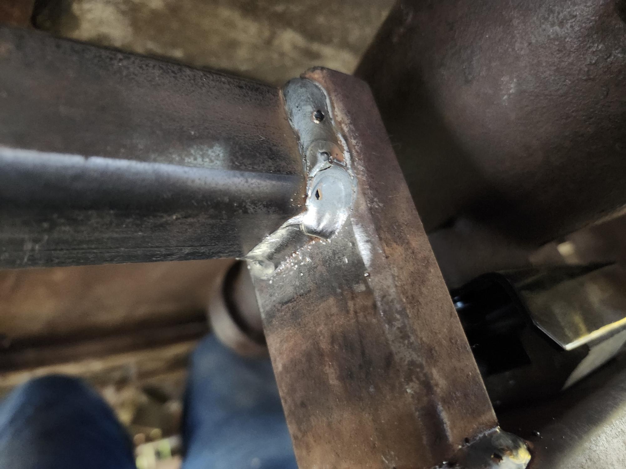

  25. We made a transmission crossmember for Papaw. The one I bought from EBay was advertised as being for an AD truck. Nope, didn’t fit for ****. With lots of encouragement from my friends, Lloyd and Lumpy, we made one that will work. It’s not the prettiest thing, but I think it will work. I also taught Little(?) Truckdoctor how to weld. He did damn fine for his first job. Resized_20241027_145154_1730058765627.jpeg Resized_20241027_145211_1730058757282.jpeg Resized_20241027_145215_1730058756962.jpeg Resized_20241027_145147_1730058766346.jpeg Resized_20241027_145140_1730058768678.jpeg Resized_20241027_145129_1730058773776.jpeg

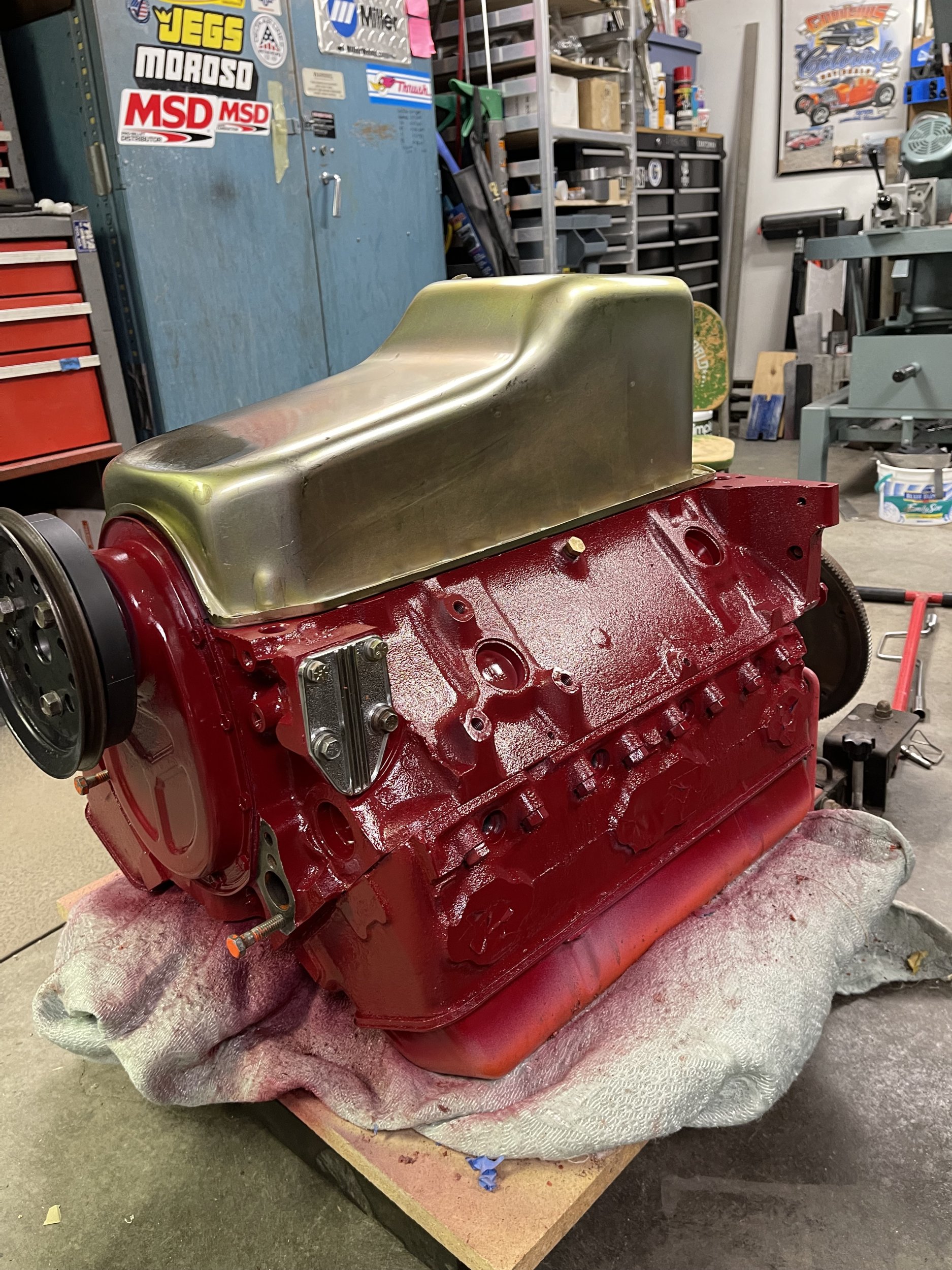

  28. Kid got his last brace fabricated for his jeep floor
