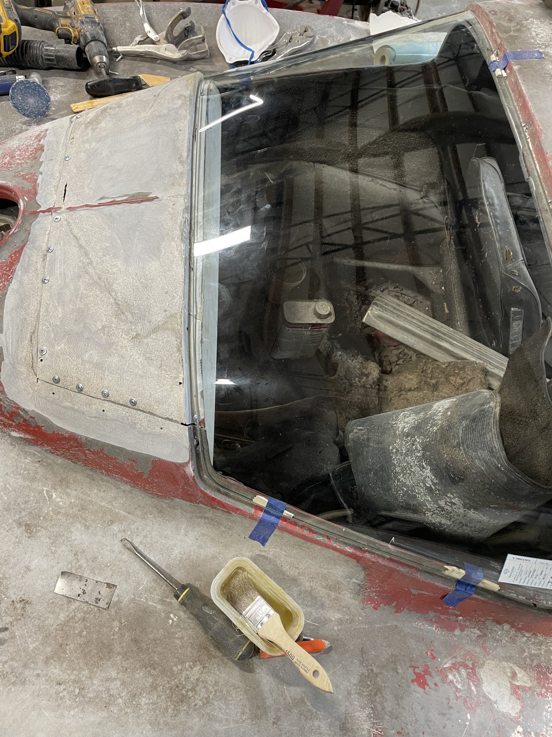

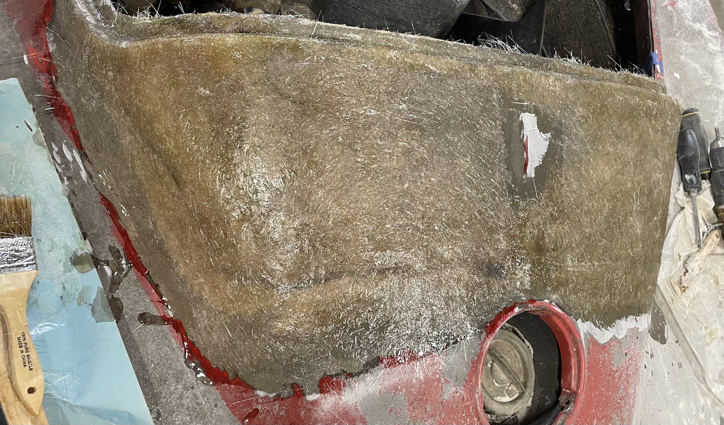

  2. Got the busted up outer panel glued back together. Doing a gl*** check.
    Looks ok
    has a couple layers of mat underneath. Made a backer piece for each side along the cut to screw it down to. About to glue this piece in so it can set up.
    Left the center style line in just to line things up. It has cracks in the gel and I’ll grind those out after its glued in The outer will get a couple layers of mat plus an extra narrow strip along the splice

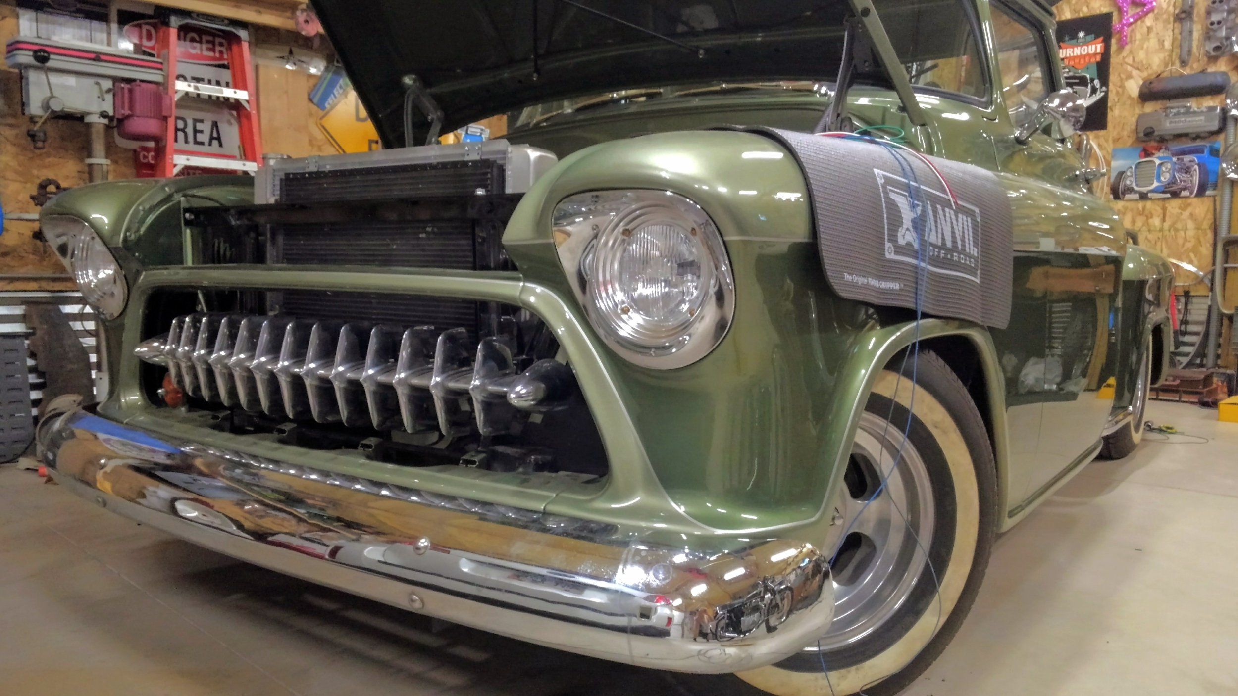

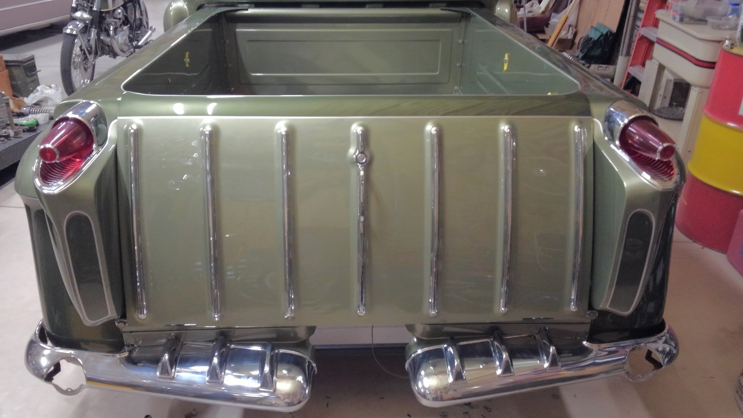

    Got my grill squeezed in without messing up the paint
    Real happy with how the front of the hood sides turned out
    Screenshot_20241101_183836_Gallery.jpg Screenshot_20241101_190957_Gallery.jpg 20241101_174017.jpg 20241101_174037.jpg

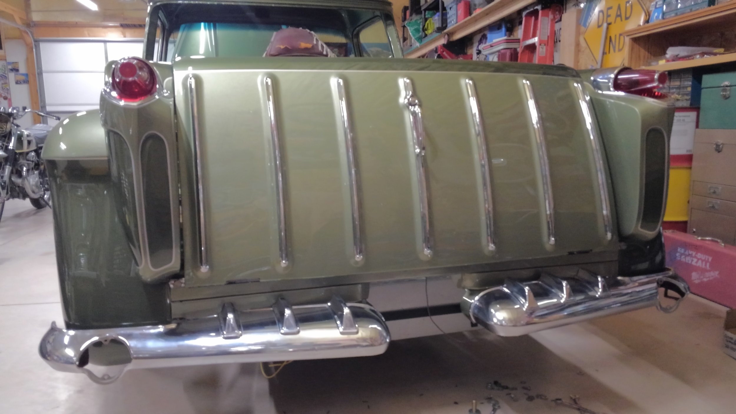

    And the script piece under the tailgate turned out pretty good

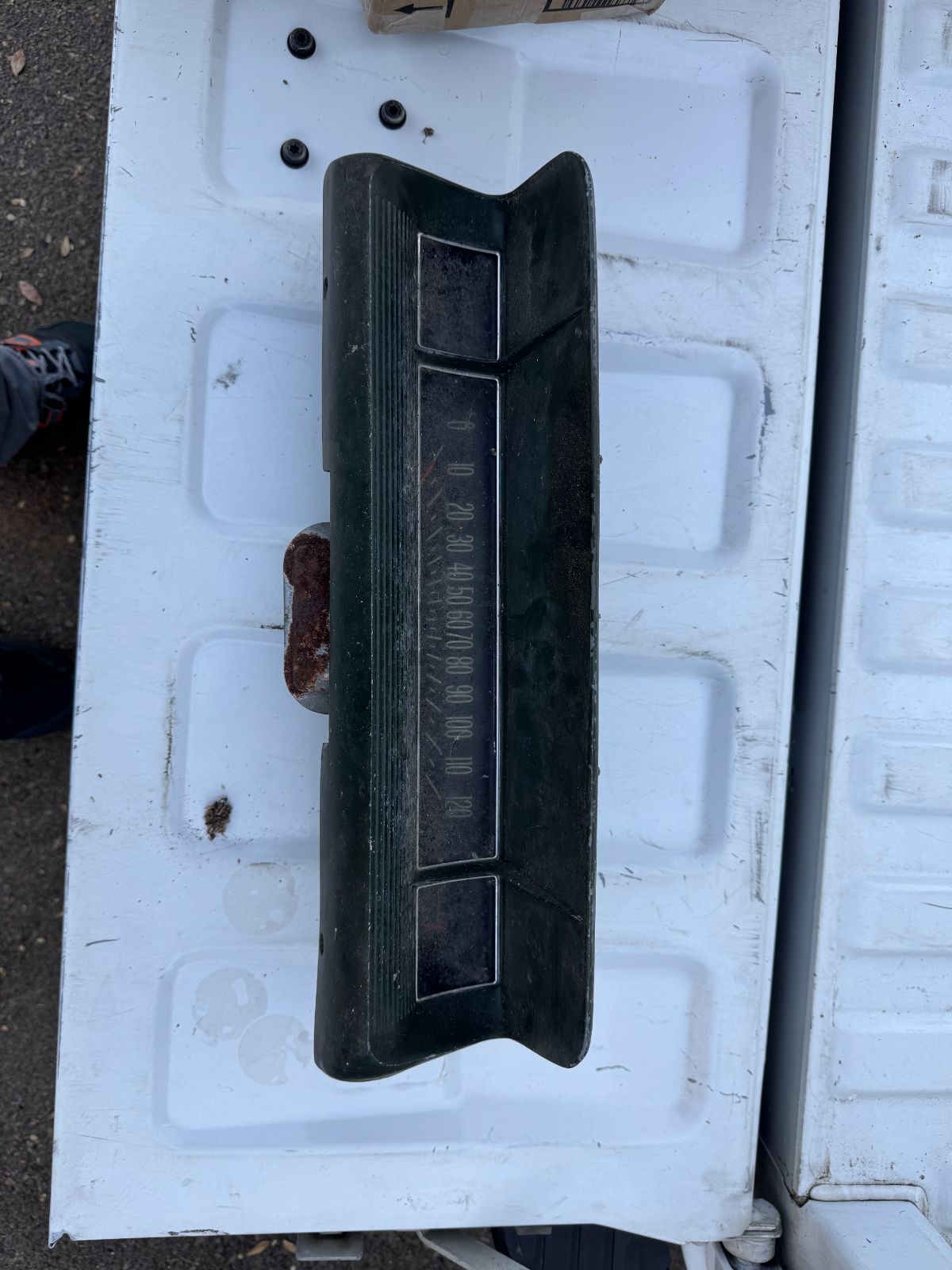

    IMG_20241101_191302.jpg IMG_20241101_191255.jpg After a couple of months of searching found a speedo pod for the Tempest to replace the sun fried unit that came with the car. Bonus is it's a 61 which is made of aluminum.

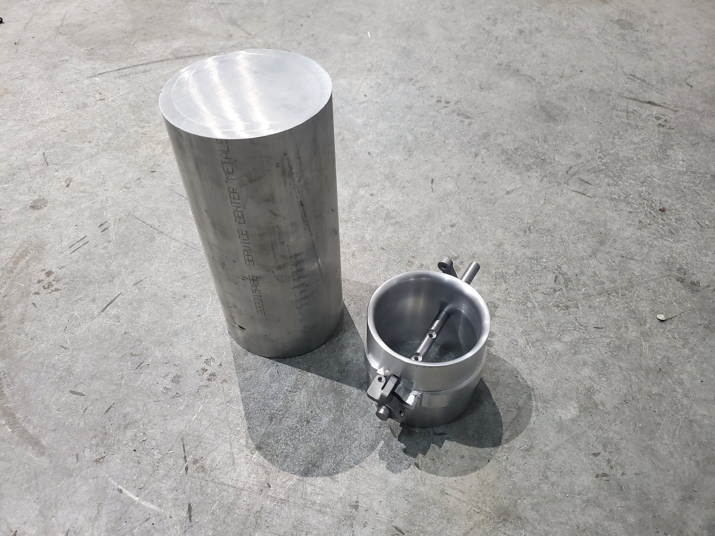

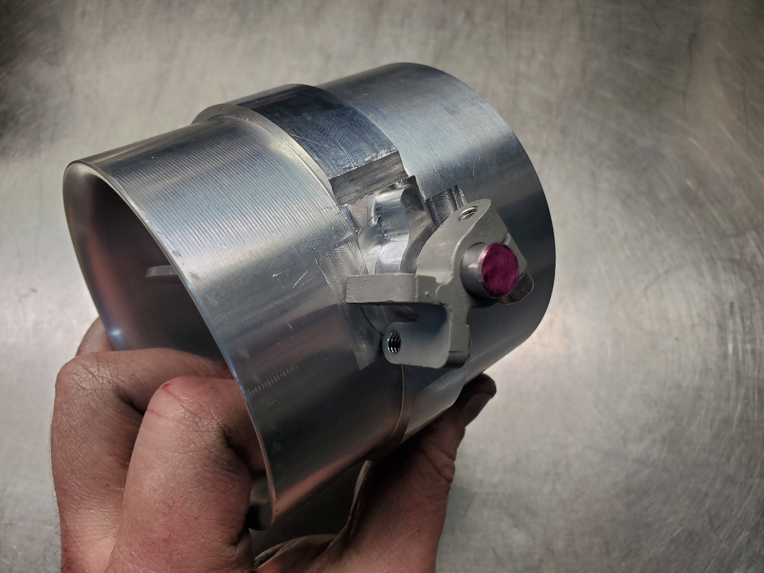

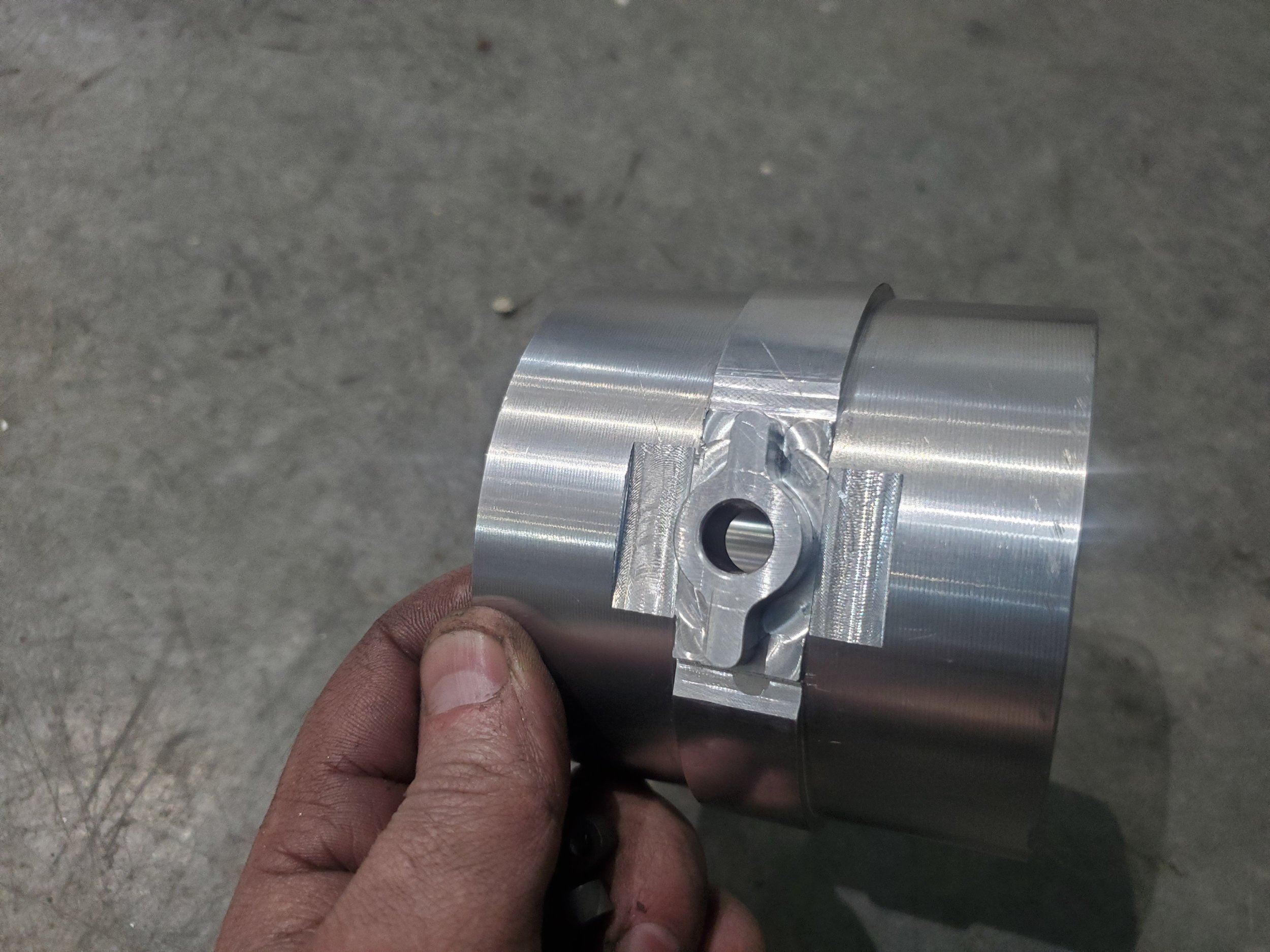

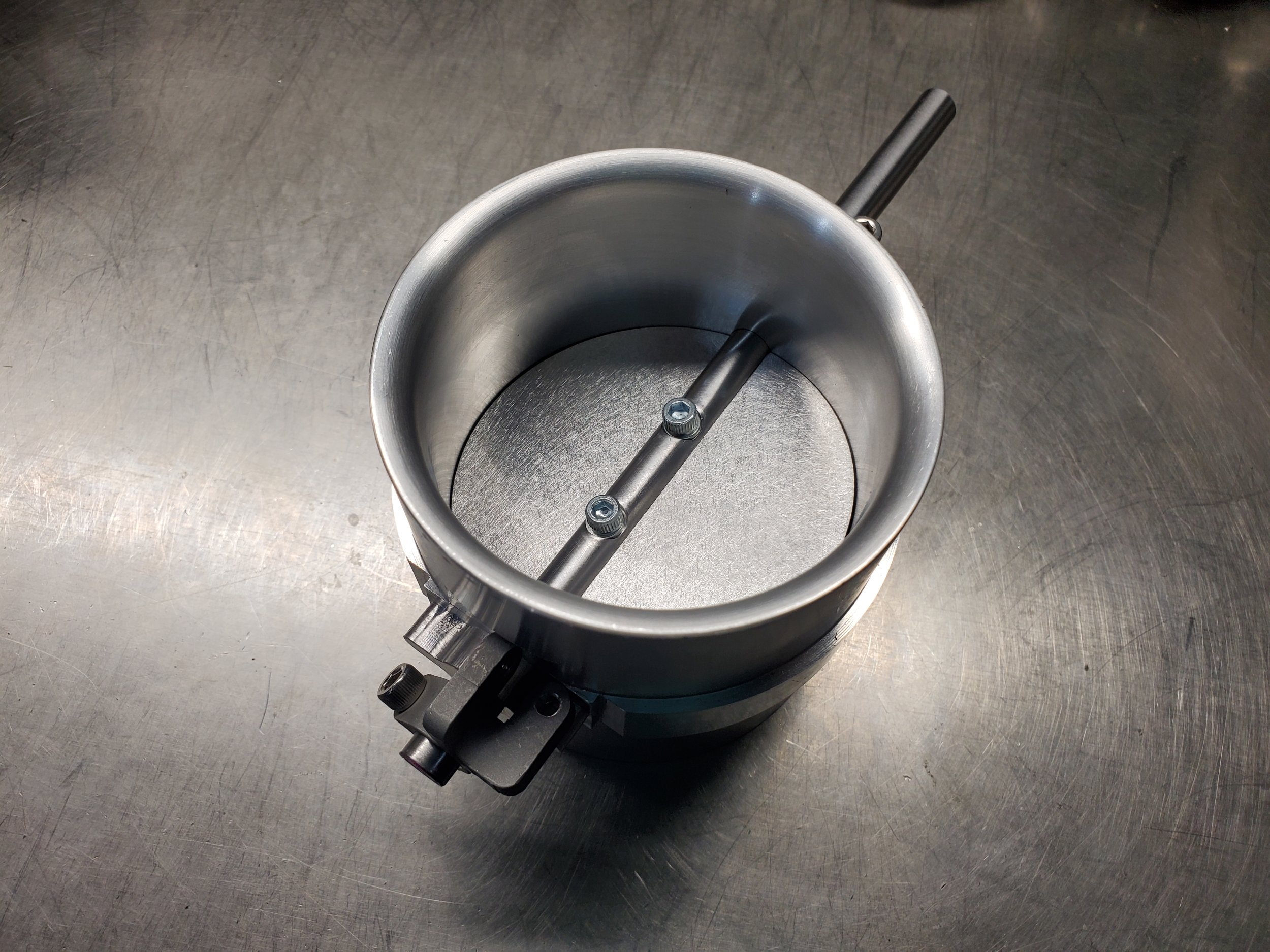

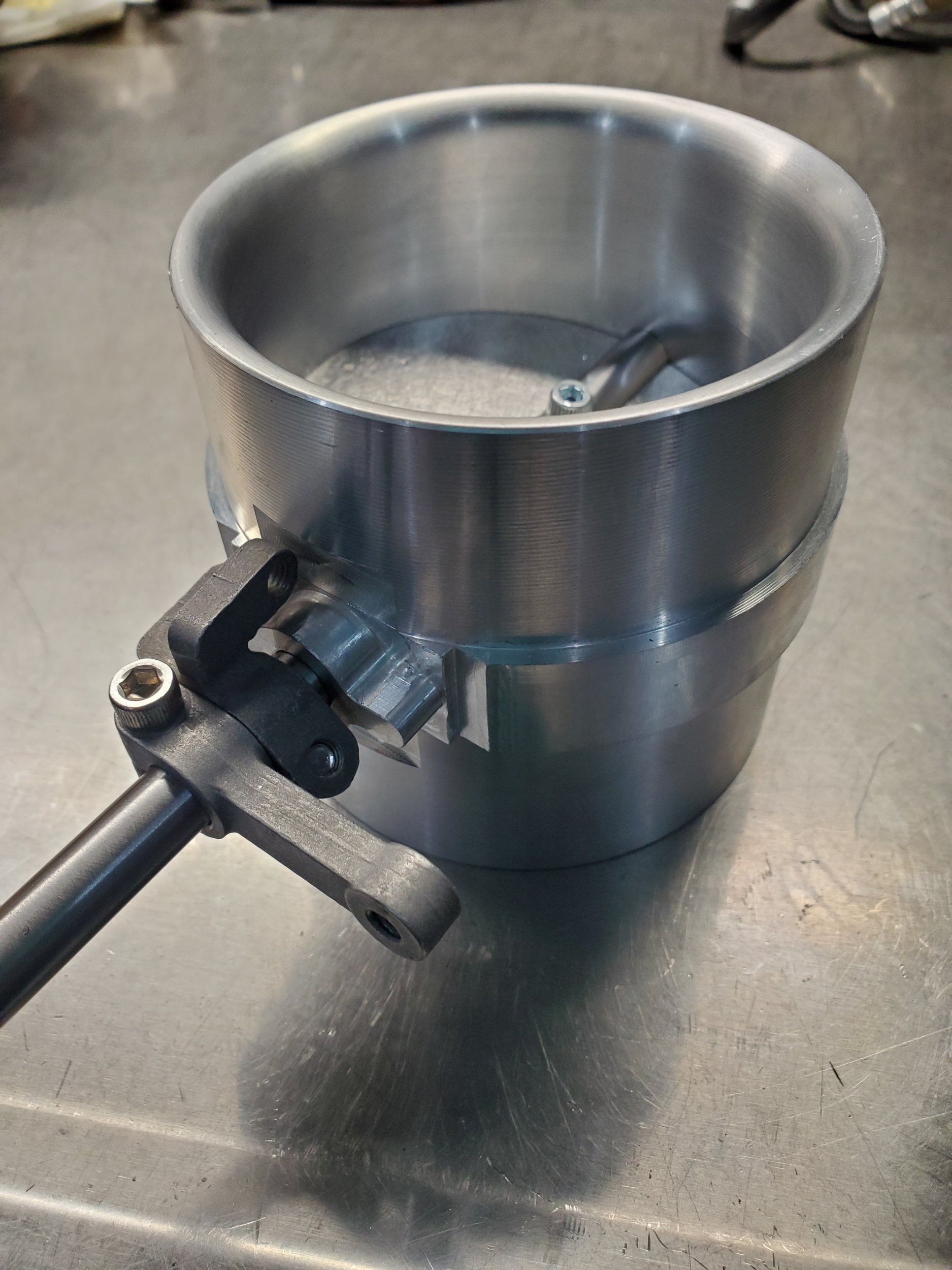

    Got asked to make a one off throttle body for a friend that runs a Turbo VW. Made this from 5-1/4" aluminum bar stock. Layout uses Hilborn style shaft, blade, arms, and stops. Need to TIG weld a V Band flang to the bottom end of it yet. Made this on my vertical mill.

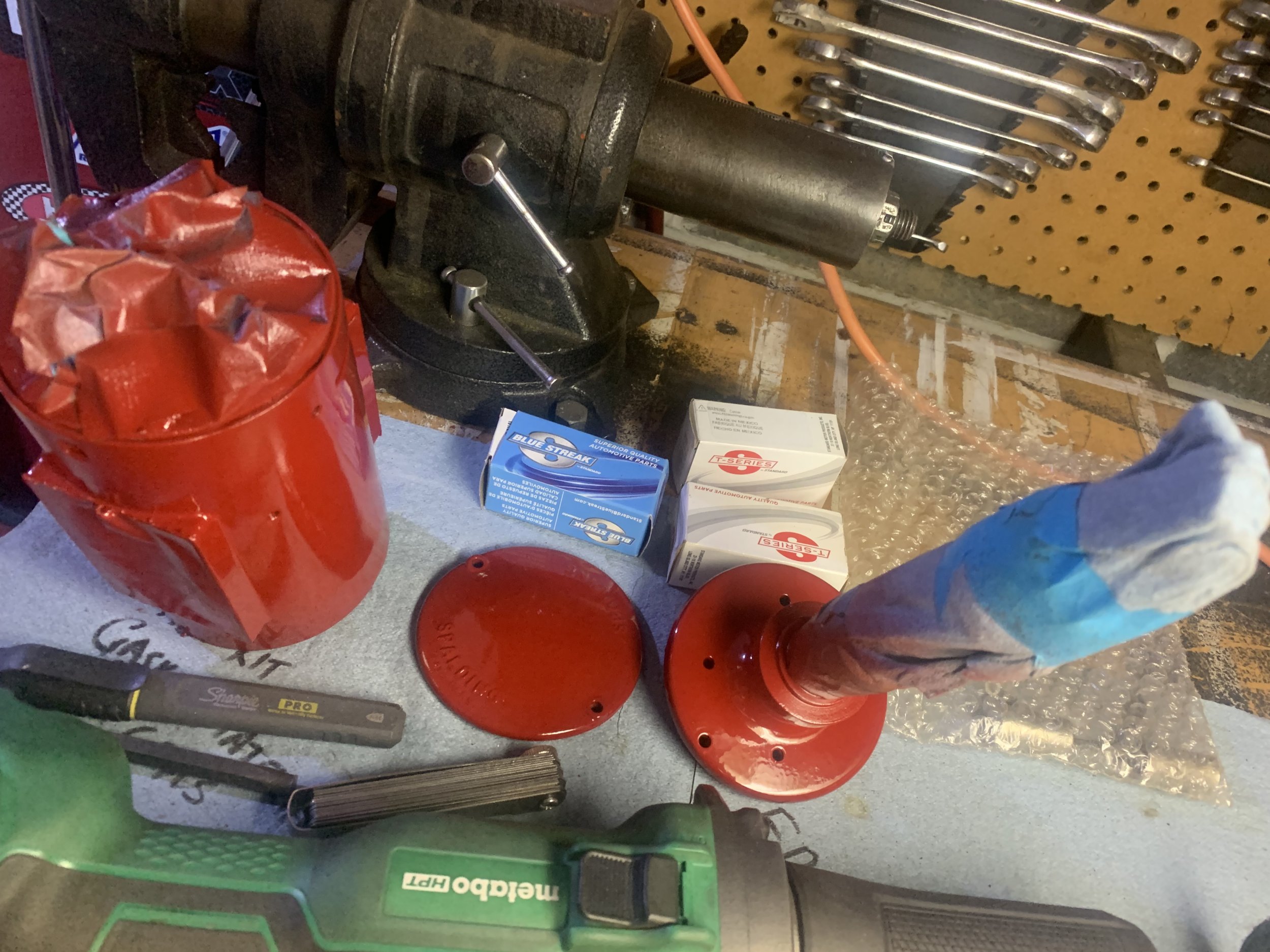

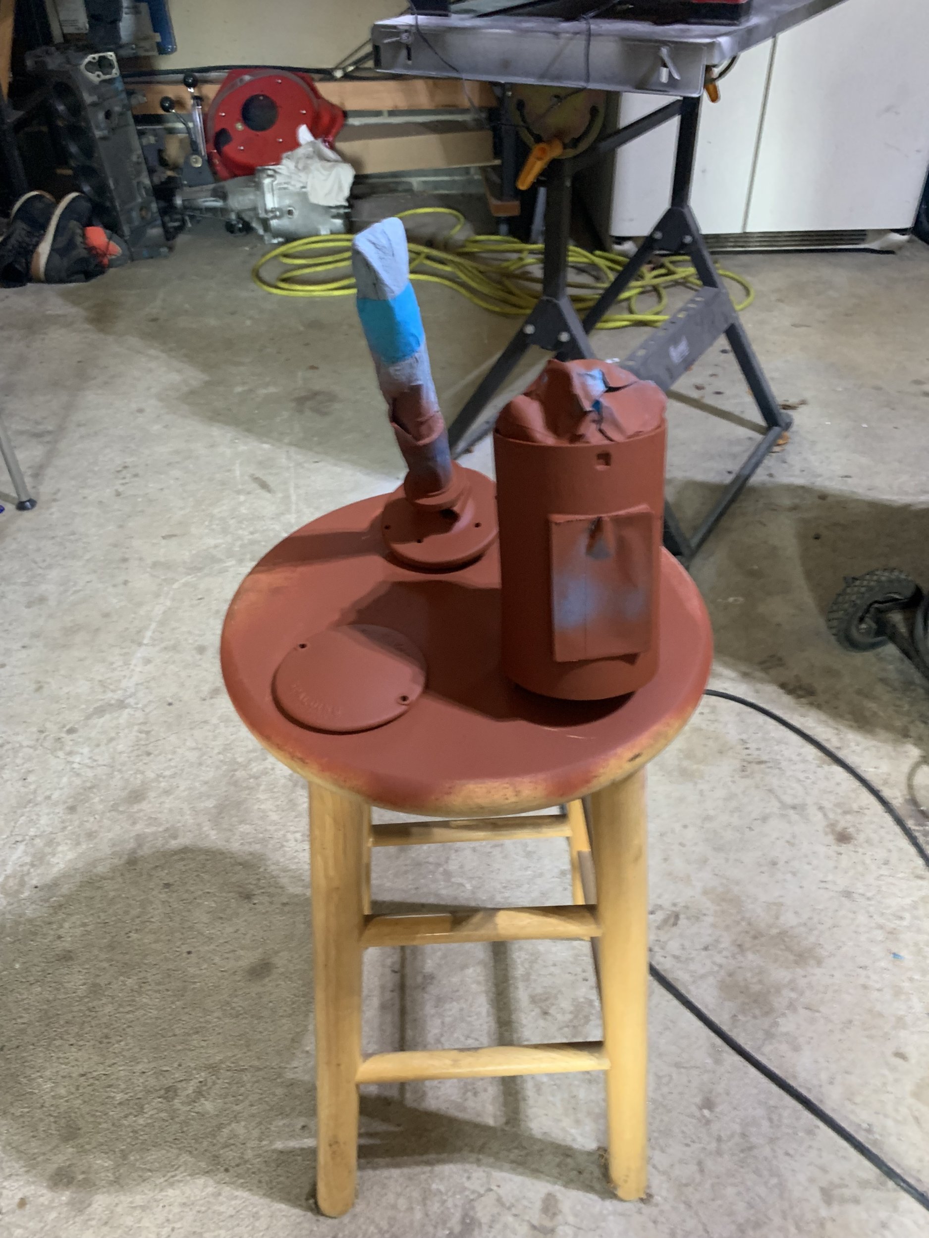

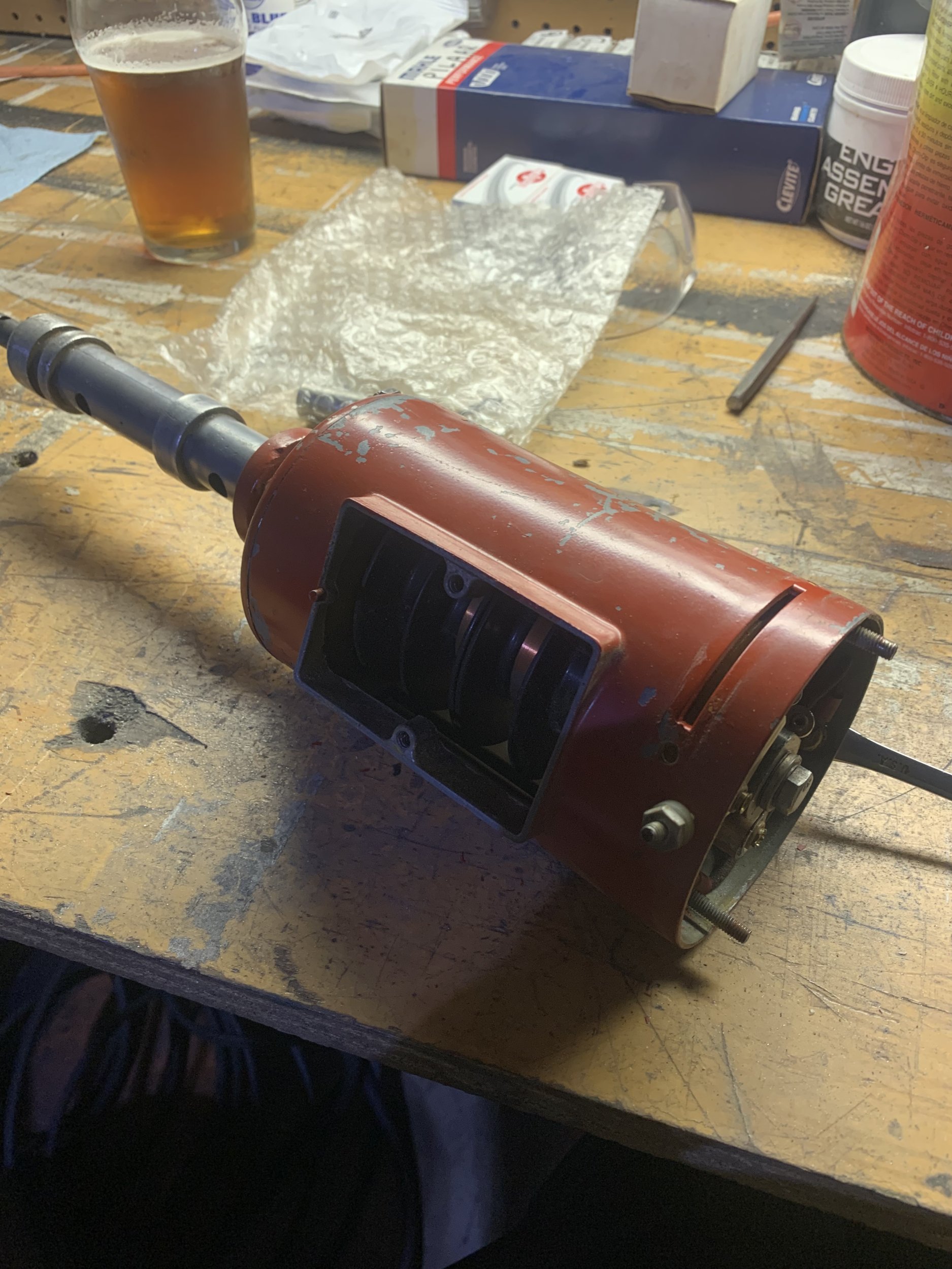

    Haven’t updated on this thread in a while, but my build thread has some updated pics. Currently working on refreshing the Spalding Flamethrower. IMG_5348.jpeg IMG_5377.jpeg IMG_5389.jpeg IMG_5390.jpeg

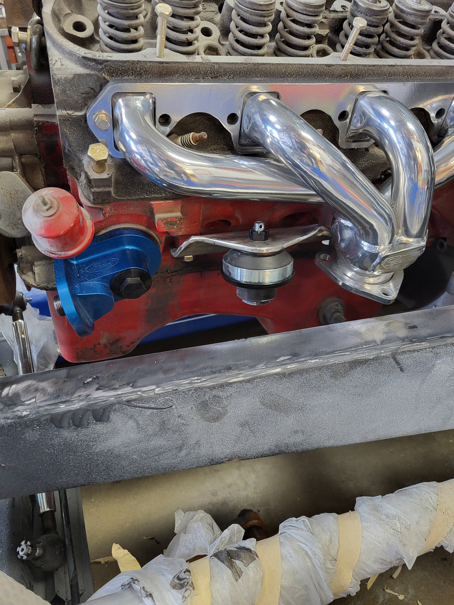

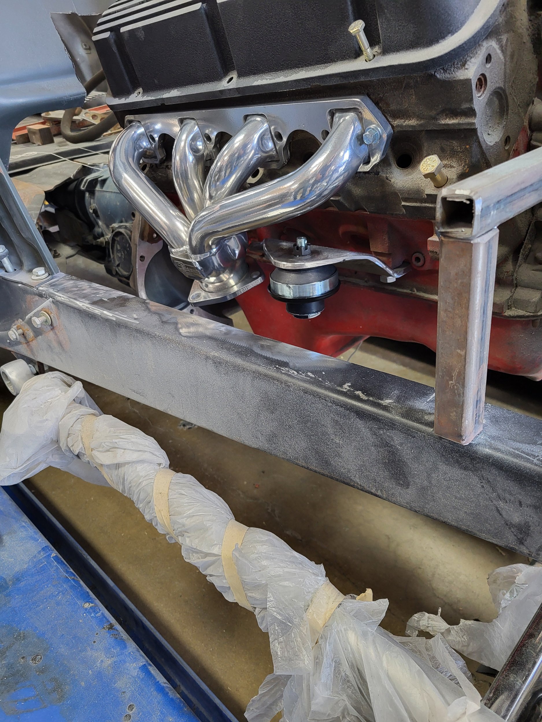

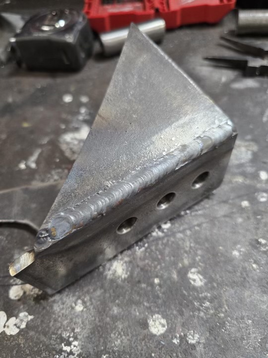

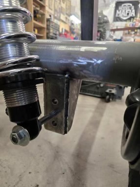

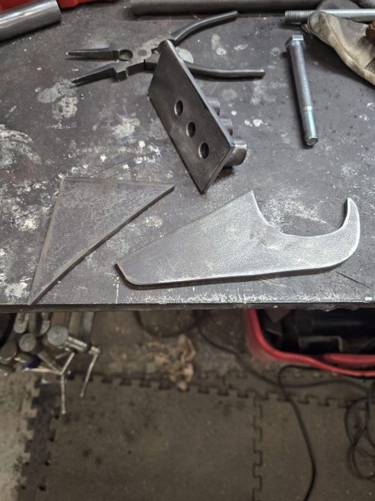

    20241102_143846.jpg 20241102_143832.jpg Worked on fabbing engine mounts to put a 289 into a 32 3 window. It's a bit of a chore around the steering box.

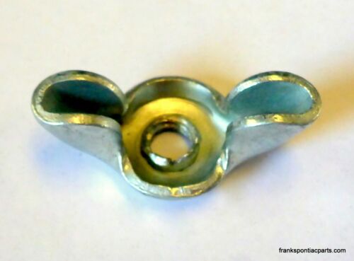

    I've seen an engine eat one of those. The guy took off his air cleaner and spun the wingnut back on the stud so he wouldn't lose it. He then made a p*** down the drag strip and the wingnut spun itself off and went right down the wide open carb.

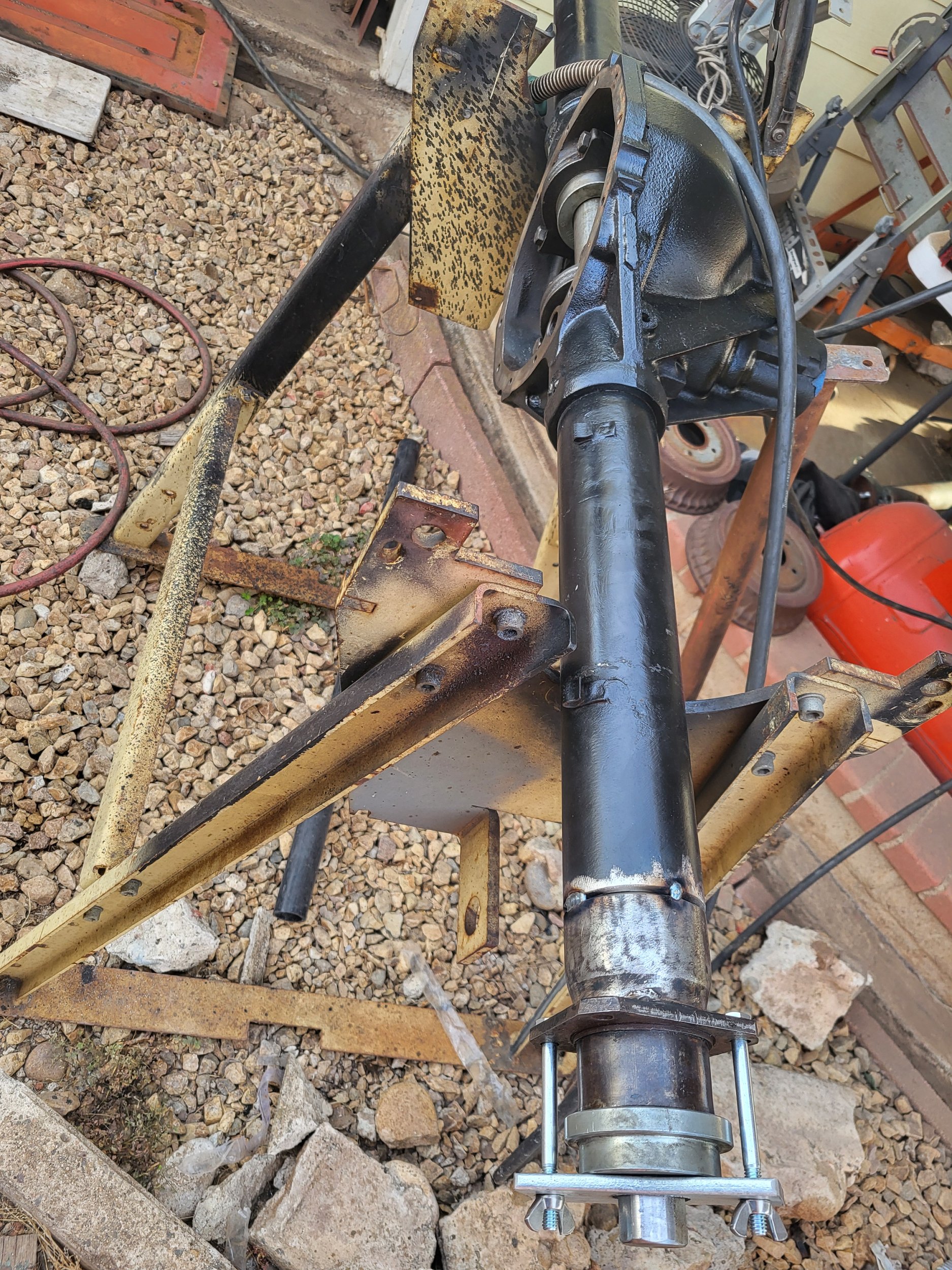

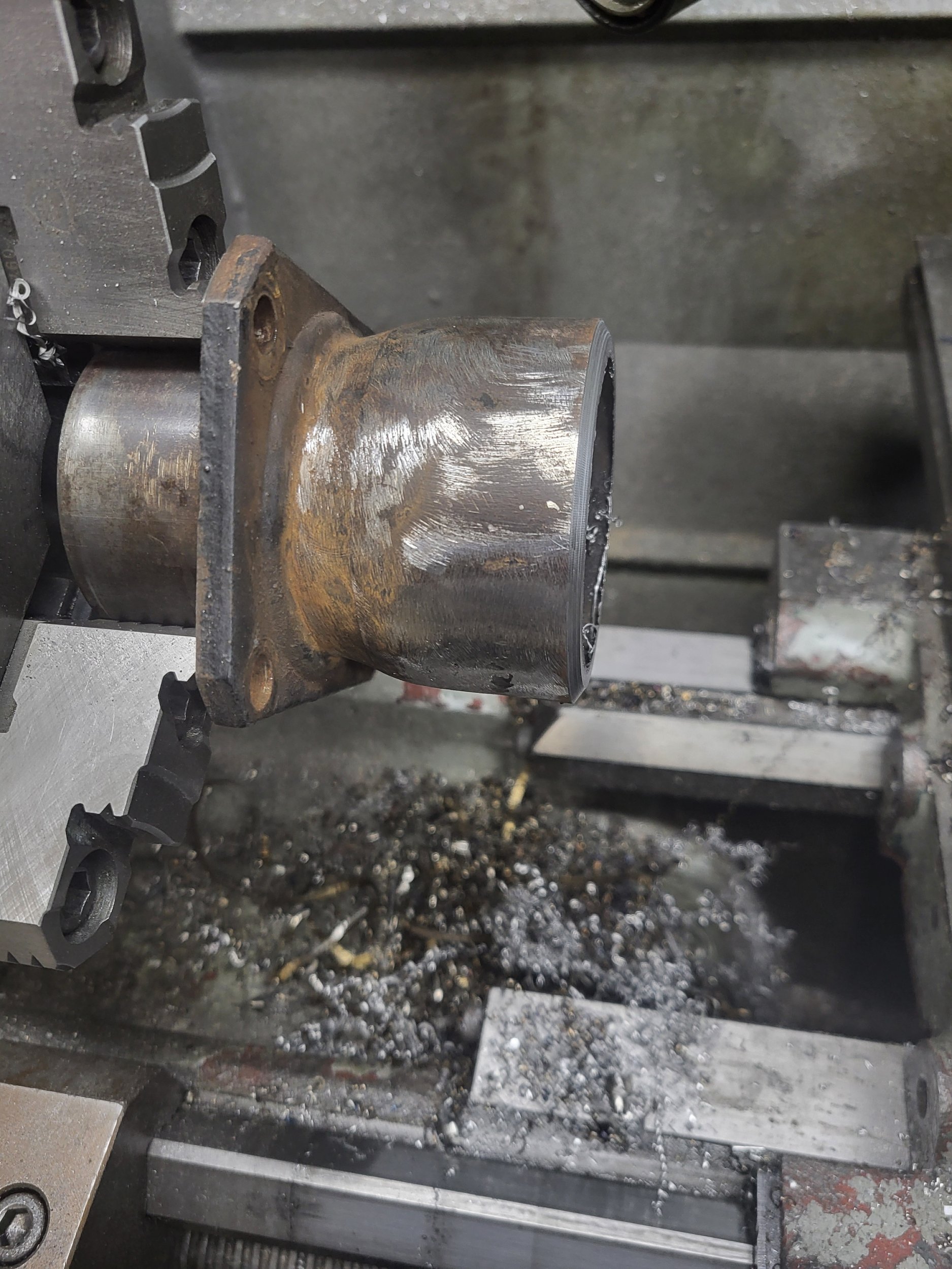

    20241105_085914.jpg 20241105_153737.jpg Cut some housing ends off a junk Chevelle 10 bolt and shortened up a big ol Imapala 12 bolt and turned it into an early Chevy II 12 bolt:cool: will fit the Tempest perfectly.

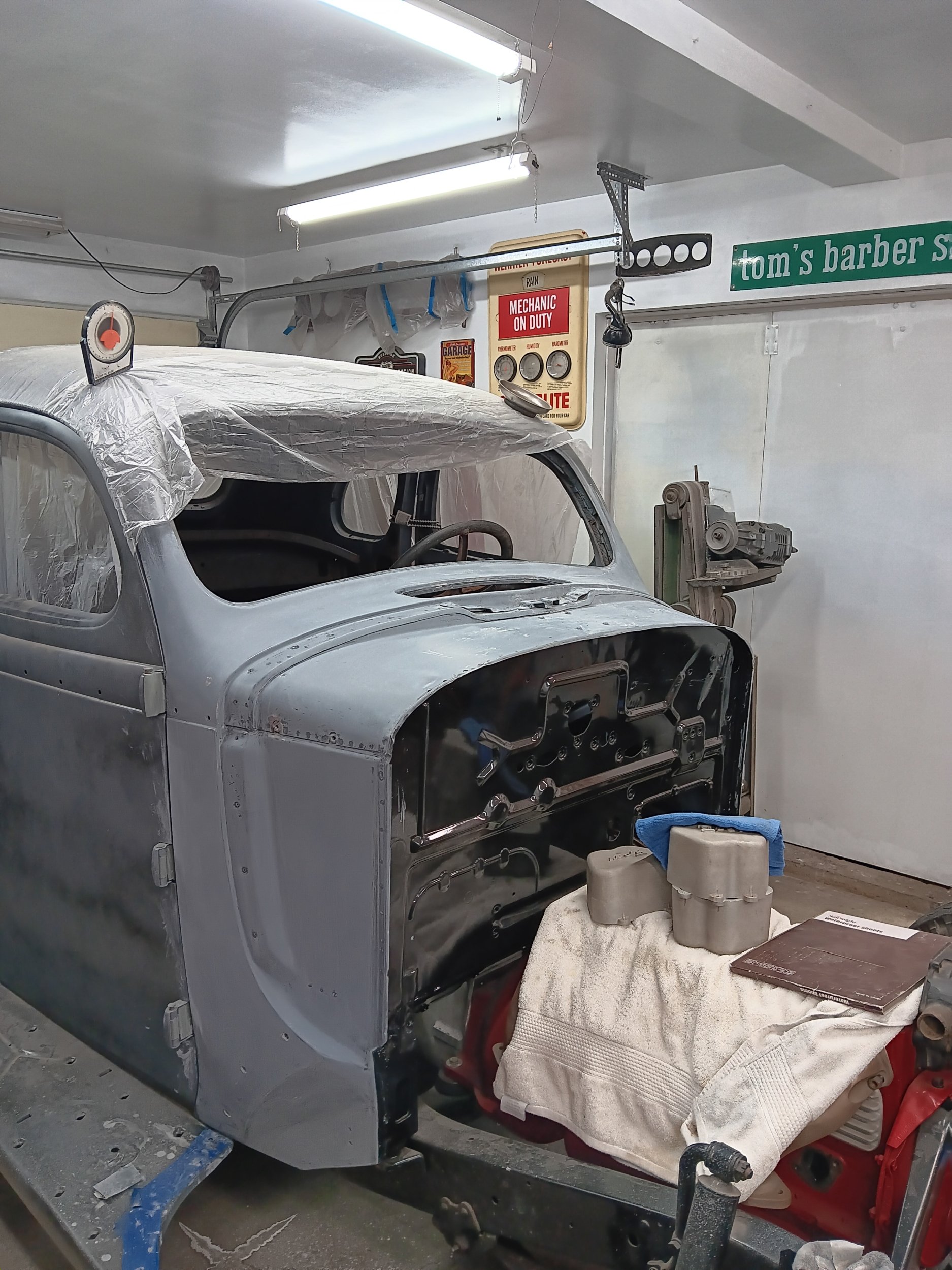

    My winter project. Block , fix imperfections, prime , block.

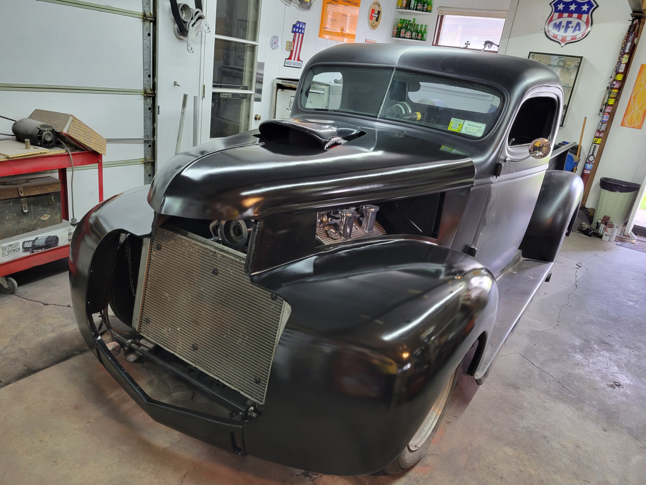

    I got the last pieces (headlights and fender extensions) painted and on, the "work" on this one is just about done.
    The only things I didn't do that was on my list are making windows and figuring out which front rims to get.
