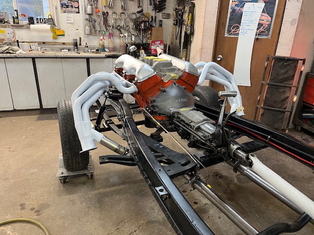

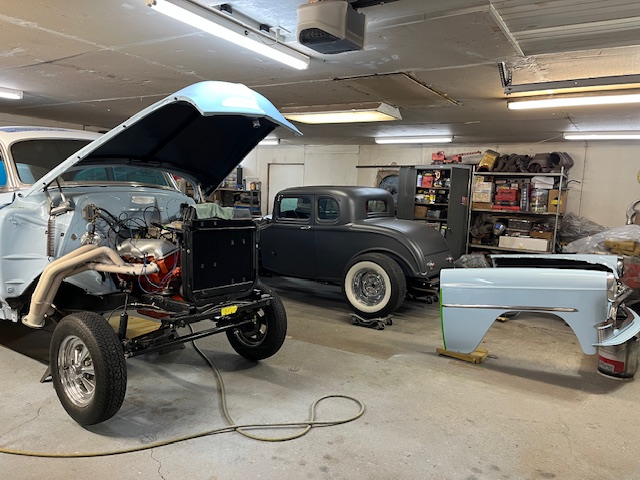

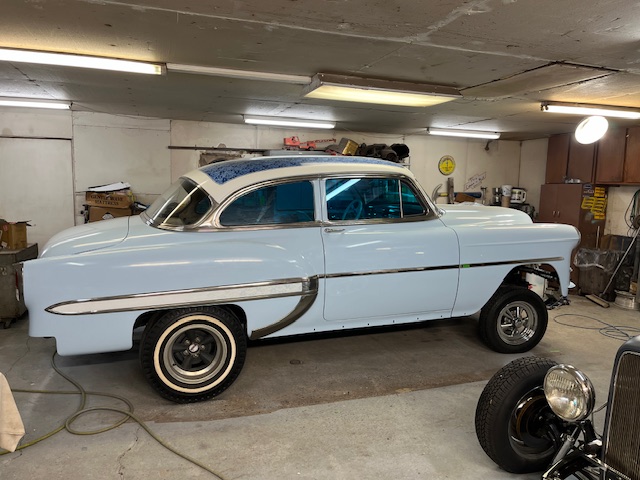

    I originally built the '53 with sa healthy 427, but last year they were going to have 348-409 cars featured at Fallout. As I am only 5 or 6 mi from the track and I had the 409 built about 1o years ago. and it was just sitting there, I thought why not? Got it all ready and on the Sat of the weekend, The clutch slave cyl failed to release. So back to the drawing board. I'll be 78 next year, so my son may run it.

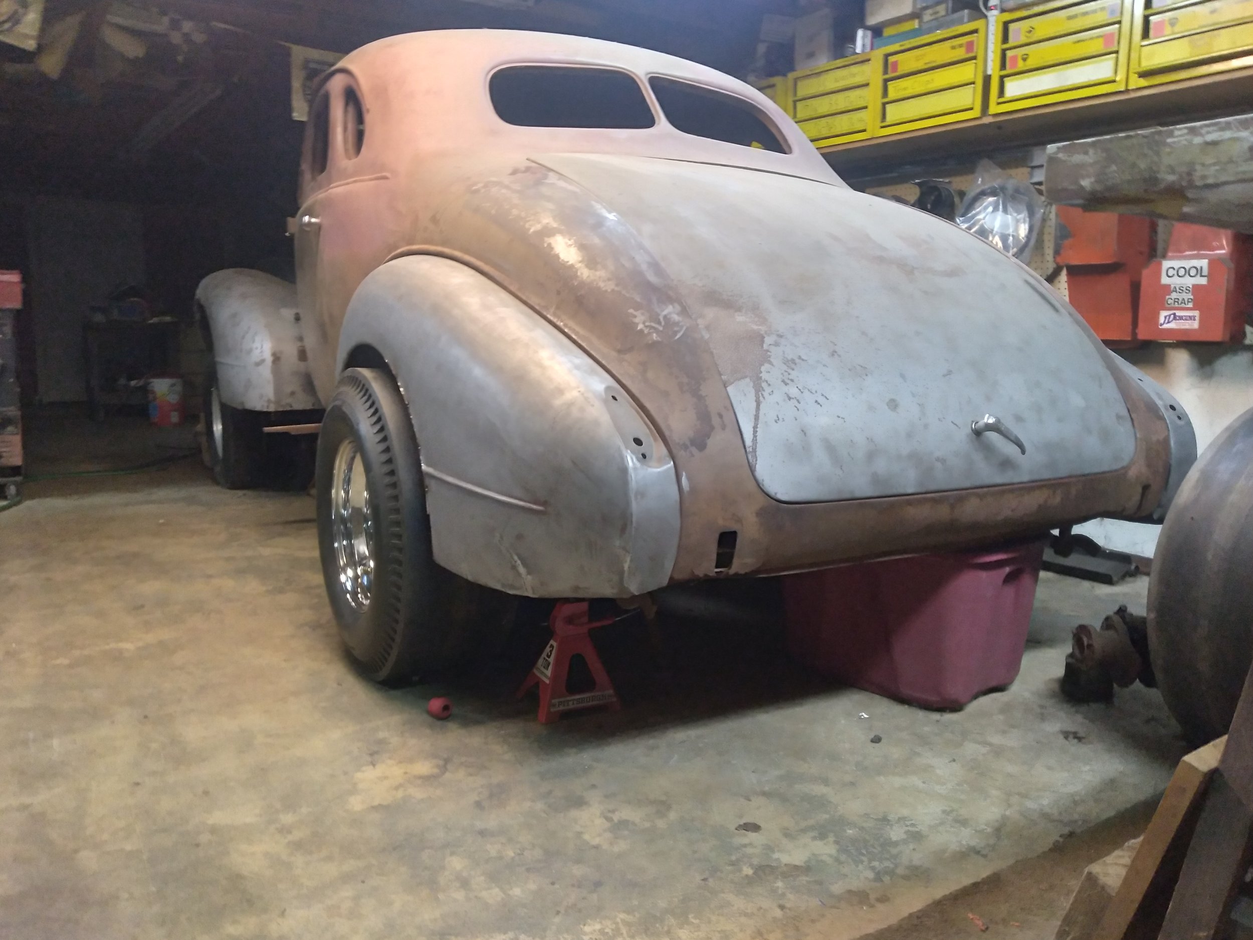

    Did you make the fender well headers or were they something you bought? I have a 37 Pontiac that will get one of my 409 engines and well need to figure that part out for this car.

    The headers are something I made from a set of Patriot tri-5 BBC. I had a set of 409 flanges and did a bunch of cutting and welding. I have pictures if you would like them. I also have another set of flanges.

    I did find a company that well sell a kit for the W engine (kinda pricy I thought). I have a long way to go before I'm ready.
    Would be great to see some pictures of how you did it, could help my piggy bank in my decision on how I attempt to pull it off. I have small and big block engine options for this car also.

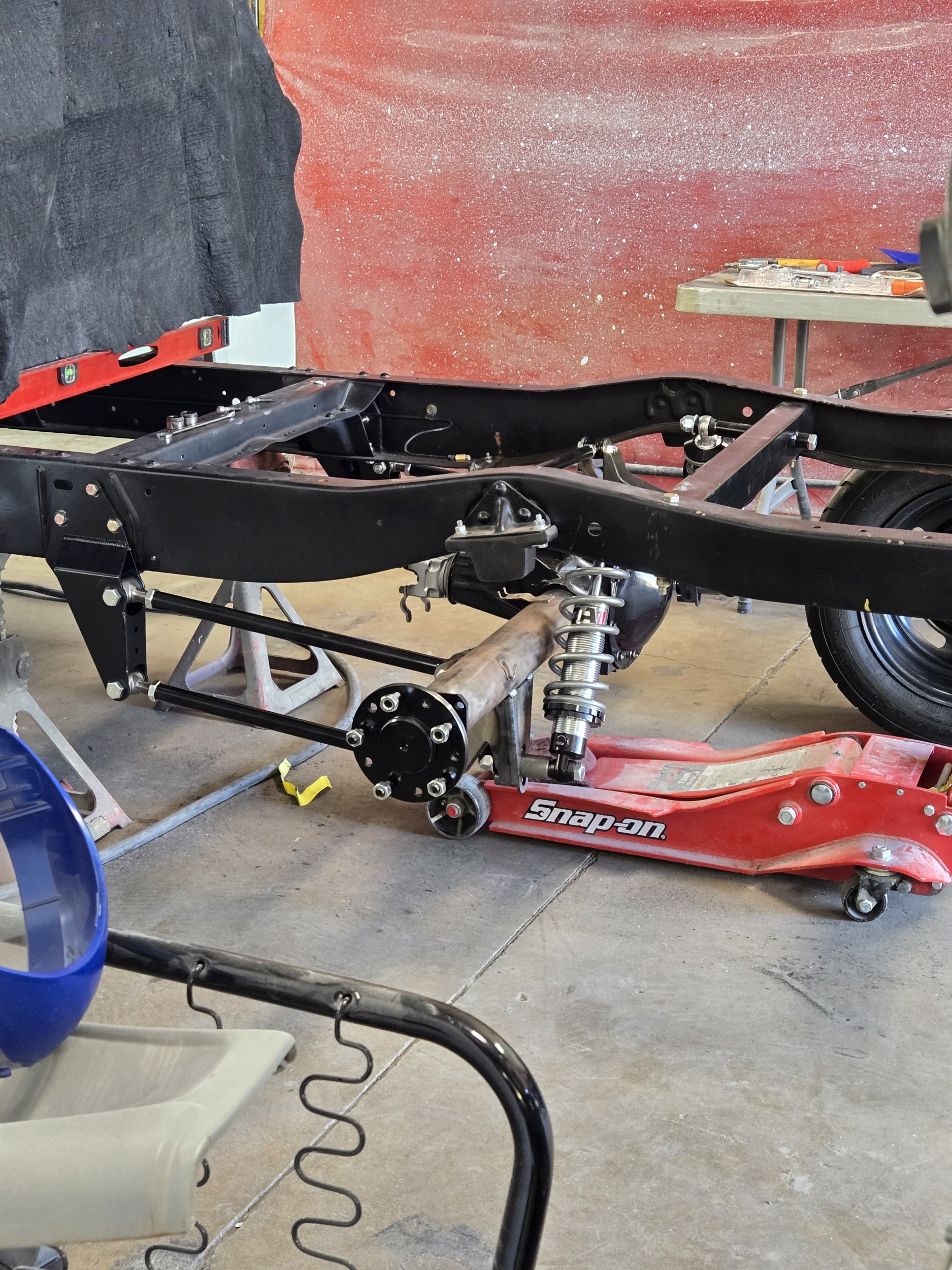

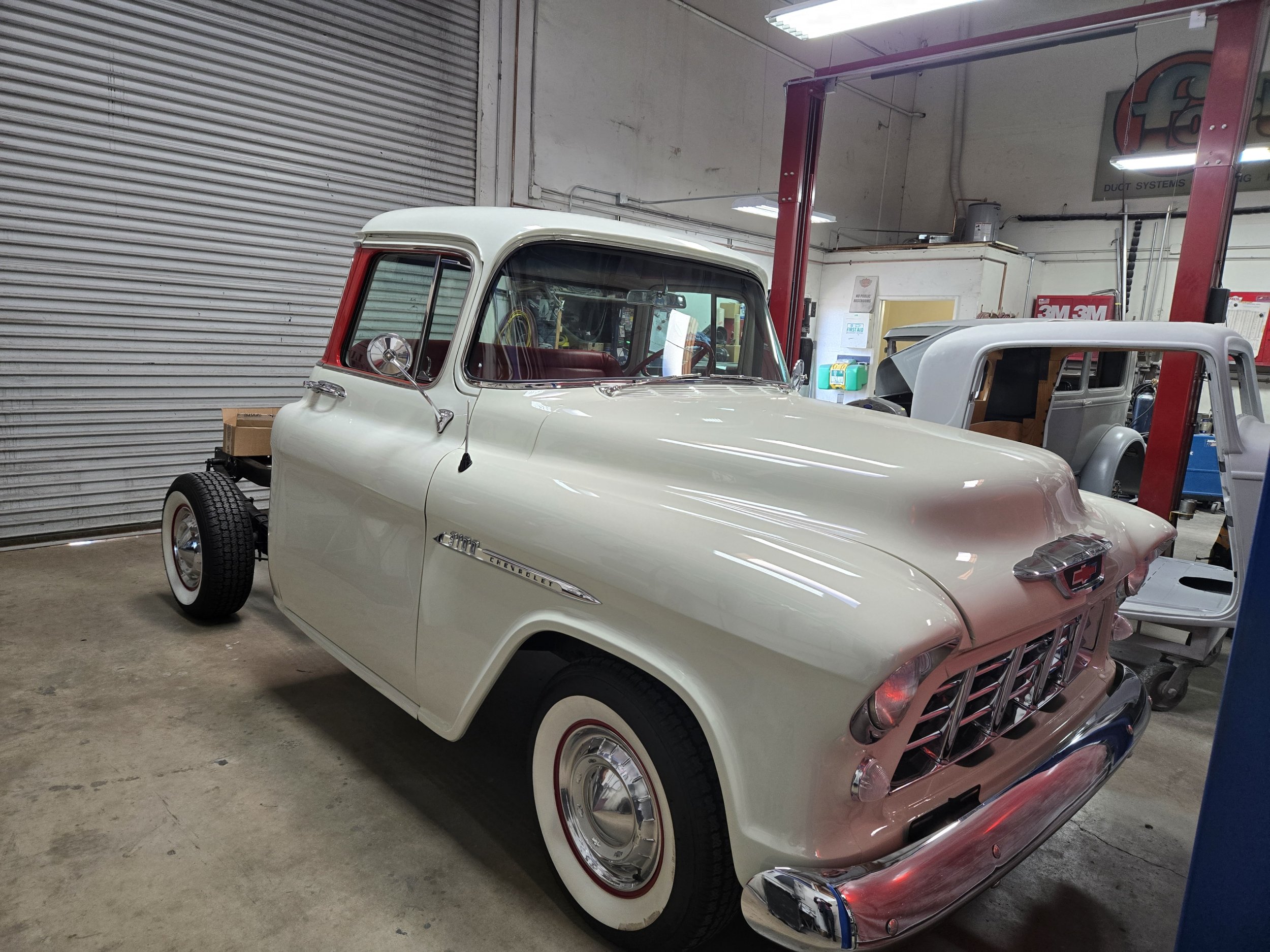

    IMG_20241221_173211.jpg My kid drove up to L.A to get the donor Tempest while I stayed at the shop and put a 4 bar in a Cameo. 20241221_081052.jpg 20241221_125301.jpg

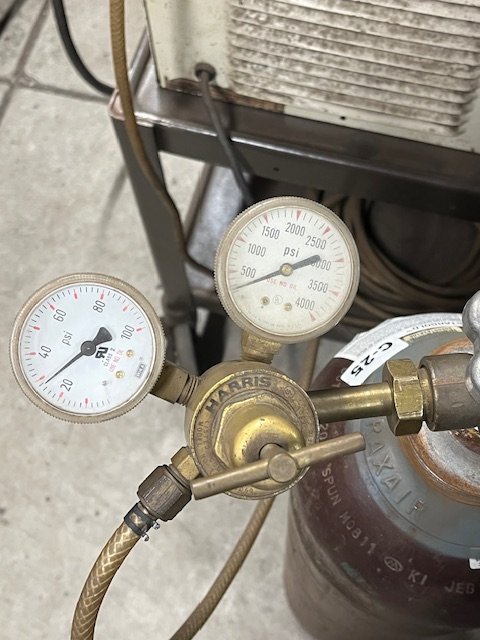

    On the flip side of that. I had a newly filled tank of argon. I forgot to close the tank valve knowing that the mig trigger had an ever so tiny leak. There went good money into the wind.

    Hey Phil , it was a Heidts kit... IMO the shock angle is a little too much for my liking. I told the owner I could make new lower mounts if he decided to do so.

    When I put the 9 inch in mine I thought the stock angle was a little extreme so I put the new mounts a little more inboard.
    Now of course that means a shorter shock but with the lowering springs I needed a shorter shock anyways, so now I need a shorter shorter shock. Lol
