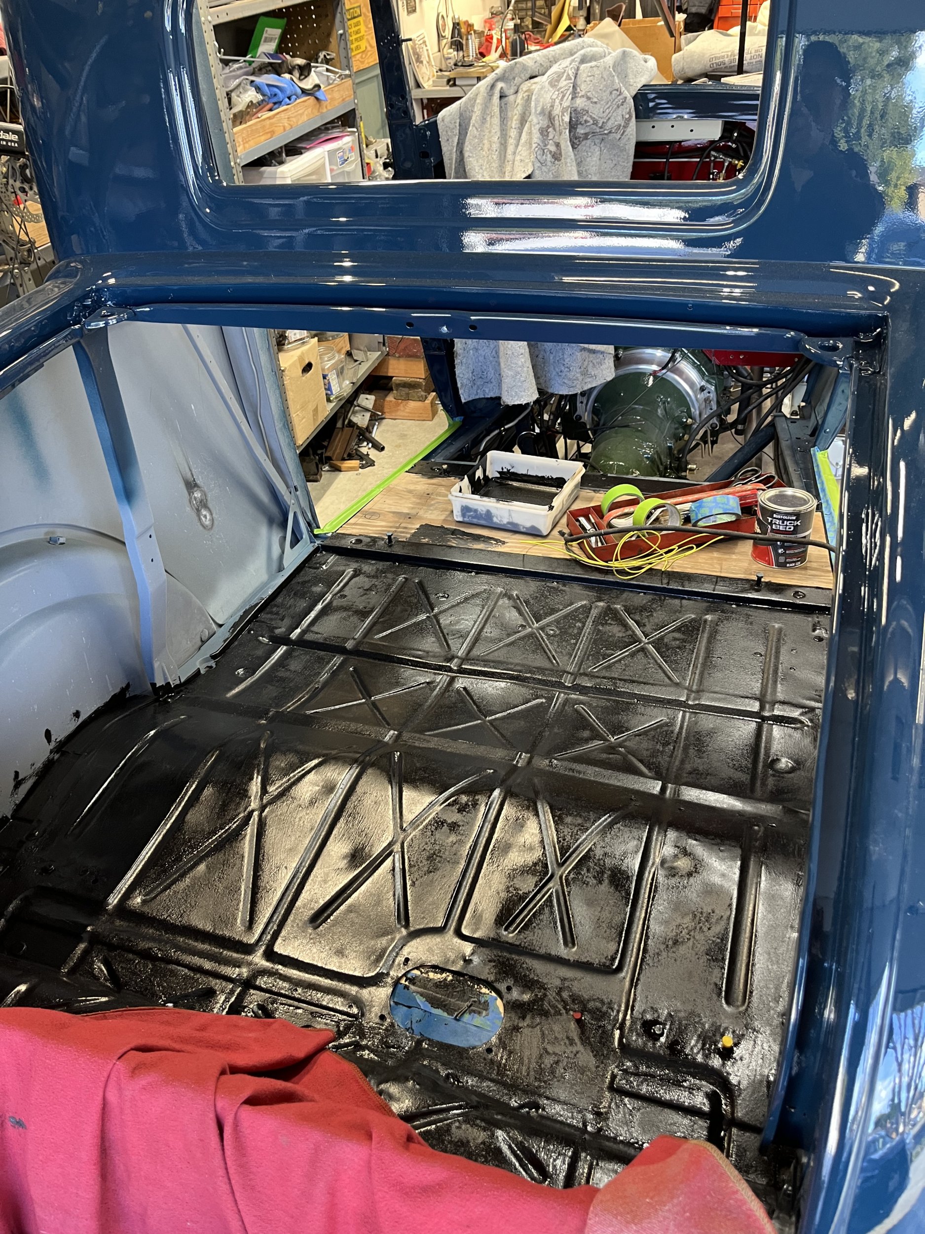

    IMG_7394.jpeg Applied bed liner to the floor. Floor is way too nice for dyna mat

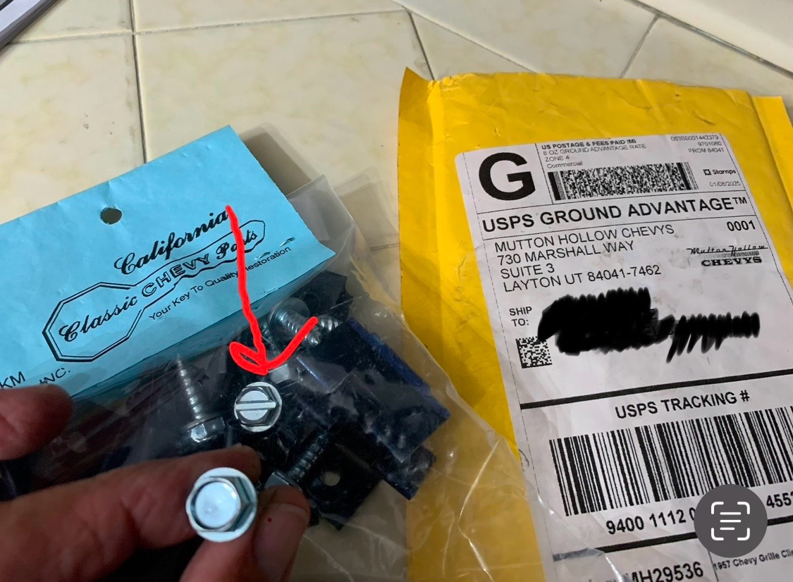

    Arrived late this evening. Working on what I’m going to say about this in the morning. Not happy about cheap Home Depot type screws. Should be like the one I’m holding onto. IMG_3733.jpeg

    Cripes, I hate those things, the corners round off at the first use.

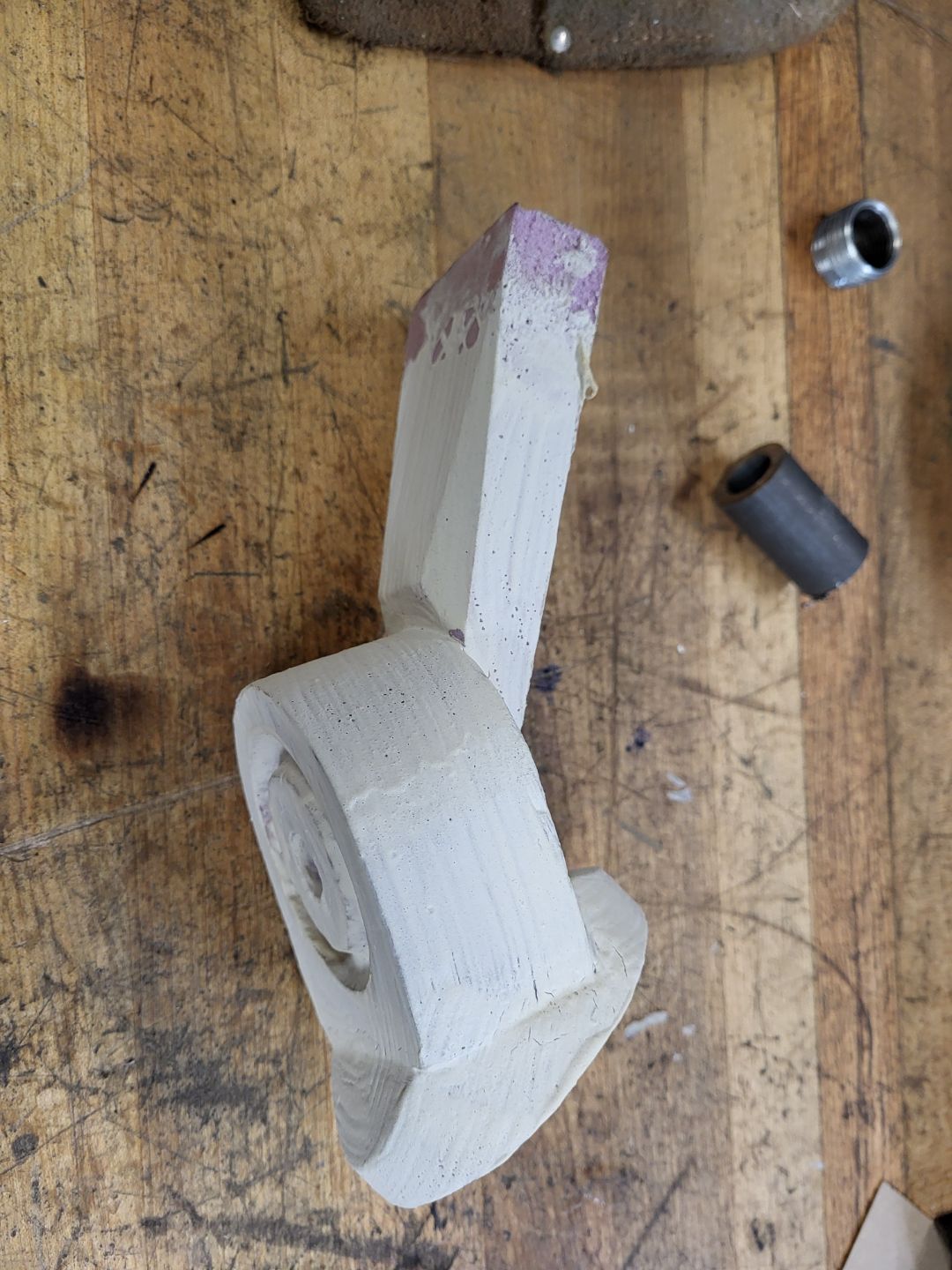

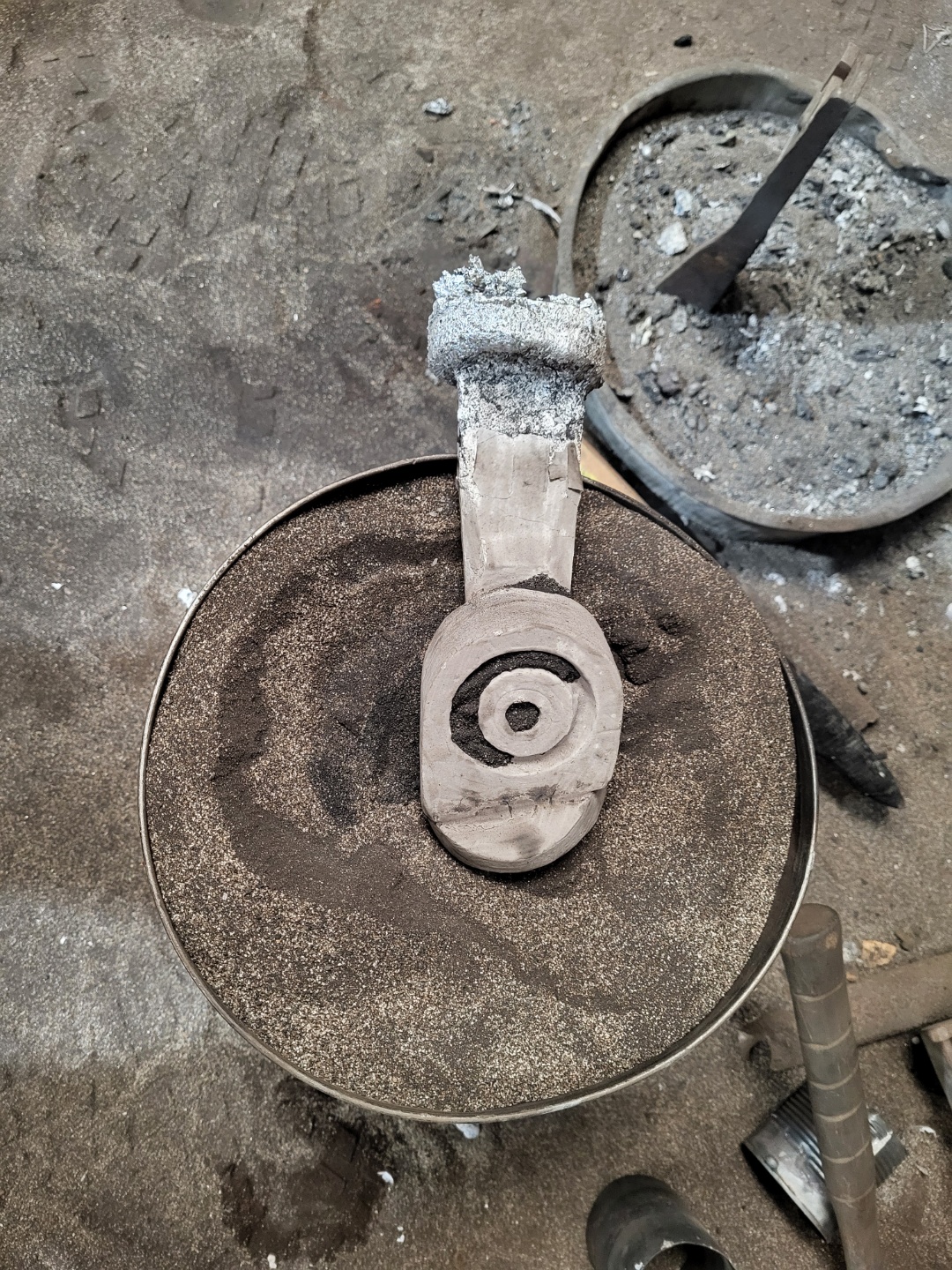

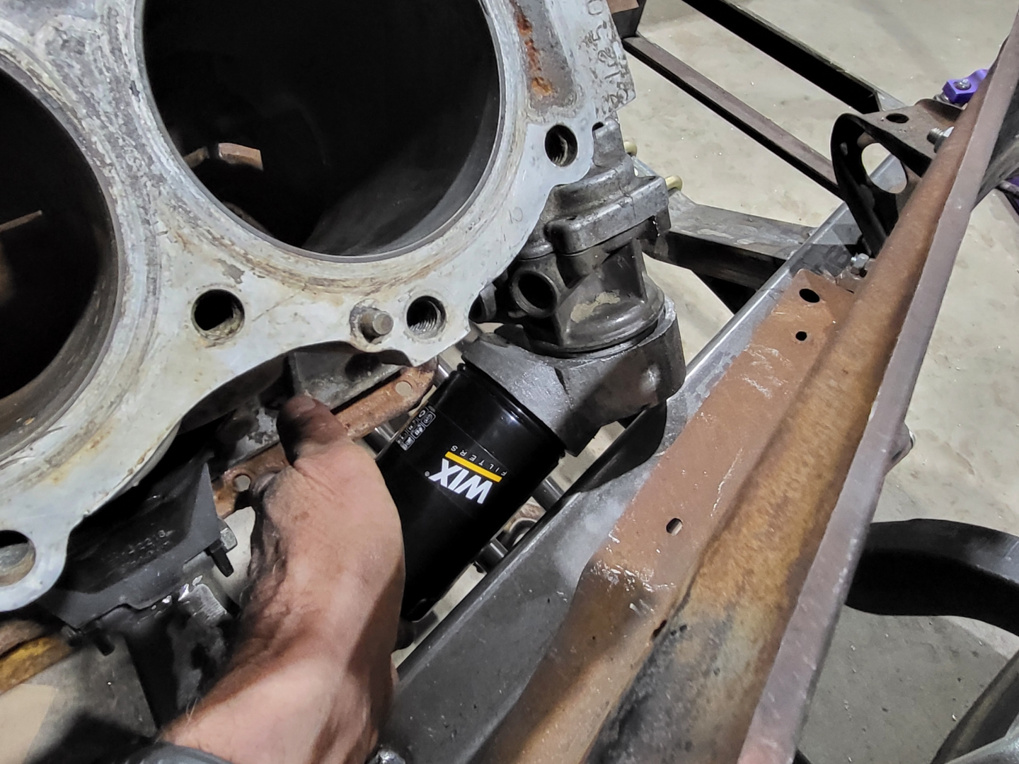

    I have been working on repositioning the oil filter on the 215 Buick to clear the frame rail in the Ruby. I started with a universal re-locate kit, but the adaptor was still to large. So I carved some foam, glued the pieces together and coated with a thin layer drywall mud and poured.
    This is the conflict I was up against, and my solution. I tried going vertical but had interference with the tie rod. So, the most open area available was parallel with the pan in a horizontal orientation. In the process I am also going change the thread of the ****** to match the smaller late model 5.7 filter. It may have a tendency to unscrew in from the pump so I will add some sort of retainer.
    Resized_20250105_164008_1736868222976.jpeg Resized_20250113_103336_1736868229276.jpeg Resized_20250113_140428_1736868259139.jpeg Resized_20250114_173329_1736905931653.jpeg Resized_20250114_163051_1736905970485.jpeg Resized_20250117_141506_1737166613869.jpeg

    ^^^^^ That is awesome!

    Brilliant!
    I've always been in awe of guys that do home casting.

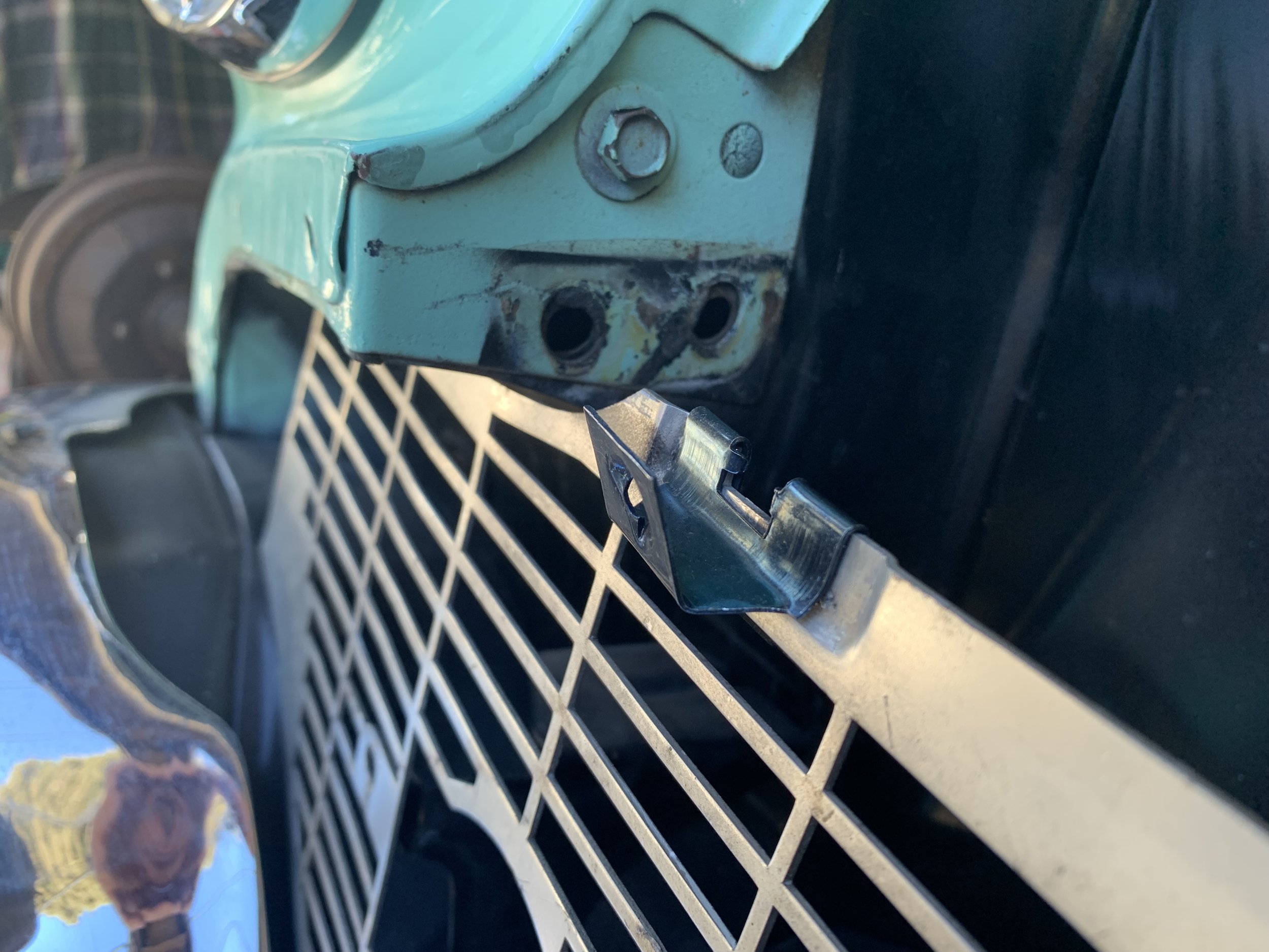

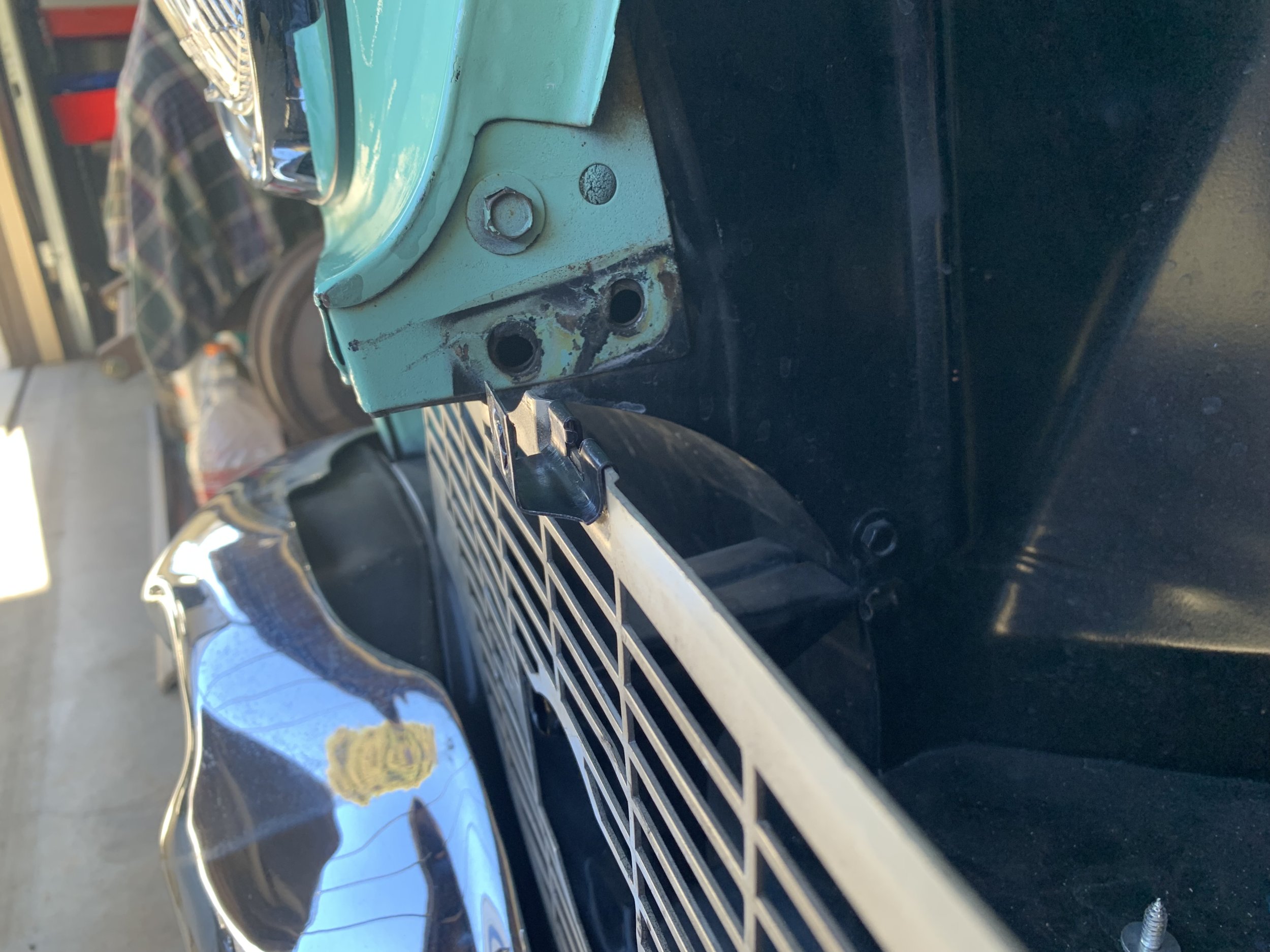

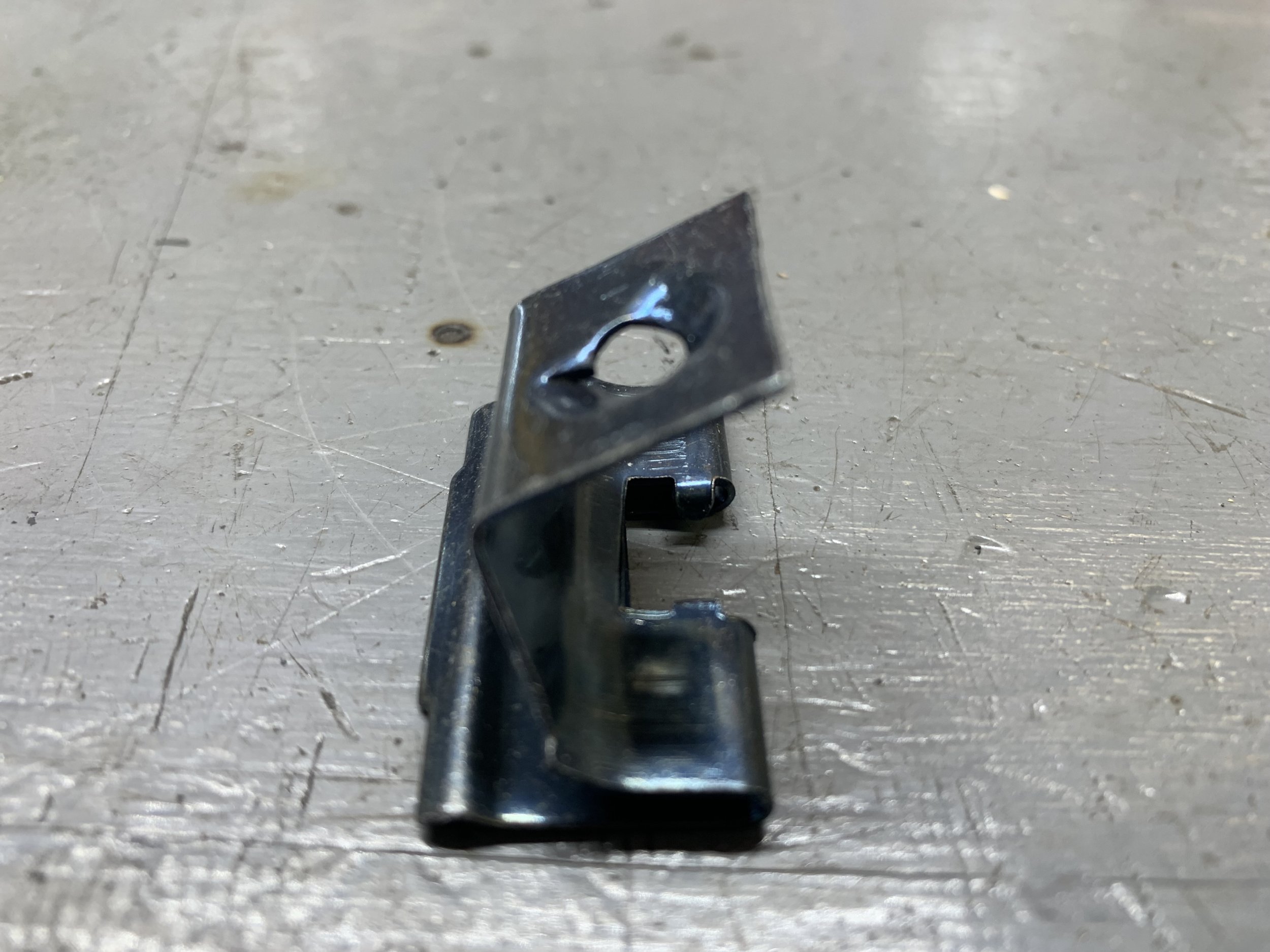

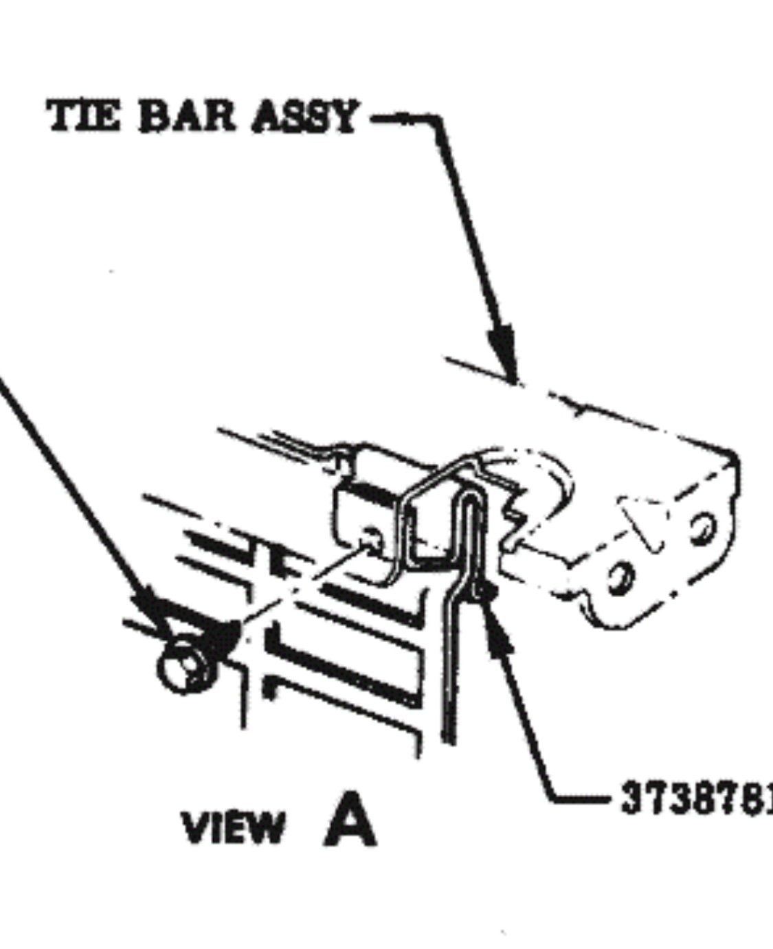

    More to deal with. Upper clips not formed correctly. Look at clip face to witness mark of the tie bar on the fender. IMG_3738.jpeg

    Excellent

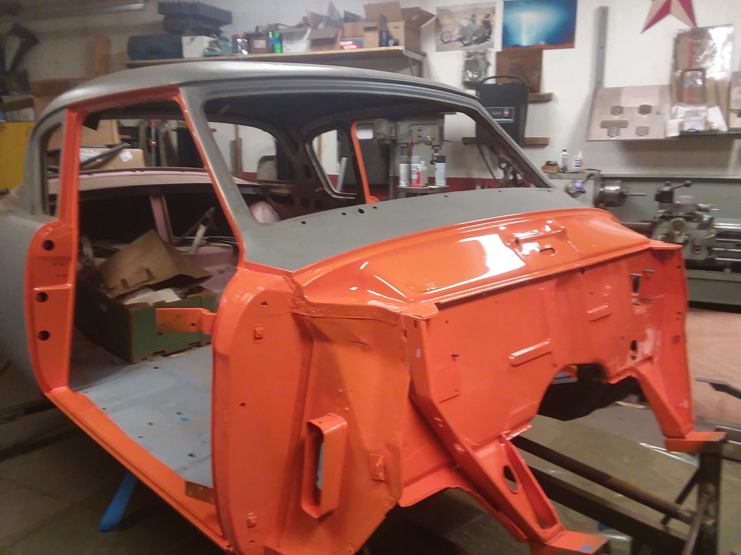

    Plug and smooth paint this firewall Studebaker liked lots of huge holes 20250112_120751.jpg

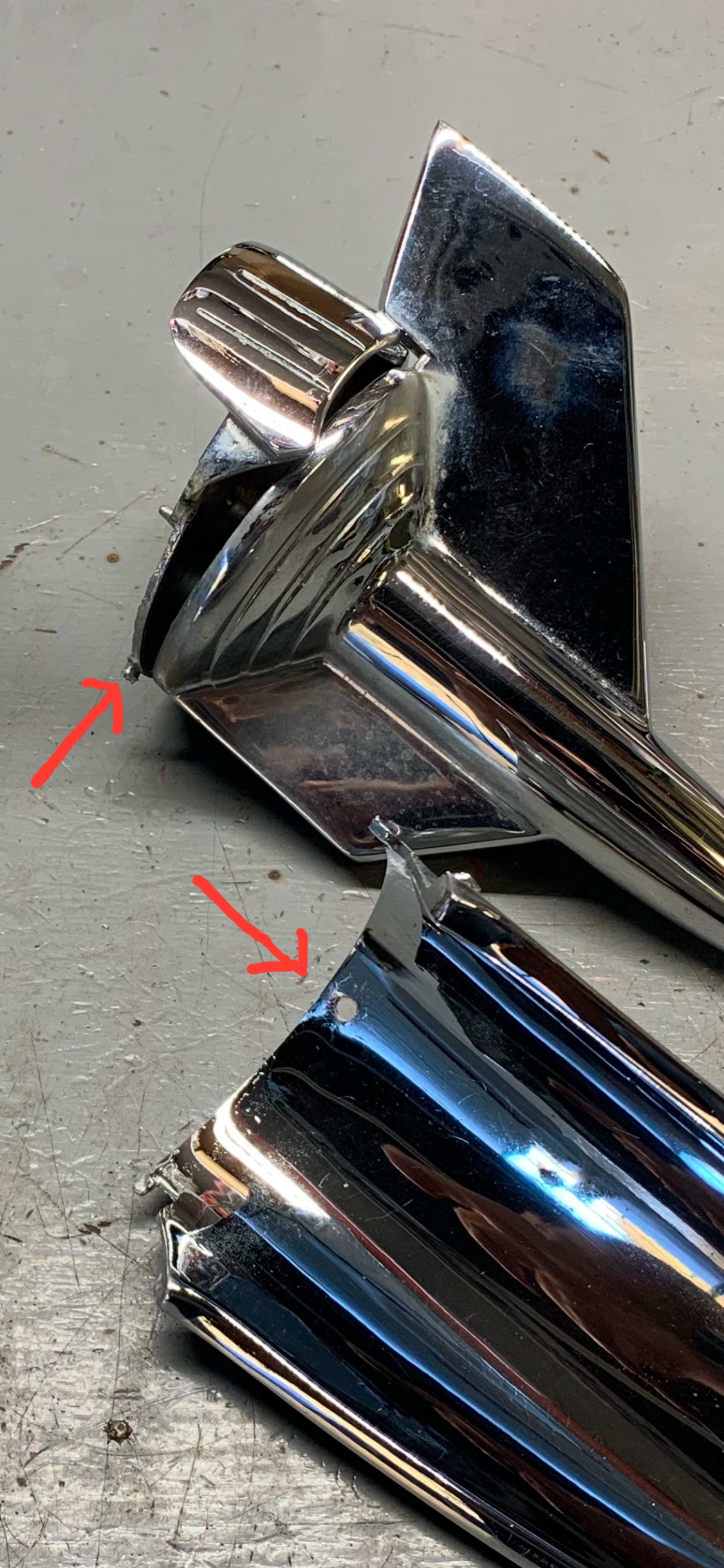

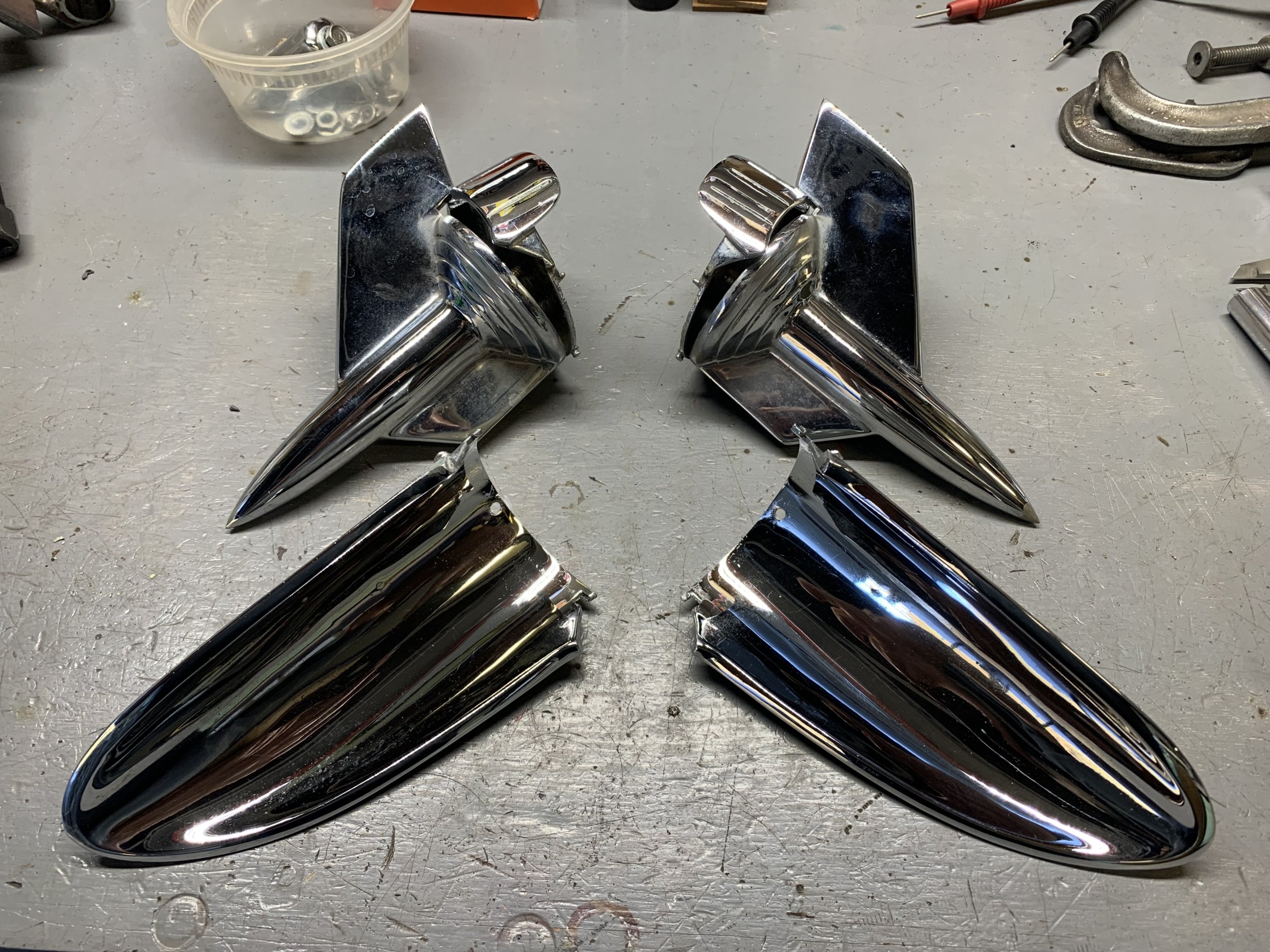

    Forgot to show the process on how I mechanically get these two parts back together again since the friction head of the rivet had been grind off prior to me owning it. So “a picture is worth 1000 words” will have to do.
    I was originally going to cement a piece of 1/4” key stock in the channel of the rocket point (right arrow) then drill and tap it 8-32. But I settled for the easier route instead. IMG_3745.jpeg IMG_3746.jpeg

    I remember the rockets on my 57 took a bit of fiddling to make em look half decent...

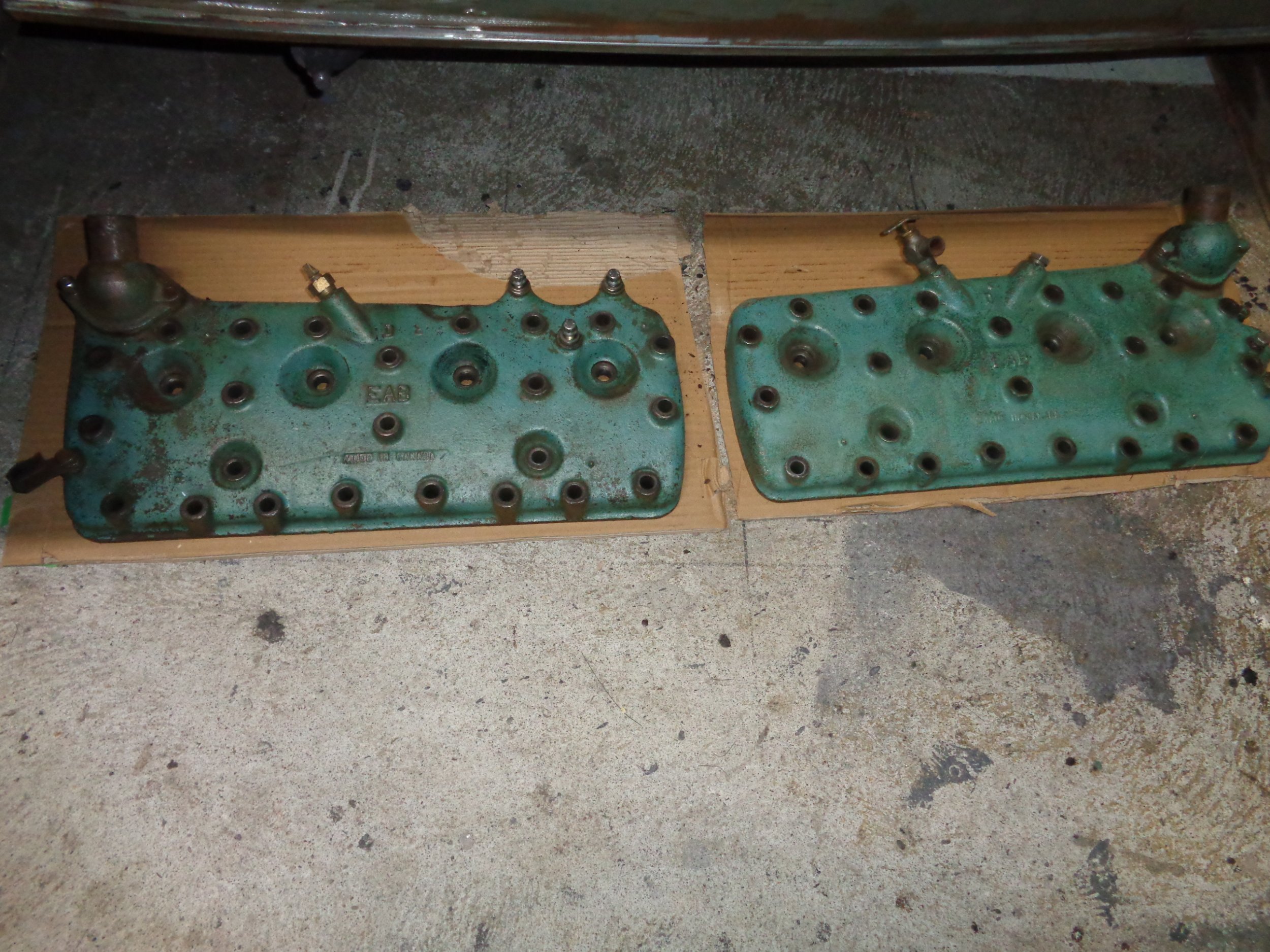

    Started cleaning up, measuring and inspecting the flathead I drug home last week. A complete teardown is in progress. Story is, it was stored for decades after being refreshed and replaced with a hemi in the seller's friends '30 A coupe. Supposedly only 3000 miles on the rebuild. It is standard bore, 4" stroke crank with no ring ridge and the hone hatch still showing. It is within out of round spec and doesn't appear to need a trip to the machine shop. (I have another in the shop now). Found a few minor things that need to be tended to but overall it's looking good. It was painted black years ago but removed easily with a wire brush. Came with everything needed to build a reasonably priced runner. including a nice set of unknown tube headers, early Fenton dual deuce with 94s, bell housing adapter, new fuel pump and a barrel of other parts. Plans are to adapt the early intake with a PCV system and use what I have on hand to build a custom combination fuel pump stand/vented filter/ oil fill cap. This one will go in the coupe and the other will be a mancave coffee table until needed. DSC08113.JPG DSC08077.JPG
