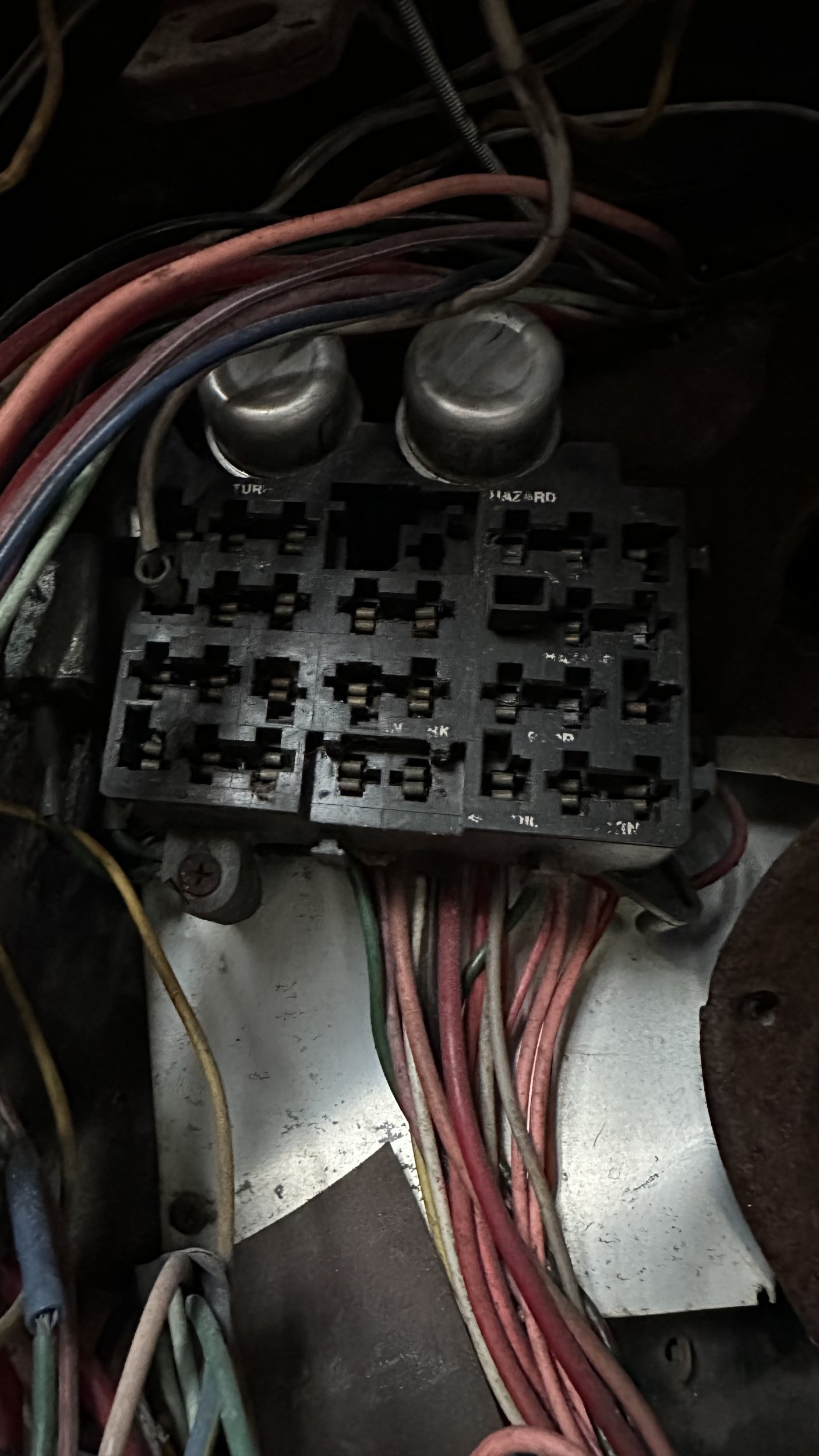

    Looks similar to the layout on my Painless, if nothing else you can see what fuse is what. My original painless from the 90's had thick pink wires like that, but they were numbered to correspond with their chart (before they labeled wires).

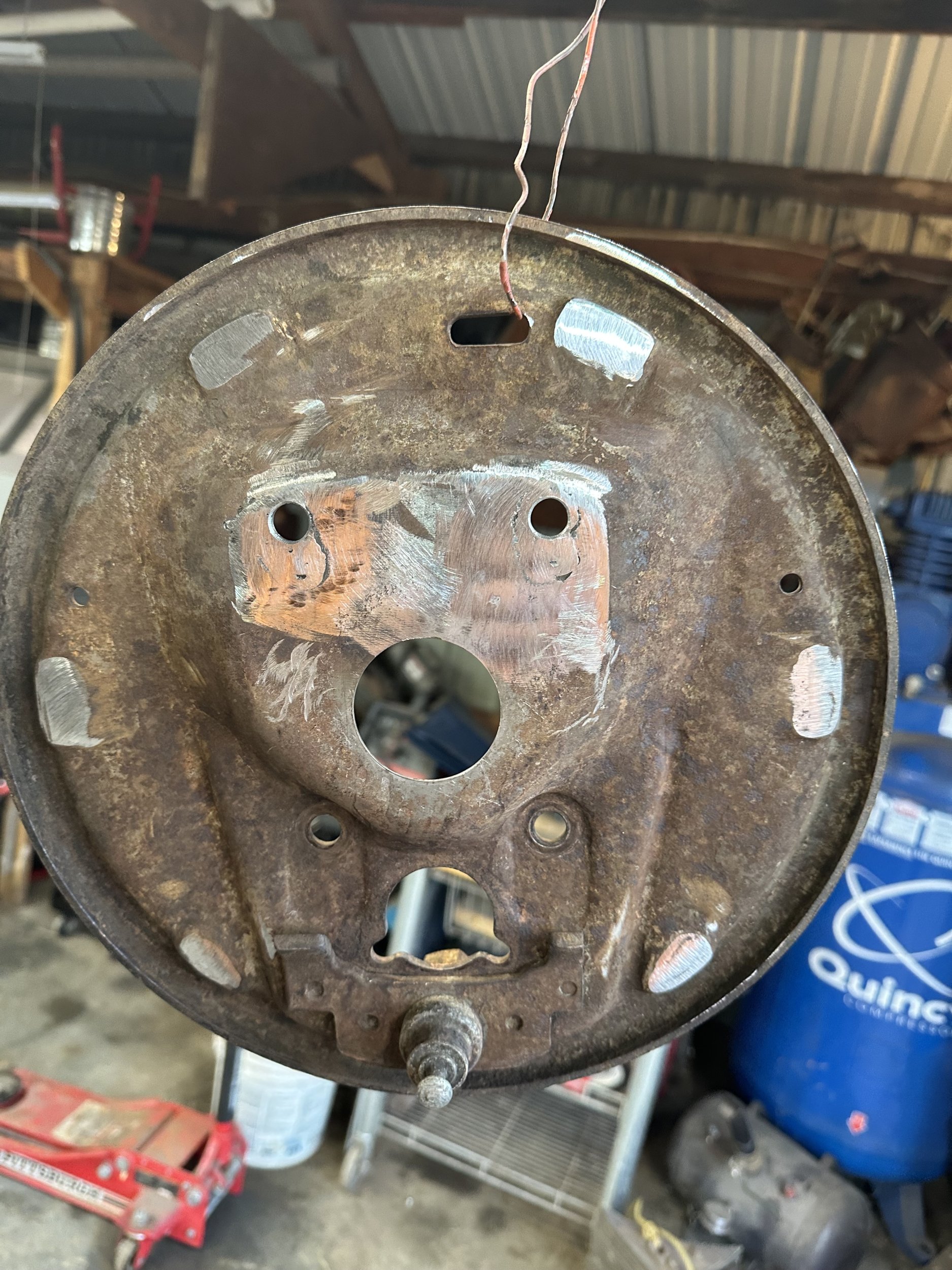

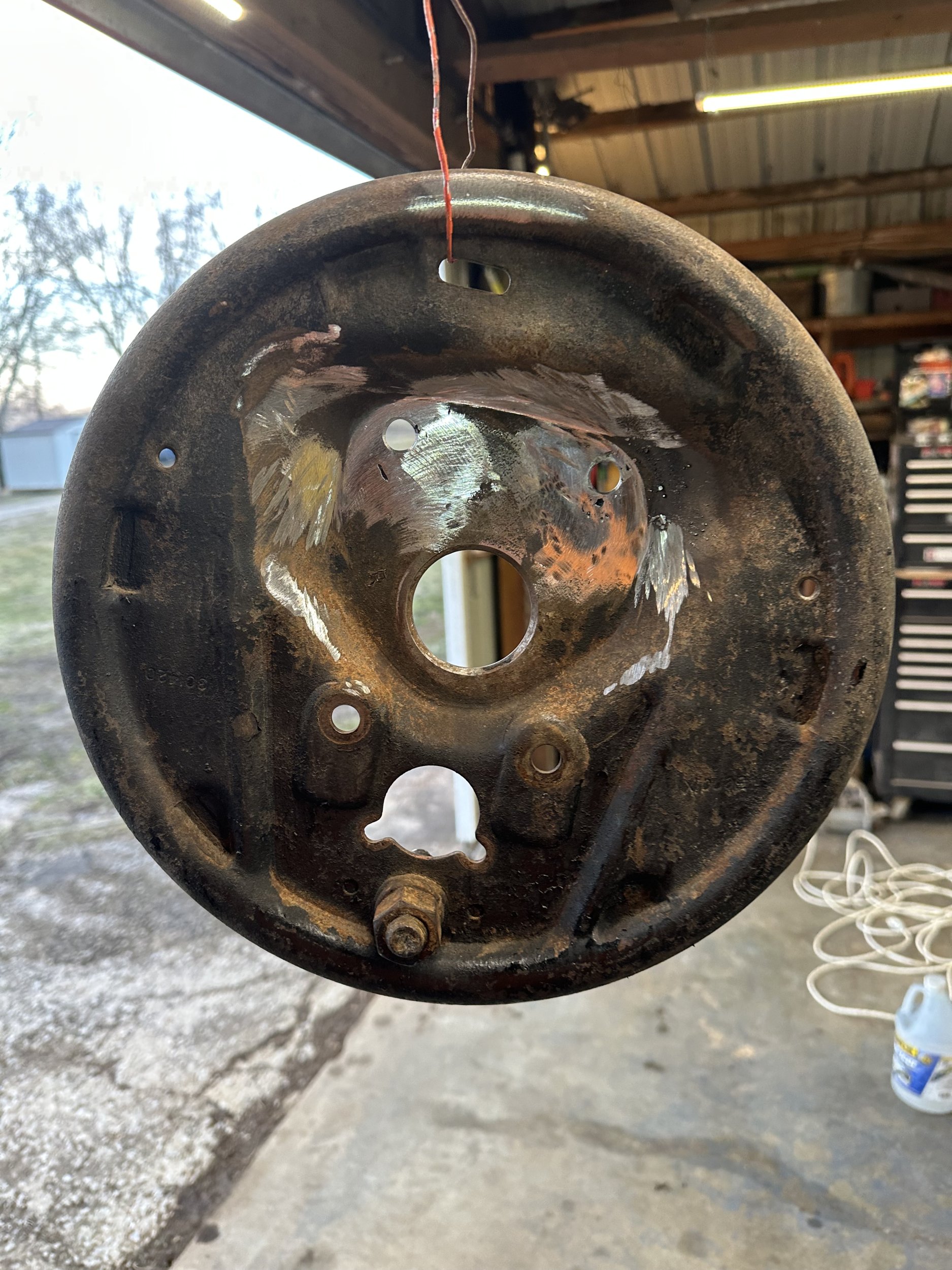

    Lumpy, we are down to the front brakes, master cylinder, and shifter. We are using Bendix backing plates from a car on the front and someone had drilled a bunch of extra holes on the lower side and reamed them out when they didn’t line up. Little Truckdoctor welded up the holes and ground down the welds. Then we accurately located the holes and re-drilled them. The last thing we got done was to paint the backing plates before the weather turned cold and snowing. I’m going down to Lloyd’s in March to hang out and work on his wagon. I’ll pick up the shifter then. I’m hoping to have it ready for a car show and open house at my Alma Matter, Ranken Technical College, on April 5. Little Truckdoctor is seriously considering going there for Diesel Technology.

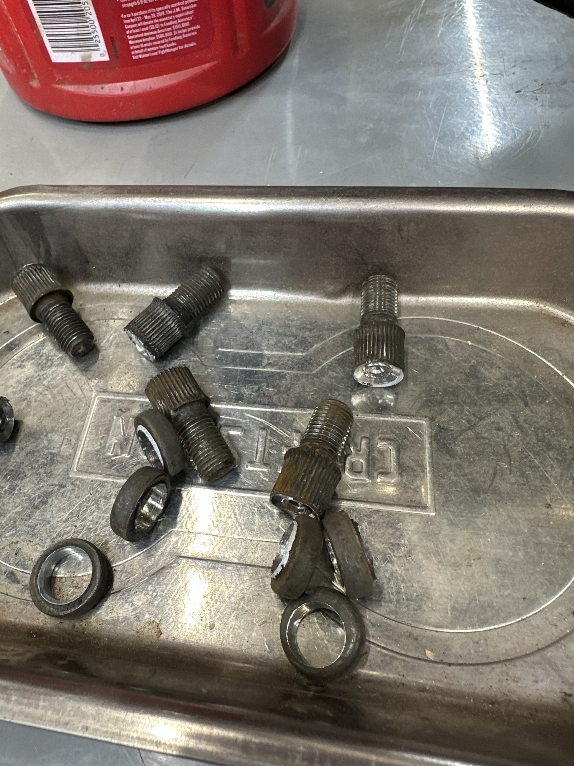

  20. Ok, I’ll shoot some after the paint job, but just to warn you, I got lazy and didn’t bead blast them. I should have taken the time, but was running late the night we painted them.
    Today, we removed the Huck brake drums from the hubs. The Bendix style drums mount differently and I’m going to take the hubs to work and steam clean them. The wheel studs were swedged to the hubs. I’ve read various threads on here, but we’re not completely clear on what people were talking about. Not wanting to buy a swedge cutter or ruin my hubs, we drilled the *** out of each stud, then drove them out forward. I should have taken them out to the shop and used the drill press, but damn, it’s cold out there. We used a hand drill and my arms are tired. IMG_8966.jpeg IMG_8963.jpeg

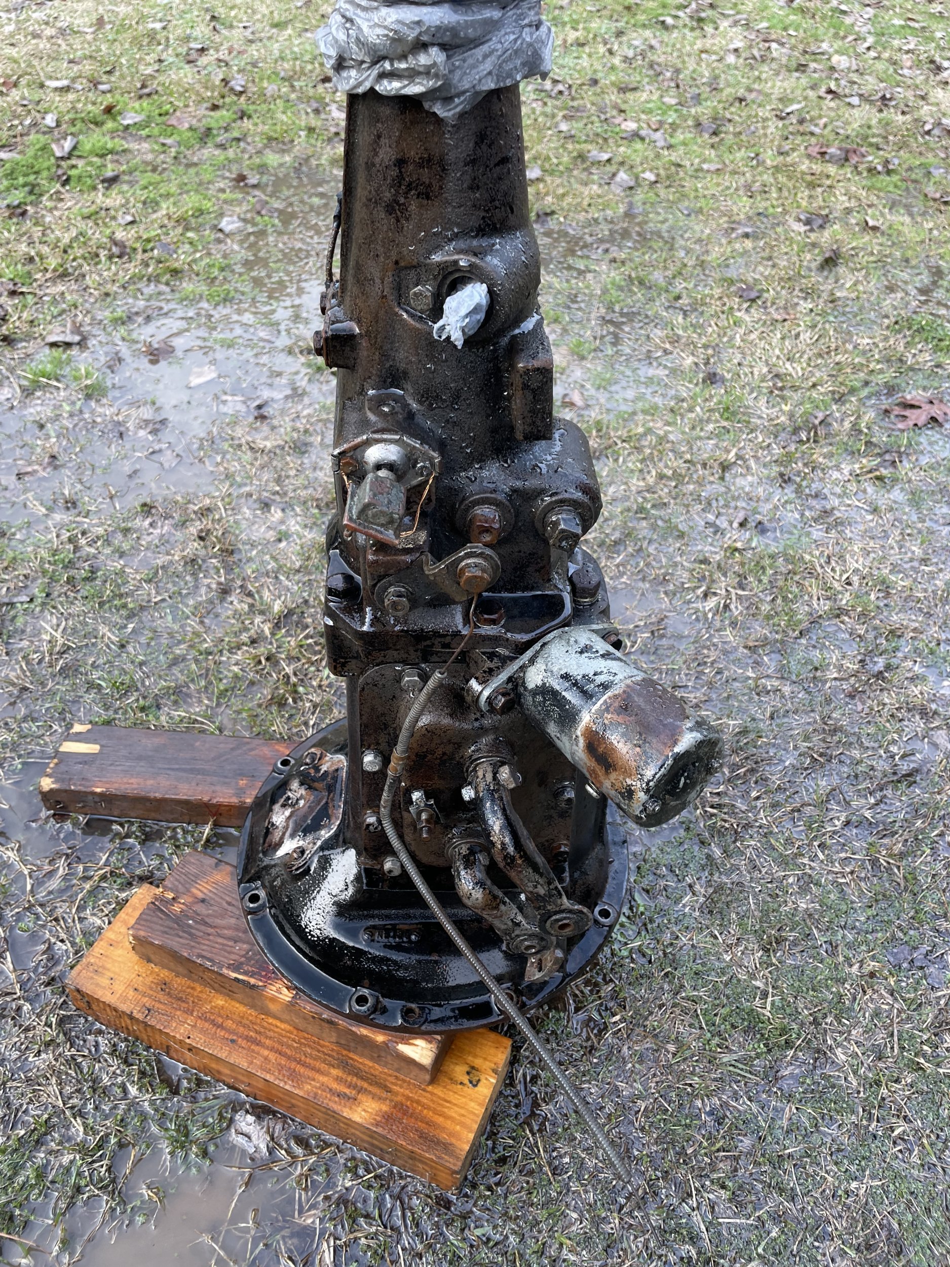

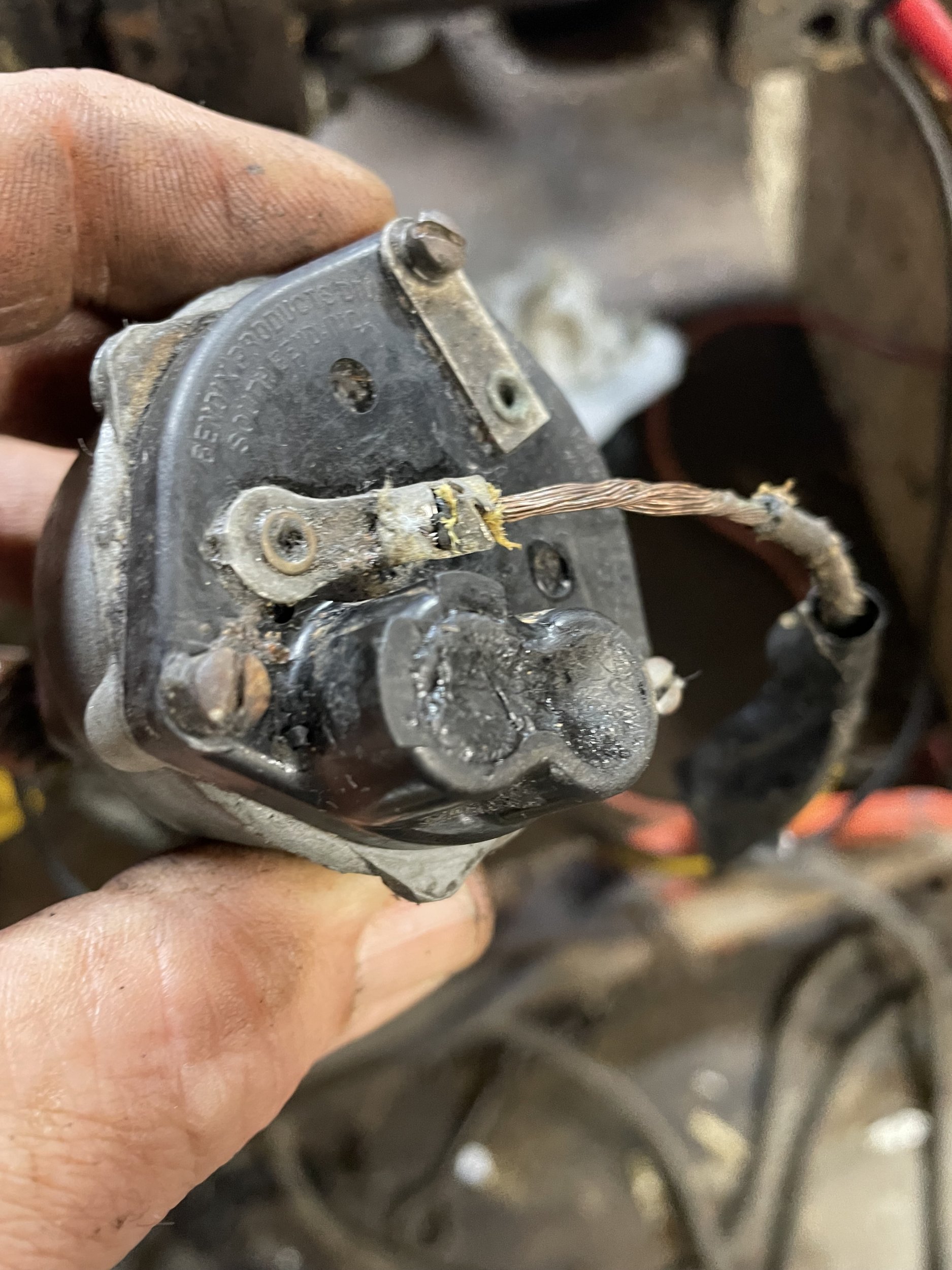

  21. Messing with an R10 OD
    Had this solenoid that came with some parts
    Works. Came with a gm set up so should be 12v still cleaning it up to look for numbers
    The longer one is what was with the Merc trans
    these reverse lockout switches ohm out. But seem to be too short to make contact with the internal shaft IMG_4937.jpeg
    And I guess I need to either carefully unfold the terminal crimp or clean and solder a new wire on the governor.

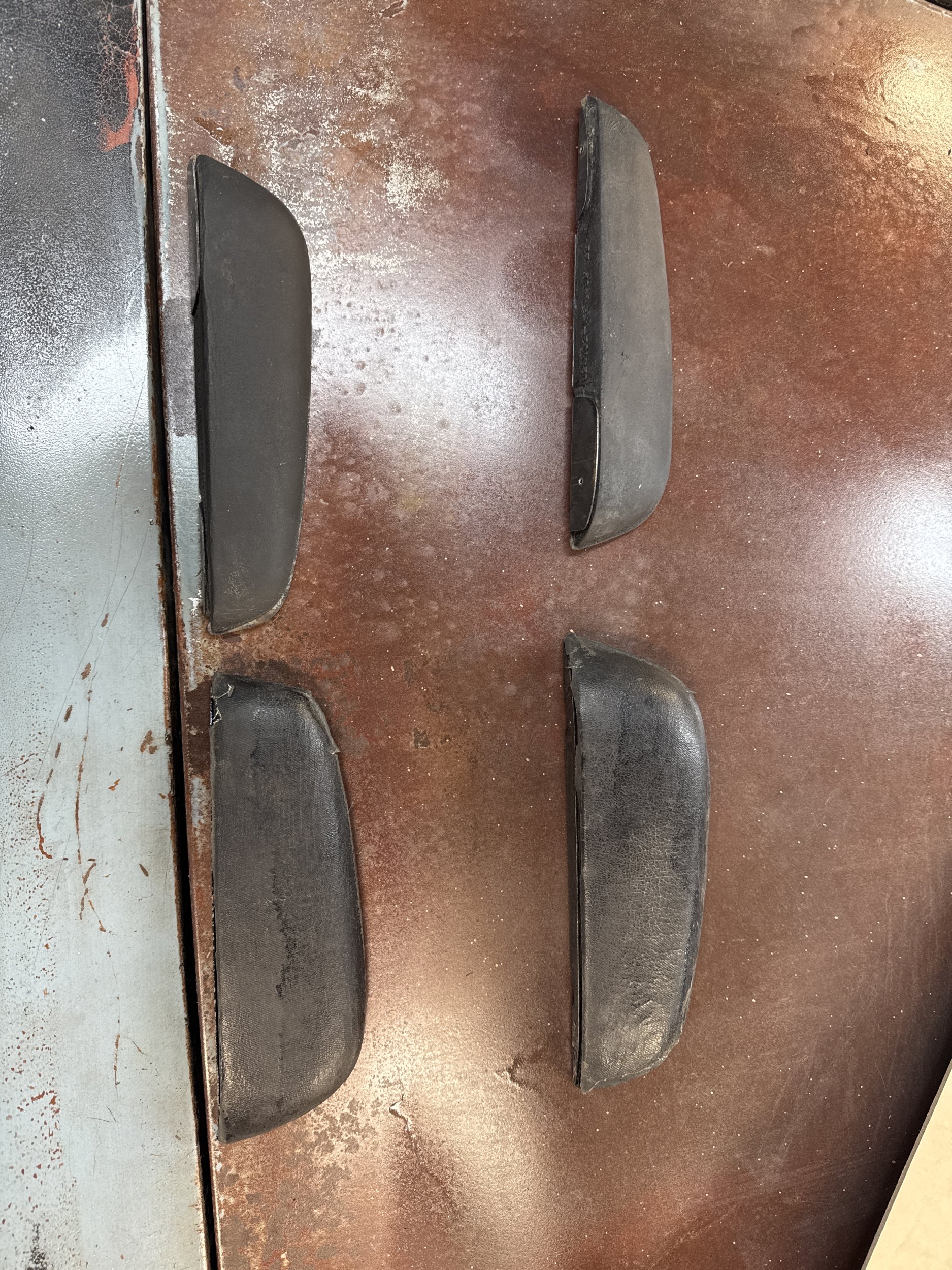

    image.jpg image.jpg Workin on the interior how dose the front and rear arm rests supposed to fit?
    1953 Ford Customline two door

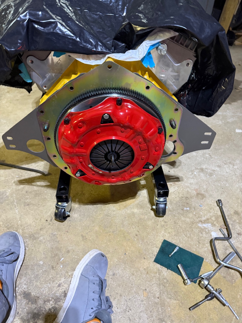

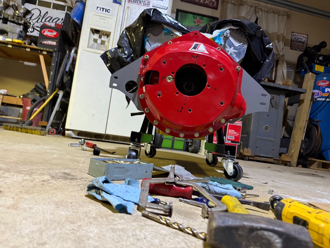

    Clutch done. Bellhousing done. Engine in.
