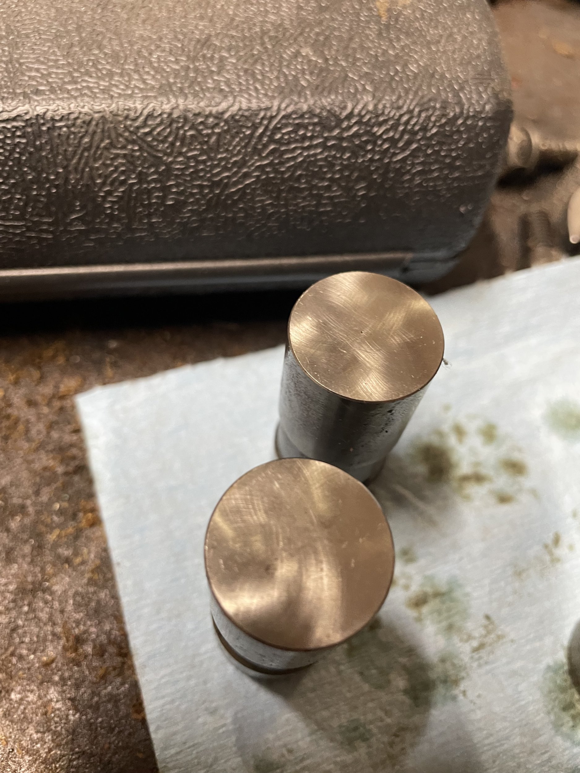

    I’d probably stick with the old, depending on how old. Nothing with flat tappets is getting better.

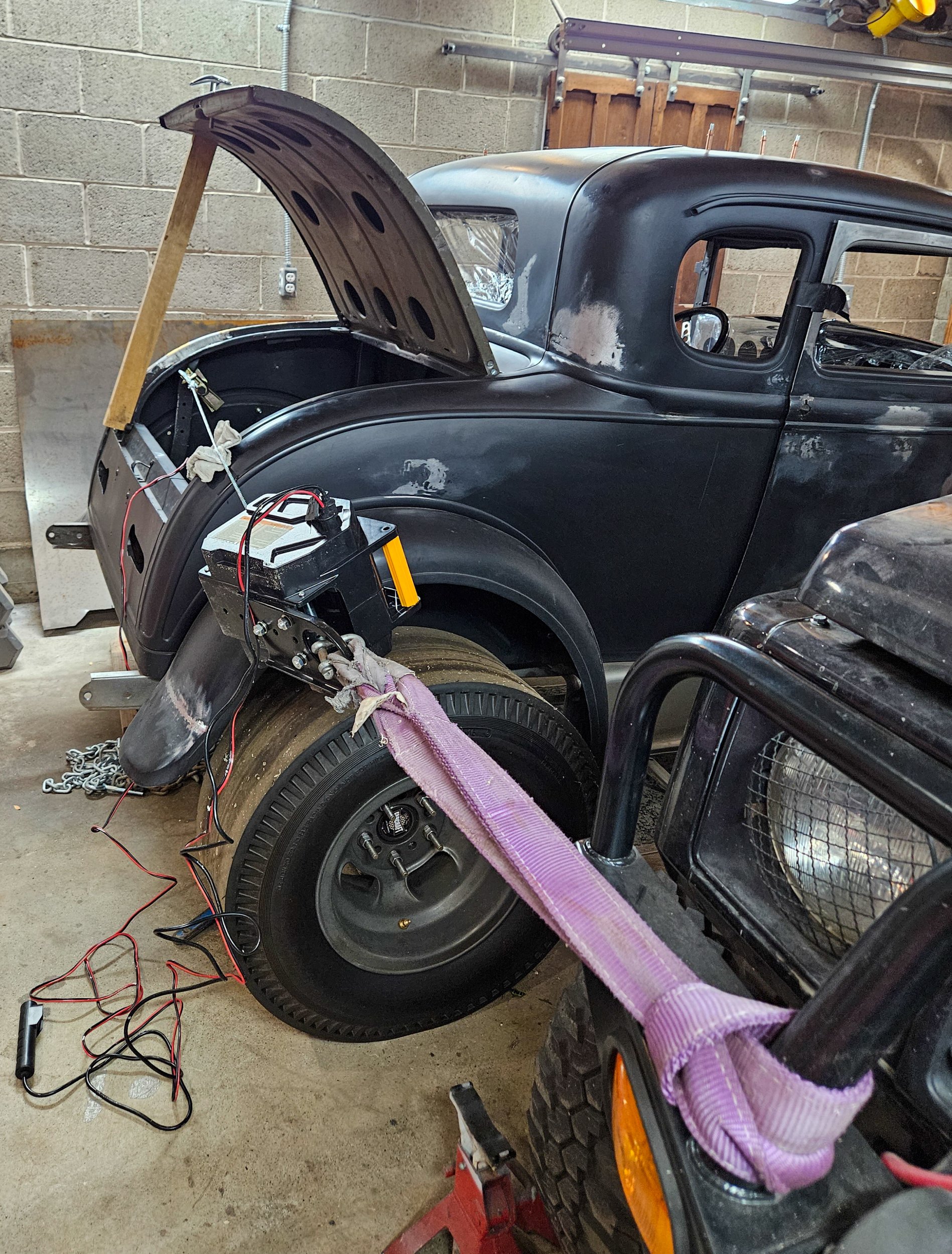

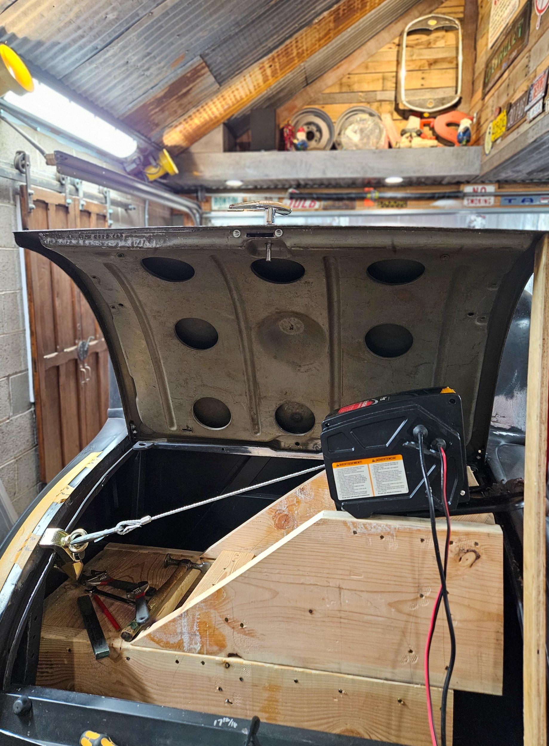

    The first redneck body puller didn't work. It just pulled the vehicles together and flexed the suspensions.
    I had to rig up a fixture that sat inside the trunk. Strapped it to the winch bumper for insurance. It kept the winch from tearing out of the wood.

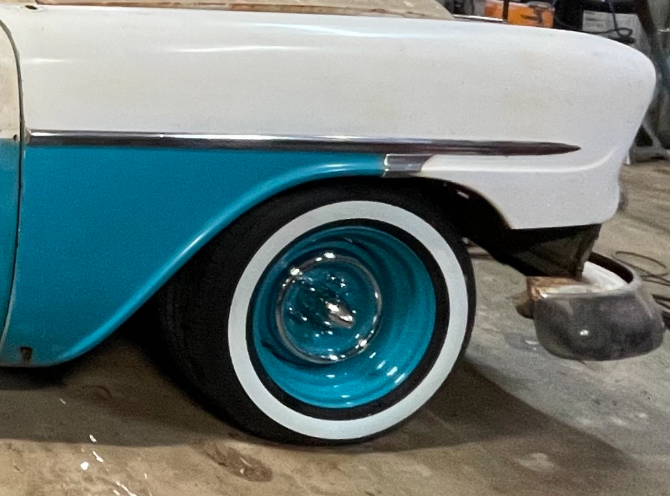

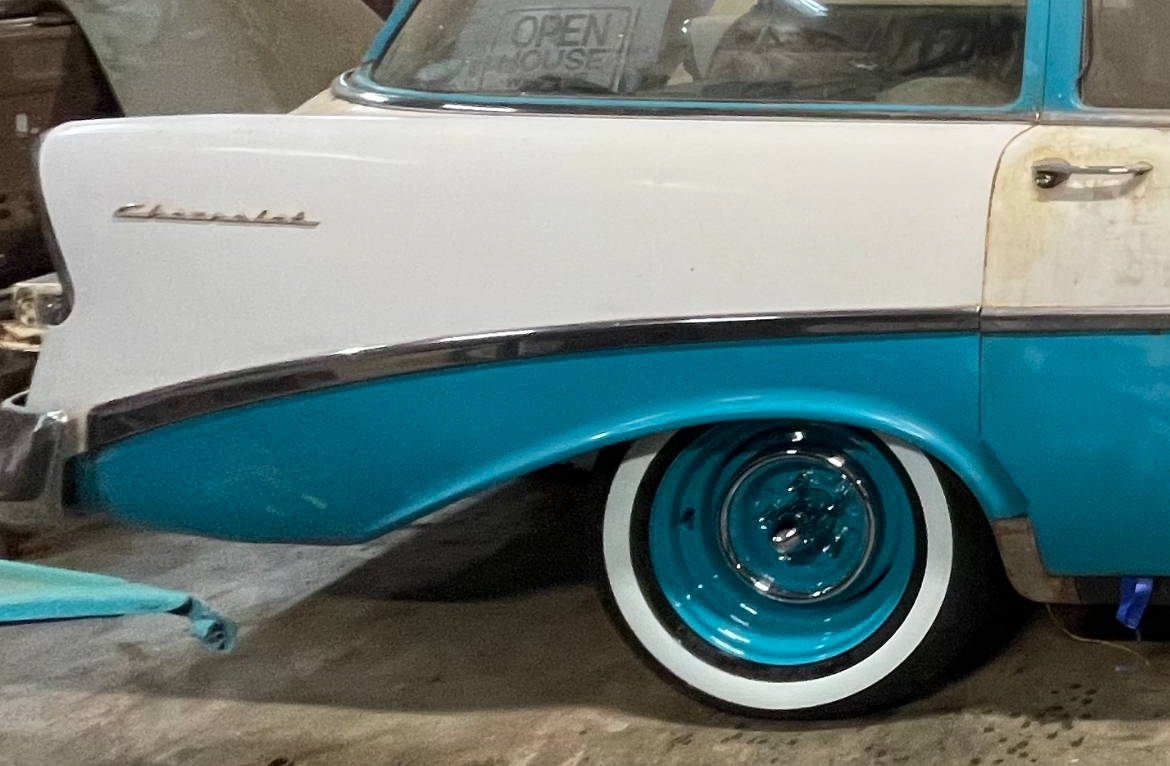

    IMG_2963.jpeg Yore not going to skirt it Right?
    Dan
  5. Yesterday would have been a yes
    But rethinking that now. Kinda dig it
    I’ll stick the skirt on soon and see how I like it

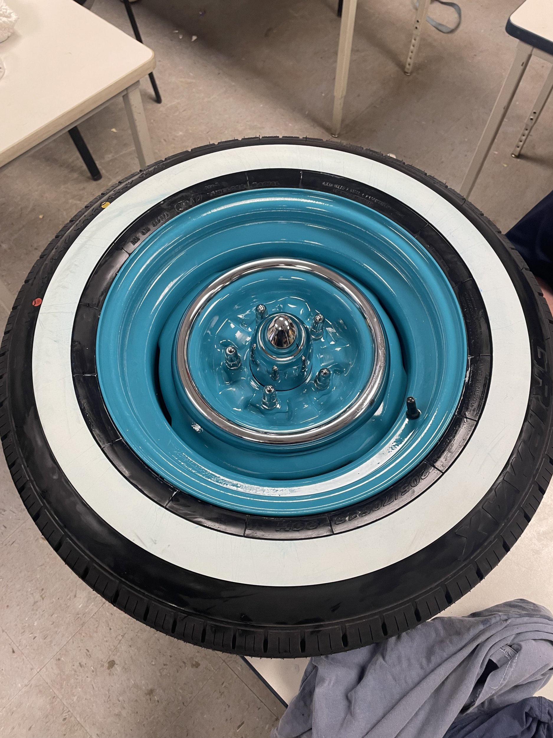

  7. This may be a stupid question but where or how do you get the little chrome ring on the wheel That surrounds the lug nuts? I have seen this treatment a few times and I really like it It. feels very early '60s or late '50s in the looks department.
    porkshop and Sharpone like this.
  8. Oneball
    Joined: Jul 30, 2023
    Posts: 1,913
    Oneball
    They fit on just like a dog dish hubcap.
    porkshop, Sharpone and anthony myrick like this.
  9. Called spider cap rings or something like that
    Ya beat em on like a hub cap

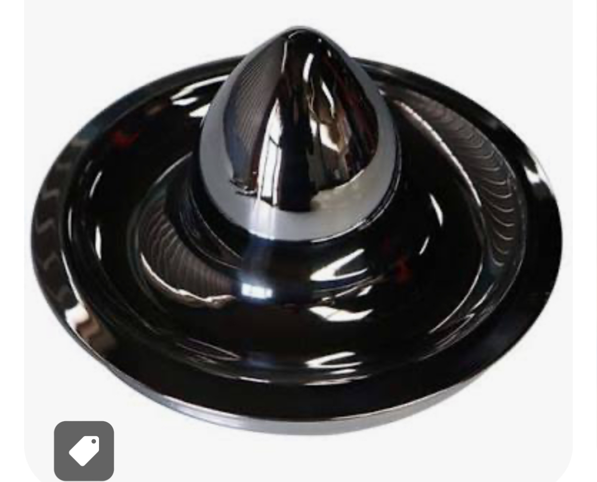

    I thought they were called Shannon cones, I believe @wheelkid had a thread about making them a few yrs back

  15. This is a Shannon Cone
    mine are push thru caps and trim rings

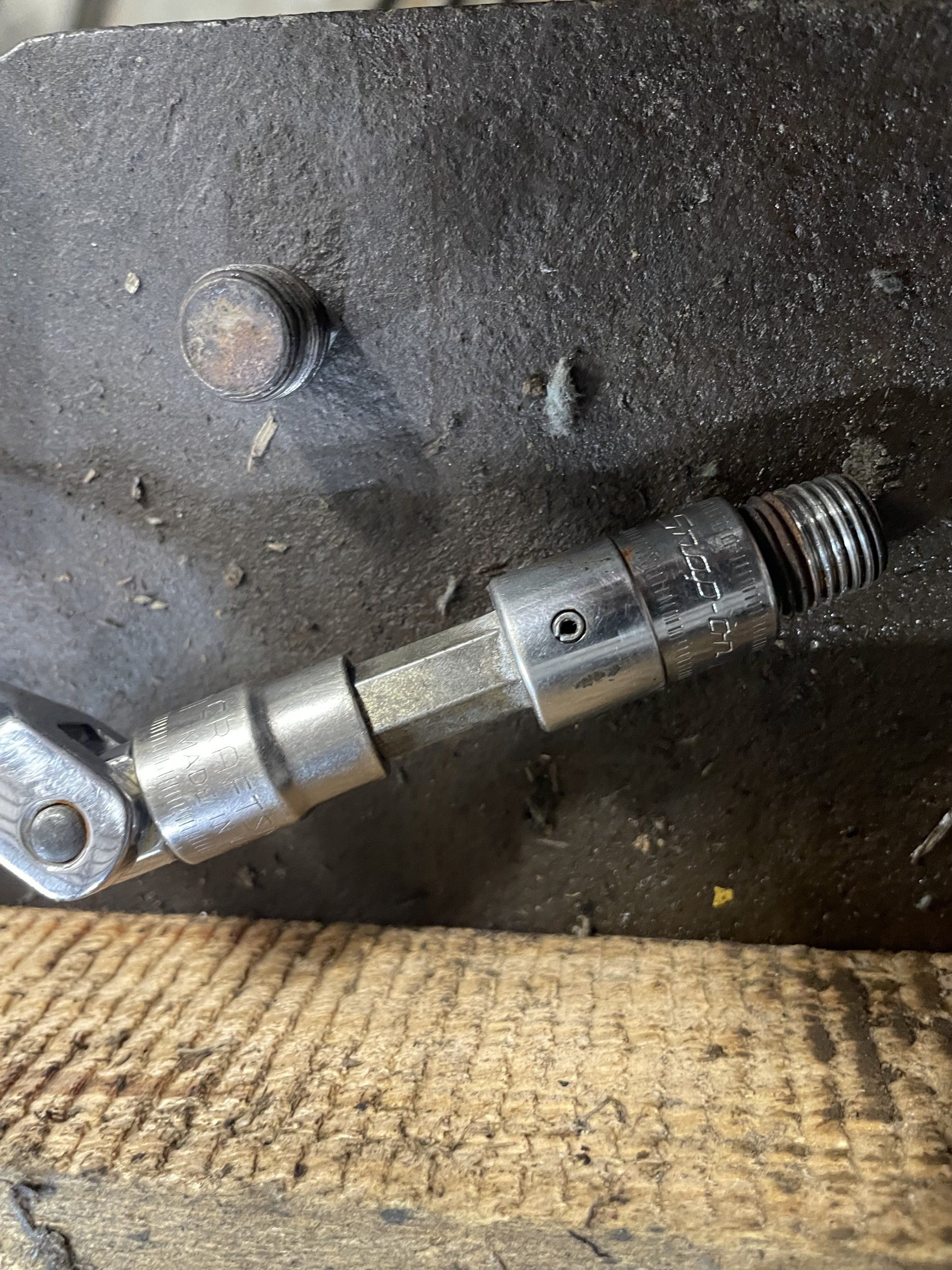

  17. Got 2 of the 3 galley plugs out.
    got creative.
    The center one is stripped. I’ll either leave it and flush from the front or weld a nut on it

    I always give those a good smack with a heavy hammer before I try to remove them.
    porkshop, Okie Pete, pila38 and 6 others like this.
  19. Might leave it and extend the pipe cleaner and scrub it out.

    My Friend , trying heatin it and sticking a candle to it 2 or 3 times . The melting wax can be your friend when a tight spot .
