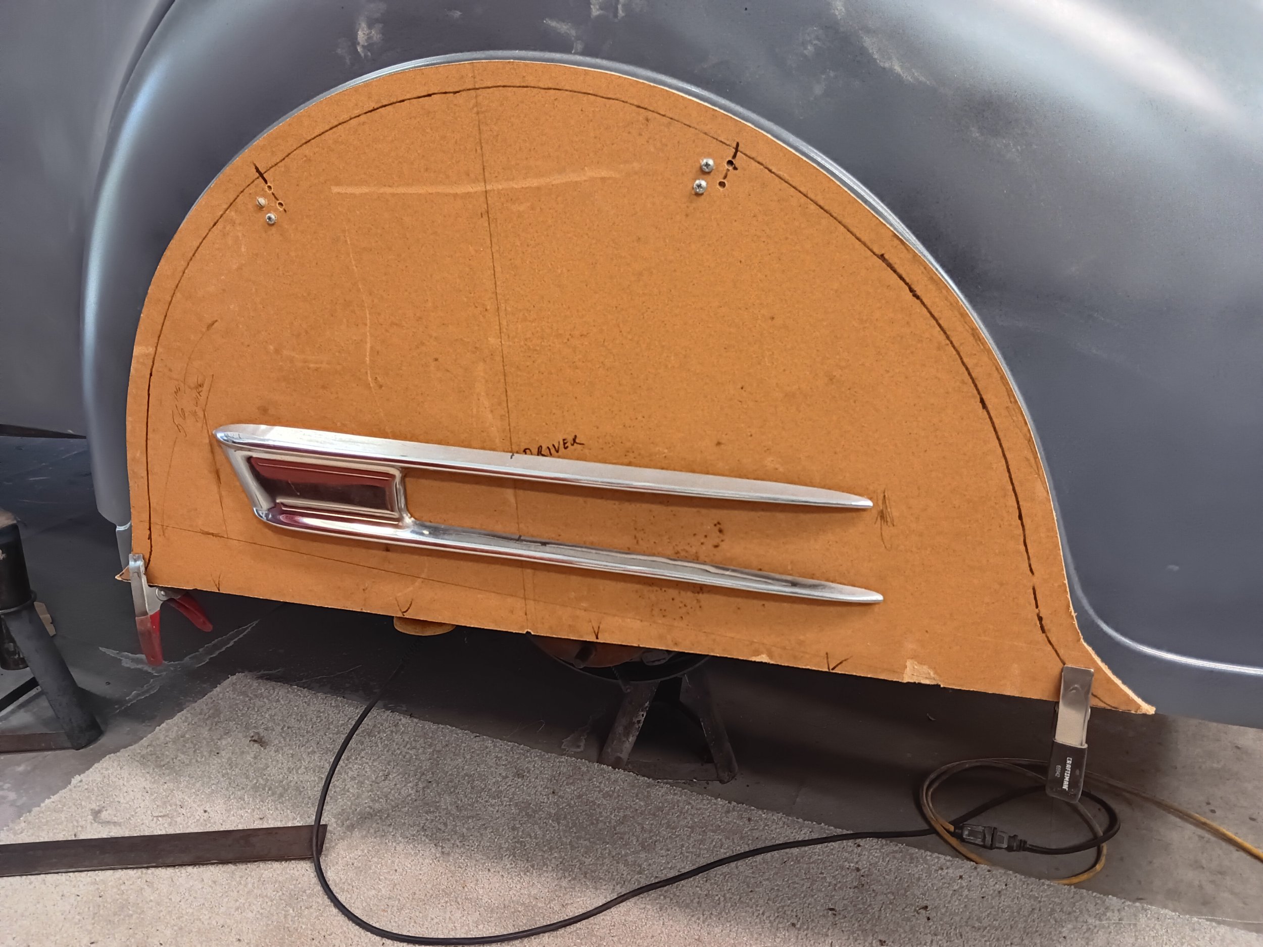

    20250228_144507.jpg 20250228_144507.jpg 20250228_144507.jpg started making skirts for the Boznetic Coupe '
    Starting with a cardboard template them transferred it to Masonite. Fit was good. Making lower brackets today. When iam happy with that , I'll transfer it to shèetmetal and wheel in a little ark.
