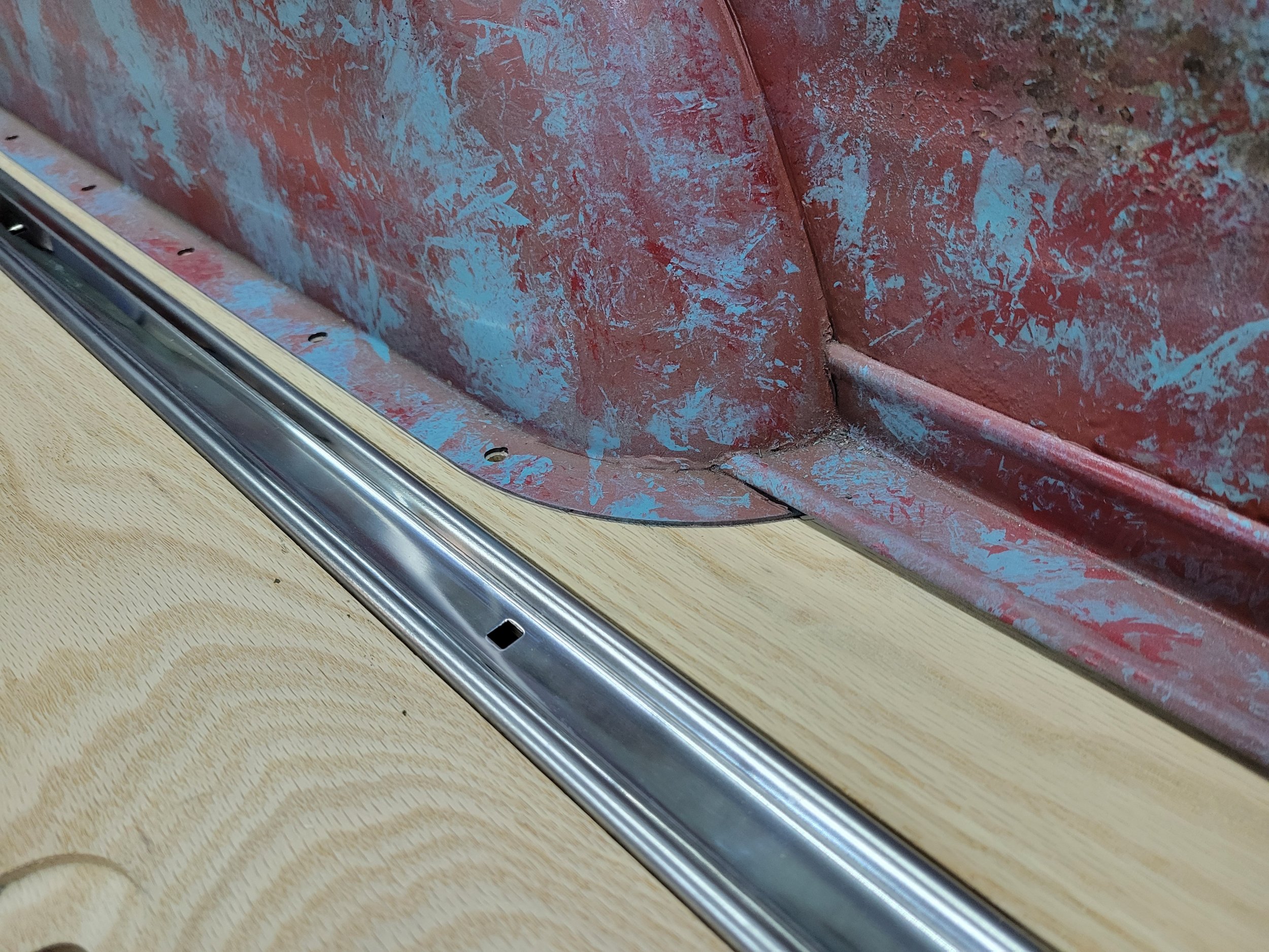

    I spent entirely to long with hand tools trying to recess my wood plank for the wheel tub lip to sit down into.
    Tomorrow I think I'm going to try the hole saw in the drill press mill hack again, because a sander, wood chisel, sand paper on a puddy knife, angle grinder with flap wheel, then with grinding disc, then with a cutoff wheel, a file, just didn't cut it.

    Look up router guide bushings.

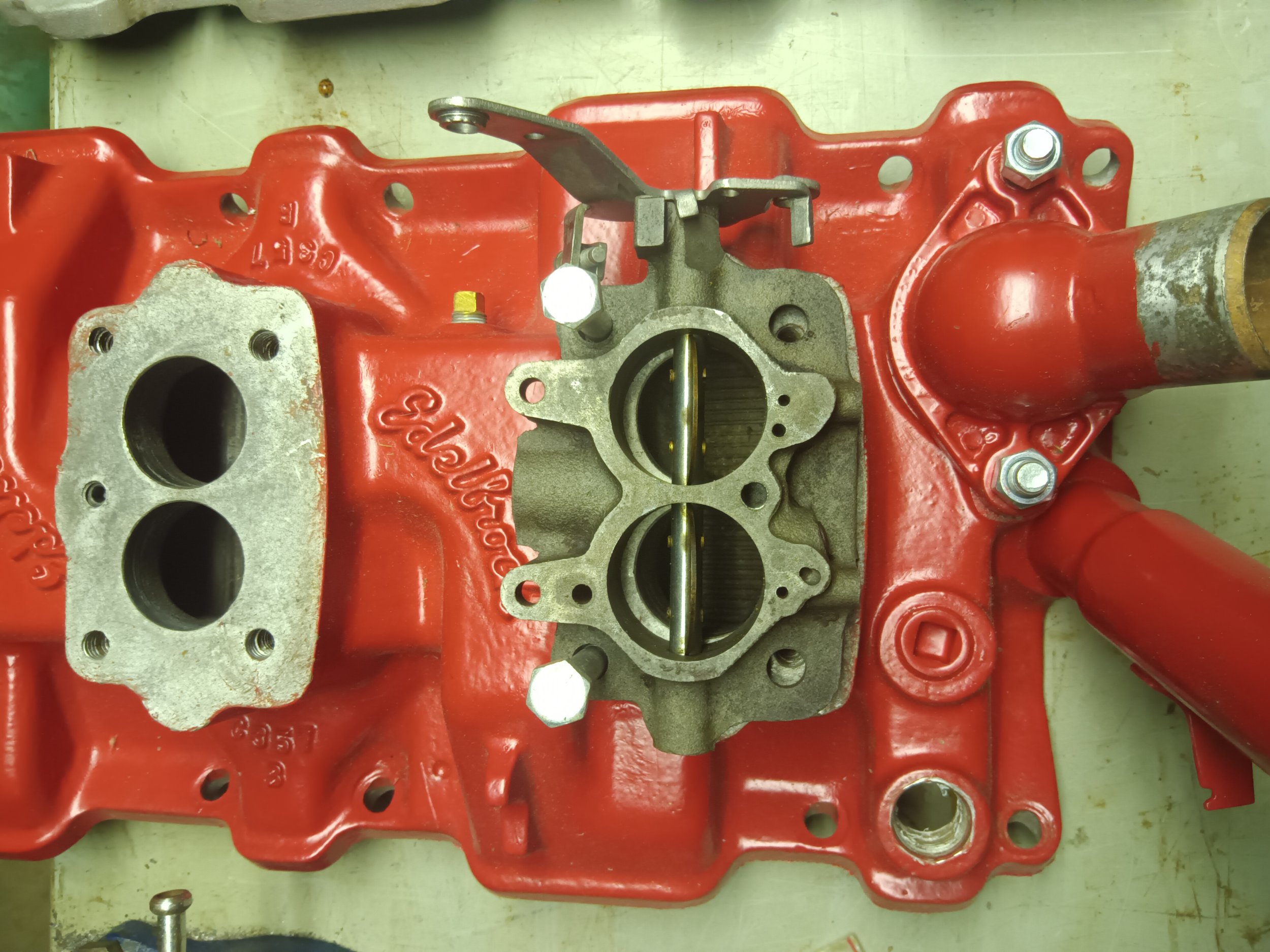

    IMG_20250307_100959.jpg i don't know if you've checked it out or not but when i put studs in the intake and set the rochesters on, the front bolts were too narrow and the throttle bores didn't line up. You may hafta do more adjustments to the carb bases and intake. I don't know if those are factory carb mount holes but they look the same as yours.
    I paid up for the true tri-power carbs i have and i don't really want to grind away on the original secondary bases.
    I have another intake drilled for the rochesters only and am going to use that. Unfortunately i just figured the dual bolt pattern on my first intake was gonna take the rochesters just fine and went ahead and drilled and made a baffle underneath for a pcv and cleaned and painted the whole thing .

  8. I’ll check mine. I’ve just set them on
    If it’s off I guess I could enlarge rhe intake bolt holes and weld em up. Then re-drill
    Probable take the bases off, use the best one for the center and determine if I’ll modify mine or buy new end bases

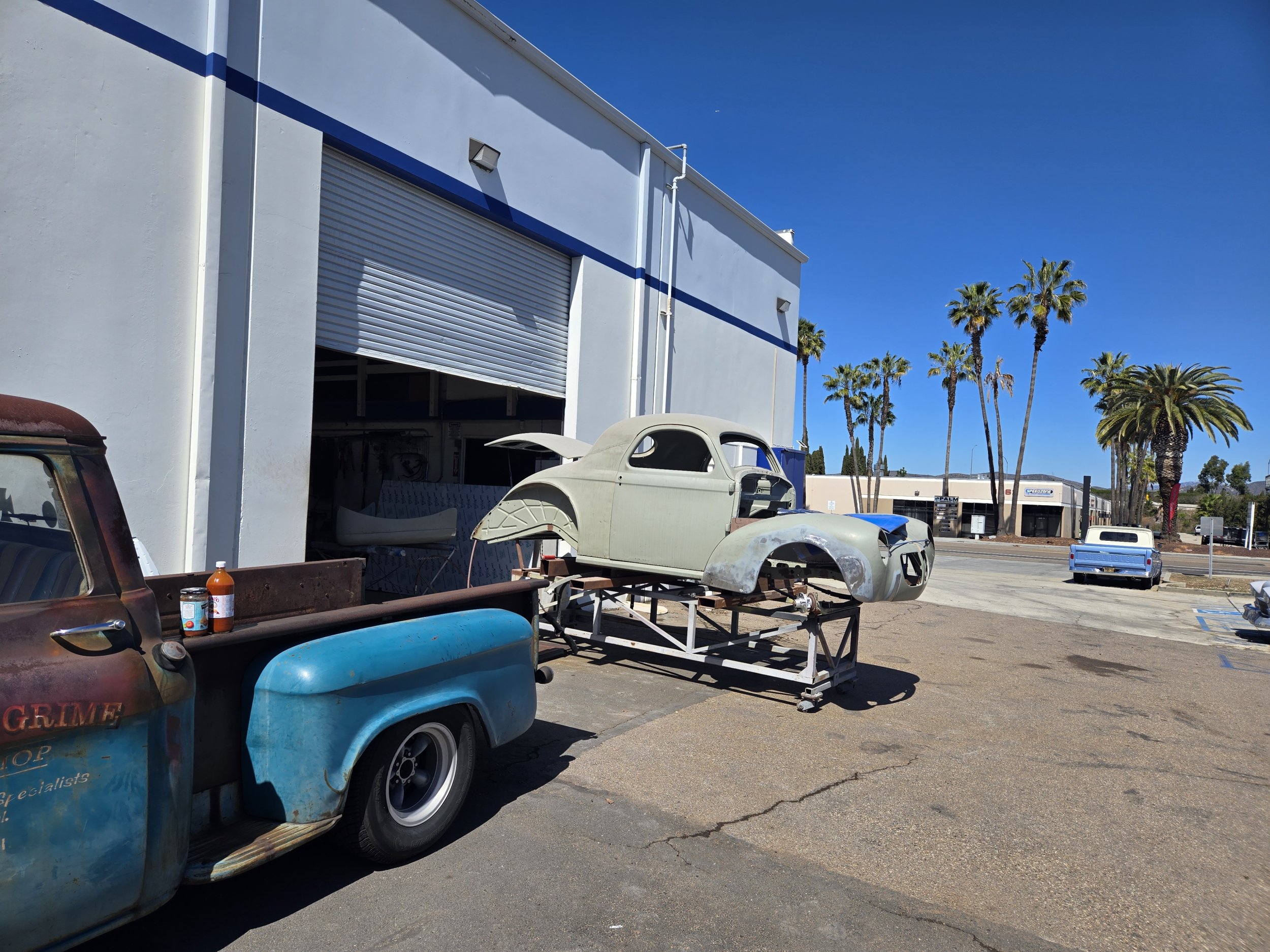

    Worked on the trans tunnel on the Tempest and then we pulled Bob's stalled project out of the storage Shed to get a fresh start on it. Then we cooked up some carne asada for lunch 20250308_111733.jpg 20250308_111334.jpg

    Oh yeah, much easier but still tedious

    A 40 Willys and grilled beef... My heart bleeds for 'ya. LOL!!!
    Some guys got ALL the luck! :p:p:p
