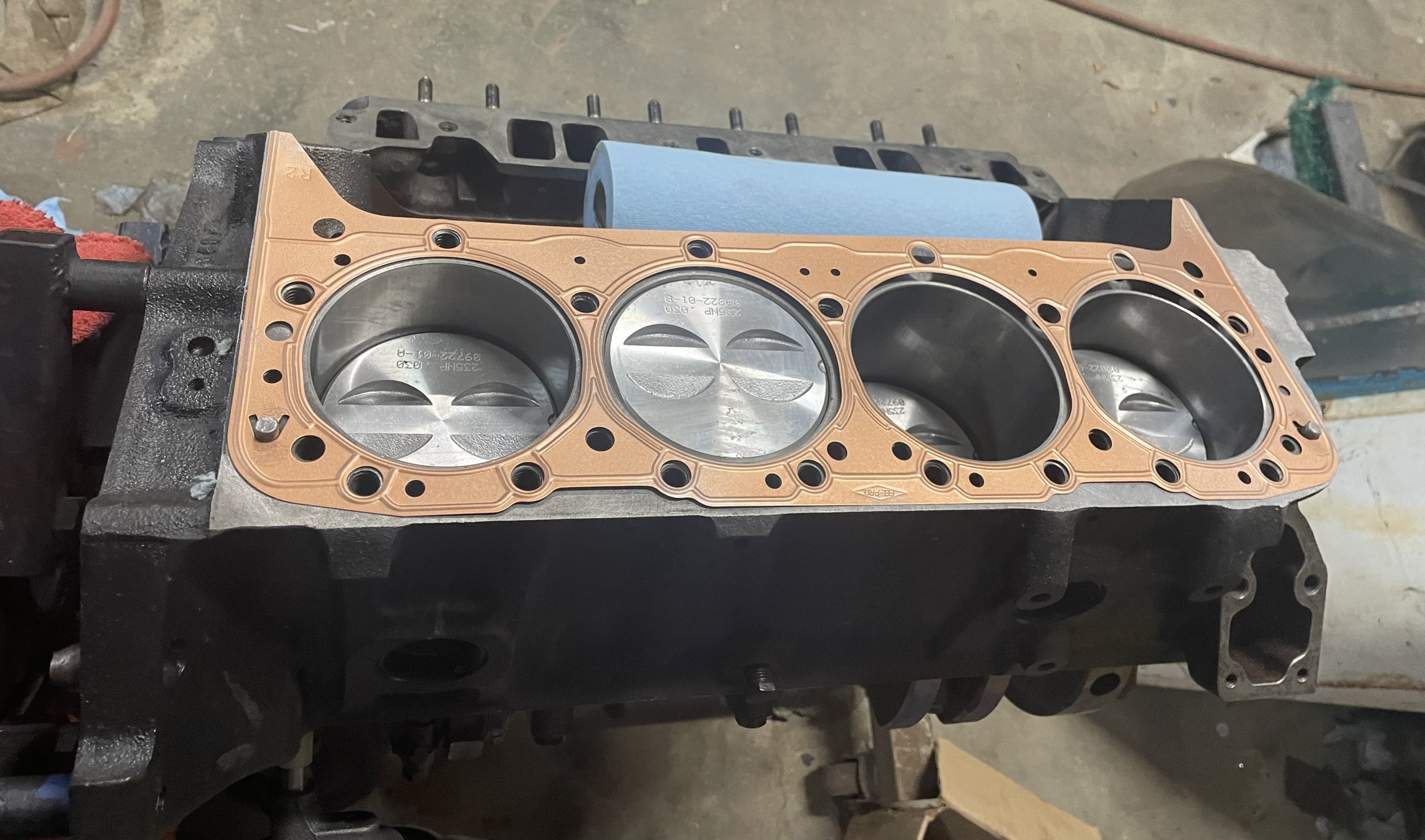

  1. Yep
    Nothing special. Off the shelf cast.
    Bout as performance as I build for myself.

    patsurf
    hillbillys use composition gaskets...safer!
    porkshop, Sharpone and anthony myrick like this.
  3. Those new fangled contraptions?
    Old engines use real gaskets
    porkshop, alanp561, Sharpone and 2 others like this.

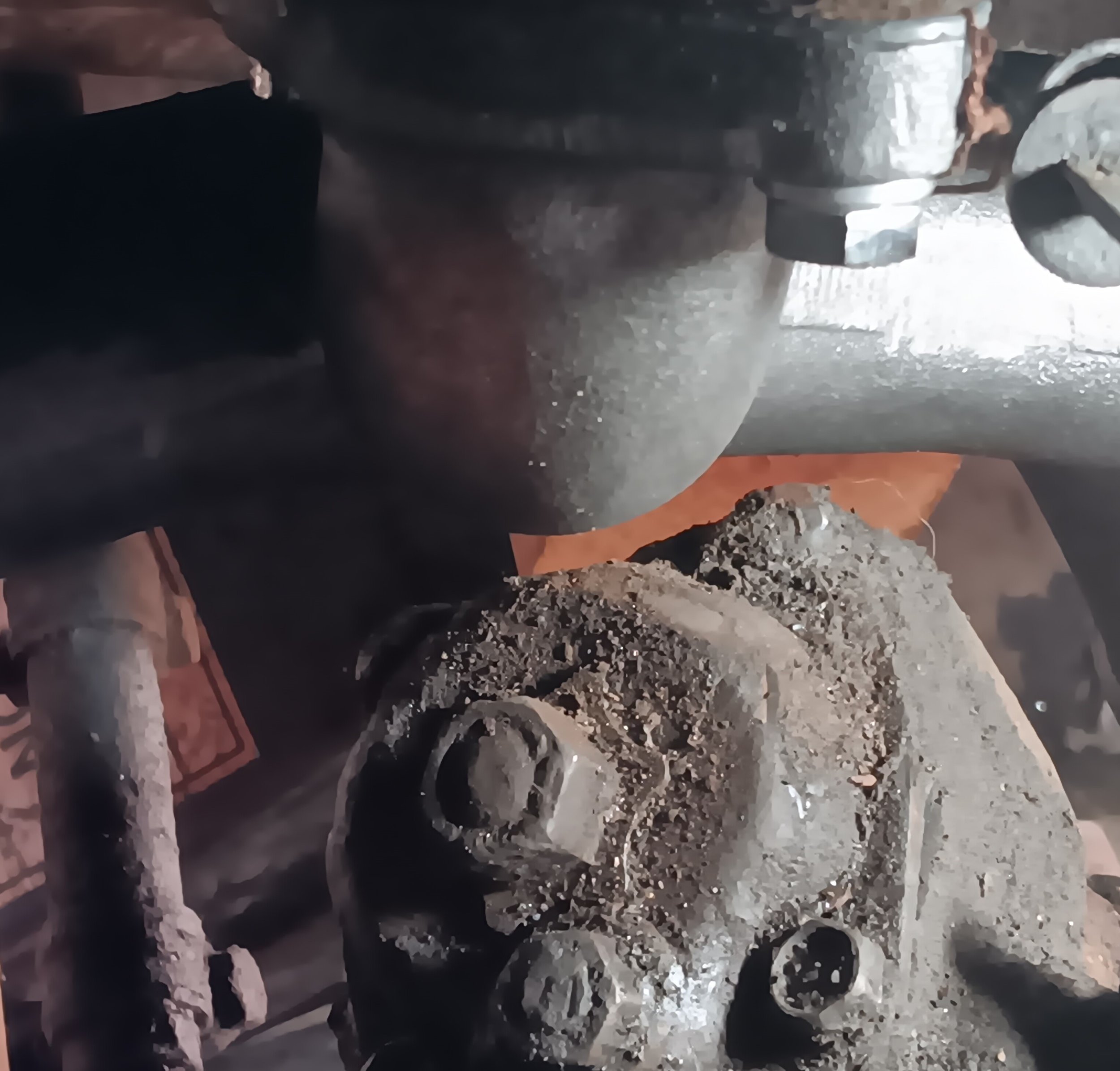

    More progress! After sawing 1/4 inch off of the header bolts and shimming the front motor mounts 3/8", I finally got these headers in place. Some bolts went in easy; some went in 1/6th of a turn at a time. No room for sockets. Now, on to the pipes.
    Driver's side, we got clearance.
    P***enger's side.

    Alan,
    At least you got yours in with 1/6 turn at a time. I usually wind up having to do 1/12 turn at a time.
