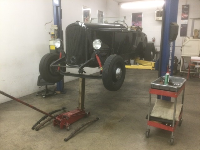

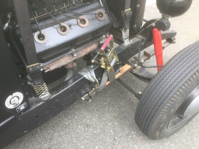

    Spent the last couple of days replacing (+ slightly modifying/tweaking the new ) front springs in my PB Roadster.
    The original, 93 y.o. springs or more specifically the right front main leaf with who knows how many miles beyond +/-100.000 I’ve driven on it/them in past 35 years broke (due to aging & metal fatigue) sometime during my Saturday morning drive to GNRS '25, prompting not only a call to AAA to get the car & me back home later that afternoon, but also a few weeks later, after first trying something experimental & temporary by welding the broken leaf and carefully drive around town to see how long it will hold up, couple of calls to Detroit Spring to discuss availability, confirm specs and place an order for new OEM-type replacements which finally arrived last week.
    Once I’ve driven a bit more and verified they work as expected, I’ll order a pair of replacements for the rear since those are also now 93 y.o., have 100.000+ miles and likely right on the verge of expiration.
    The second image shows how I prepped and tied the broken spring together for the drive from home to my shop (only about 3 miles and using back streets).
    Yeah, I could’ve called a AAA flatbed, but this was quicker and more interesting experience.

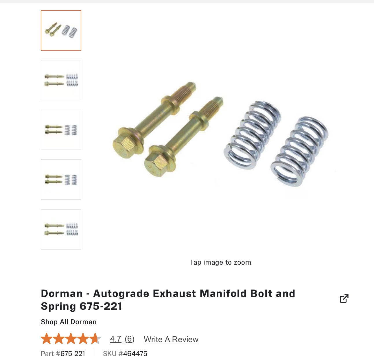

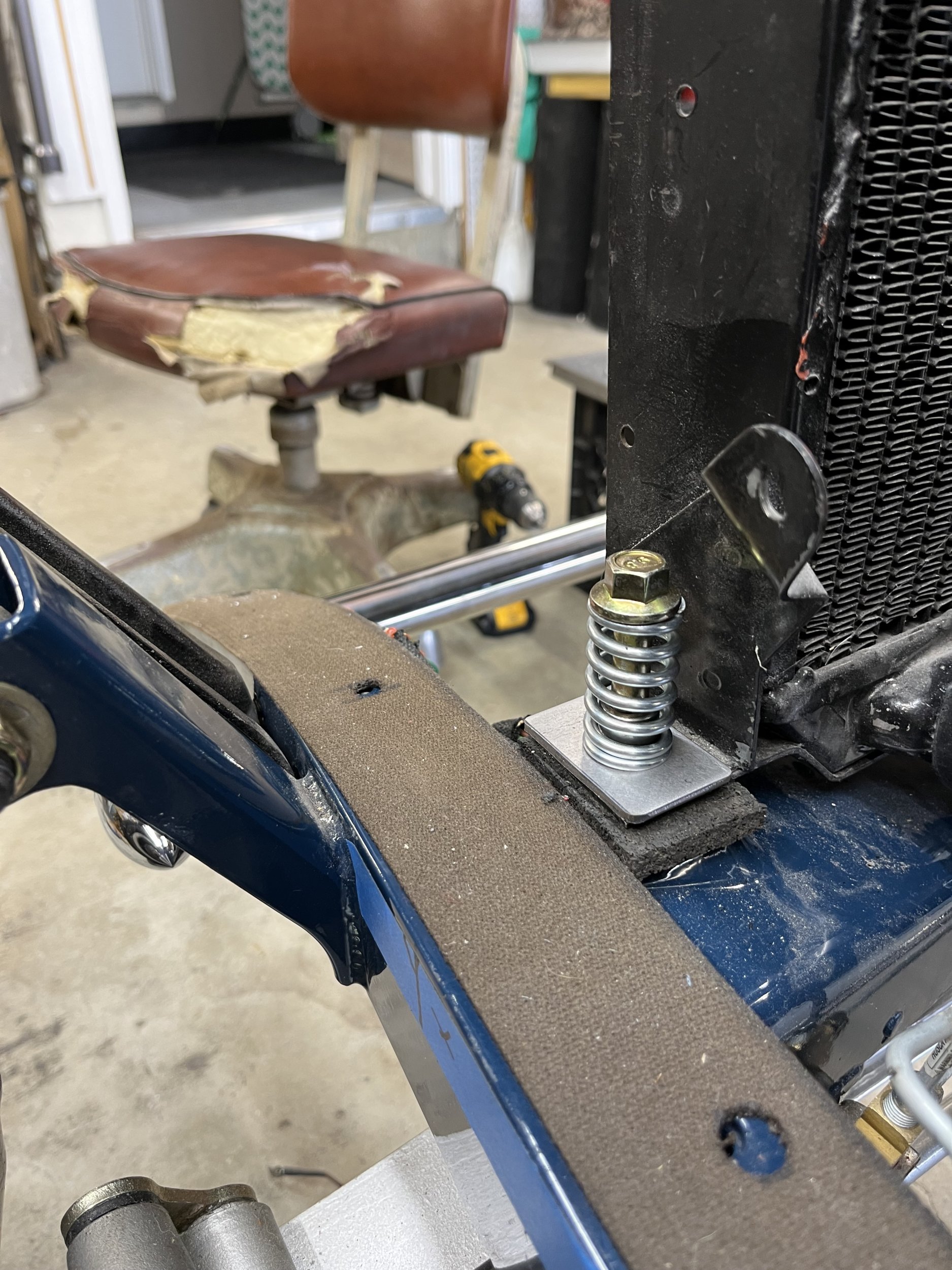

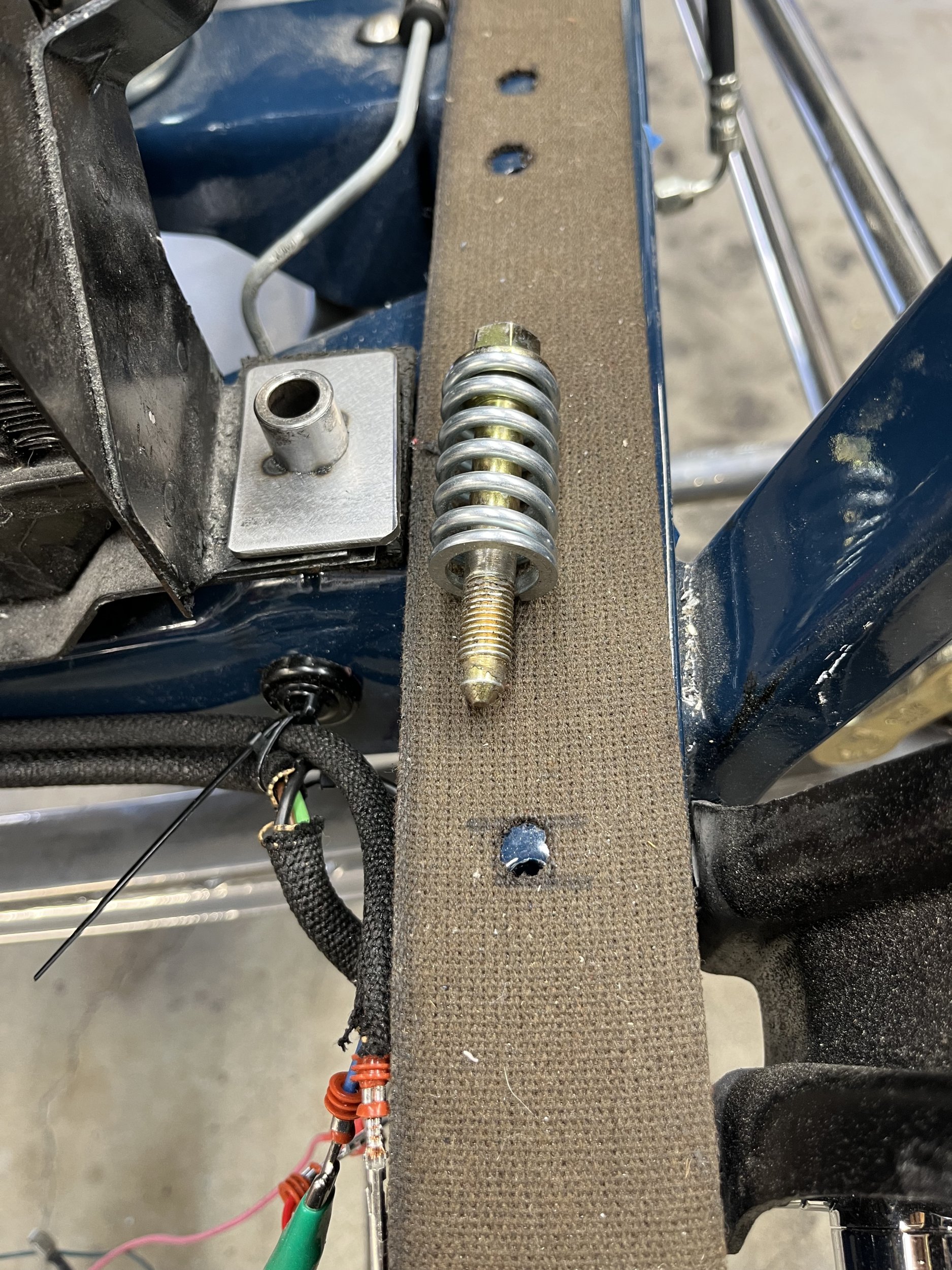

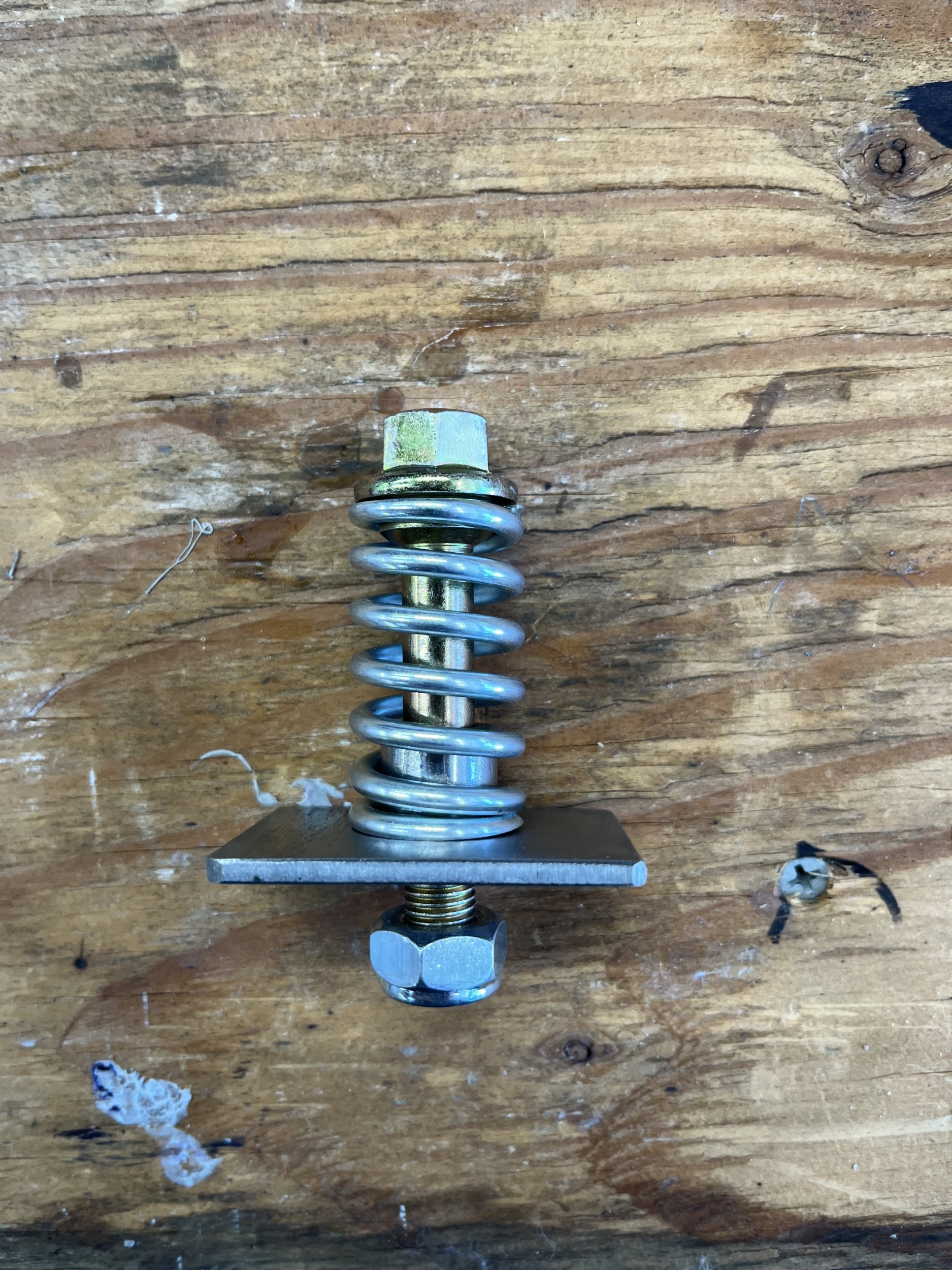

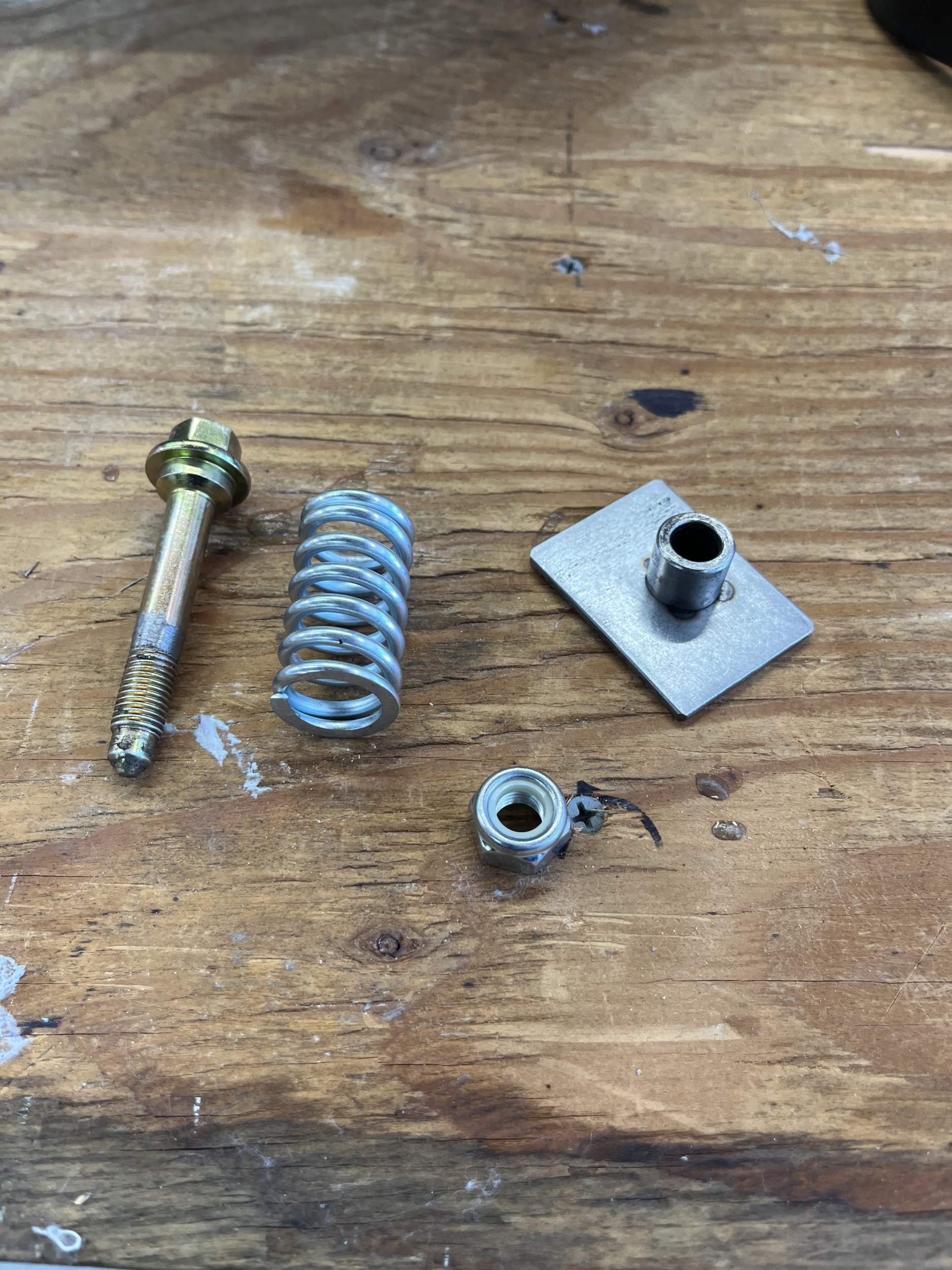

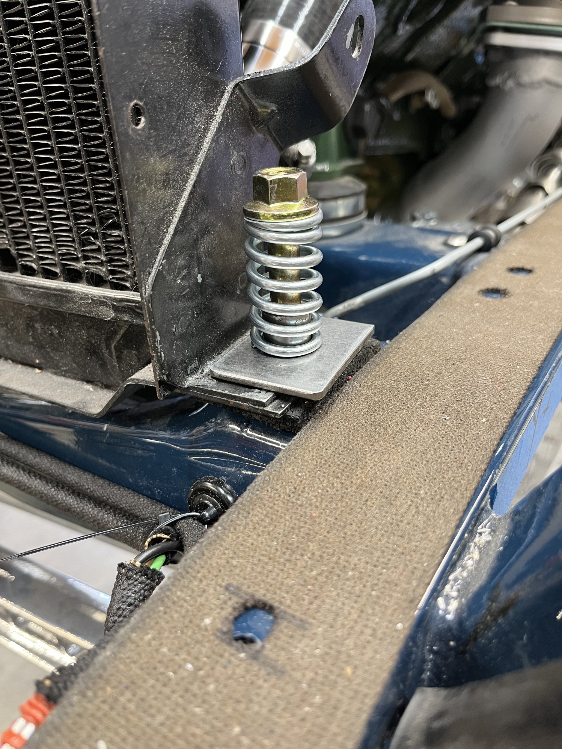

    I have the OEM bolts in mine . The are not the same design and have a hole and castled nuts, along with the springs . The bolts you have used are nice , are they replacements for this purpose ? If so where did you purchase them . Thanks and be safe

    The bolts and spring are some sort of exhaust bolt. I saw them at Auto Zone. I fabbed up the bottom keeper and added the nylock nut IMG_8228.jpeg

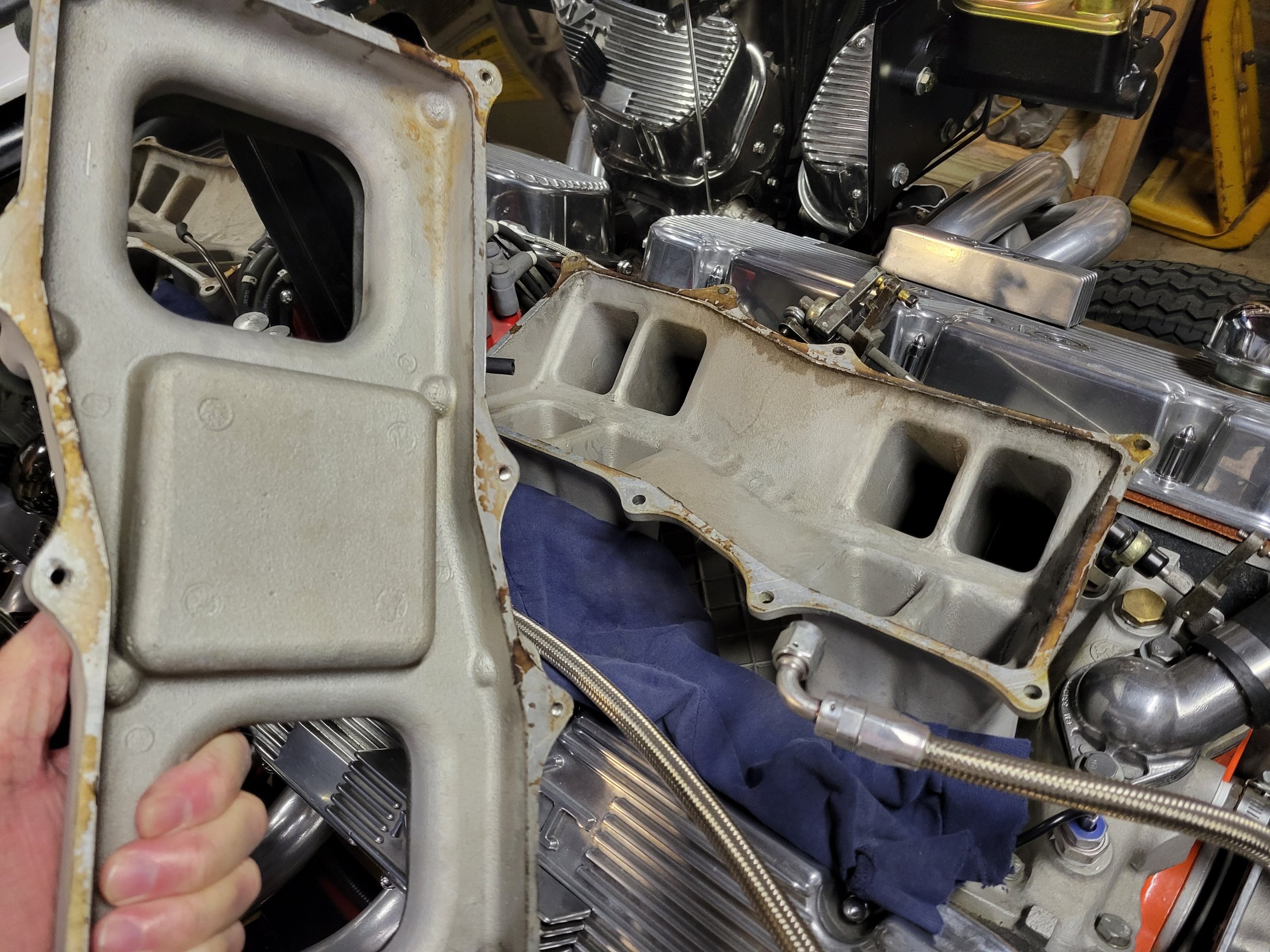

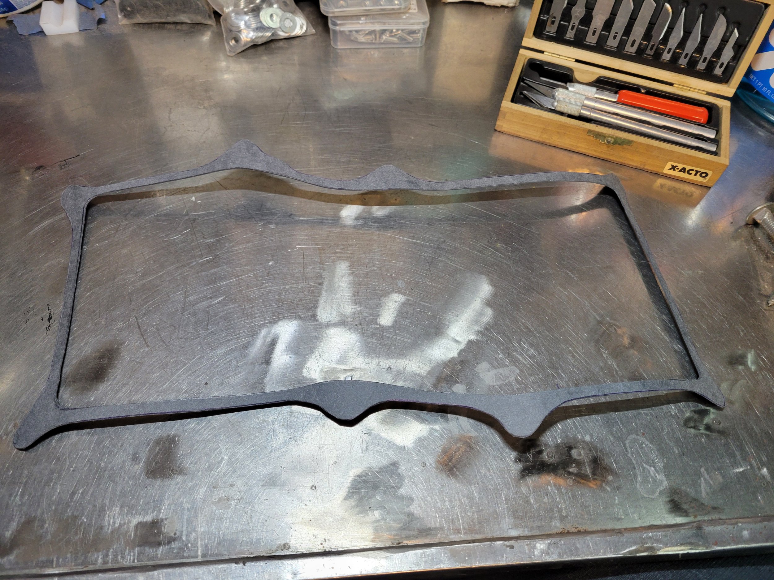

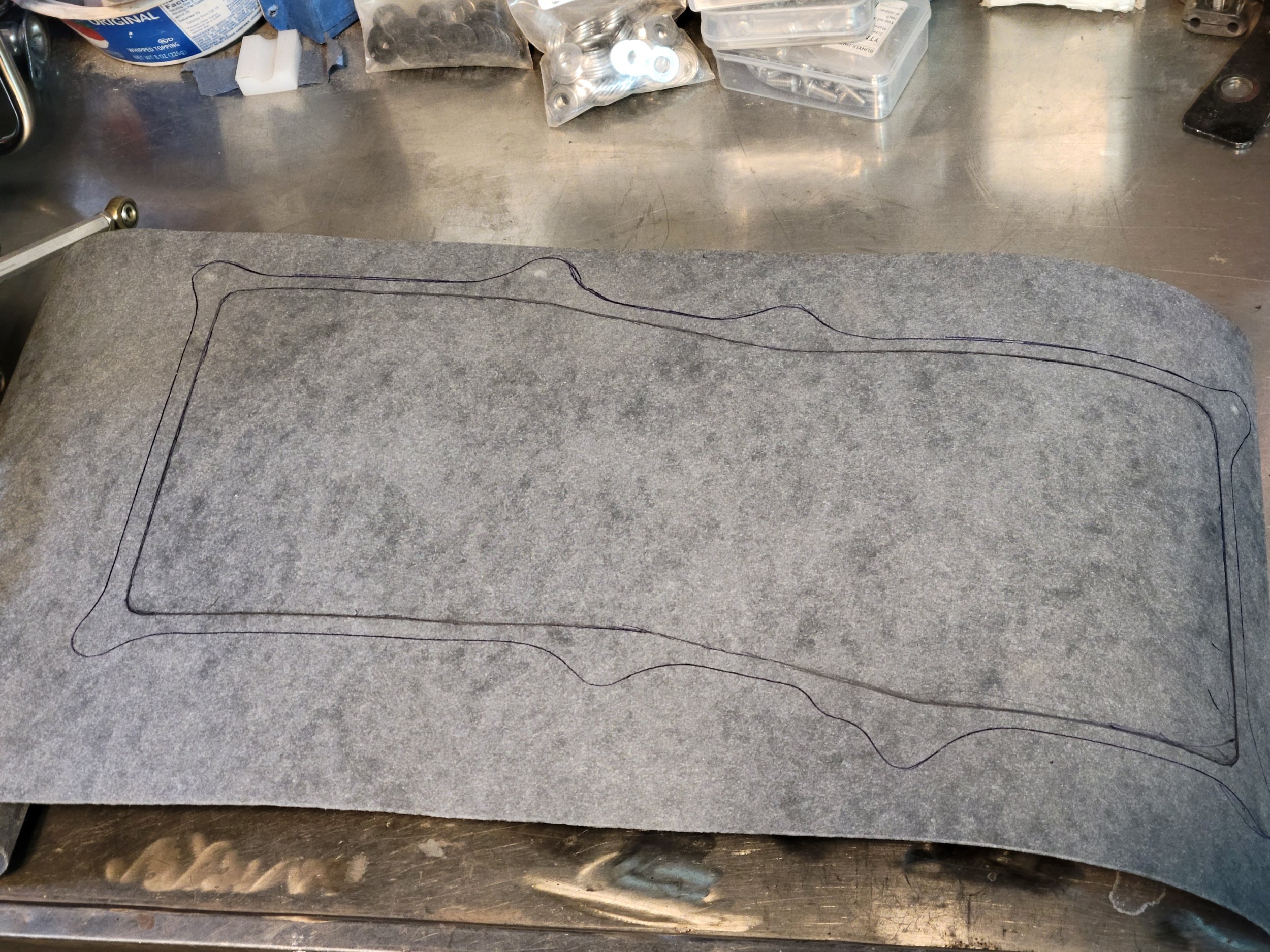

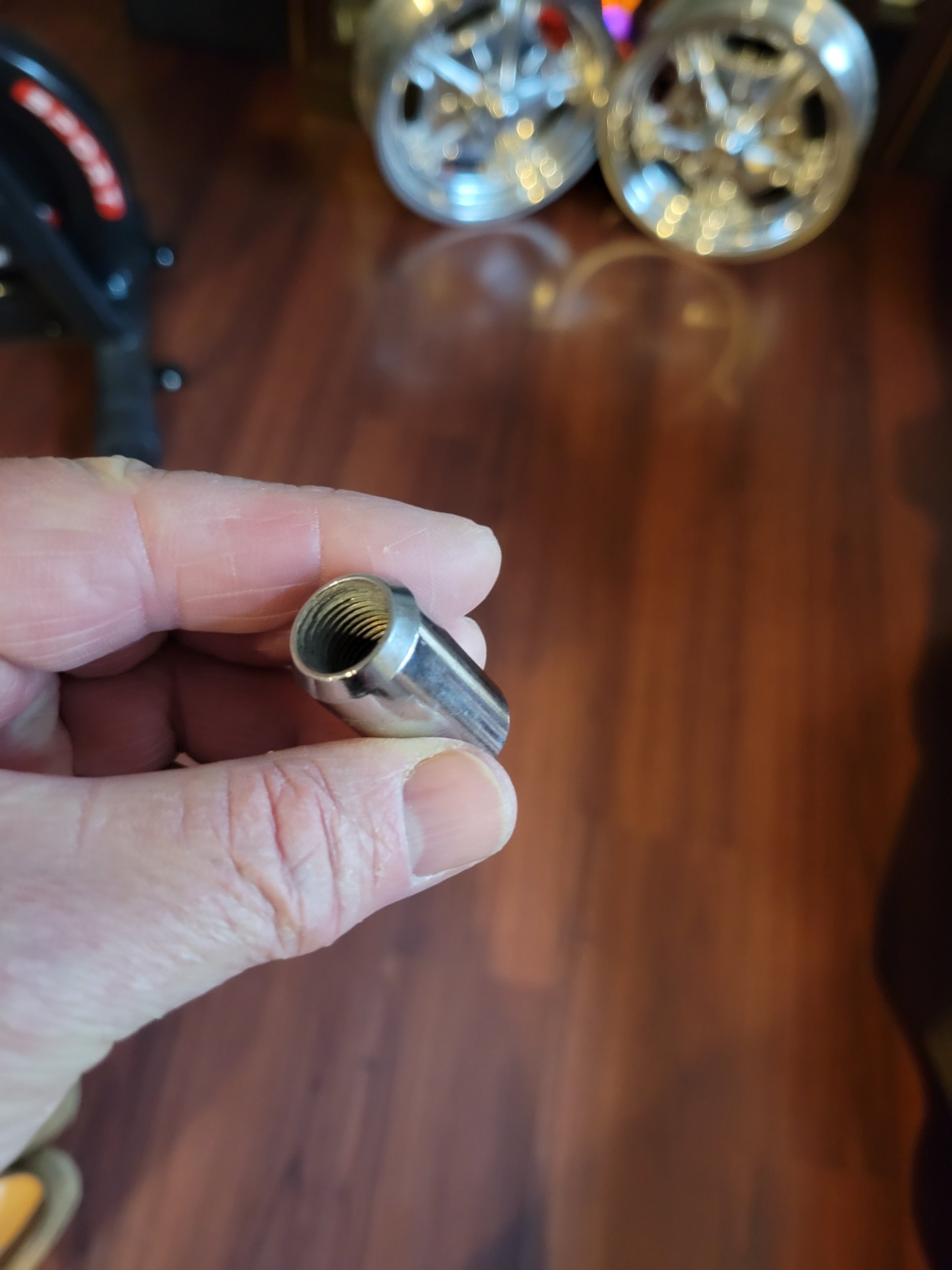

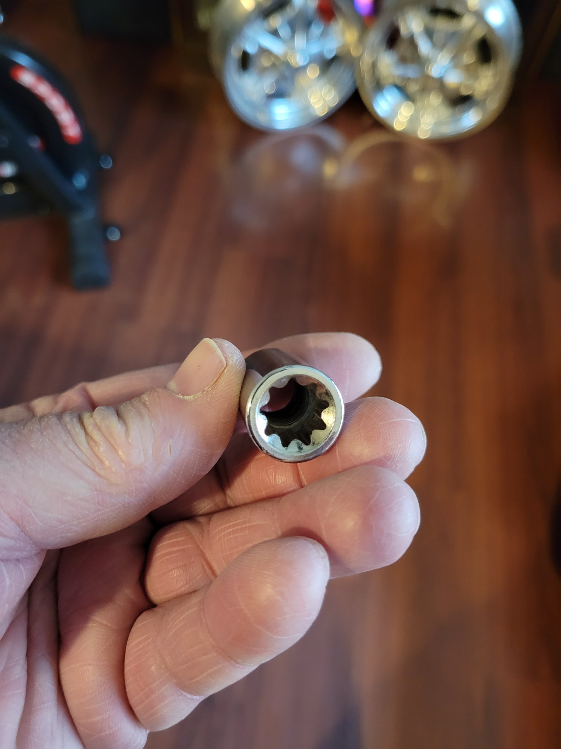

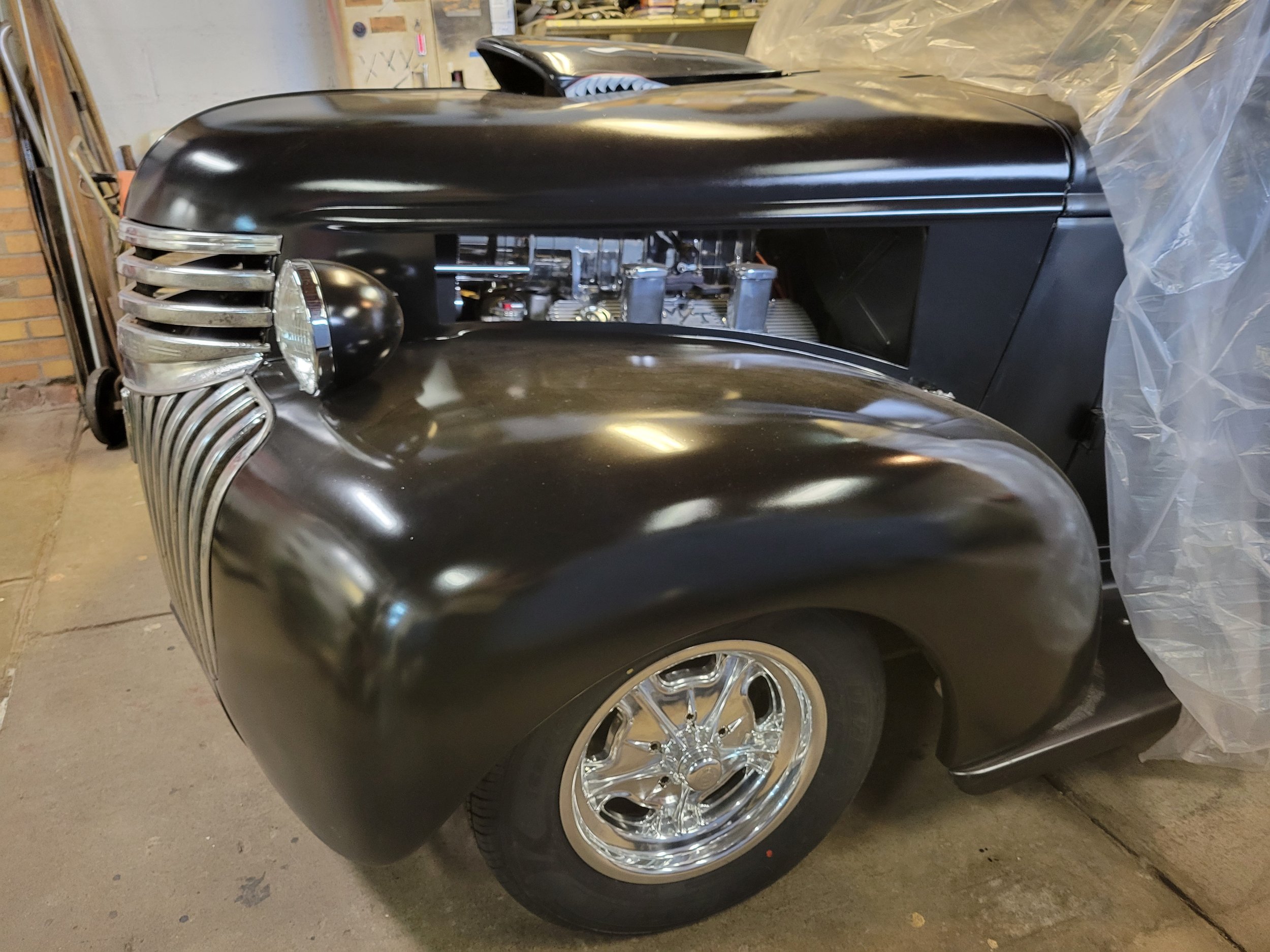

    Me looking for something
    That wasn't there
    So I had to make one

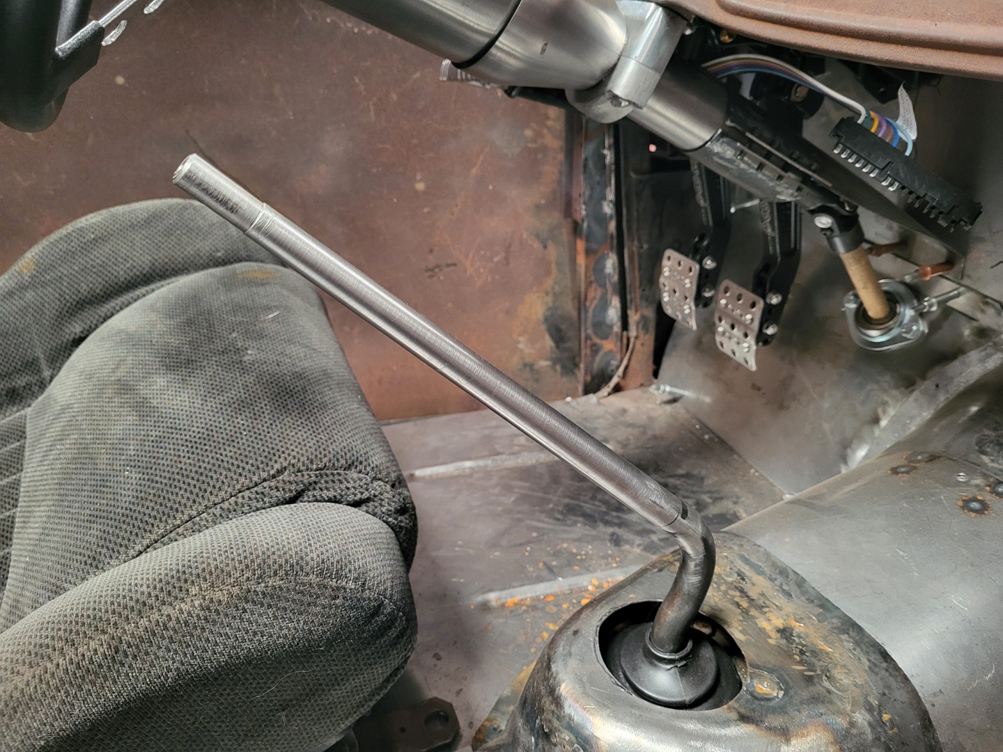

    Like swade41 I was looking for something that wasn't there so I had to make one. I couldn't reach the shift lever on the T5 without leaning forward so I turned a taper on a chunk of bar stock and threaded it on. The ball is in the mail, so I'll thread the extension when it shows up.

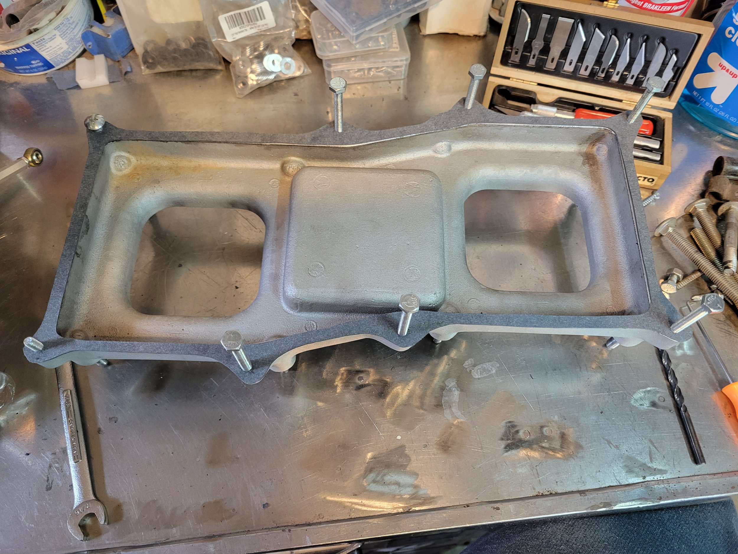

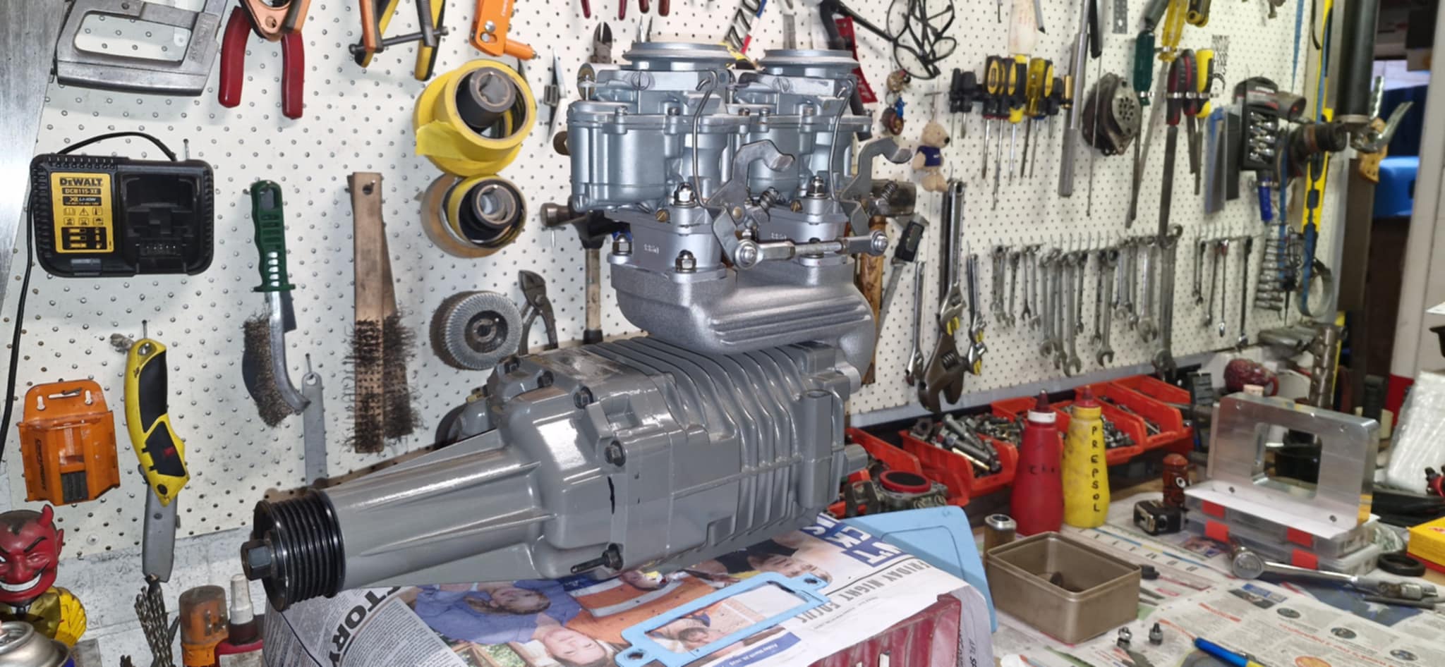

  14. Building another blown flathead using an Eaton lung, curiosity has got the better of me. Block is at the machine shop so started with initial mockup and carb adaptor fab. Will also need to mock up/machine pulleys/idler and hone out a SBC balancer to make it fit the flathead crank snout.
    Blower is a new Eaton M90 off a 90s T Bird Supercoupe.
    Should be interesting :)

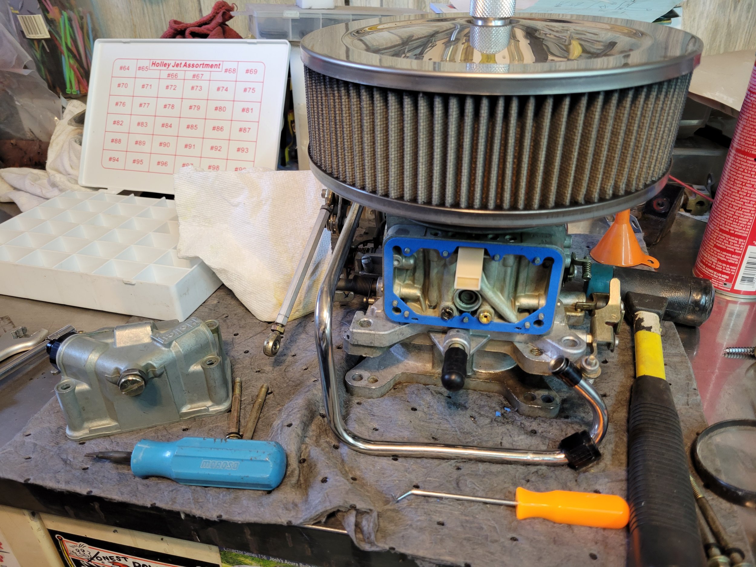

    Foiled by the delivery system to finish this job up, one of the downfalls of a 2x4 system is that you need twice as many jets. I had ordered them ahead of time to coordinate with the timing of this job but so much for that strategy.

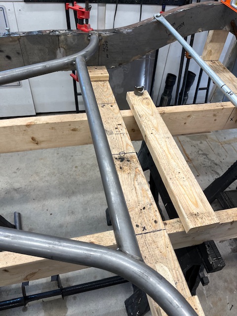

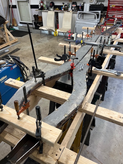

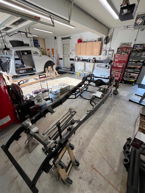

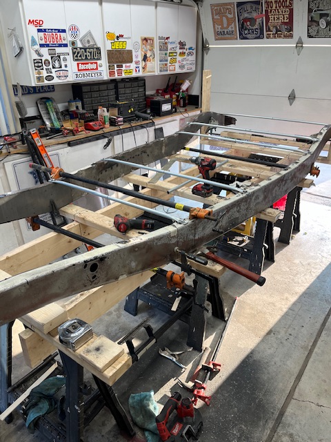

    I hit a major milestone yesterday!

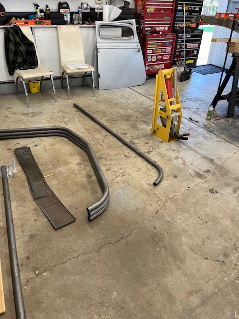

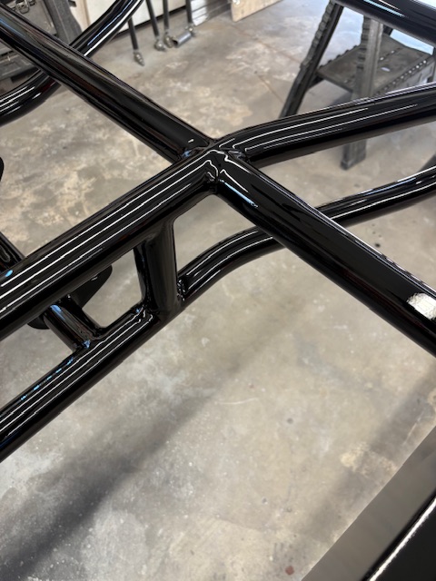

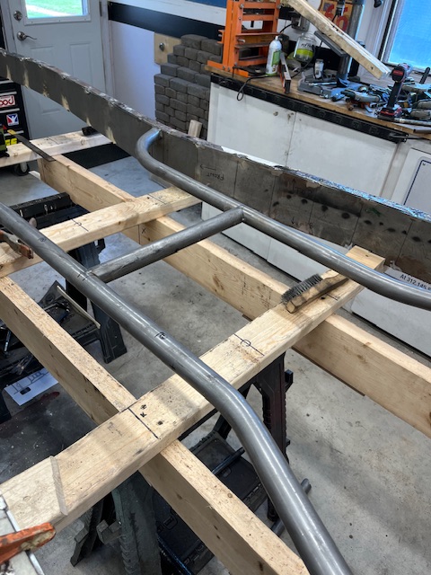

    This is the ch***is I started in July of 2024. I was able to strip the parts off the old frame down to just the original 1934 Ford outside frame rails. I was able to straighten the bent rails and add IMG_2696.jpeg IMG_2910.jpeg IMG_2980.jpeg IMG_2981.jpeg IMG_2986.jpeg IMG_2998.jpeg IMG_2997.jpeg IMG_3395.jpeg IMG_3530.jpeg IMG_3530.jpeg IMG_3612.jpeg IMG_3613.jpeg IMG_3618.jpeg full boxing plates from Speedway. Then fabricated all the round tube crossmembers from 1 1/2” x 1/8” wall, DOM.

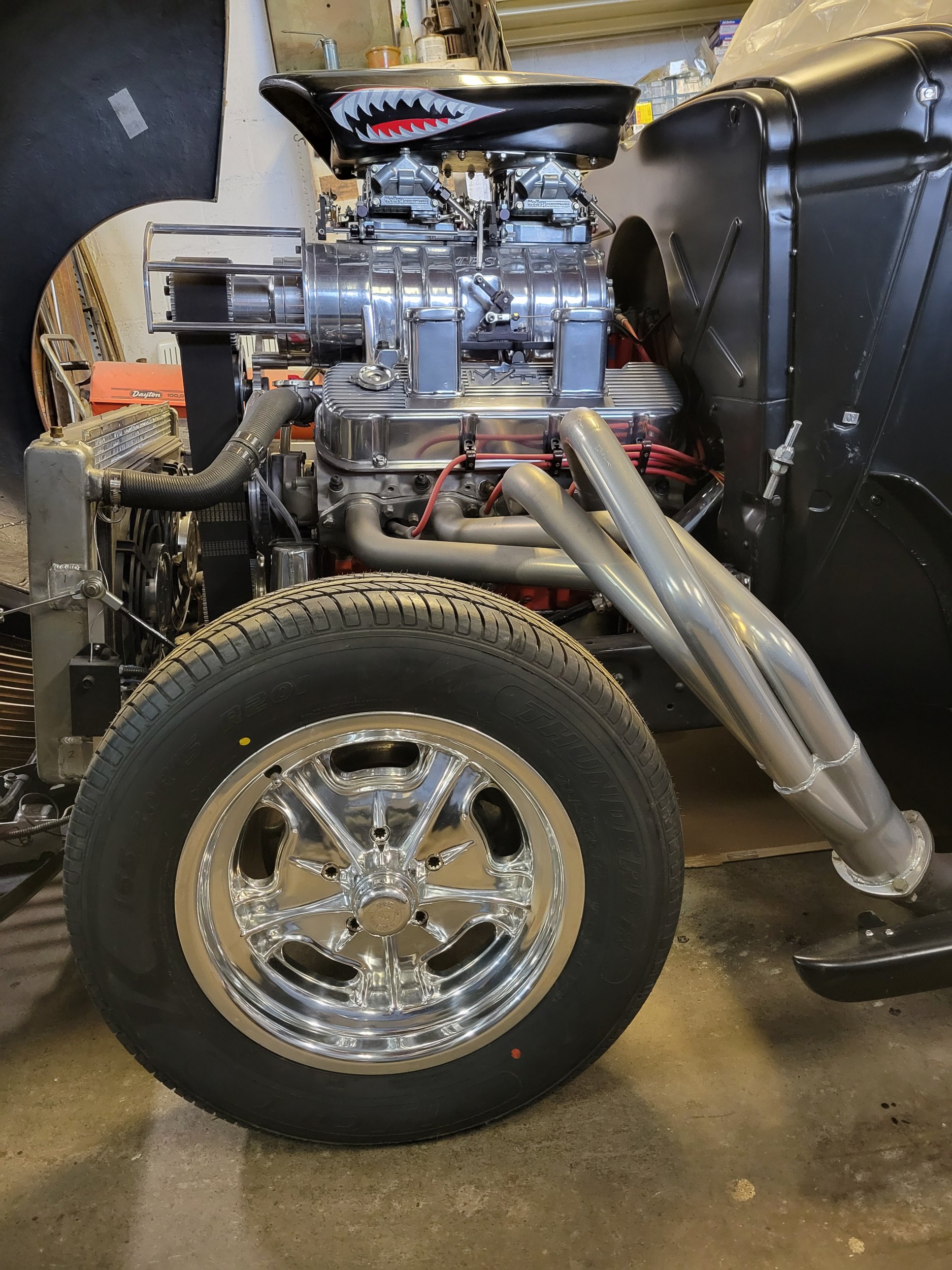

    My parts came in, they were nice enough to deduct $4.99 off my bill since I let them know they were late. Lol Anyways I finished up the carbs and got it all back together.
    I went to the other end of the car and moved the alternator charging wire to the other post on the battery cutoff switch, hopefully that shuts the car off now. The only thing yet to fix is the pesky leak on the line lock, which I've addressed a couple times already.
    With the wire moved I jumped over to the shrunken head that rides in the 41, his bone was to long so I took a little section out of the middle. I epoxed it back together with a stiff copper wire where the marrow used to be, should be good.

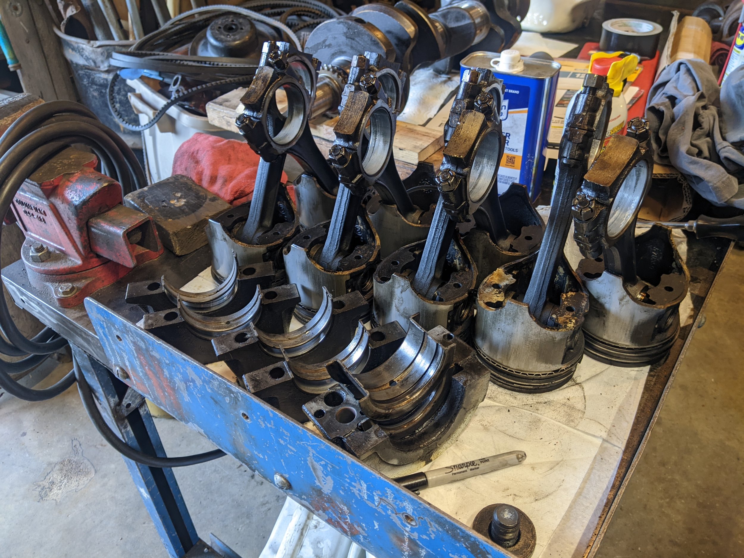

    tore down another Olds engine
    this one a '57 371
    standard bore, crank rod and mains.
    cam, lifters and whole valve train look real good.
    it's borderline per spec on the crank but I'm going to hand polish it, hone the cylinders and give it fresh bearings, rings and gaskets.
    may not last a 100 thousand miles but it should hold together a little longer.

    Finally, after spending countless or dare I say too many hours over past several days tweaking and fine tuning the front suspension, including ride height, caster angles & other handling characteristics, I think it's as good* as I can make it and while preliminary, short road tests seem to support that, I can hardly wait to take her for a "spirited" +/-100 mile Sunday morning drive up to local mountains to confirm success.
    And if everything goes well, I'll look into ordering new rear springs soon.
    * This was one of those countless instances where the famous quote "Perfect is the enemy of good enough" turned into my own interpretation or version of it: "Perfection can become a victim of good enough".
