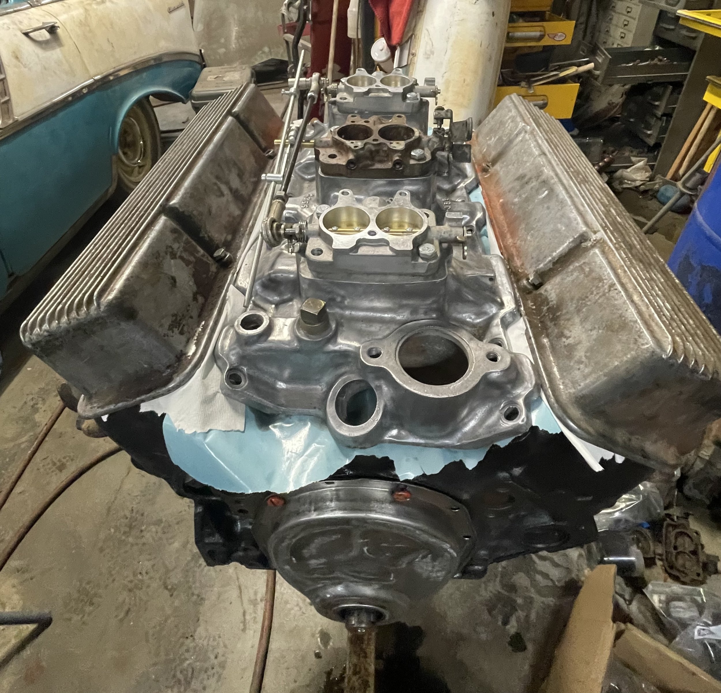

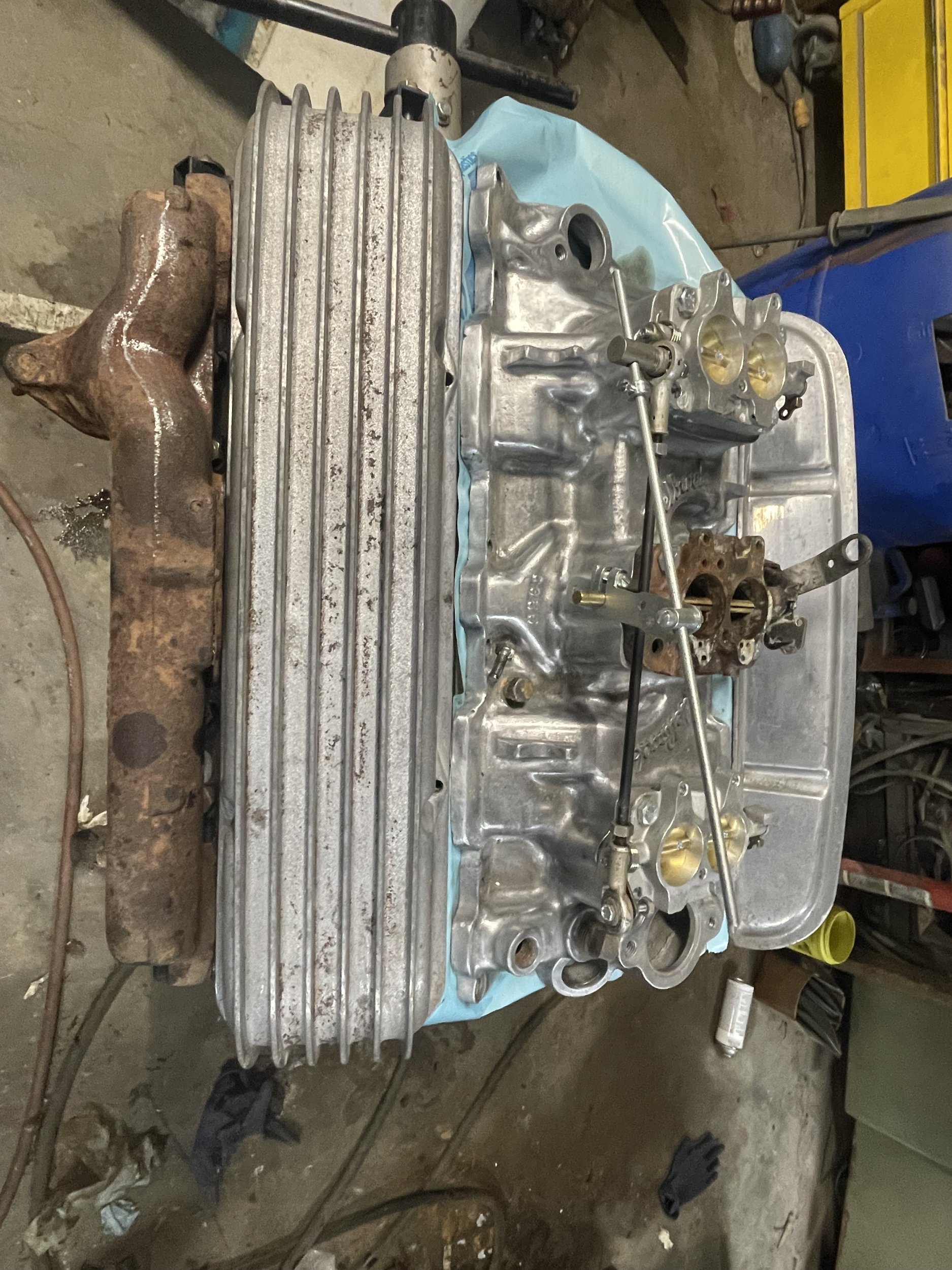

    Anthony is the engine going in the Chevy on the left?
    Dan
  2. No.

    Definitely gunna be cool old school

    Nice find. I have a set of those but one of mine has a small piece of the gasket lip broke off. Some day I'll repair it. Pretty hard to find and they usually bring good money.

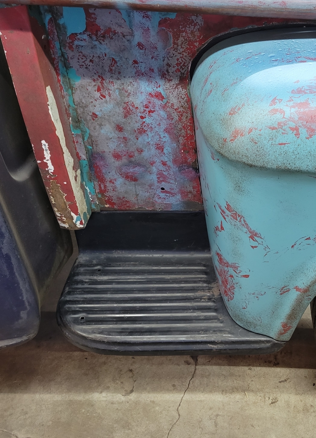

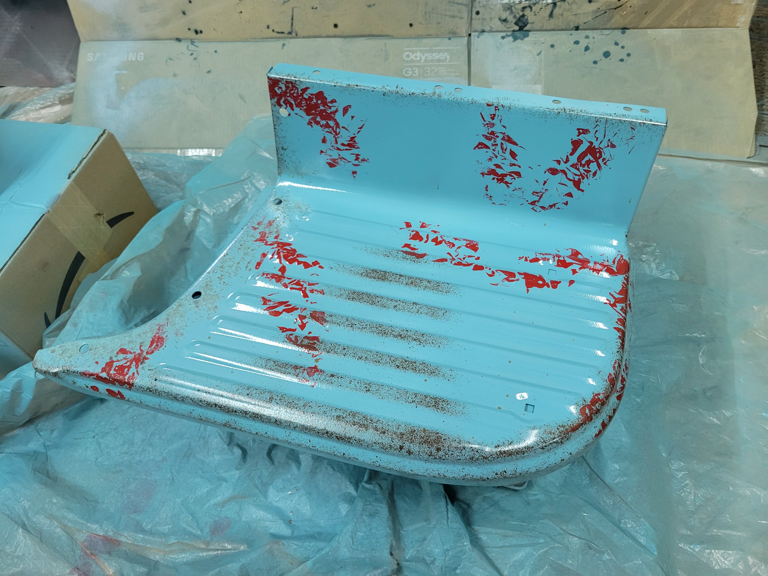

    I've been working on the steps on the 57
    Screenshot_20250504_140825_Gallery.jpg 20250503_155016.jpg 20250503_162253.jpg

    Did you step on wet paint?

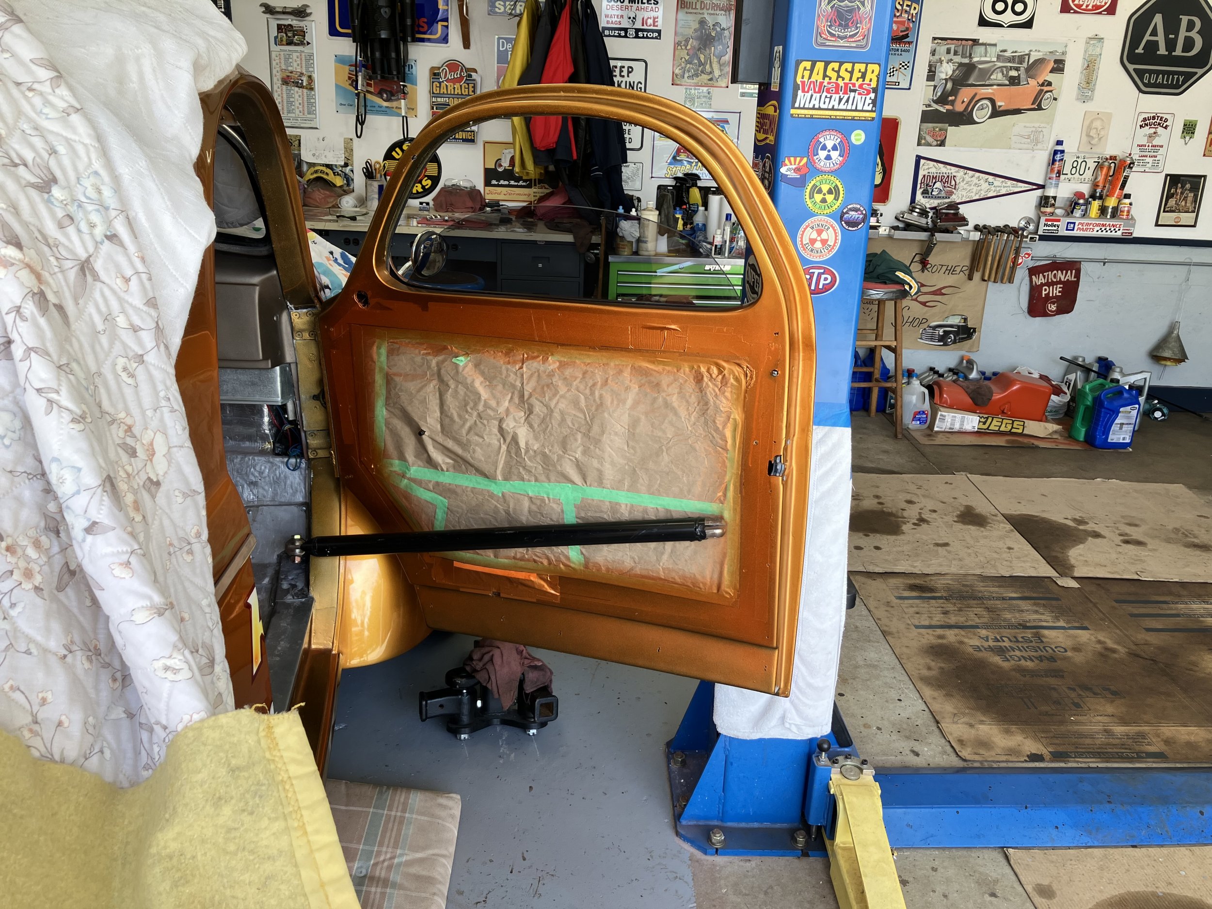

    I stepped in something lol

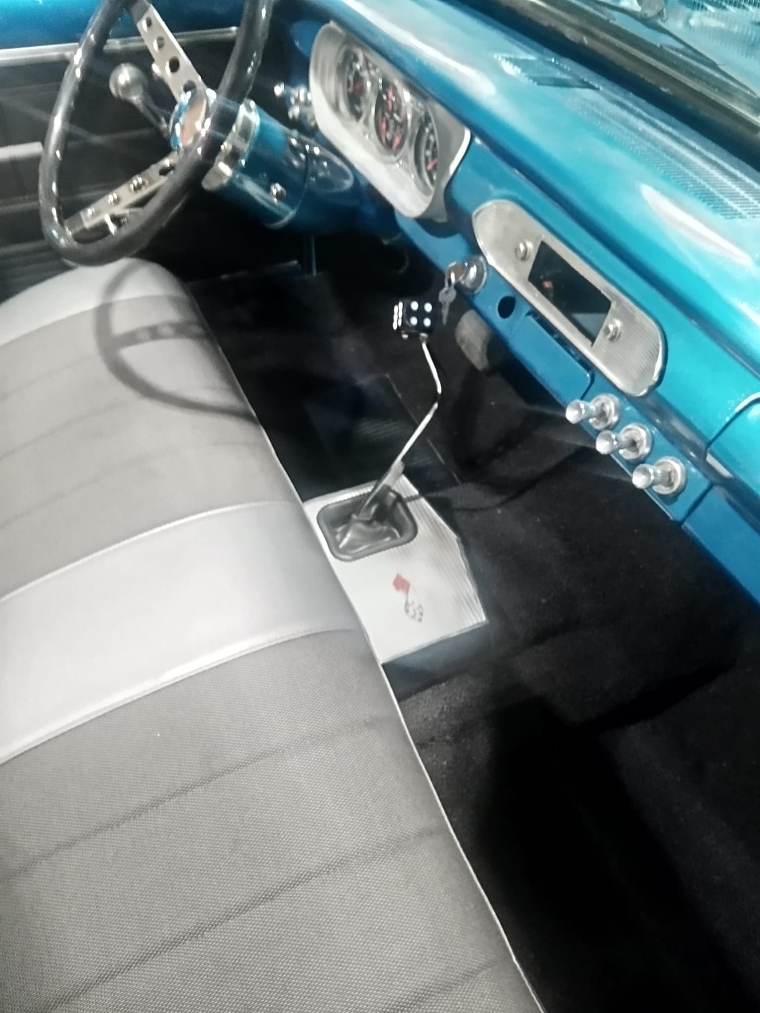

    @saltflats Is that a shifter mount on tail shaft housing?
  15. saltflats
    Joined: Aug 14, 2007
    Posts: 13,792
    saltflats
    from Missouri
    This one does use a tailhousing mounted shifter. It's out of a 63 Impala SS.
  16. fastcar1953
    Joined: Oct 23, 2009
    Posts: 4,296
    fastcar1953
    449792161_8197684646922416_3334897836403534514_n.jpg Wished i had one of those for my nova. I have a 4 speed boot for a bench seat 63 Impala. It has a Powerglide in it.

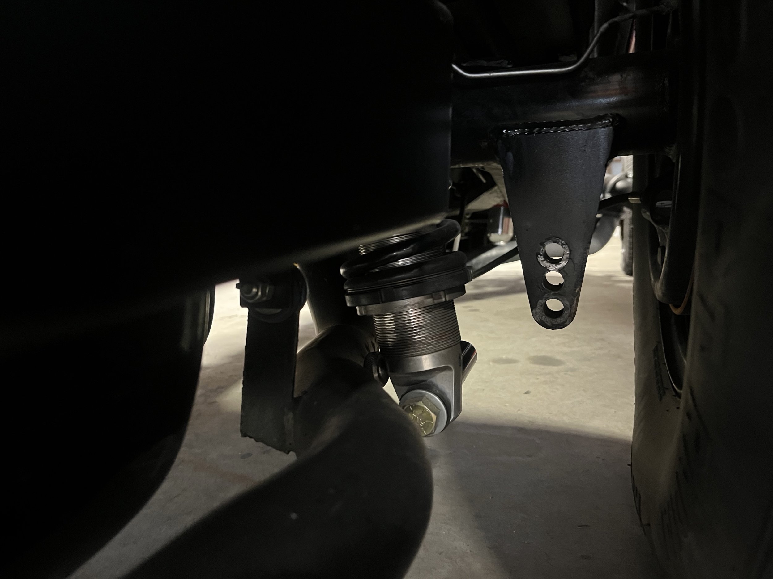

    All good ideas/questions.
    Double shear would be better.
    The bolts were grade 8 from the hardware store, but the grip wasn’t long enough and it broke in a threaded section. I replaced with longer Grade 8 bolts from a better source.
    Gulp…. No suspension travel stops!
    Thanks folks.

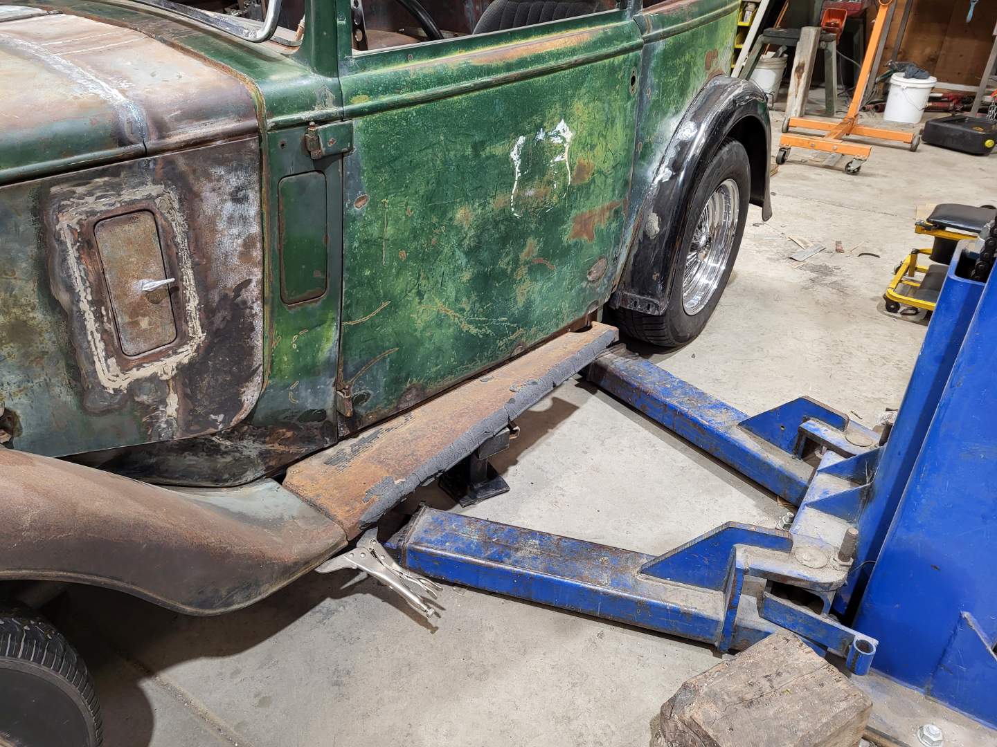

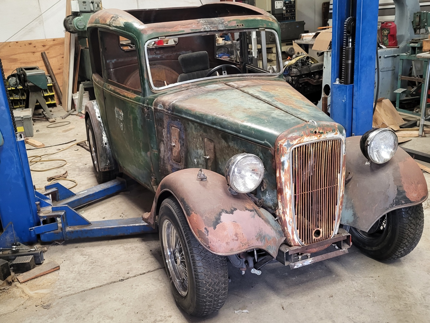

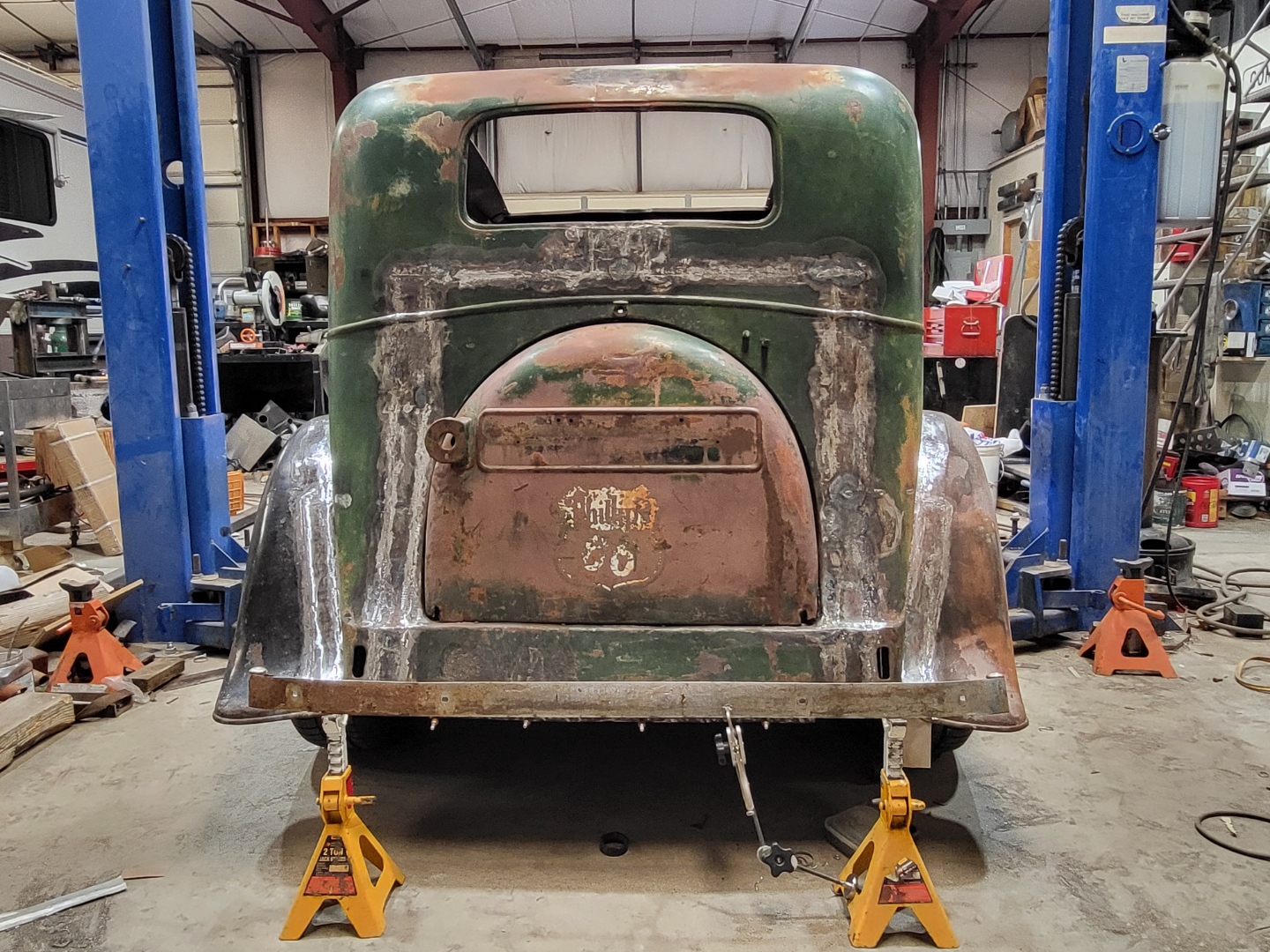

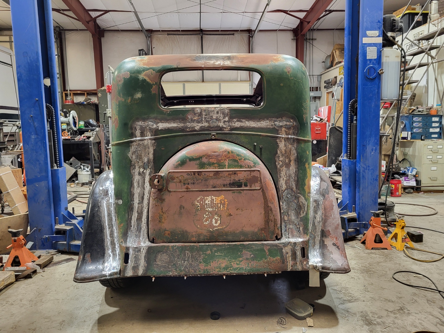

    I finished the vents in the hood and mounted the fenders to shape the lower edge of the sides. Then I widened the rear fenders and mocked up the original running boards. I will probably make new ones since the taper and extension would require a lot of welding on rusty and pitted pieces.
    Resized_20250502_131229_1746499600640.jpeg Resized_20250504_125239_1746499612270.jpeg
    I didn't like the look from the rear so I tried the original bumper. That seemed to help the look, but it is just a 2 x 3/16" strip of steel so no strength and not long enough. Maybe a g***er tube bumper is in the works.

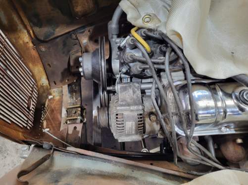

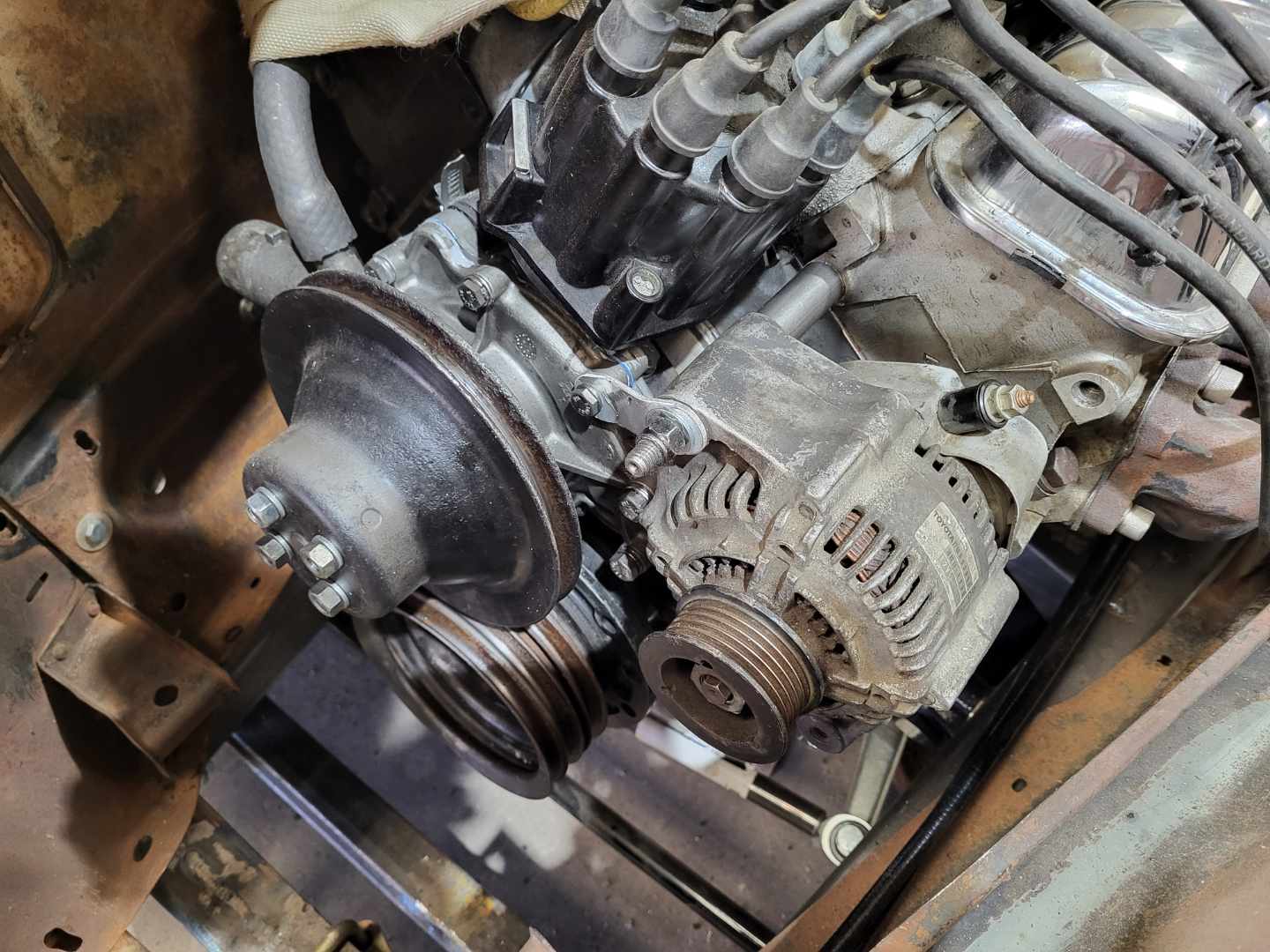

    Engine, check, 1962 Buick 215. Transmission, check, T5, exhaust, check, gl*** packs although I will have to check on the direction I installed them. Yesterday I dug out an old Toyota alternator that is no longer available that I was able to hang on one of the accessories mounting bosses on the 300 heads. It is a smaller diameter and not as deep as any of the later units and with an internal fan. A single groove pulley is on the way.
    Resized_20250506_171055_1746580997462.jpeg Resized_20250506_171109_1746580998897.jpeg
