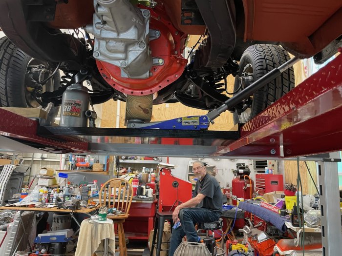

    Trying to figure out the one person engine/trans pull on the 51 Styleline. Everything is disconnected but when I lift the engine the trans presses down on the crossmember and won’t slide forward. Not sure if I can jack the trans up and slide forward and clear the firewall.

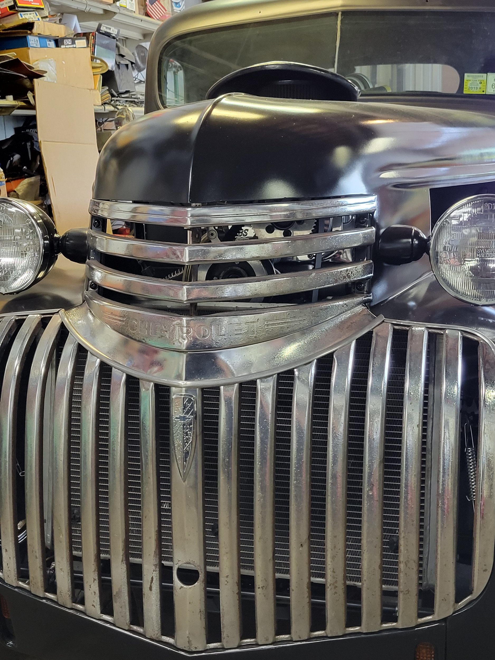

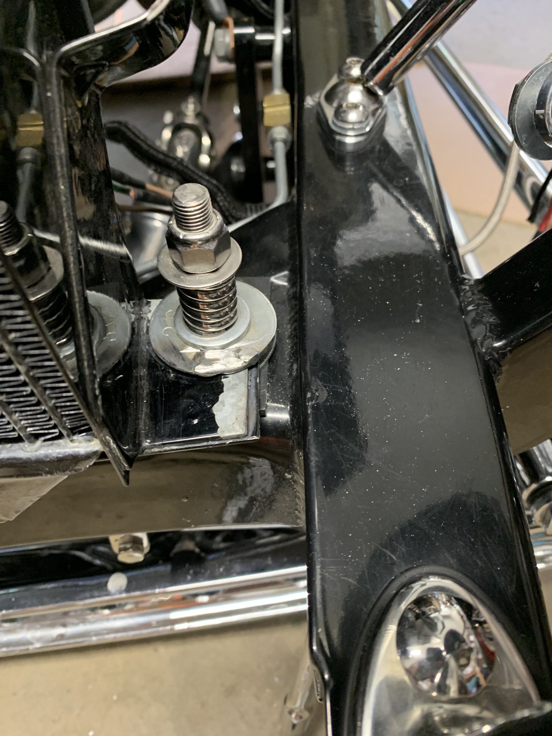

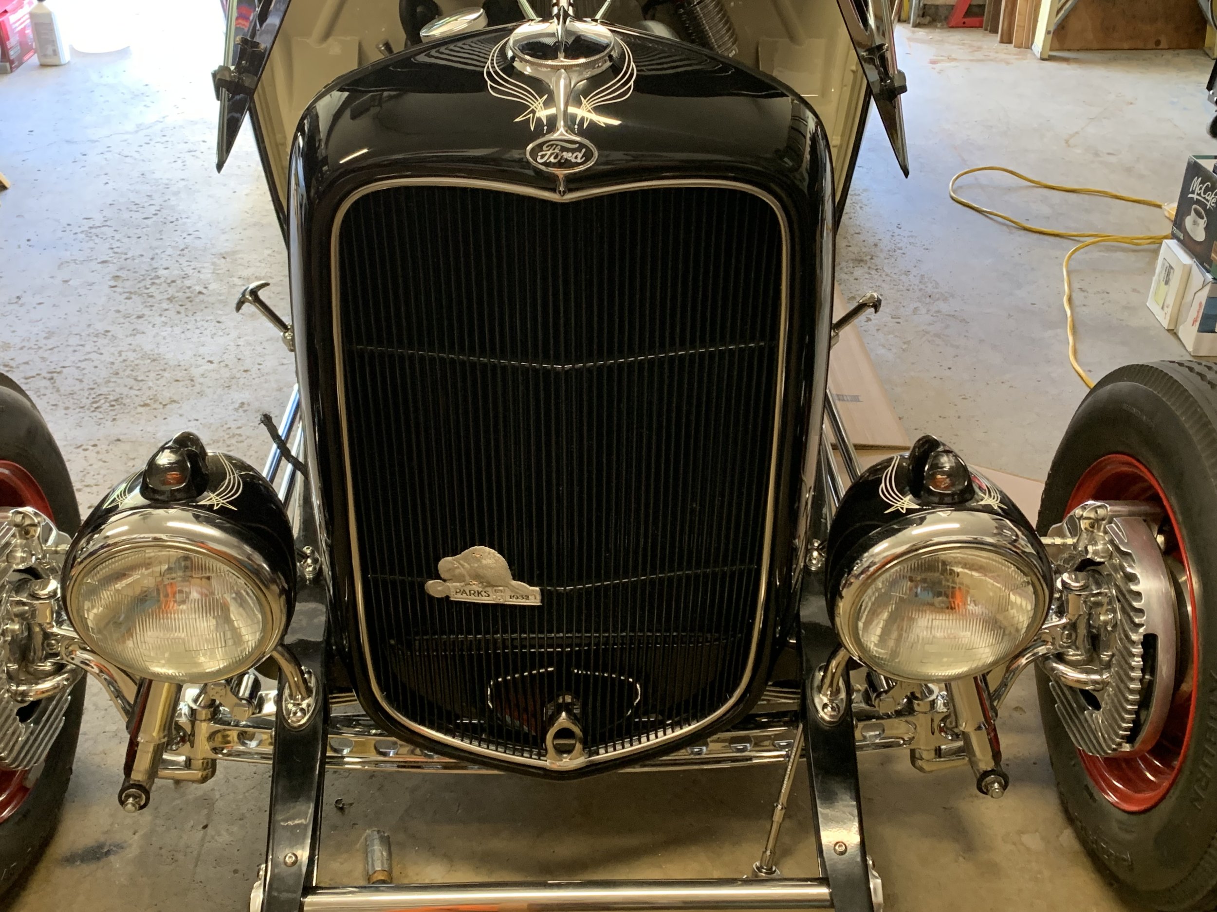

    After enough miles of shakedown it’s time to find and fix all those little nits that popped up. Never have two builds that work out the same even if they are basically the same type of hot rod.
    The Tudor is no different, so when it was time to take the grille shell off and pop in a freshly painted insert (black this time), it was time to see if anything shifted.
    Sure enough, the rad had wandered west a bit so it was time to invent a solution.
    Repositioned the rad and drilled some holes through the rad feet, spacers, rubber and the front cross member. Then made a couple little positioning pins welded to some washers that won’t interfere with the rad flex springs and re***embled everything.
    Worked out well and really like the black insert.
    Bonus is that the hood fits great again.
    Spring looks tight, but left space in each coil.
    Have to do a little paint touch up now. Boo

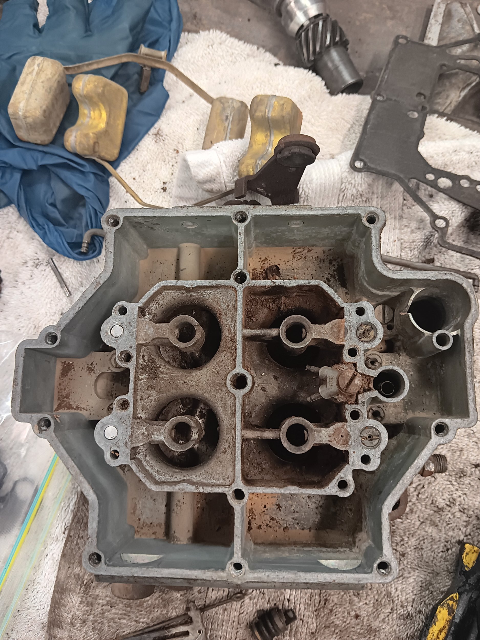

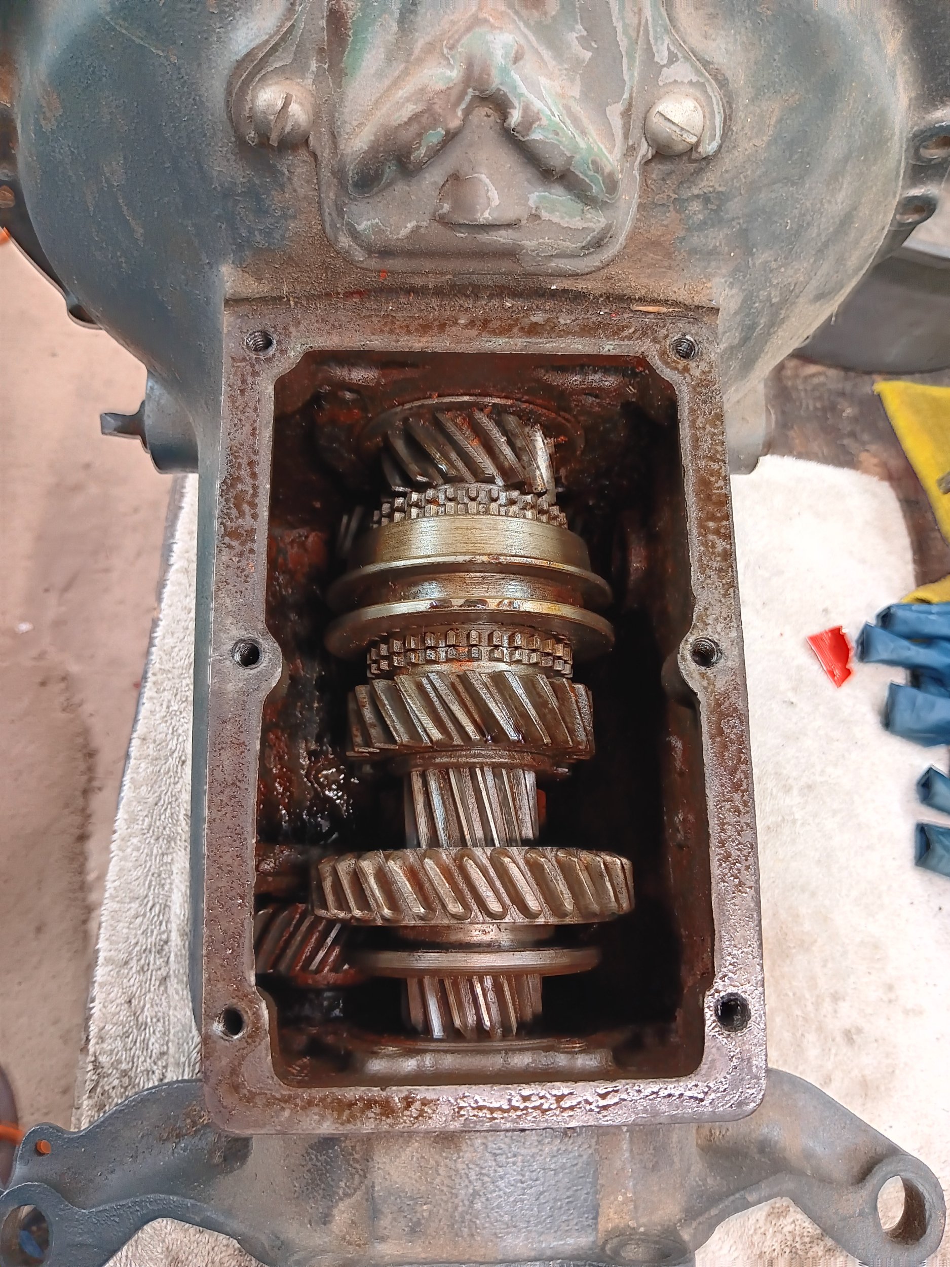

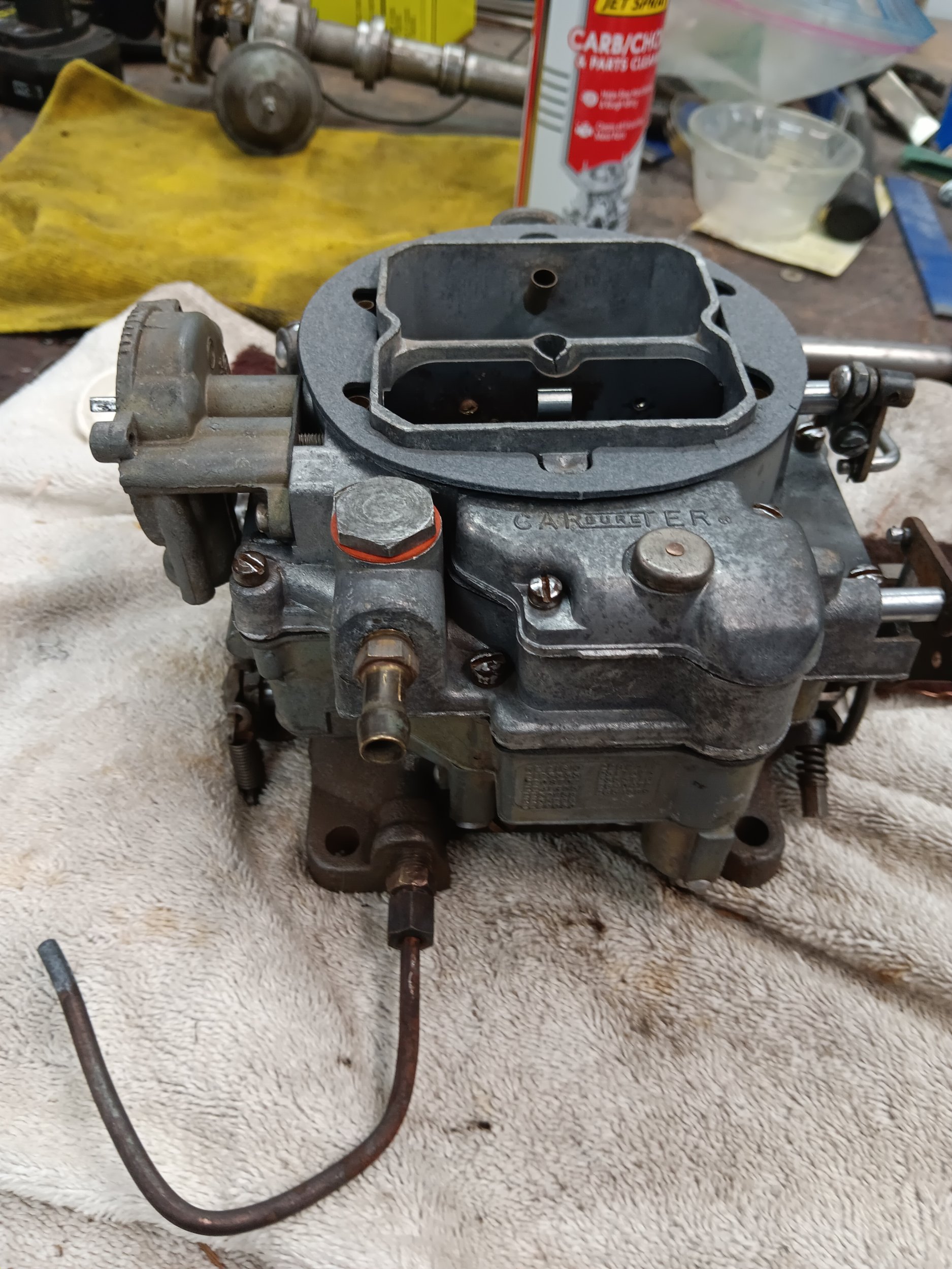

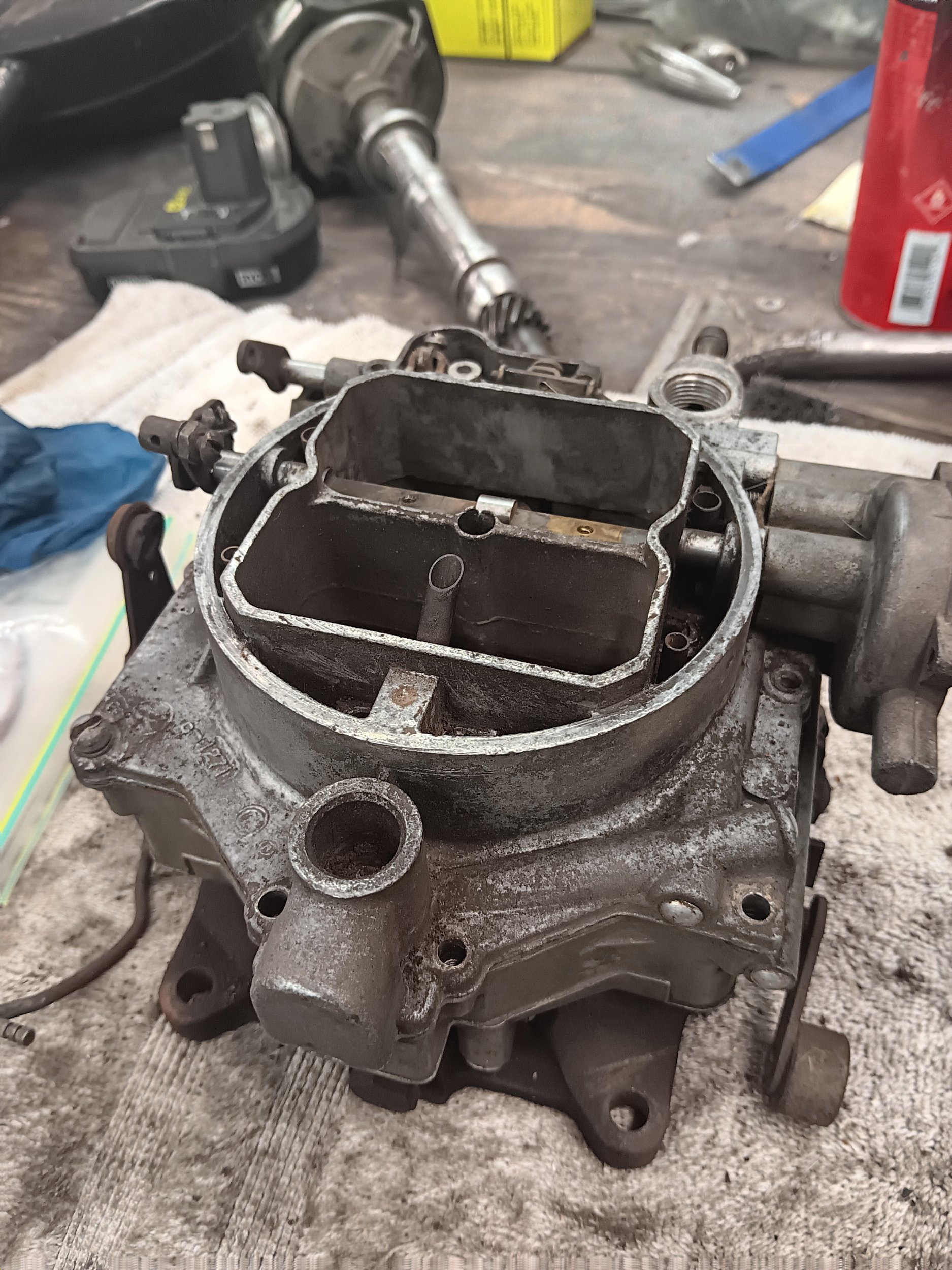

    Rebuilt the WCFB. It was bad.
    Now on to the 39 transmission. It's bad to ! Anybody have a 29 tooth cluster gear ?update on the trans, not one usable part! Only the case.

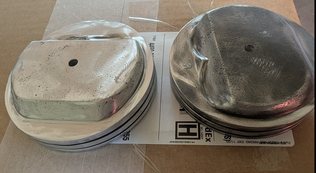

    Still waiting for my olds 303 pistons from Tony a year and counting so I decided to polish the fairlane today and take it for a short shake down drive. Picked up this dual action buffer of the Mac truck it's basically a Dewalt painted red works good but the car wears about 85% of its original paint so a guy has to be careful. 20250531_123156.jpg 20250531_123128.jpg 20250531_123218.jpg

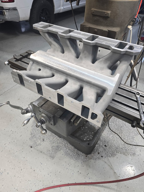

    The final machining is nearly complete on the first 2 MEL / 6-71 Intakes.

    Pits are ok and add some interest, but you need to lose the sanding scratches. I take metal to 3000, 5000 if I am show polishing. The more time spend sanding, the less compound and effort to polish.

    Well today I finally found out how to get the engine and transmission out of the 51 with just one person. As a local rider explained to me after stopping him to admire his OT 39 Ford, “you don’t pull it, you have to cut the transmission mount out “ it falls down in the back and will slide out. The stock mount apparently doesn’t fit the 700R4 and needs removed anyway.

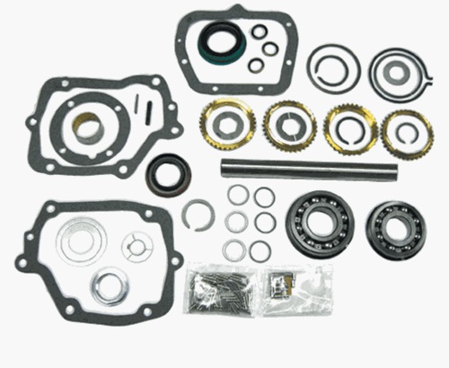

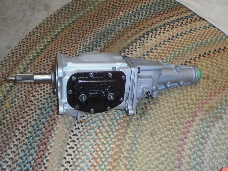

  15. Got the ****** kit and rebuilt the T-10. Got my cast aluminum oil pan and had a problem with the fel-pro gasket. No way will the bolts pull down the gap. Turns out, I'm not alone with this issue, so now I'm waiting on a Mr Gasket pan gasket. Still made in America I've discovered, not like Fel-pro is pushing these days.

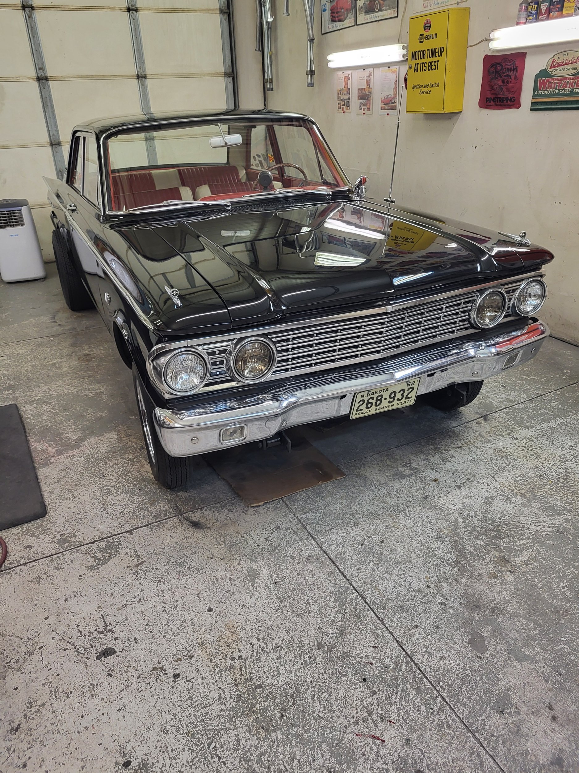

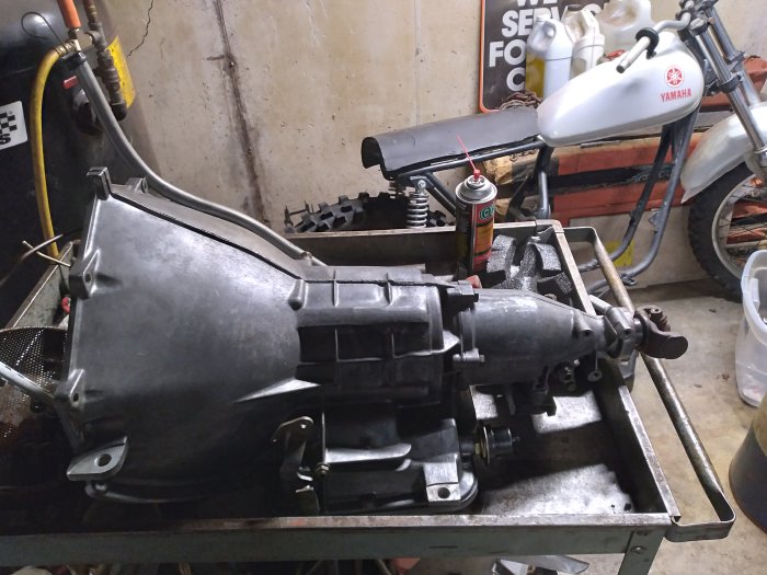

    Got the power glide back together and spent so time on the 62 Biscayne project. Got the clutch, ****ter shied, transmission and shifter installed.

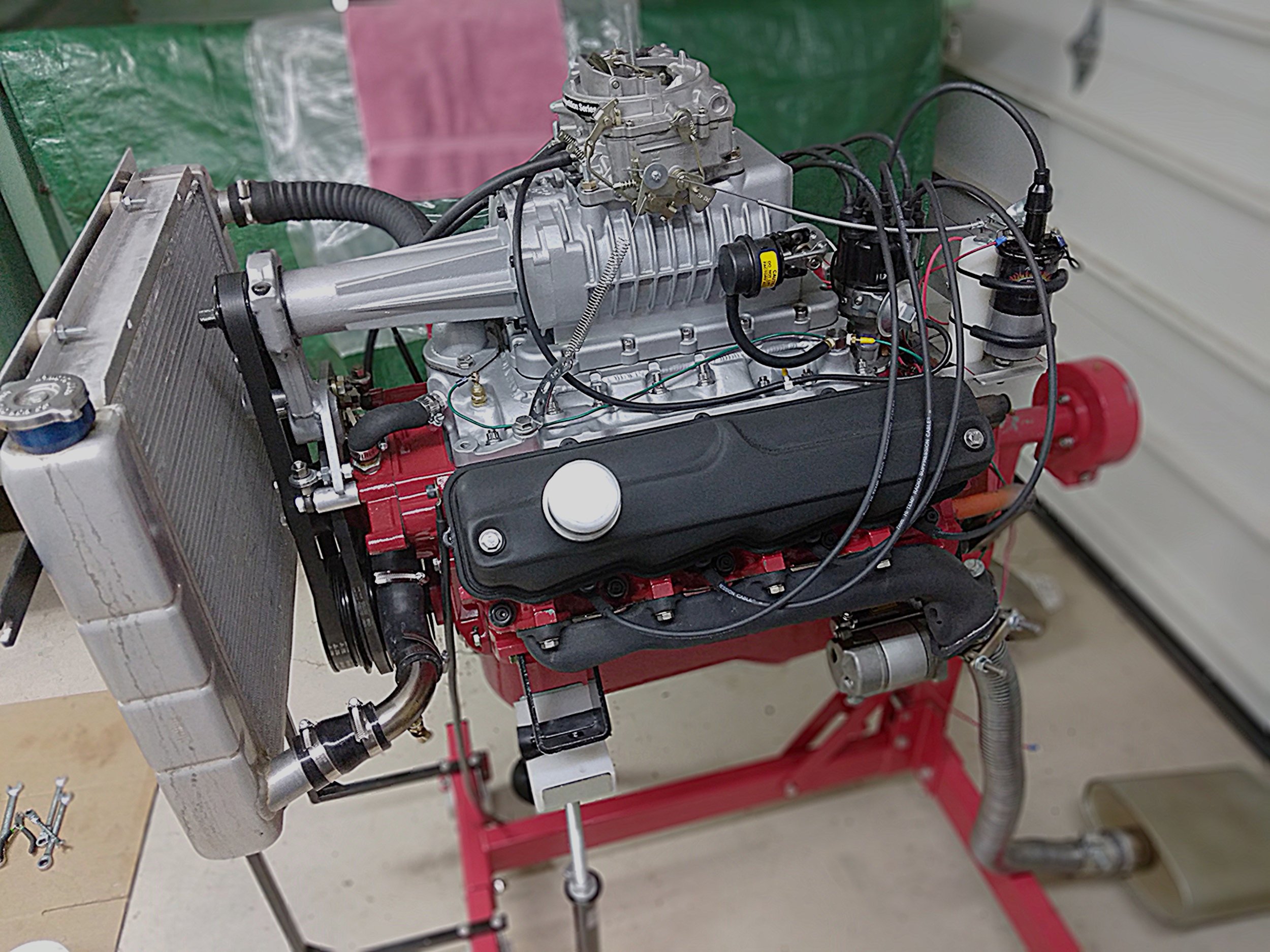

    #4.jpg Just completed camshaft break-in on my new engine.....

    Yes, 1963 Poly built to the following specs for my 65 Dodge Utiline SWB pickup. The intent was to have a fairly mild, stock-stroke engine that could put out decent HP and still have good manners and mileage.
    - .030” over on 1963 Poly block yielding 323 cubic inches
    - Decked to yield .015” piston to deck clearance
    - Align bored
    - All rotating parts Dynamically Balanced
    - Crankshaft re-ground to .010” / .010”
    - Sealed Power CP series Rod & Clevite P series Main Bearings
    - **** I-beam connecting rods
    - NOS TRW Forged Pistons (L2270F), increased valve relief diameter and depth for 1.94” intake valves and increased lift
    - SpeedPro E178K Moly Rings
    - OEM camshaft reground by Oregon Cams to:
    224/224 @ .050”, 270/270 adv, .470”/.470” lift, 112 sep (Lift = .499" with 1.6 rocker change)
    .022”/.022” lash hot
    int open 0 btdc close 44 abdc
    exh open 44 bbdc close 0 atdc
    0 degrees of overlap @ .050”
    - Heads:
    o Re-surfaced to achieve 30RA or better surface finish for Cometic MLS gaskets
    o 1.94” / 1.60” Pro-Flo stainless valves / Comp 747-16, 10-degree locks / Comp 614-16 (+.050” offset Retainers) , .060” lash caps on Exhaust valves
    o Schneider Valve Springs # 68044, 125 lb. seat / 310 lb. open (break-in were Comp # 942-16 springs)
    o OEM rockers, Rebuilt, bushed and modified by Rocker Arms Unlimited to 1.5 and 1.6 ratios (1.5 Intake / 1.6 Exhaust)
    o New hardened rocker shafts, new ARP 3/8” – 24, 12-point adjuster screws and nuts
    o Teflon Positive Valve seals
    o Gasket-matched and Ported
    o Cometic .040” head gaskets
    - Smith Brothers push rods
    - FlowKooler water pump #1701
    - Summit Racing billet gears and double roller timing chain set
    - Howards Cams Direct Lube (EDM) solid lifters
    - High Volume Melling Oil Pump w/custom pickup to fit modified Chrysler Marine oil pan (7 quart capacity)
    - Weiand 7503 (original Weiand prototype manifold, modified by owner for supercharger)
    - Carter Compe***ion 625 CFM 4 barrel (9636SA), manual choke
    - NOS Carter street / strip mechanical fuel pump
    - Ford 302-351 Headers w-custom Poly head port adapters designed and machined by owner (not shown in the break-in picture)
    - Pertronix Distributor (for now)
    - Magnuson 112C supercharger
    - 440 Source billet steel flywheel w-SPEC stage2 clutch
    - TKO 600 5-Speed
    - 7.8 Static Compression Ratio / 10.0 to 10.9 : 1 Compression ratio with 6 PSI boost depending on formula used (cranking pressure 136.6 psi)
    Yielded 461 HP per Performance Trends software (which is usually within 2-3% of dyno runs based on replies from several pro engine builders on the Speed-Talk website. I have also made provisions in the intake manifold to spray water or water-methanol to cool the charge if needed which might yield a bit more with timing changes.

  23. EarlyMoPAR, that is an absolute jewel of an engine. Thank you for the thorough rundown explaining each element and the precision invested in making this poly what is possible. The basic engineering was always in this engine's design but you've unleashed a lion by careful machining and ***embly, and some clever creativity in several places. Thanks for the treat for us old MoPAR fans.

    You are welcome osage orange. It has been a lot of fun but also slow (and discouraging at times due to errors made by both the shops that did the block machining and cylinder head work). I gained a big respect for these engines when my dad bought a new 59' Plymouth Sport Suburban 9-p***enger station wagon, We moved to Oregon in 1960 and that car received a lot of use and never once had issues. So when I got my pickup 12 or so years ago, the first thing I wanted to do was to put a Poly engine in it, so that started the process for me. The Poly was an "option" in the truck when ordered but mine came with a slant 6 and 3 on the column like many did.
