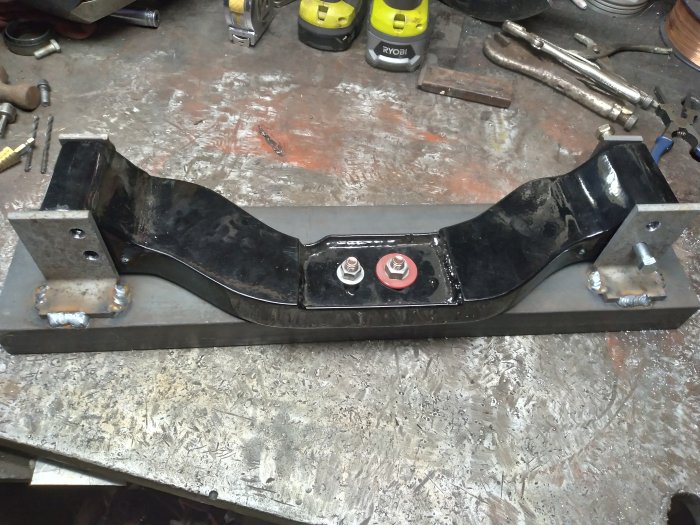

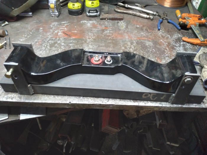

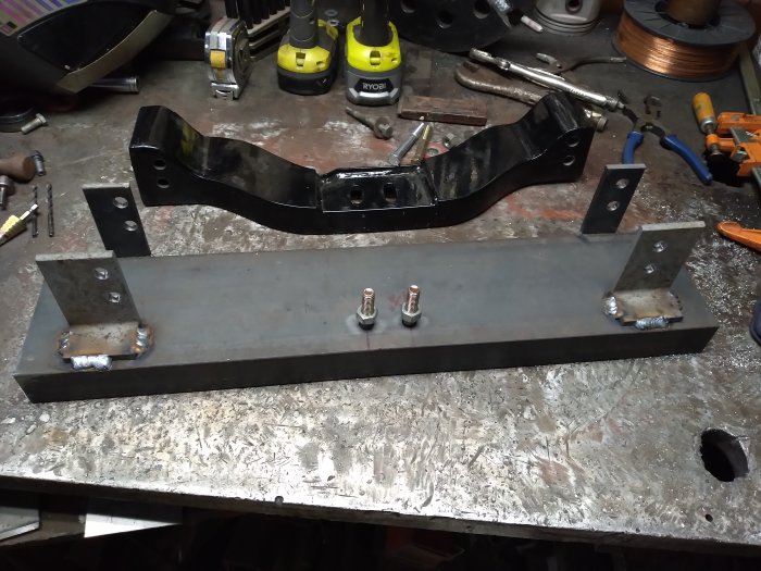

    Working on a fixture to recrate a crossmember to install a Richmond 5 speed in a X frame Chevy. I had one for a project coming up so I one for the pattern.

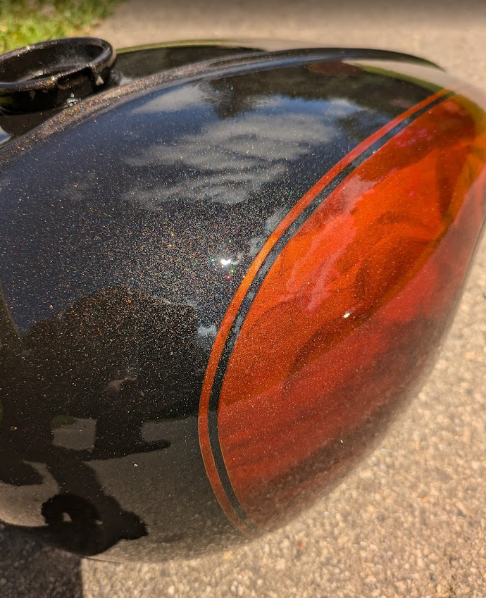

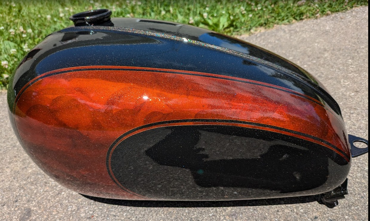

    Finished. Good enough for an old Triumph.
    Couldn't resist adding a little Spindrift flake too.
    It's Black. With HOK Gold base graphics. Then acetylene smoke. HOK Candy Tangerine over that. Urethane clear with the flake. Other than the black, the paint I used is VERY old.

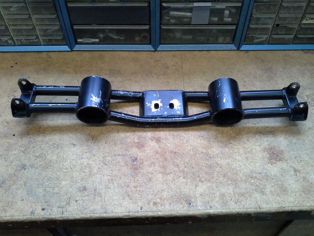

  17. DDDenny
    Posts: 23,431
  18. saltflats
    Joined: Aug 14, 2007
    Posts: 14,131
    saltflats
    from Missouri
    I built one similar to that for a 84 Camaro to be able to run the exhaust from the headers back.
  19. DDDenny
    Posts: 23,431
    My Nova is pretty low, nothing I hate worse than the sound of expensive mufflers s****ing pavement.
    porkshop, Tickety Boo, pila38 and 3 others like this.

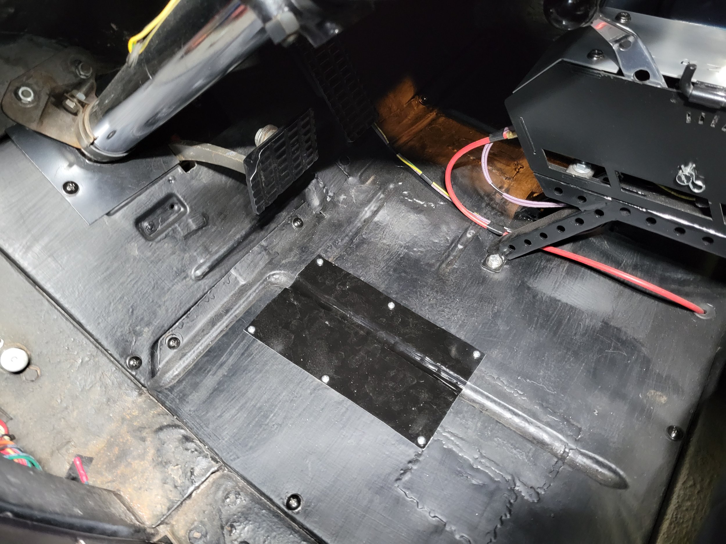

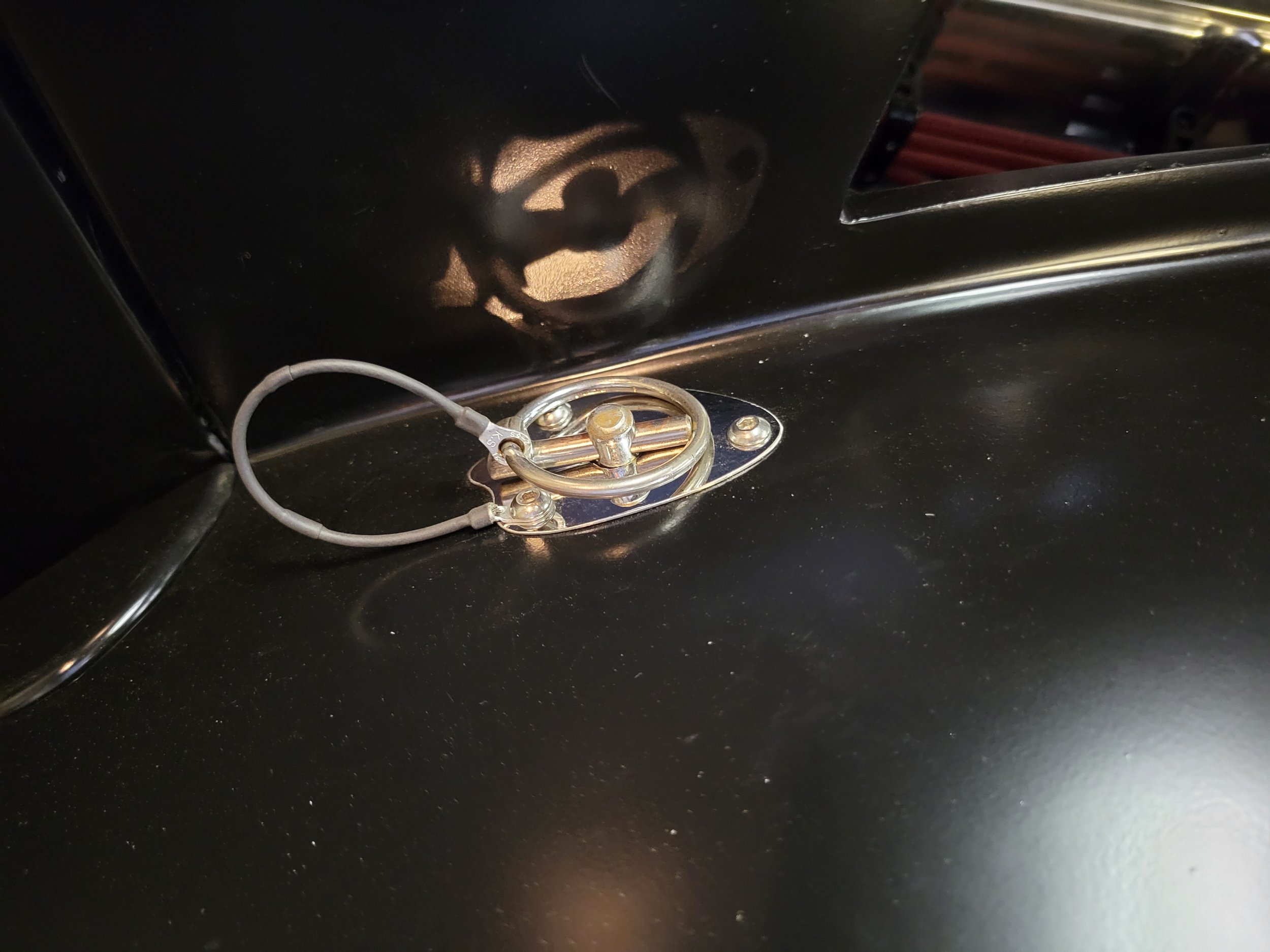

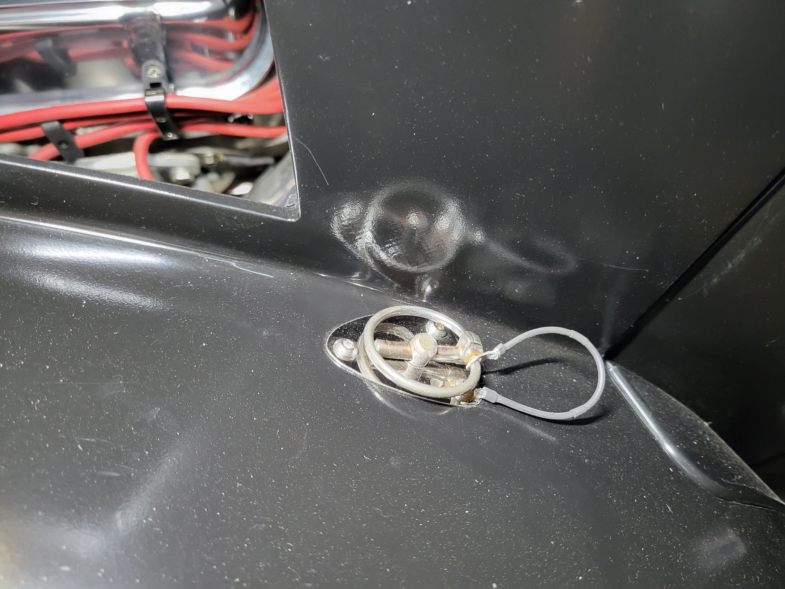

    I made that access panel to cover the hole in the floor for the master cylinder on the 41 pickup, damn hole was like a blast furnace on my leg.

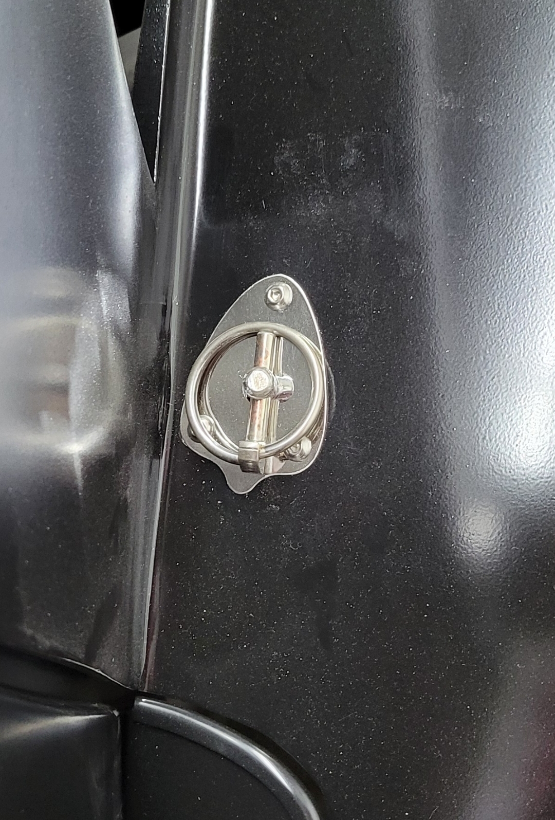

    Then I made up these little cables to hold my hood pins and keep them from disappearing. I had cut the pins down so the rings had an interference fit over the ends to keep them from walking out by themselves but I still didn't trust it.
  23. atch
    Joined: Sep 3, 2002
    Posts: 6,767
    atch
    The bead in the MC cover is a nice touch.
    How did you get the wiring terminal onto the ring?
    osage orange and swade41 like this.
  24. swade41
    Joined: Apr 6, 2004
    Posts: 15,001
    swade41
    from Buffalo,NY
    I chucked a chisel in the vice, slipped the ring over the chisel, then put an awl on the other side of the ring and pulled it out of that little block. It put up a fight but I was able to get one side out just enough to slip the terminal end in there.

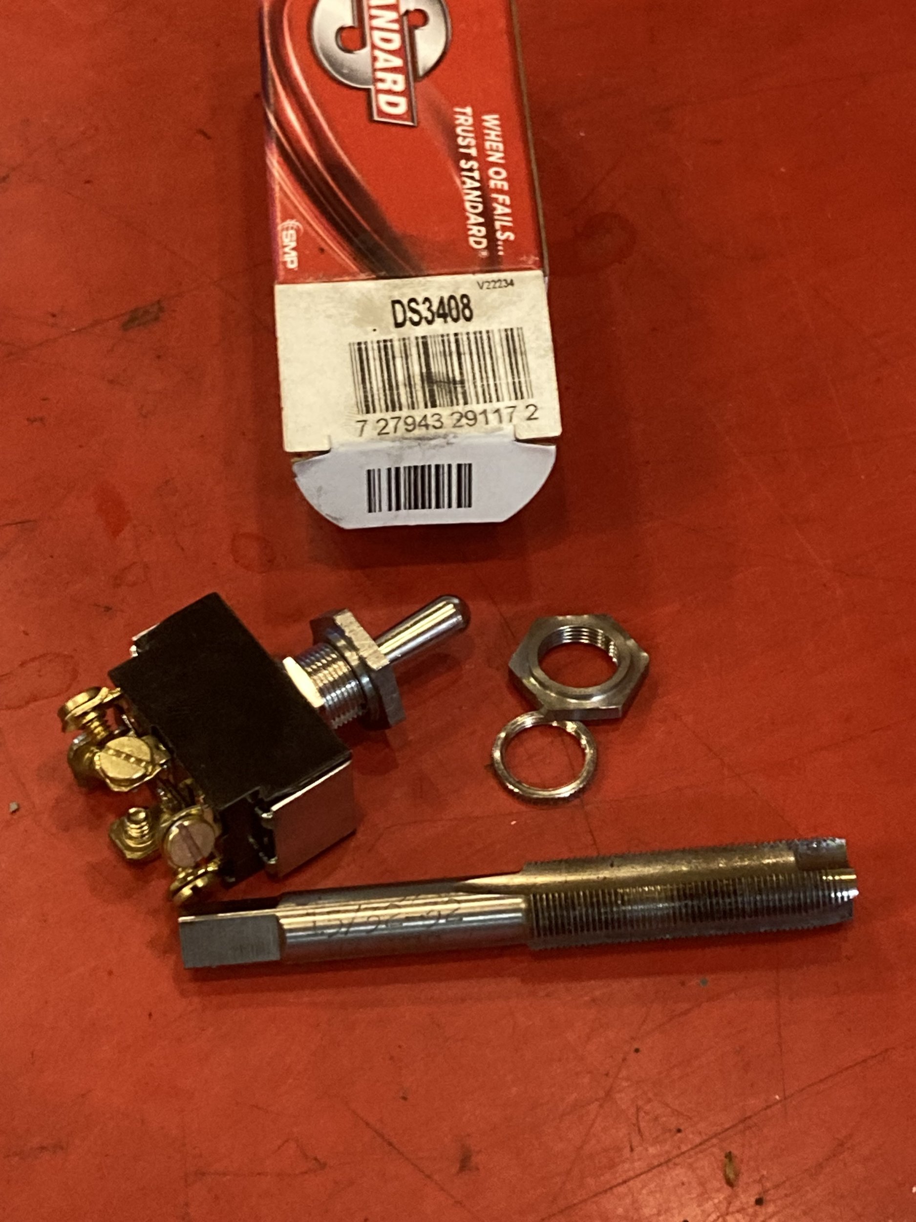

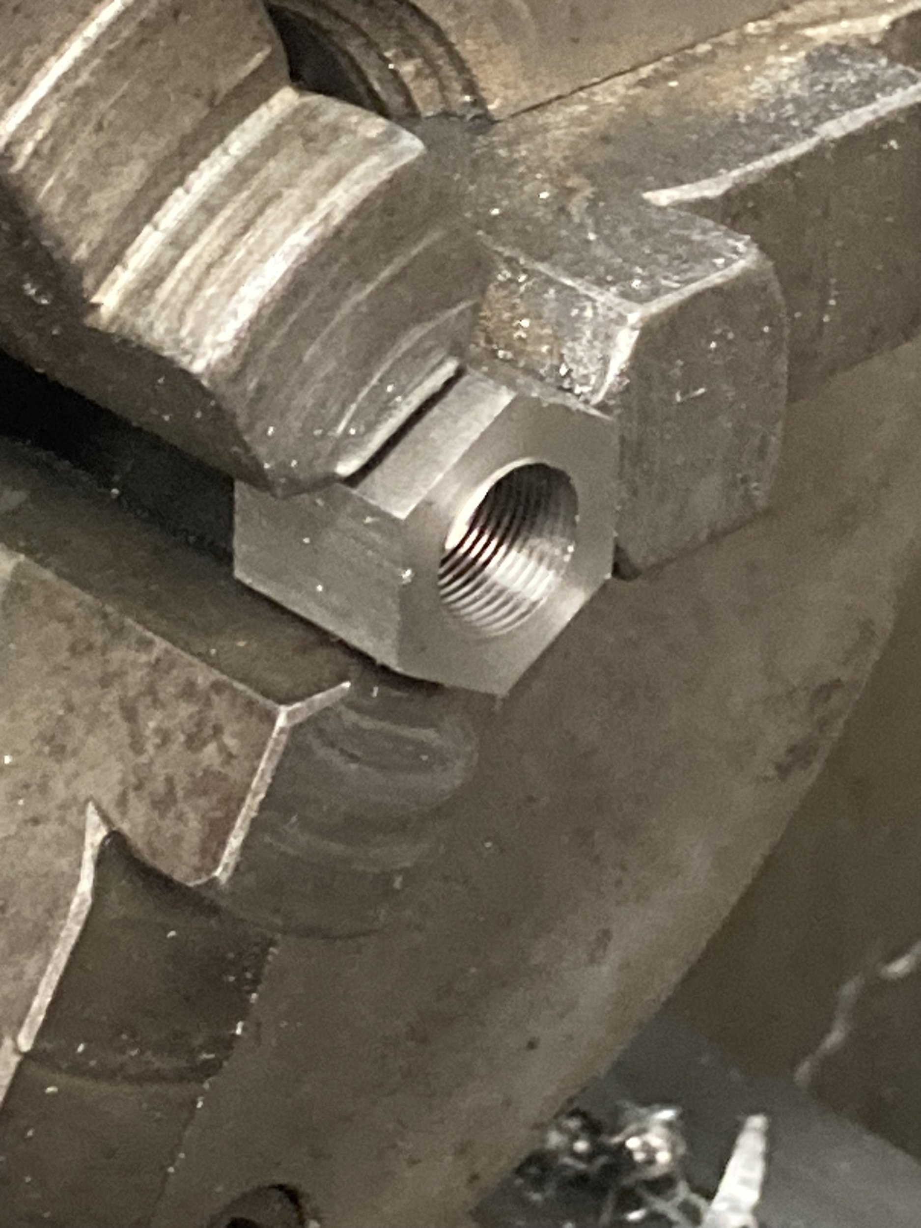

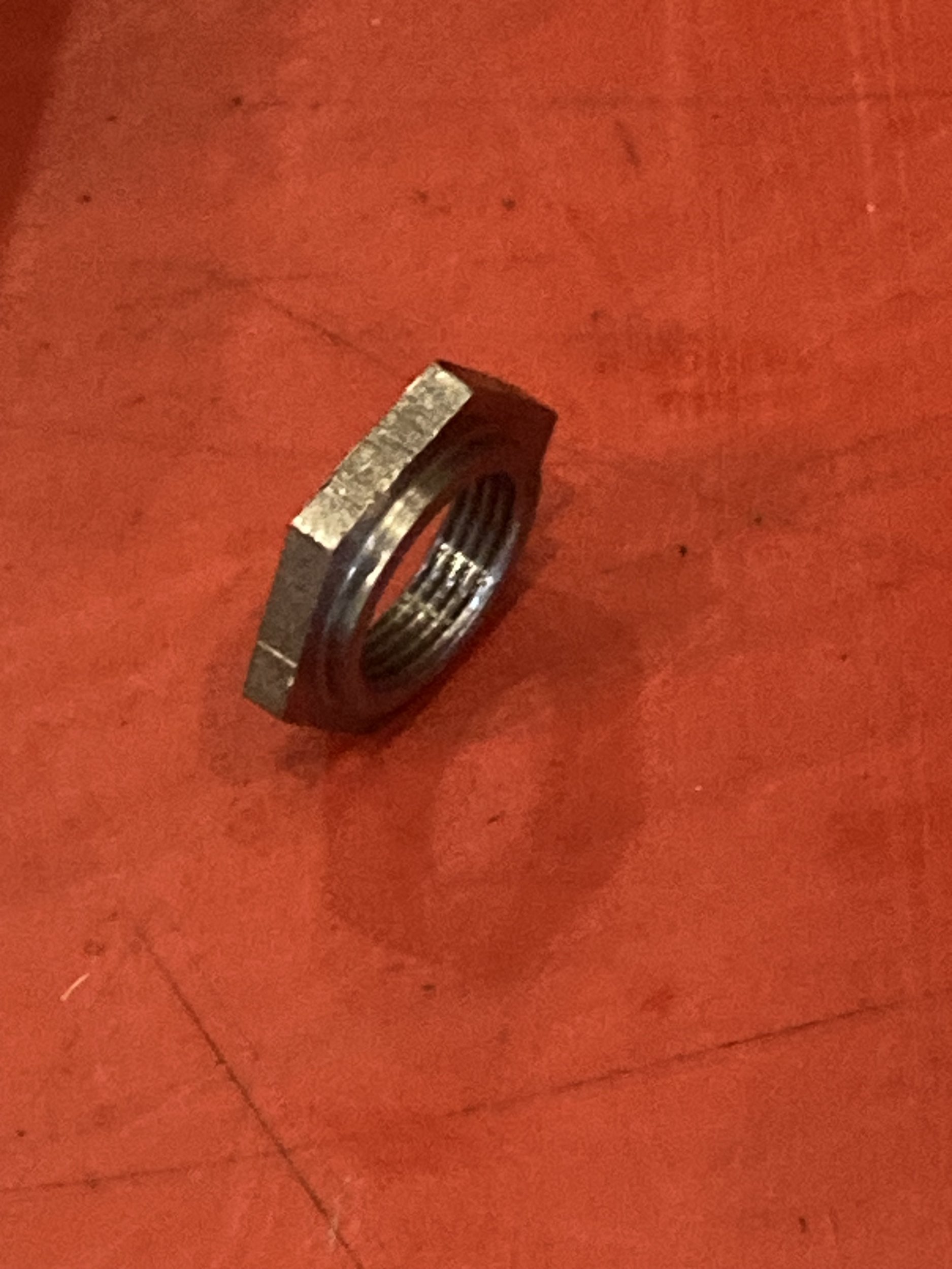

    15/32-32 thread nut, weird but I think I saw a listing for 1/4-100 in McMaster-Carr
