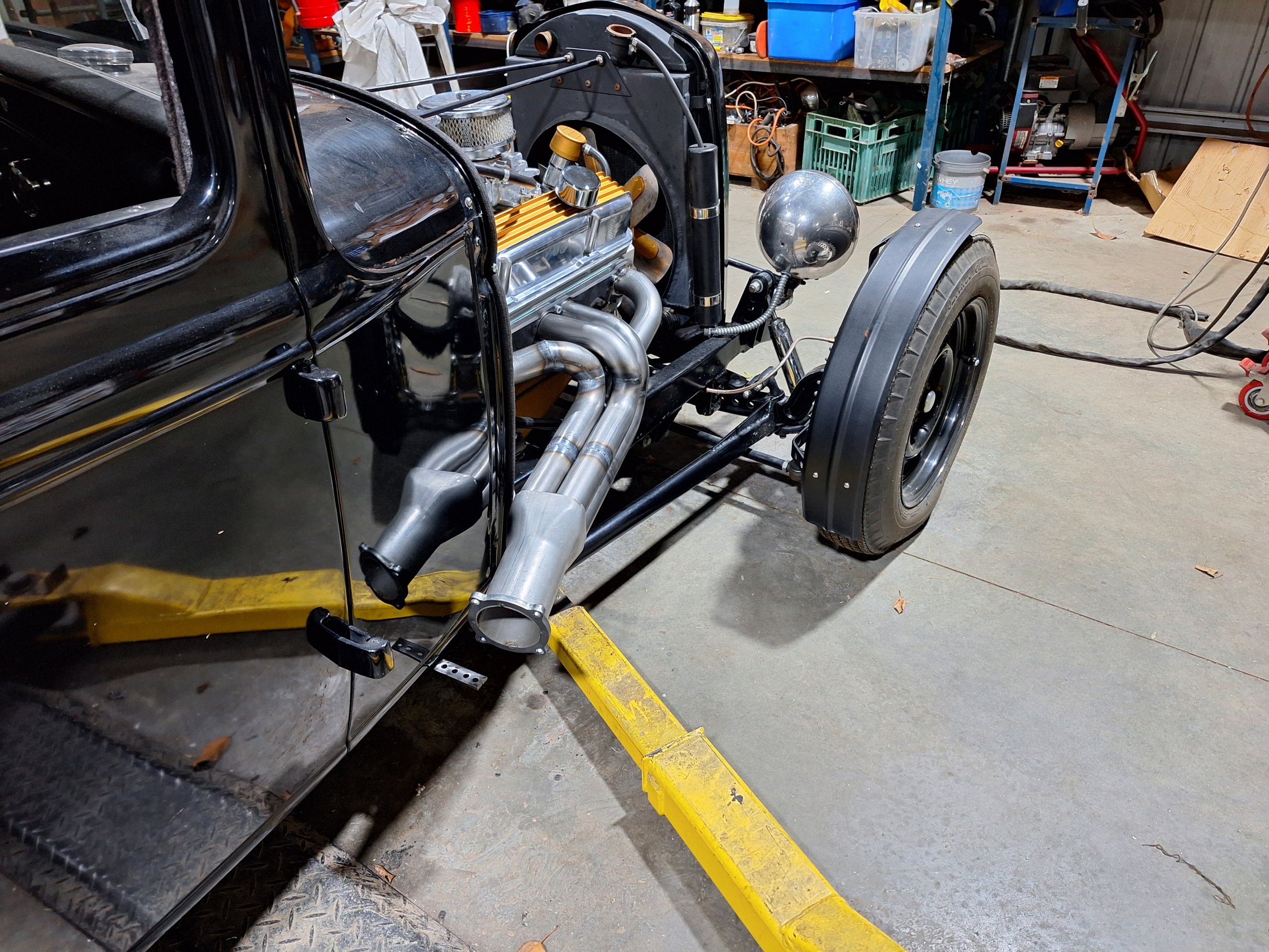

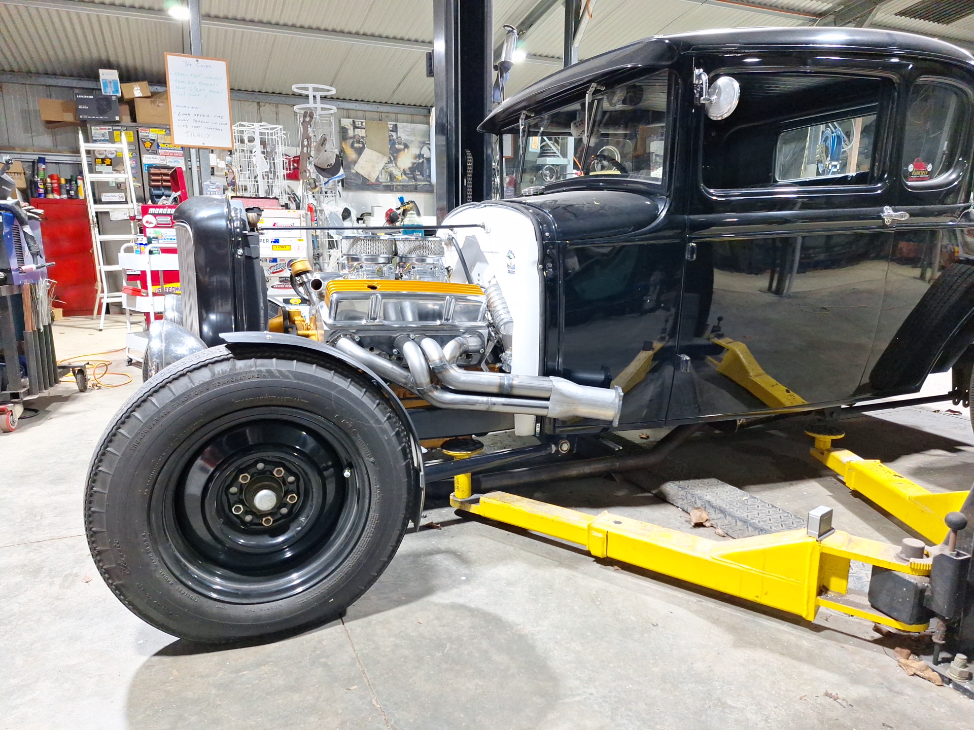

  1. Bandit Billy
    Joined: Sep 16, 2014
    Posts: 17,208
    Bandit Billy
    That looks to be a nice little hot rod your playing with.

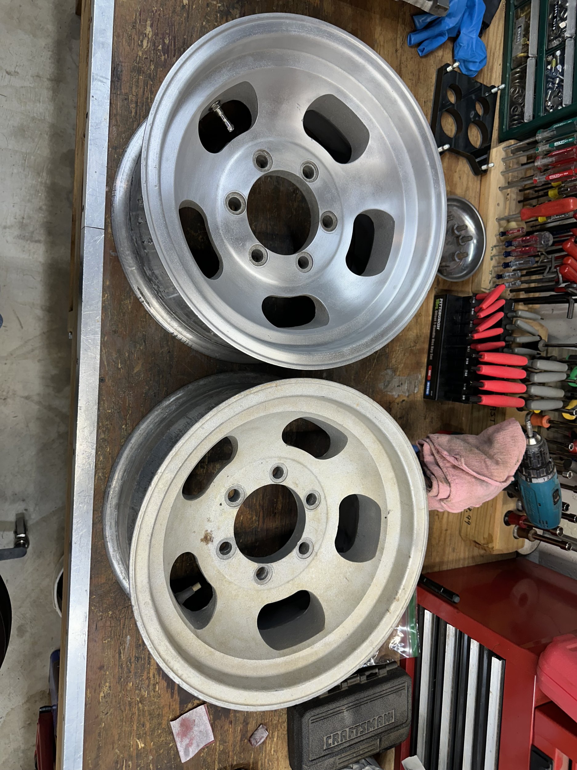

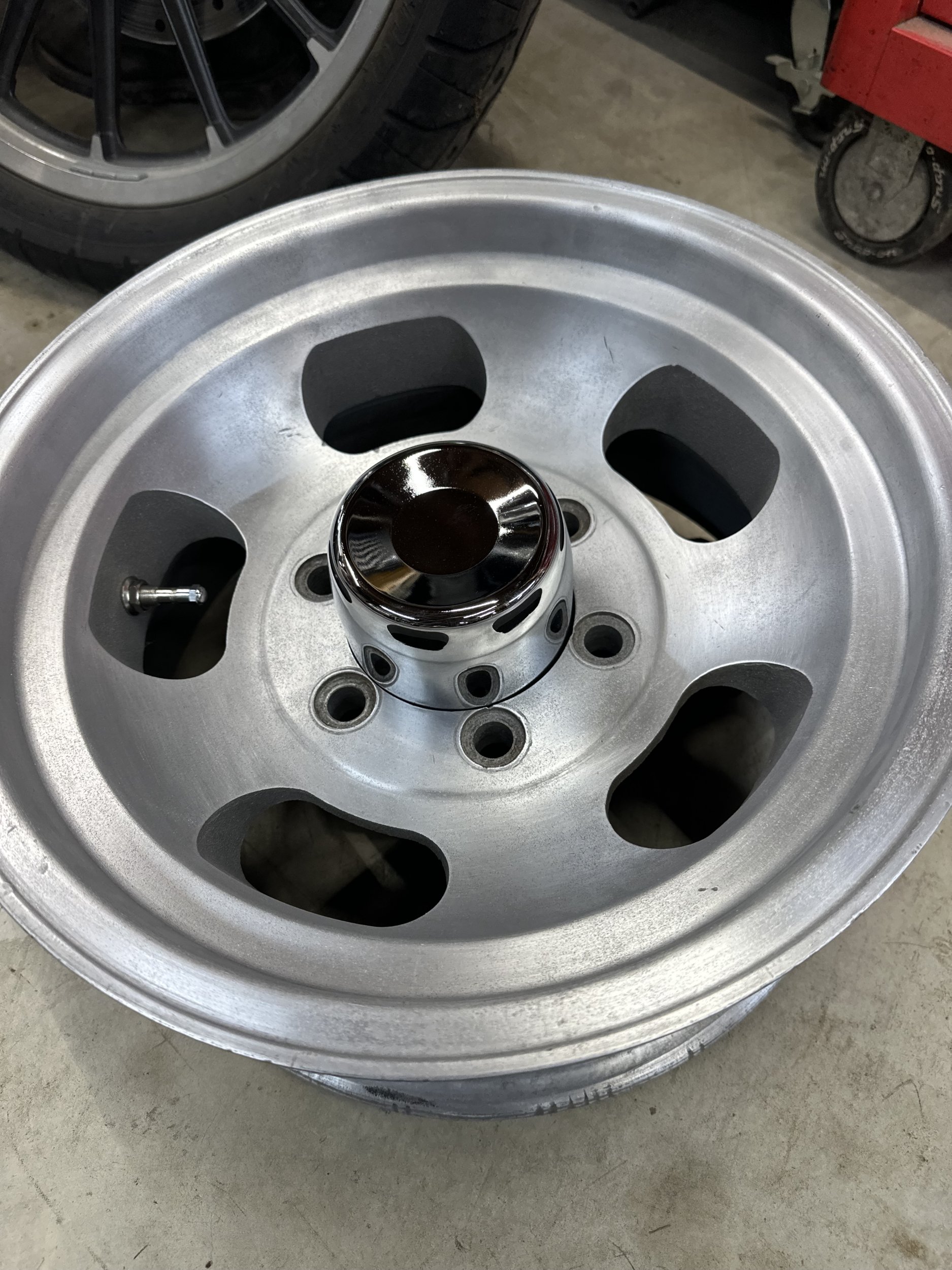

  2. IMG_9662.jpeg IMG_9663.jpeg IMG_9652.jpeg When we were at Bowling Green last month, I scored a set of 15x7 Aluminum Slots for $150. Someone had sandblasted them and I’m in the process of sanding them out. I don’t want polished aluminum, I’ve ridden Harley Davidsons for almost 30 years and hate maintaining it, just a smoother finish than what’s on there now. I believe these will look nice on Papaw. I also swapped the 600 Edelbrock for a Quadrajet. It runs better all over and makes that glorious Q-Jet music when I kick it in the ***.

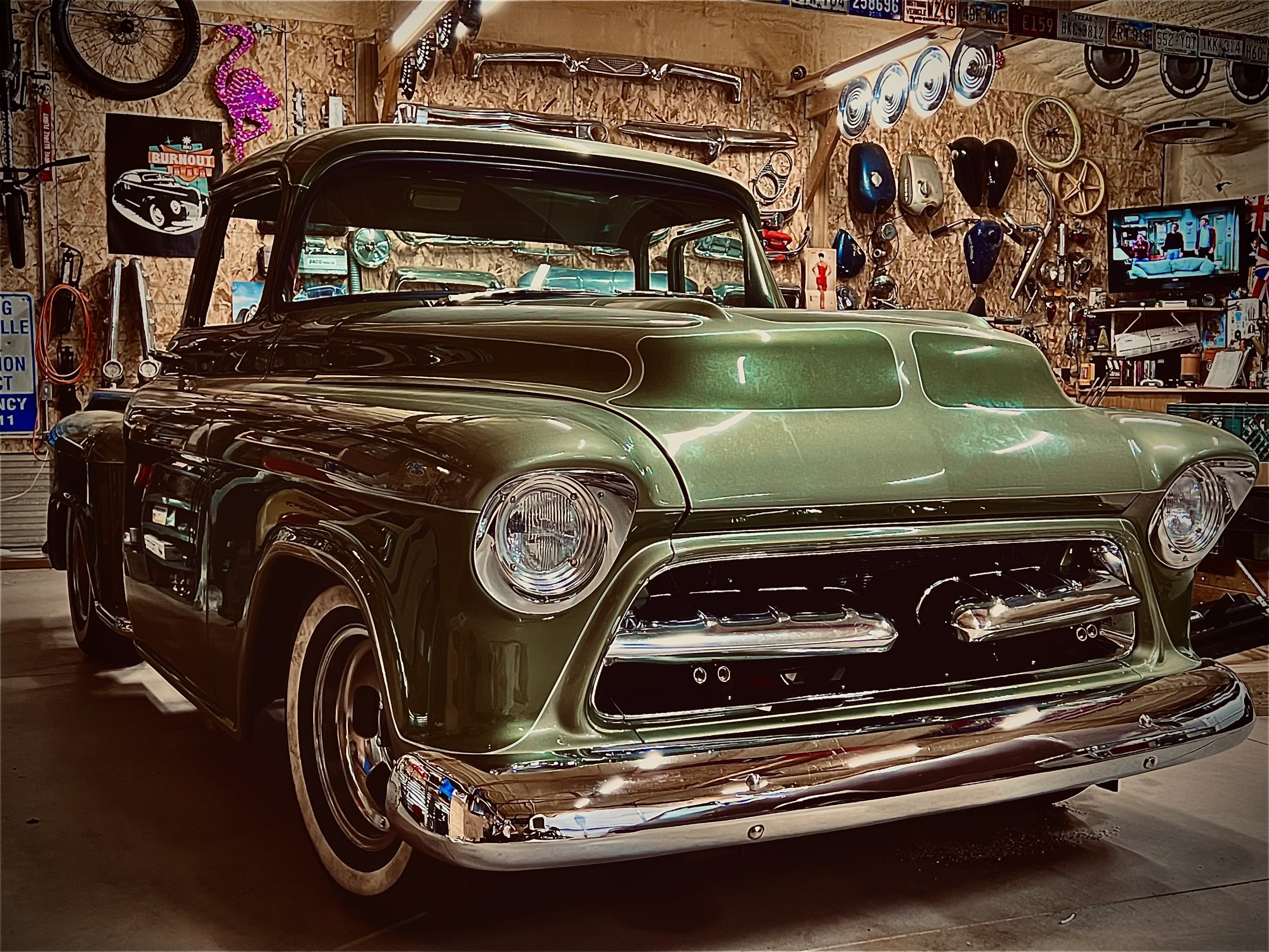

    Finished putting the grille in.

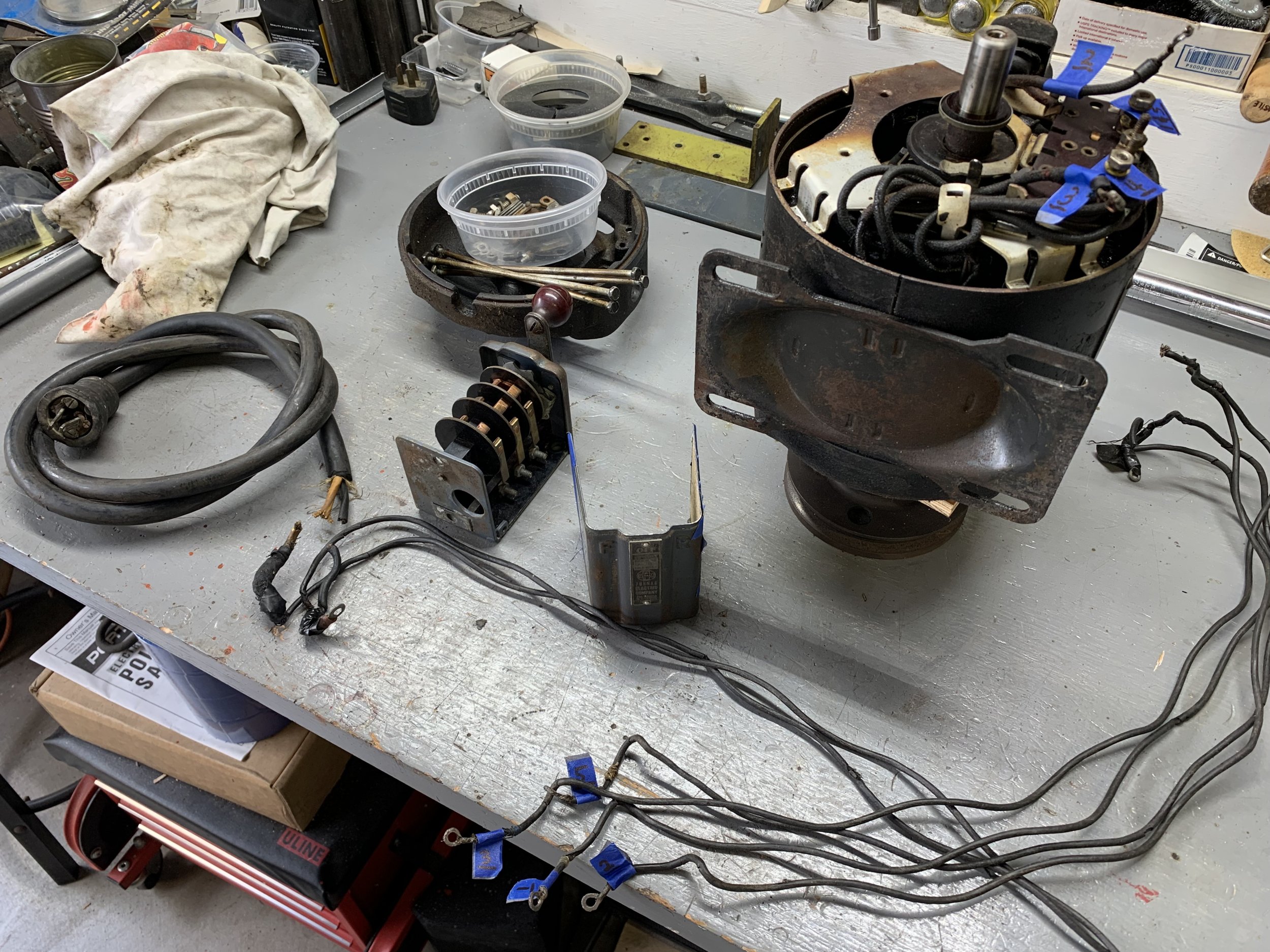

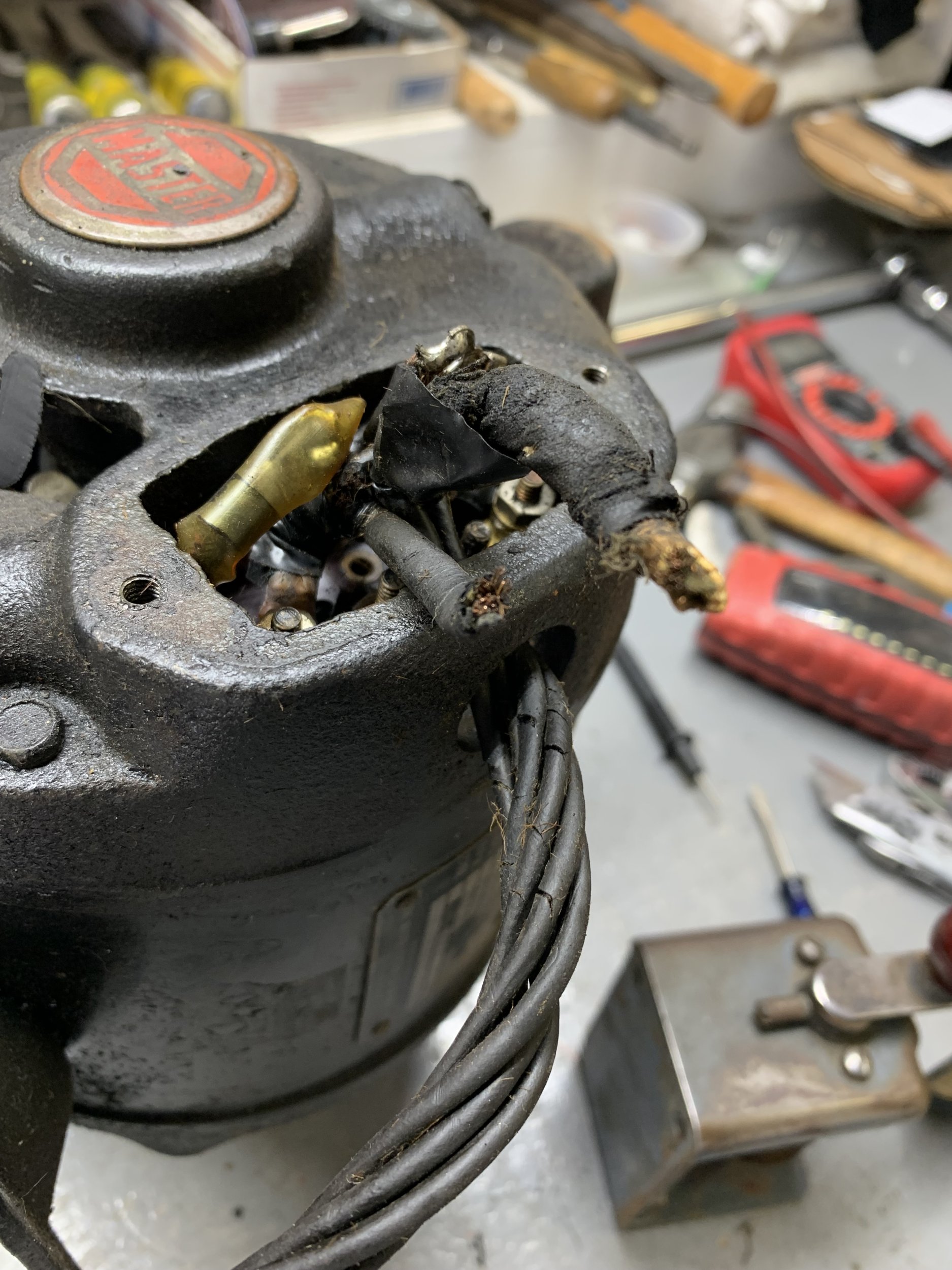

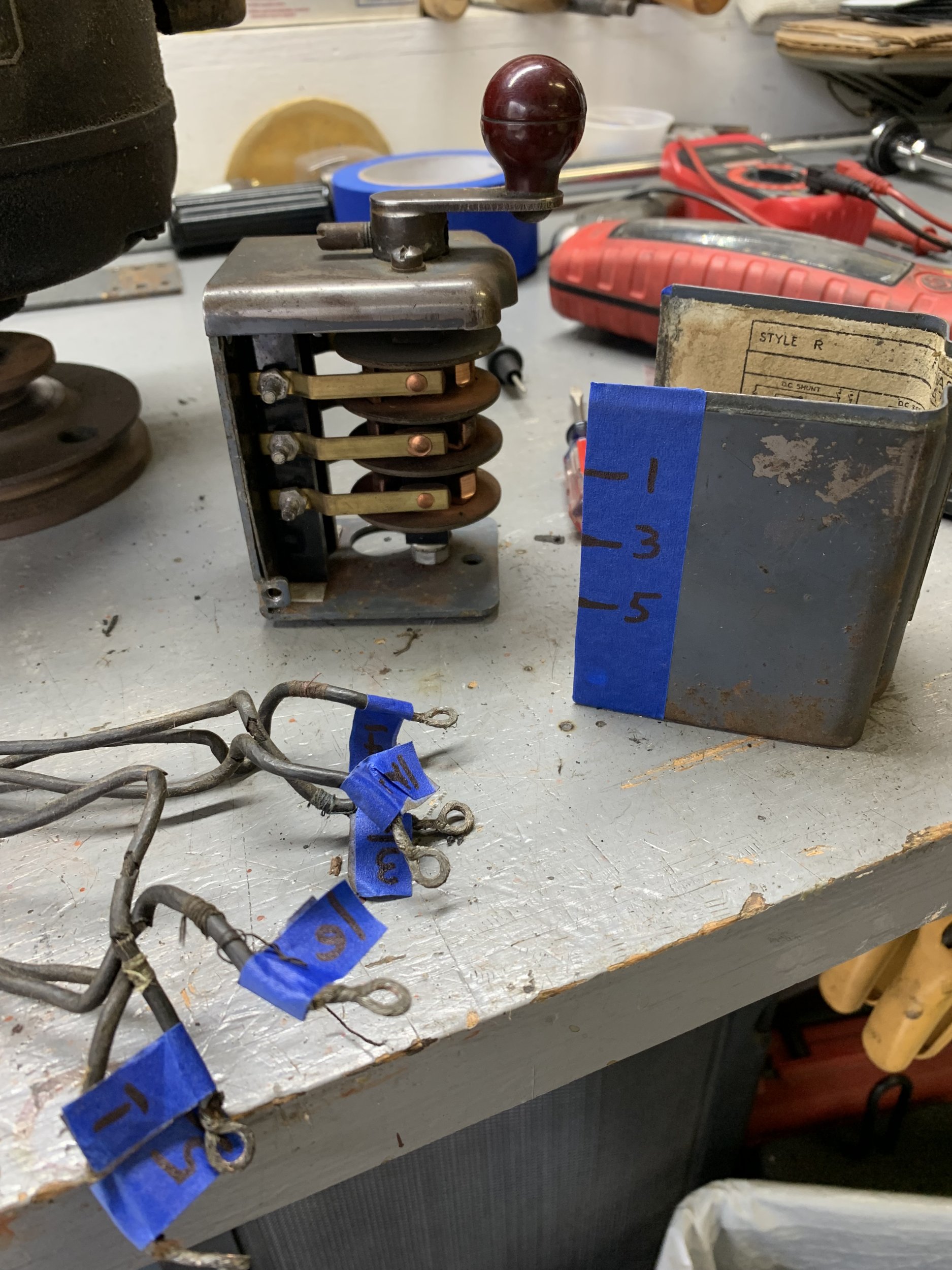

    New power supply wires for a Logan 820 lathe IMG_4360.jpeg IMG_4361.jpeg IMG_4362.jpeg

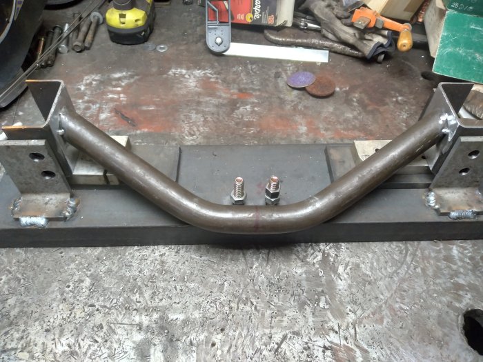

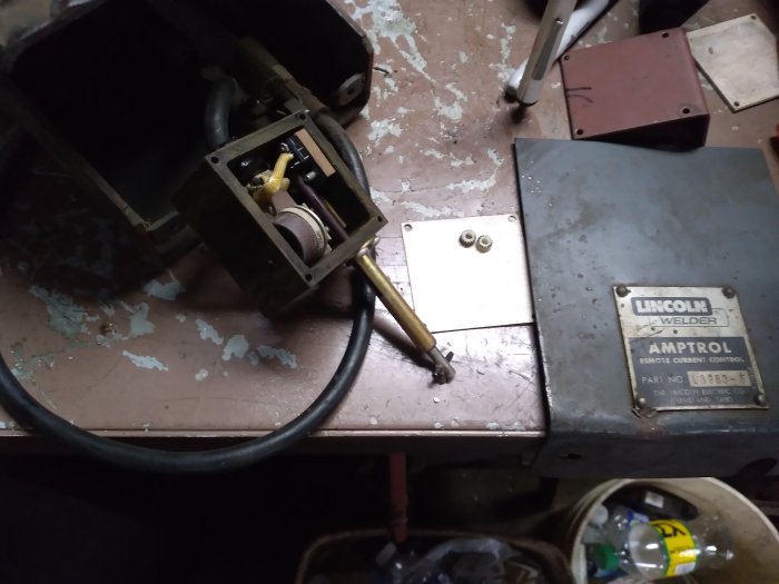

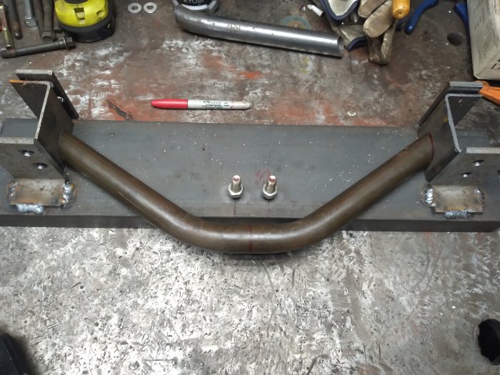

    Well made it this far on the crossmember project. Having some trouble with my tig welder I need to figure out. Seems to what to run too hot or not hot enough. Maybe the amptrol.
  6. patsurf
    Joined: Jan 18, 2018
    Posts: 3,407
    patsurf
    better go into manufacture w/ a jig that nice!

    Does look like the amptrol has a problem. The little white gears are not secured to the shaft of the rheostat.
    Could be an interesting fix.

    how many wires go to it?

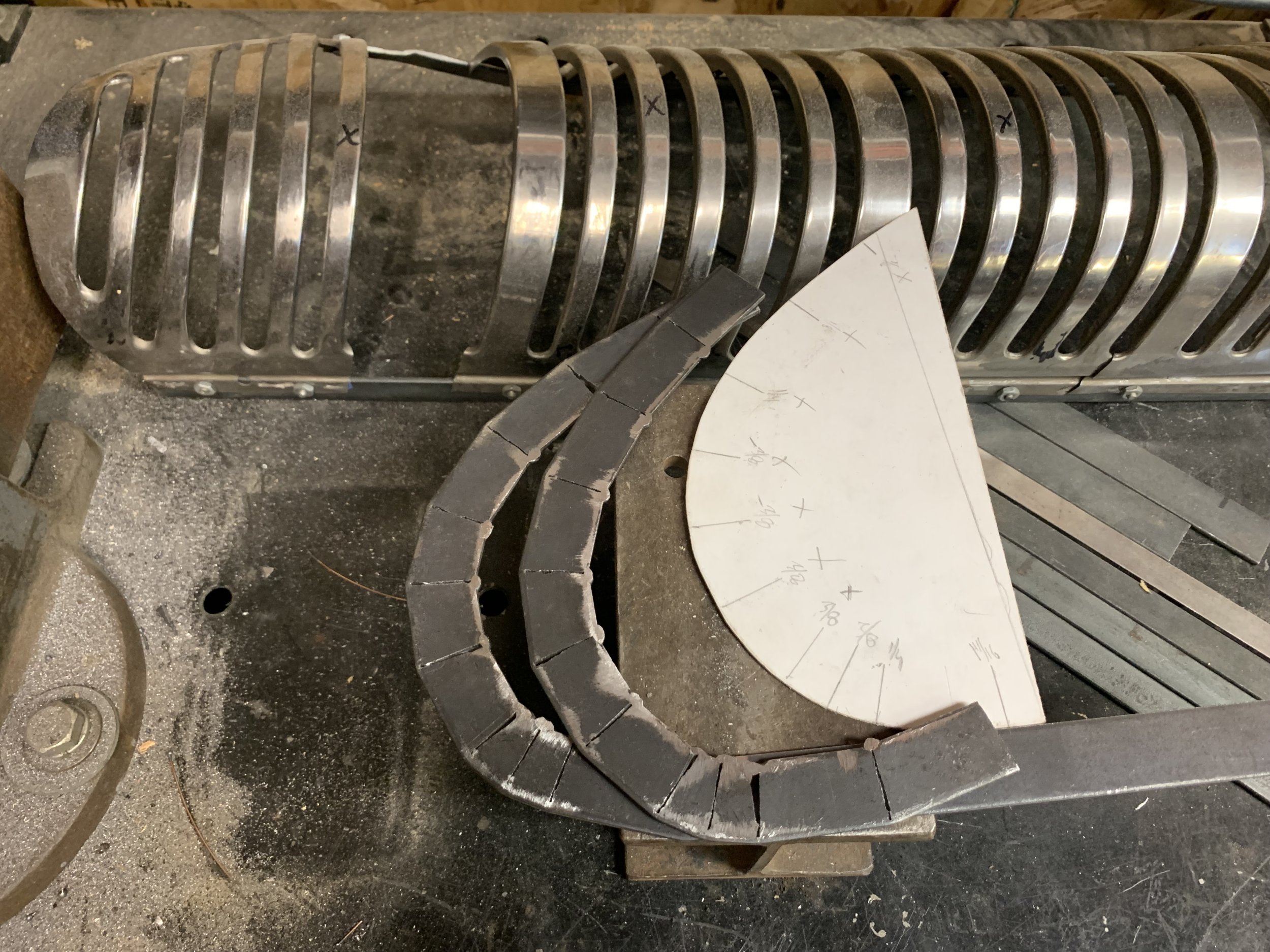

    Spent day repairing rotted soffits on the house and then Tonight worked in some free time to slice and dice some flat stick to create curved ends for a frame to mount my grill pieces. I dissected a mercury grill to straighten and lengthen it … IMG_2577.jpeg IMG_2840.jpeg

    It's a 5 wire with 2 different plugs. Old Lincoln 300/300.

    is there a way to use only three and put a generic rheostat on it or can you buy one on ebay?

    No it needs the 5 wires to work. I'll look into fixing this one first. It went together it has to come apart so should be able to fix it.

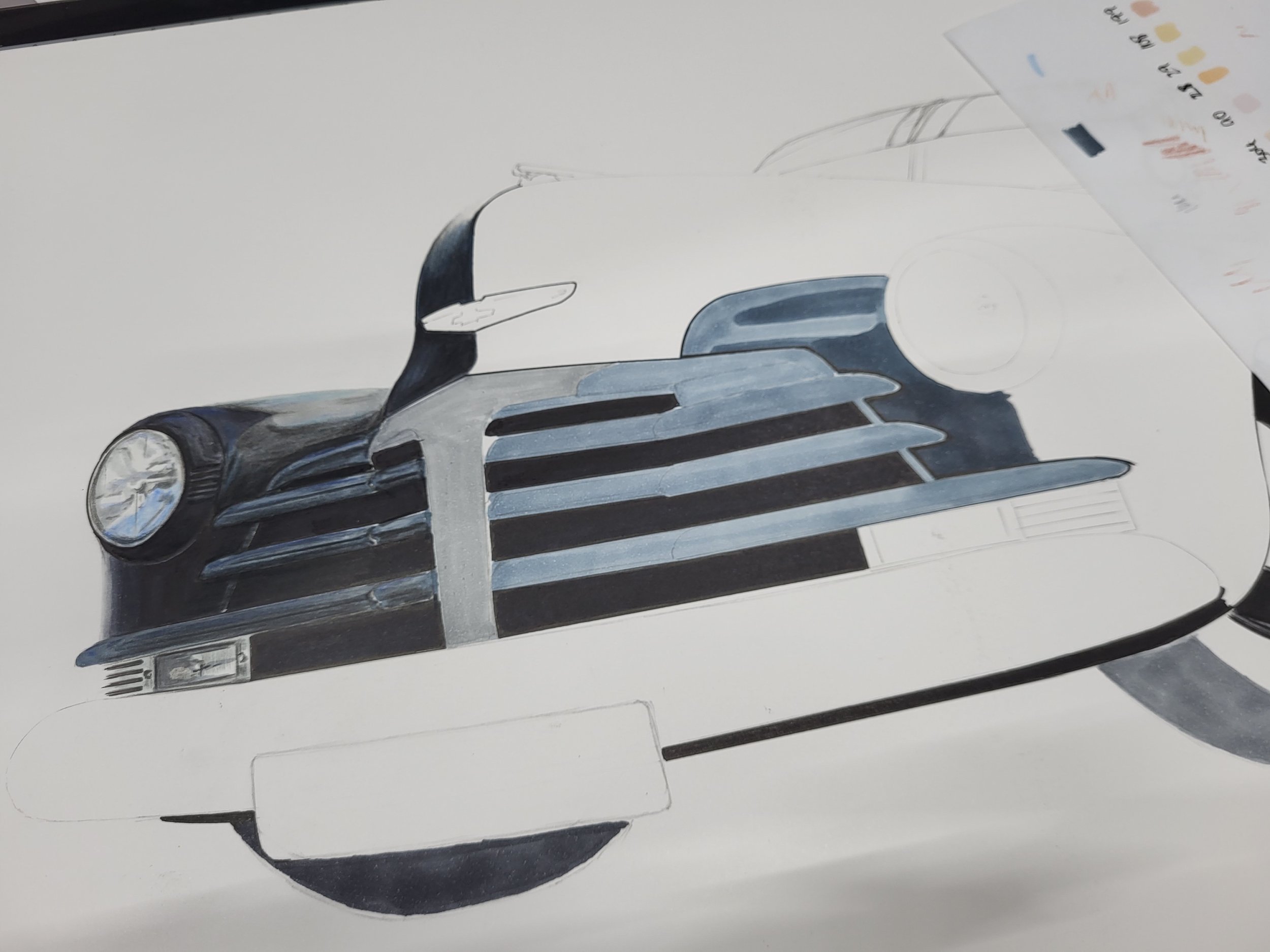

    Currently working on this one.

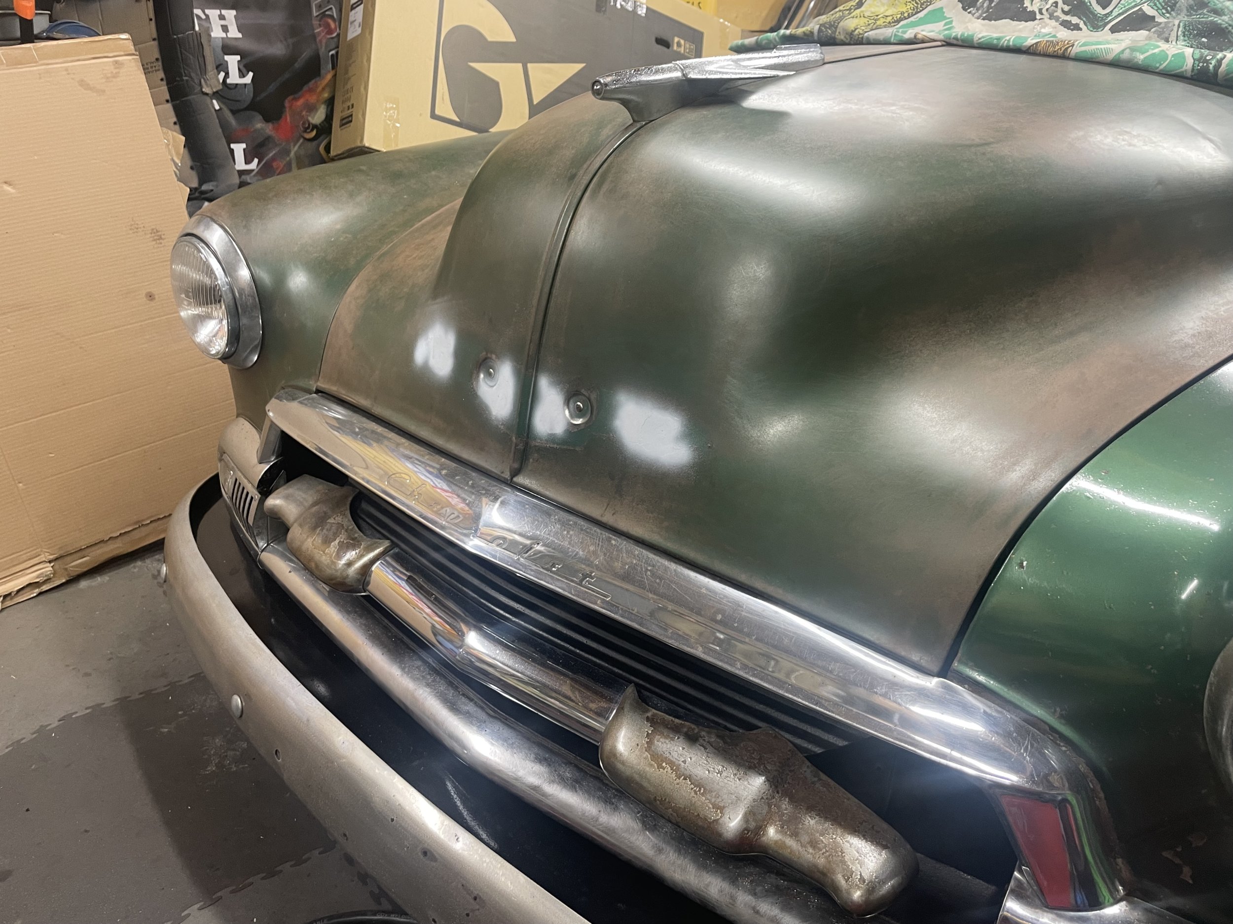

    Made a start on the Nose and Deck job on my ‘51.
    Kinda wanna lose the ornament but keep the hood seam trim, need to figure out a way to get a bullnose trim over to Scotland without either needing a second mortgage for the shipping or it arriving folded into a useless ball :(
    Also filled in the holes where the backup lights used to be

    Got the amptrol working. Guess I'll see how long it works. I used some super glue to hold the little gears in place a secured to the shaft.

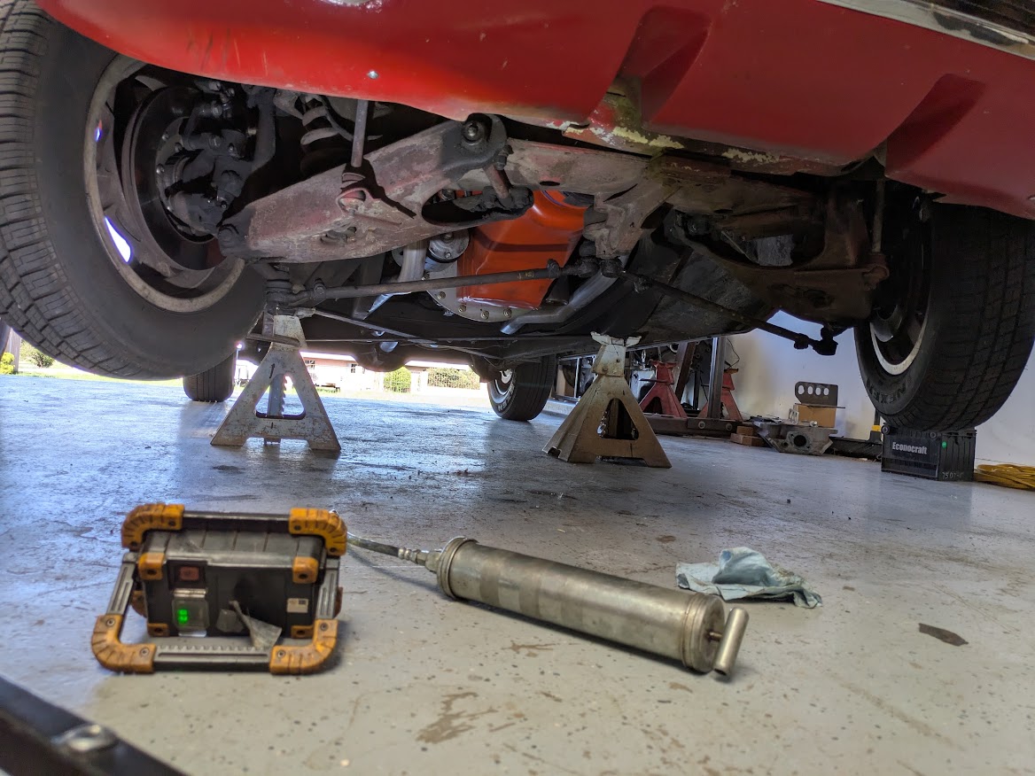

    Mr Squirrel that front suspension has lots of moving parts . Keeping it lubed well is a great thing to practice .

    Jim,
    I was having a hard time understanding the steering setup looking at your pic. So I googled a diagram of it. That's a quite interesting geometry.
    Does it handle well?

    It's just like a 49 Chevy. It handles fine, compared to my old truck....

    worked well enough they kept it almost 15 yrs--or more likely the general was being cheap!
