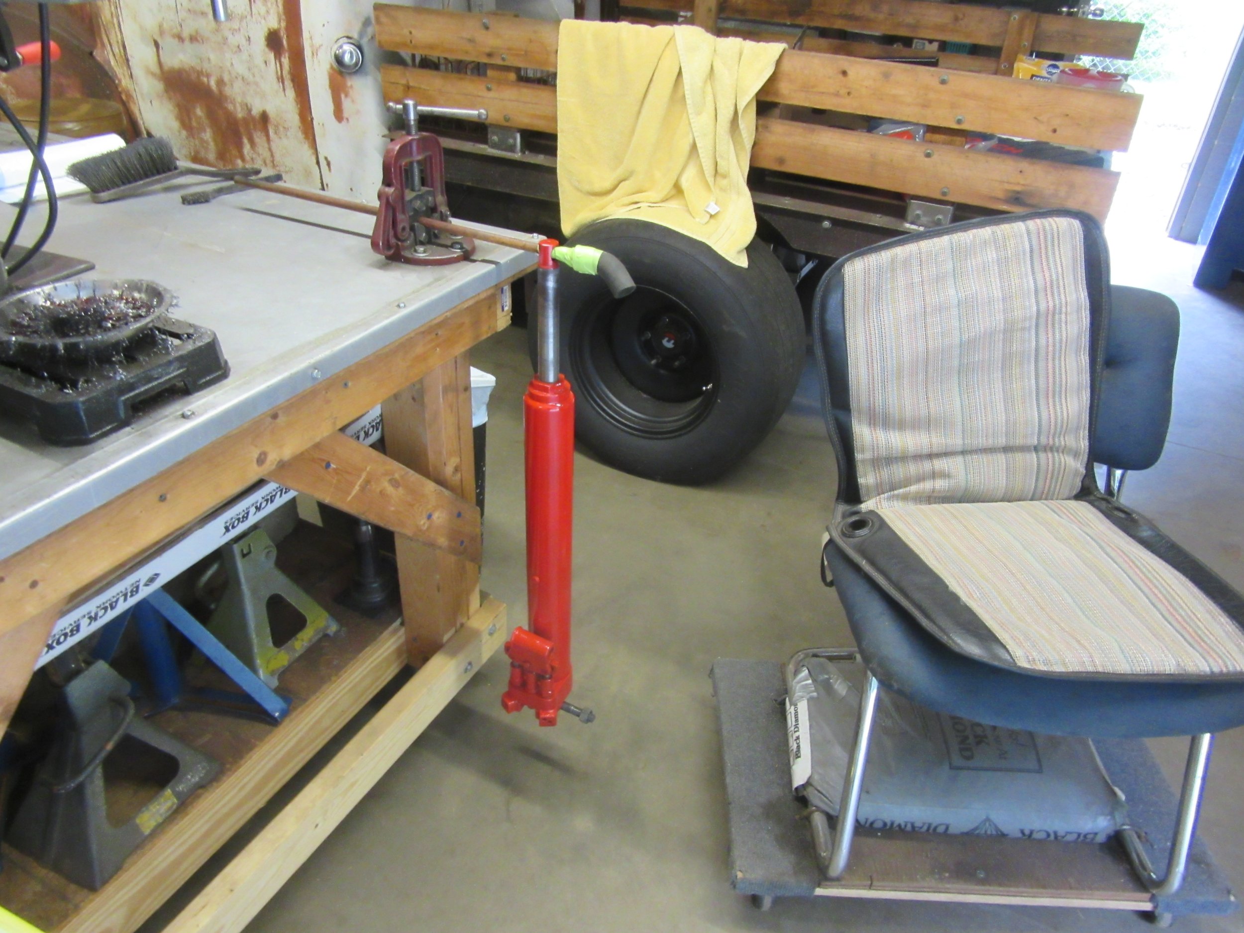

    I am in the process of reconditioning my engine lift, I have had this thing for over 40 years and it has earned it's keep. It has no real value but I thought I would prop it up so the next guy can take it to the century mark . IMG_2052.JPG IMG_2049.JPG IMG_2045.JPG

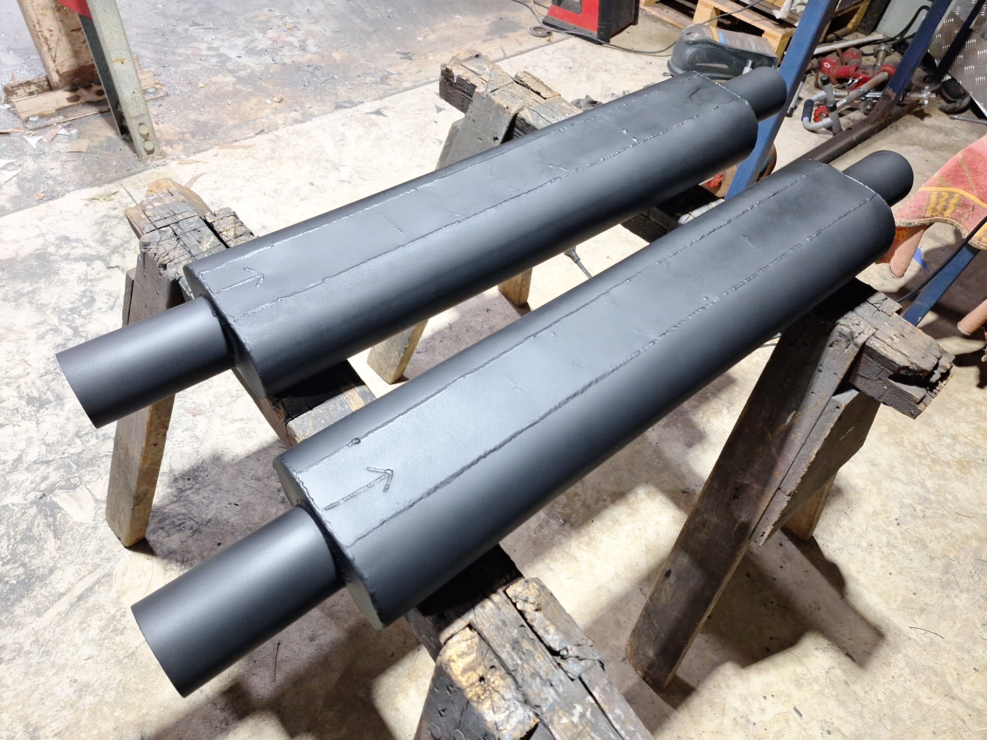

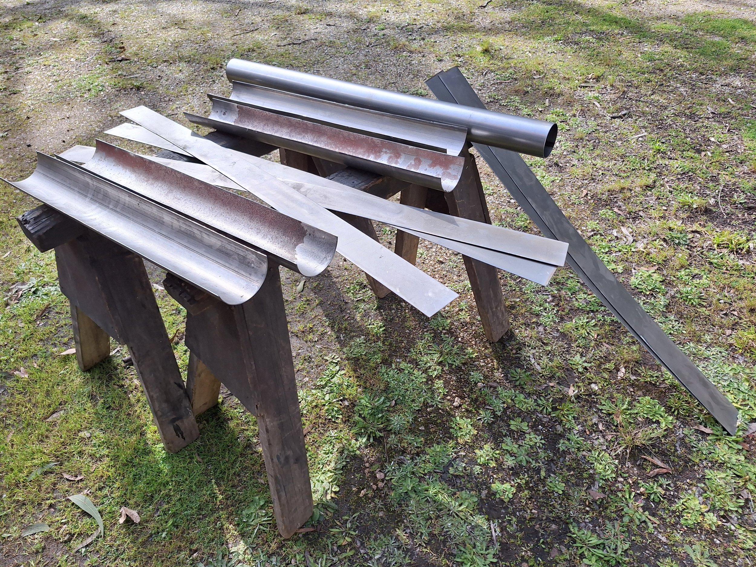

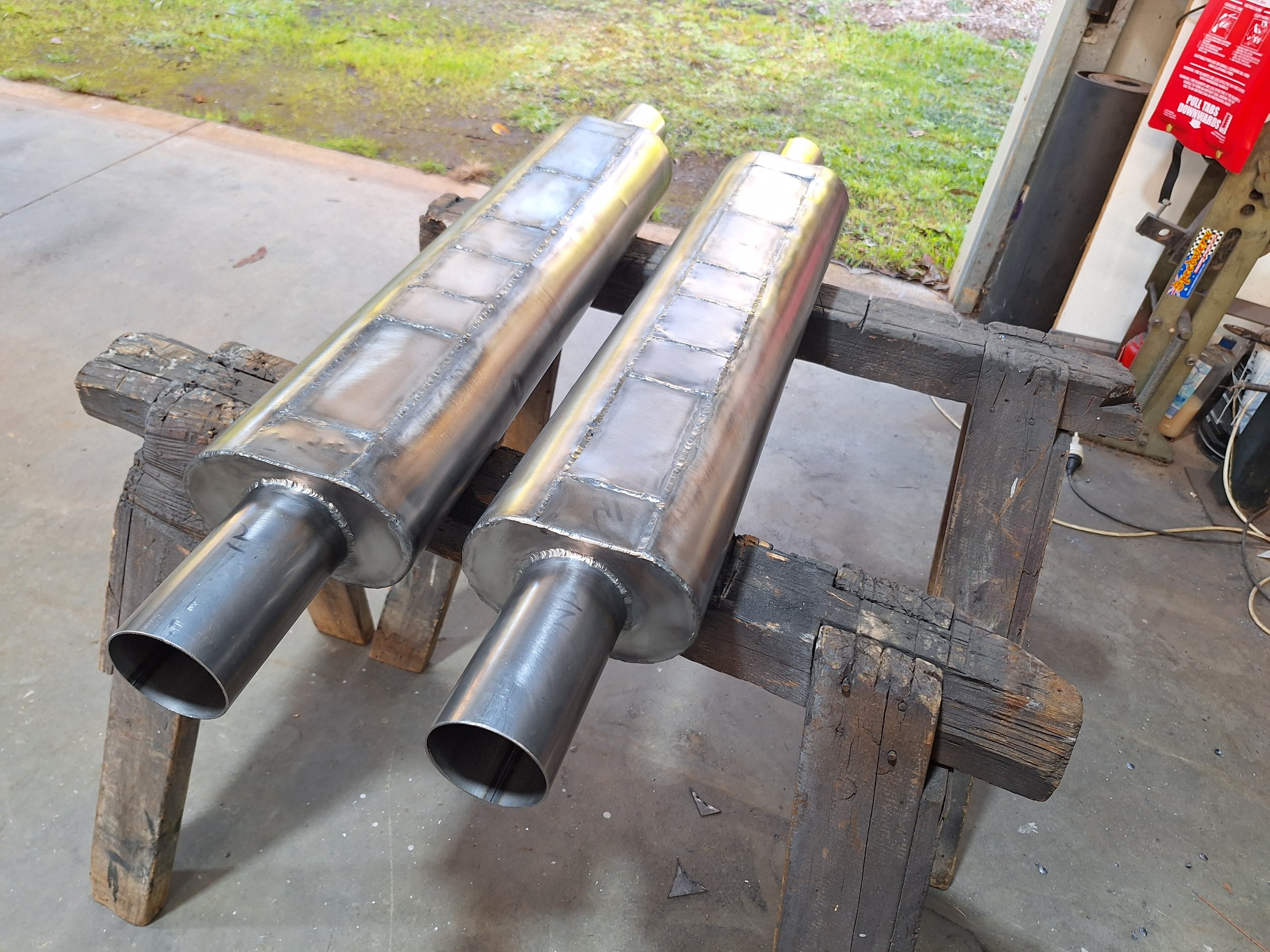

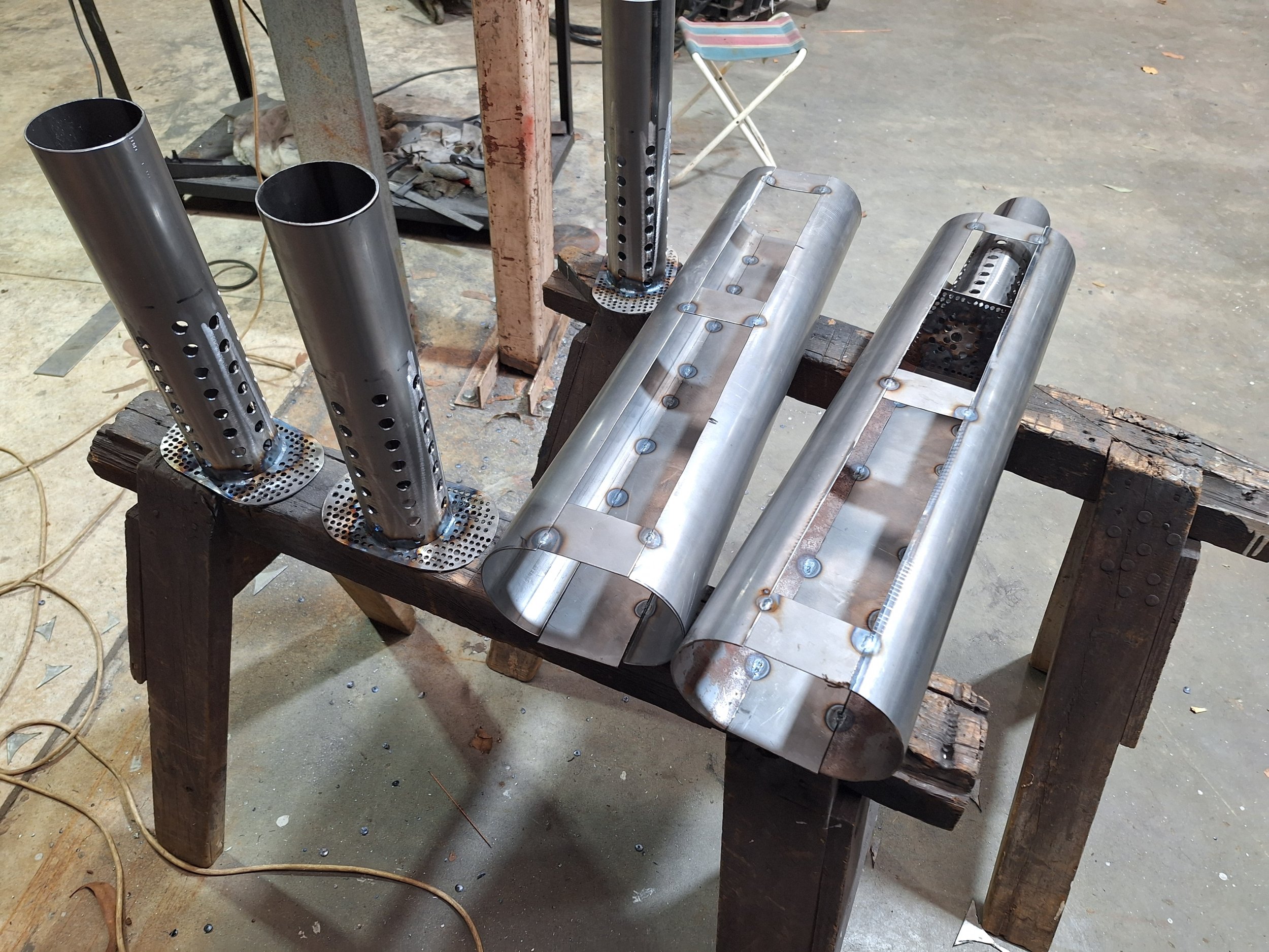

    Thanks Impala4speed for your kind comments, I am happy with how the mufflers have turned out. I decided to make my own mufflers as this car needs to meet quite strict noise requirements for registration and running a healthy supercharged SBC this was always going to be an issue. So I decided that I would fill up as much space as I could with muffler, these mufflers are 750mm long, 175mm wide and are made using a 4 inch pipe cut in half, inlet and outlet is 3 inch ( whole system will be 3 inch and finish out the side before back wheel ). Glen 20250905_163955.jpg 20250905_164004.jpg 20250905_164011.jpg 20250905_165611.jpg 20250905_165621.jpg 20250905_165629.jpg 22b61691-1494-4b24-8725-5cd132a17720.jpg

    curious to how did you design the mufflers / references / technical info ? that's real hotrodding there...thanks

    I’m like you I build all of my chambered mufflers after we blew one up from a nitrous backfire:p You can build them a lot cheaper and tailor them to fit your needs. Those should sound pretty good being a small but long 5 chamber 3” and let the motor breath :D

    My design brief included, available space, engine specifications and internet searches on muffler types, I decided that a perforated pipe and chamber design were the best of both worlds ( I hope I am right ). Glen

    Yep, 2 full days, day 1 cutting and drilling holes, day 2 ***embly and welding, day 2 1/2, I run out of gas for welder on day 2, all work done with angle grinder, mill / drill and tig welder. Glen

    Thats correct, I built these to suit my needs, after watching lots of YouTube videos and internet searches, I decided on this design as suiting my blown SBC and registration needs, I feel these will work well - time will tell. Glen
