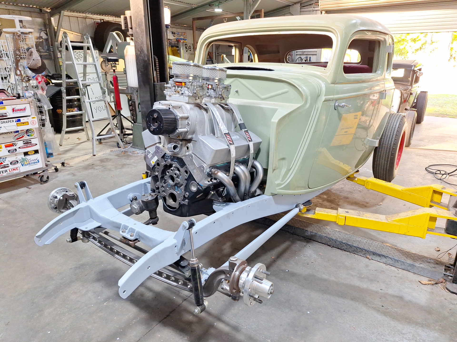

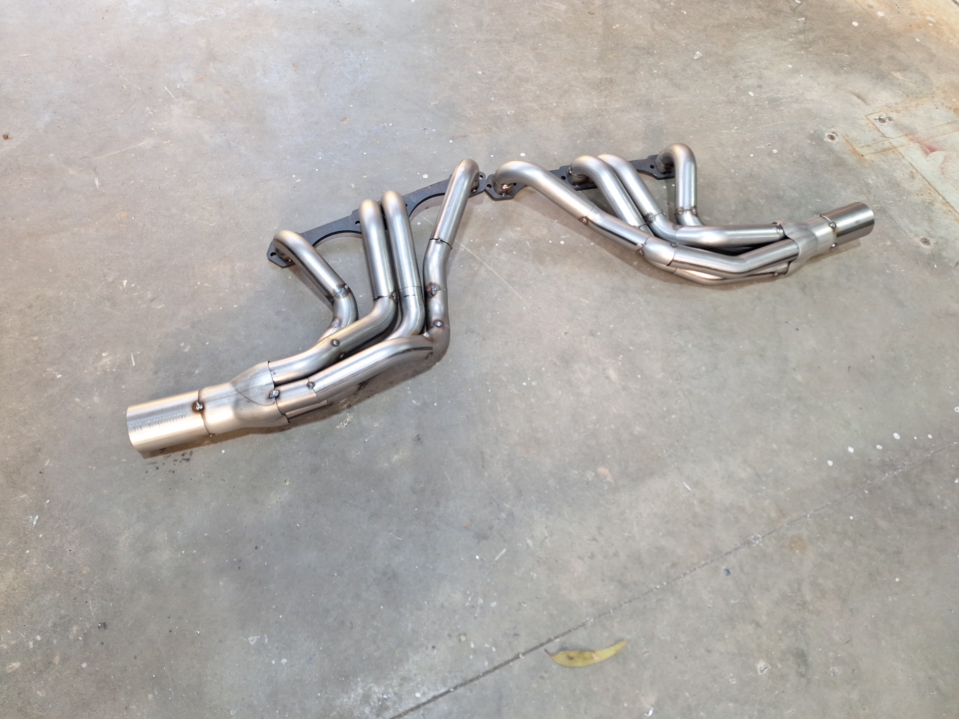

    Nearly finished fabbing headers for my 34, Glen f77d2019-b5be-4472-94cf-ca207d7723ed.jpg fc5e54c1-44b0-471c-a6ad-f1346ba4a1b2.jpg

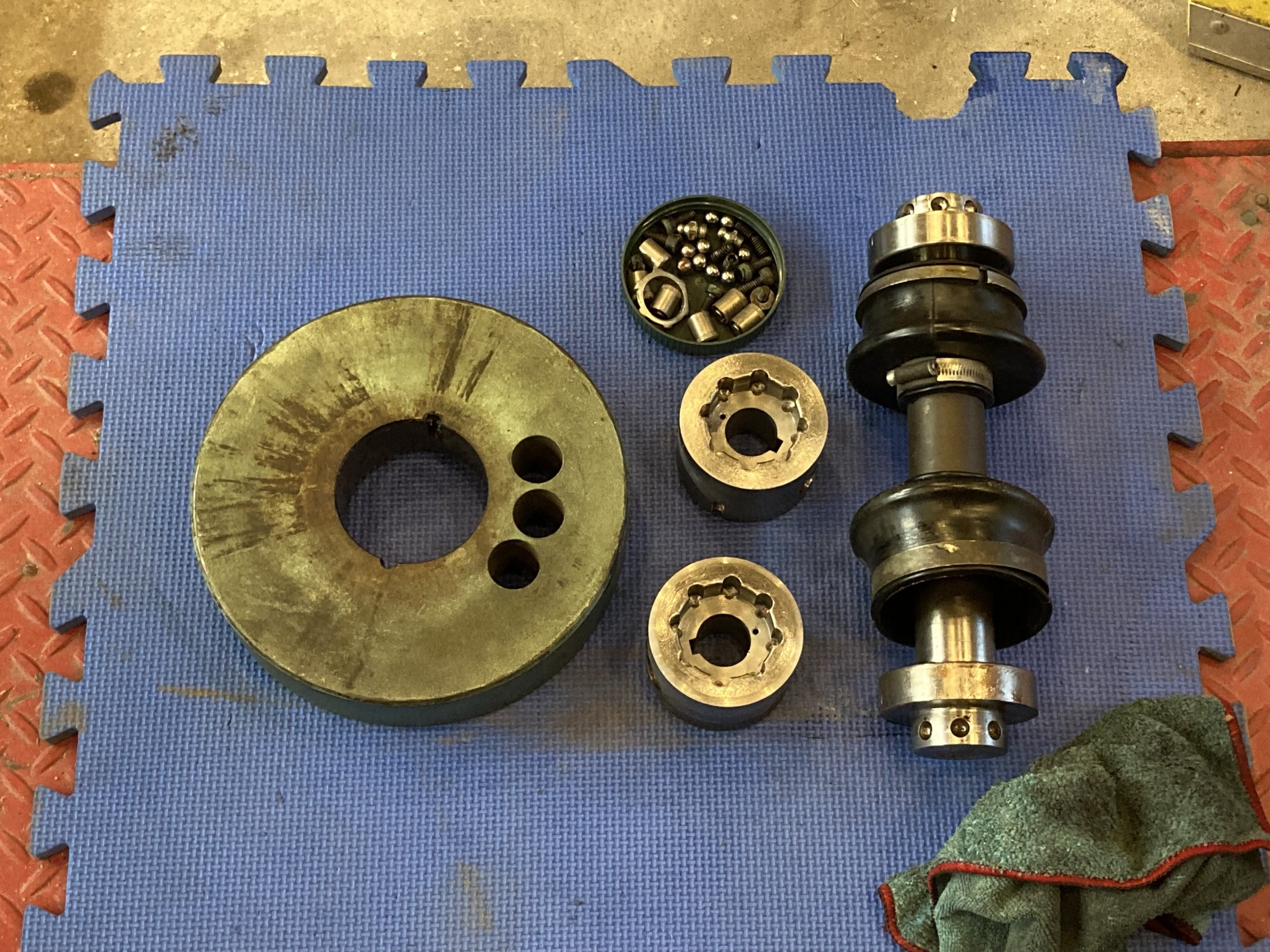

    Weighing my options for the Rzeppa joints on the driveshaft of my Pullmax P6. They’re making noise when the gearbox is shifted to an offset position. The rear joint looks fine but the front is showing some wear and definitely some metal to metal contact where there should be none. If I can get off work I’ll bring the ***embly to the drive shaft shop and get his opinion. Plan B is to do some light machining to touch up the pockets and replace the 3/8” balls with some 10.5mm. This is a bummer because I had the machine sold until I noticed the noise.

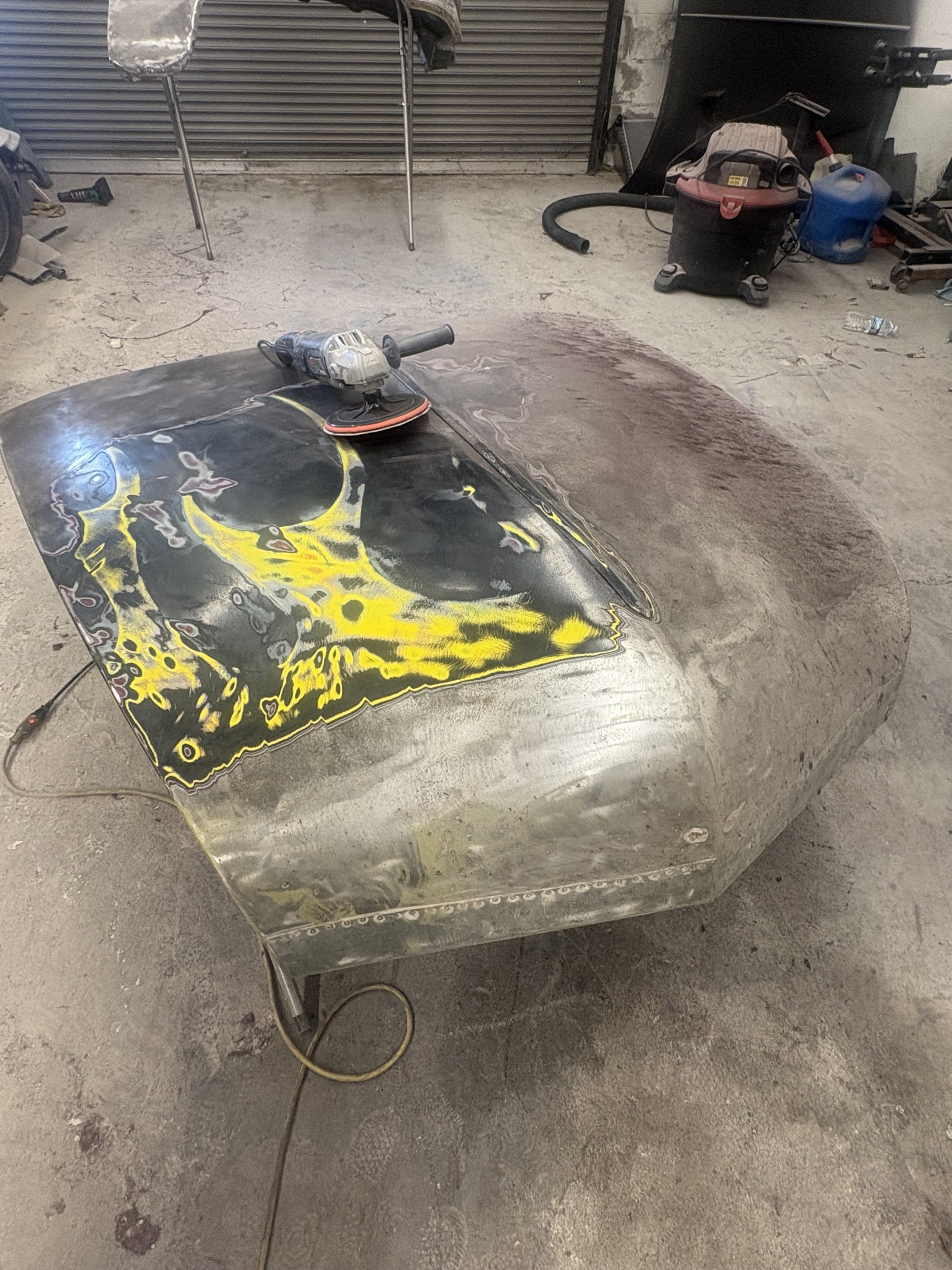

    IMG_2158.jpeg Stripping down the hood. Aside from uncovering the old patch repair. Found an old flame job.
