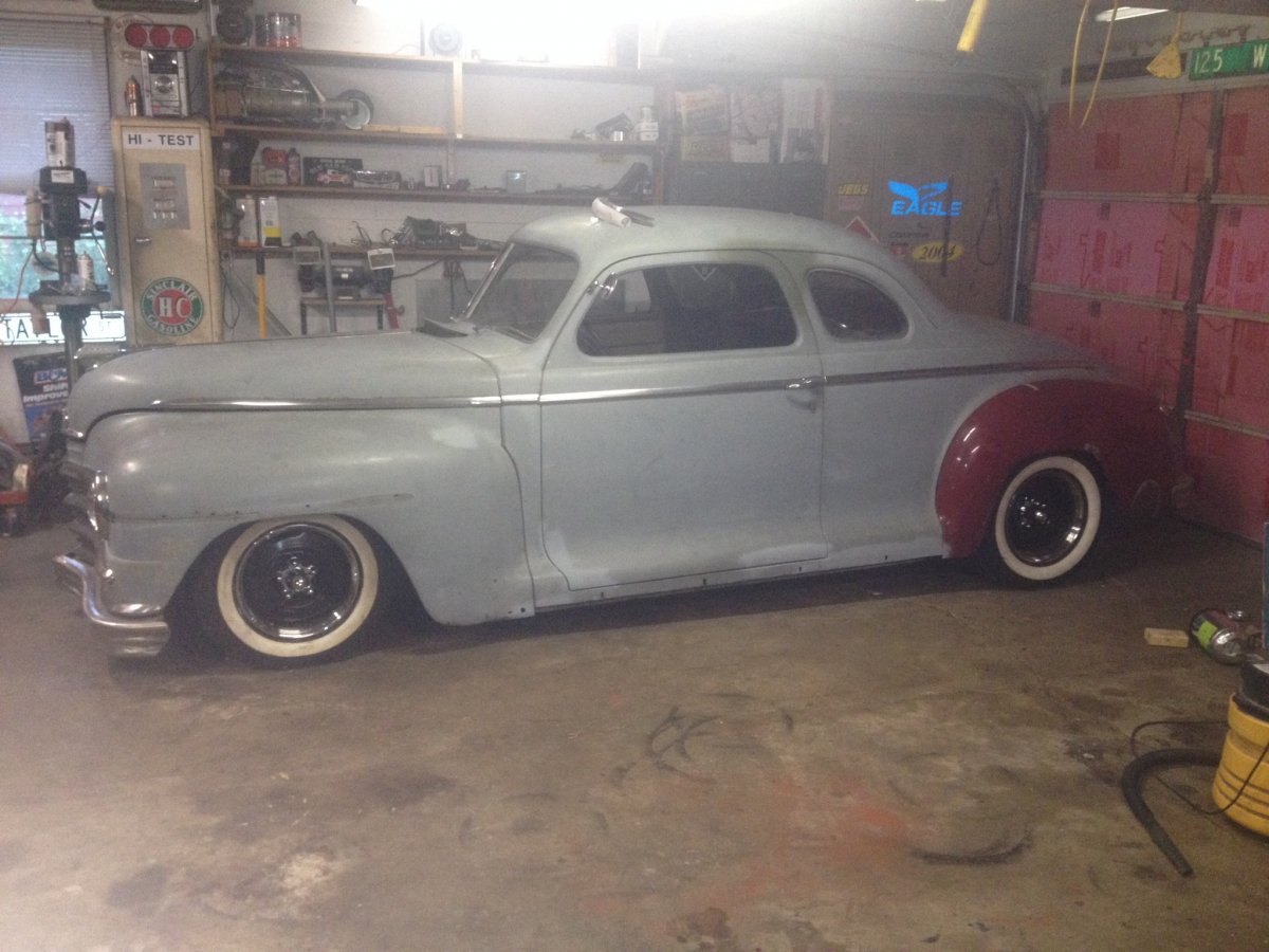

  8. Ok how about hemi in vette, unmentionable motor in unmentionable chevelle, find a nailhead for stude, 427 bbc in plymouth? Now i have an extra sbc, Lumpy was saying I needed yet another car so that works. The 56 bel air feels left out in this shuffle. I dug up a pic of the mystery plymouth from the archives
    now i just need some skilled help, any volunteers?:D

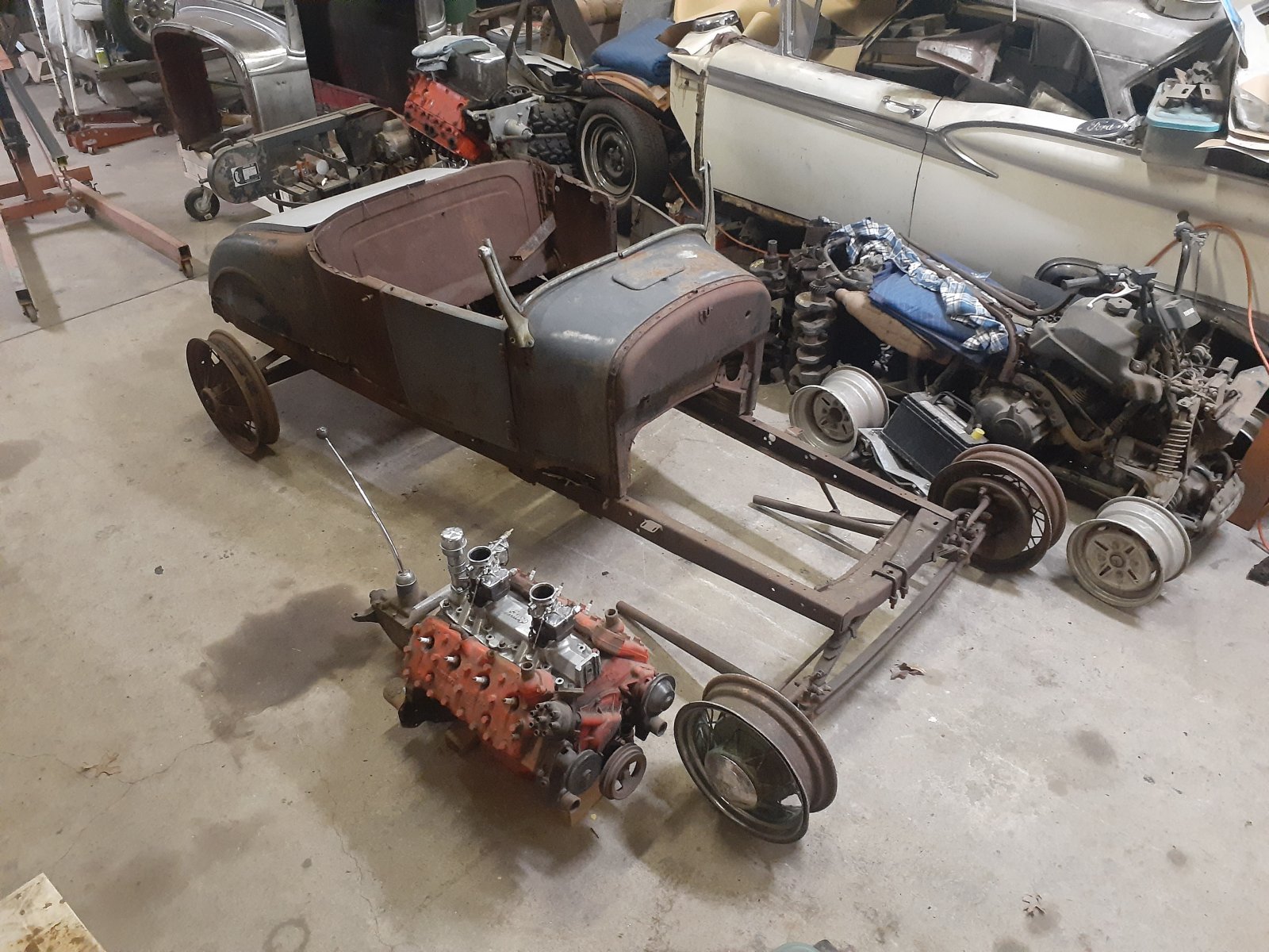

    20230417_013645.jpg View attachment 5704333
    New to me project T Roadster. A rails. 8BA/Open drive 3spd. Dropped 32 axle/36 rear. 39 hydraulics.

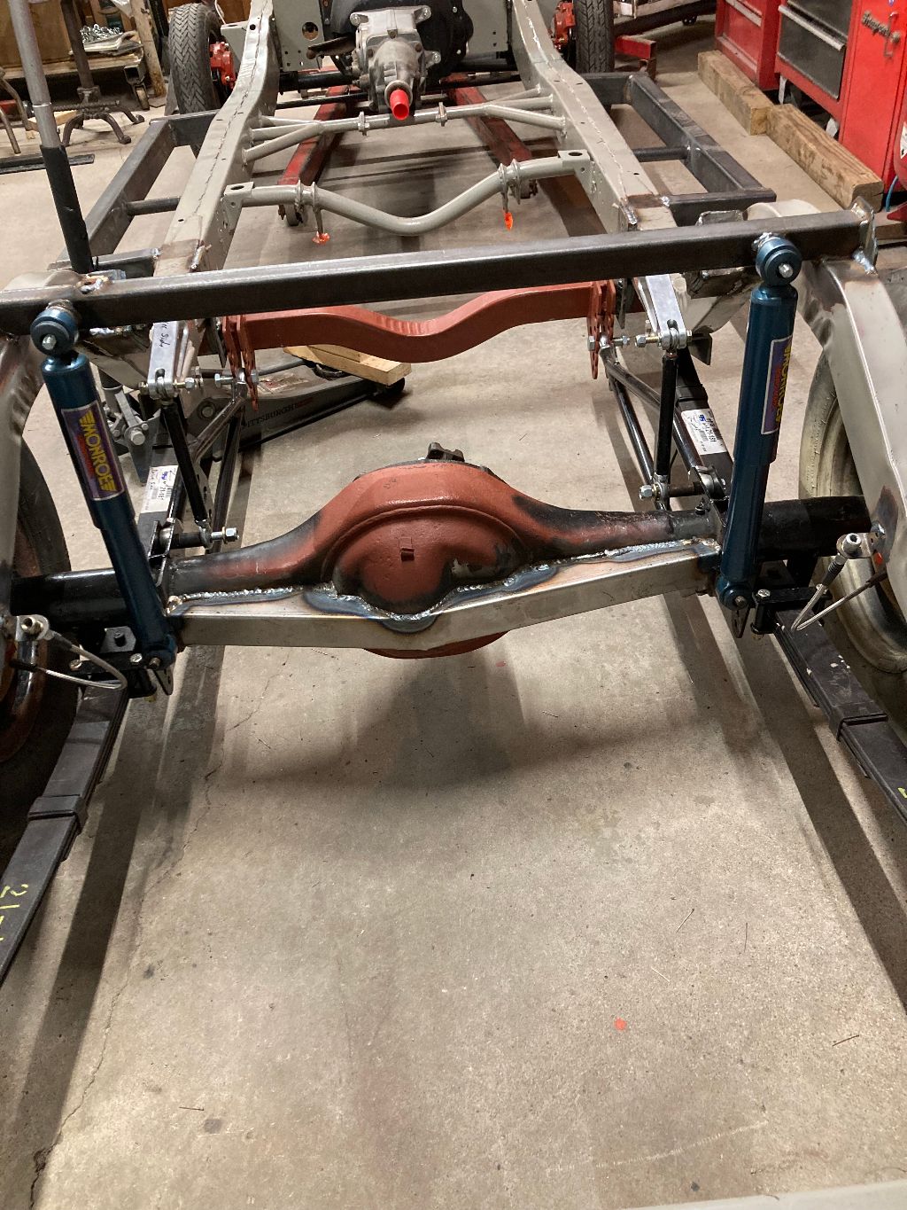

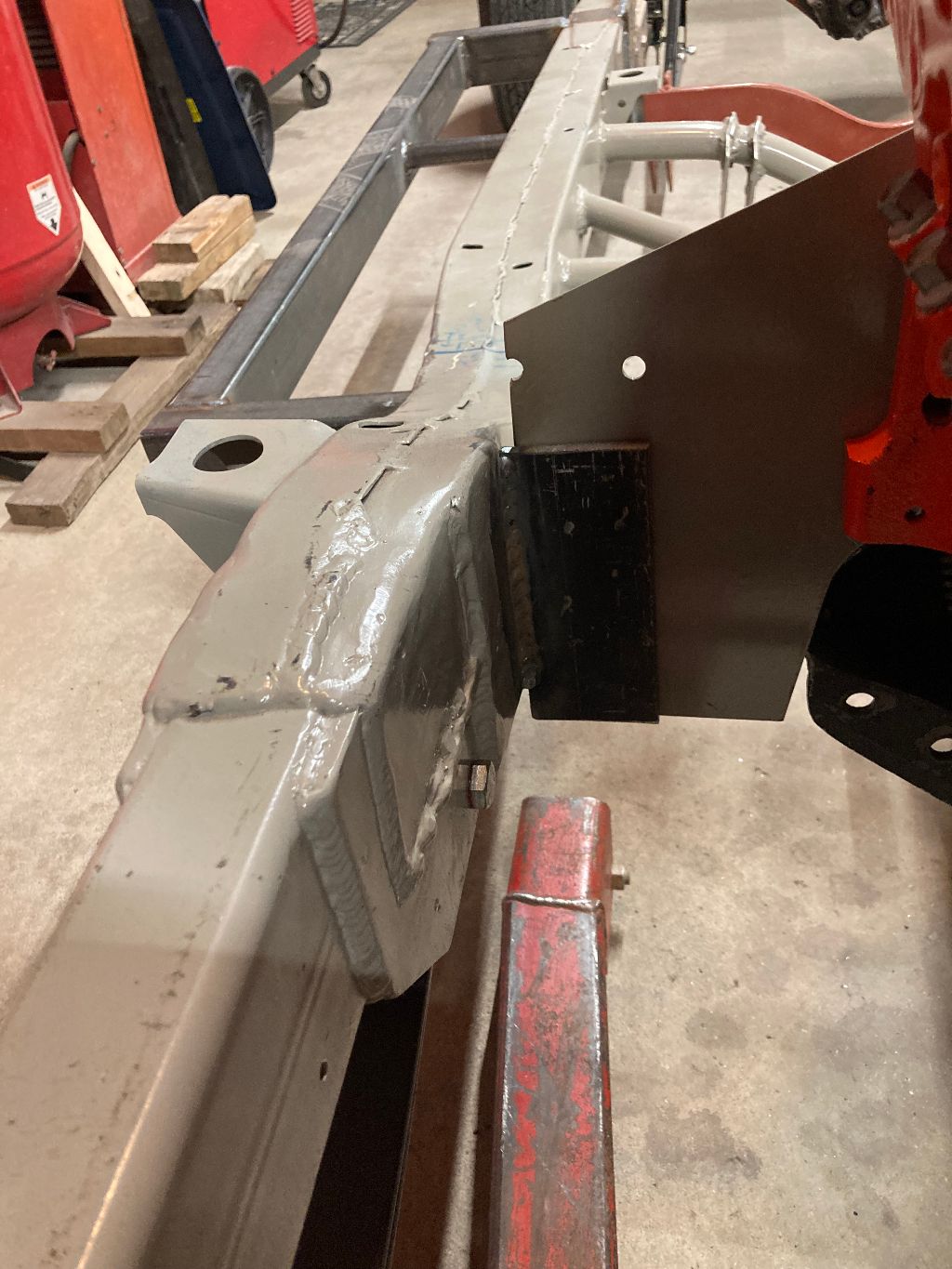

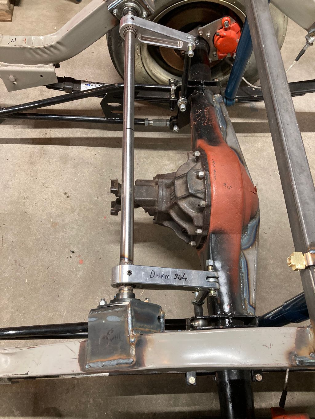

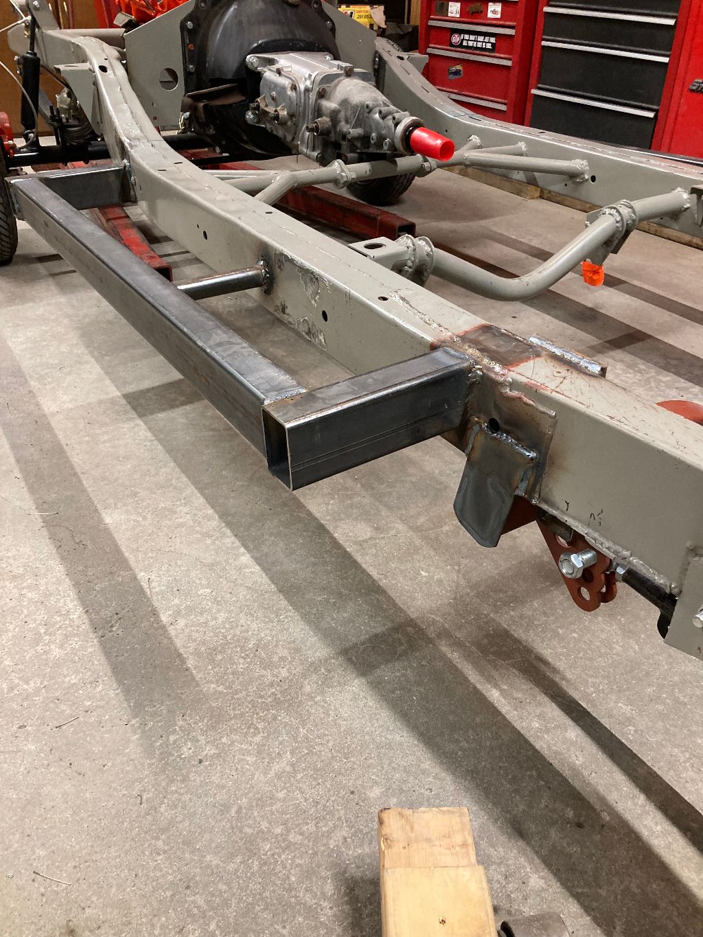

    We made more progress on the 56 :rolleyes:.
    Aaron was over to burn in more stuff that I tacked.:cool: Anti -roll mounts.jpg mid-plate mount tab.jpg roll cage frame mounts.jpg

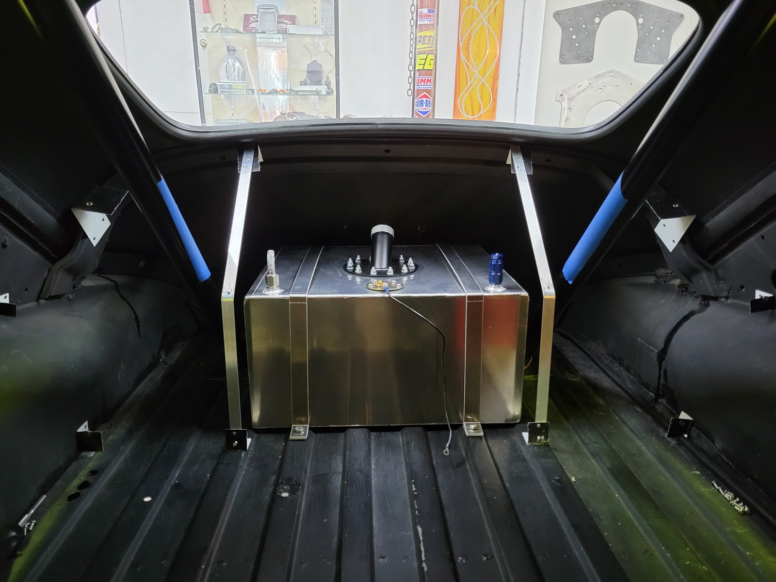

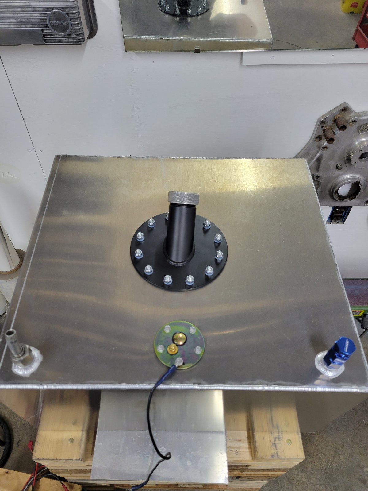

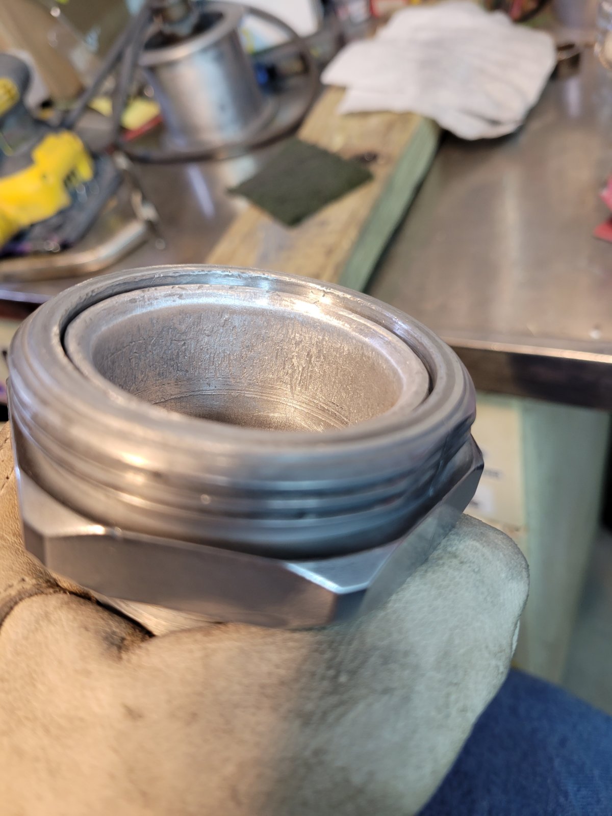

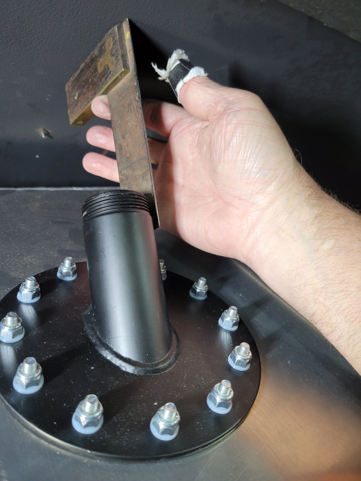

    That RCI filler neck came in yesterday, look at that crooked *******, you'd think whomever welded it could've at least lined it up straight.
    Good news is it looks to be a straight shot from body angle to angle of the filler, about a 5 inch distance from body.

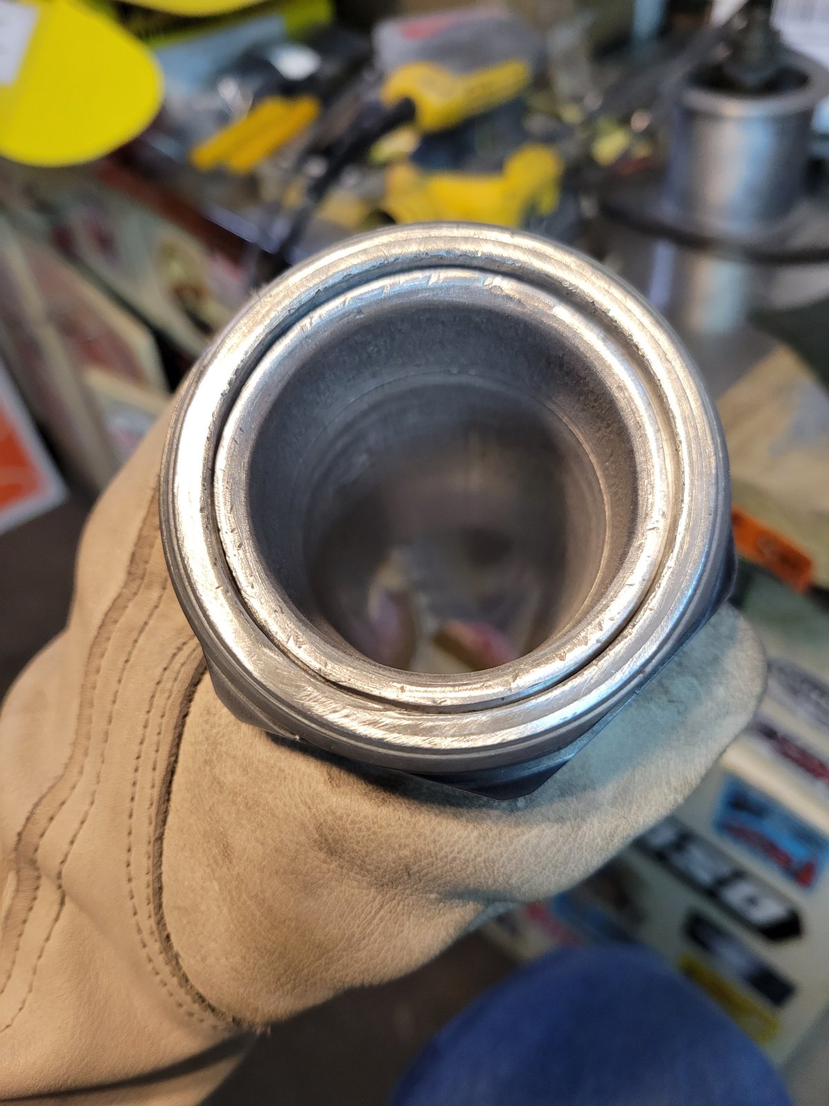

    Put a little flare on that filler neck pipe, tomorrow I'll stop at my buddy's to see which end he wants to weld on
    Threw an old test panel in there to see if that's something I want to put on the bulkhead pieces at a later date.

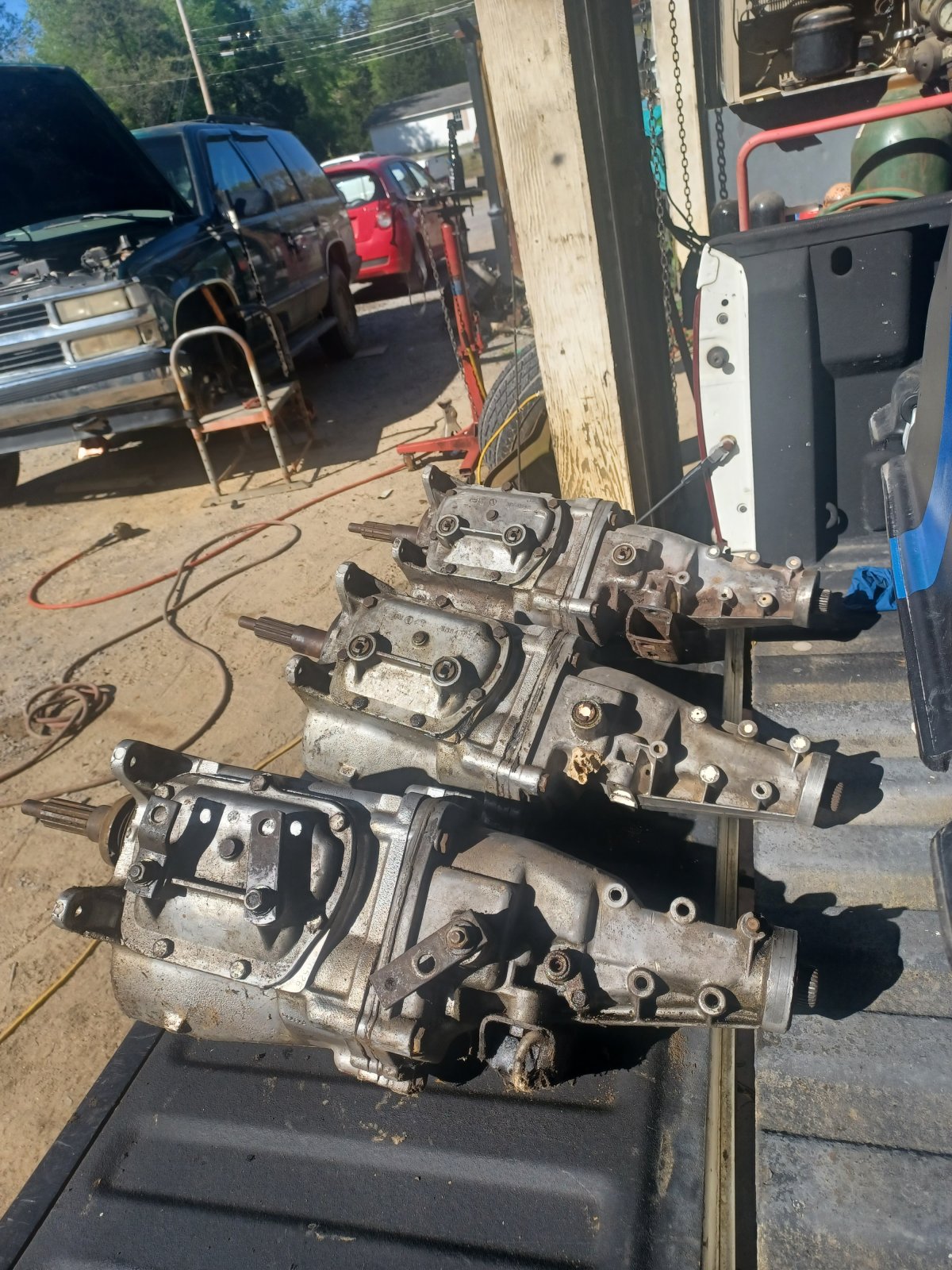

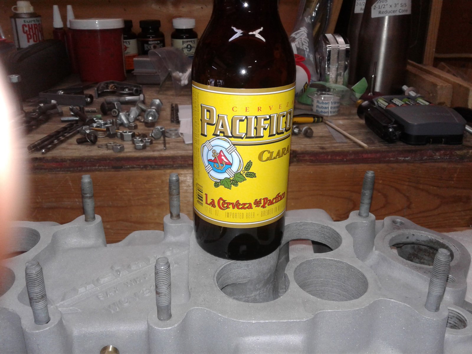

    My beer holder.

    Love the garage expedient finger wrapped in rag and black tape to stop any blood leaking :)
    enloe, rod1, alanp561 and 8 others like this.
  20. Greg Rogers
    Joined: Oct 11, 2016
    Posts: 1,265
    Greg Rogers
    I see someone else does "Field -expedient" bandages out in the garage. Good thing for napkins and electrical tape!

    Saved it from the original frame rails that came with the car, but it looks to be Anti roll bars from Compe***on Engineering part # C 2027

    One of the bolts from the old under car fuel tank had a burr on it preventing it from coming up and out of the hole.
    I'm inside the car sticking my arm through the fuel cell sump hole with a pair of vice grips, figured I could clamp onto the threads, unscrew the bolt from inside the car effectively removing the burr.
    That quickly excelled to beating the bolt with the vice grips and my thumb decided to jump in the way for some unknown reason, smarts pretty good. Lol

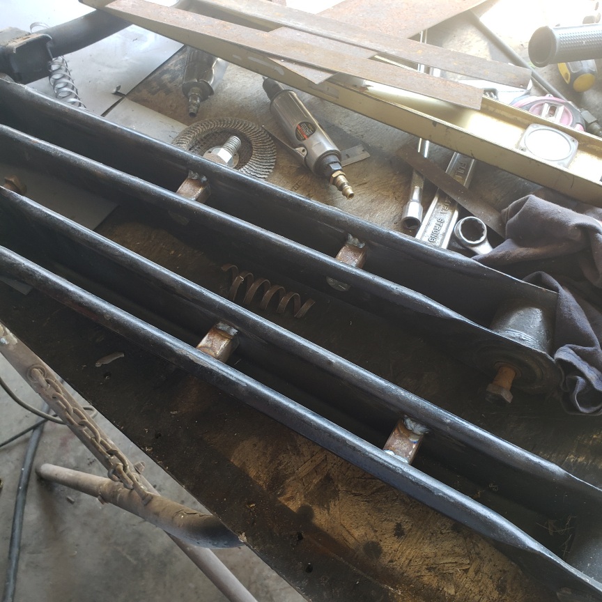

  24. Boxed and put crush sleeves in a set of A body rear bars. 20230418_145941.jpg 20230418_150009.jpg 20230418_150027.jpg

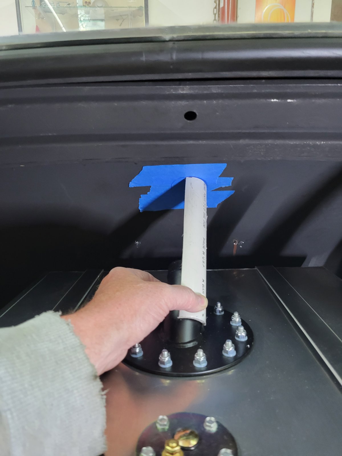

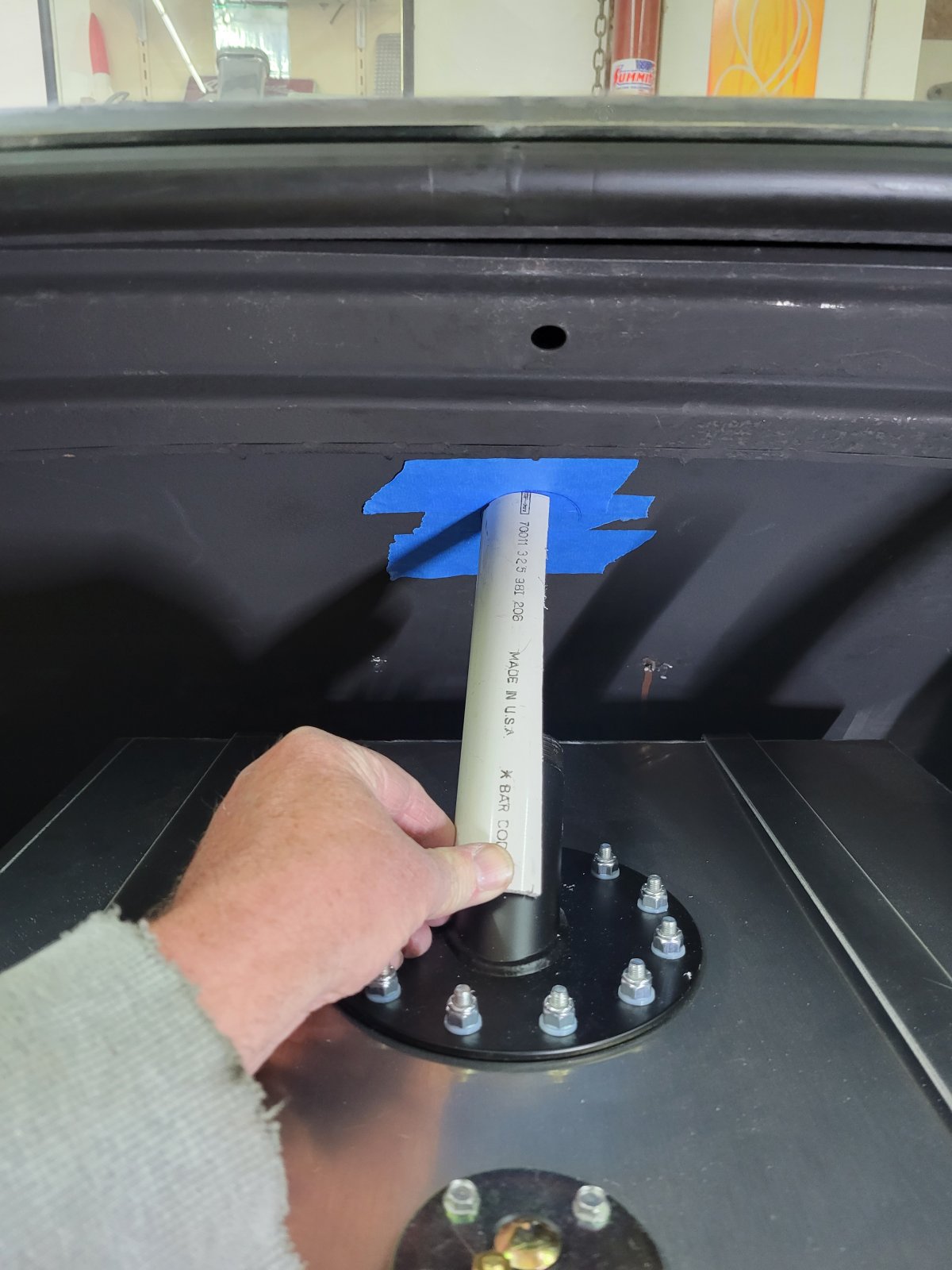

    Starting mapping out the hole I have to cut for the gas cap, cut up some pvc pipe to use as a guide to get at least the height of the hole. If the stupid thing wasn't crooked I could've located the hole with this method, but the aftermarket doesn't make it easy on you.
    I'll probably measure down from the window rubber and gamble a little with measuring over the bracing, which of course isn't there on the outside where I have marked the centerline.
