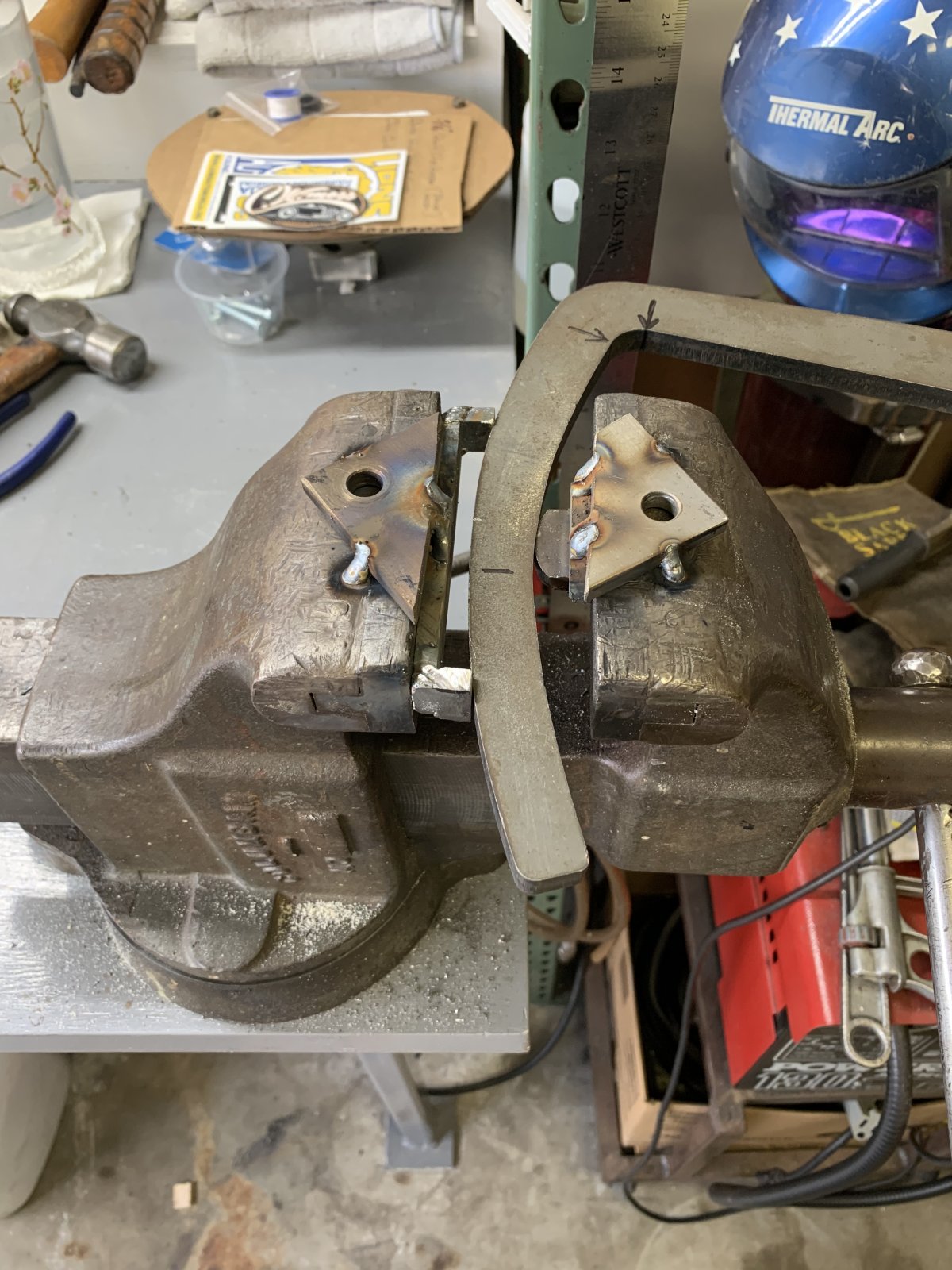

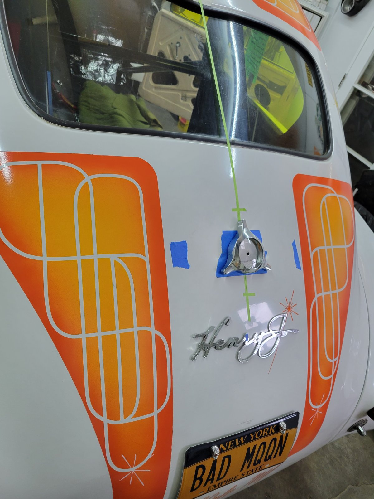

    Nothing left to do but cut it, I think I'll stare at it awhile longer to make sure I'm good with it.
    It's directly in line with the filler but not exactly centered, there's only a couple inches between the two pipes, so I doubt a hose will flex between the two angles if I move it up.

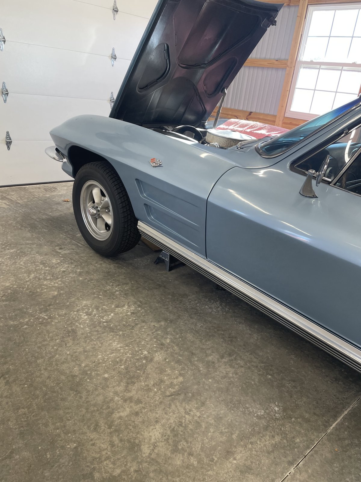

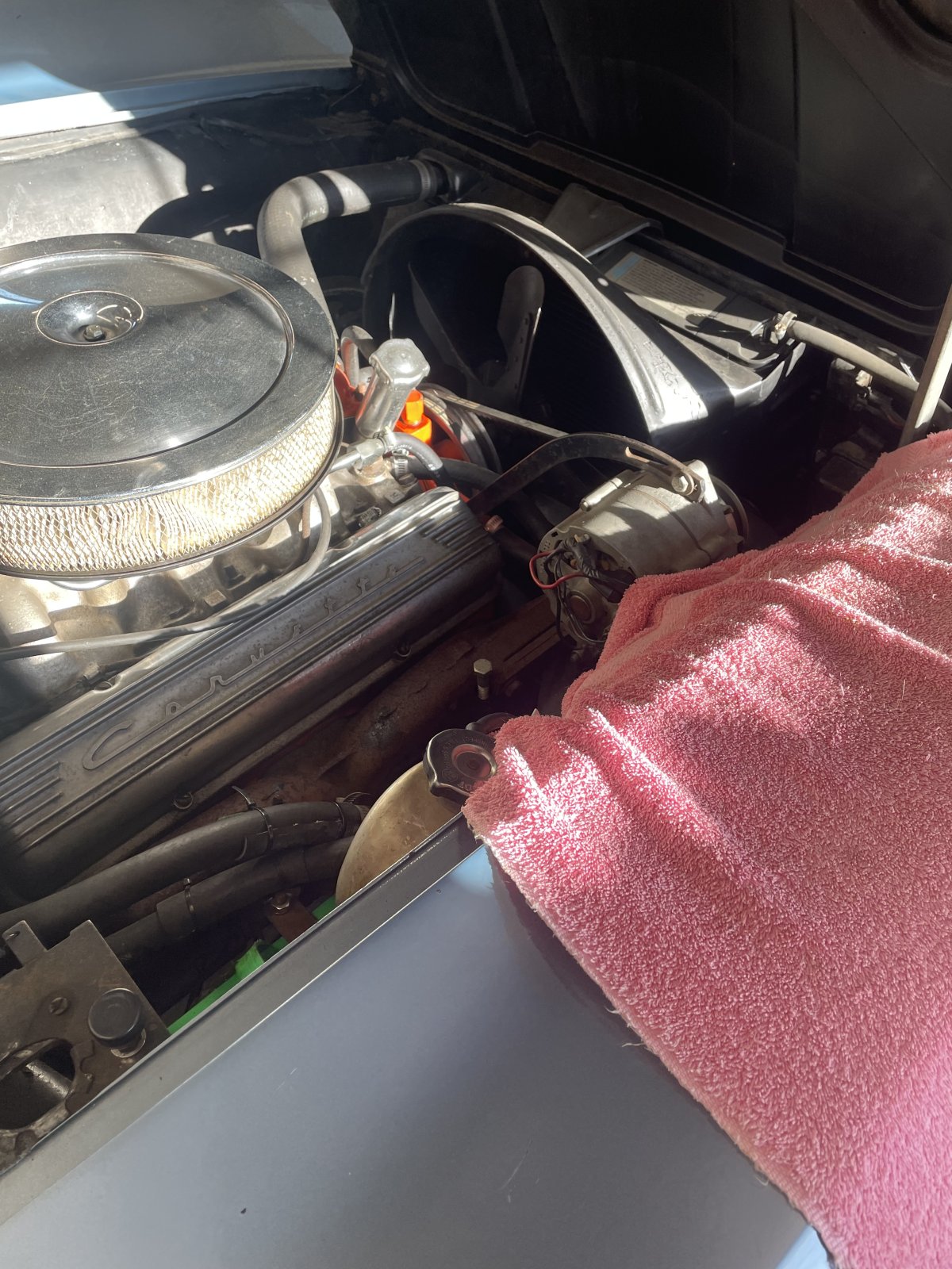

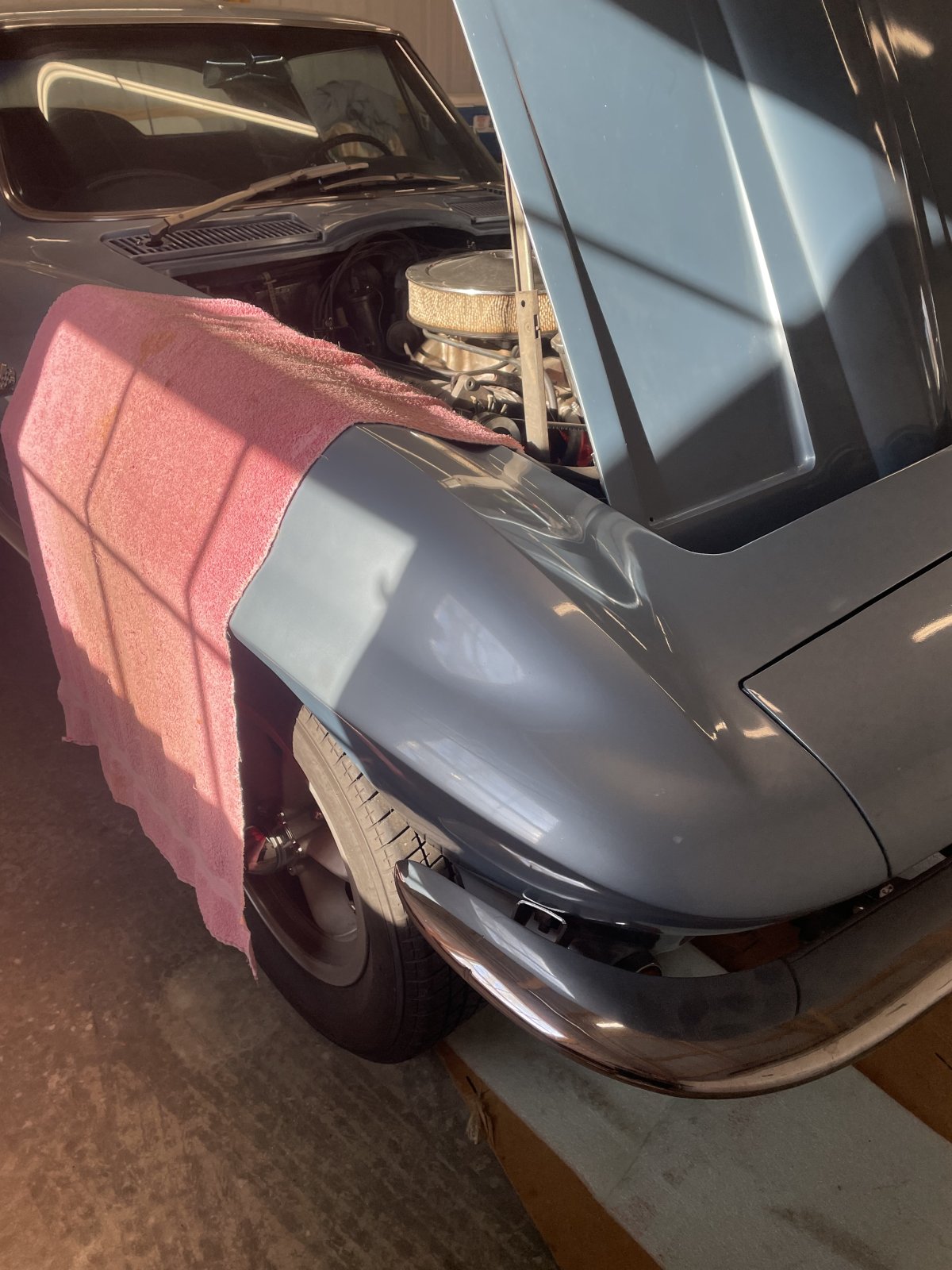

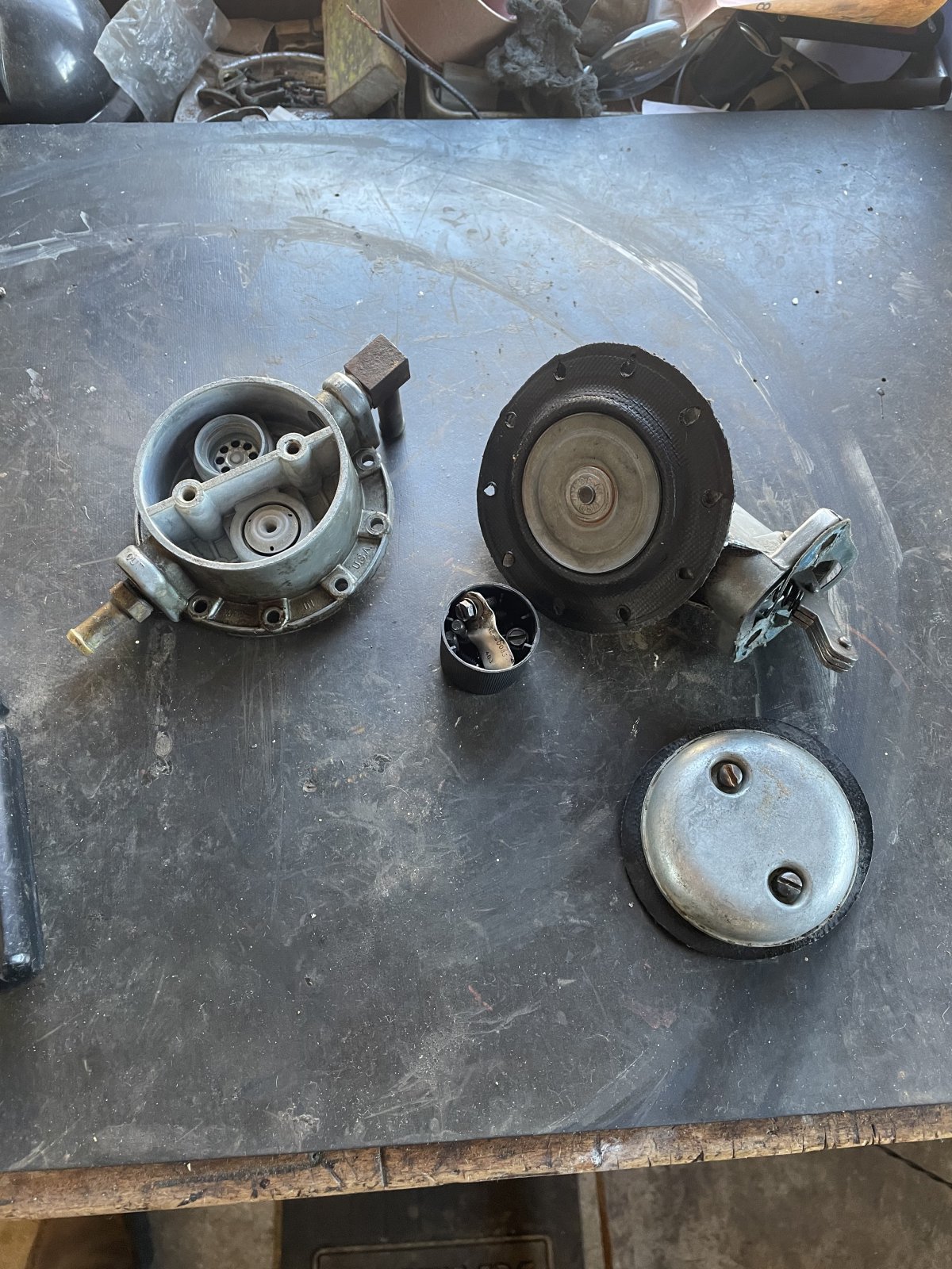

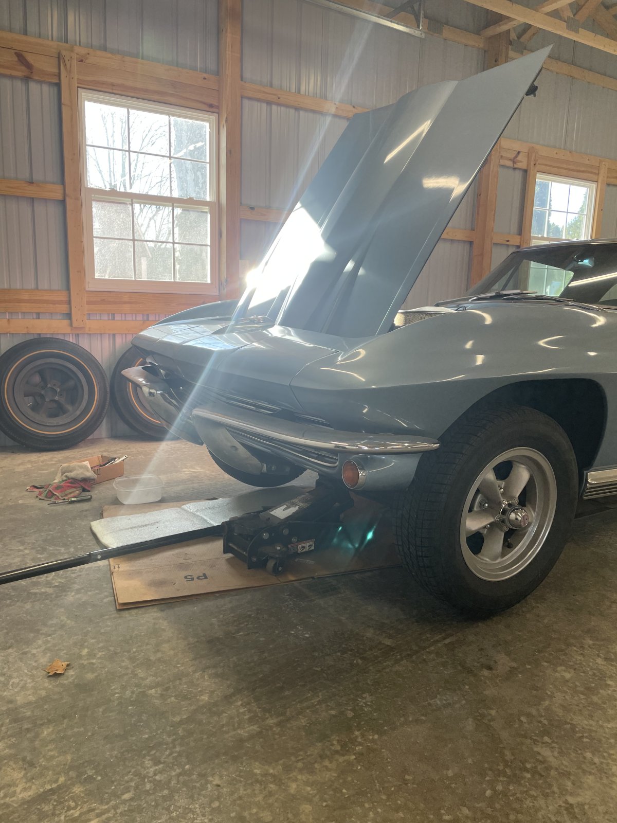

    Got temporarily sidelined on my Vette. It seems a rebuild kit for a hipo fuel pump doesn’t exist? Might have to do a jury rig with a standard one… still looking. FB3F4402-A9A5-494D-8465-EC033963F5D2.jpeg 3AF2C53E-F04D-4BF6-8A57-E794C2D73E5A.jpeg 566A6421-FC88-4AB5-8E03-24ECB3E9C14A.jpeg B7133020-8A74-49FA-879E-53846CDEFCE8.jpeg 4695F102-FD30-467F-BB91-34E0F96DE2B9.jpeg

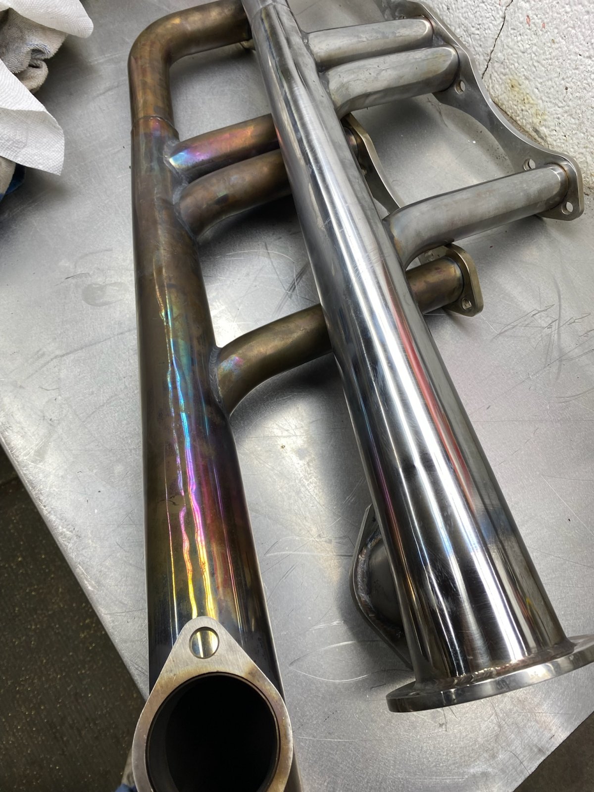

    7135E471-A2AB-4307-9AE8-E620544EEFB2.jpeg I had the 97’s on my SBC rebuilt locally. When the engine was started for break in, we found that the emulsion tubes were not cleaned on any of the carbs. We had my brand new stainless steel lakes headers on it for the break in. Both headers got very overheated due to the lean condition of the carbs. Today, I used a metal polish ( white Diamond ) on a red 3m scrubby. It did not all come out but enough so they look like polished Stainless

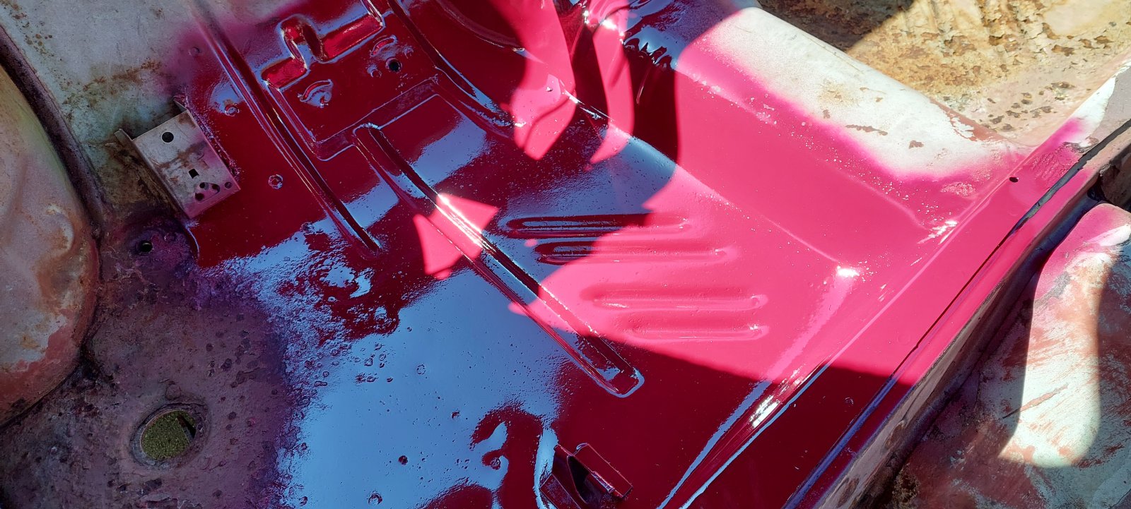

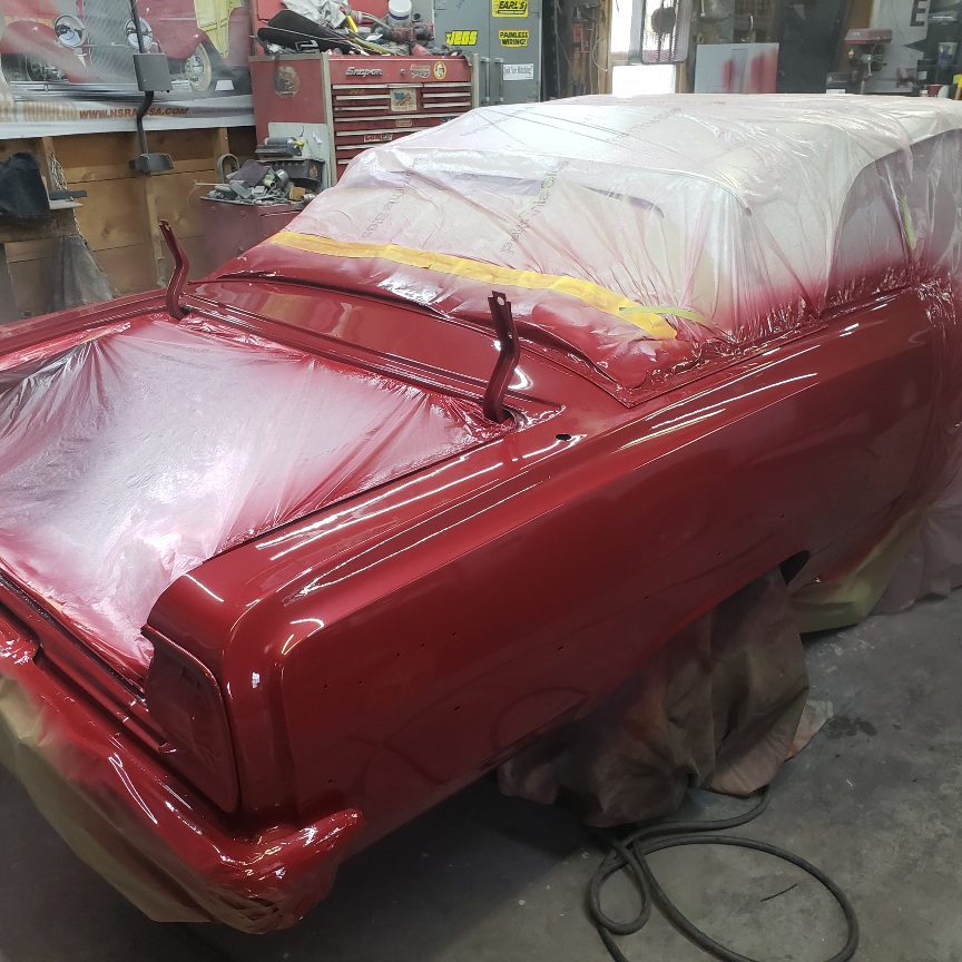

  15. Anybody else ever have to lick their calf? Damn sealer... 20230427_145158.jpg

    Is that Maderia Maroon?

  18. Ford toreador red pearl. FL is the paint code

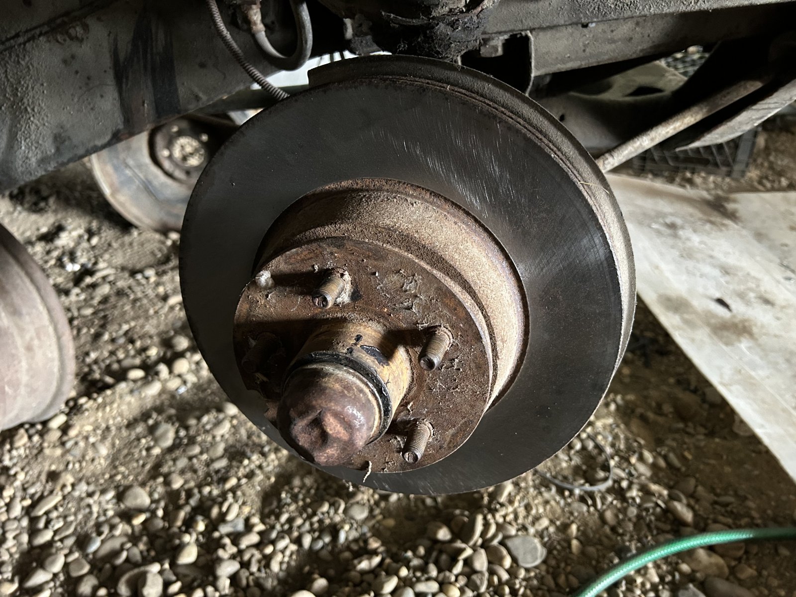

    Got the new front wheel bearings repacked and the rotors back on the front of the ‘64 Barracuda. Students turned the rotors a few weeks ago while we were doing brakes. I’m waiting for seal kits for the four piston Kelsey Hayes calipers and the master cylinder then the brakes will be done and on to getting the engine in.

    a 64 cuda came w/ discs? or aftermarket?

    Discs were optional in ‘65, someone had put them on this car before I got them, so they are factory brakes just not on this specific car.

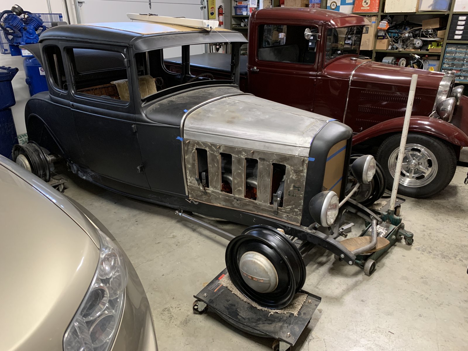

    Started cutting and fitting up the 32 Chevy hood sides to the coupe. 33670647-CDBF-4E15-B14A-08338E7BF42B.jpeg

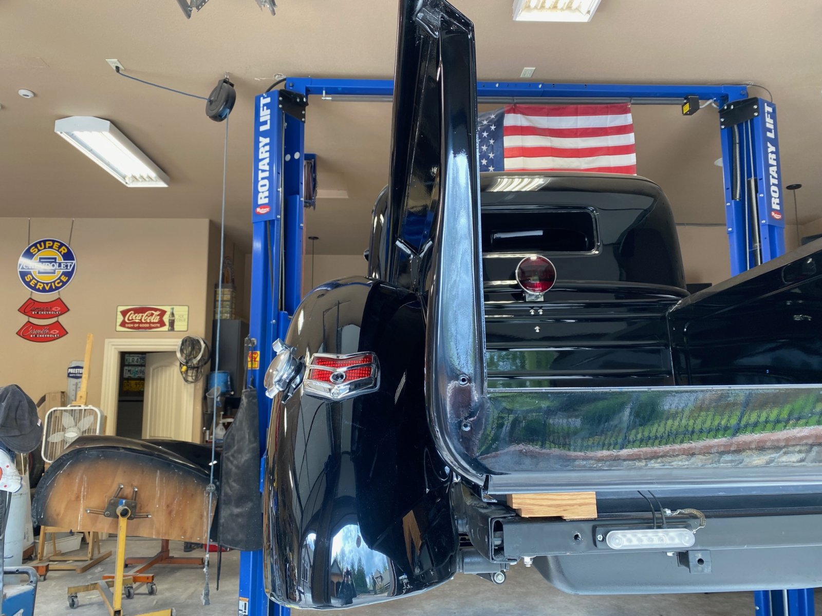

    Over the weekend I bolted on the bed and added a fender to the wife's PU.
