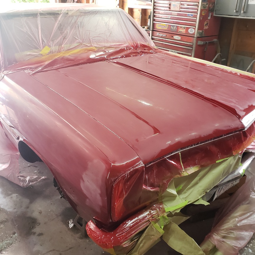

  2. Cut and buff, and buff, and buff.... :rolleyes: 20230502_144748.jpg 20230502_144802.jpg 20230502_172601.jpg 20230502_172614.jpg

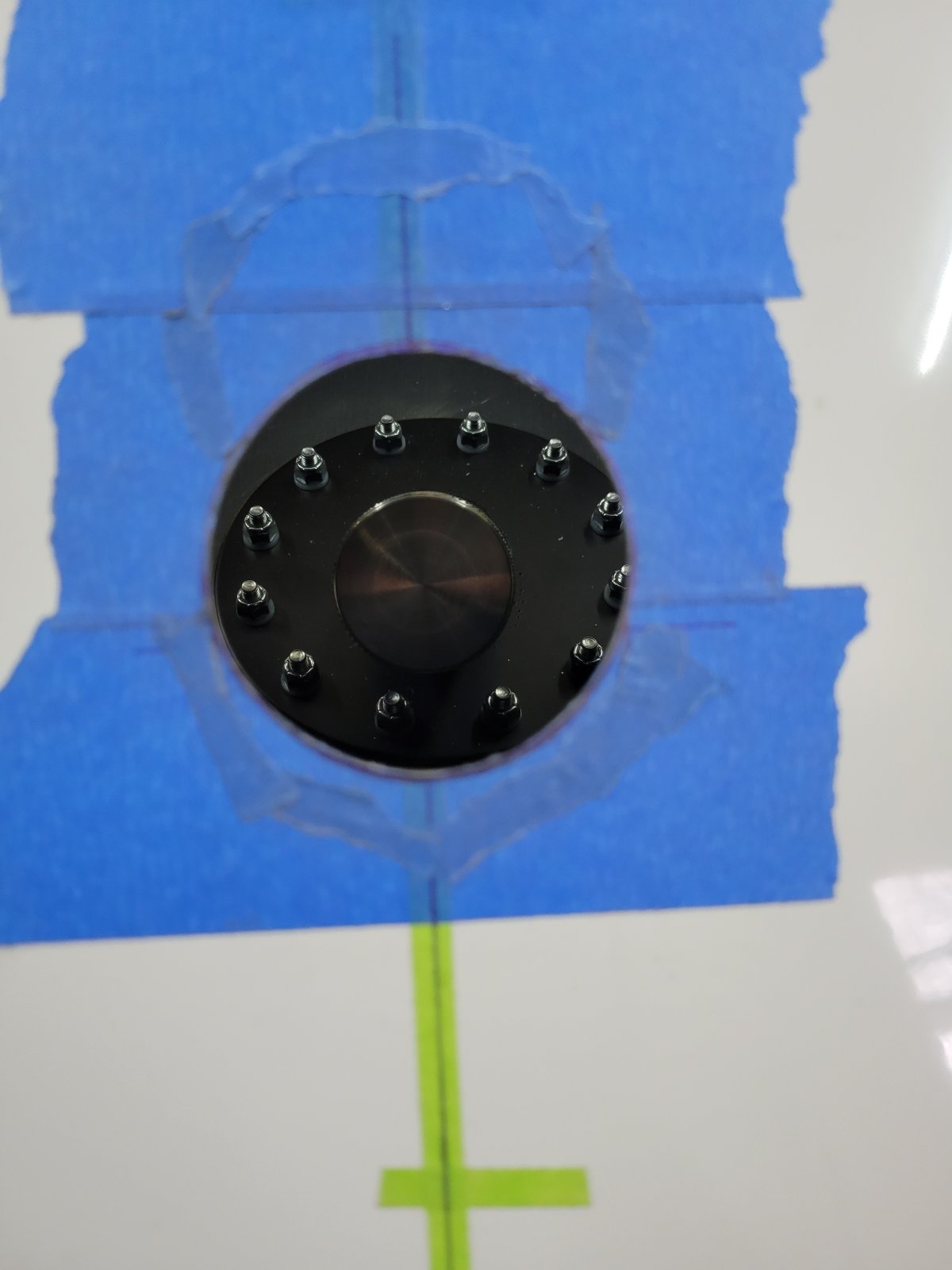

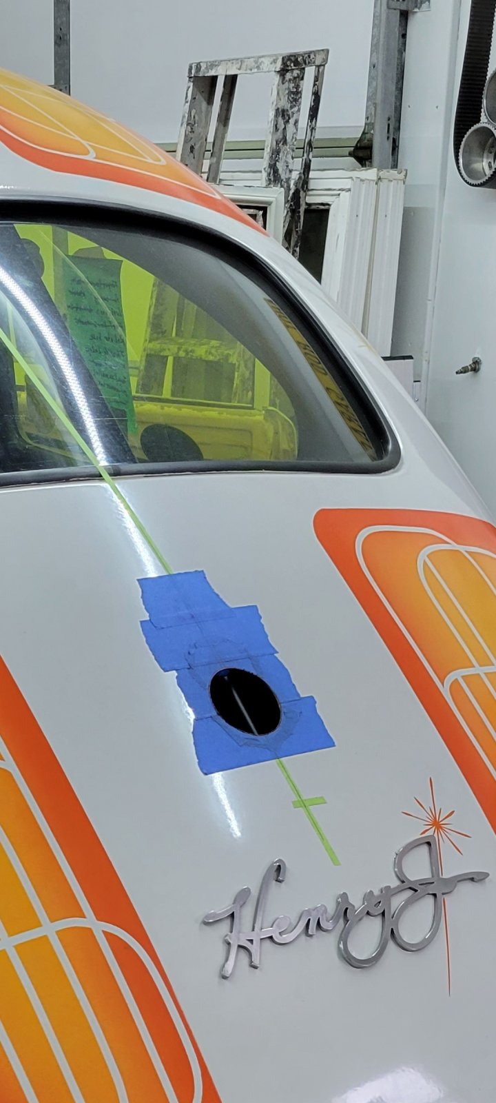

    Cut my hole, lined up pertinear perfect
    Screenshot_20230502_170429_Gallery.jpg 20230502_160649.jpg 20230502_153744.jpg

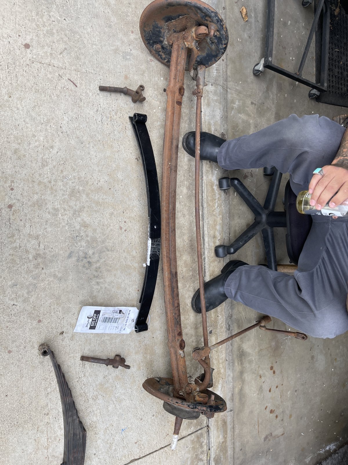

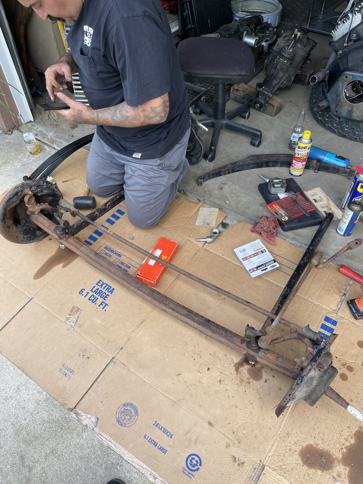

    Reason for template (paper doll). 58E66BDB-8B3C-48FE-A251-A925993E8042.jpeg 8081AF3B-8220-4DB4-85E4-0F23F546F16C.jpeg

    I won't lie, I was sweating it a bit, at the last minute I measured from the body down with a 1 3/4 tube and it was a little different from measuring from filler tube up.
    I had used that little 5 inch square and it showed the angles were pretty much the same, the smaller footprint of the tube showed they weren't so I moved it a half inch up.
    That's where the doubt creeps in lol

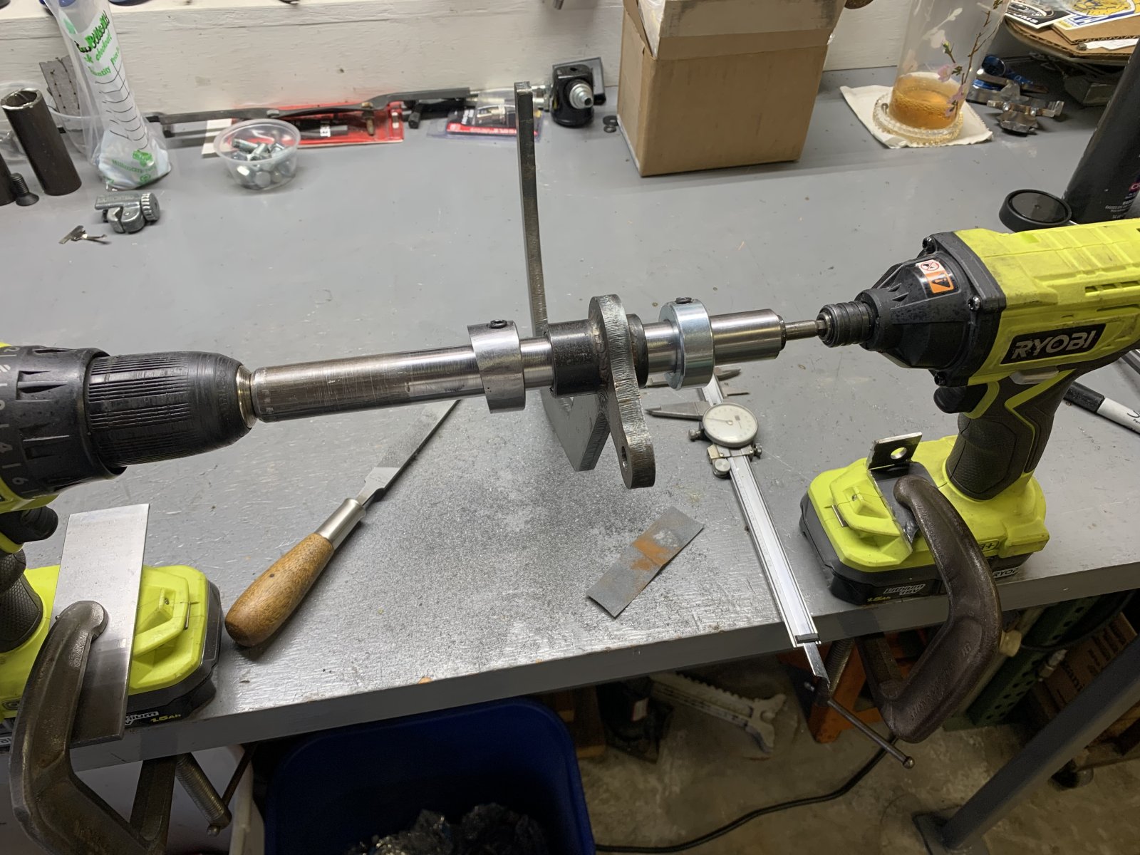

    After being layed off due to Covid no more machine shop to walk into. So what do you do when you need a few .000’s off? Get creative. Only need 4” so don’t be thinking I’m doing the whole 36”. Just mock up to see if I can spin some stock. 23D6CB62-17E8-4DC1-96E1-8CEF8A868FD7.png

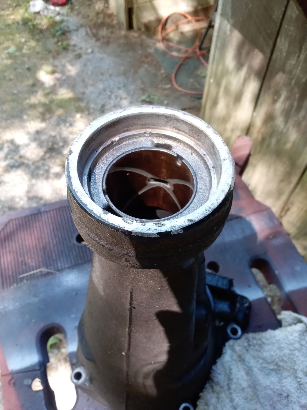

    Thought I had a bad u-joint, turns out it is a bad tailshaft bushing. Called around to four different trans shop, same answer,, we can't get parts!!Got on the net and hand two coming within ten minutes, be here Monday...Sad when people just don't want to help. F'em

  24. I've been through that here, luckily a place called Camargo transmissions keeps a stock of redi-sleeves on the shelf.

    Redi-sleeve or tail housing bushing?
  26. Every one I've got from them is in a redi-sleeve box
