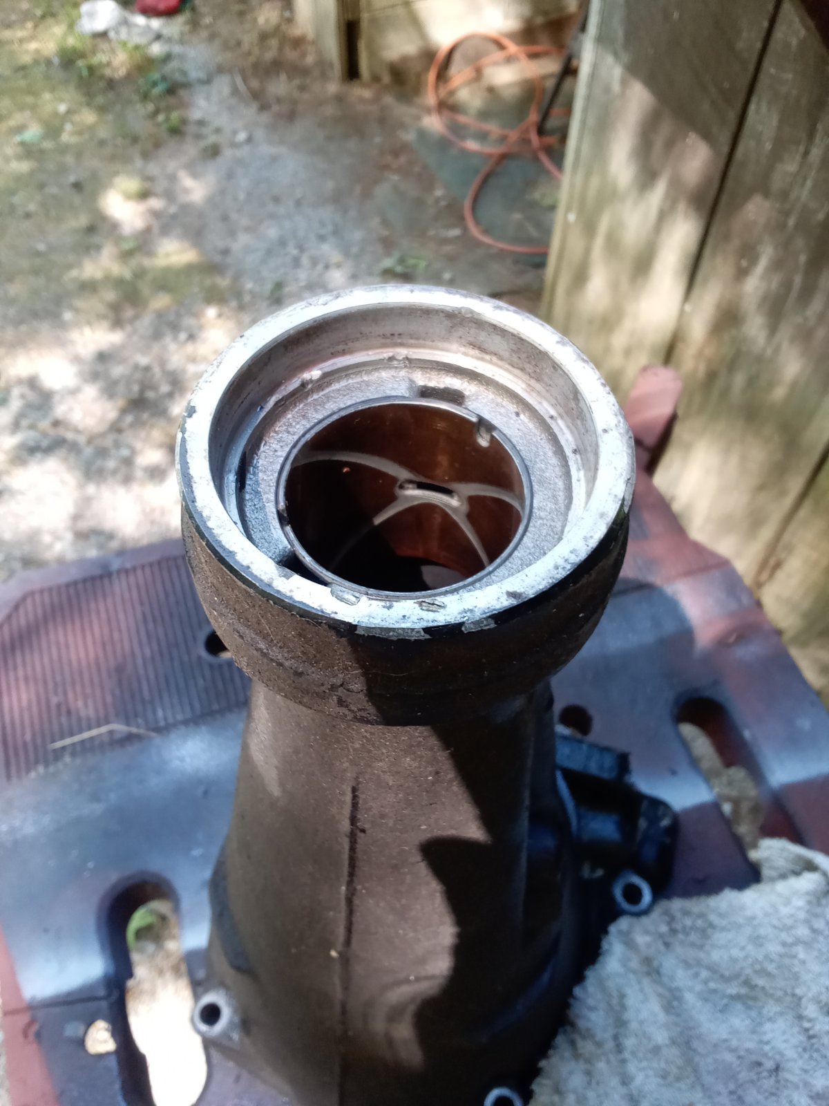

  3. Bushing shortage. Yeah, just went through that trying to find a stator bushing for an AOD I'm trying to rebuild. Took me three weeks to finally get the right one. The delay stalled my project for a while, but this week I'm resuming the process. Shout out to Saltflats who's helped me tremendously in all kinds of ways as I tackle this new skillset.

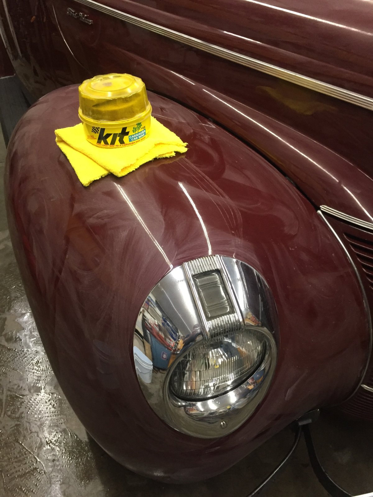

  4. My Dad loved Kit Wax!! It sure works nice on my stuff.

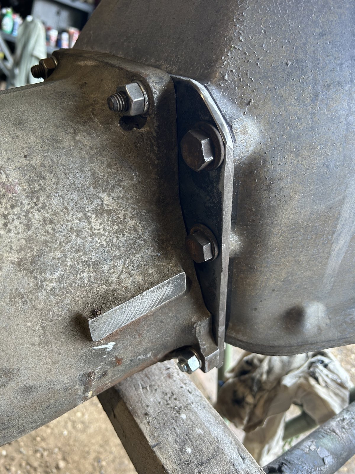

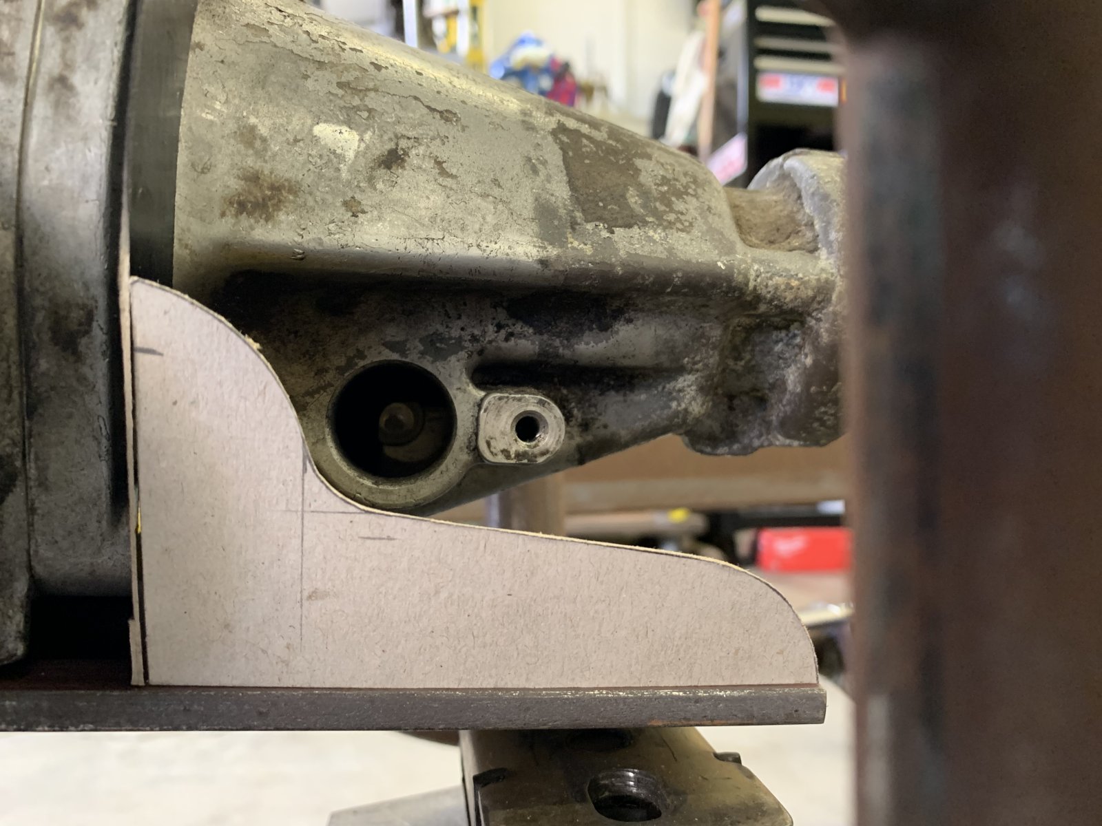

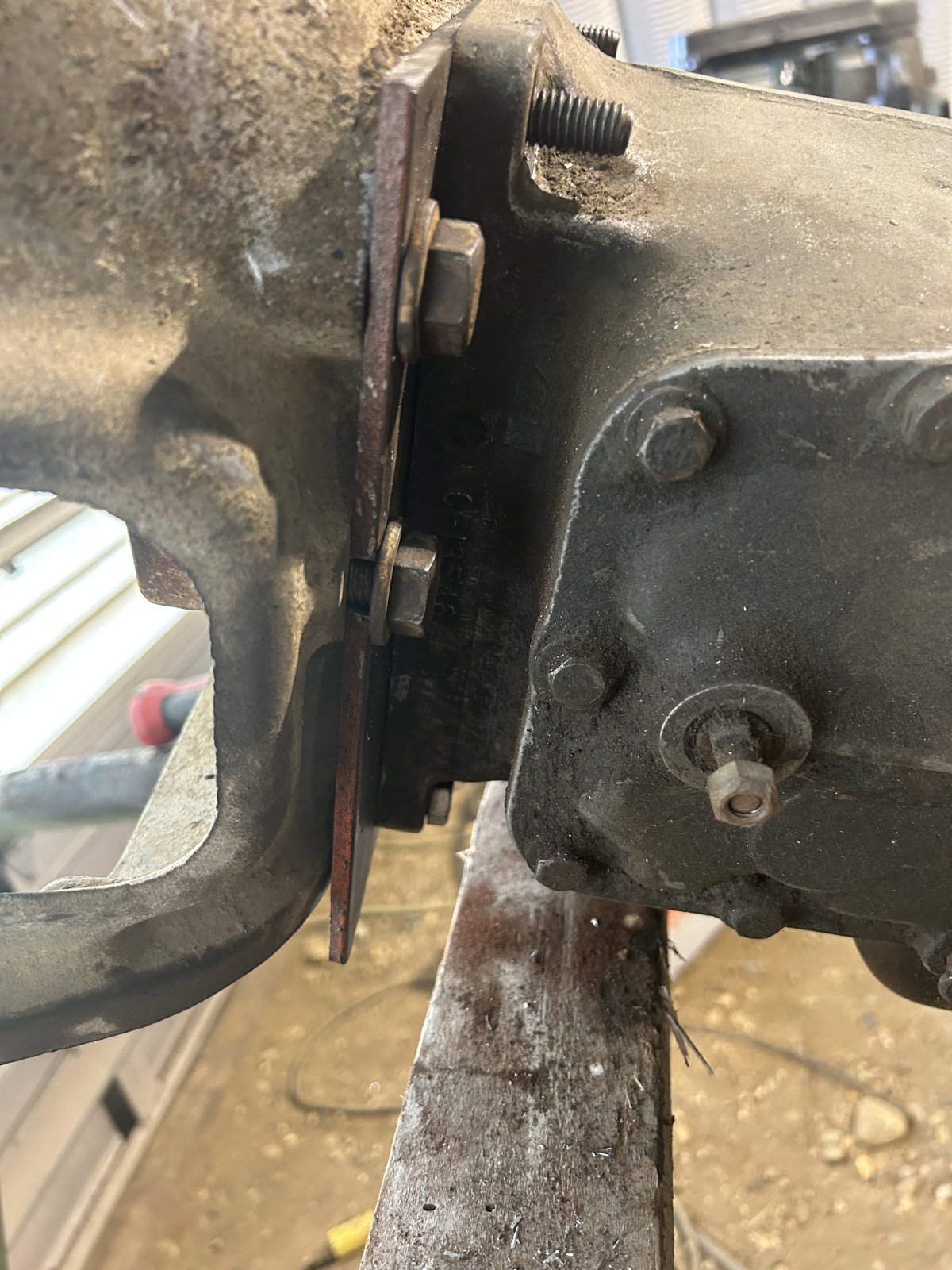

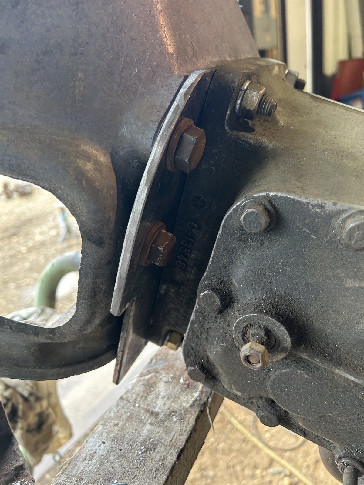

    Finished up an adapter to bolt an A833 overdrive four speed to a NP435 bell housing. They share the same bearing retainer hole but have a different trans bolt pattern, the plate is 1/4” and I milled a 1/4” off the back of the bellhousing as well. Going in the Barracuda project behind a freshened up 318.
    And the bellhousing in the surfacer at work.
    This car is all about using parts I have, this transmission I’ve been packing around for 25-30 years. I had two of these bellhousings a flywheel and a clutch.
  6. Very nice work Fargo!! I like the way you think!

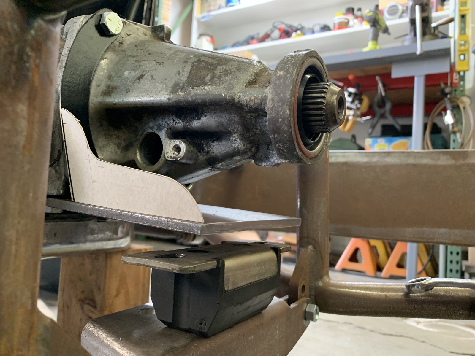

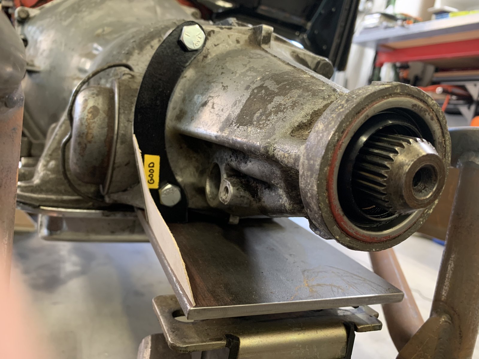

    No longer an idea. Making it happen. 8C6EDDB5-296D-48AD-8174-9606F2D3B8DF.jpeg 5E729B6D-50E7-4A03-8AD5-316E7CCB425A.jpeg EE1EBAD6-5DB8-4C6C-A20B-67885C1ECAE5.jpeg

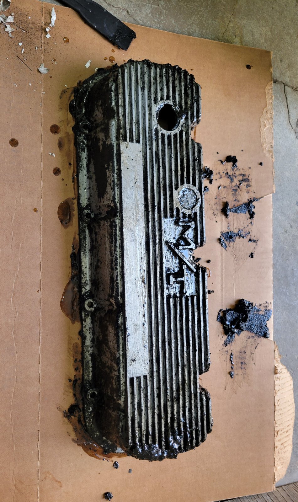

    I got sidetracked from what I should be doing on the Henry J and started the process of making some new bling for the 41 B/BBC.
    Stripping the black crinkle paint to see what I have to work with, going to put a pair of duals on them and polish them out of course. I've been thinking about building this set for a few yrs and have had all the parts for at least a year now, time to at least get started.
    I'm also thinking about buying a bench top blasting cabinet for baking soda or something else fine, don't need any extra roughness to work out on the polishing side of things.
    https://www.eastwood.com/eastwood-b...ickedid=629947571437&wickedsource=google&wv=4

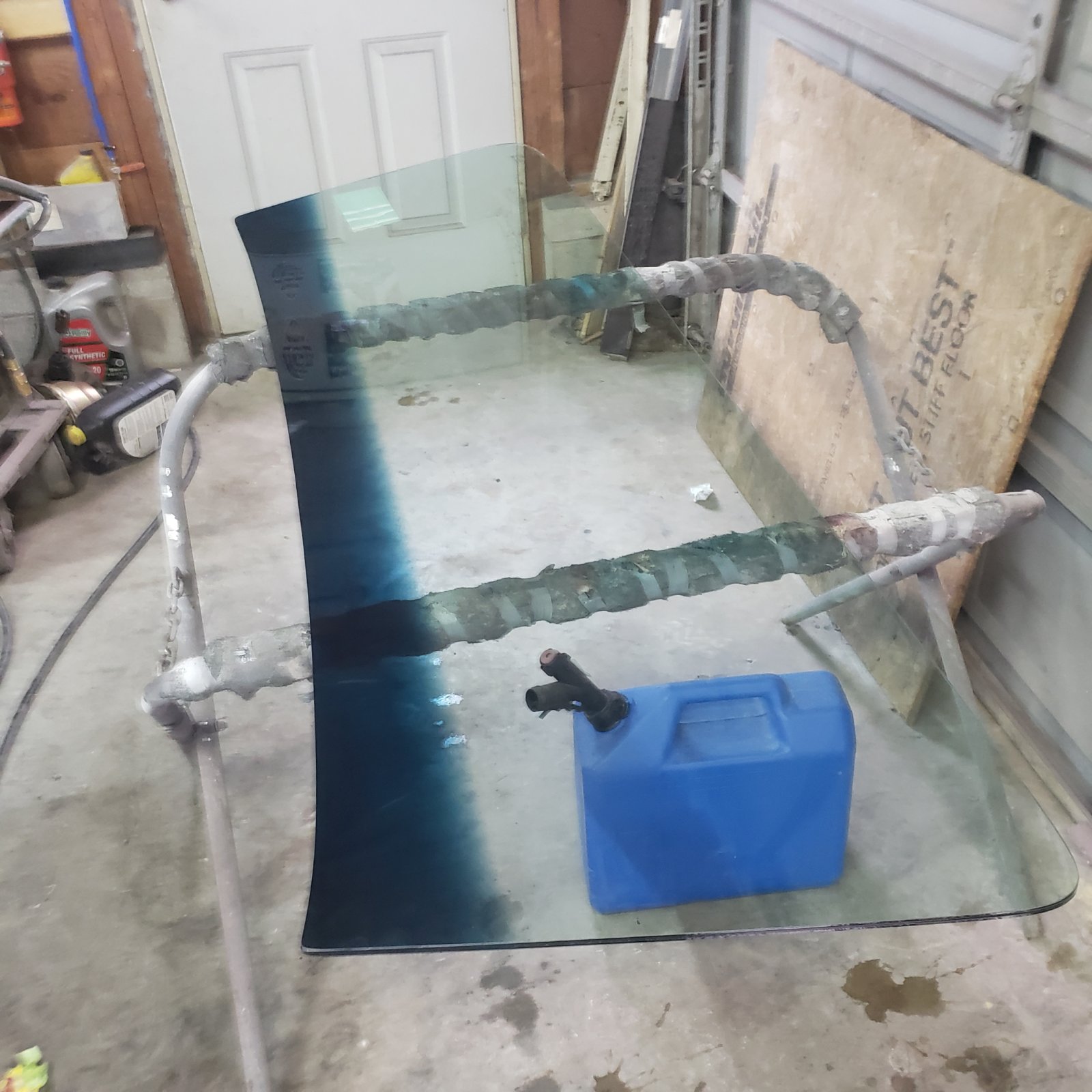

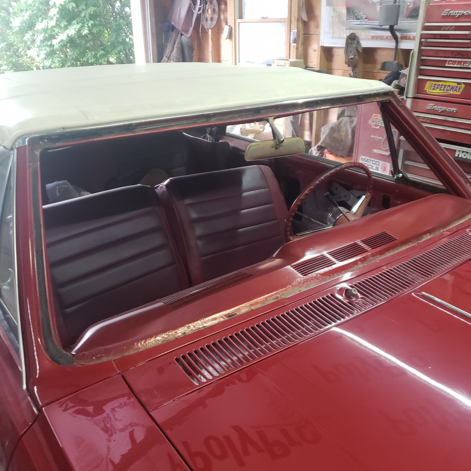

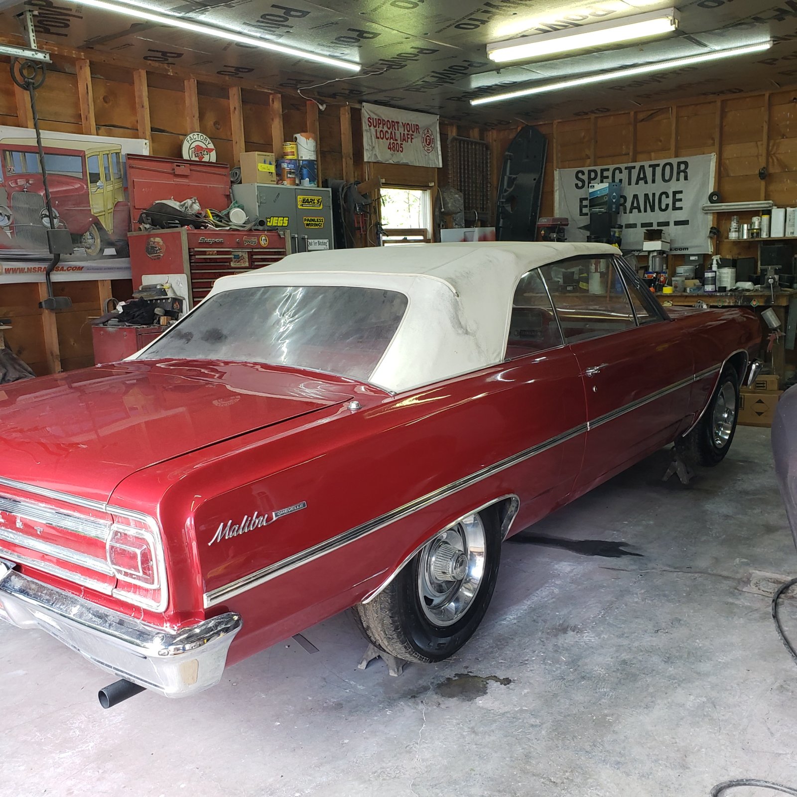

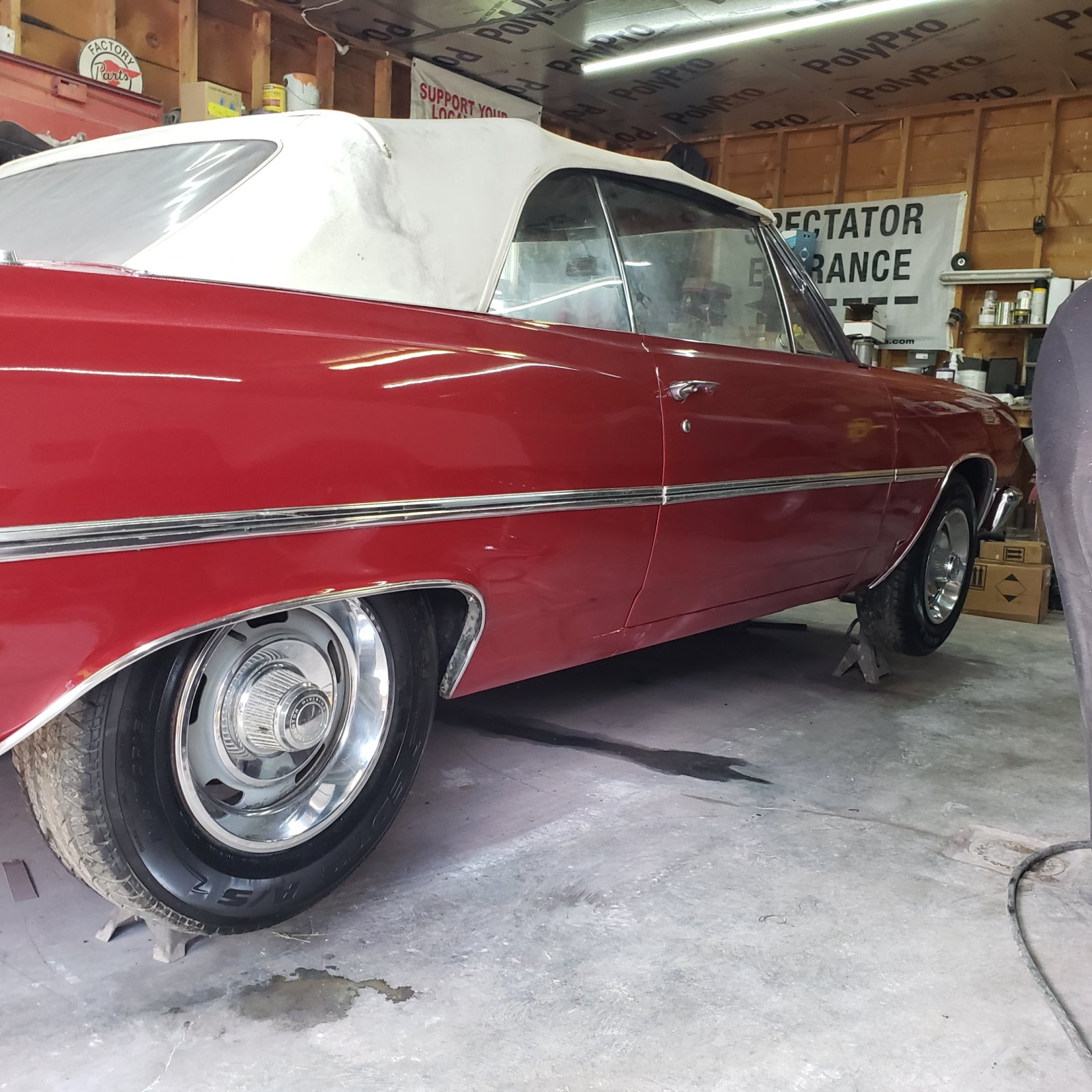

  11. Almost done, couple more spots that need a little cut and buff. Fender emblems, put the door panels back in, new windshield, and it goes home :D 20230511_160338.jpg 20230511_160530.jpg

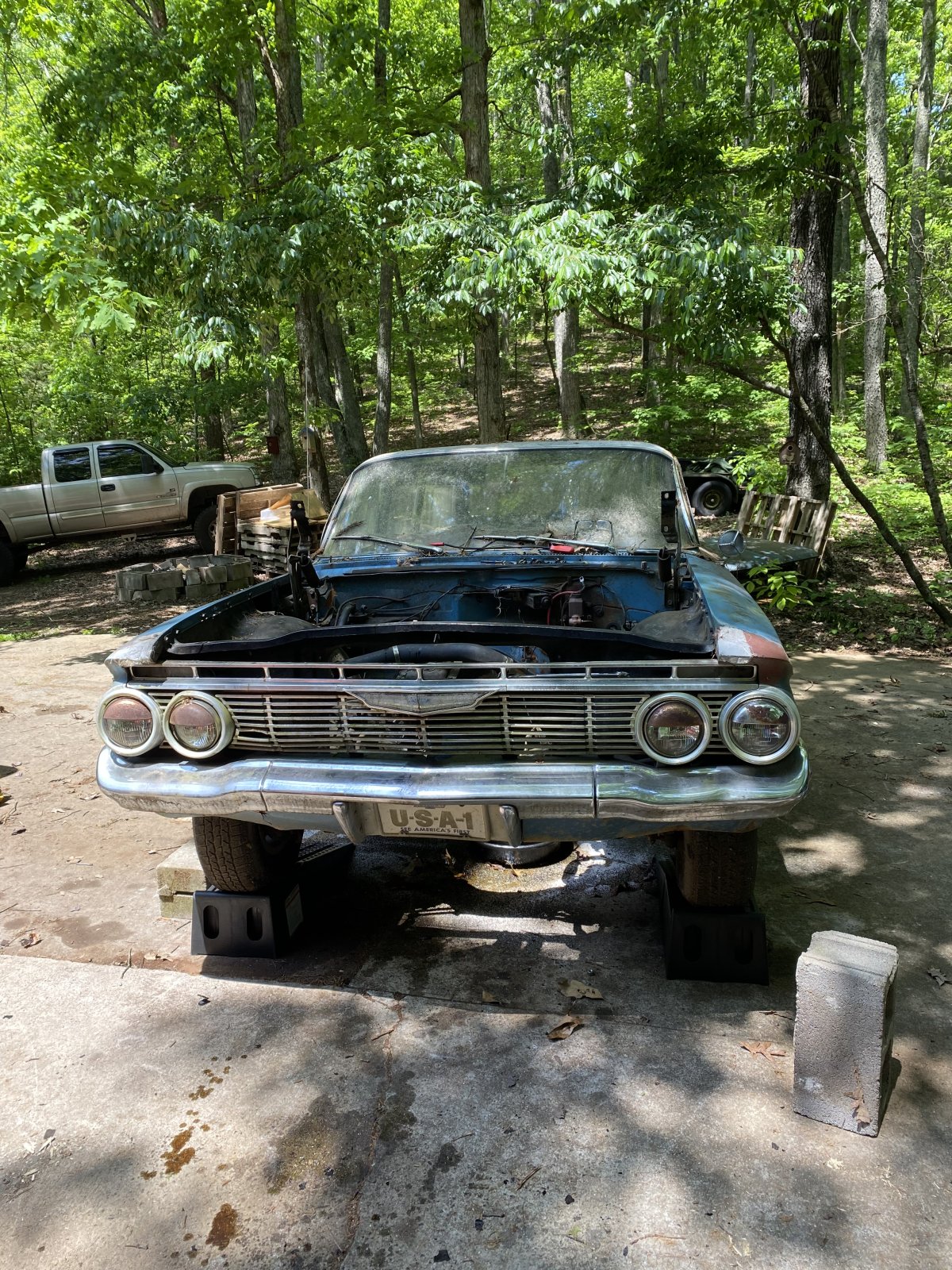

    Picking up parts today and back on this one tomorrow. There are more pics in the thread that is linked in my signature CDBE42C4-130F-422A-B2D3-406480CBECA7.jpeg

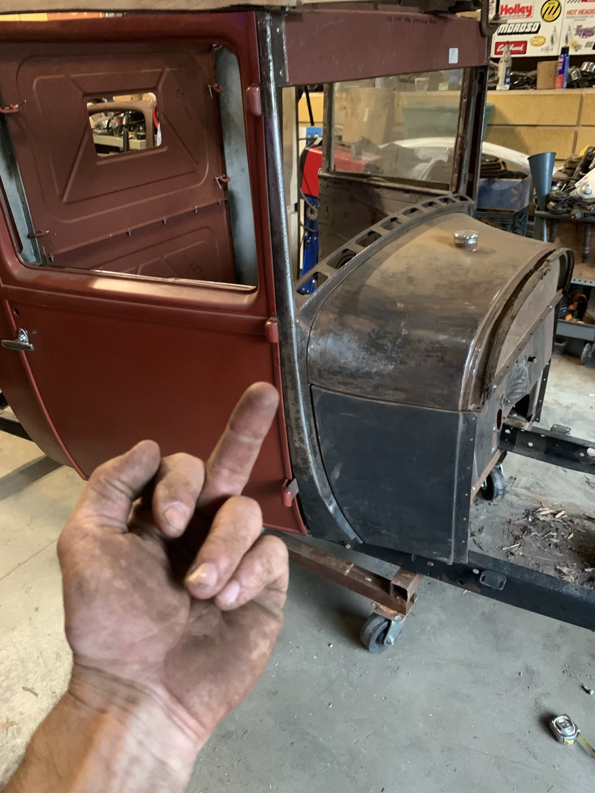

    This aggravatin' son of a *****!
