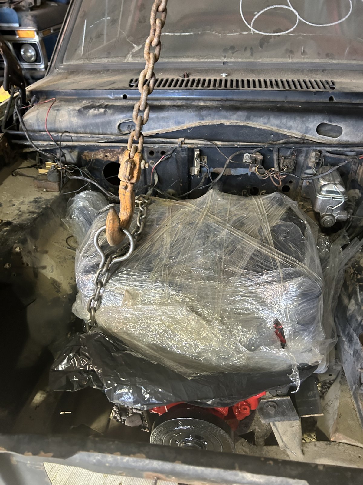

    And we have to be in Bowling Green in a few weeks
  2. It's ready to hit the road brother! Gotta finish getting door gl*** in it for the drag race though.

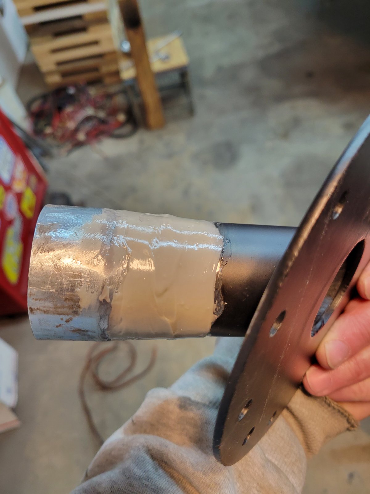

    I couldn't find a fuel hose that was 2 inch to 1.75 inch, lots of straight 2 inch and 2 inch to 1.5 inch, so I cut the threaded section off of the filler neck
    And welded on an exhaust reducer that was 2 inch o.d. to 1.75 i.d., not supposed to be welding but I got it done complete with a blow through and fill it back in.
    My auto helmet doesn't work after getting a nice flash in the eyes lol, so I used an old school flip, which didn't help matters.

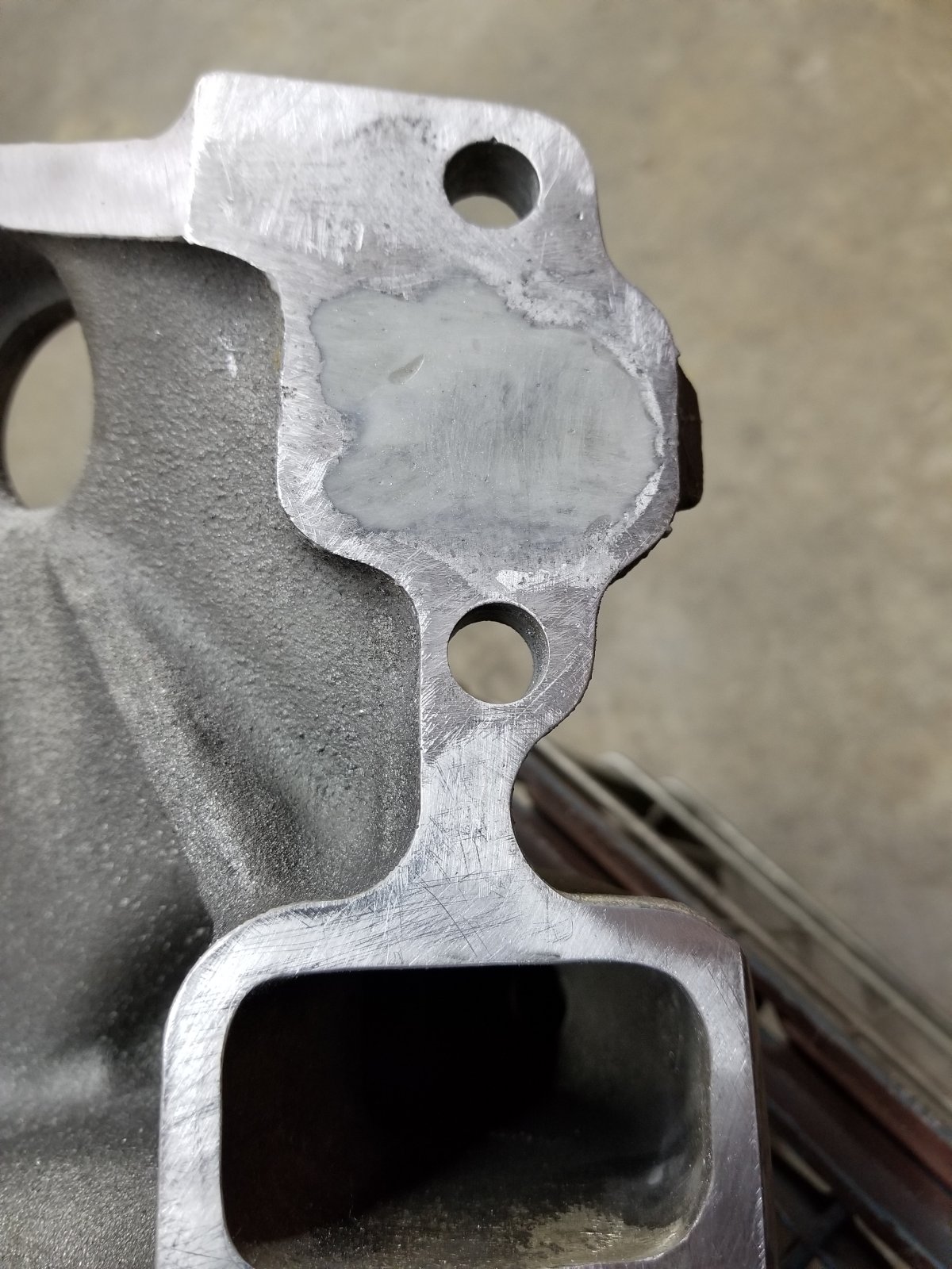

    Then I gave the weld a liberal coat of epoxy that I had used on that intake I had the corrosion spot on, tomorrow I'll give it a coat of paint and source a 2 inch hose to call that job done.

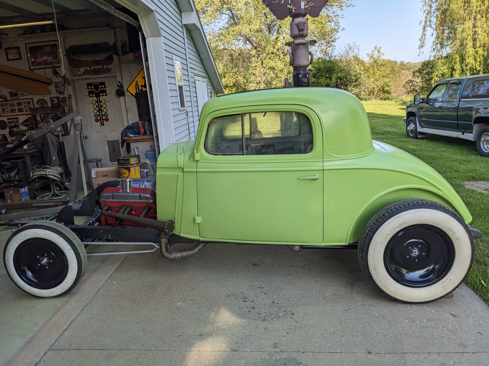

    The Chevy 3 window is back on the ch***is, getting close PXL_20230520_221258726.jpg

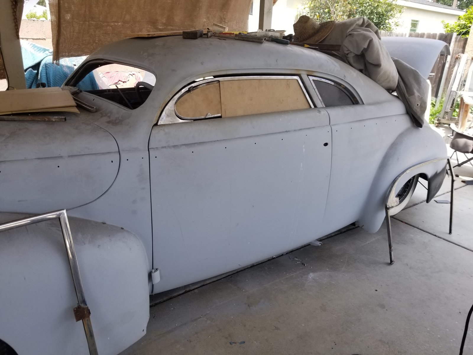

    Pushing to get the merc ready for paint..

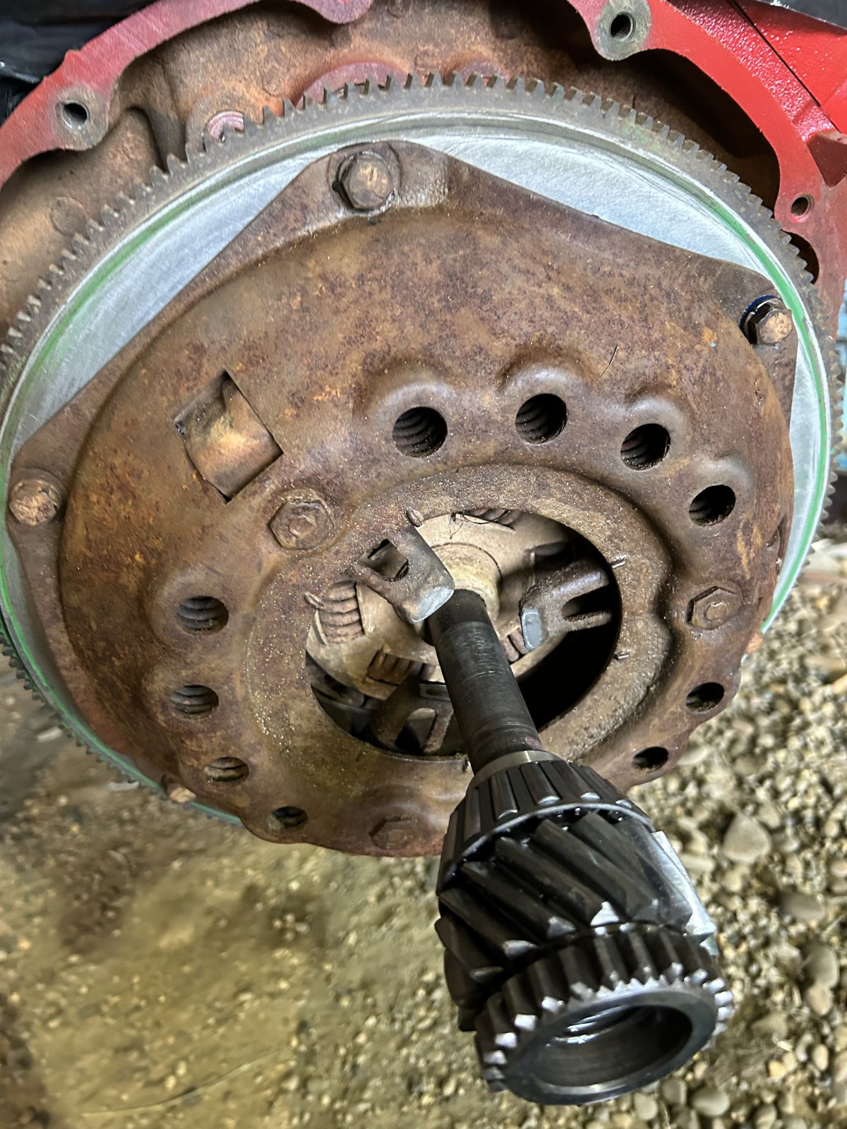

    Installed the previously owned clutch and the newly resurfaced (80 grit on an orbital) flywheel on the 318 for the ‘64 Barracuda project. The four speed is bolted up and engine and transmission sitting in the car. IMG_4436.jpeg
    One step closer

    Back in the '70's I worked as a mechanic at a local dairy. We "surfaced" many heads, exhaust manifolds, and flywheels by rubbing them on the concrete floor of the shop when time or budget issues prevented sending them out to the machine shop.

    I actually think the flywheel was new, it was painted green. It came off an engine that had been used as a training aid for ***embly/dis***embly at the college here. I sanded the paint off and it looked perfect

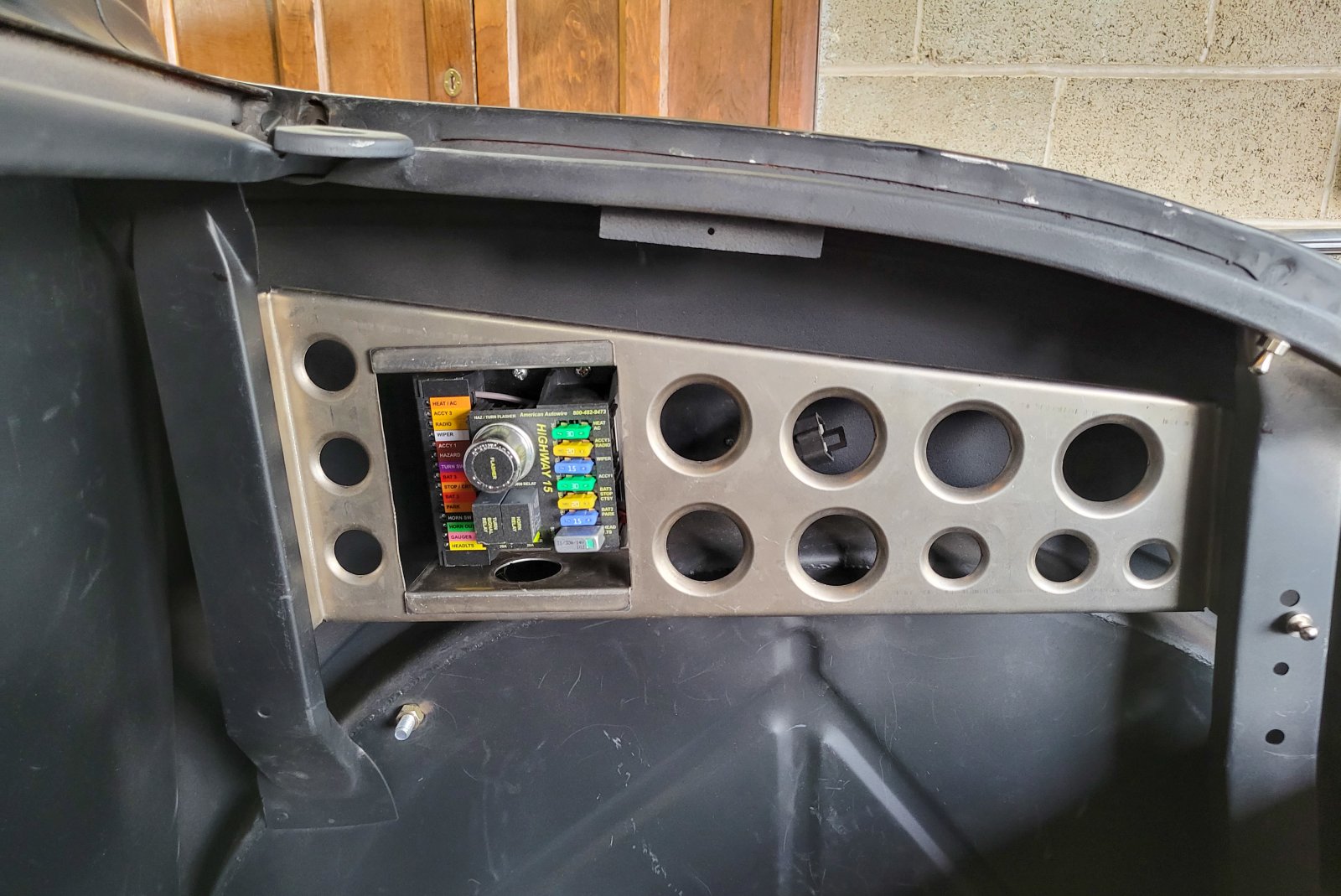

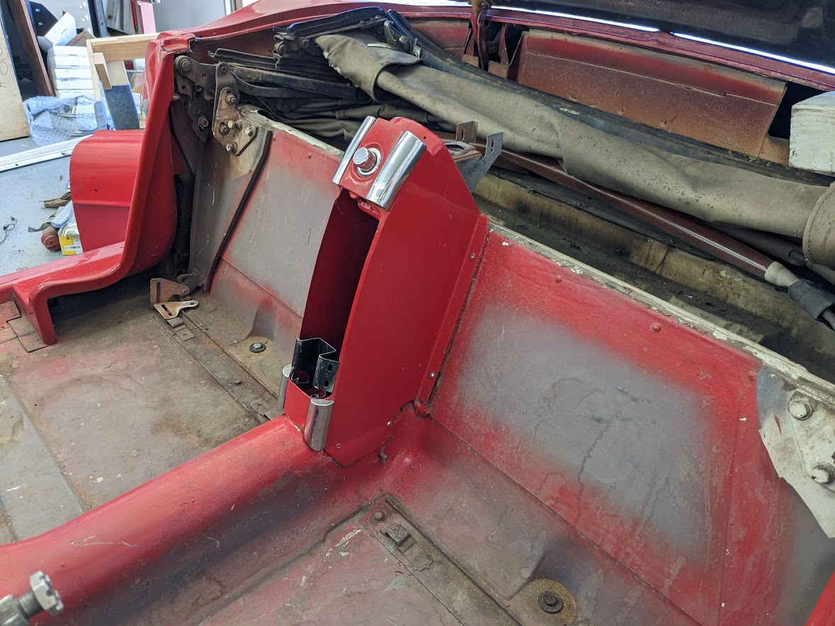

    Putting the fuse block in the back of my Model A.
  21. Dang son! You win for the sweetest fuse block mounting panel hands down! :cool:
  22. -Brent-
    Joined: Nov 20, 2006
    Posts: 7,921
    -Brent-
    Thanks! It's a bit overboard/absurd... I do that sometimes. Hahaha.

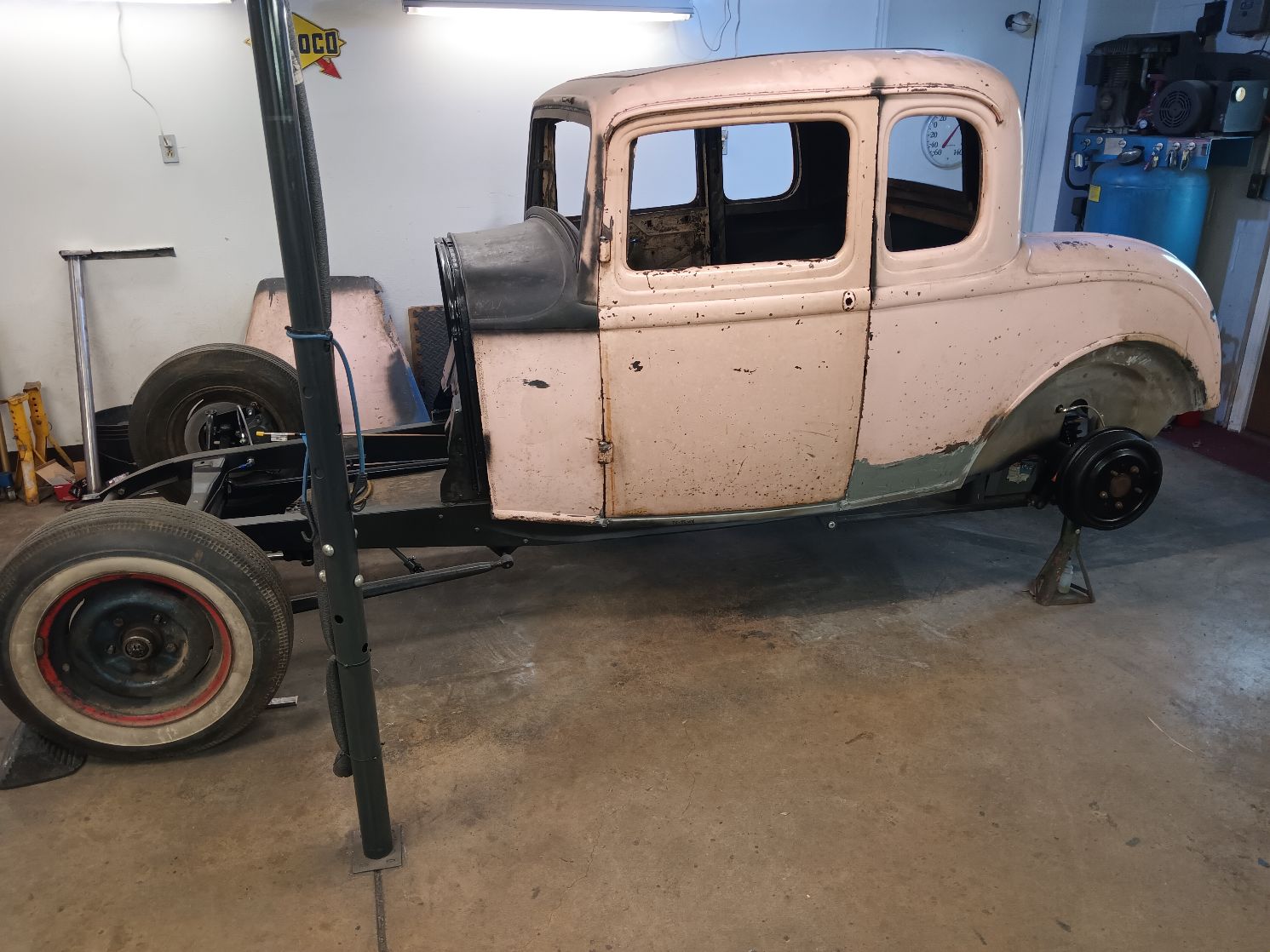

    I'm helping my cousin with his 32 5 window, that he has owned since 1964. It was a C/Altered, ran infrequently at Pittsburgh International Dragway until it closed. Typical East coast rod, channelled, no chop.

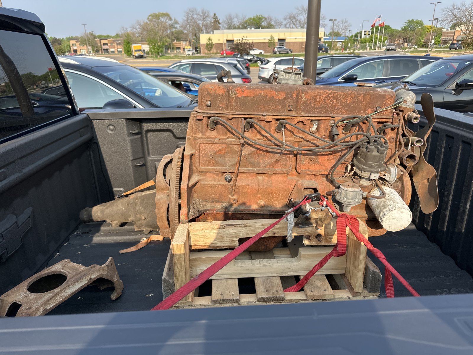

  29. image.jpg This is the engine and transmission we picked up at French Lake Auto Parts today for our 1950 3100 project. Now, I just have to finish the engine installation into Little Truckdoctor’s Cub Loboy 185 to free up shop space. Do you guys know if the front fenders and grille will come off of a 1950 Chevy truck in one piece, or do I have to dis***emble it?
  30. They should, Td. They will on a Buick. One CAN'T remove the bell housing from a Buick as has been done on that Chevy. Lot more must be removed first.
