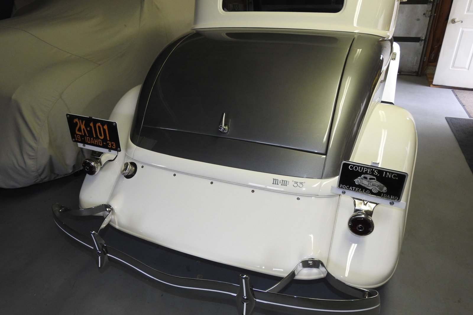

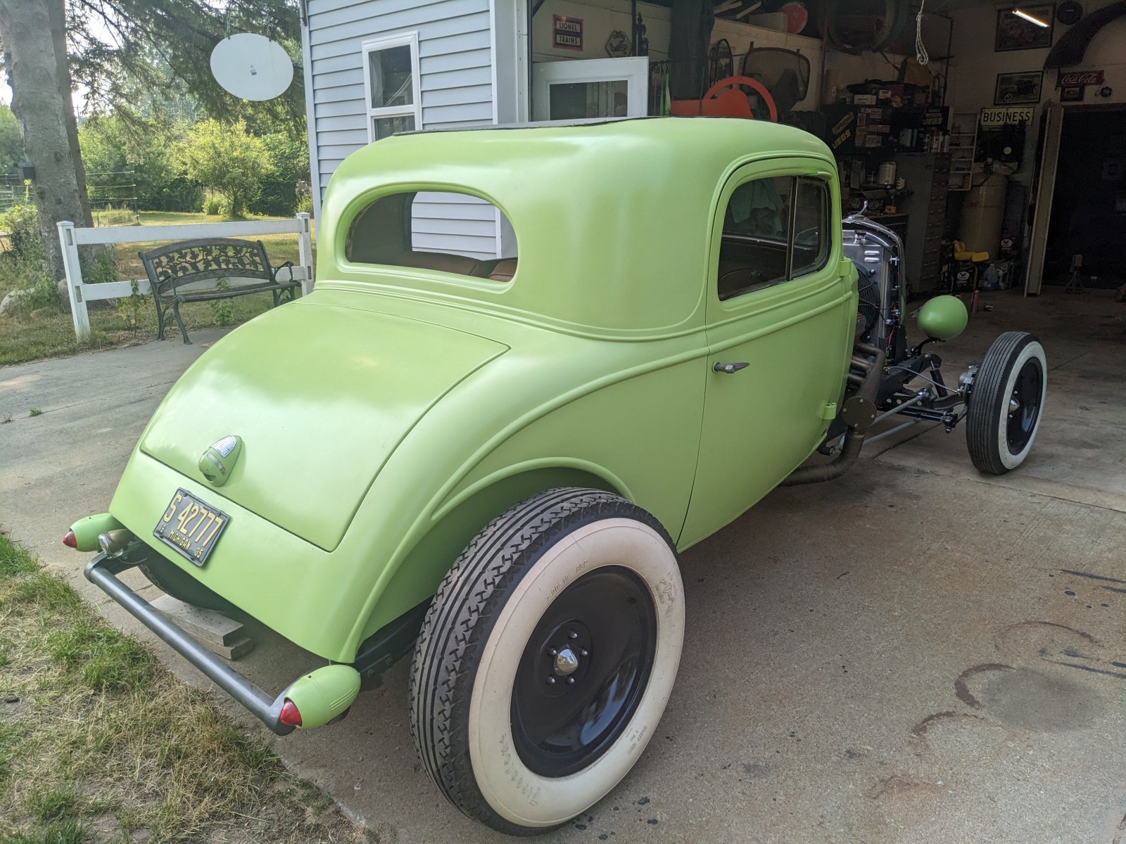

    PXL_20230617_213807387.jpg Ready for a test drive...but waiting on the steering wheel delivery Monday...

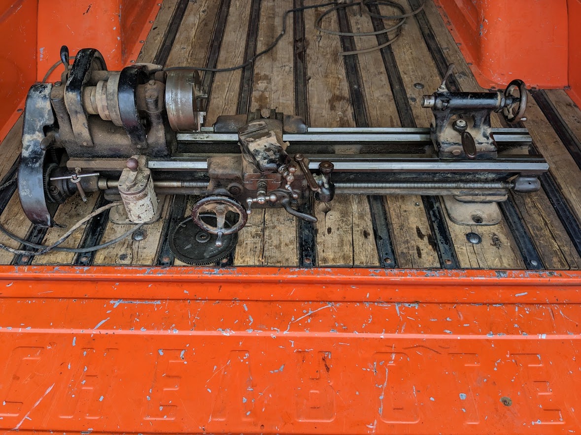

    Picked up another lathe, which I really don't need....was hoping to use it to replace my well worn lathe, but it's different enough that I don't think that's going to work out. This one was made in 1935, but it's the cheap version of the South Bend 9". Not much wear on this one, it's mostly complete with tooling. Came with the countershaft ***embly and motor, but they were not set up right. Also got the bench, which someone made a long time ago.

    And the compound is set at 29.5 degrees for thread cutting. You get any extra belts? Parts are still available for the old SB lathes.

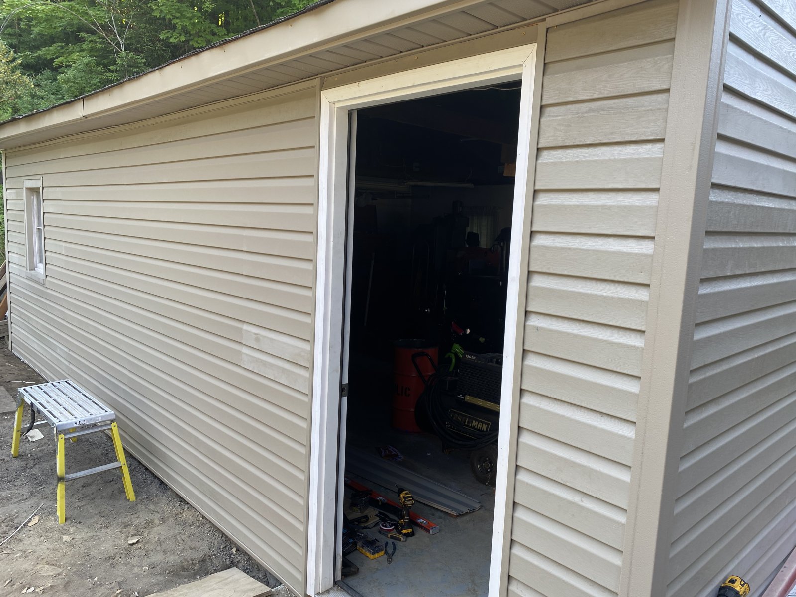

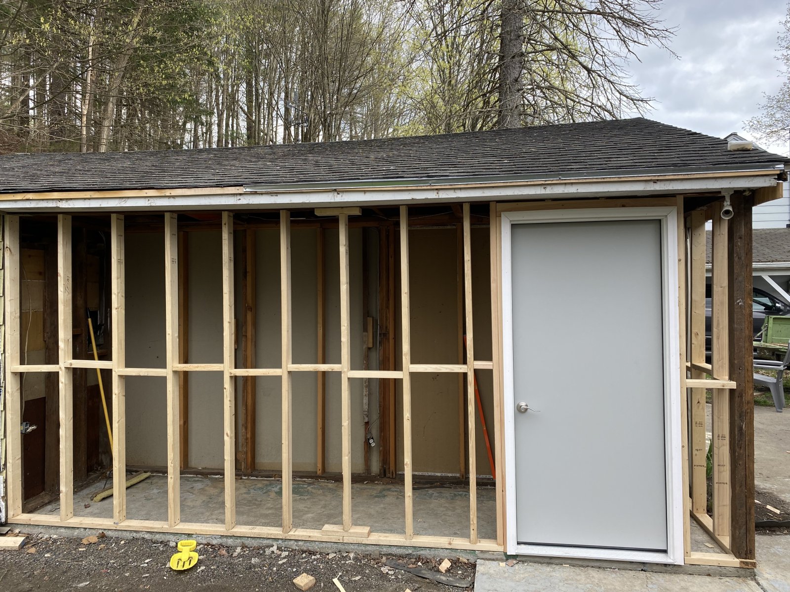

    45C85BF3-D556-40BA-B62B-D5E8F2E4B37F.jpeg C68E5D5D-BCAA-44AC-90EF-87162795B221.jpeg 6A1A726C-B117-4EB8-99F4-773E4943071D.jpeg
    The garage foundation and roof was square but they left a section open for patio ****. Closed that and picked up another bay. 600 square foot garage now. The next move is running 220v and a 50000btu gas heater.. capable of heating 1000 sq ft , work this winter in a Speedo..

    The compound was set about 45 degrees, I moved it to some random place around 30ish degrees. I haven't cleaned off the scale yet so I can set it to 29.5. It came with a neat thread cutting tool, too.
    The belt drive system is not set up right, it had a V belt running on the spindle cone that takes flat belts. And a can of belt dressing nearby, to try to make the belt stick, I suppose. I need to get a proper flat belt cone for the countershaft, and a flat belt for it. And redo the mount for the countershaft and motor.

    My friend Chingiz (RIP) would berate you if you set up at 29.5* lol. He showed me another way that I’ve been using ever since.

    29.5 is traditional.....

    I’m aware. That’s how I learned in trade school…. using a traditional HSS hand ground tool.

    I still use the old lantern type tool post and the ***ociated tool holders, and grind the cutters from HSS by hand. No need for me to go modern on any of this stuff, I'm retired.

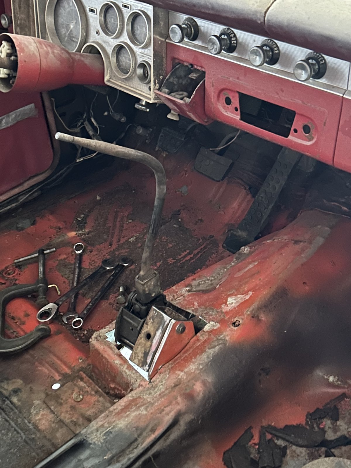

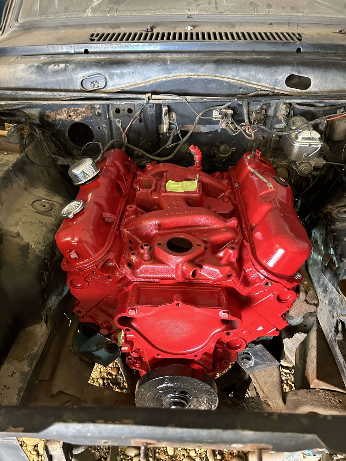

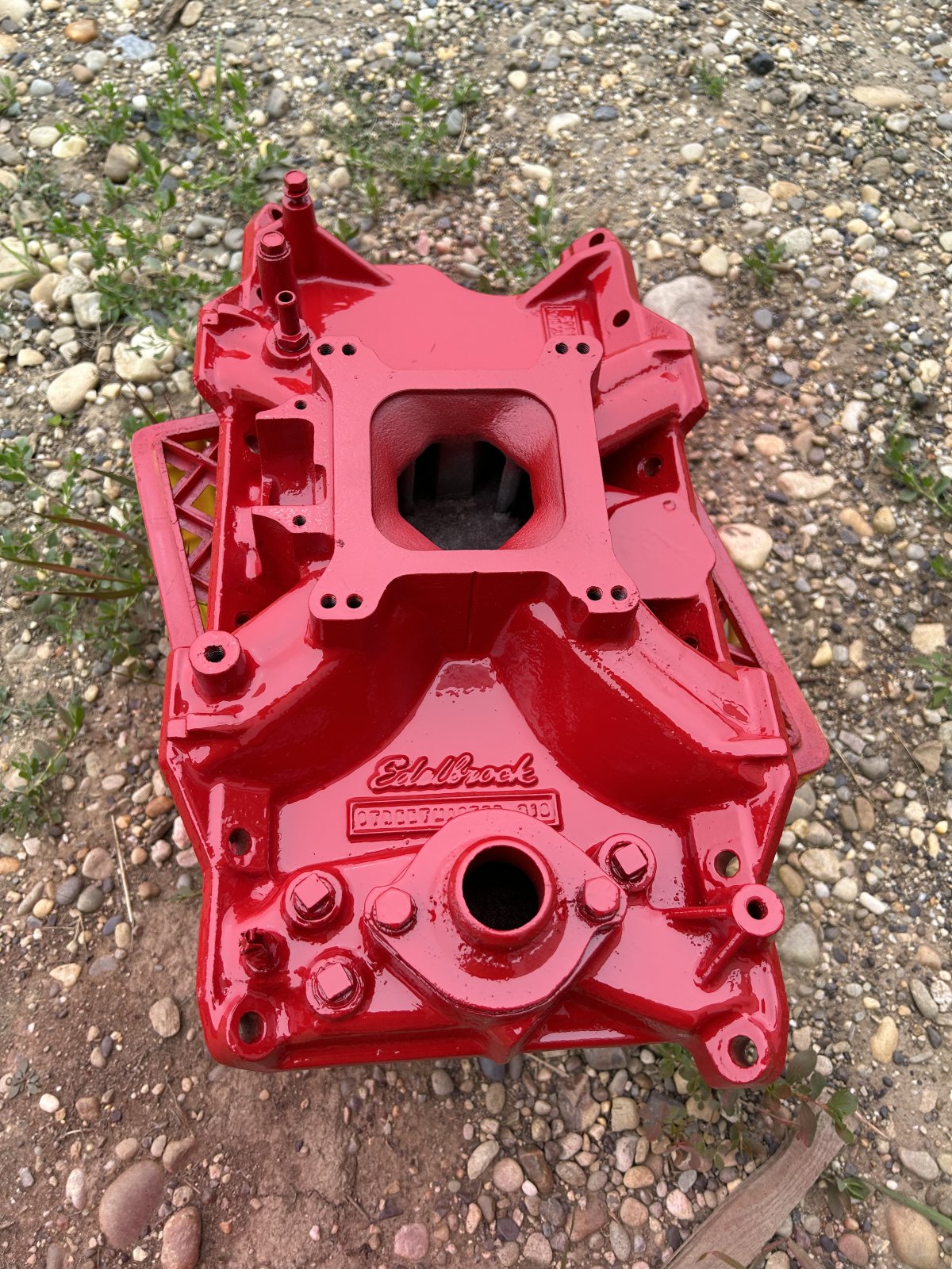

    More work on the Barracuda, lots of little things getting scratched off the list.
    Also painted the vintage street master 318 intake for it.

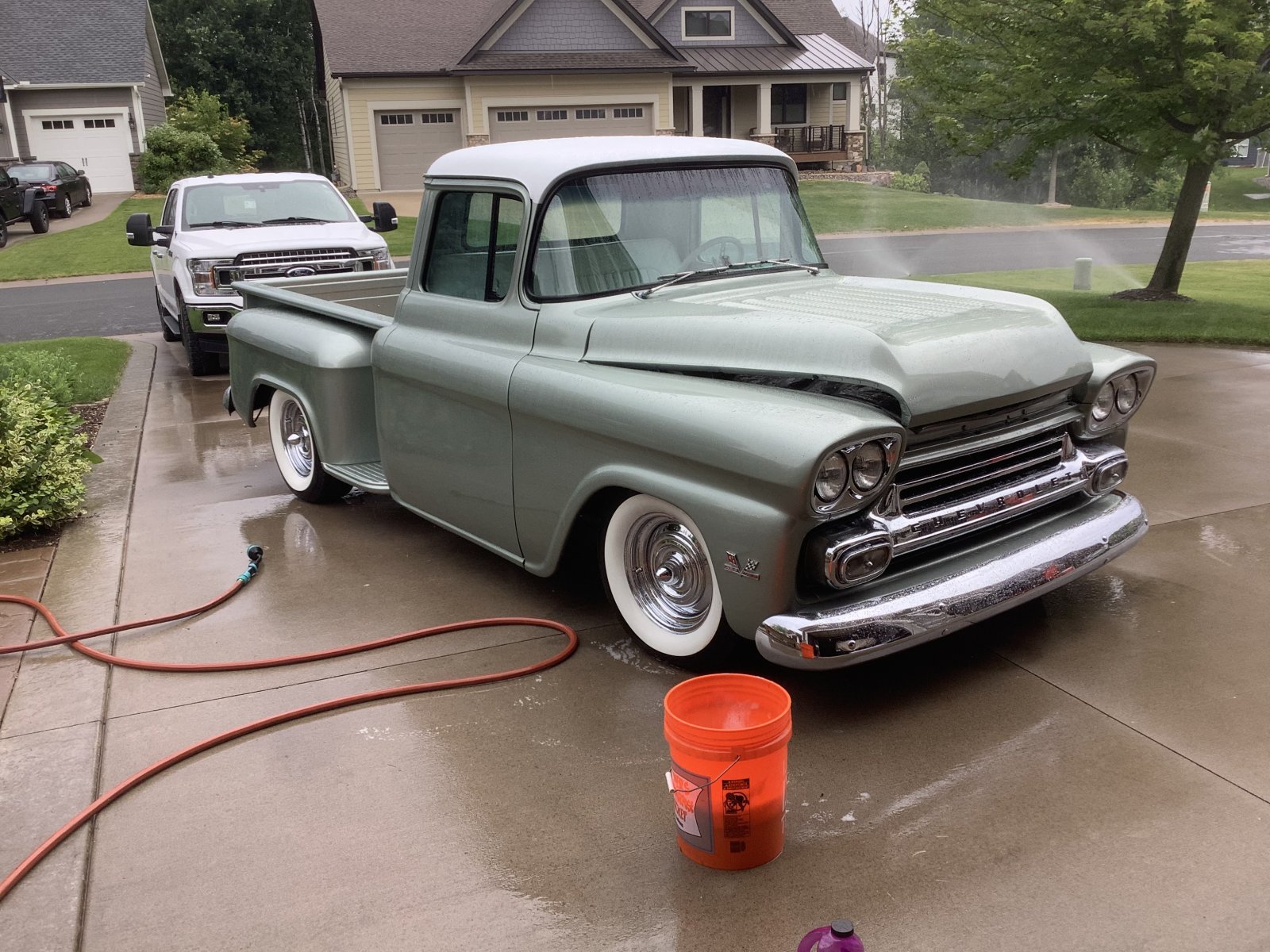

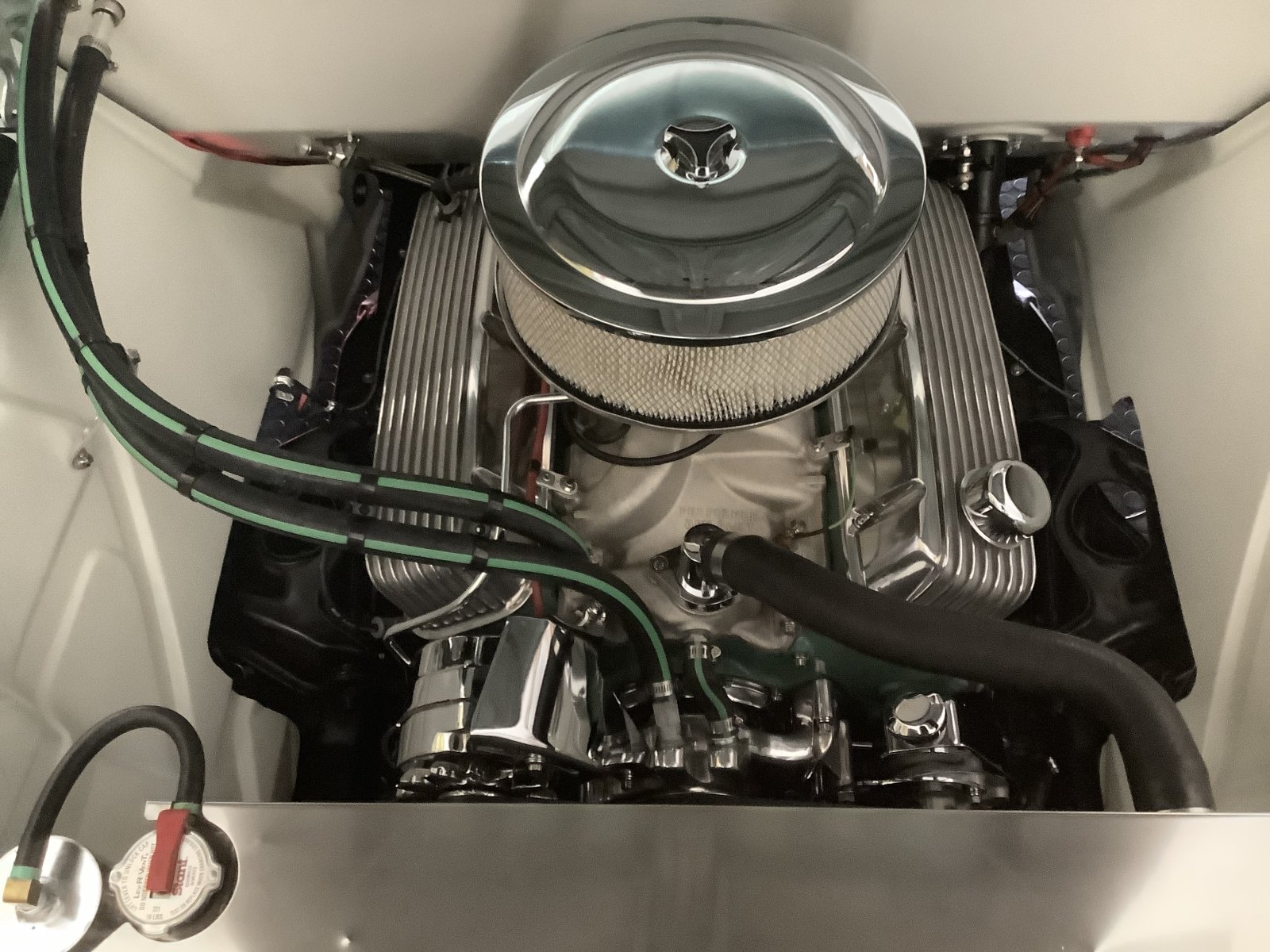

    Getting the truck ready for Back to the 50’s Weekend. I have been driving it a lot so the truck was in need of a serious cleaning. I gave it a bath, a fresh coat of wax and detailed the engine compartment. I still need to do the windows, vacuum the carpet and wipe down the chrome but I can knock that out after work…
    9FC682E7-2C43-424E-A144-8A0F613F7751.jpeg B09296CD-DBEF-4B5B-965C-70BE6E0A61A2.jpeg

    is that thing right hand drive?? or did the drug store reverse the negative before they printed the photograph???
  26. chevy57dude
    Joined: Dec 10, 2007
    Posts: 10,361
    chevy57dude
    ^Very sano. How is it washing the the truck with that louvered hood?
    Lloyd didn't tell us that Ruckus is center steer!
