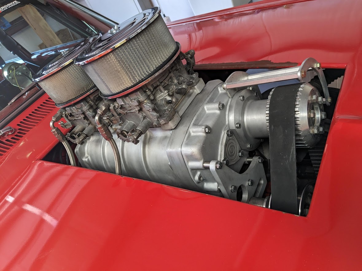

    I got the blower overhauled on Plan II, a fellow in Tucson did it. Back on and running again, it don't rattle so much now.
    Also finally added that fuel pump primer switch I've been dreaming of for years.

    Did you test the boost capabilities?:D

    Not yet, I'm thinking about going for a little test drive tonight.

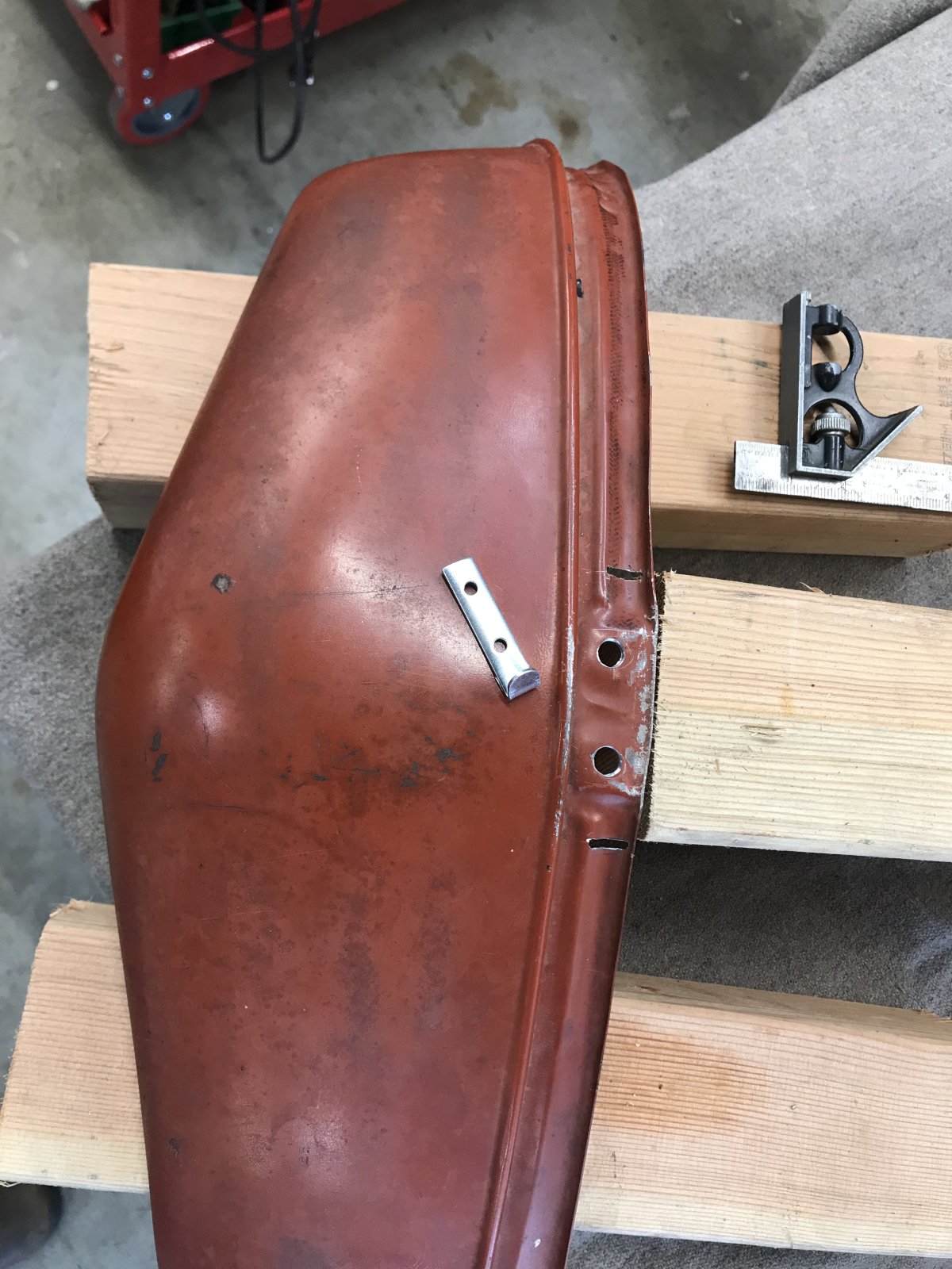

    IMG_5814.jpeg Cutting little slots for welting

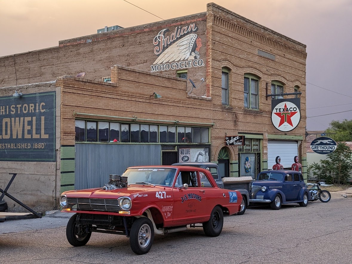

    I went to Bisbee, stopped for a picture, and Jay was home. I showed him the car, he'd never seen it...

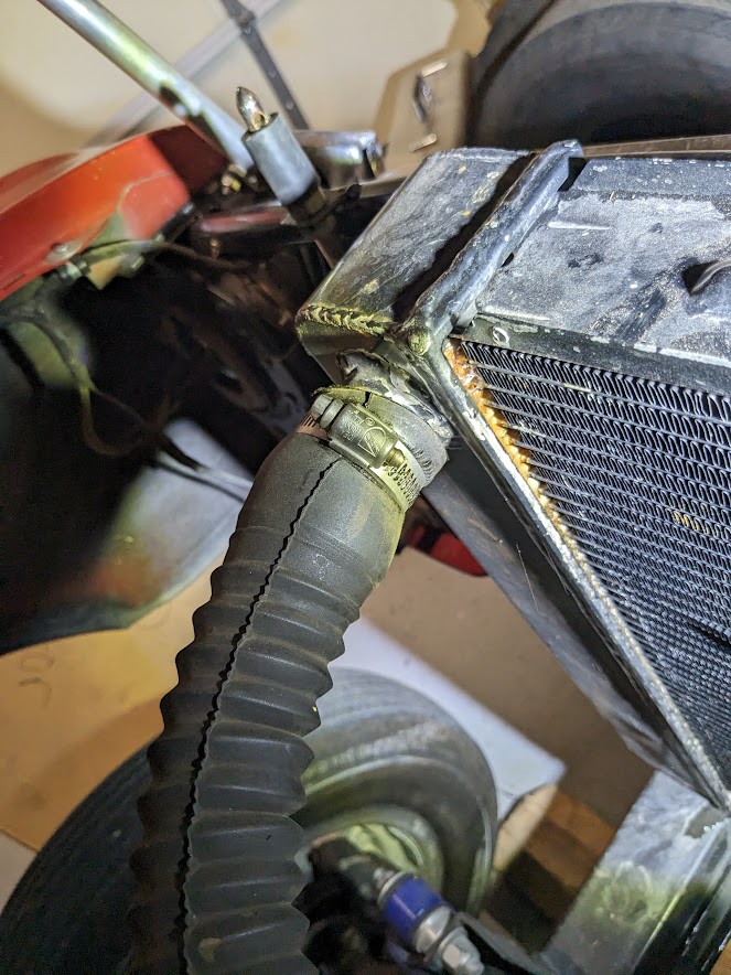

    Then when I got back, I was looking things over, heard a little hissing sound. Uh oh.
    so now I'm shopping for a radiator. They don't seem to make this particular one any more, so I'll probably have to adapt something else. More work.

    Mr @squirrel -How many miles did your blower have on it? Curious about longevity. Bummer about your radiator. Had one fixed like that 2 years ago. now seeping again.

    Mr. Jim, would you by chance have a part # for those air filters? Just what I'm looking for...Hate those damn purple filters that come with V stacks.

    The blower has a lot of miles on it, they generally go roughly 50k between overhauls, more or less. I've put something like 130k on this one, it's been gone through a few times.
    The housings are repop 427 Cobra Stellings & Hellings, with Wix 42040 filter elements, which are not quite the right size--a bit too small diameter, but it's all I could find. I didn't want to run the short foam things that came in them.

    No radiator shops around?

    No. And getting one to fix a tube to header leak on an aluminum radiator...figure the odds of that happening....

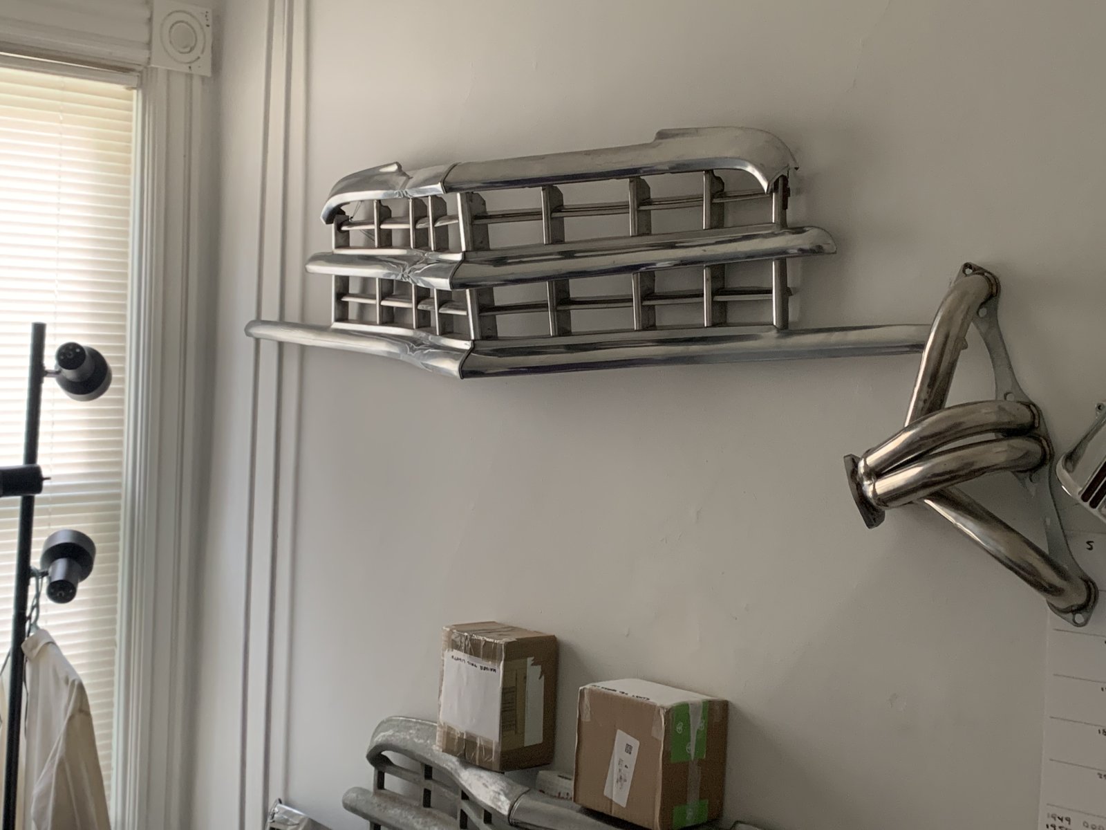

    Storing my NOS Dodge grille .. Whats better than a wall for safe keeping.. Cant get lost , damaged or misplaced.. ATTACH=full]5785671[/ATTACH]

    I took my family to dinner in the 442 last Sunday, same thing happened, got home and a trail of green coolant told the tale. I went on Summitt Racing and they had their own brand aluminum radiator on my doorstep the next day. Fit like a charm. $335 delivered. You might try them.

    I found one on ebay that should fit, I'll have to make new mounts for it. The old one had mounting holes in the tanks, and I built the support to work with them. All the replacements I've found don't have them, they require making saddles to support the headers, or something similar. I also found one that's a bit wider, hopefully a little more cooling capacity.

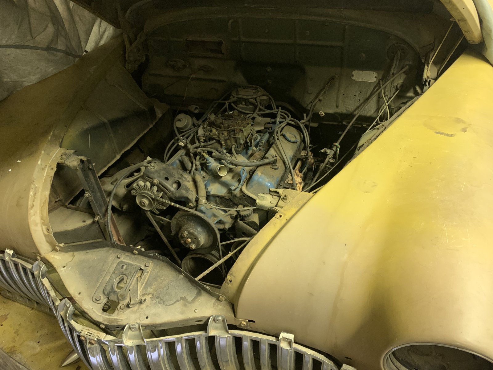

    Planning the 6 inch setback for the 350 SBC in the Desoto for radiator options . Also better front to rear weight . Got new block huggers , intake, carb , distributer. image.jpg image.jpg
