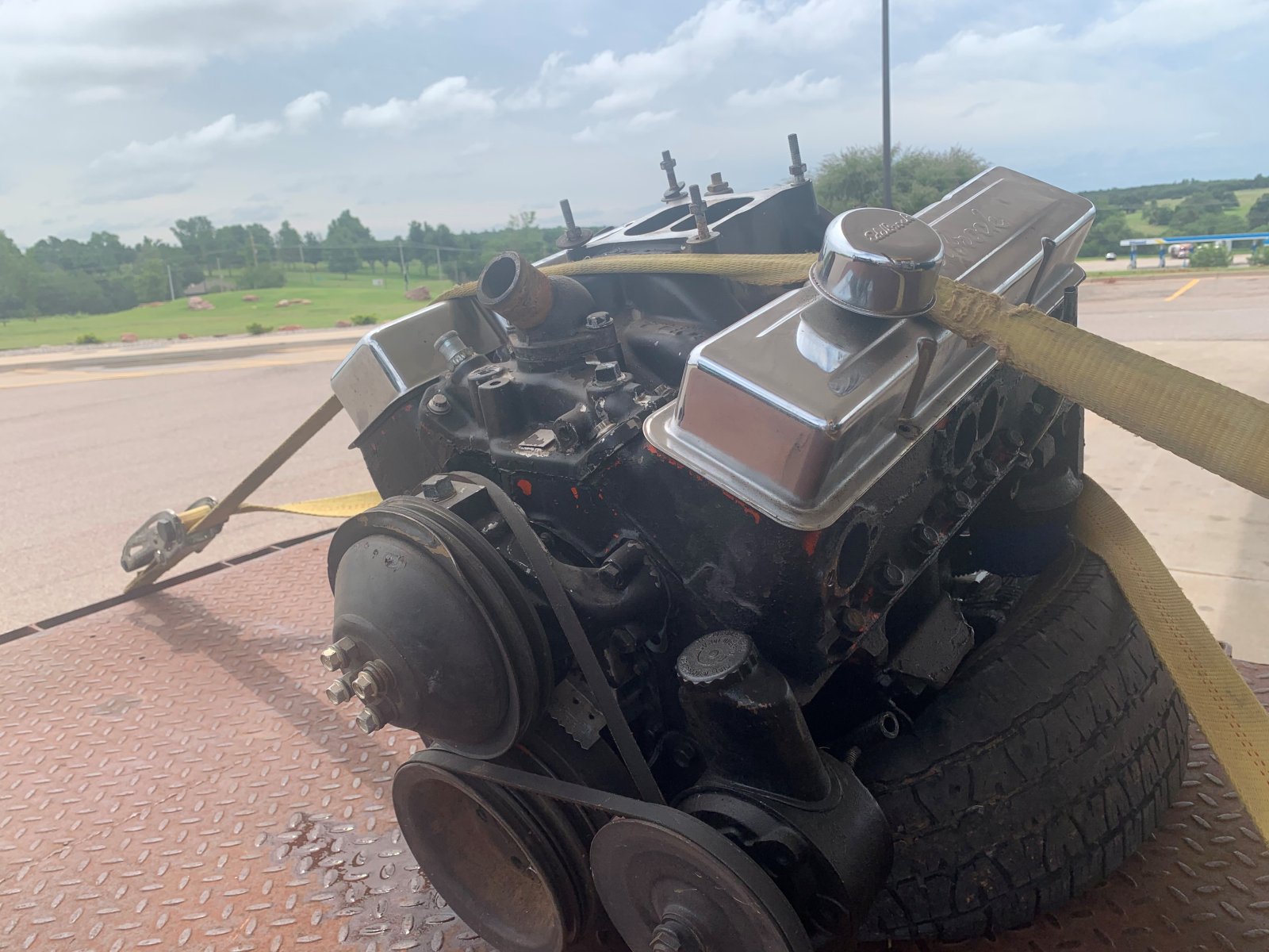

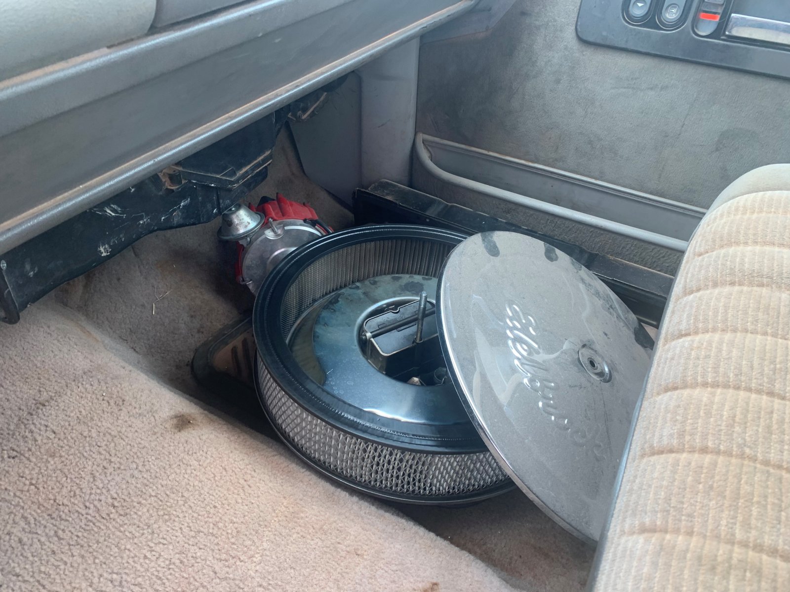

    Speaking of non-Ford stuff... :D I was standing at the counter at my local parts store Saturday getting some parts for a C10 I am working on for a retired guy that I used to work with when I noticed a guy buying parts for his 66 Impala. I knew this guy was putting in one of those late model motors that we don't like here and he had mentioned how he wanted to sell the fast "LT1" that he pulled out to me about a month or so ago. I told him I might be interested but he didn't give me a price at the time. Anyway, I asked about it again Saturday and it seems I stalled long enough to get a good deal. He told me he would take $150 for it so I told him I would come get it. It was literally complete from air cleaner to oil pan and did have 462 heads, a polished Edelbrock intake, an MSD HEI, roller tip rockers, starter, ps pump, Summit carburetor, headers, etc. with it. I decided to decode it and it appears to be a 1970 2-barrel 250 hp block, so I think I got screwed on the deal... :rolleyes:
    This is why I love those late model motors so much. :D Makes for good deals on the older stuff. ;)

    You paid too much....in 1960 dollars..he he he

    It has a smashed pulley so I only would of paid $75

    Yea, I thought of beating him up for that but he threw in the headers. :rolleyes:

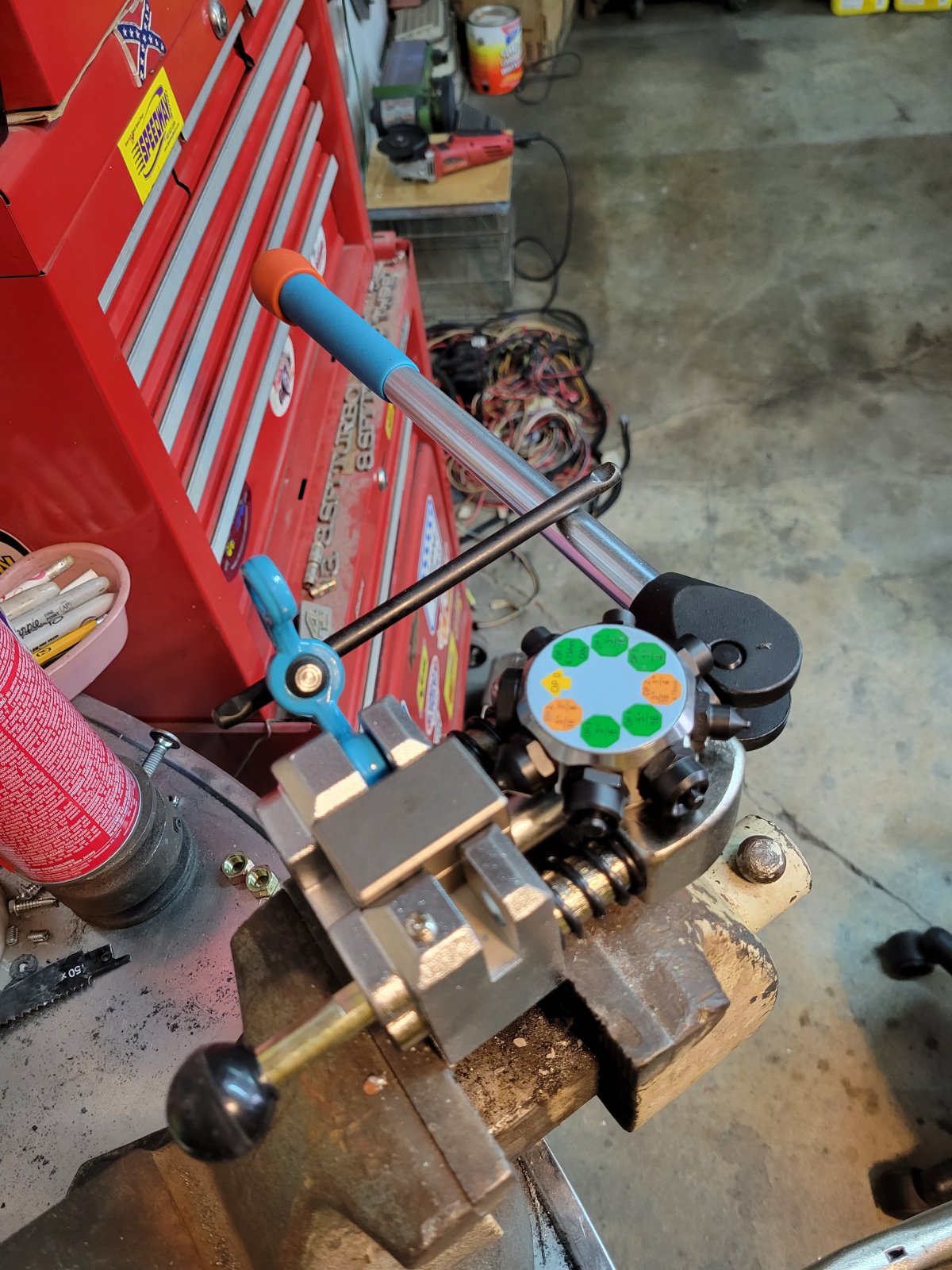

    After the e**on Valdez trans line way to many times I bought a new flaring tool to see if I can damn the leak instead of damning that damn line.
    I'm stepping up to modern times here with this baby
    So I made another lower trans line, hopefully this ******* doesn't leak lol

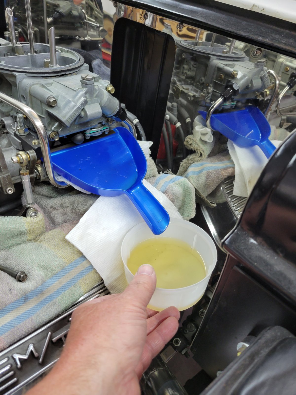

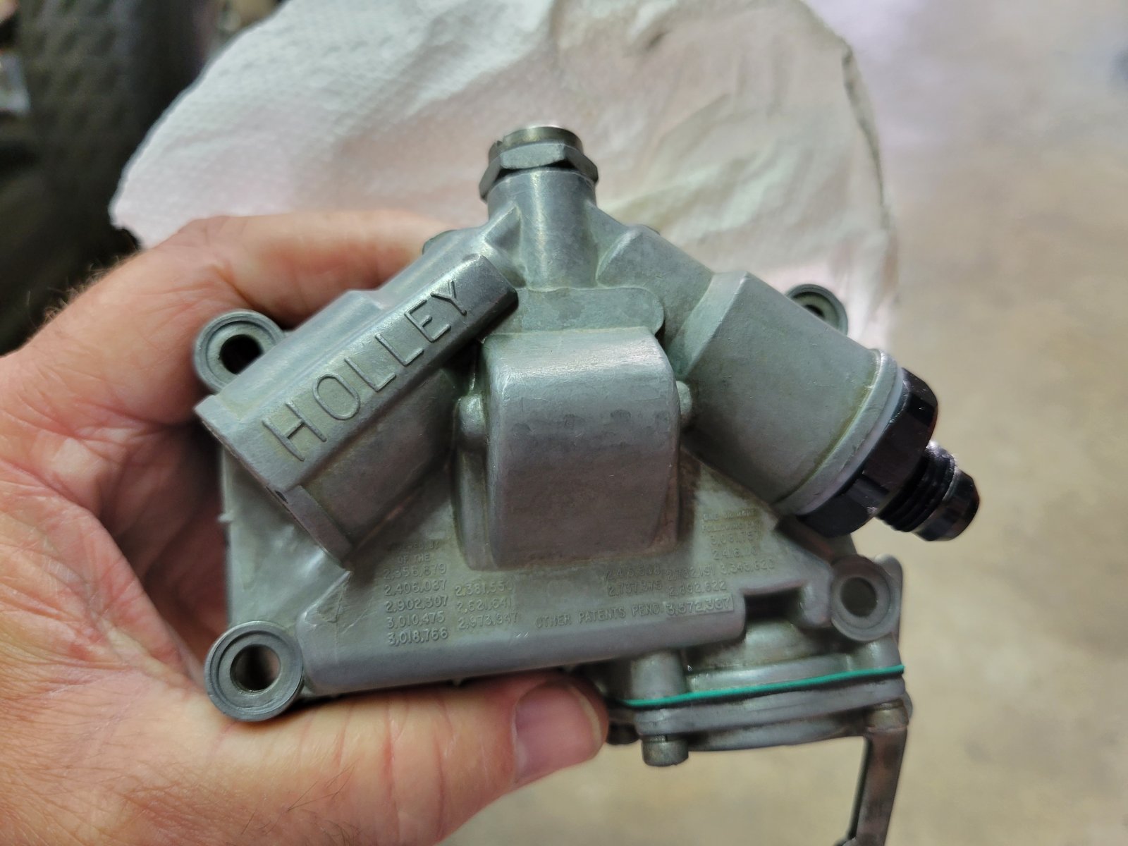

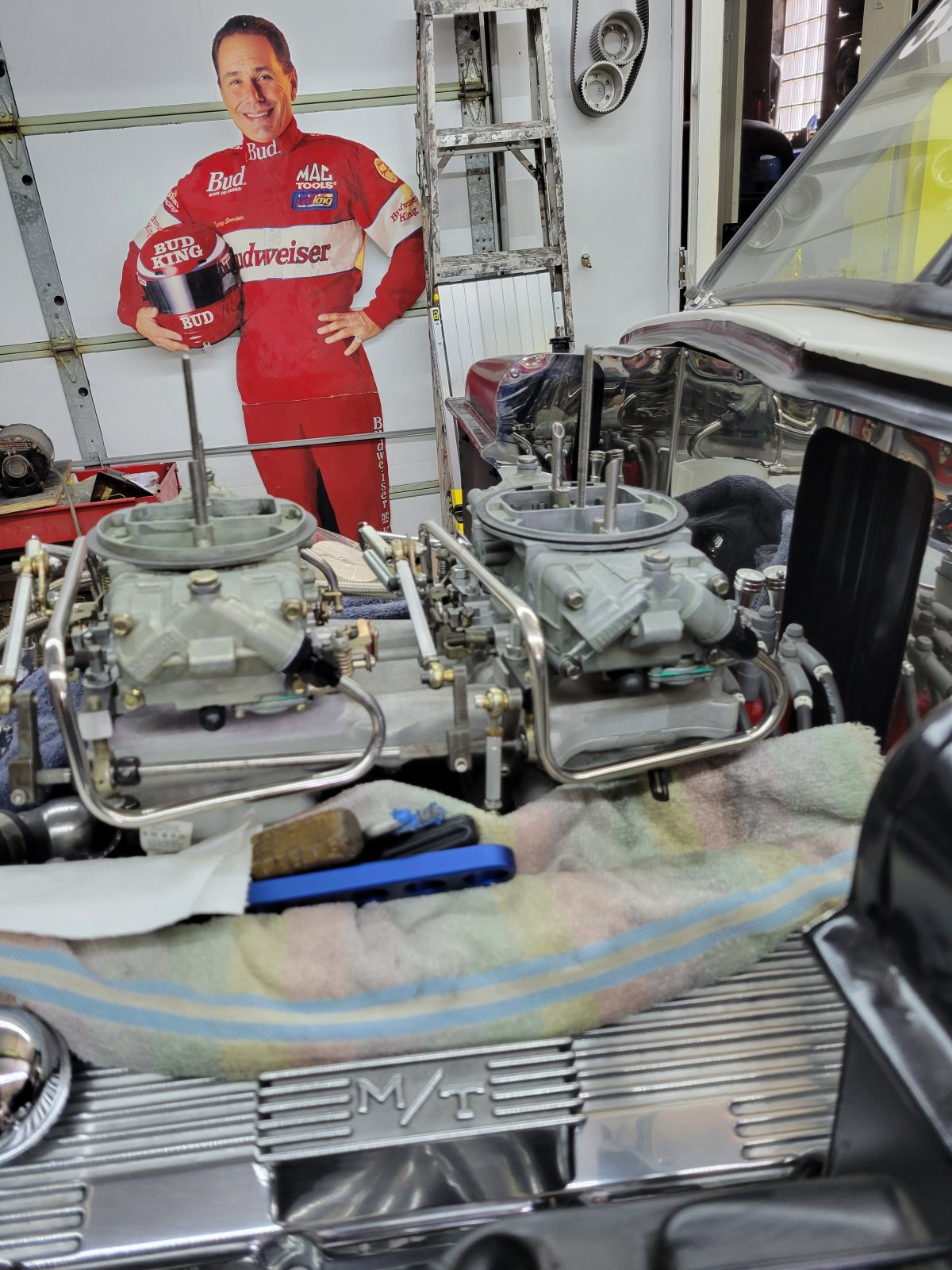

    The mailman shows up at 7 pm with those fiber gaskets for the float bowl screws, so I drained gas and changed the leaky 3, I sure hope all of this cures my fluid exodus.

    I got one of those tools for Christmas , I love it.

    Got the same flaring tool and I love it! Also got the 37* flaring head for it, too. Game on!!! :cool::D

    I have to say, it was much easier
  12. What brand is your flaring tool and where did you get it? That looks great!
  13. lumpy 63
    Joined: Aug 2, 2010
    Posts: 3,607
    lumpy 63
    Several companies sell it. pretty much put their sticker on it:p

    I got deal on one a while back through ePay. Made by K-Tool International. Identical to Eastwood but a better price. Looking forward to using it.

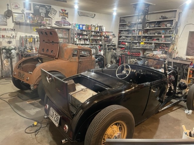

    Today I'm putting the heads on the flathead in my 31 roadster. Tonight I hope to finish wiring the 31 coupe too. fhrdandcp.jpg backhalf.jpg

    My old eyes find that the deep recessed area for the float bowl screw gaskets hides old partial gasket pieces real well, what looks like a black stain could be a piece of old gasket causing a leak :eek:

    I let it run for a few seconds today and the fiber gaskets look to have worked but that damn transmission line is still leaking, now I'm starting to lean towards the radiator being the issue.

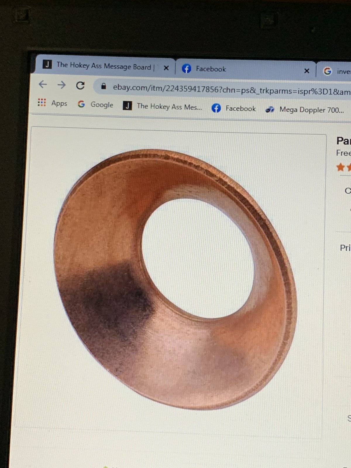

    These came in handy when I had trans line like yours give me grief. 9D2D1234-8160-49AB-9FA0-6E6C08276A4A.jpeg

    What is it ?

    it looks like a copper washer to put in a flare fitting, to help it seal.

    45* beveled copper sealing washer as Jim mentioned.

    I need a box of those... look like a part everyone should have, especially with more imported parts these days.
