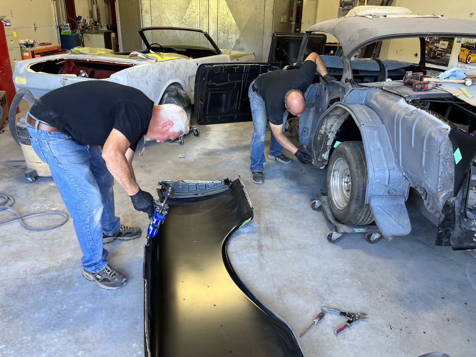

    Watched a couple friends use 3M panel bonding adhesive to put a new rear fender on Chevy. Took 45 minutes including grinding the e-coat off the mating surfaces. They had it lined up beforehand. Last photo shows the squeeze out.
    I’m sure there are down sides to this method, but it seems pretty slick.

    Thats amazing....like bondo post lead work...guess the future is here now..

    I had a good friend put a partial quarter on a 69 Camaro with that method back when the factory started doing that. It worked well right up until it had issues at the joint a few months later. However, a complete quarter where that seem gets covered by trim on that 57 will likely be good. I’m still of the opinion I would rather weld stuff on, but I’m sure I’m also just stubborn.

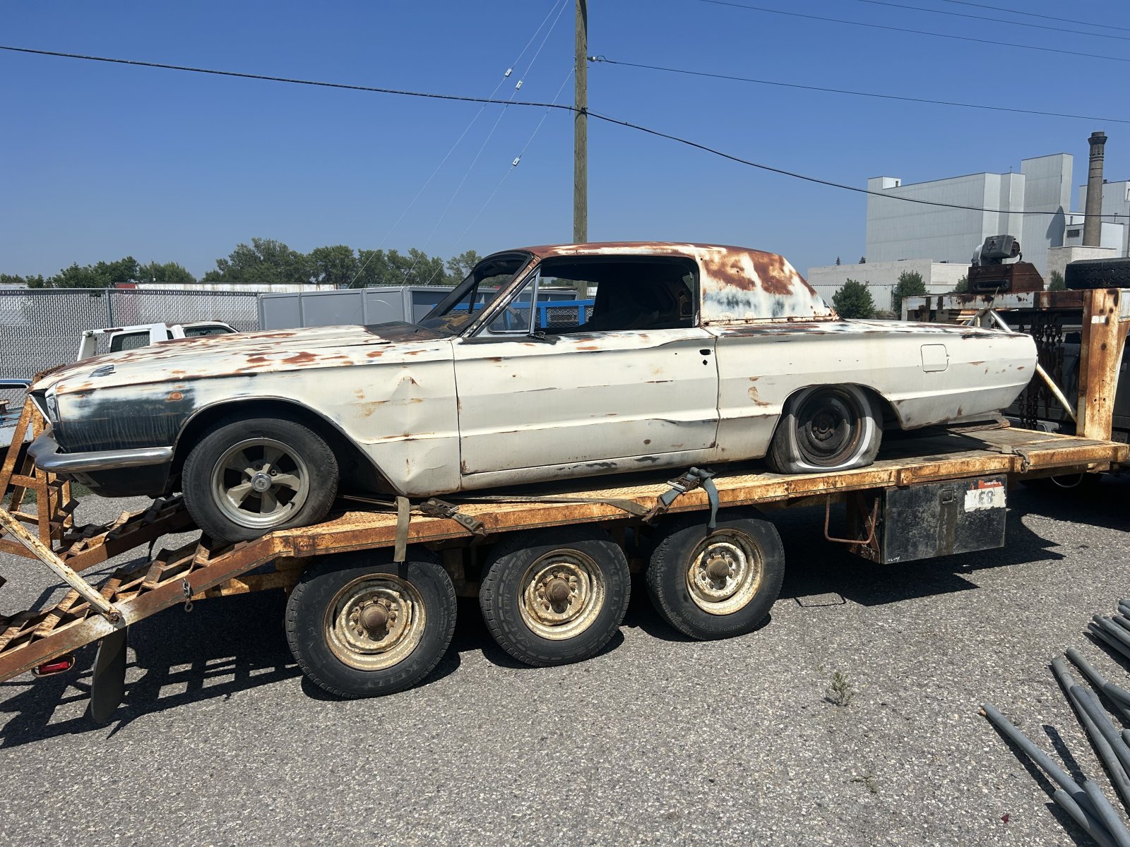

    considerably more solid car to build, headed back north, only six or seven hours to go!

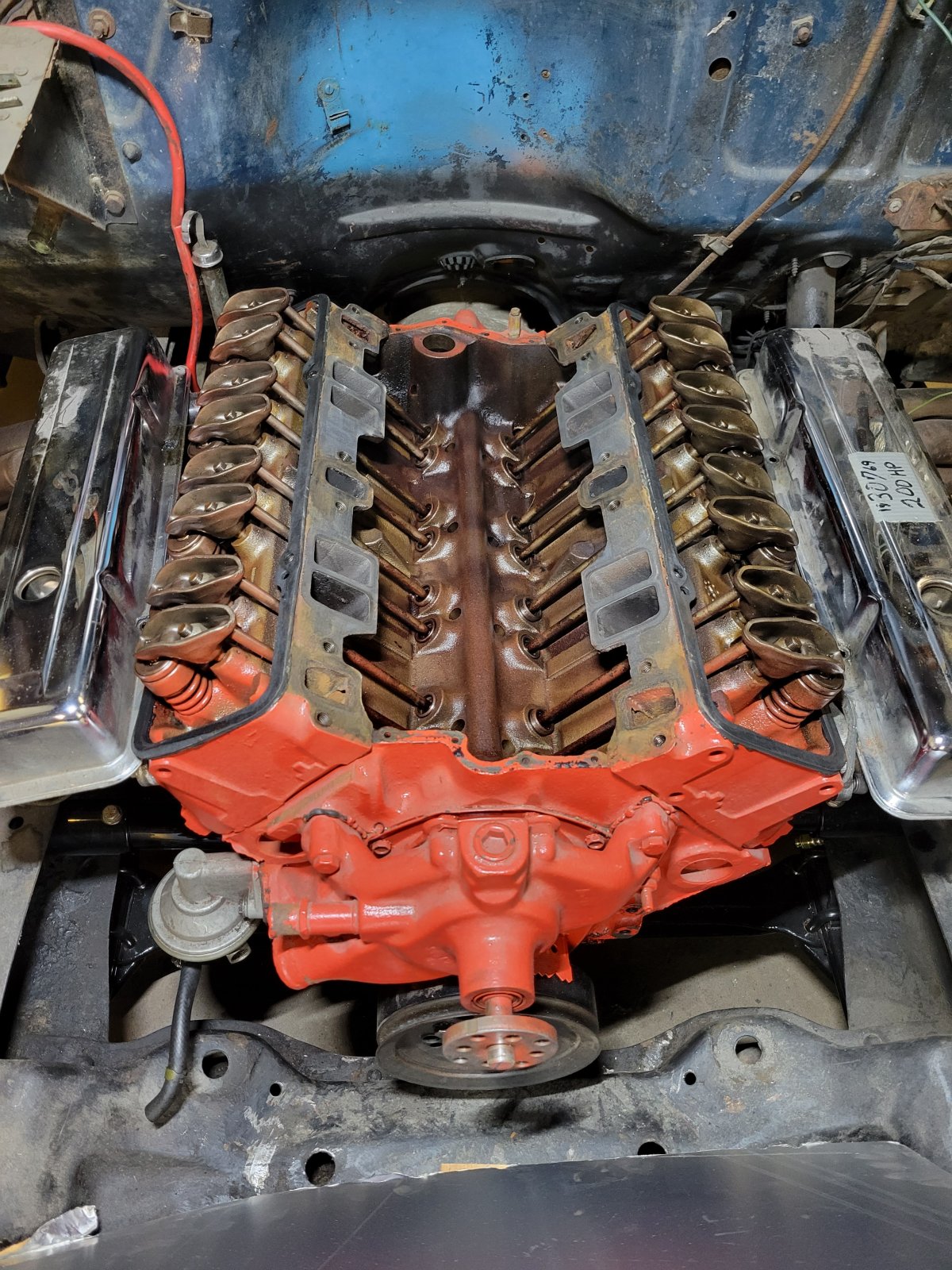

    Got the 350 in the Desoto that was pulled fron a 52,000 mile Camaro that was rear ended 22 year ago running ...I misted the intake heavily with penetrating industrial lube first... fired up on the first crank....

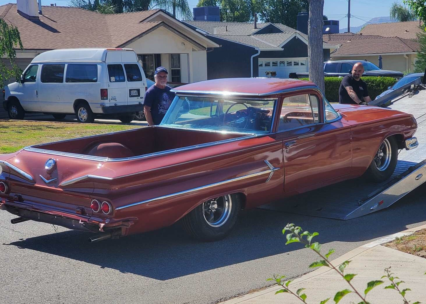

    Just got my '60 back from paint. Now it's time to re***emble and take care of some minor mechanical stuff, then drive it!

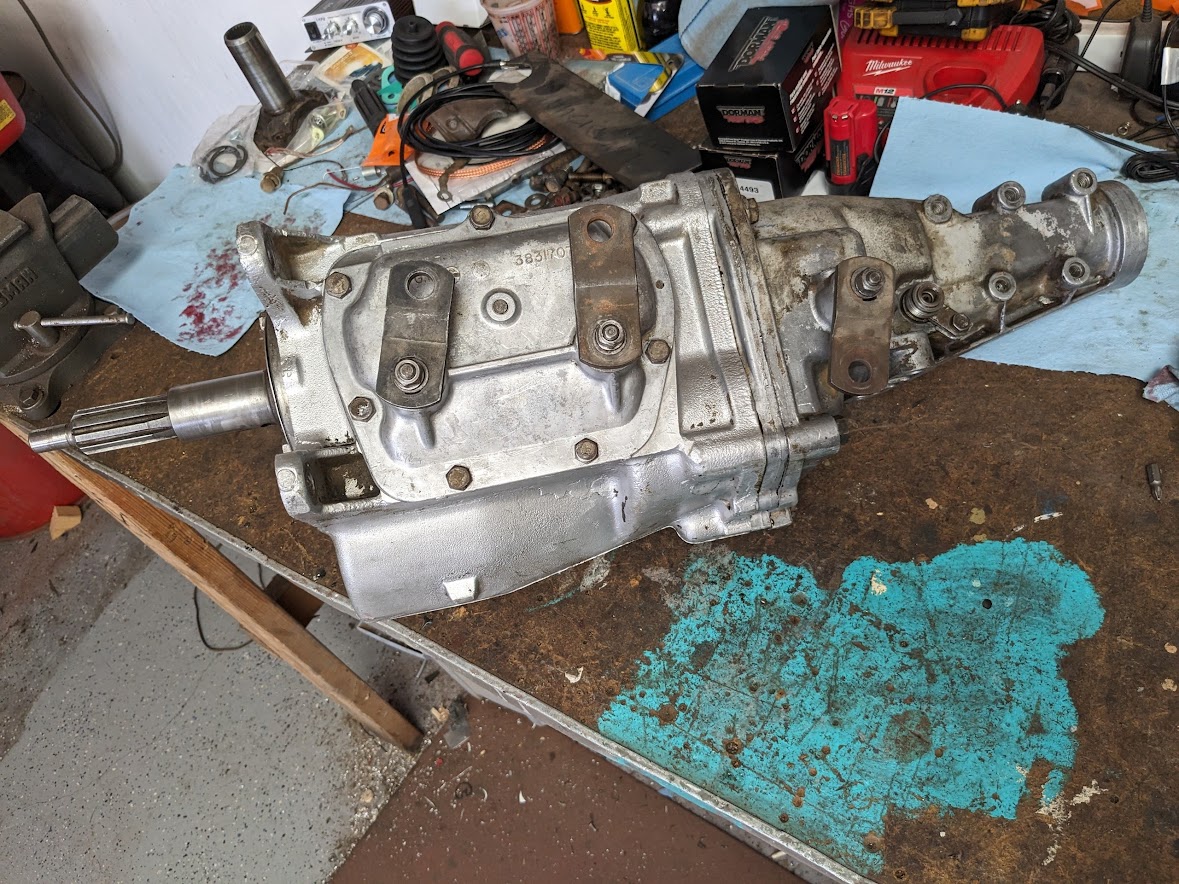

    I got a new rear bearing, and put the Muncie for the Corvette back together.
    I also pulled the rear axles, and removed the wheel bearings, one came apart from the force of pressing it off...has a couple big pitted areas, I guess that's more likely to blame for the "wup wup" noise than the strange bearing in the transmission.
