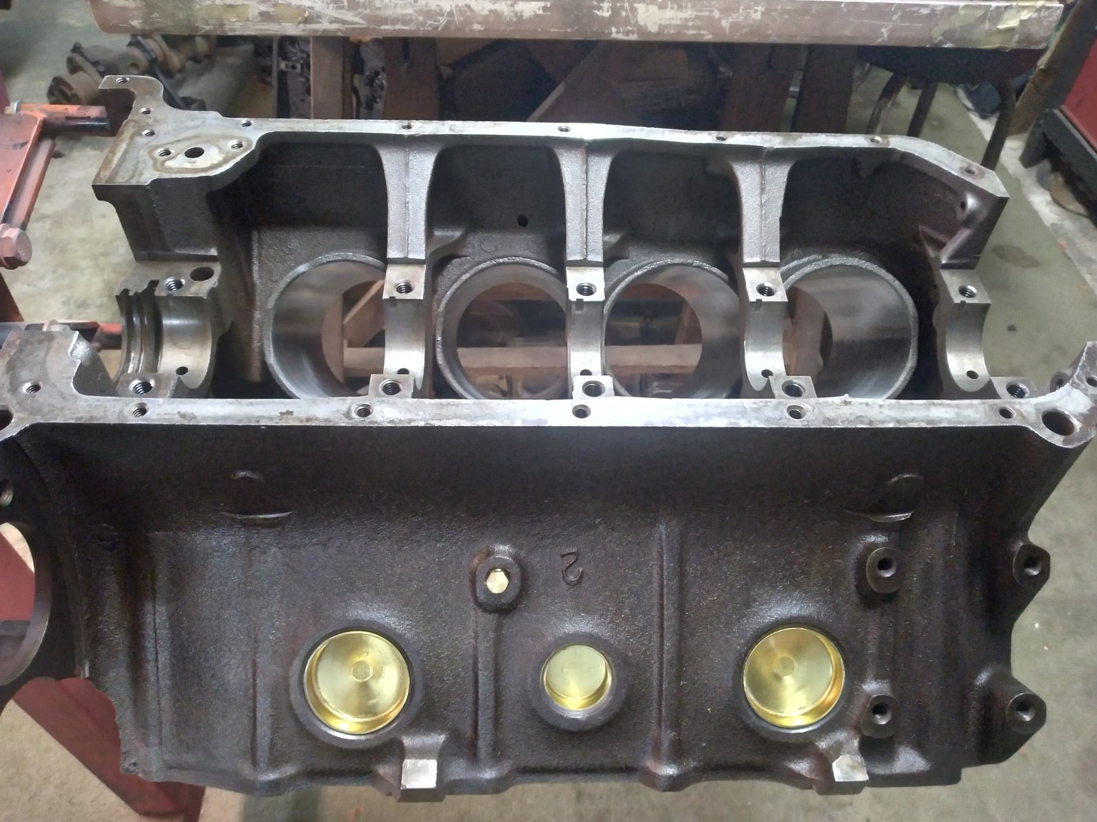

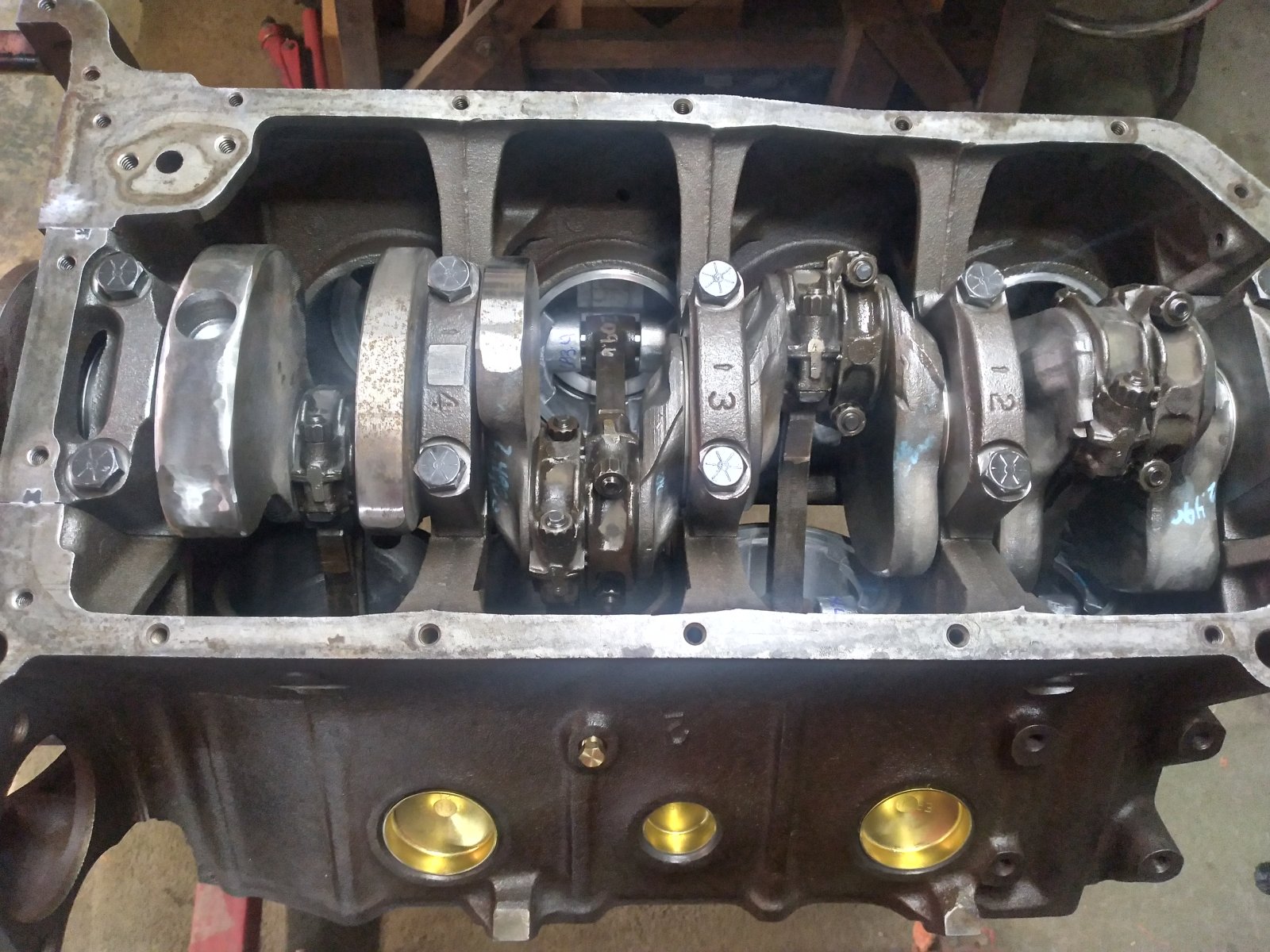

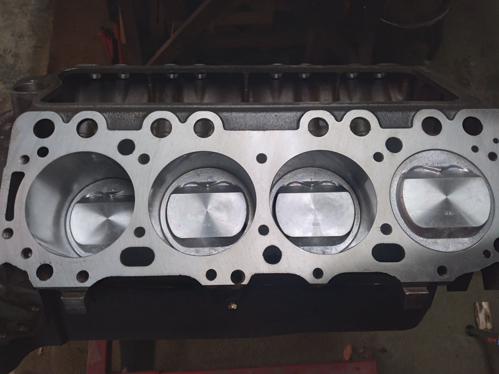

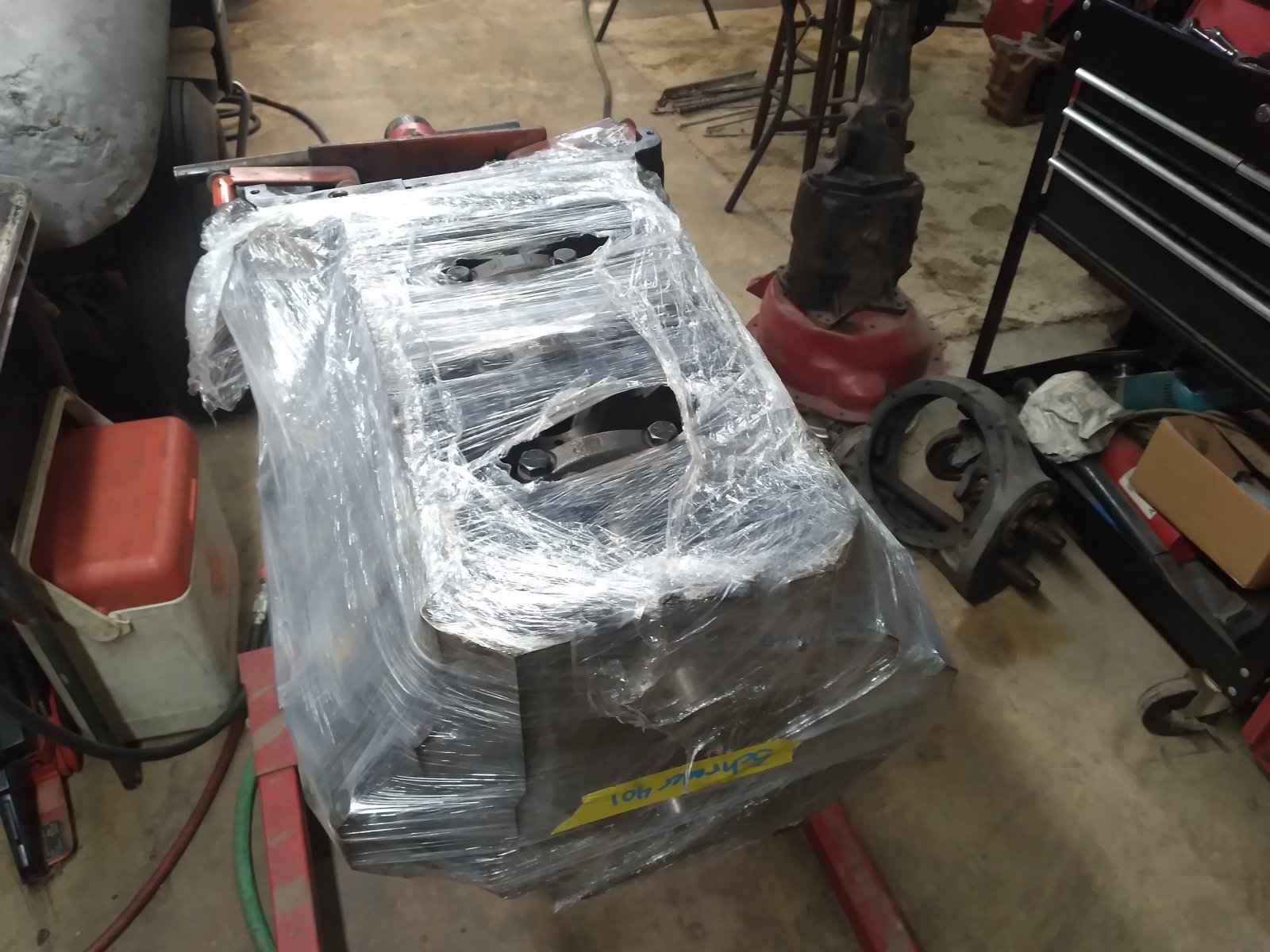

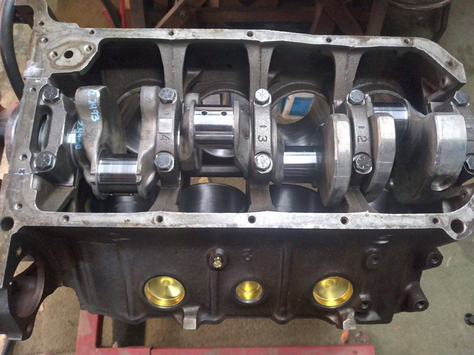

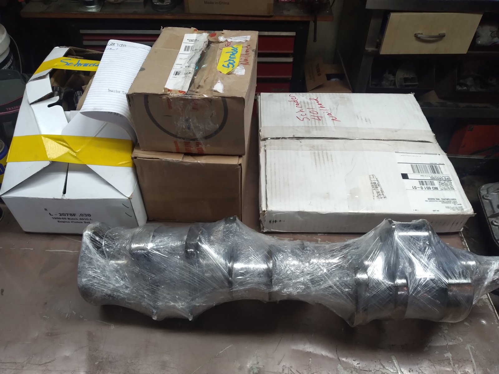

    Getting this nailhead ***embly together.

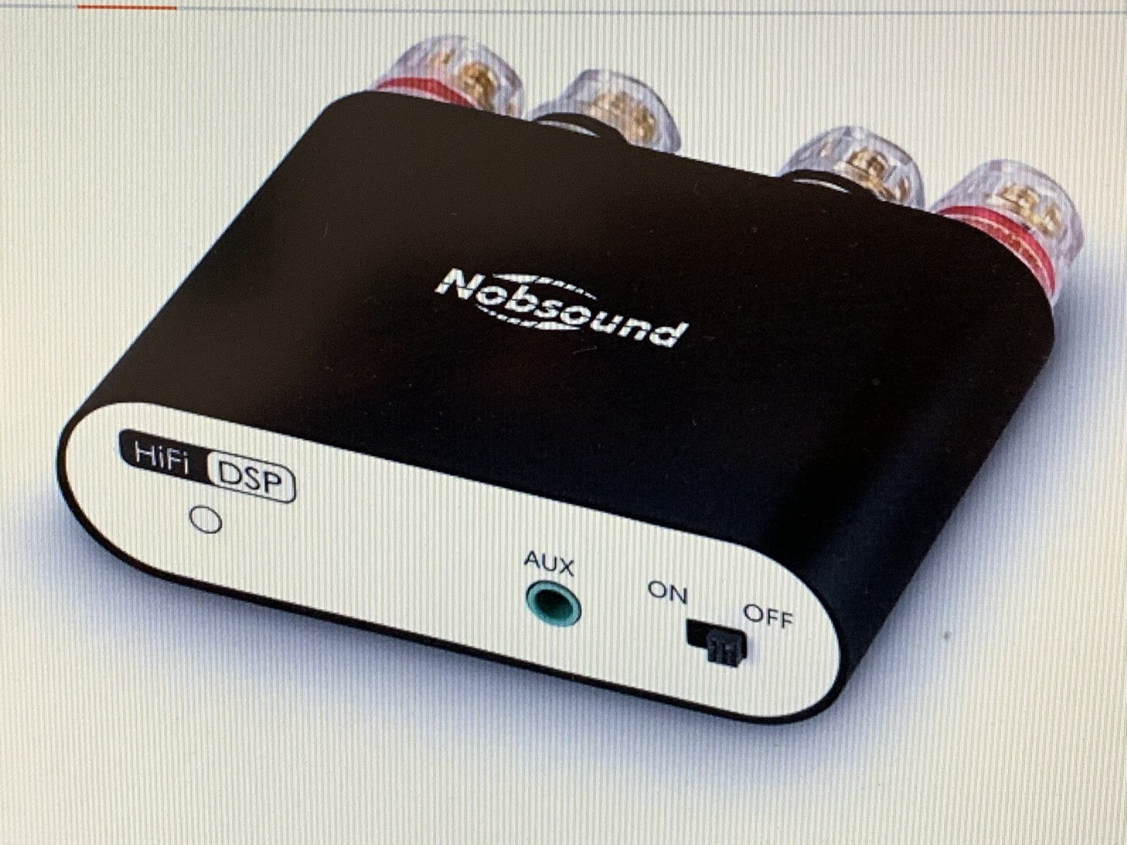

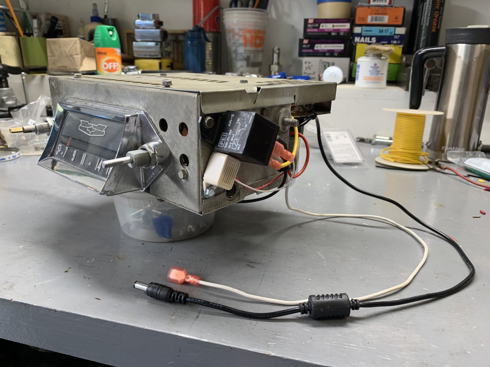

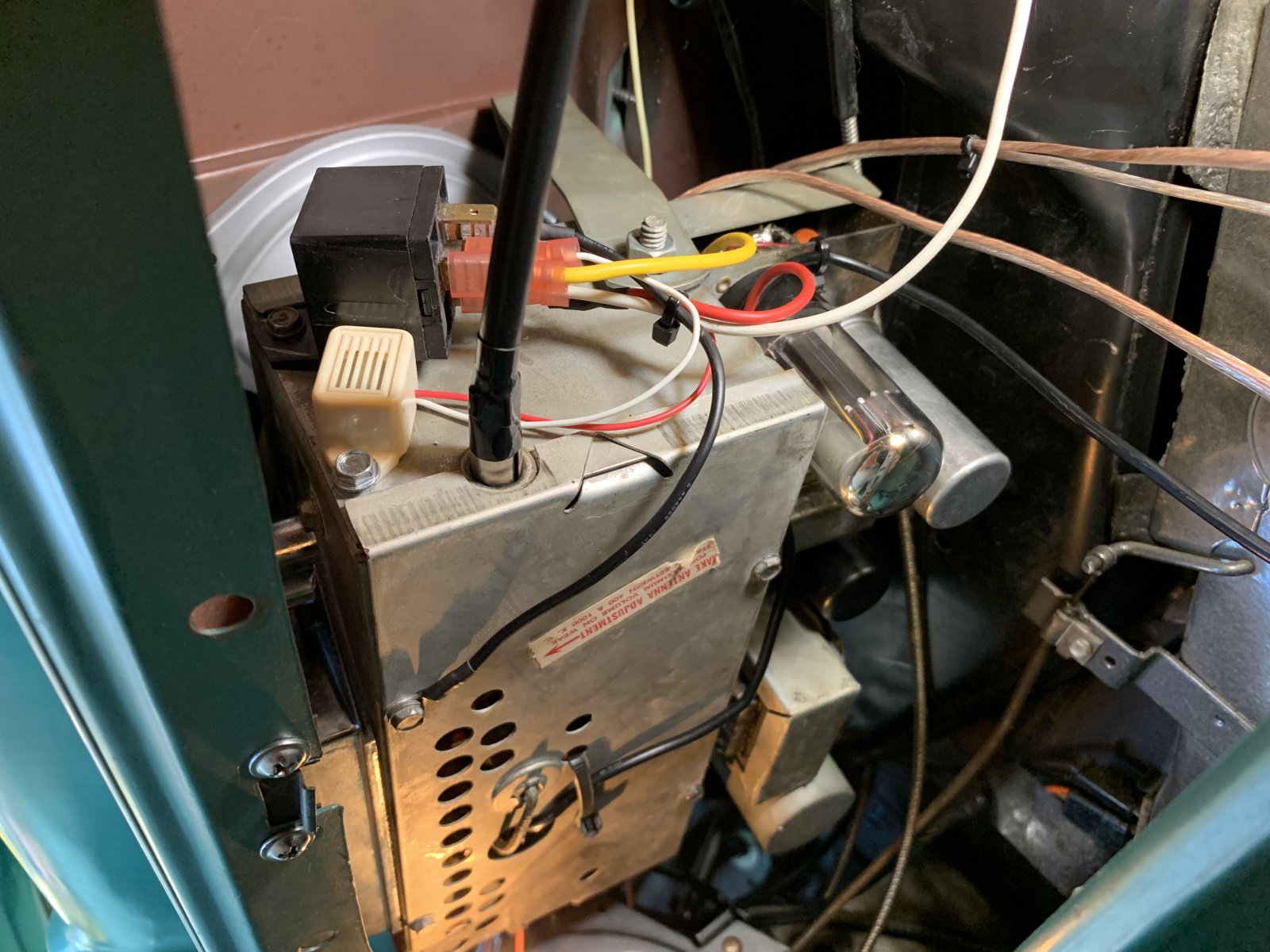

    Here’s one I did. Byp***ed the radio switch to turn blue tooth amp on and off. I like full time 12v so I added a buzzer in case amp accidentally gets left on. 1F2C7191-8E7C-4B78-9883-CF28CC30D8AD.jpeg 02DD0173-635B-4385-A8D9-8A03341D15A2.jpeg
    Blk cord goes to amp Wht wire taps into door jamb switch.

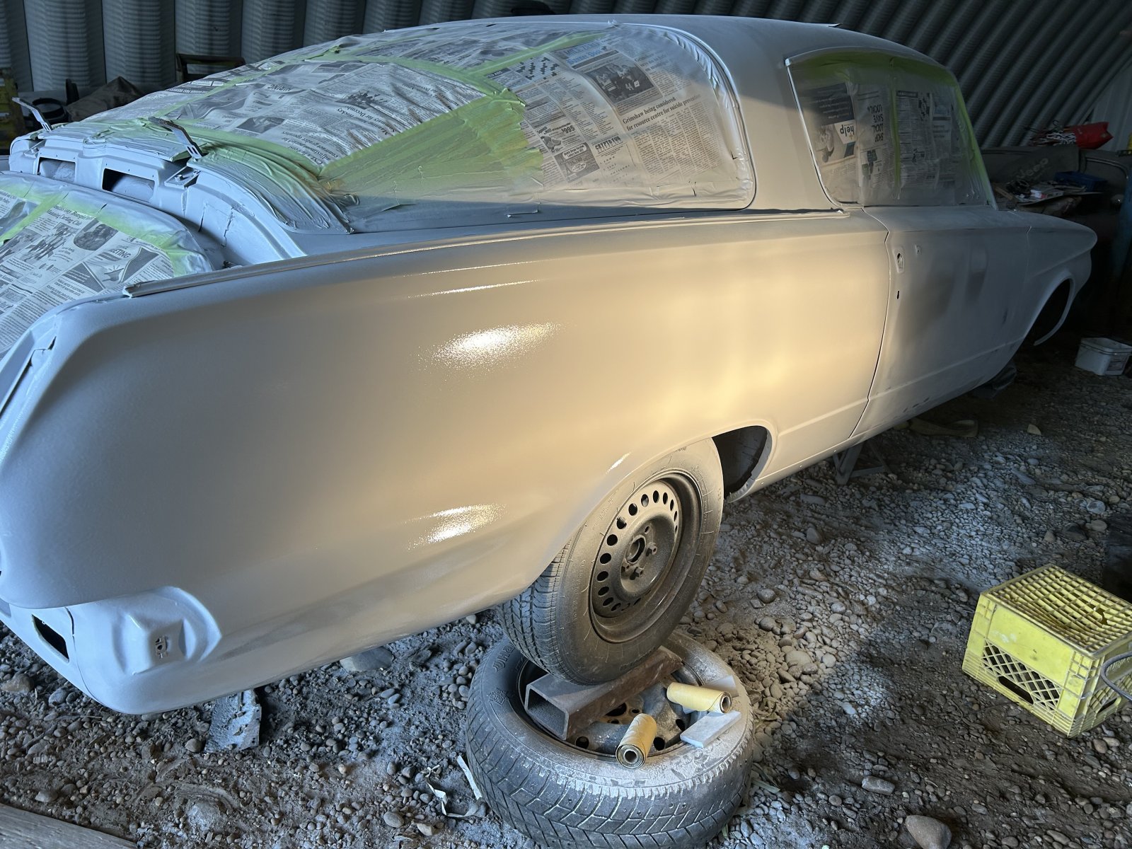

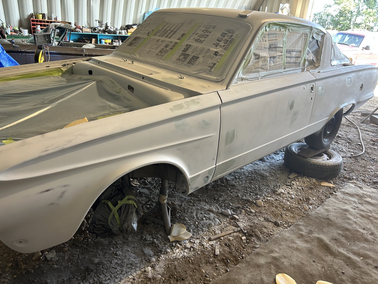

    re-primed the quarter that required a fair amount of “touching up”. Then put some sealer on the door jambs.
  26. Bandit Billy
    Joined: Sep 16, 2014
    Posts: 17,190
    Bandit Billy
    I am glad the ole b'cuda is sitting on tires as well as jack stands. I watched my old t-turd roll right off the stands on a gravel surface in my misspent youth. Anxiously watching for the finished pics.

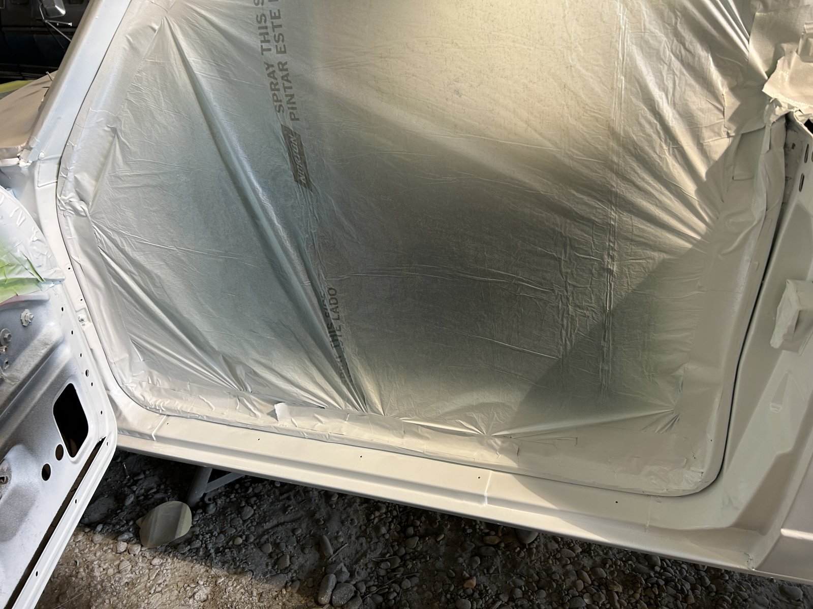

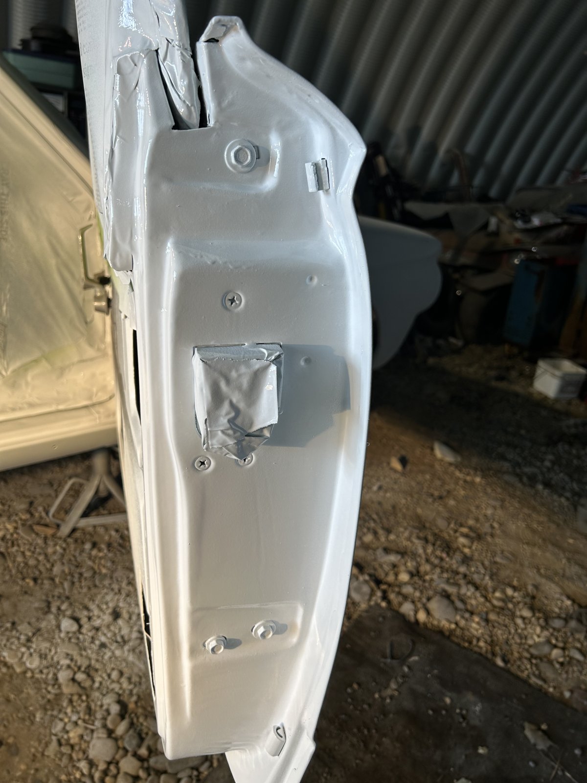

    door jambs are white, I have some non car related things to look after the next few days but hope to have paint on it next week.
