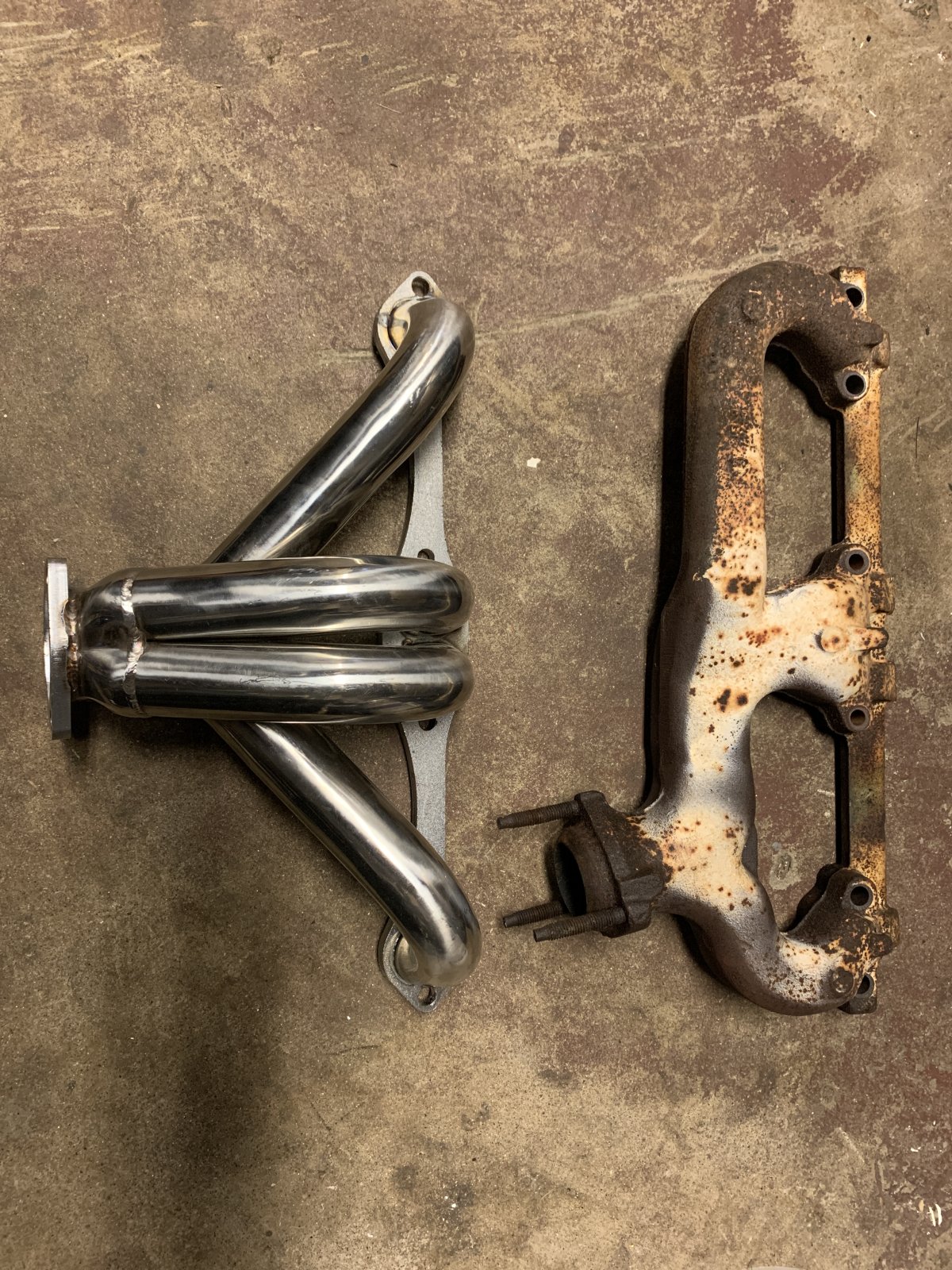

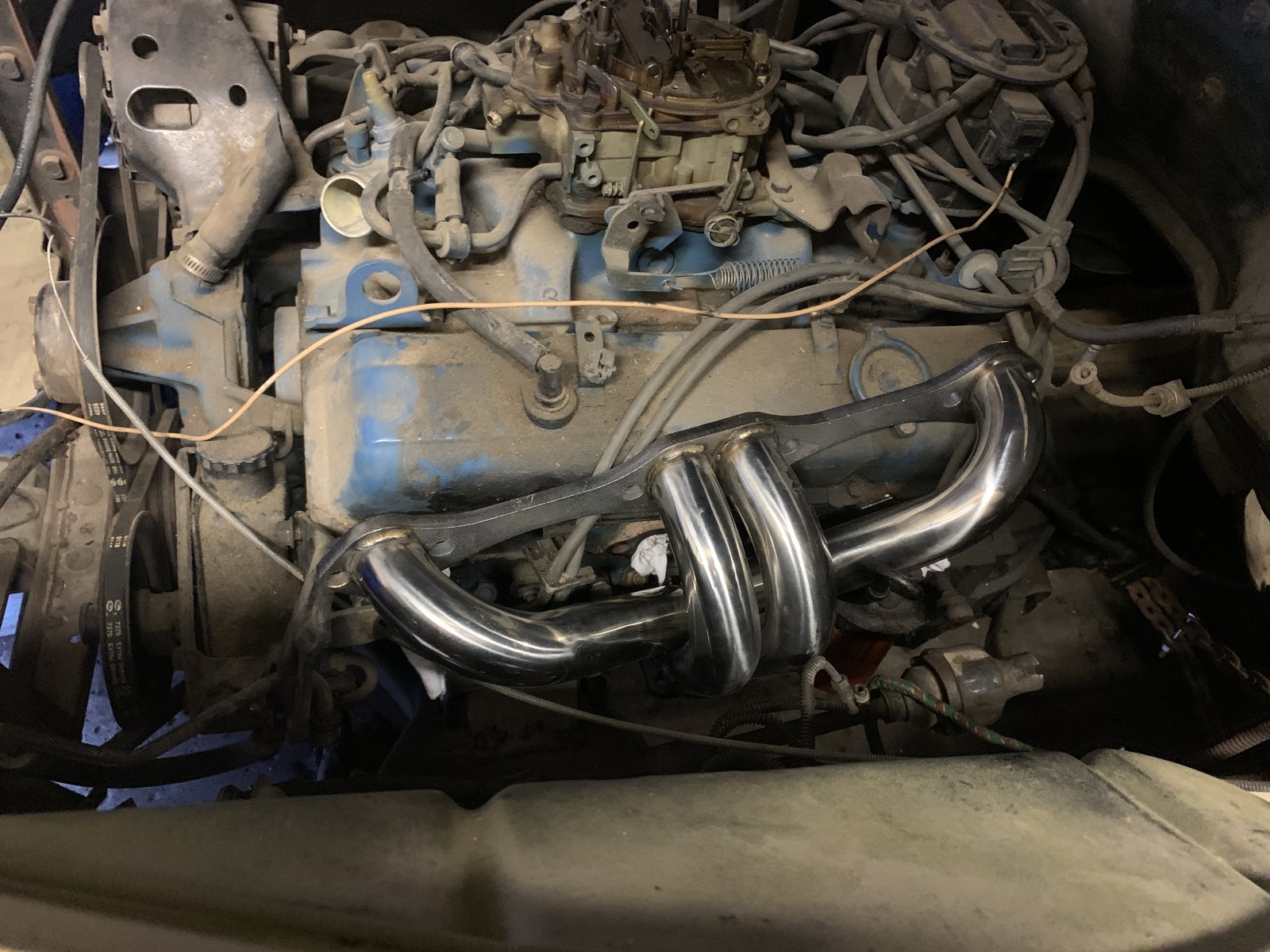

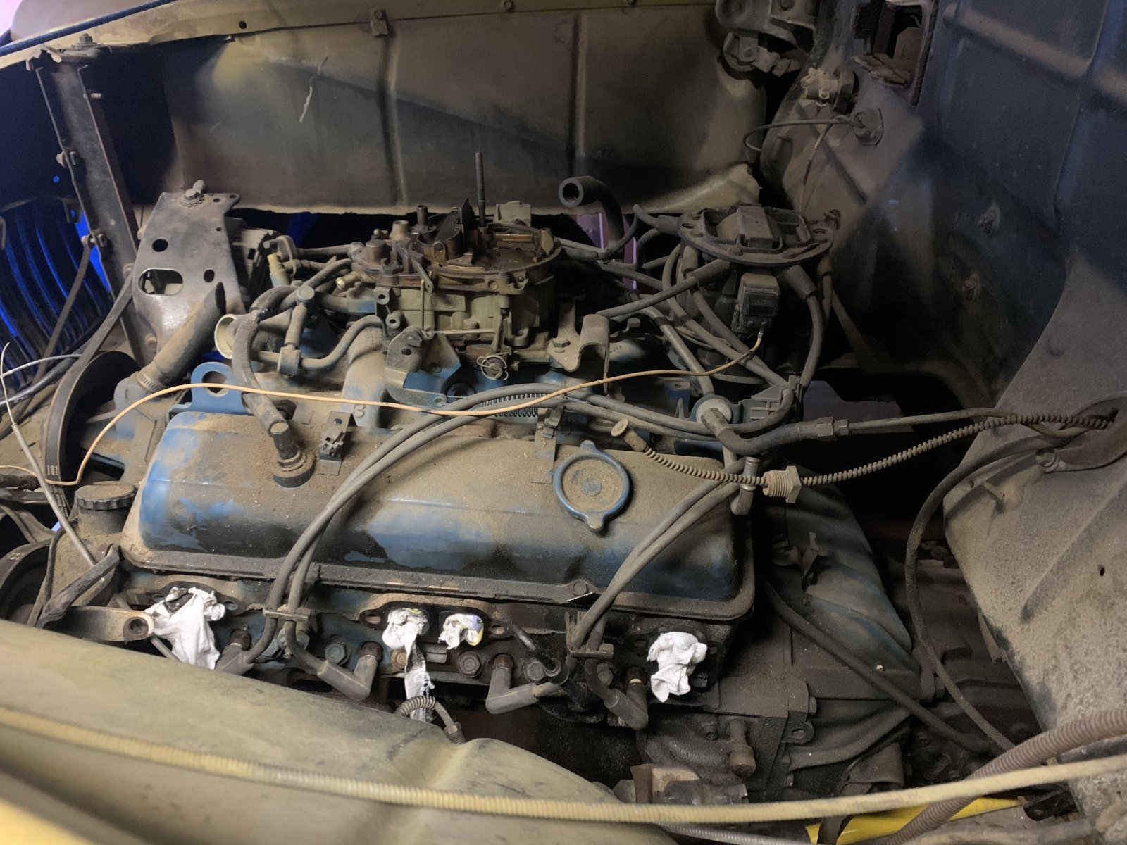

    Removed bulky cast iron exhaust manifolds .. Pic shows amount of setback im going for .. 6 inches .. Block huggers will be utilized.Original 52, 000 mile motor exhaust studs are perfect.. C2AF43BA-53EF-4E86-AA9D-DAE723A2BC1A.jpeg image.jpg image.jpg

    They look good. Even better if it makes people notice you're slowing down.

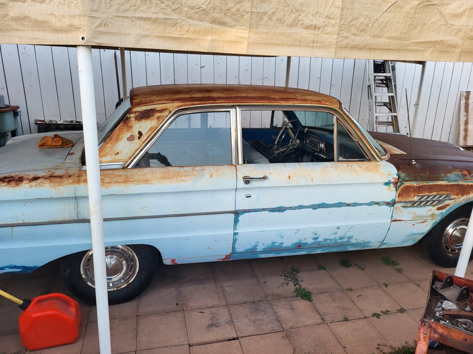

    Started building another straight axle car yesterday which surprises me because I had pretty much got it out of my system a few years ago by building both a Willys and a 55 chevy g***er. But a young coworker really expressed interest in building one. He's a great welder and fabricator but he's only built vintage Harleys to date. Last week he picked a really solid 62 Falcon, so here we go..... 20230729_192533.jpg

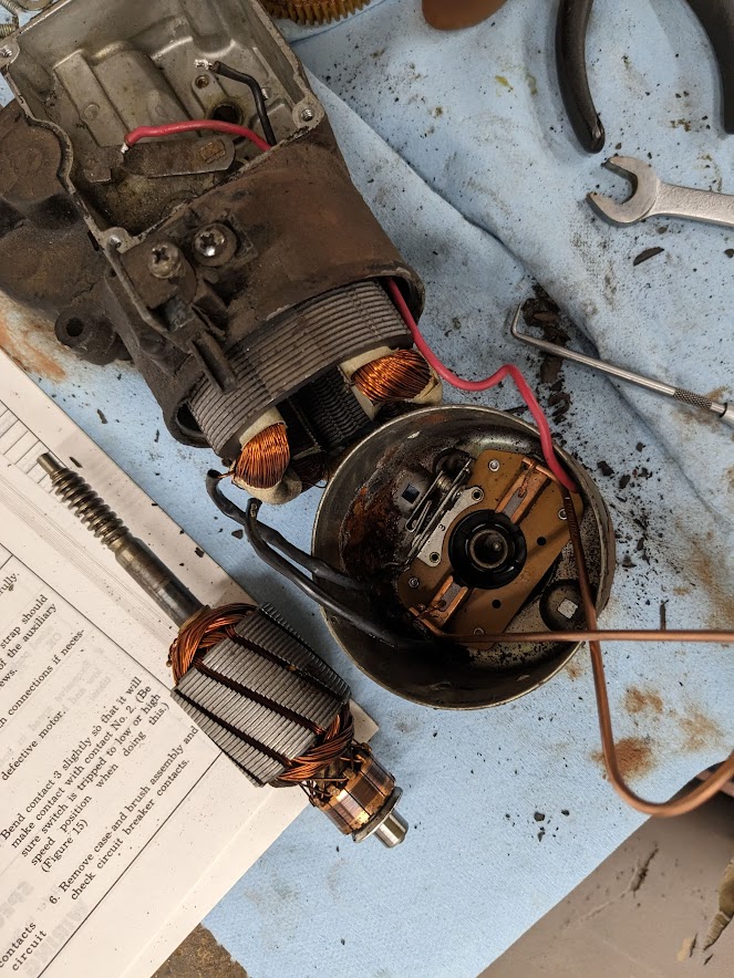

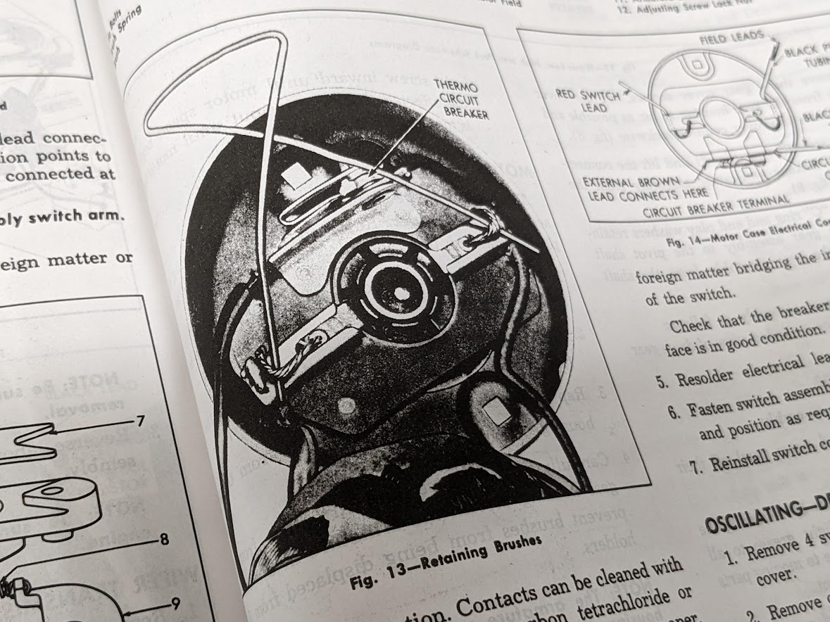

    Wiper motor. This was last night...I got it put back together, it mostly works, I still need to get the switch slider freed up more.
    I got to make a special too. What fun! The PO cut off the power wire, right next to the motor, so I got to install a new wire.

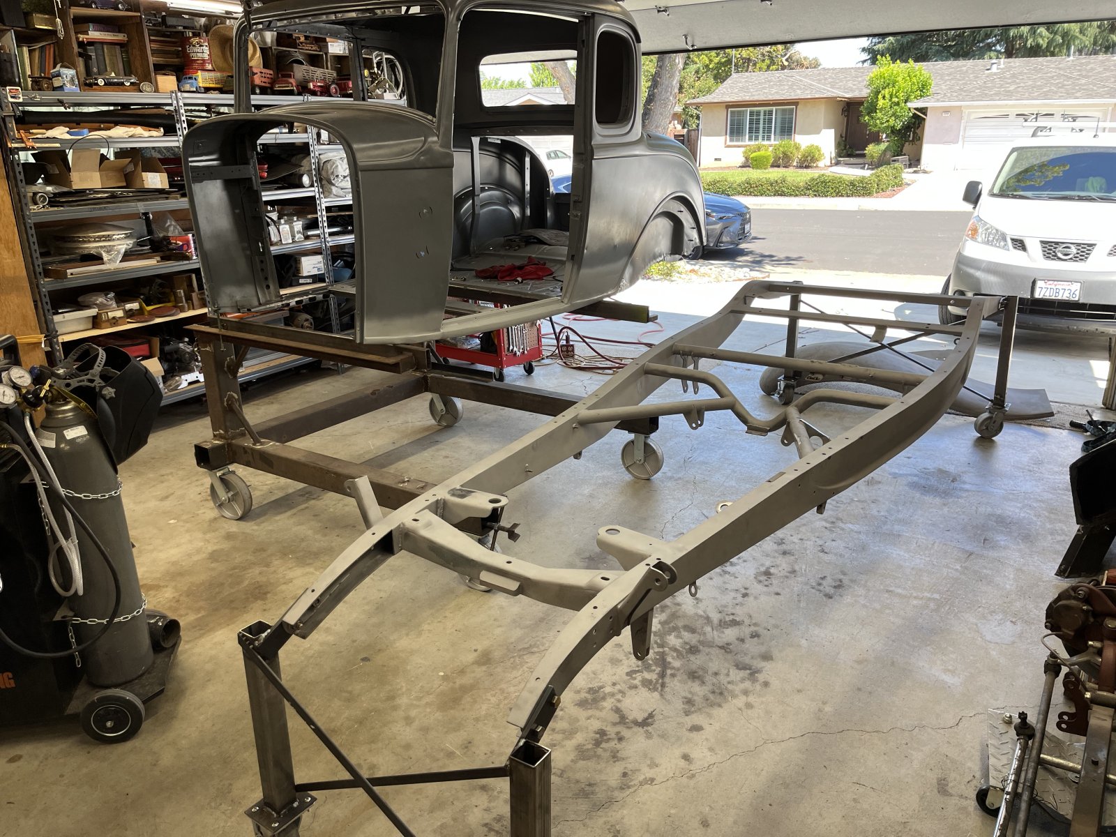

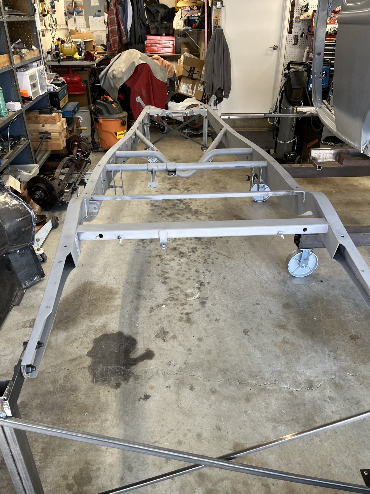

    So that’s the little secret. Takes me up to an hour with multiple tries with fat fingers, thumbs and hooked tools plus some words of anger before I get one closed. Then cross my fingers it works vs pinching a wire causing a short.

    Don't forget putting it together finally and realizing you've got it clocked 180° out...

    A sharpie is your friend. ;) But I’d like to know how you got a wiper motor of the type mention clocked 180 off?

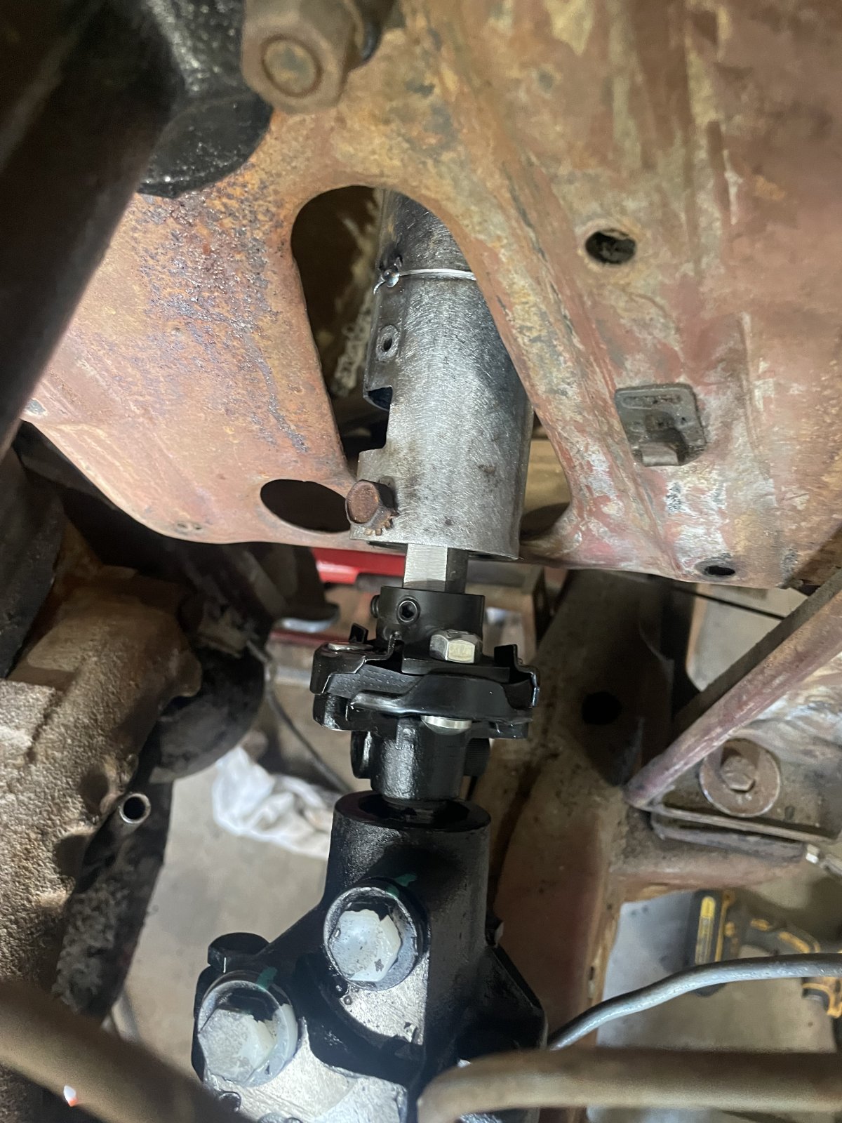

    I've been doing all the last minute checks on the 55 for the trip to the Tri Fives next week.
    Got the timing set, spare aired up, junk in the trunk cleaned out. All that little **** that has to be done. It went from a ****py driving car to a pleasure to drive after I rebuilt the steering box last month. I haven't pulled the camper with it since, but I do believe it will be just fine. Now it makes me want to fix some leaks and go ahead and change the rear end next. I need a road gear for the old car.

    Motors in general...
    Managed it with a starter motor once.

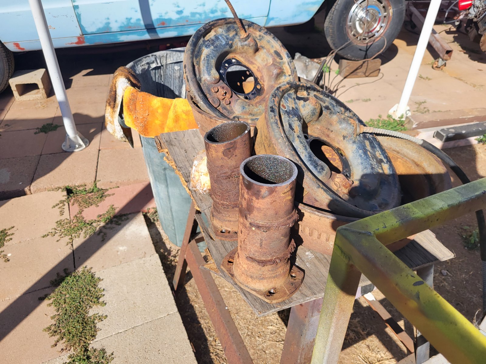

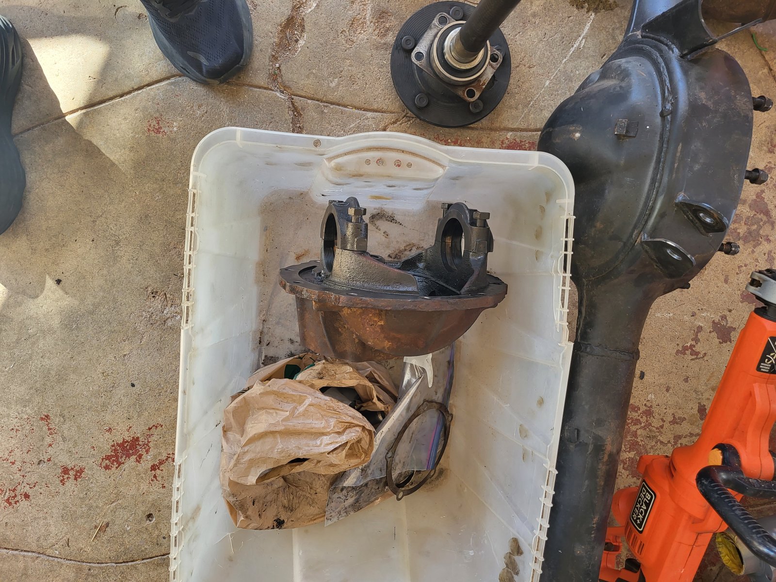

    Came home after work and sawed the new style big ford ends off the galaxy housing so I can clean em up and put em in the lathe to true and chamfer them. I will put these on the F100 housing once its narrowed. Also took apart the 3.70 diff . The gears look really good and we will add a posi and put it back together. 20230804_165711.jpg 20230804_165656.jpg

    Do you check the backlash before to take it apart? I do if I plan to reuse a gear set then set them up the same as long as pinion depth isn't changed.

    I did not, The guy I bought it from had already pulled the pinion support out but he saved the shim. he also pulled the yoke off to install a new seal. It all looks really good and I will set it up and check it.
