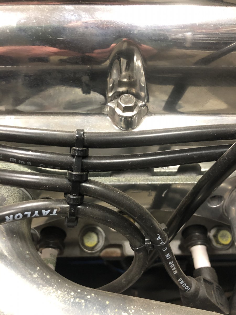

    I cringe when I see that Taylor name, I worked at that place for a short spell outside of KC. when I was going to tech school. Finally got a job at the Midas shop at 30th and Troost :eek:

    Braided steel hose in black? Never saw that.
  3. saltflats
    Joined: Aug 14, 2007
    Posts: 14,130
    saltflats
    from Missouri
    It has a fabric cover over the stainless braid. I like the look.

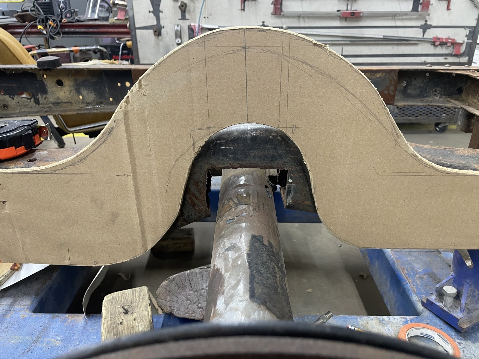

  4. 57 Chevy
    More realistic C-notch this time

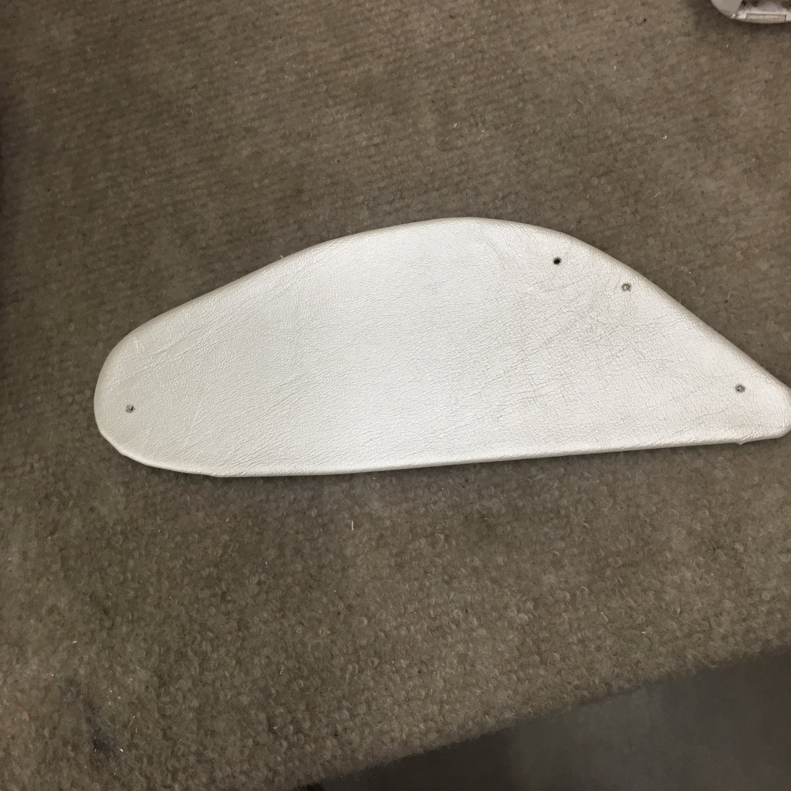

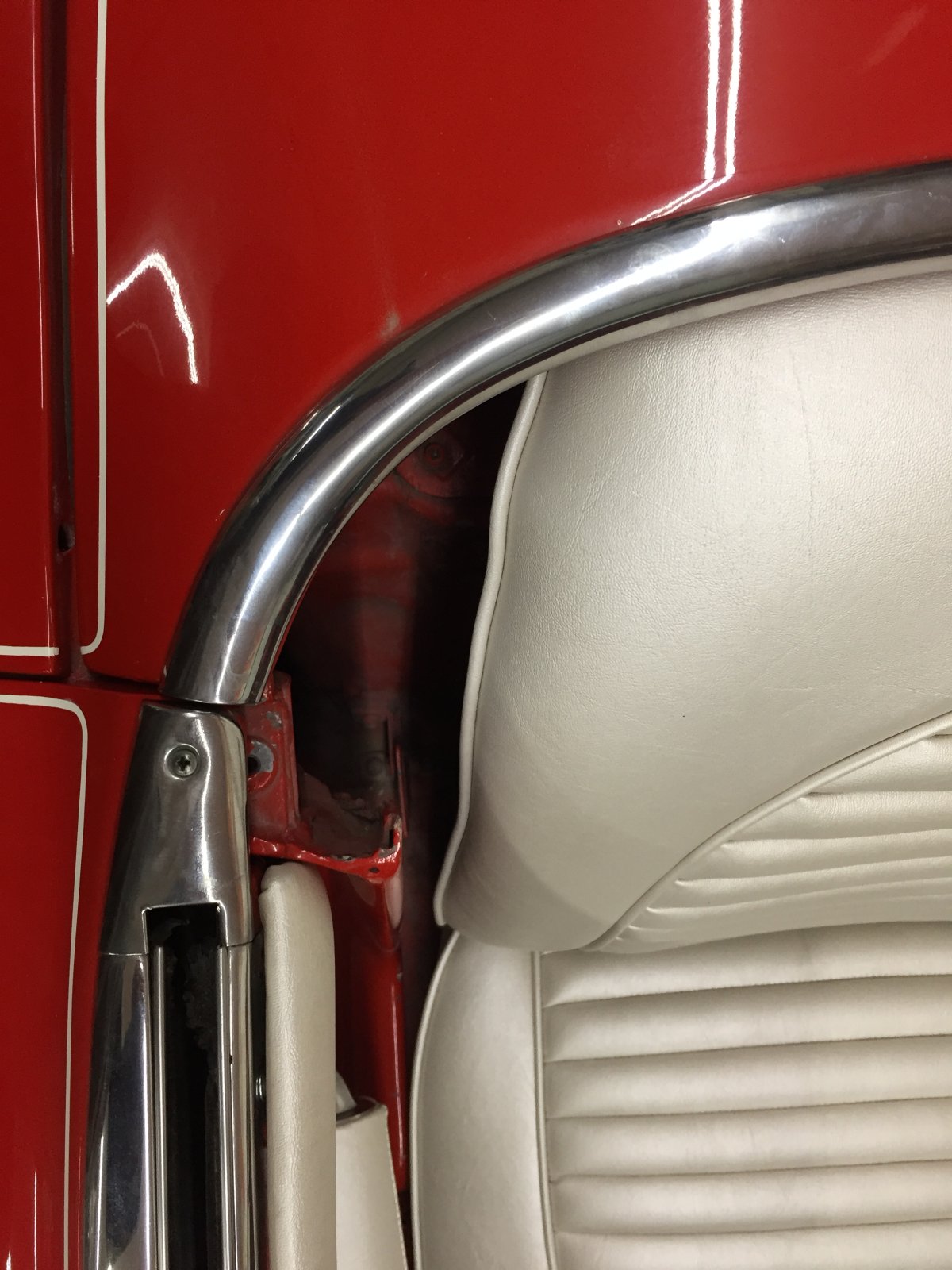

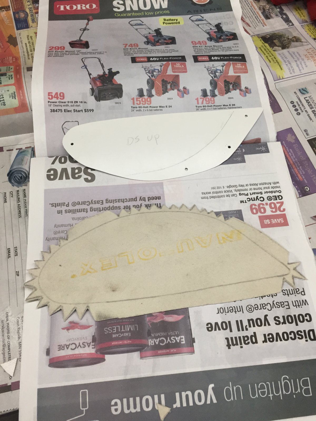

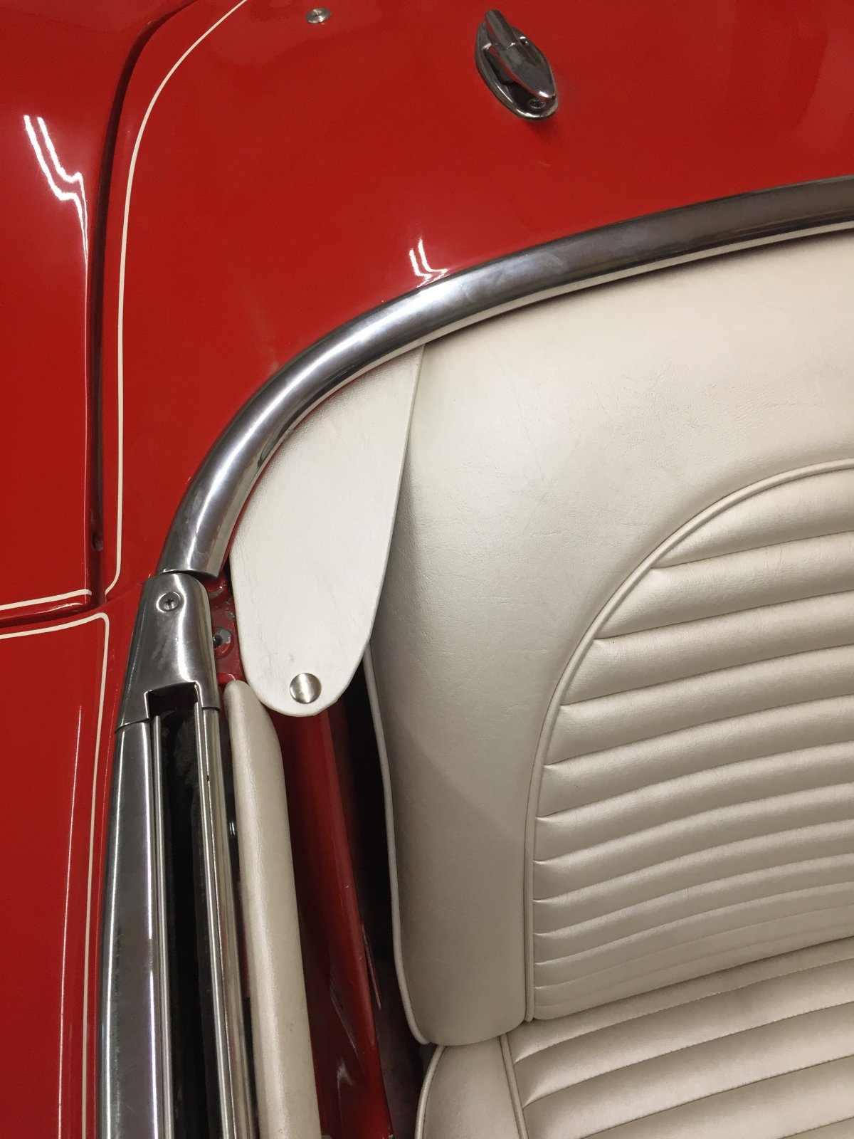

    Now that the top is off my corvette this gap was real obvious
    Pretty ugly back there. I knew there was a small upholstery panel supposed to be there. I had some .025 polycarbonate and pearl white vinyl. So a little spray glue and a snap for the front. The back is riveted to the bottom of the hatch for the rag top
    A5C8435B-15F5-409B-970E-6B6B79BB4D91.jpeg AAE4A62C-F45C-434F-9EB8-9931DBBA8599.jpeg

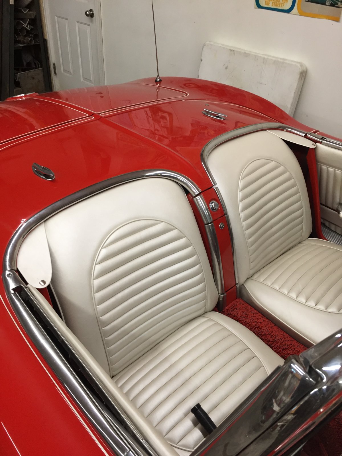

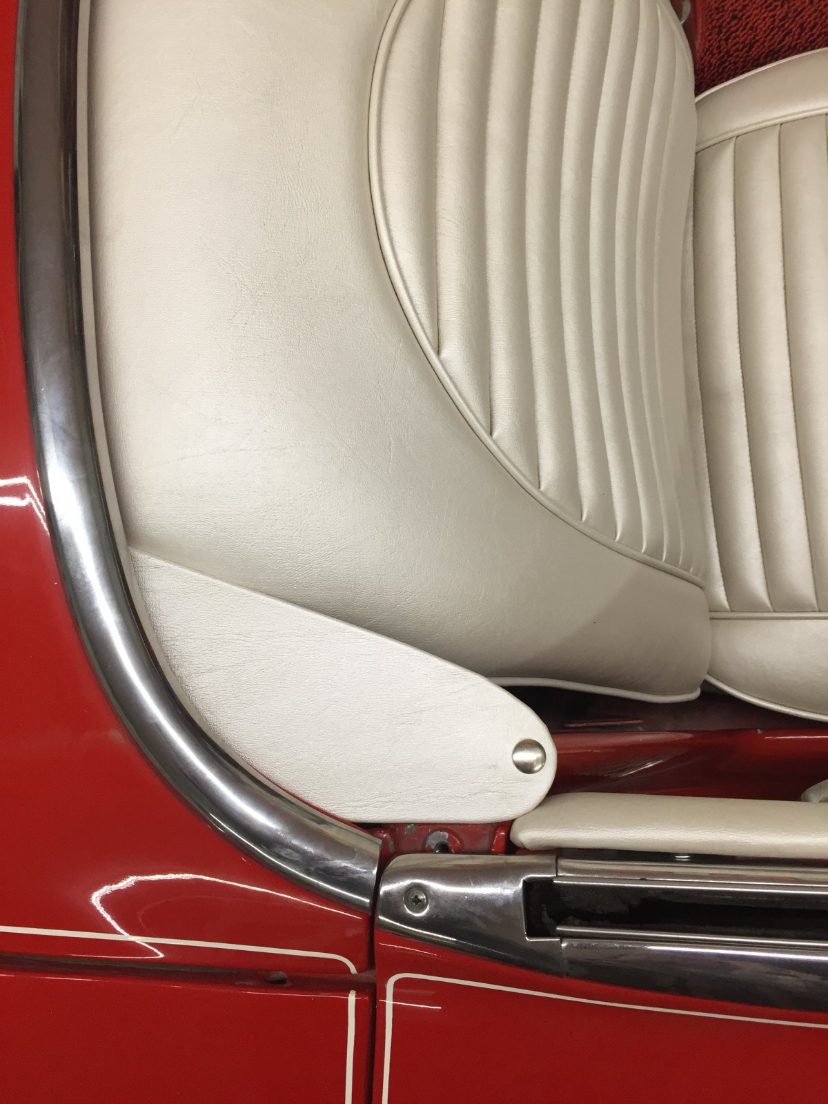

    Looks a lot better
    3C538FB6-1740-4BDD-967E-20500A5A11F4.jpeg 05609FA3-8293-4394-8C6E-17FA24005680.jpeg 3DD4E282-E8C5-44EB-890F-DF1EC6C86F3B.jpeg

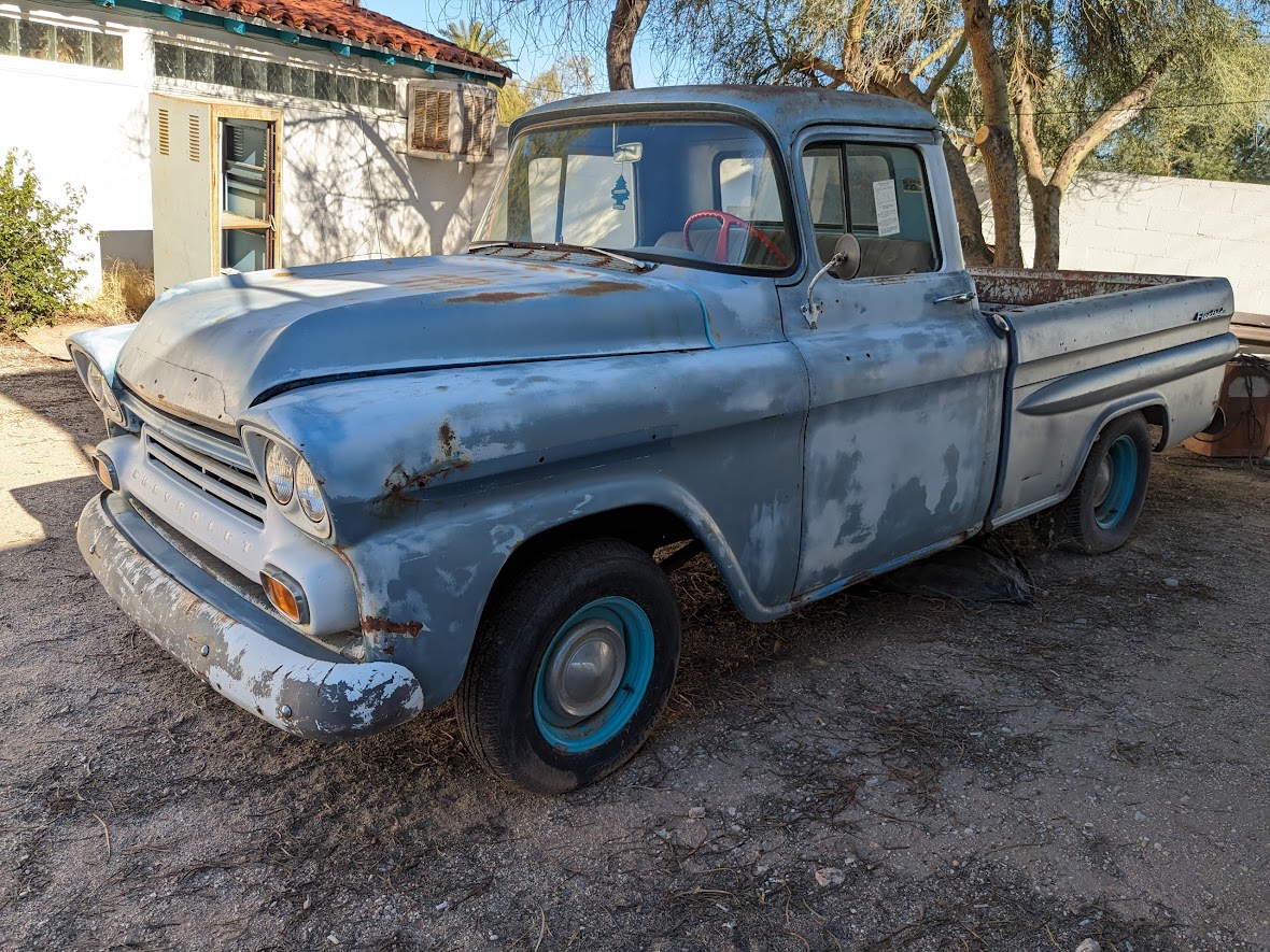

    I hauled this home...I worked on it a long time ago. Now it needs to get back on the road after sitting for several years. 6 cyl 4 speed.

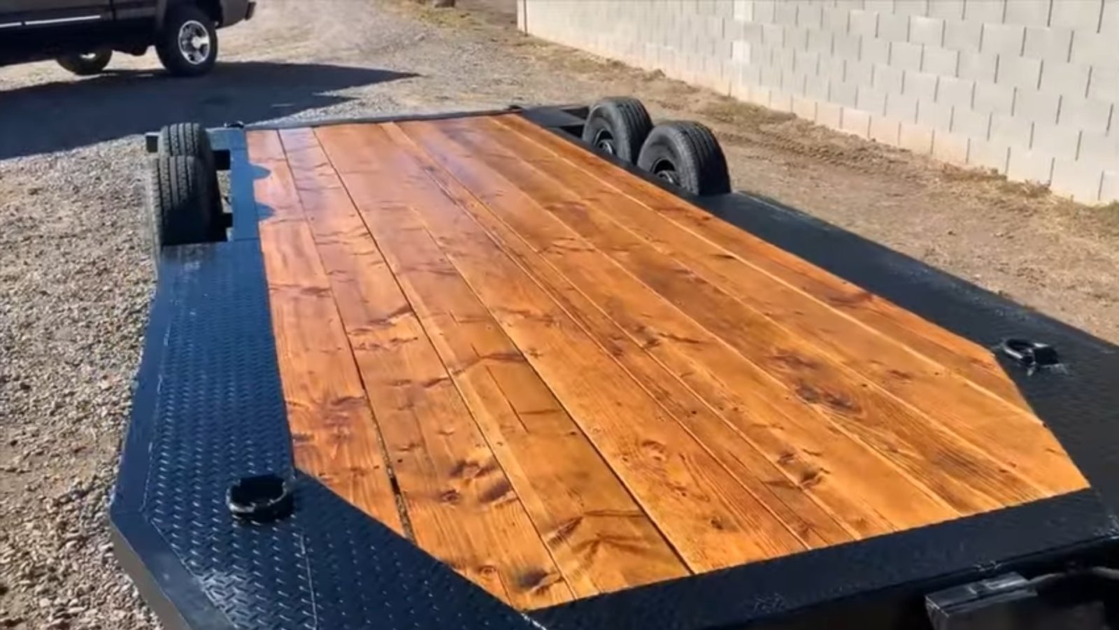

    I put used motor oil and crude oil on rough cut white oak for my 29 AA truck. It soaks in and doesn't peel. Diesel fuel is very similar. Its definitely not a show finish but I really like its utility.

    That's nice, and tough. And stable quarter sawn.
  18. That looks great! A home for your new 261?
  19. squirrel
    Joined: Sep 23, 2004
    Posts: 60,989
    squirrel
    Probably not, the 235 is in good condition I think. Trying not to spend money on it.

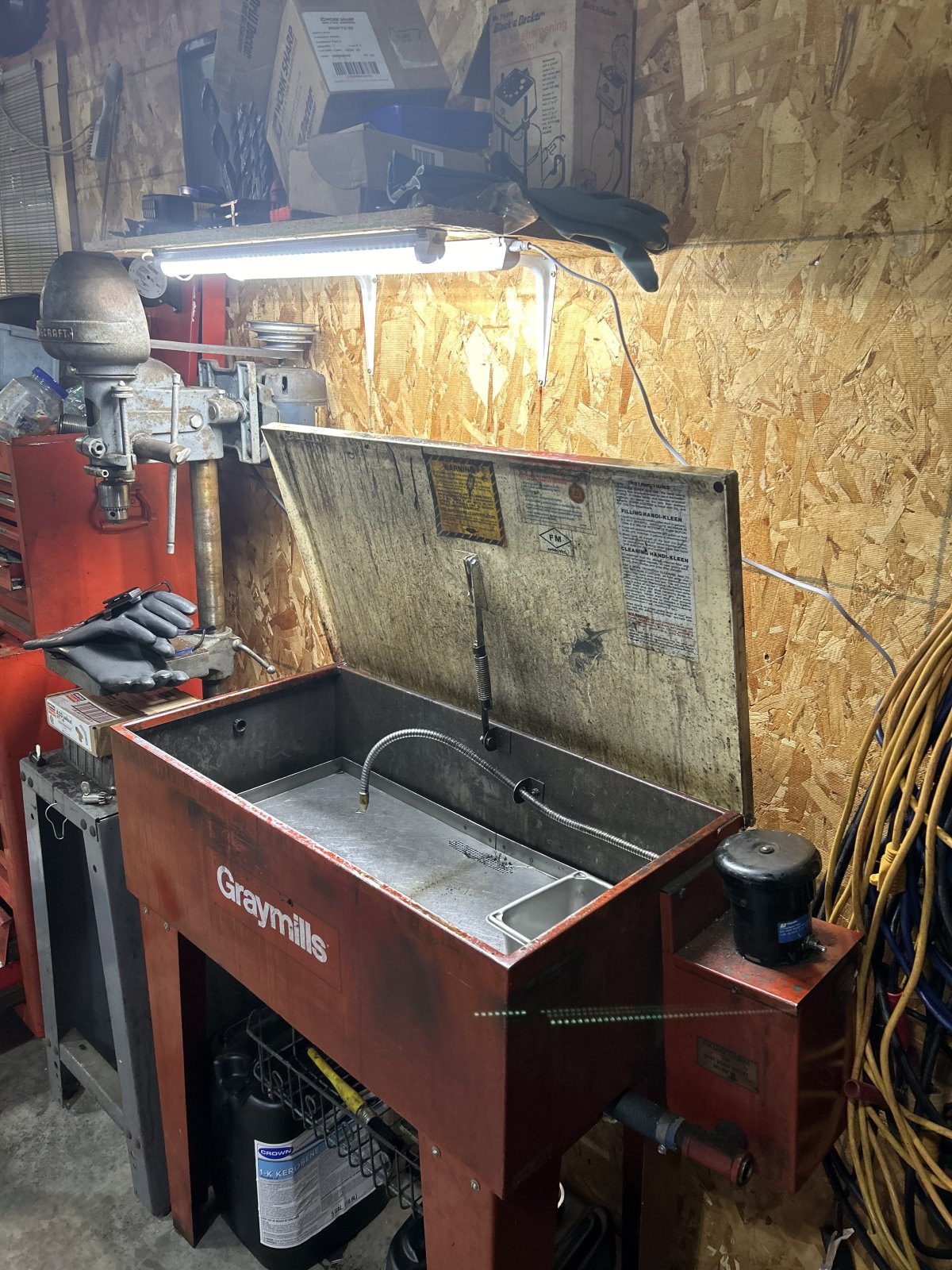

    Rebuilding an engine right now, so it seems like my parts washer gets used daily for one thing or another. Sitting in one of the darker spots in the shop, I finally got around to hanging a couple 2’ lights over it that mount pretty well under the shelf above the washer. IMG_0128.jpeg

    What cleaning solution do you use in the parts cleaner?
