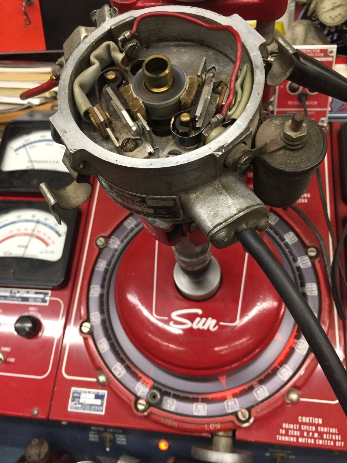

    I set up my old Delco tach drive single point vacuum advance distributor the week before last...no machine, just used the timing light, it works pretty well now.
    This is a before picture.

    So with the points wired together do you just set the gap and not worry about the dwell. I just set up a GM dual point tach drive with GM style points and it was wired the same way as yours which I found odd. But I only put one set of points back in it so not a big deal. All the ones I have set up in the past had individual lead wires .

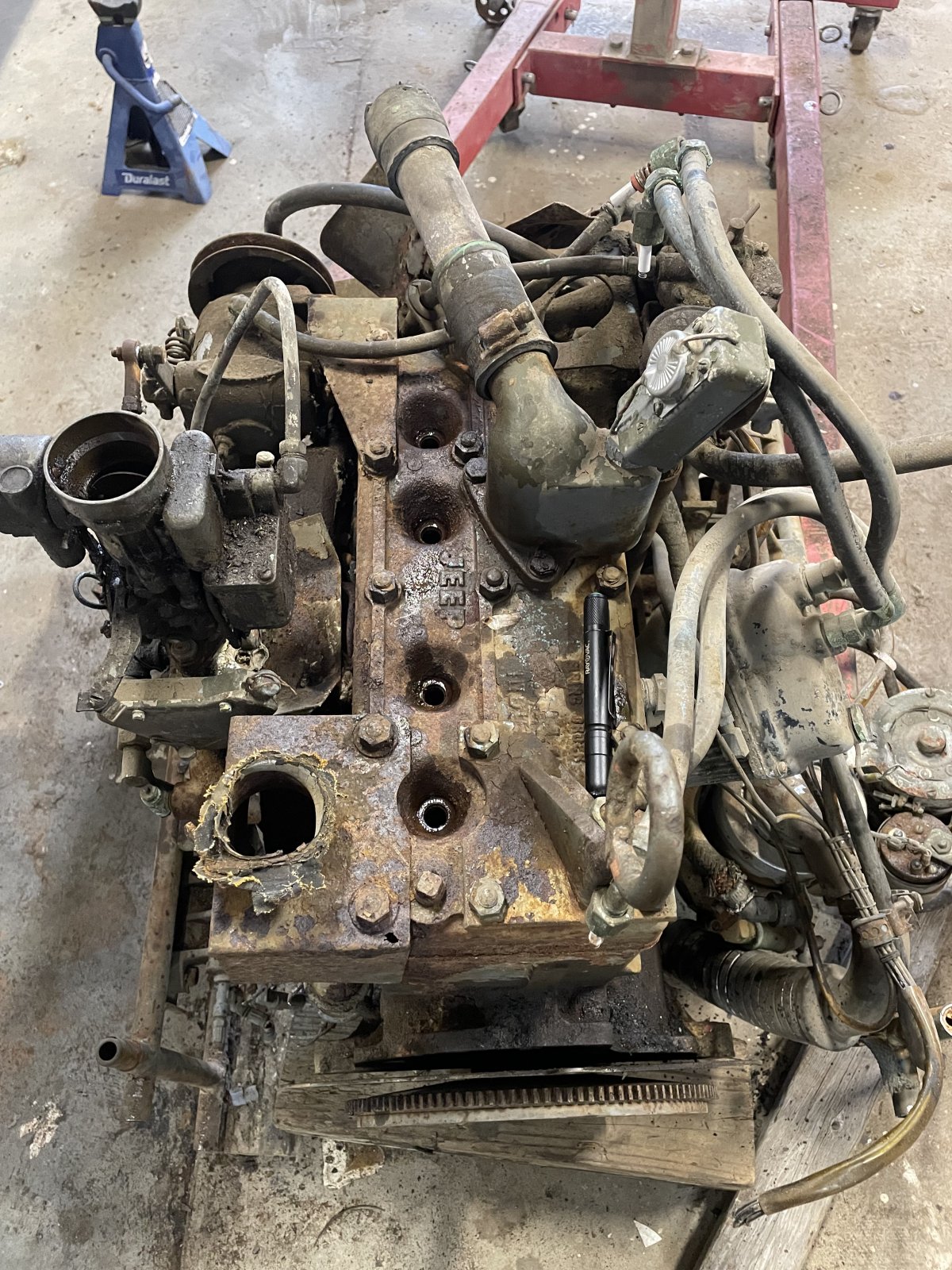

    20240106_141602.jpg More Rat motor goodness today.
  11. Very cool! Is that the Willys Go Devil engine?
    deathrowdave and anthony myrick like this.
  12. The military version.
    I guess the big difference is the waterproof dizzy and wiring. probably 24v as well.

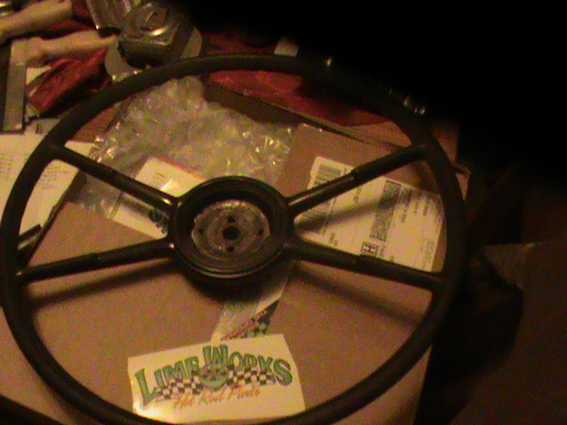

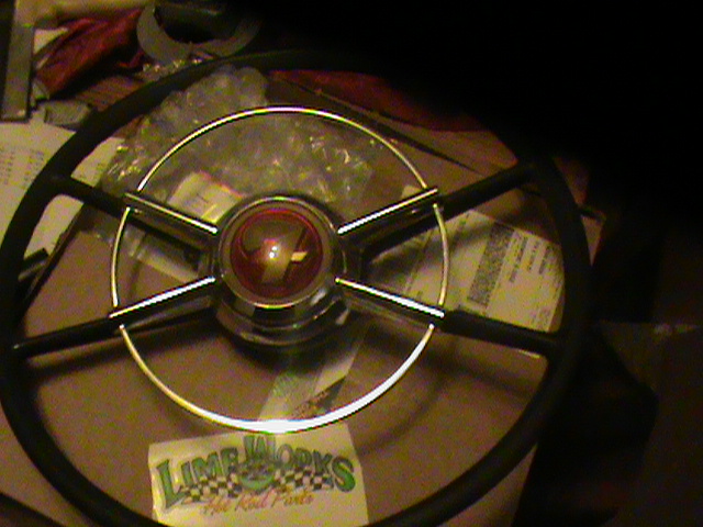

    I bought the black wheel in 2014 from a hamber and repaired it with some two-part epoxy putty from Amazon in 2015. ($50.00) I was lucky enough to find an original horn ring and had it re-chromed. and bought a new horn ring ****on for it along with the hardware to install it.(NOS) I recently bought the other wheel to repair and purchased a Lime Works horn ring and ****on. I plan on putting one on my 1950 Ford coupe and the other one in a display case, along with some other 1950 Ford stuff. I am currently repairing and painting both wheels. The horn ****on in the last picture will be for sale. Sorry, the wheels are not for sale.

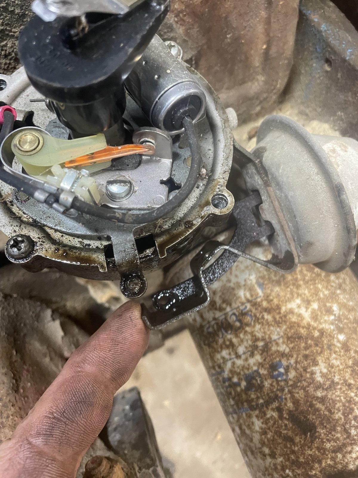

  24. Weekend distraction from the 56
    292 inspection. Removing the air compressor.
    Used a bore scope and cyls look great. Super clean on the inside. Clean behind the side covers and under the valve cover. Might just do a reseal if the comp numbers are good.
    2 plugs had fouler tips. Guess I’ll look at valve stem seals then the guides.
    The point mounting plate was loose and the advance disconnected
