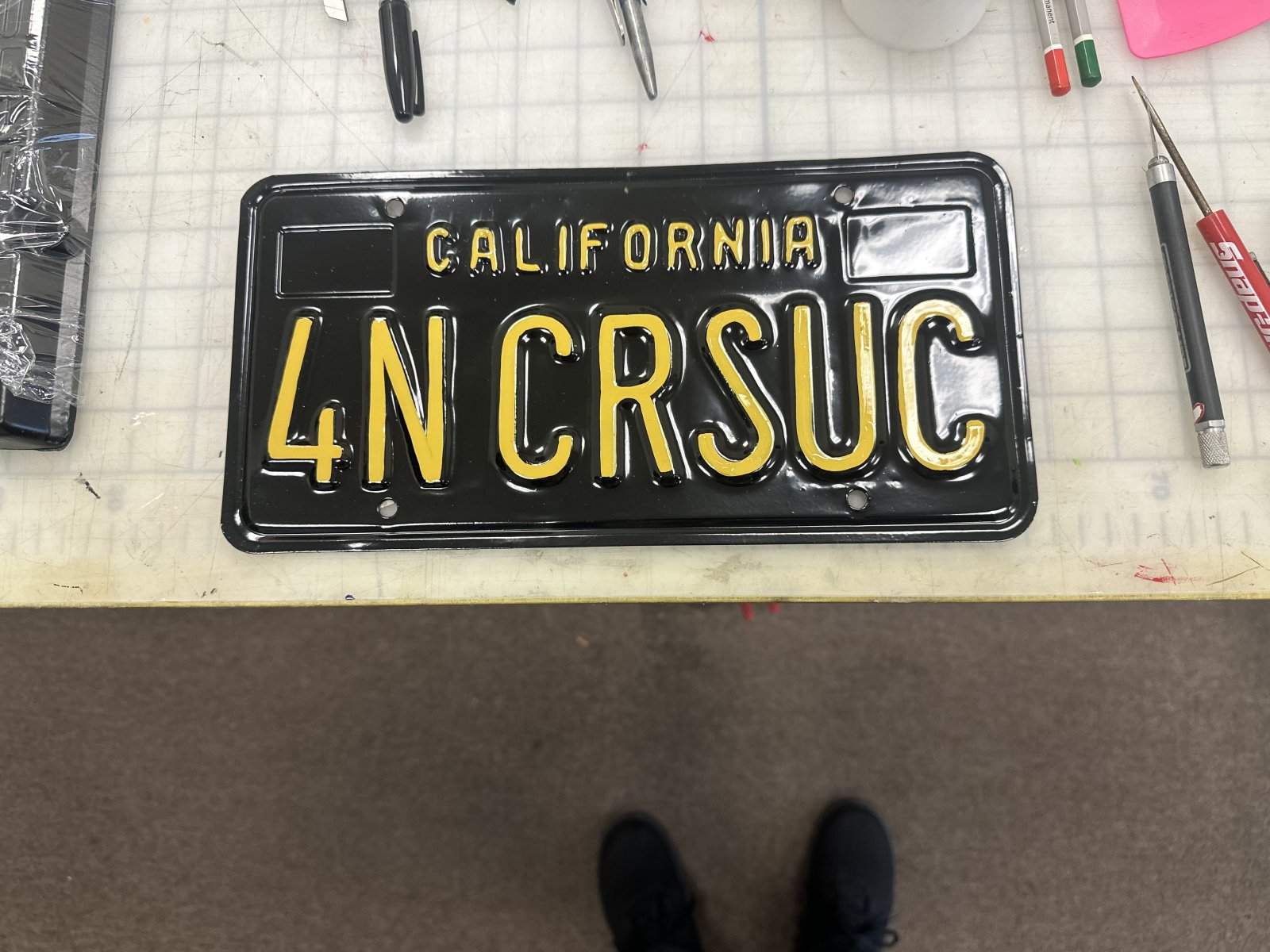

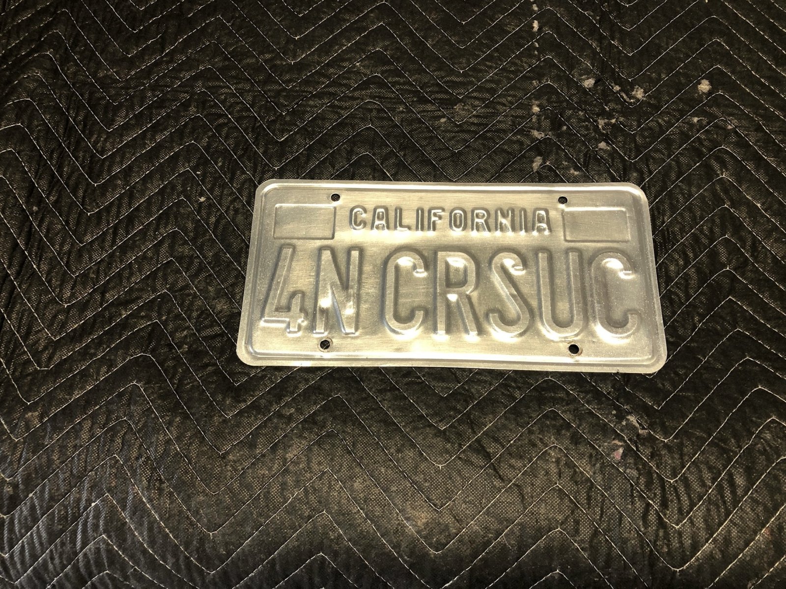

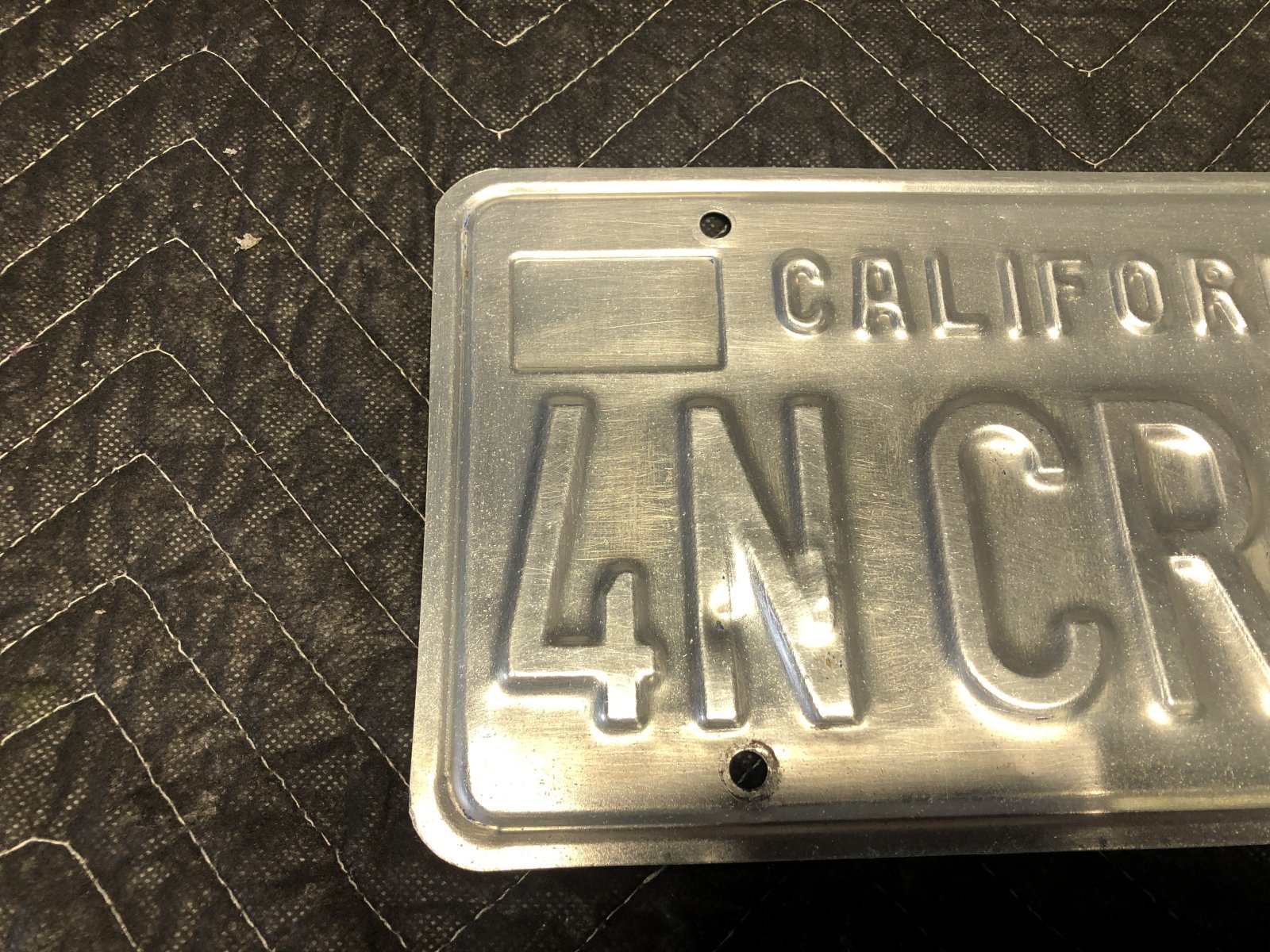

    Refreshing the license plates form my sons 40 Chevrolet. They were blue with yellow letter/numbers. He took them off his truck and had them re***igned to his coupe. They are going to be black with yellow. The N needs some body work. The old coating was tough. IMG_6363.jpeg IMG_6364.jpeg
    Picking up from the stripper tomorrow! Black Rustoleum for a base worked pretty good.

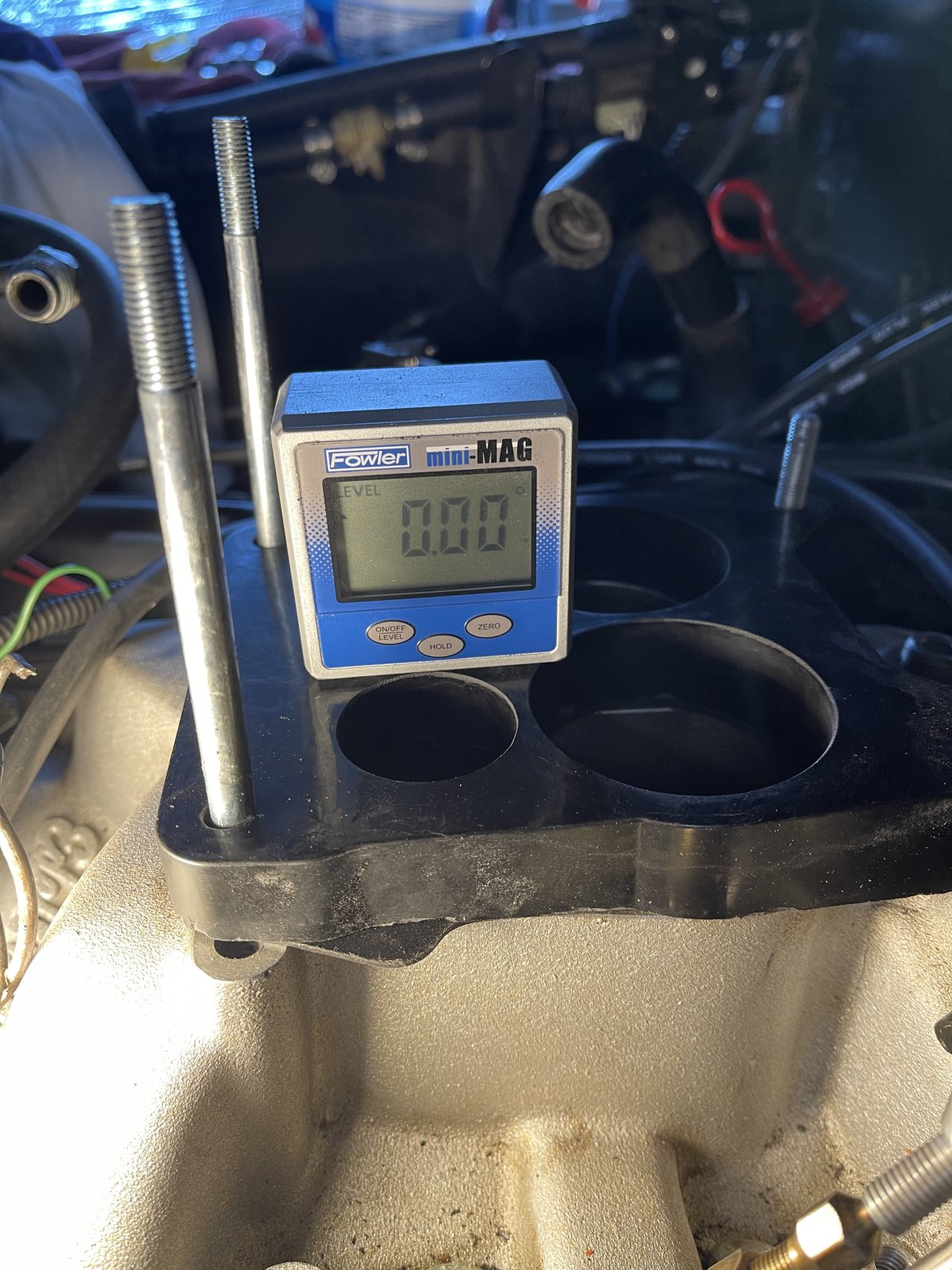

    Decided to mill off the heat spacer under the carb to get the carb to sit level and hopefully eliminate the hot start problem I have after the car sits for 30 minutes. IMG_1983.jpeg IMG_1984.jpeg

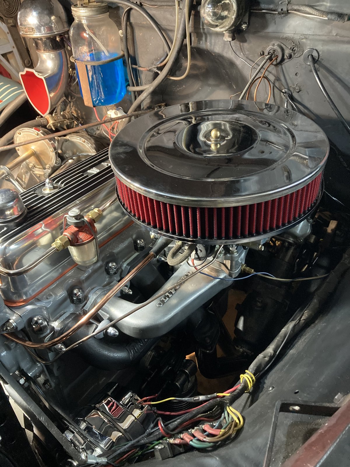

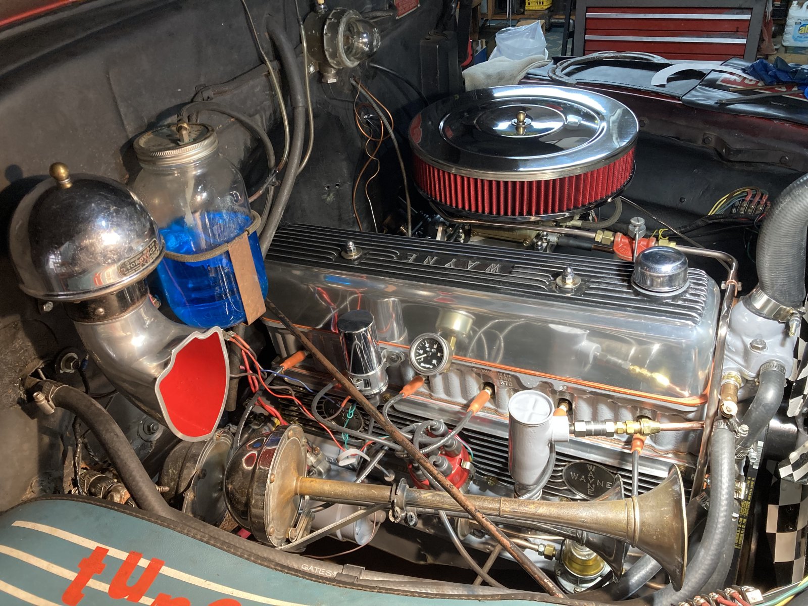

    upload_2024-2-9_11-23-50.jpeg upload_2024-2-9_11-25-4.jpeg Working on starting my 261 tomorrow morning.

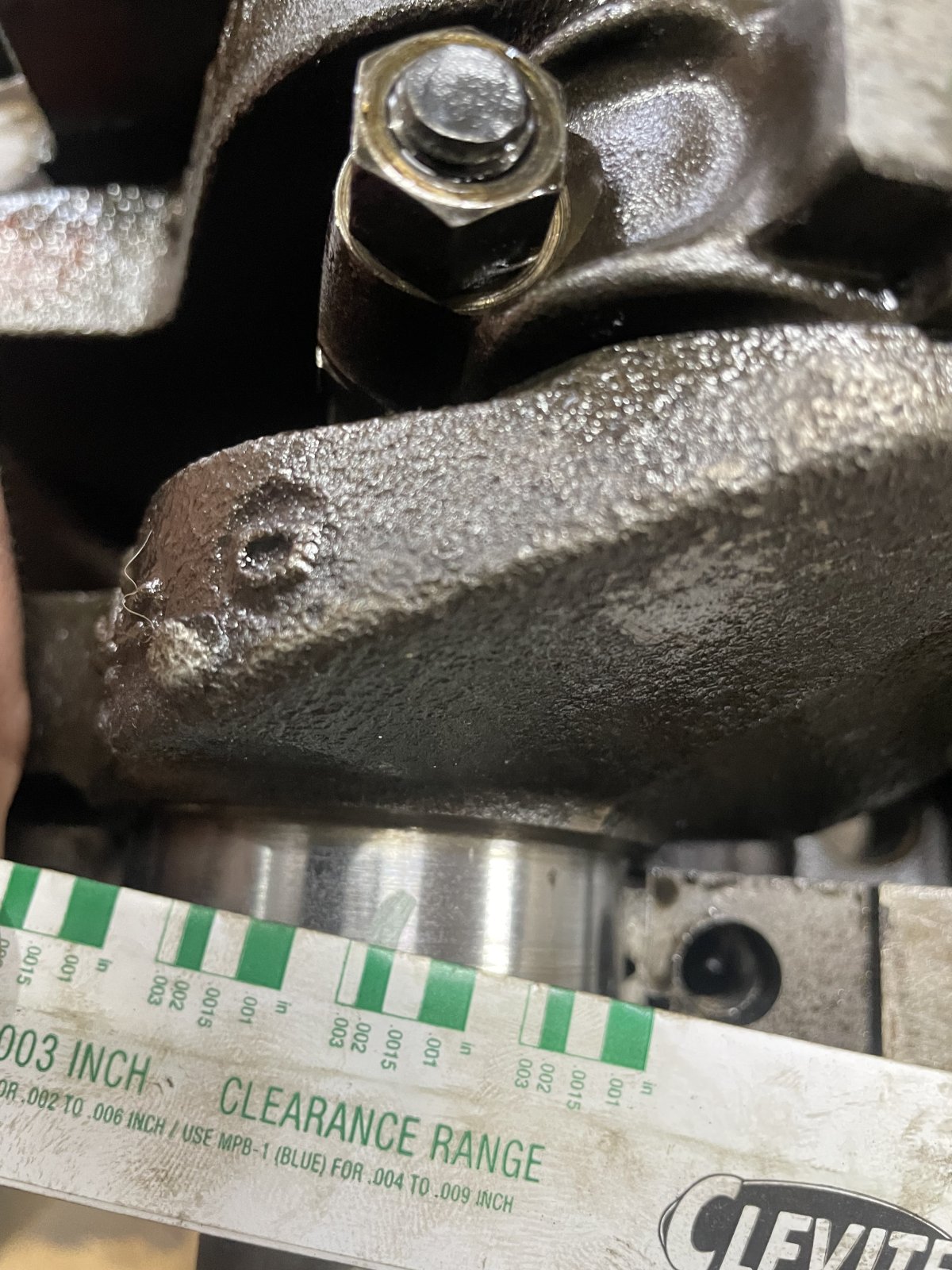

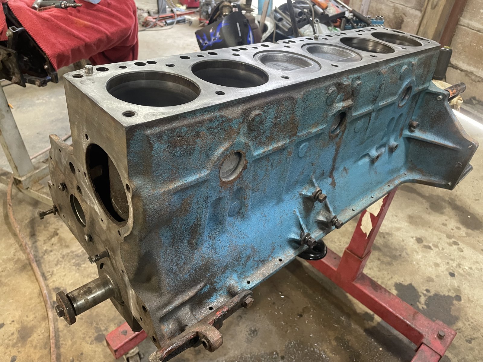

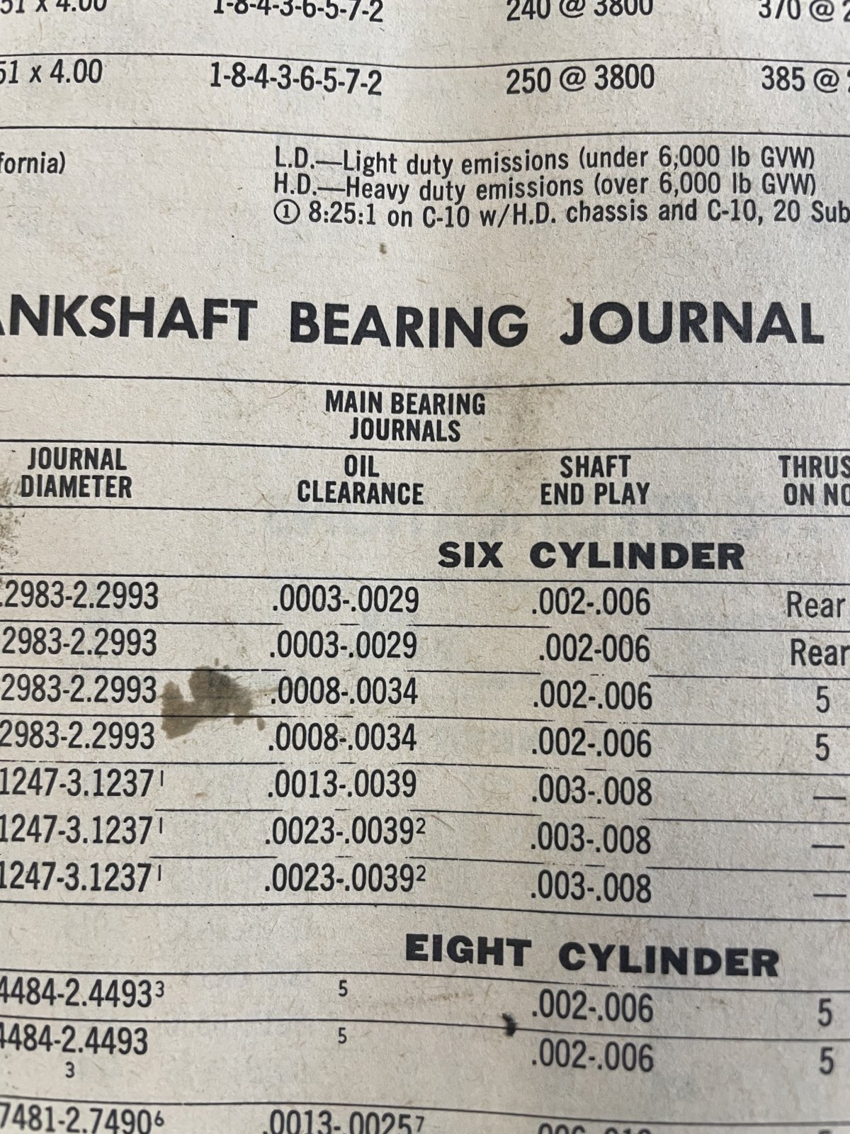

  17. Cleaning on the junk yard 292.
    gonna do a plastic-gauge check.
    If it’s good we’ll do a valve lap, seal it up and go.
    Sometimes it’s fun to see how long stuff can last
    my son said leave the rods caps alone and send it :)

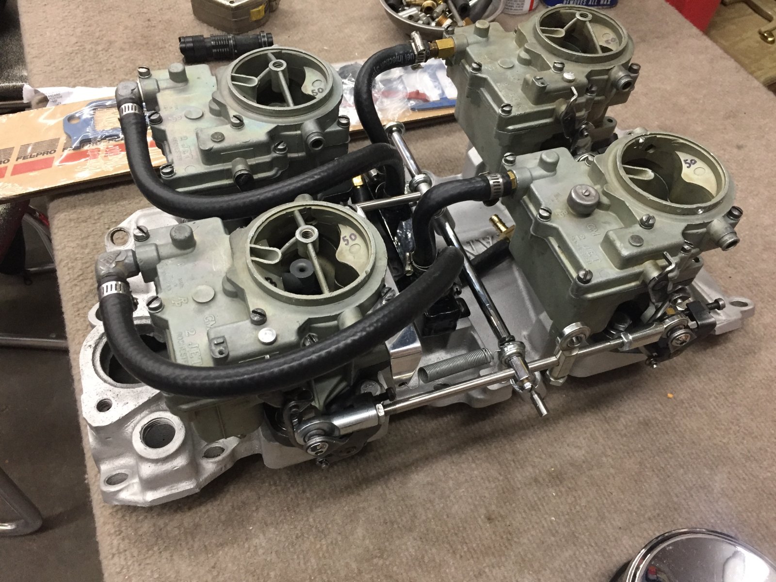

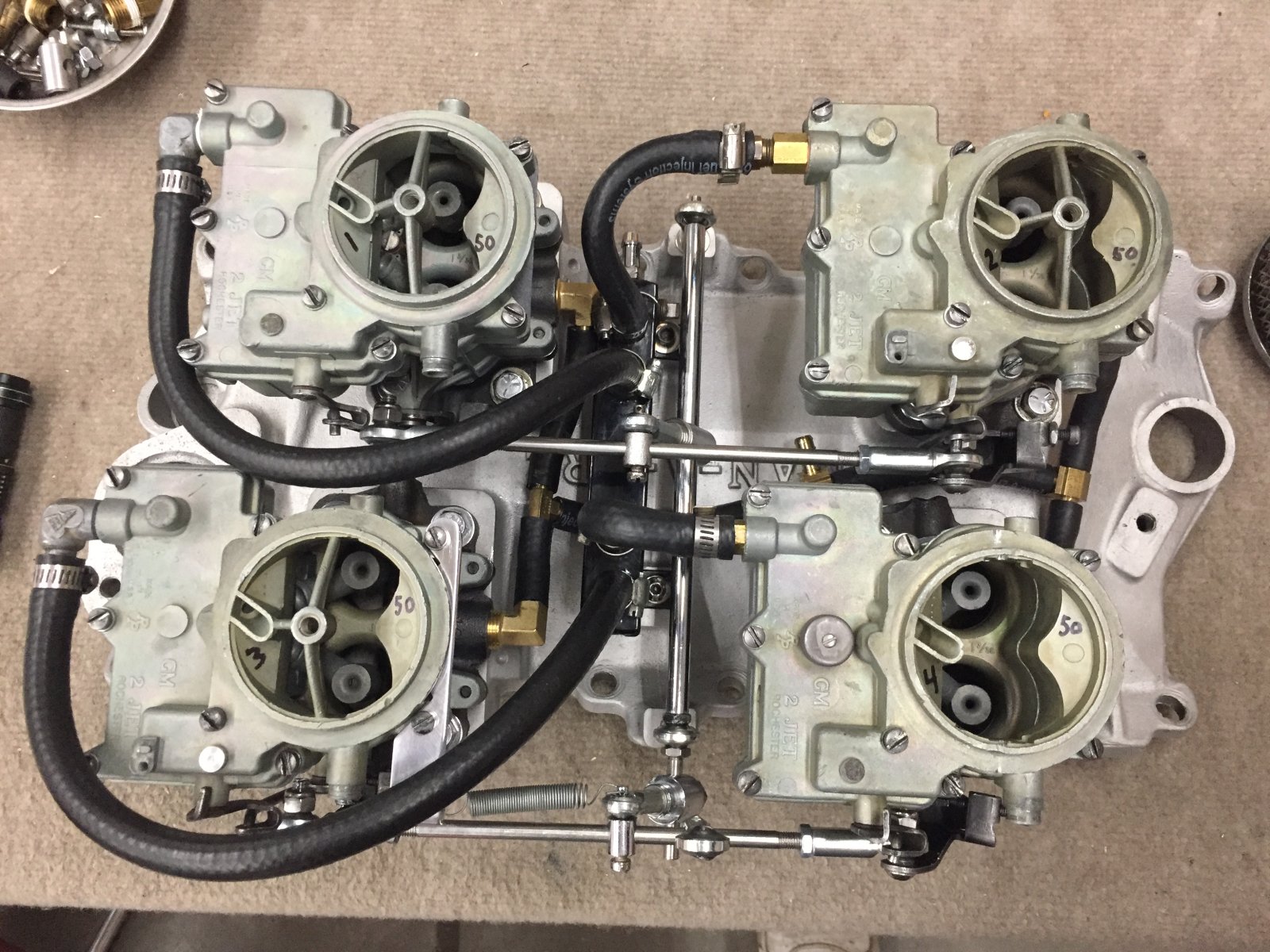

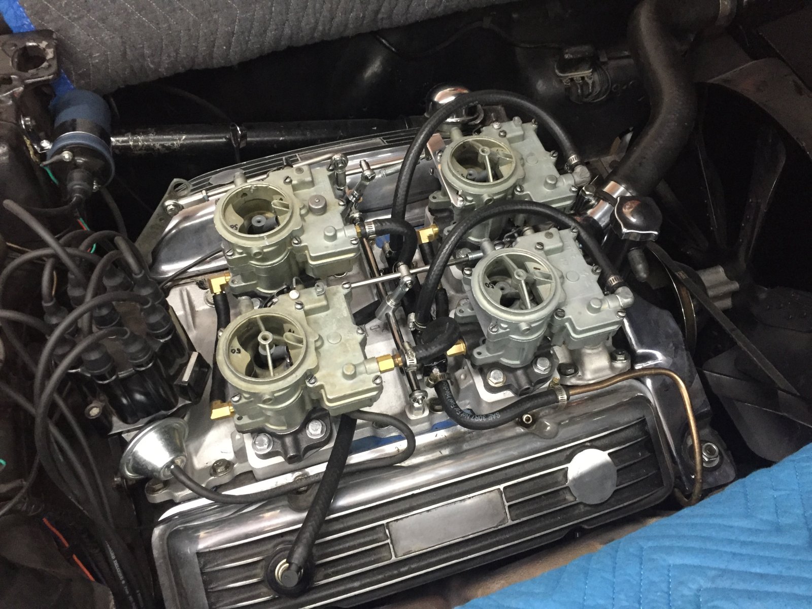

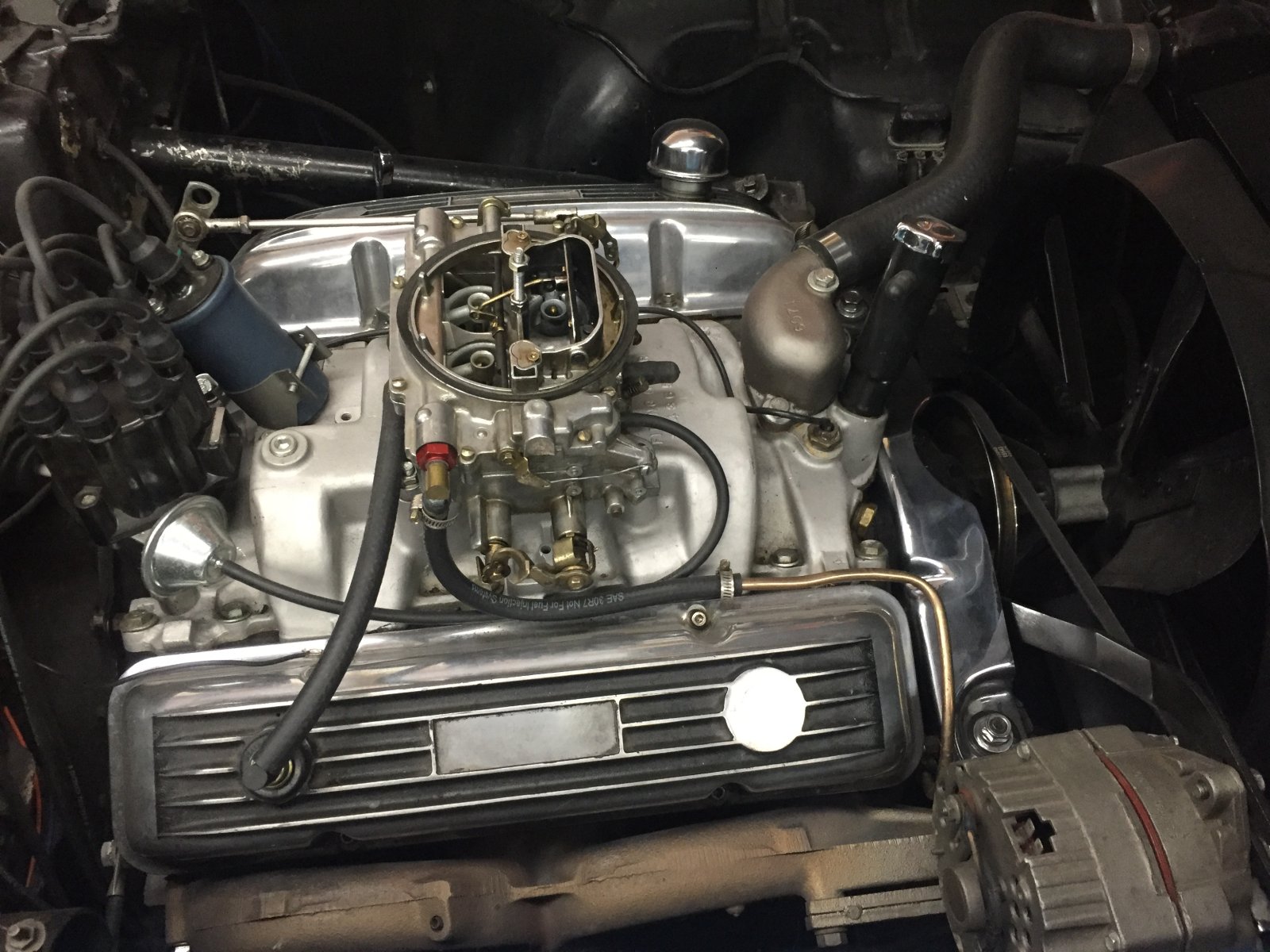

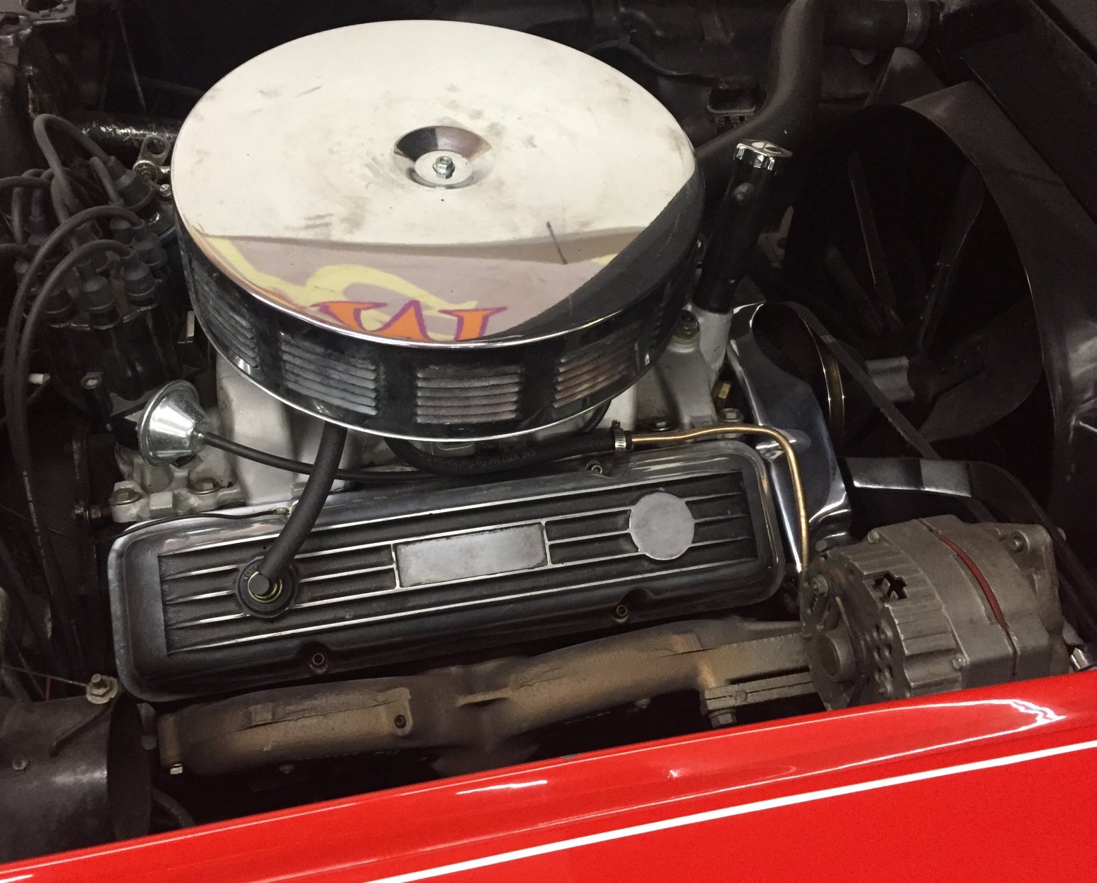

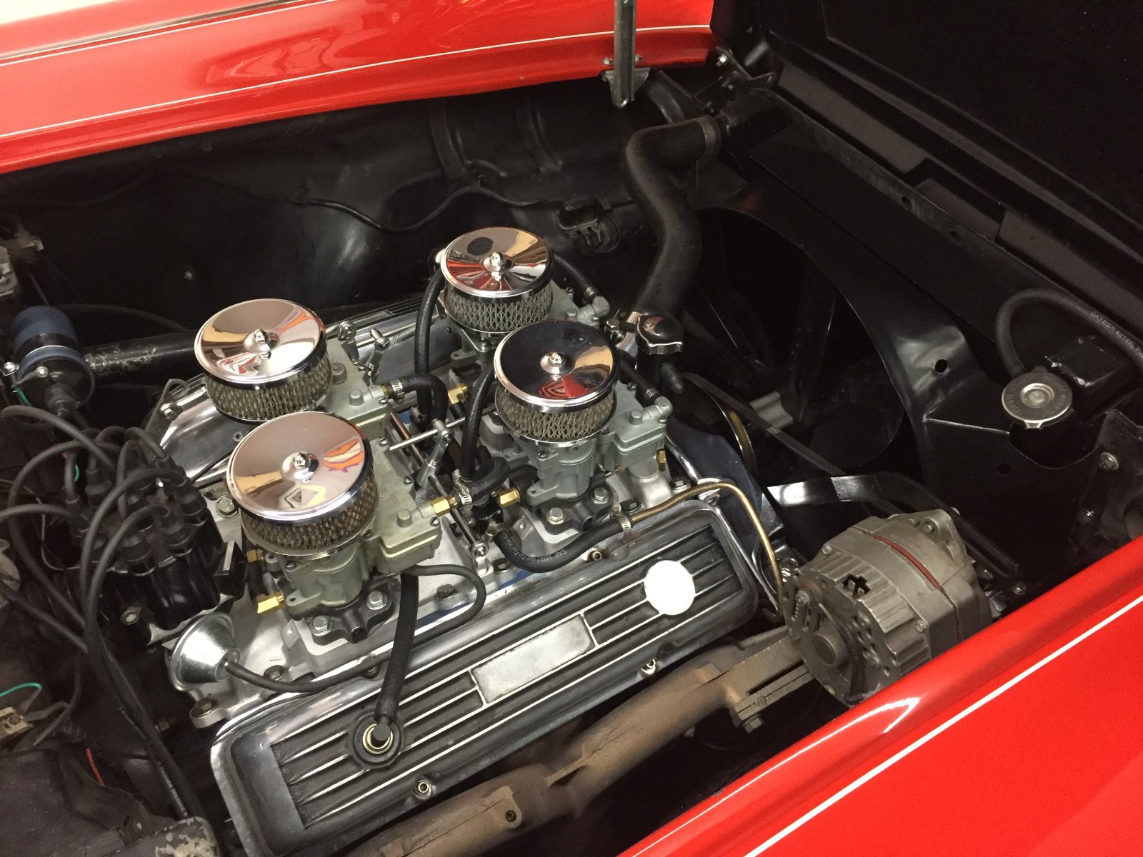

    About a year or so ago in an effort to try to troubleshoot another problem on my Corvette I removed the Man A Fre and put an L79 manifold and a 600 Edelbrock carb. as it turns out the Man aA Fre was not the problem but I procrastinated on putting it back on. The linkage for the 4 carbs was orig Man A Fre parts and admittedly some of the rod ends were worn out or loose and sloppy. The whole mess was kinda ****py looking. I bought a pile of RH and LH 1/4" rod ends and some 1/4" stainless rod and made new linkage for it. Also grabbed 4 kits and went thru the carbs just for good measure.
    I never told anyone I took the 4 carb setup off and while the 4 barrel setup ran real good it was not nearly as fast as it was with the Man A Fre. Here is a pic of the 4 bll manifold on the car
    0DFD8E3A-5AD5-4AFF-B665-6DAFFE2D3363.jpeg 08C32D63-EBD2-493A-B736-81F2277CA7E0.jpeg

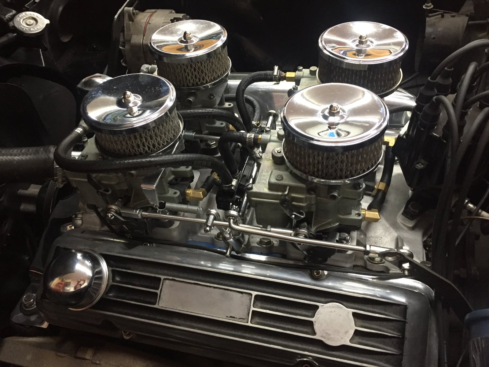

    Here is the Man A Fre with its new linkage (smooth as a gravy sandwich now) and rebuilt carbs
    0834F2E9-A05B-4FDF-9BEF-A8BE838CD59A.jpeg 5CCF0E31-0D38-4BF8-A8CA-B75B56FF3133.jpeg 9AF696FE-61E6-4ABE-A9F8-DD836AE2646D.jpeg
    So I got off my *** and put the Man A Fre back on, just fired it up and all is now well with the world

    Heck!!! A real Corvette without Corvette valve covers......Oh My. JW

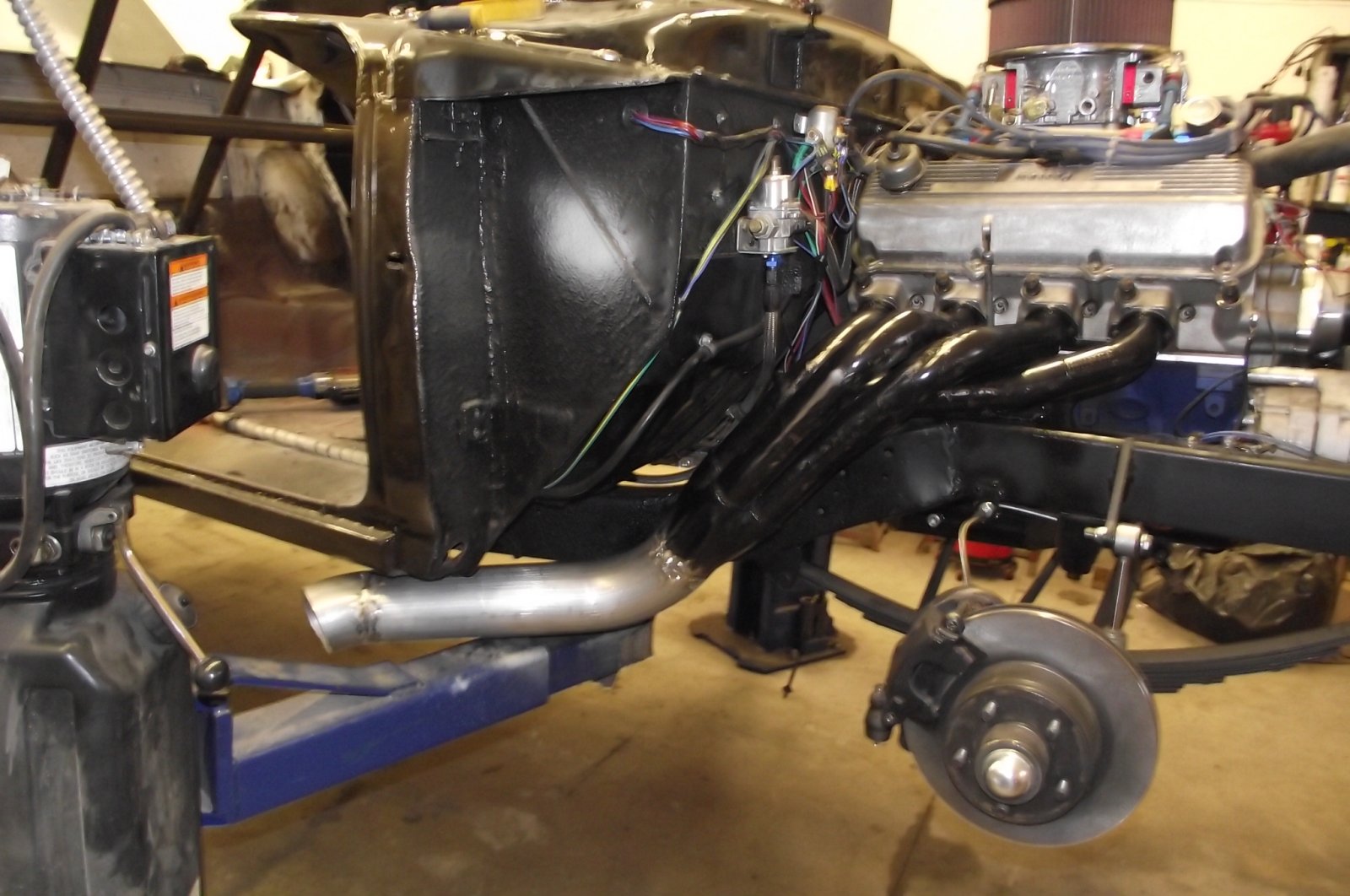

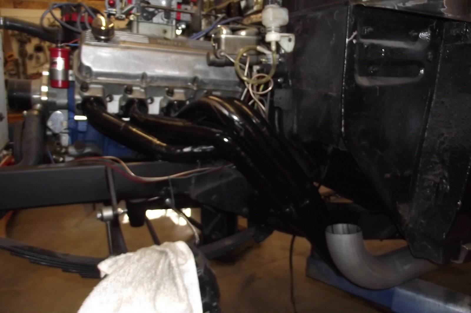

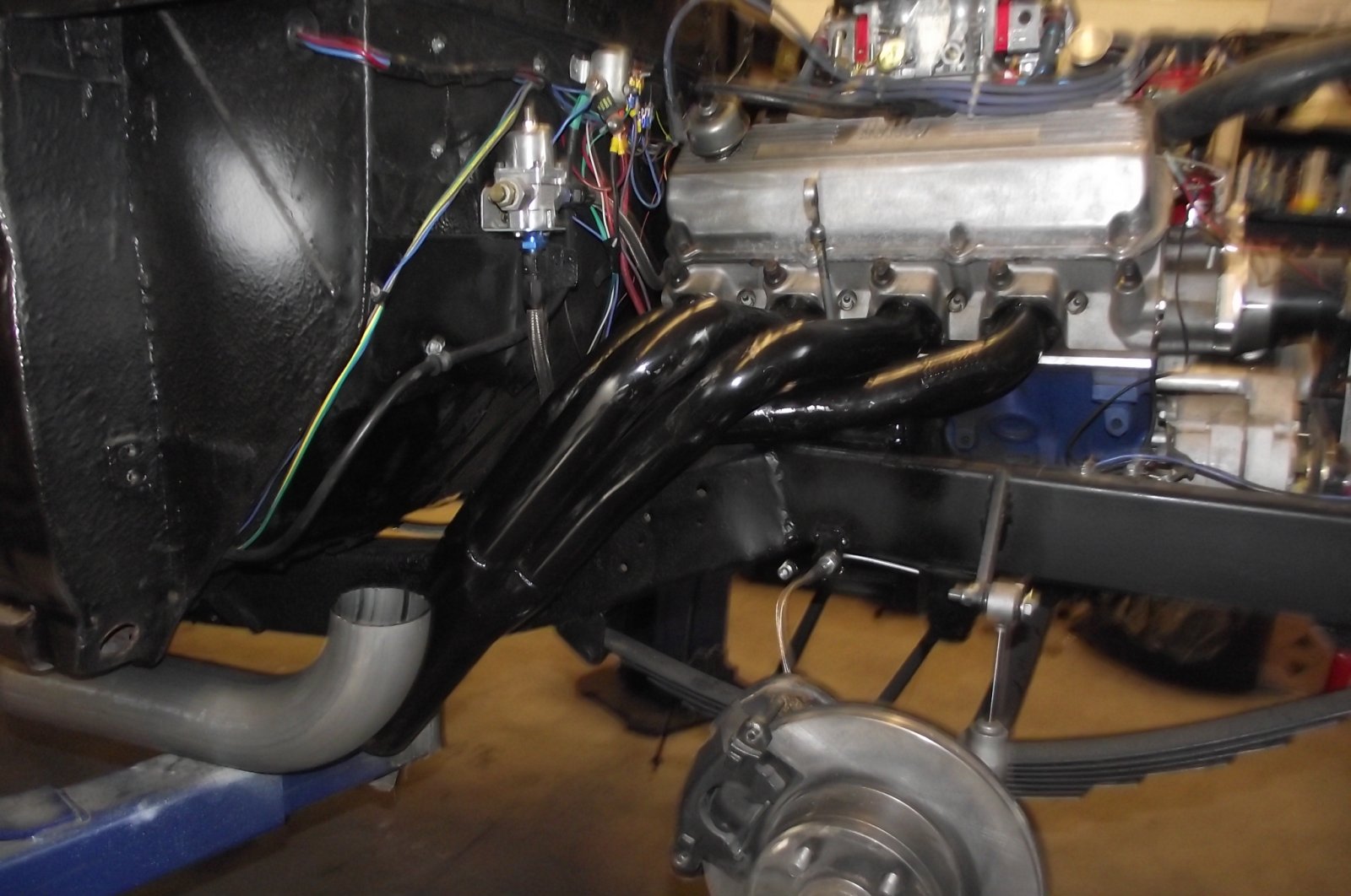

    Headers and dump tubes.
