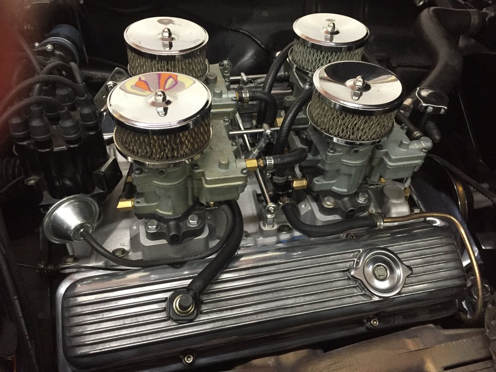

    Ok I flipped a hose clamp and scrubbed the lettering off the hoses...

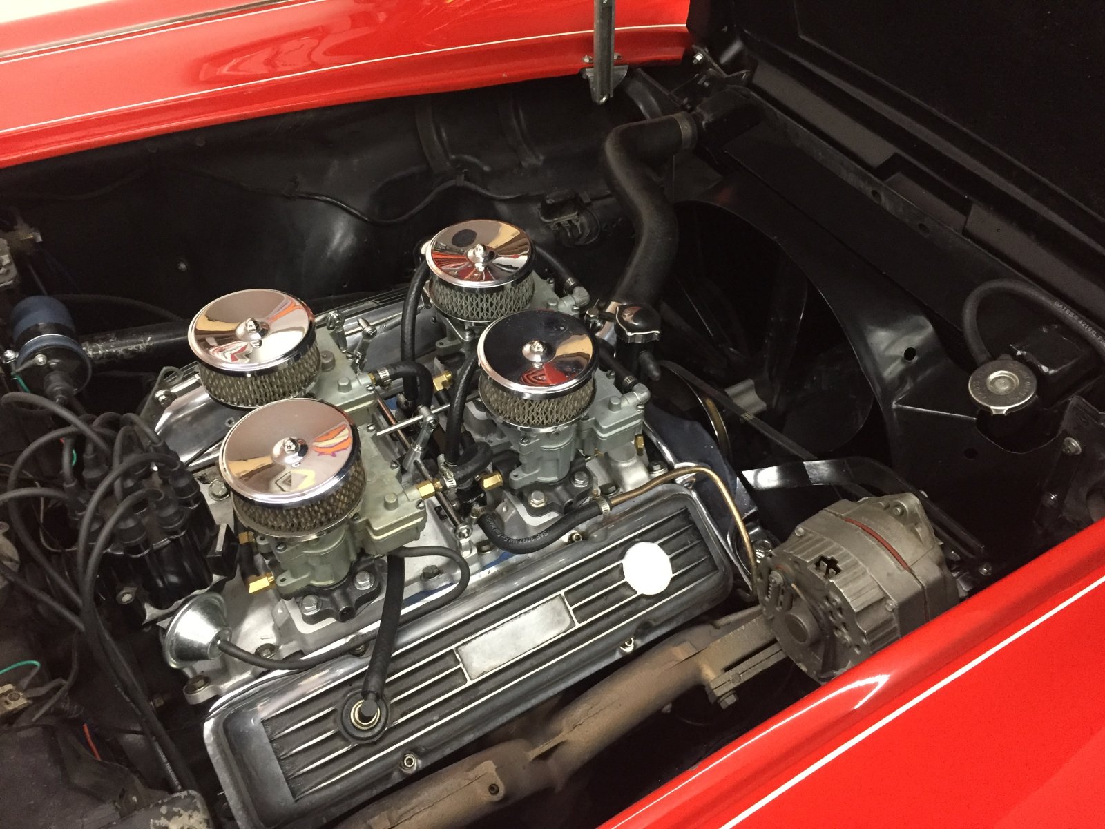

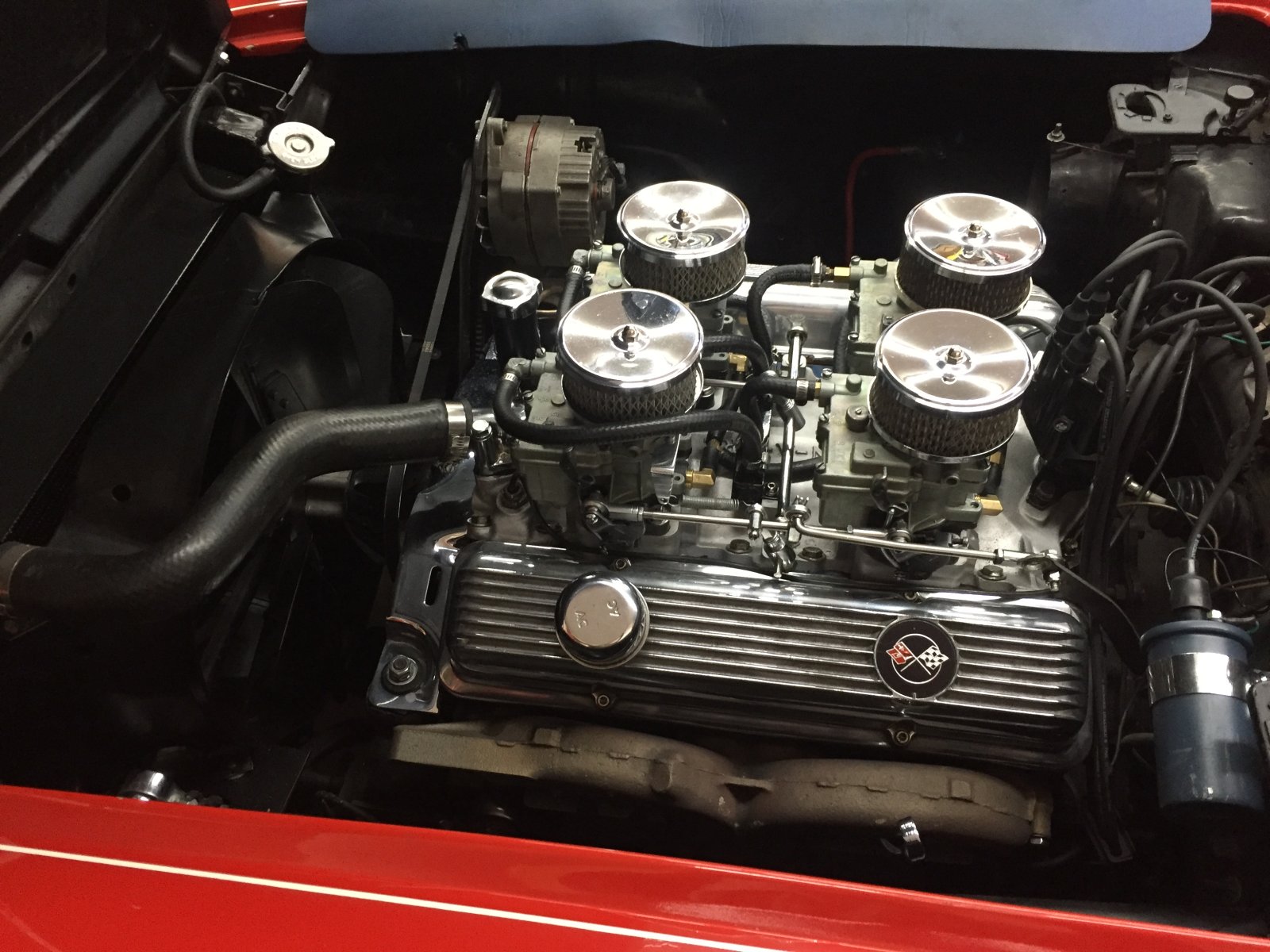

    Mark's engine:

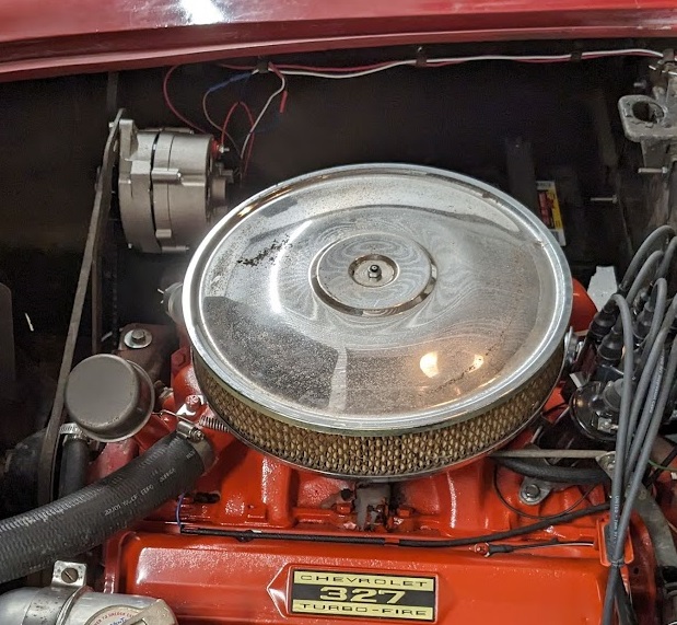

    I gotta admit, his alternator wiring is a lot cleaner looking than mine:

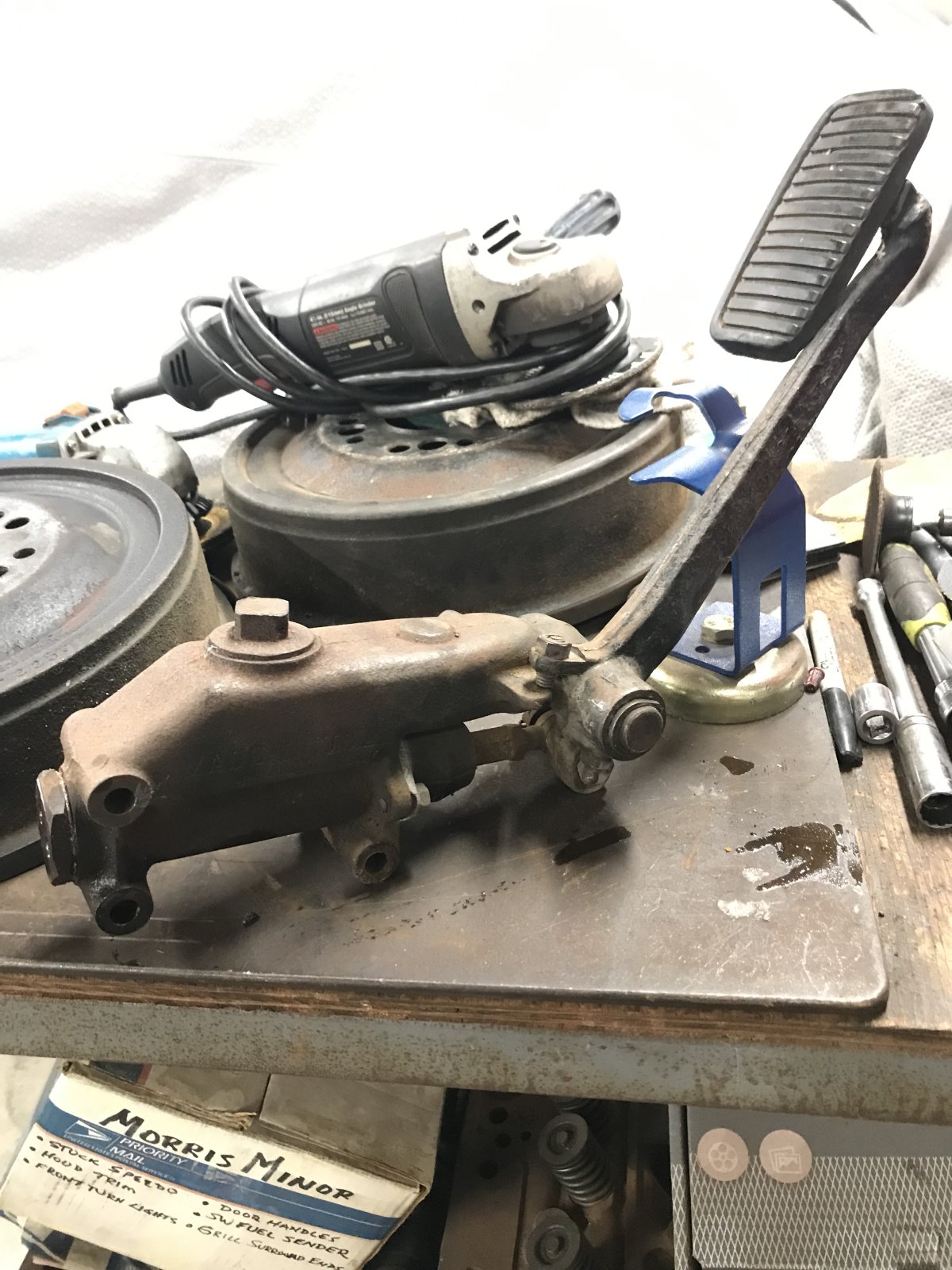

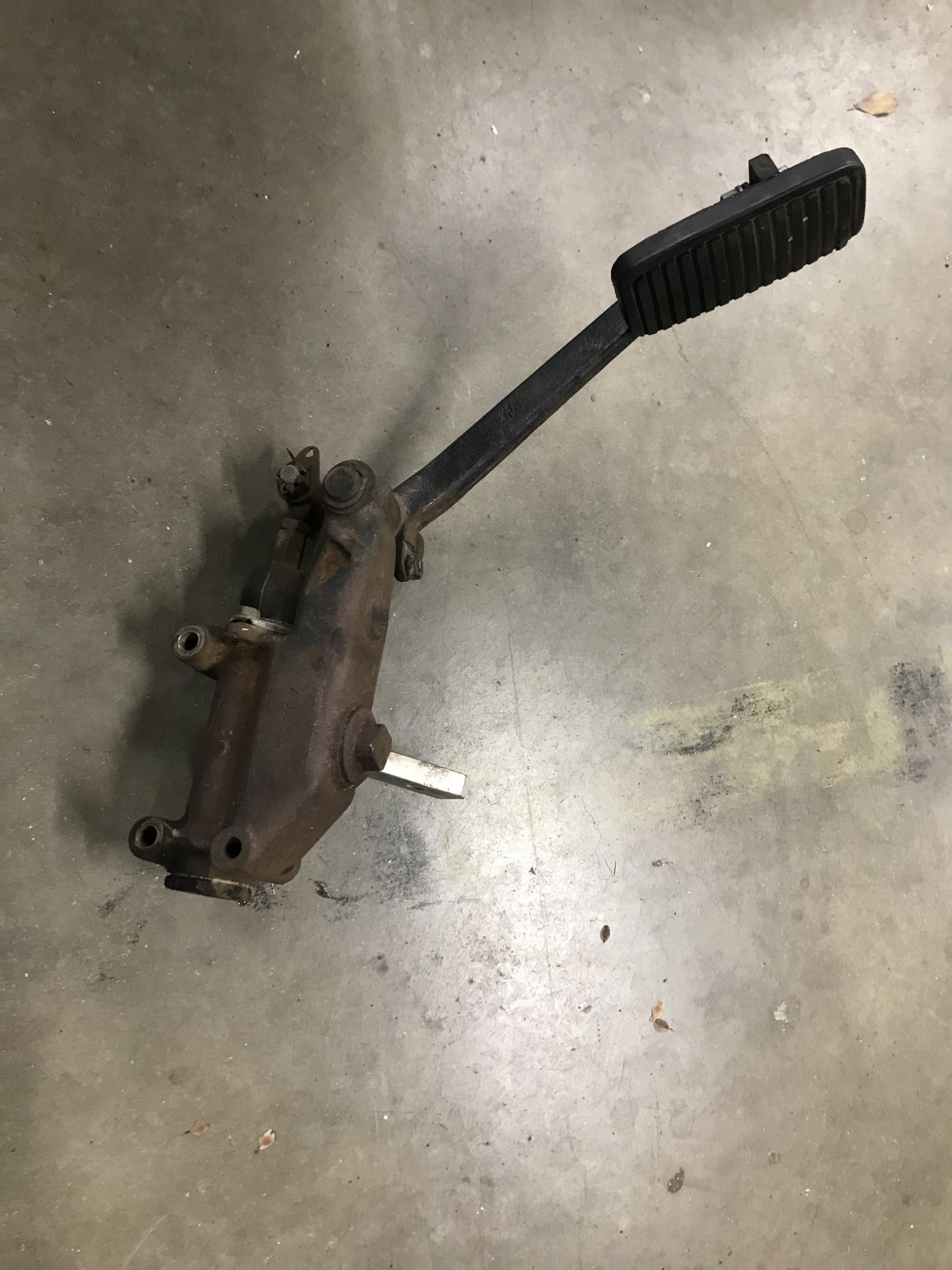

    I continued the Austin g***er upgrade. Made a bracket to relocate the brake junction block out of harm’s way. Took a Wire brush to a bunch of the rear end stuff. Painted the areas where I added gussets and stuff.
    I was afraid that this project would snowball and it’s starting to. I reigned it in some by keeping the leaf springs and I’ll be adding some Cal Tracs type traction bars now that the ch***is is robust. I was thinking of going to the 4 link/coil over setup that I have.
    Today I pulled out the M/C with the intention to upgrade the M/C and definitely the pedal position. How’s this for a race car part? Anyone recognize it?

    Strange choice for a supercharged g***er. It was a serious racer way back when.

    better than mechanical brakes? :)

    It stopped ok at normal street speeds, but the pedal position and angle was awkward and difficult.

    I hope you'll find a better way to do it
    although when you're working on a little car with a big engine, it can be challenging

    You know Mark, as much as I like the LT-1 valve covers and as good as they look on there, aren’t they just a little too “late model” for your Corvette? I think a set of well polished and detailed stock Corvette valve covers, early Cal Custom, Moon, Edelbrock, or maybe chrome stock script covers would be more appropriate.
    I’ve seen some smokin deals on nice LT-1 valve covers but I never have a car that they are period correct for. Just my $.02.

    if you need the holes for ventilation, they are the best thing out there

    If it’s an early block with a road draft tube there are ventilation options. If not, it’s harder to do but not impossible. They do look good in any case. And that Man-a-Fre is just awesome.

    Have a look at this thread. I know the bracket would be of a different design but you might get an idea of how to do yours.
    https://jalopyjournal.com/forum/threads/61-econoline-dual-port-brake-mc.1286113/

    Is any of the original mounting there?
    From memory the master cylinder was under the floor with the front brakes being hydraulic and the rear mechanical.

    Yeah, it is an early 70's 350. no road draft tube. I kinda need late covers for the PVC stuff. I have 2 sets of early corvette covers but I really did not want to drill a hole in the Man a fre for a pvc grommet
