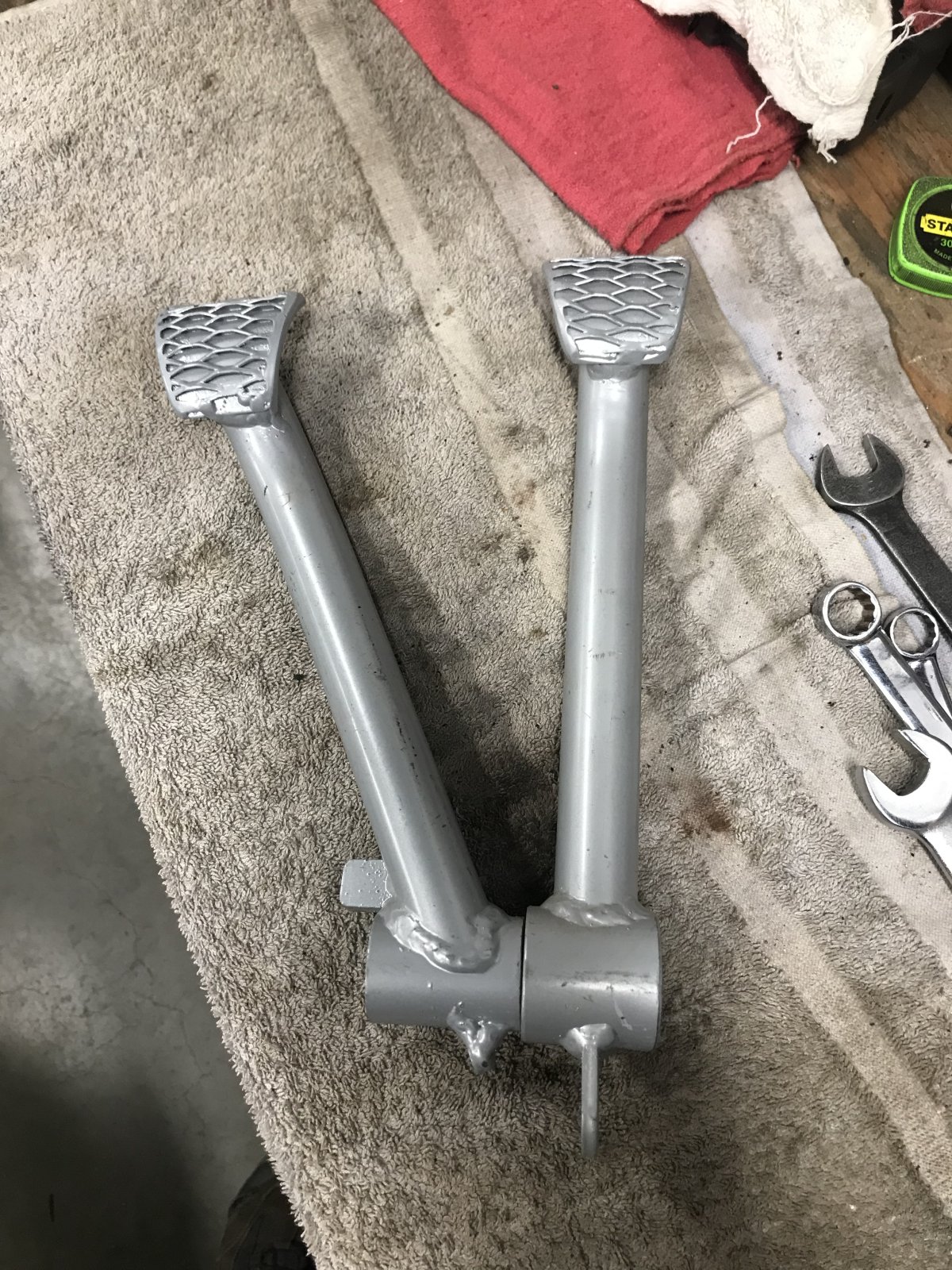

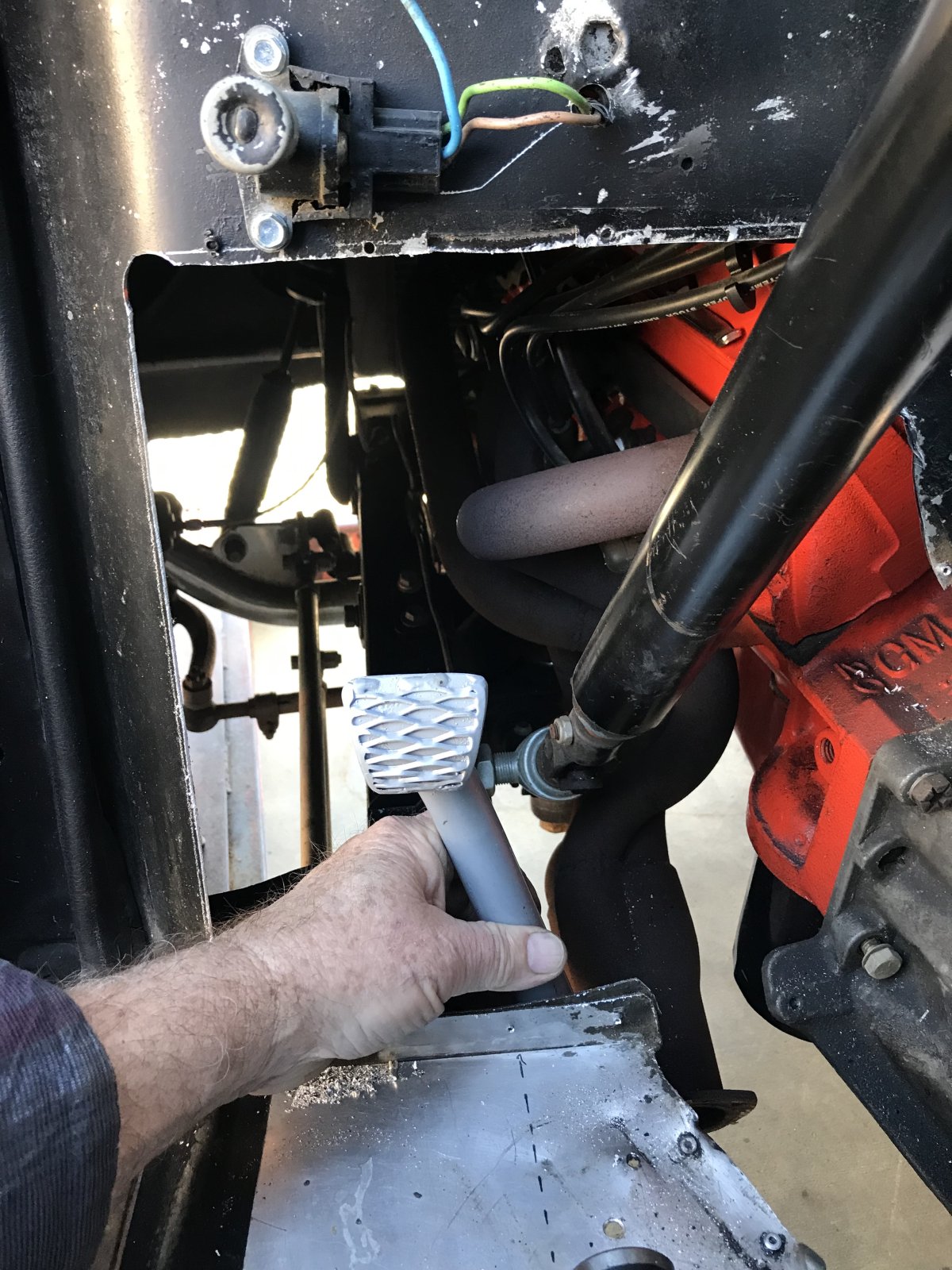

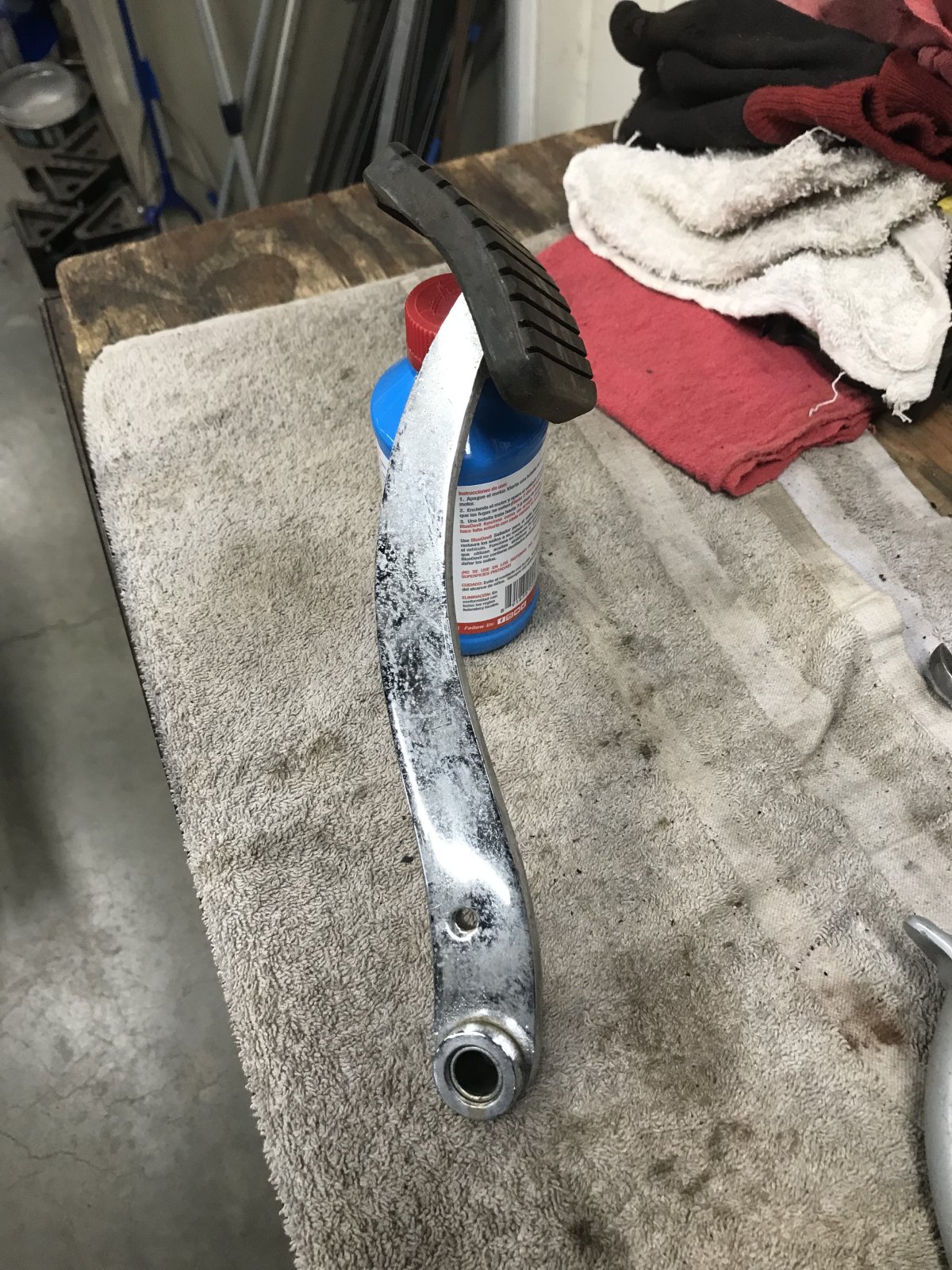

    I’m waiting on rear brake parts for the Olds rear end in the Austin. So I decided to attack the brake pedal/MC problem. I did consider rebuilding the monstrous MC/pedal ***embly that I took out, but it’s a single and the pedal position is really awkward. The driving position was the deciding factor, so I dug into my stash of junk to see what I had to work with.
    I had this nice chrome pedal with a pad that really fit the British car theme.
    And I had this Alston race pedal ***embly.
    After some mock up, a modified version of the Alston clutch pedal works best, with a Mustang MC under the floor. Fire up the sawzall and the welder.

    I cut the firewall for a “footwell” so I could move the pedal to a better location. The current tin work is sad and I’ll probably redo it all soon, but for now I just cut out what I needed to.
