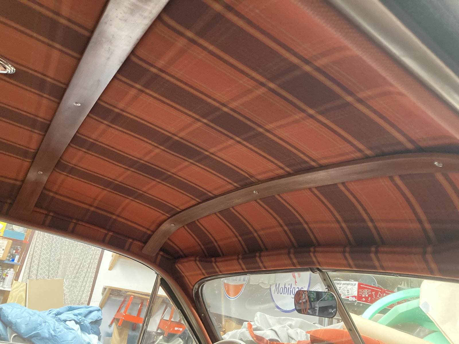

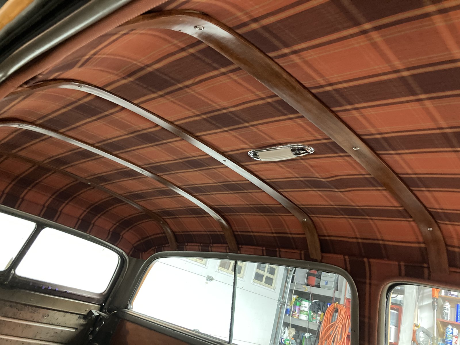

    Just finished a custom headliner for my ‘51. Steam bent wood slats are screwed to the original bows, 1” foam is covered in fabric and glued to the roof. Very pleased with the results.

    That headliner is really nice!!!! Well done!!!:):)

    That turned out awesome. It looks exactly as it should in that car. Nice work!

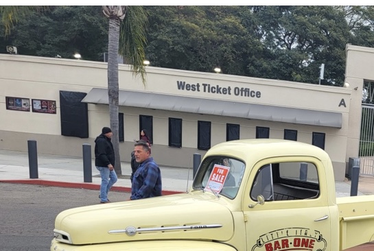

    It's north island credit union ampitheater in Chula Vista. I work in Balboa Park

    Got it. It’s these ticket window’s had me thinking the auto museum parking area of the park. IMG_2475.jpeg

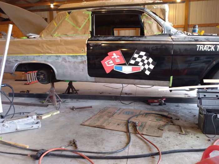

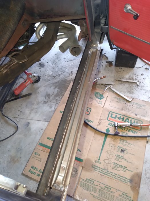

    Well today I finally got to work on something O/T. Weather was nice and didn't get parts yet for the ramp bed project so I thought it was Shaker time. :)
    I decided to work on the inner rockers structure. I'm using 2x4 by 1/8 inch rectangle tubing. This will help with side impact and also give a place to land the roll bar.
    Next I will build some outriggers from the frame to the inner rocker, this should make it strong like a bull. :)
