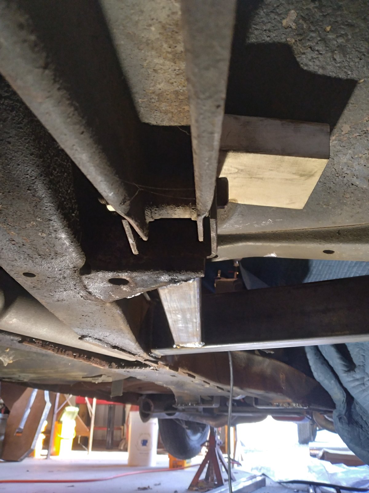

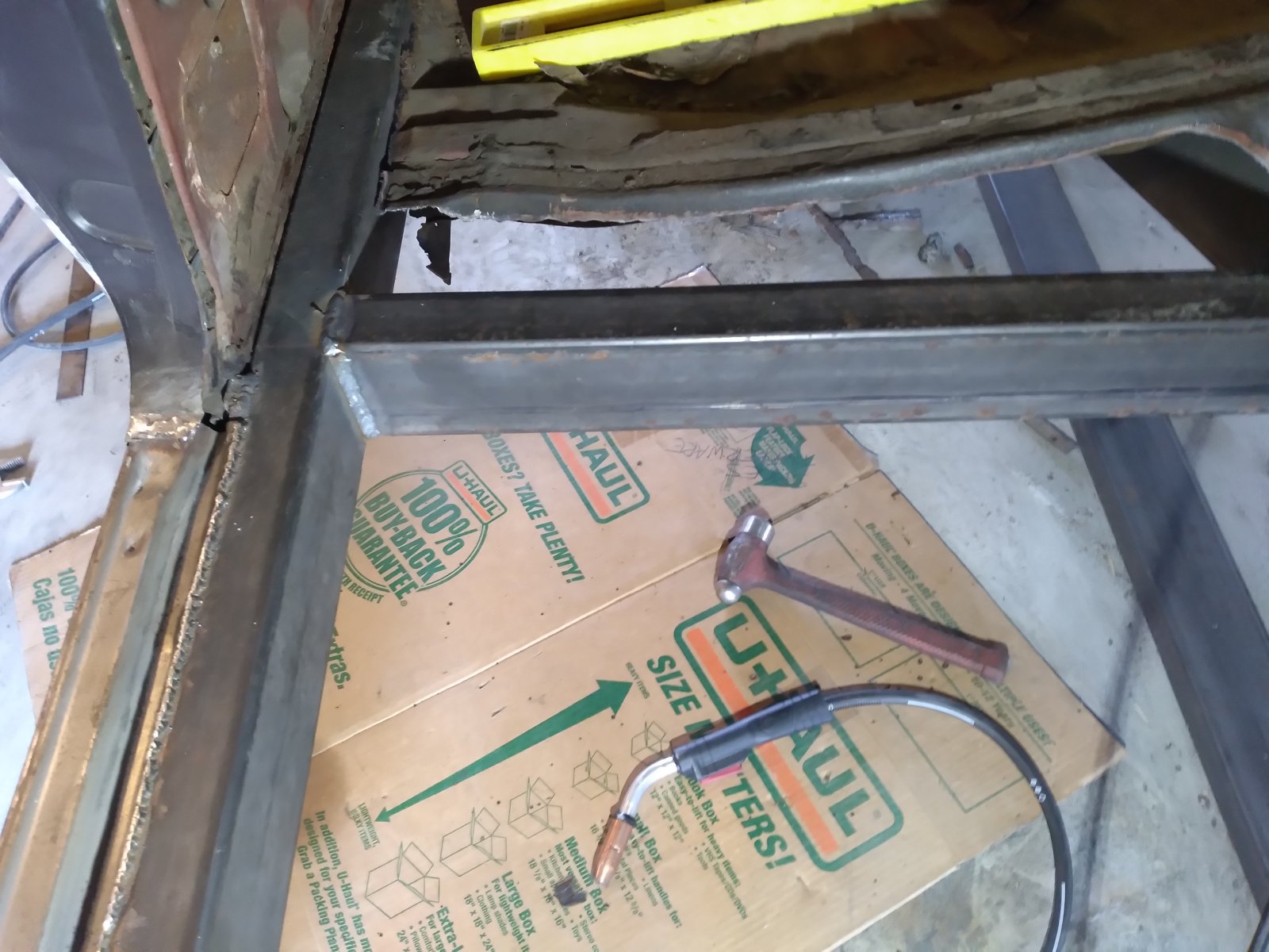

    More Shaker time today. got the outriggers welded in and one brace for lower control arm mount.
    Ben enjoying this free welder. :)

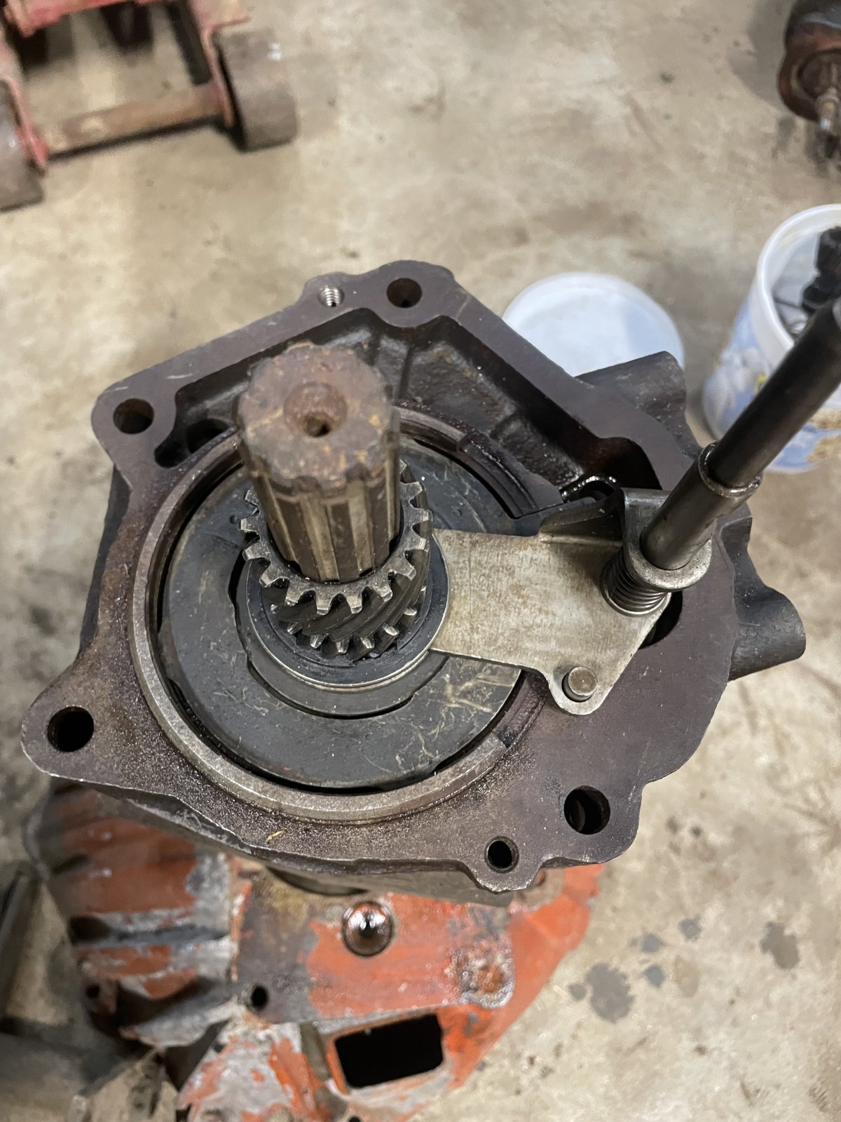

  22. Digging thru some of the trans junk I bought Monday.
    Guy said he had all the pieces for a Saginaw R10 set up.
    plus spares
    Got an extra non OD Saginaw and another trans with OD with all the other junk
    Kinda simple.
    Didn’t come with solenoids but I have 3 and 3 governors at the house.
    I’ve got a bag full of the needle bearings and other small pieces for the OD

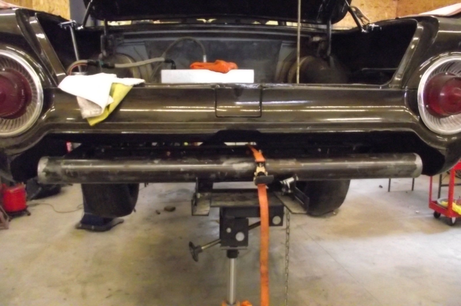

    Rear bumper and throttle link. DSCF5745.JPG DSCF5747.JPG DSCF5748.JPG DSCF5749.JPG DSCF5750.JPG

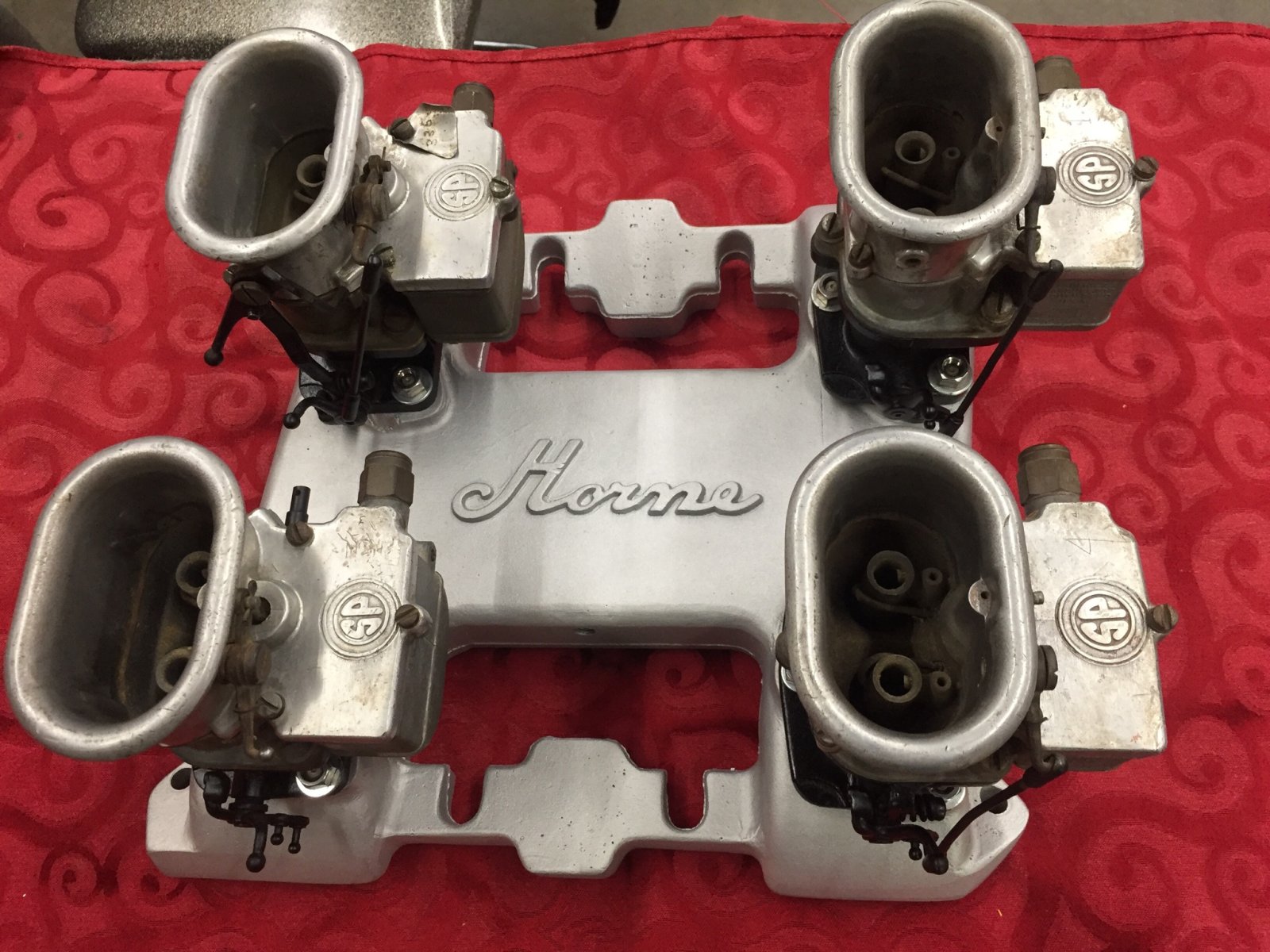

    gave it a gl*** bead blast and mounted some 97's I had with SP tops horne22.jpeg

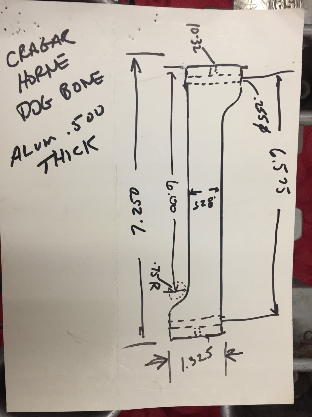

    Made up a couple of dog bones and linkage
    horne44.jpeg horne55.jpeg horne66.jpeg horne77.jpeg horne88.jpeg horne99.jpeg
