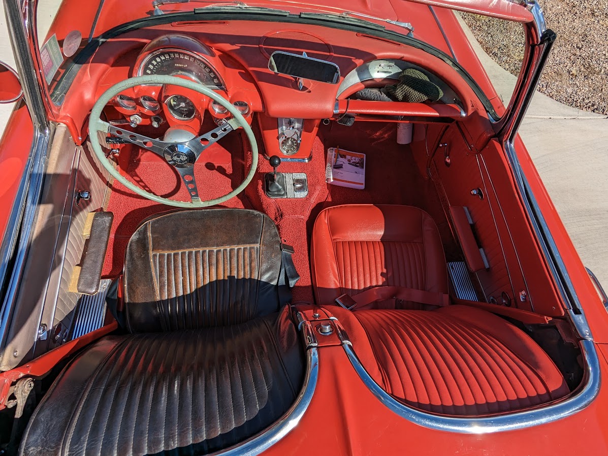

  1. Back doing something I’m more familiar with
  2. You got the wife's side finished first, you're a wise man:D

    I also made her help me ***emble the seat! now she knows what she's sitting on

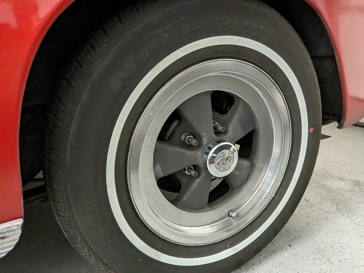

    Anyways, I didn't do much today...put some antifreeze in Plan II, and rubbed on the wheels on the Corvette. I don't do that very often, like never.

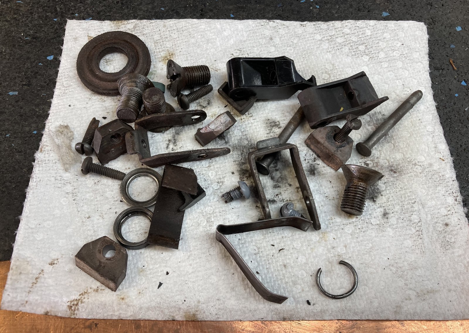

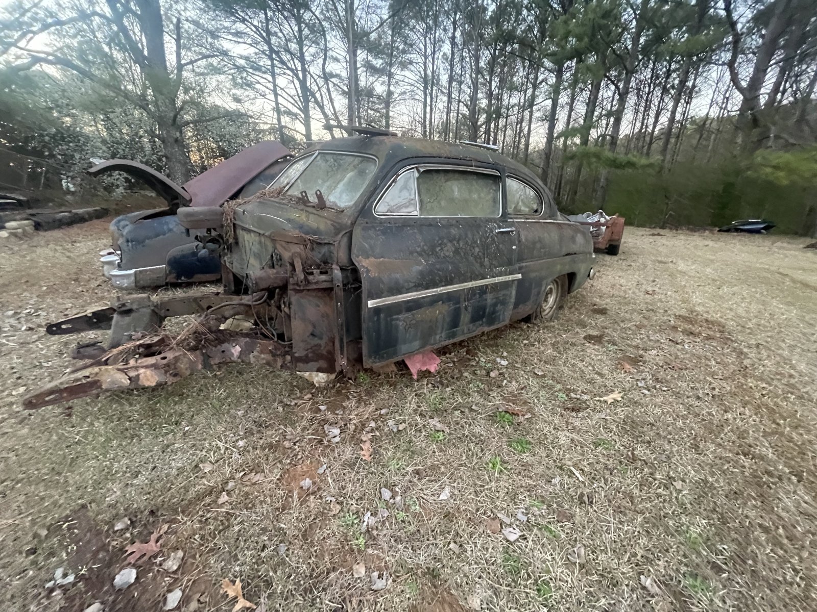

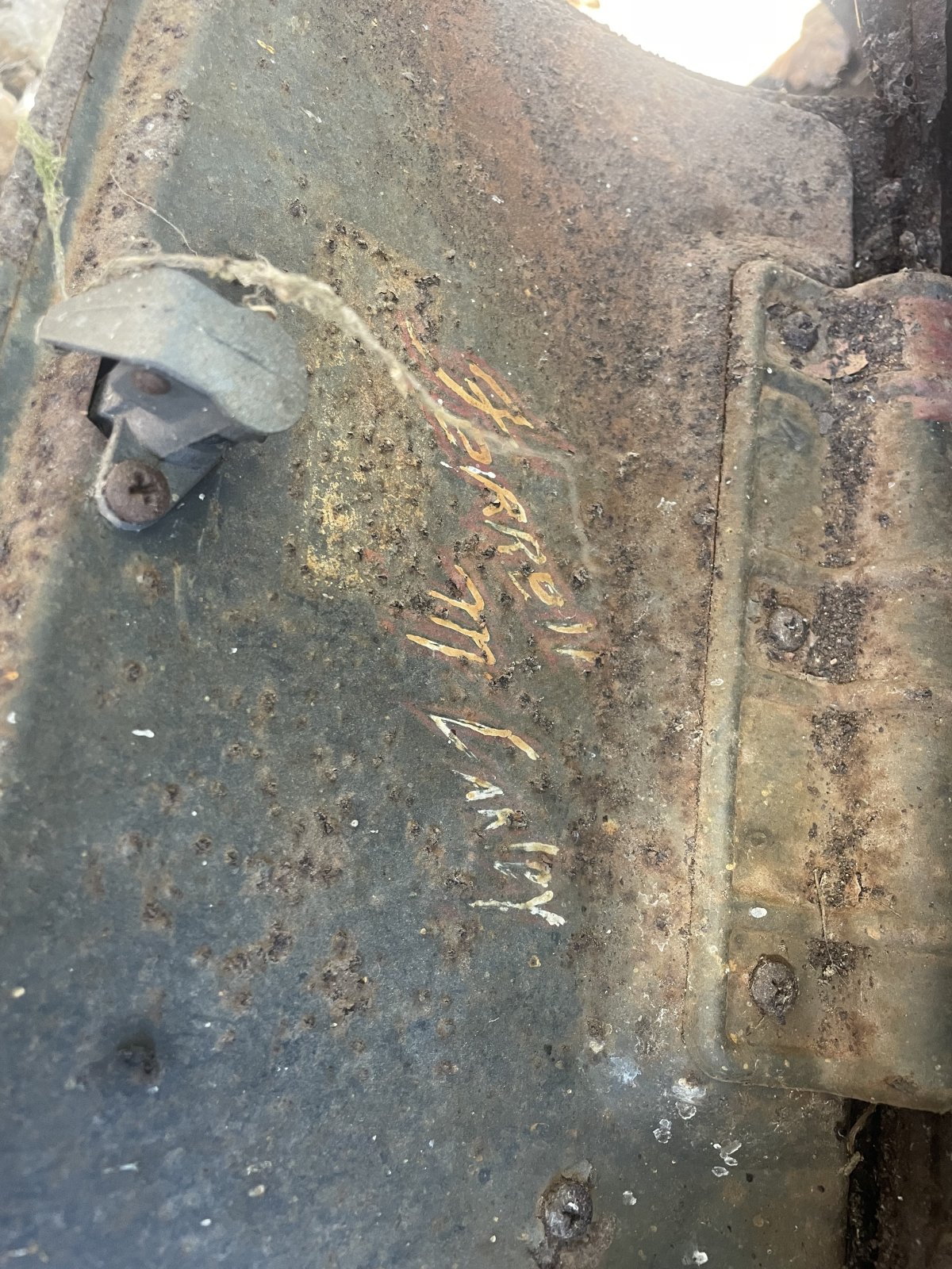

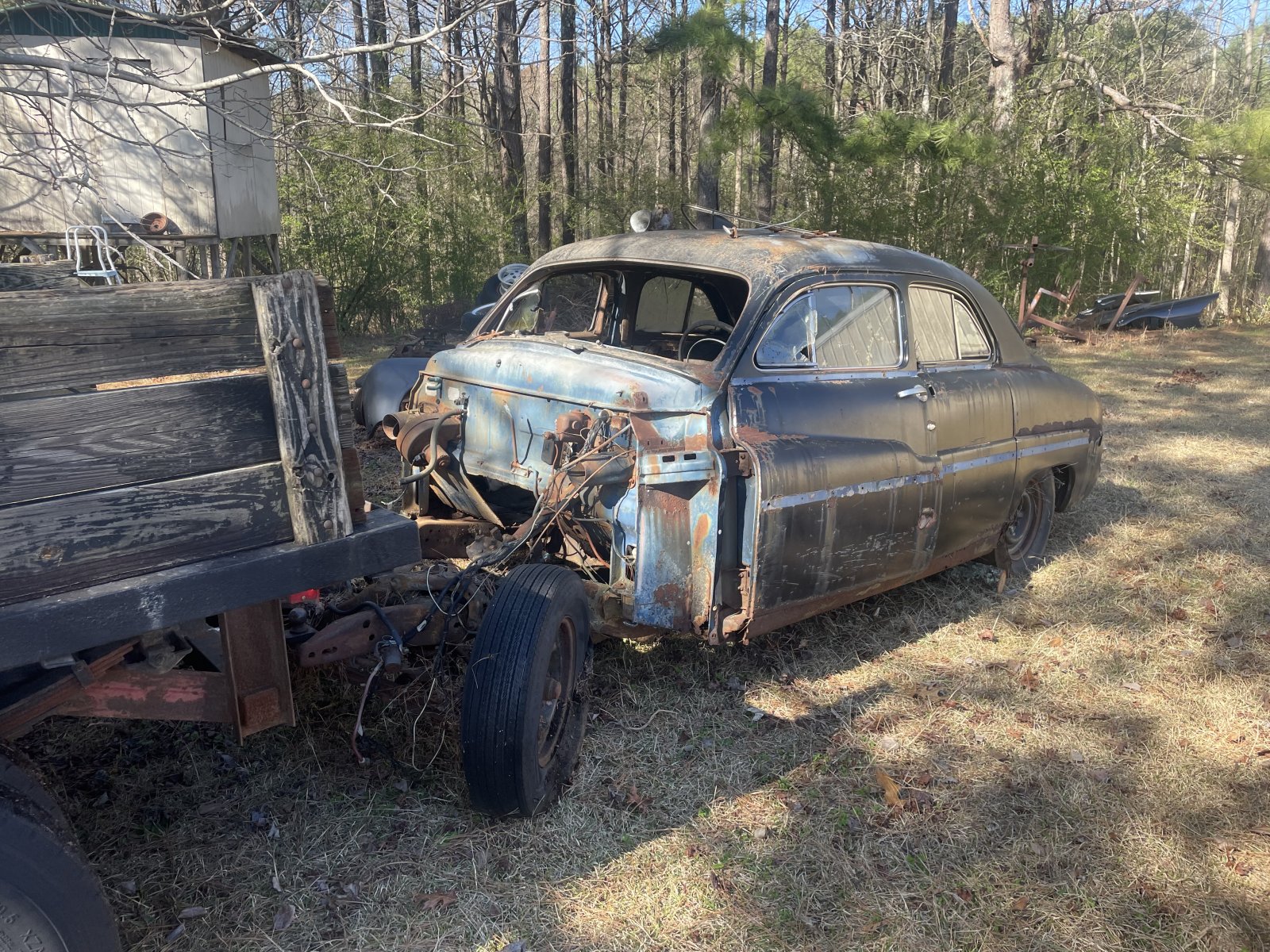

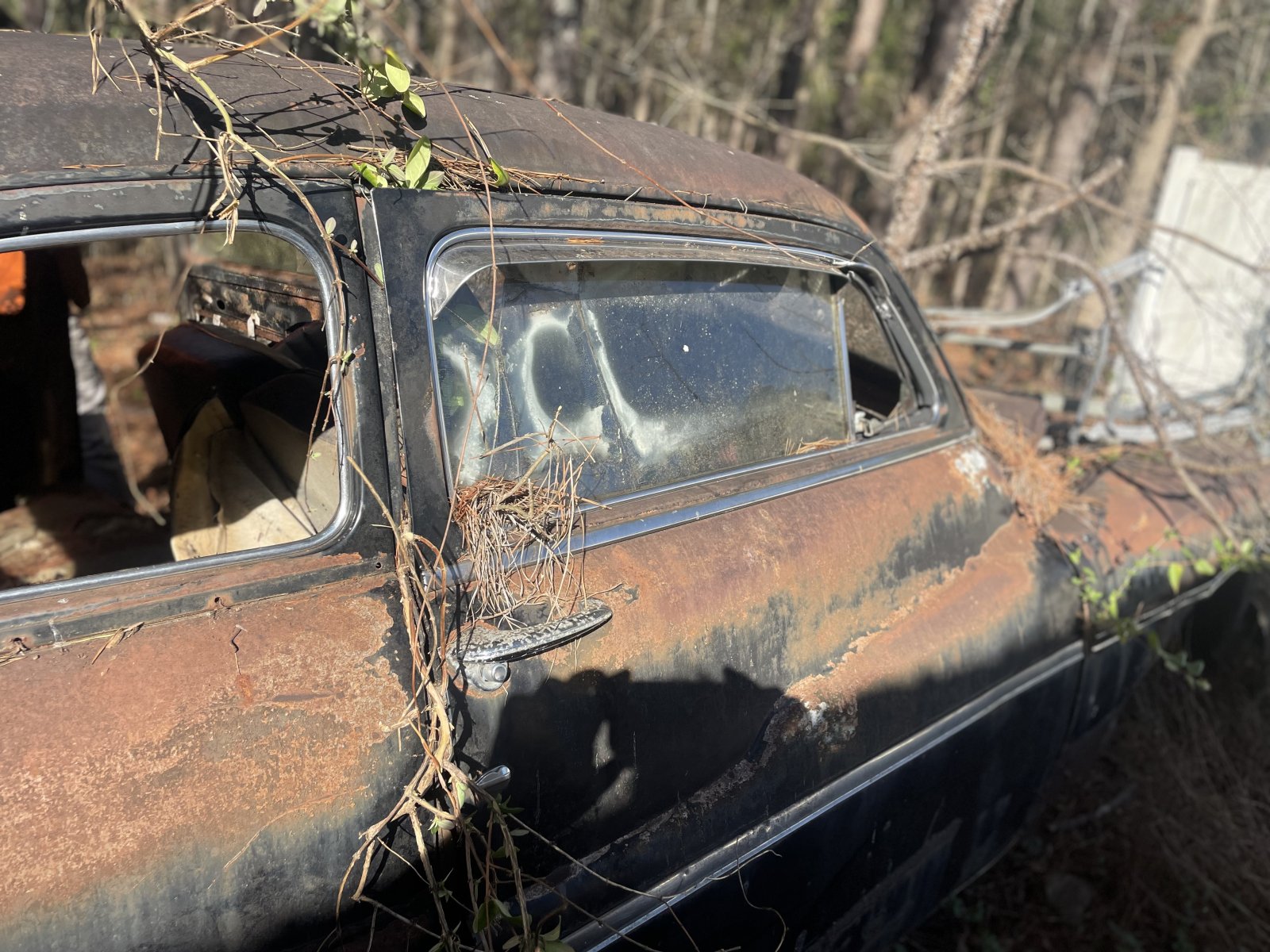

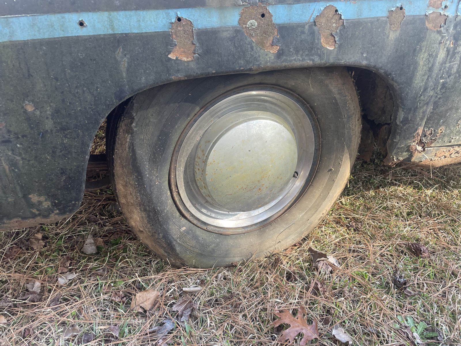

  9. Parts harvesting and spring cleaning
    IMG_7479.jpeg IMG_7480.jpeg IMG_7478.jpeg IMG_7482.jpeg IMG_7481.jpeg IMG_7484.jpeg

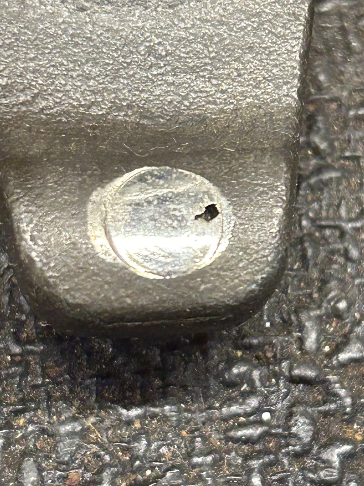

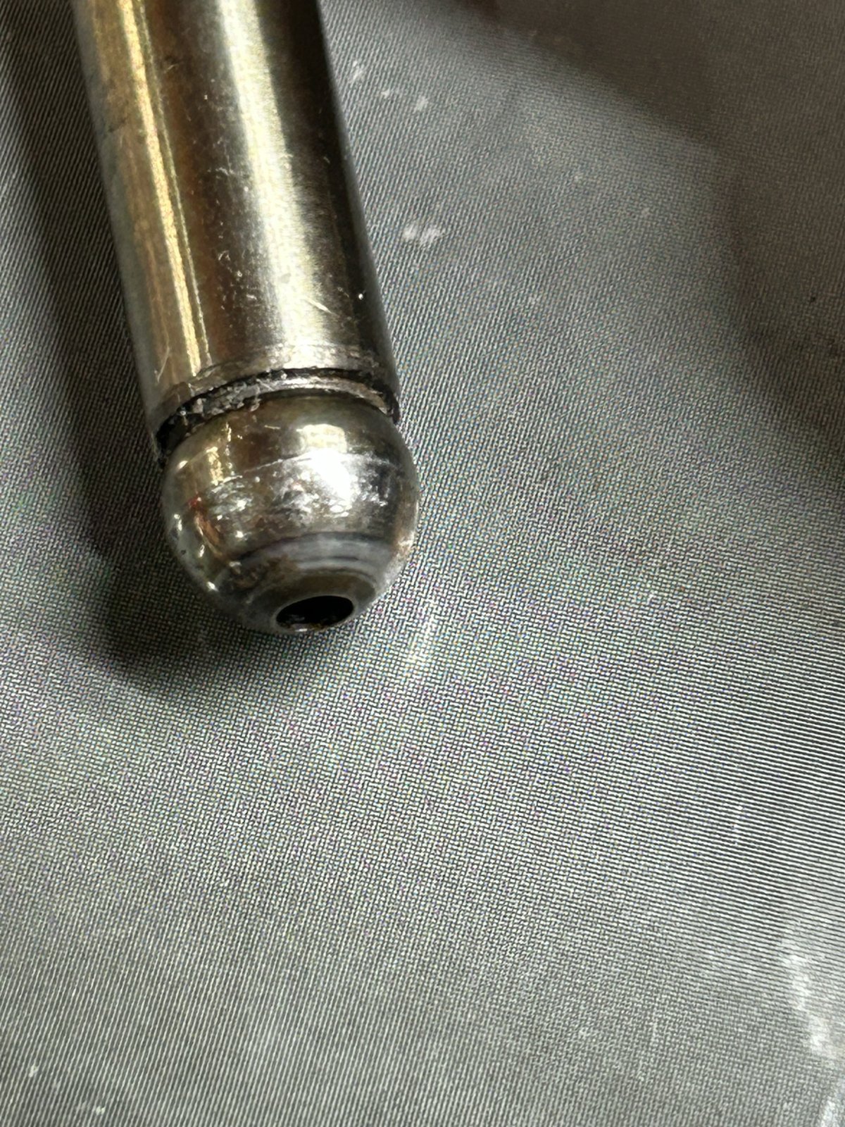

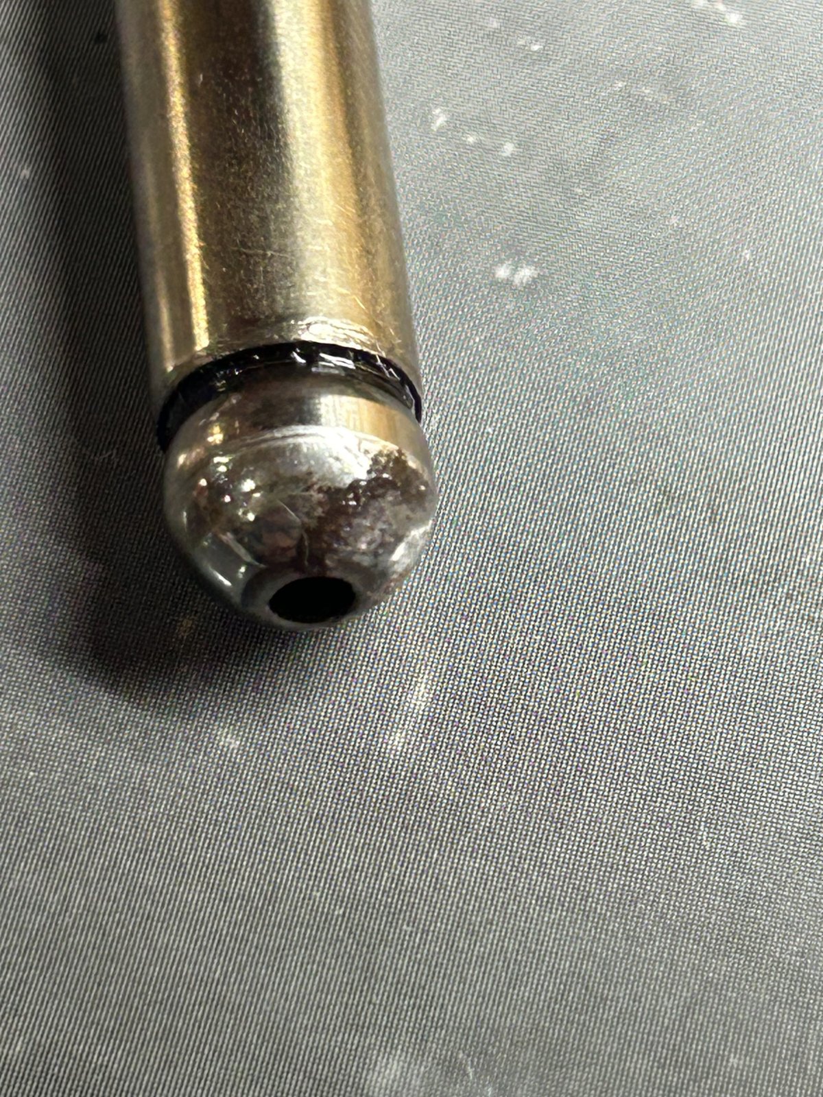

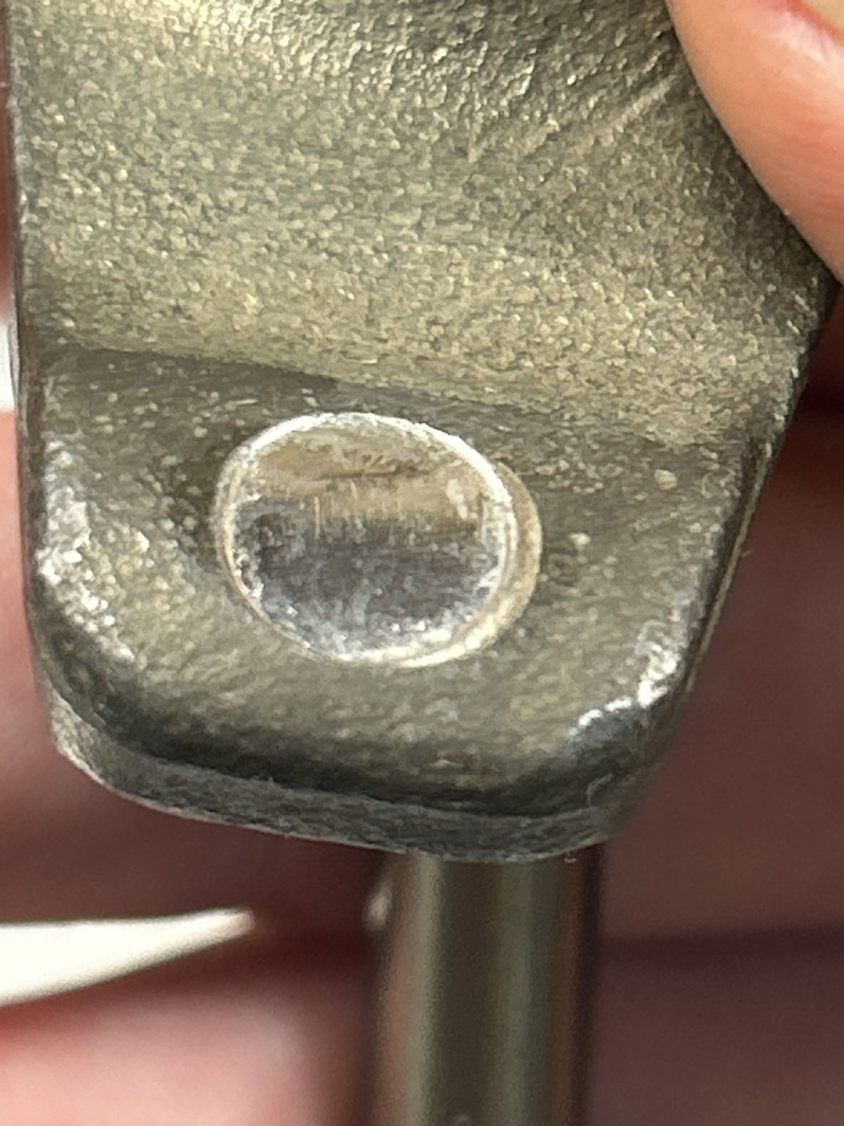

    Planned on doing my valve train install today but realized I hadn’t cleaned the rockers, pushrods, ect. On cleaning realized many rockers were shot. Mucho wear and galling. I ended up just ordering a whole new set of 16 rockers. So build will be on hold for a few days in true turtle speed fashion. :) IMG_0859.jpeg IMG_0860.jpeg

    Replacing pushrods at the same time might be wise also.

    Thanks! 2 were shot. Ordering 16 USA made new ones today. Pics ain’t the best, but chrome corroded and worn right off. IMG_0867.jpeg IMG_0866.jpeg

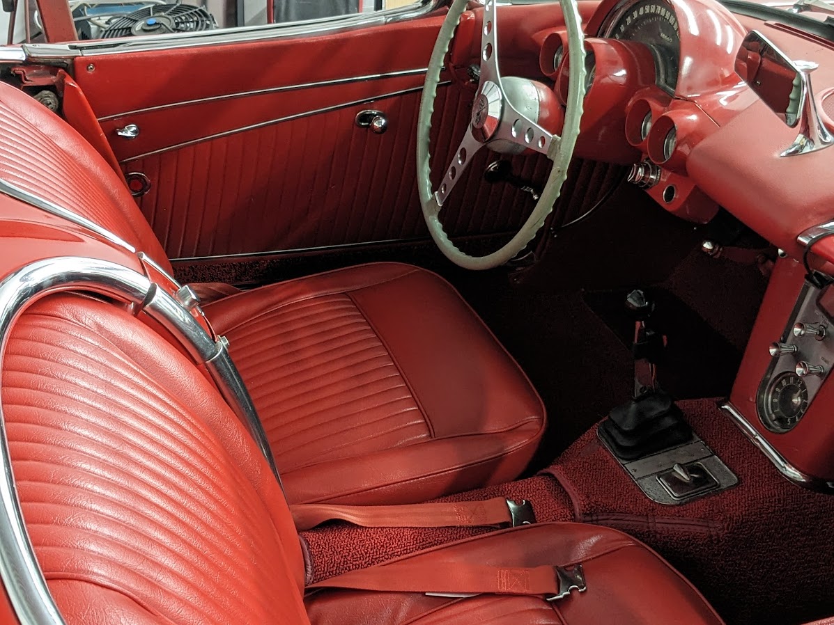

    Anyways, I've been tinkering with interior stuff again. Almost done...needs the driver side arm rest finished, and the steering wheel really looks out of place now. I'm working on ways to make it red, that don't involve complicated painting, which I promised I wouldn't do at my new digs.

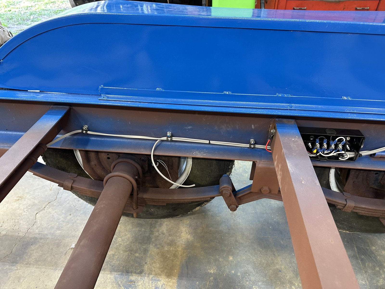

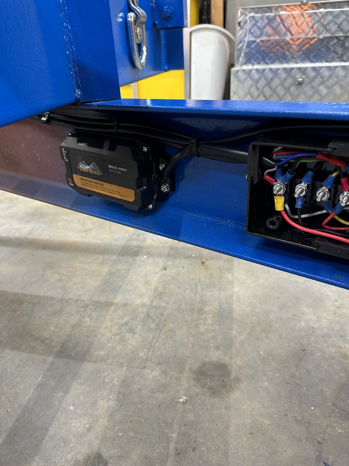

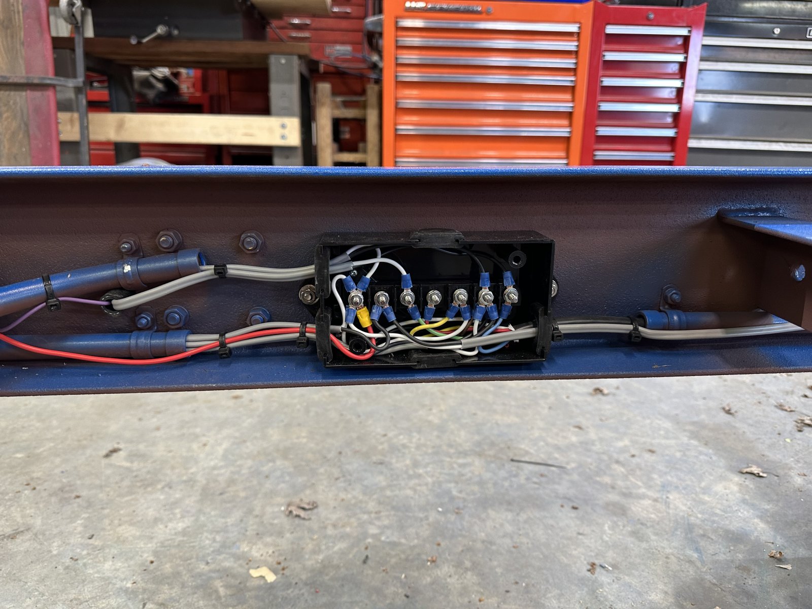

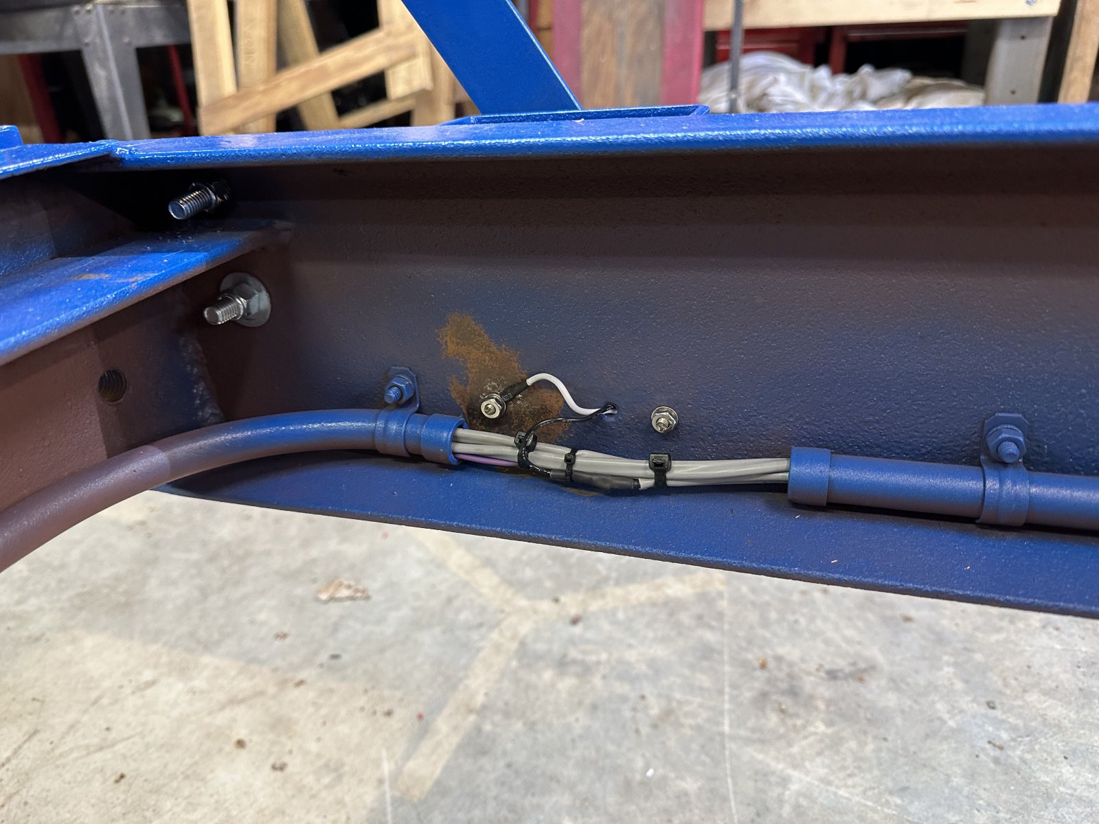

  19. We finished the wiring today on our new to us trailer. The brake wiring hasn’t been connected yet because I want to make sure the brake magnets are still good, we just ran out of time. IMG_7261.jpeg IMG_7262.jpeg IMG_7263.jpeg IMG_7269.jpeg IMG_7268.jpeg IMG_7264.jpeg

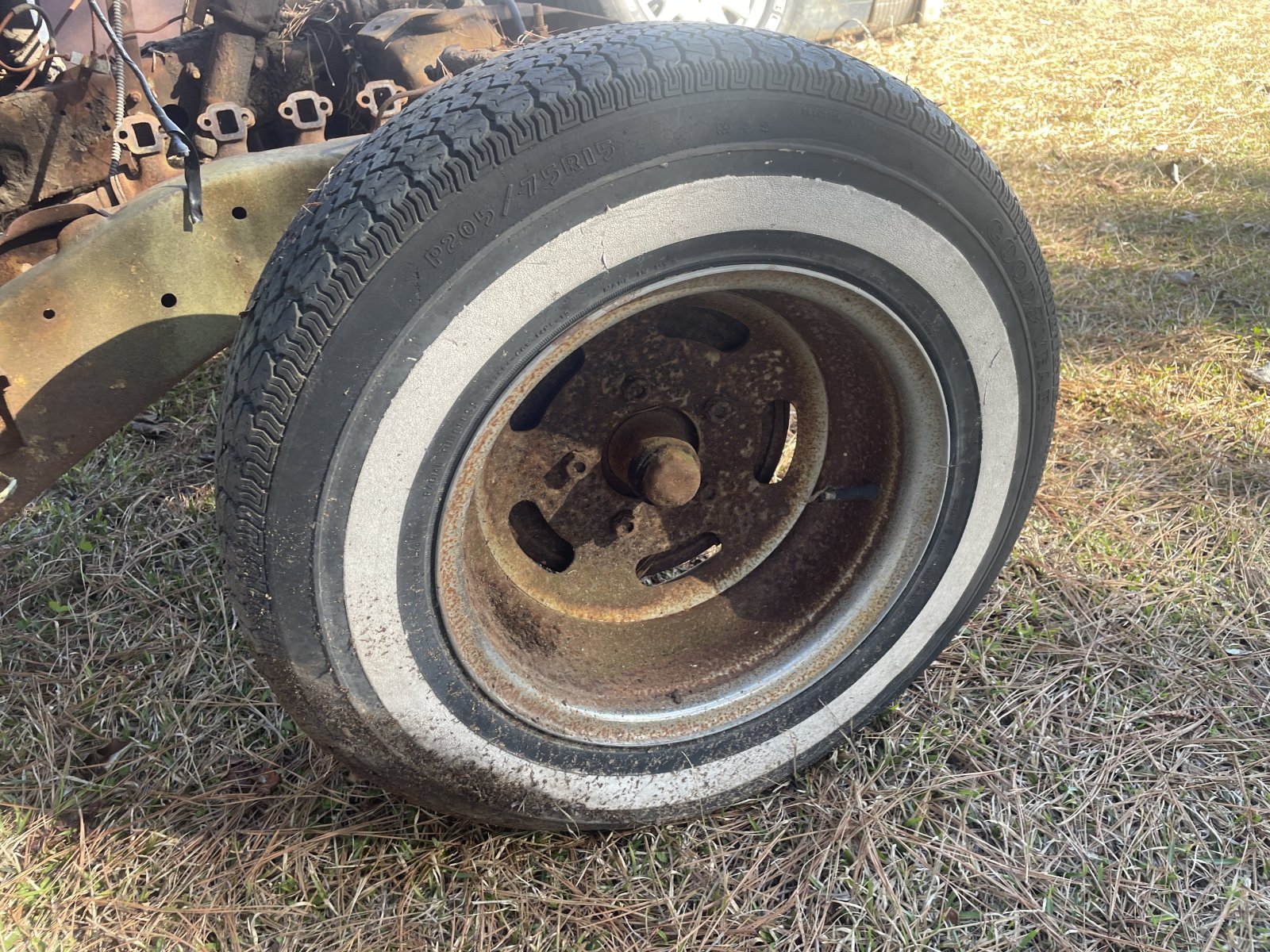

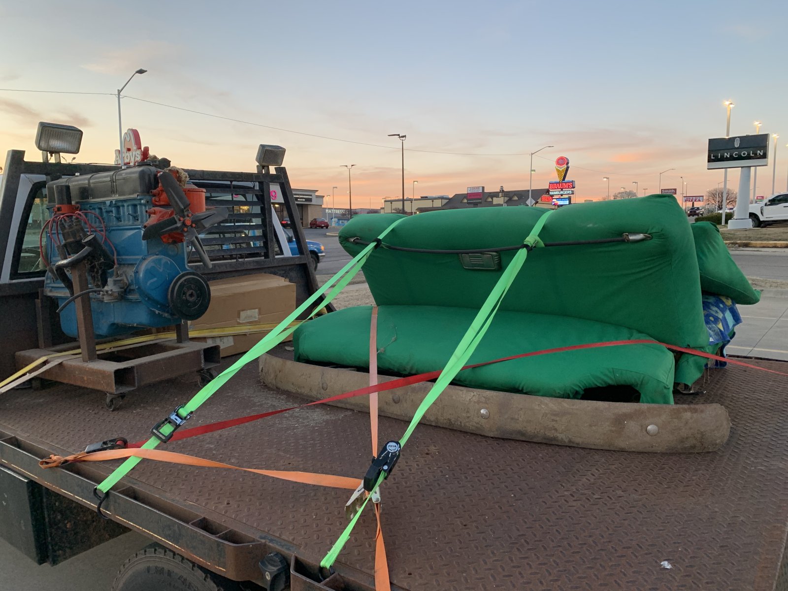

    Finally picked up the rest of the parts for the 53 Chevy.
  22. 5 on 4 1/2?
  23. This one is 5x5 1/2
  24. OK. I might possibly have one, but I know it's small Ford pattern.

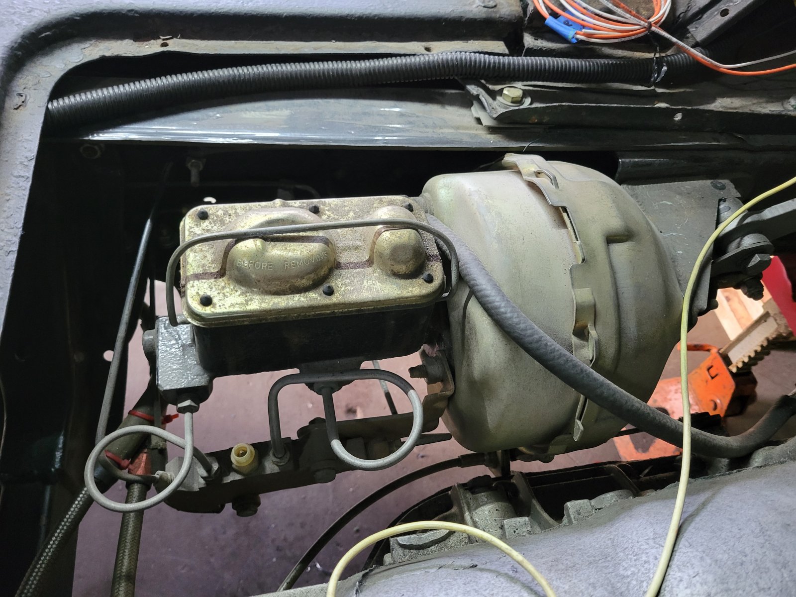

    Since my wiring is pretty much done on the 41 next on the list is changing the power brakes to manual. The plan is to just shorten the pushrod and make an adapter plate to mount the master cylinder where the booster previously mounted.
    Not sure if I'm reusing that proportioning valve or just putting a manual one in the rear line.

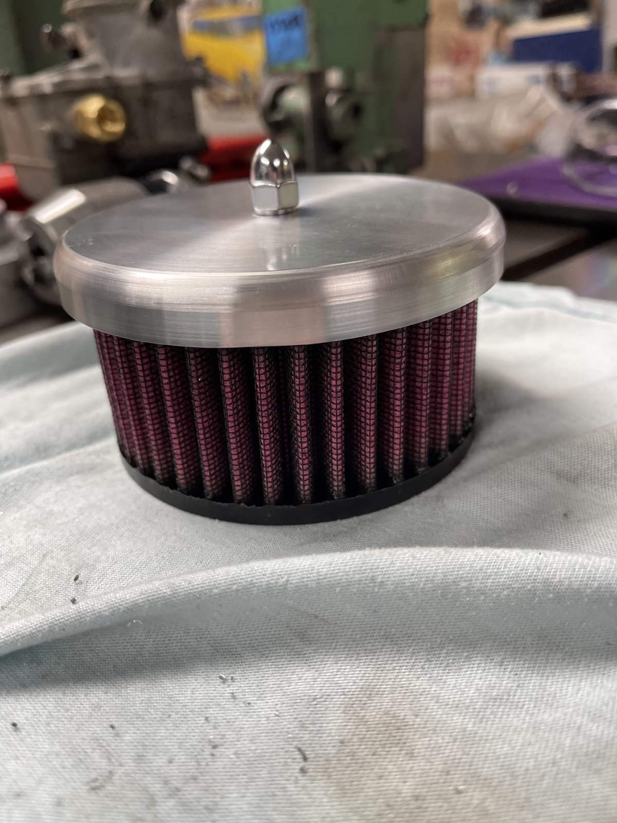

    Trying to make a homemade air cleaner, still haven't figured out a good look yet. IMG_2027.jpeg

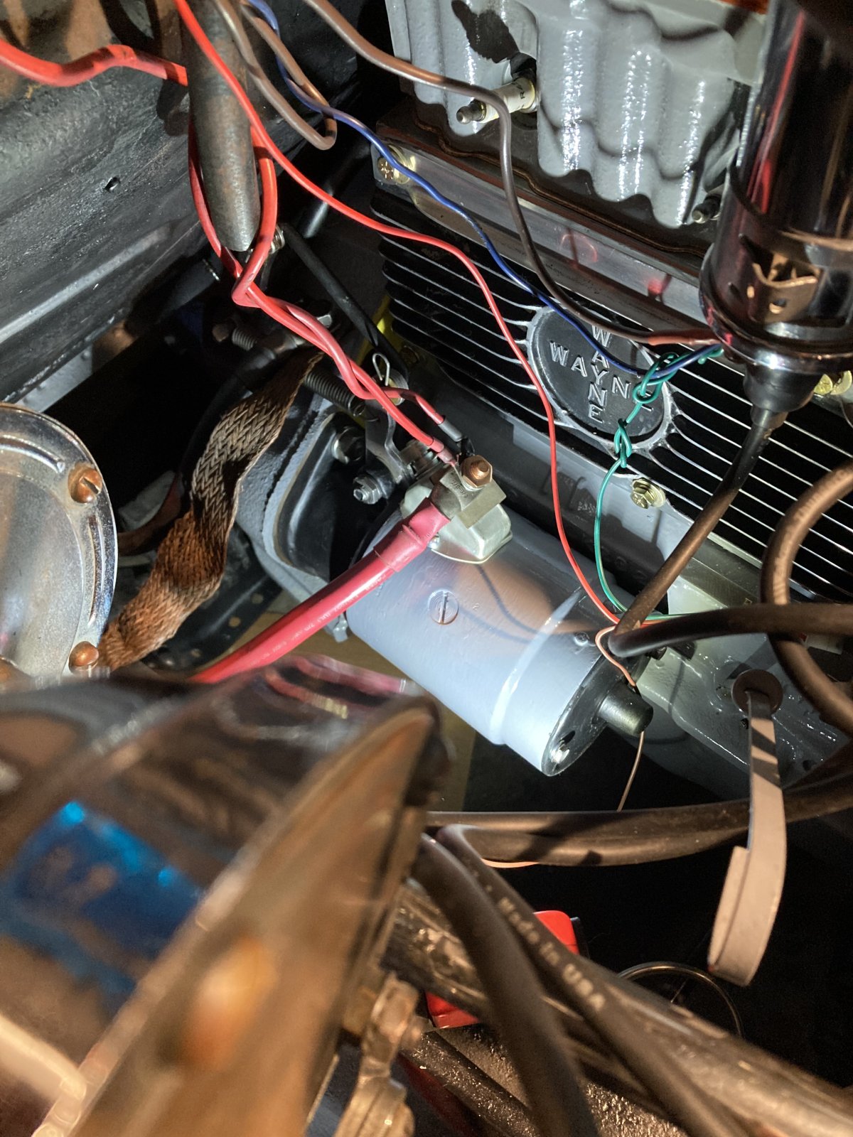

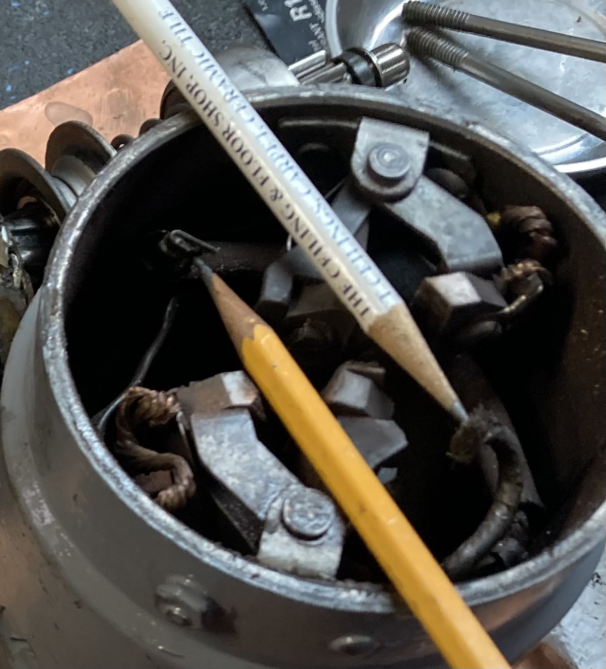

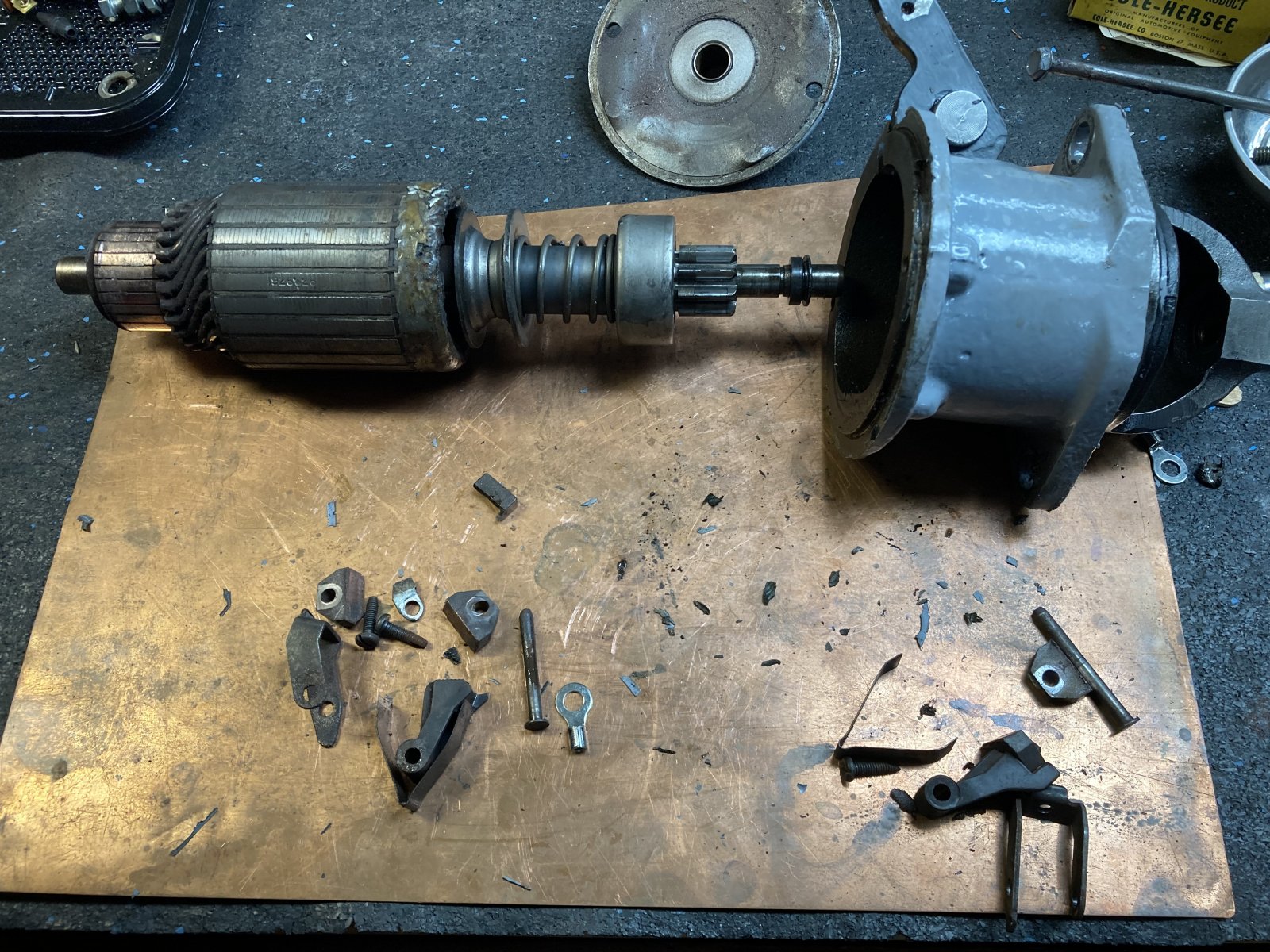

    Chevrolet Foot Starter rebuild. Discovery! Pencils point to two broken contacts. I just ordered some parts so I’m going to spend the afternoon cleaning up the case and preparing for the new parts. I know I’m all Jaques Cousteau on this deep sea expedition. I’ll have to wear a dark beanie whilst I work. The field coils are oily dirty and the brushes were on their last legs. Glad I ran into this trouble now instead of halfway through Kentucky.
    Pencils point to broken off field leads.
    1949 Chevrolet 1/2 ton truck, 1962 261 engine, 12 volt alternator, starter, flywheel.

  29. They are great! Before the completely encapsulated trailer harnesses came along on semi trailers, the boxes were industry standard. I bought 2 of them at work, Techtran brand and when I laid out the harness routing, I needed one more for the brake circuits. I ordered one from the internet, and it was a no name. It works, but not the quality of the Techtran brand. Cheap**** Andy.
    I probably didn’t post a picture of the front, but I configure my trailers like semi trailers for the truck to trailer cords. The trailer has a female socket on the front, just like the truck. I have a cord under the backseat in my truck with two male ends on it. This keeps the trailer cord out of the weather when parked.
