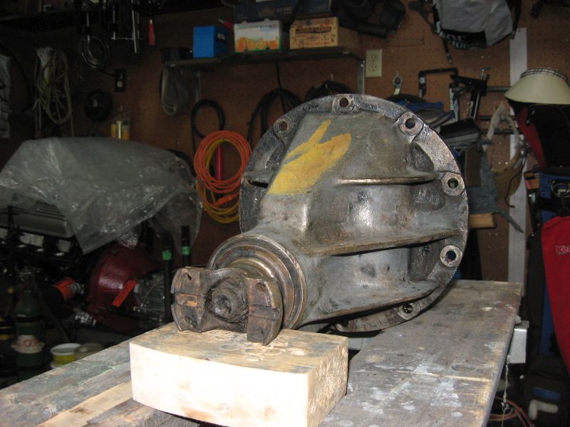

    I got this axle as part of a vehicle purchase but can’t figure out what it is and buddy’s have no idea either. Approx 58” WMS to WMS”, 5 on 4.5 bolt pattern with a removable 3rd.

    Are you sure you measured the bolt pattern correctly? It looks like an Oldsmobile rearend.

    Turn it over and let us see the other side. Might be out of a 55 or so Ford? With the 4.5 bolt pattern, leans toward Ford or MoPar. The u joint doesn’t really look like Ford, but it’s hard to see.

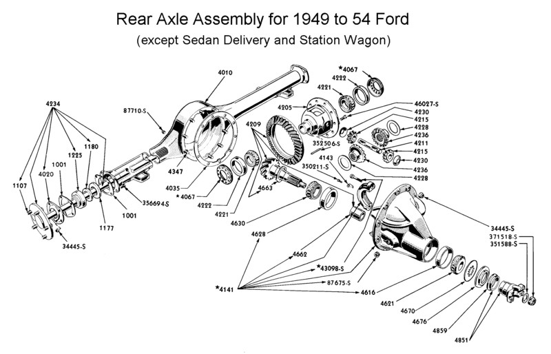

    my guess would be 49-56 Ford car, but more pics would help.
    here's the one I'm thinking of...at least, the center section

    The Mopar 8 3/4 doesn’t have a kick out for the ring gear, but I did forget about the 49-56 Ford rearend...

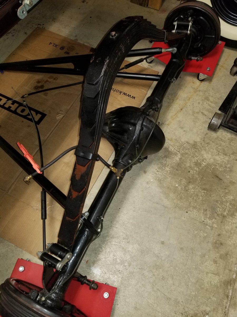

    This is what my 51 ford rear looks like
    It dosent look the OP rear has as big a kick out for the ring gear... and it looks like there isnt a fill plug in the same place.
    I dont think it's a 49-55 ford

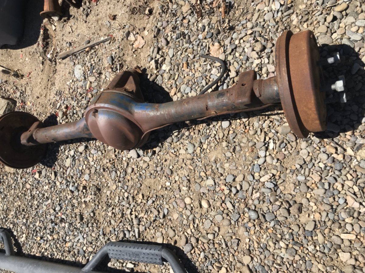

  15. Fyresq
    Joined: Nov 18, 2017
    Posts: 67
    Fyresq
    from Minden, NV
  16. Fyresq
    Posts: 67
    Fyresq
    from Minden, NV
    Finally was able to get more pics on after 3rd different try and see they still ended up in a weird spot. Posting from an IPhone gets tricky on this forum it seems. Thanks for the replies, sounding like 52-55 Ford

    Huh...that's not what the Ford parts book says. But I'm not an expert.
